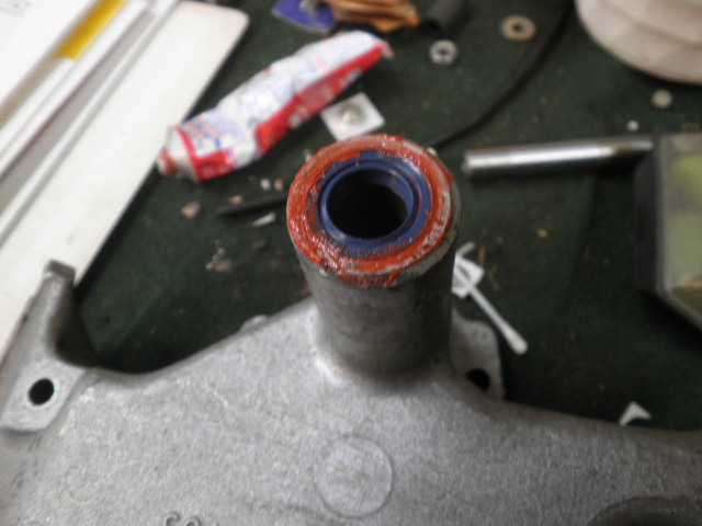

    Finally found the seal for the shifter rod and got that installed. A P.O. had replaced the seal in place and did a nice job gouging up the bottom and edge, so I was liberal with the RTV. Not pretty, but hopefully won't leak:

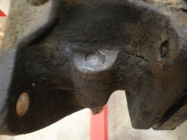

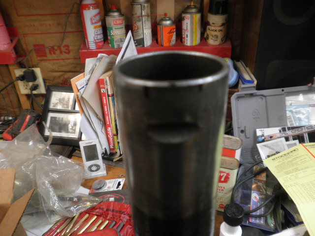

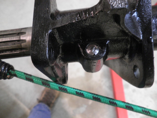

    Got the axle tube marked to line up with the bearing flange so hopefully the retaining pin will go in the first time:

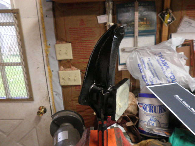

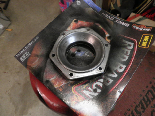

    Oh, and I did not paint the inside of the pivot flange. That's why I had it laying on the pizza carton so that only the outside got paint:

      • Phil, you can use the rolled pins over again. Note that on installation the splits are opposite of each other, ie, inner at 12 o'clock. and outer at 6, or vice versa.

        When fitting the axle flange on, you may want to put a few drops of green loctite on the bottom facing part of the fixing pin when finished. One out of 100 will leak 90 wt there. In the words of Dirty Harry, "do you feel lucky, kid?".
        Oh, don't forget to put the axle boot flange on first!!! Been there...
        Edit: DO NOT be tempted to press against the bell end of the axle tube unsupported when fitting the axle flange. It will surely bend, and you will be needing a replacement tube! Support the with a large socket, or some other fixture. Grind a little taper (1/4"?) on the axle tube to help the axle flange get started squarely.

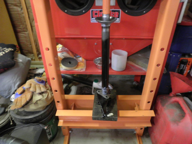

                        Put the axle tube and bearing flange in the shop press and got the tube vertical in 2 planes:

                        Even with Jack's warning I got the tube in about 1/2" before noticing 2 missing parts, so pulled it apart and started over:

                        I had to install it twice, as was off about 2 degrees the first install for the pin alignment.
                        With Bruce's comments on the orientation of the retaining pin I cleaned off the undisturbed right side to see how the slit were oriented:

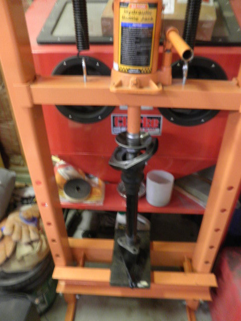

                        I did not like that orientation so installed mine with the shop vice as a press like this:

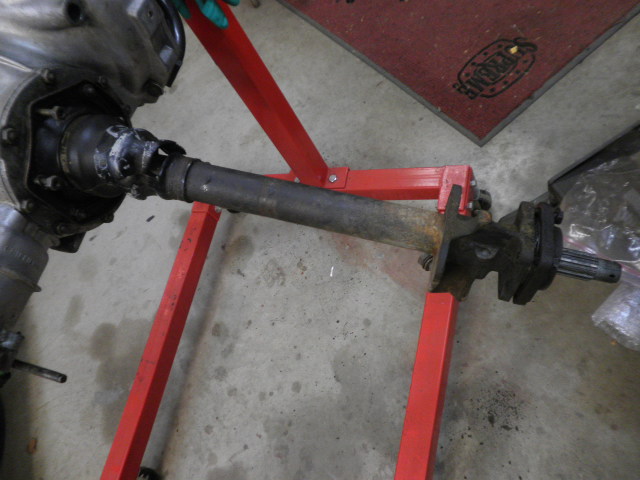

                        With the right side as far as I was going to take it a this point I moved to the left side. Both sides seem to be completely original including the remnants of the rubber boot:

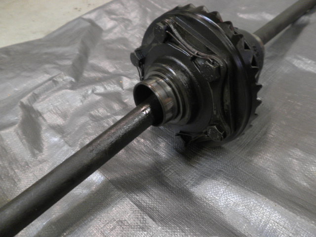

                        I removed the left axle tube and the differential cover plate. Then removed the differential to see what type of ring gear bolts I had:
                        Still has the original 10K bolts and first version of the retainer(wire). I checked Stoddards site and they list 3 different ring gear bolts ending in .05, .06, & .07 I believe. Why so many choices?
                        Tomorrow I will check the carrier for cracks.
                        • Here is some bolt info:
                          http://forum.porsche356registry.org/viewtopic.php?f=1&t=16465
                          A little more...
                          http://forum.porsche356registry.org/viewtopic.php?f=1&t=36915
                          • Phil, I hope that you are not using the cast type press plates. They have been known to literally explode, sending shrapnel in all directions, even during relatively low pressure. People have been seriously injured. Someone gave me a few a while back. I immediately threw them in the scrap metal barrel.
                            • Jack
                              You warned me about those cast plates when I bought this press. What is in the pic above is a 1" thick steel plate I have had for years. But, a good reminder.
                              I need to call Stoddard on those bolts, as the P part # bolt does not list the 12.9, only the NLA part# bolt. Anyway, have put together quite a wishlist on the Stoddard site of tranny parts. Hope my carrier is okay.
