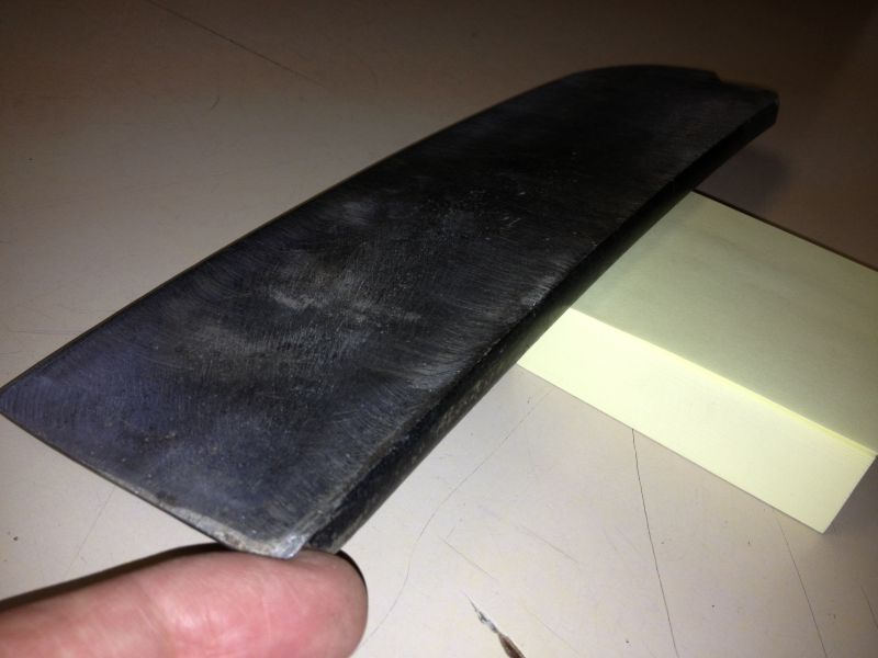

    I made this tool from a piece of scrapped truck spring. It's about 4 lbs and I ground away the inner curve at the bottom to fit into the crease of the door skin and luckily, the rest is the curve of the door bottom up and past the welded repair seam. One guy gets in the car when it's hung on the hinges and another guy outside slaps over it and files a little to find the low spots. Ear, eye protection and gloves a must!
    I can do the majority of the skin myself that way when the car and door is on a lift, but another set of hands works well in the hard-to-reach forward areas no matter what.
    As far as 'slick' (polyester filler putty) goes for the small amount of surfacing, the old adage was that "an eighth of an inch is commercially acceptable" and Ferrari used a sprayable filler that thick on some of their cars I've worked on. Most all bodyshops use at least SOME filler, but that's when talent and time are in short supply. Most filler ends up on the floor and a little here or there is not a crime if done to a minimum and done well...and a 32nd can be considered 'just something to sand' to get it smooth.

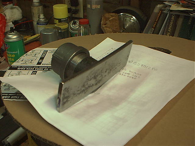

          You shared that with me a while back. I made one from a truck spring also(same one I used to make a slapper) and welded a short piece of black pipe on it for a handle. Filled the pipe with lead shot and put a cap on it. I offset the handle to be able to get to the end of the door.
          My door problem I think is from over stretching one area in the middle. This has caused the metal on each side to sink down a bit. I plan to use the shrinking disc on this middle section and hopefully the adjacent metal will pull back up. Again, not talking much of a dip.
          Regarding filler, thanks all for sharing your experiences. I plan to use lead on the door opening area like the factory did, but for the fenders and door panels will use modern fillers. Hopefully they will hold up for 10 years. That will be all I will be able to drive Foamcar if I get it done in the next few years.

            'Averaging' the metal is perhaps tried with 'off-dolly' slapping. Push the lows while slapping the high spots adjacently. Bump, file, etc. Save the heat for a last resort. You often wind up chasing your tail.

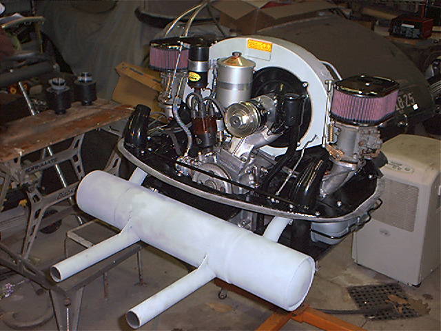

              The good news is Foamcar's engine is done and getting fine tuned in the 55 coupe:
