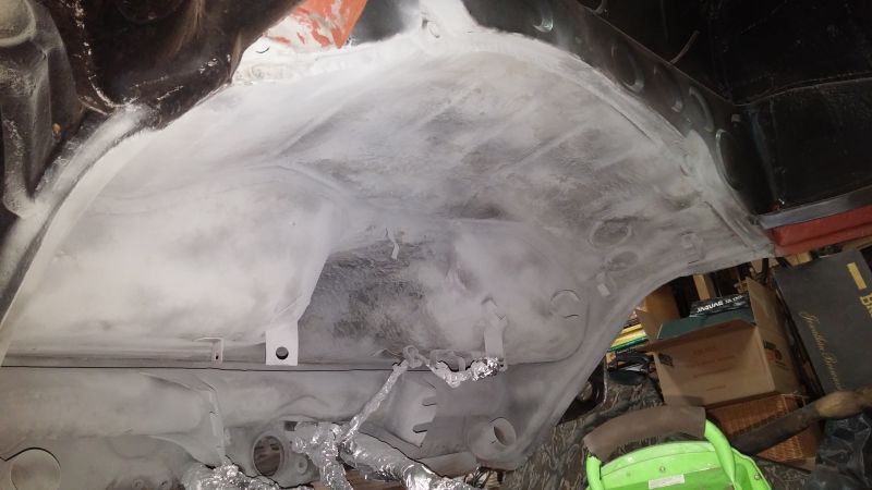

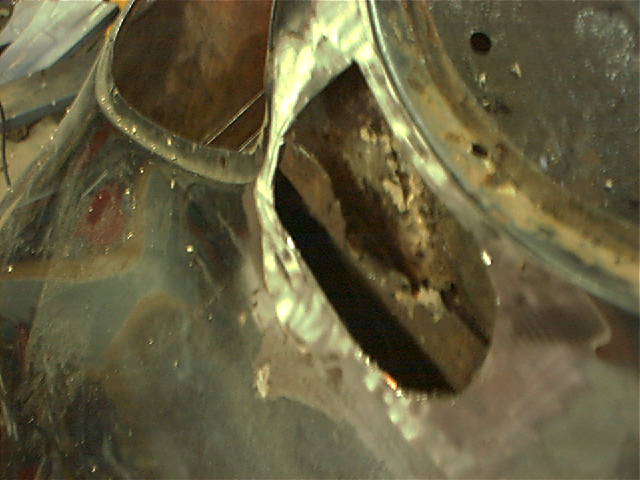

      Finished removing surface rust, foam and a little undercoating on the passenger side. Bruce, when I come to work for you I do not want the job of removing the harness up by the brake line that exits the body and goes to the junction. That one tab is a bear to open up, and I don't see any way to unhook the brake line except cutting through the tab, as it appears to be welded closed. Anyway, my last hour of serious cleaning. Will get up in there with an air gun and blow out remaing sanding dust and prep for recoating.

          Got the undercarriage rusty areas coated with some acid to blacken it, then sprayed with zinc coating.

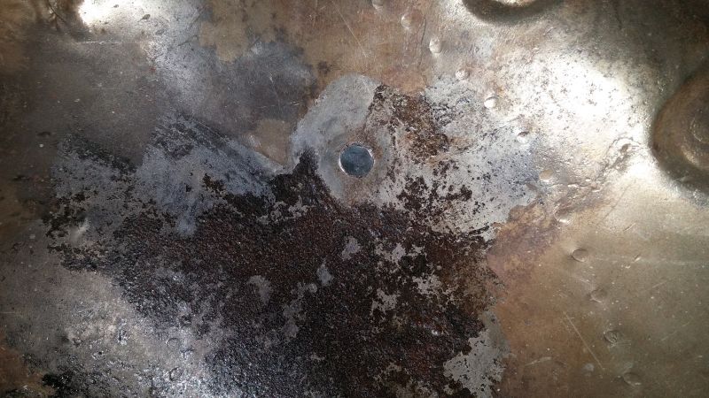

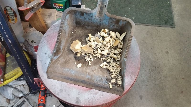

          After the zinc was on it showed a pinhole in the rear seat bottom that I had not seen. In order to get to the interior side of the hole, had to remove a lot of boxes from inside, and the last remnants of foam:
          Drilled it out to about 1/2" and made a dime size patch.
          Showing 2 pics to get you oriented where the hole was. There was surface rust and light pitting near the hole, so coated that with the acid.

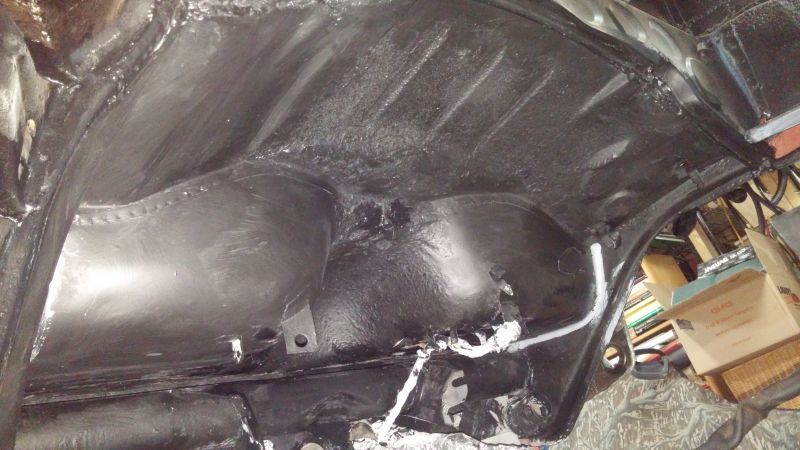

          Got the patch welded in and smoothed down. Re-coated the patch area with zinc and then put my rust tuff latex paint over the whole undercarriage with a brush. Will touch up if needed when dry, then time for the undercoat.
          • That's the last of the foam??? I'll guess you've been picking on that infernal stuff for ten years. Congratulations!

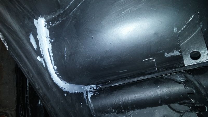

            • The latex Krylon has dried so I put seam sealer in the troughs on both sides where the rear seat bottom meets the frame rails. Next step, undercoat.

              • Phil, I approve of your use of seam sealer to protect moisture from the underside. In my local, rust is more prevalent from the inside-out, with water leaking at the window seals and other places, soaking the interior and creeping through the seams. Perhaps you could use a little spray foam on the inside to preserve those areas.
                • "Perhaps you could use a little spray foam on the inside to preserve those areas." That was mean Jack...
                  So true though, the rot takes root from pooling moisture from the inside.
                  Looking good Phil and nice to see you made it past the bottom side of that seat pan area.

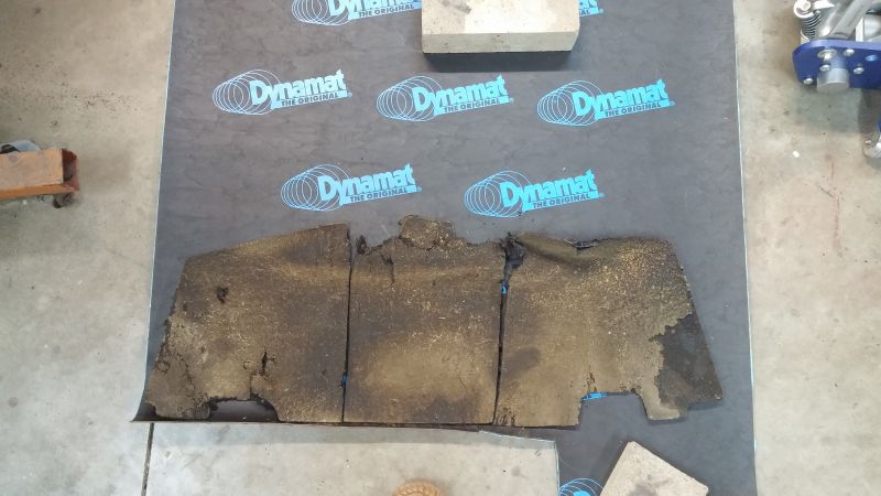

                    • Finally getting the trans undercarriage wrapped up. Used the old pieces of tar paper for patterns to cut out new sound insulation using Dynamat:

                      Installing both pieces was a bear. This is where a rotisserie would have really been nice. I used 2 coats of heavy duty spray adhesive. Very hard to get it placed just right, as once it is on it is hard to reposition. The Dynamat also tore open in a few spots rather than stretch to conform, so had to cut some small filler pieces. All installed and another coat of undercoating to cover the Dynamat advertising:

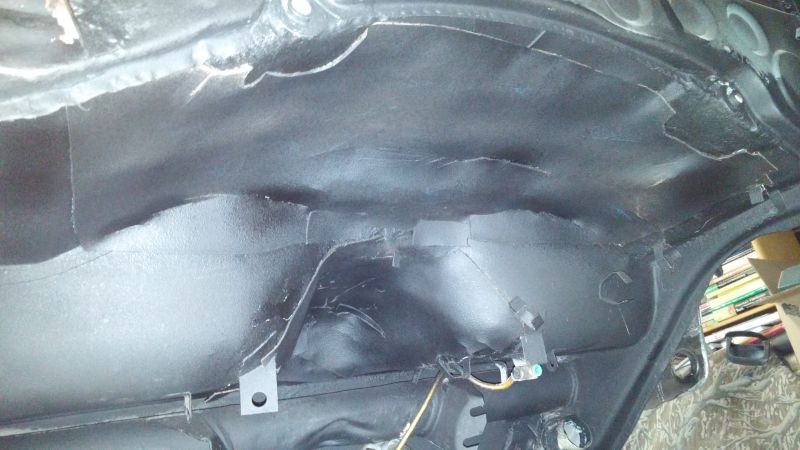

                      It takes about 2 days for this undercoat to harden(not Wurth, but Duplicolor sound and undercoating - figured it won't be seen and maybe it will help reduce noise a little). I will then coat with a sating black and start installing small parts prior to putting in the transaxle.

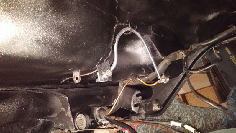

                      • After coating the undercoat with a satin black paint and reinstalling the wire harness and new upper brake line I hit the 1400 hour mark on Foam Car. I am not counting transaxle, engine, brake rebuild/repair.

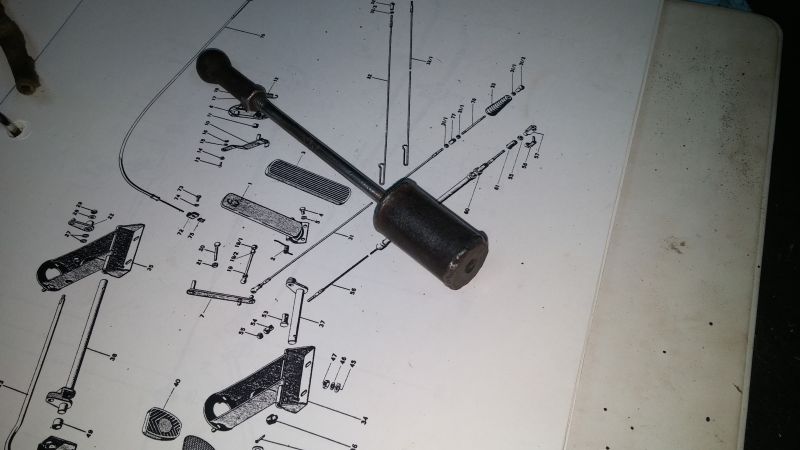

                        After attempting to clean up the ebrake cable housing I did what I should have done at the start of this undercarriage cleanup. I removed it and the homemade heater cable, along with what looks like a homemade accelerator rod connector:

                        • That accelerator coupling looks pretty stock to me. The newer style is a metal cylinder but the older ones were a solid rubber cylinder with a washer glued to the ends. Just look for cracks or de lamination of the end washers.
                          A new one is pretty cheap, if you reuse this one put some safety wire around the ends so when it brakes (and it will) you won't be stuck on the side of the road.
                          • Sorry, bad picture JB, it's all steel with welded on end pieces.
                            • Save it it will never brake
                              • Phil, that throttle connector is a "B C" thing. That is a common repair back in the day. Early cars used a solid rod. Use what you have.
