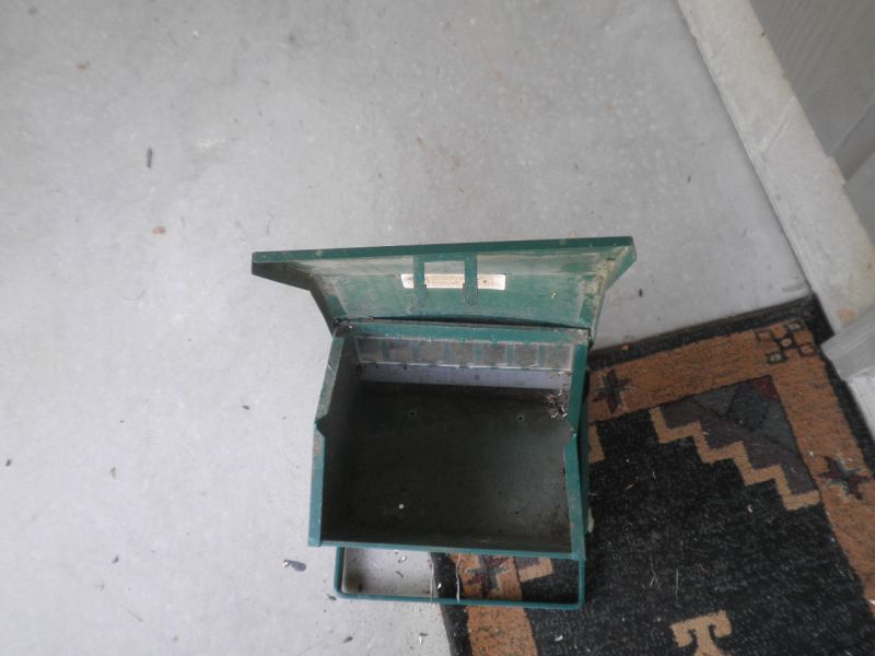

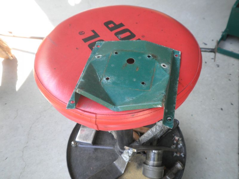

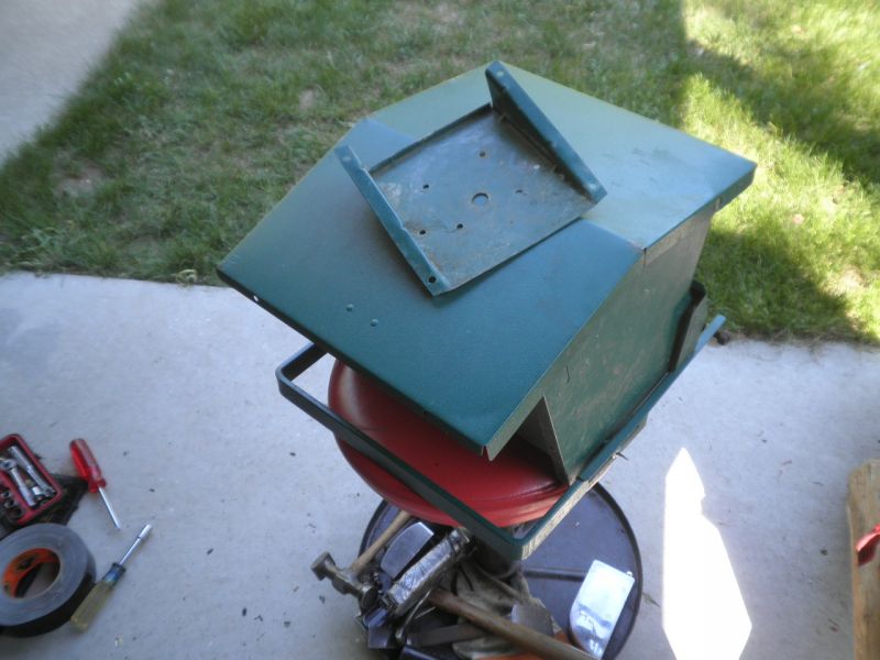

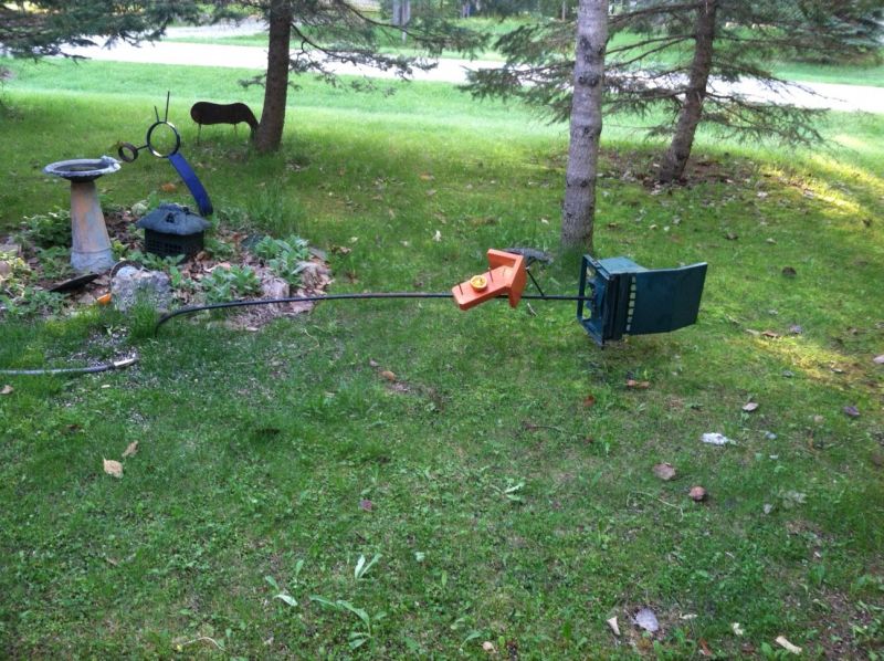

  • Here is one reason I am not currently getting much done on Foam Car. A bear attacked one of our bird feeders the other day. Had to use hammer and dolly to repair the feeder.

    All straightened out:

    • Phil,
      We have the same feeder and like you the bears found it. I added a 6" long pipe to the bottom of the feeder that fits into the pipe in the ground and now we take it in every night...hope the birds appreciate it!
      • Phil, I think a new bear skin rug would be really nice to lay on while you finish up the metal work on the Foam car.
        • Originally posted by JTR70" post=19322
          X2
          -The birds

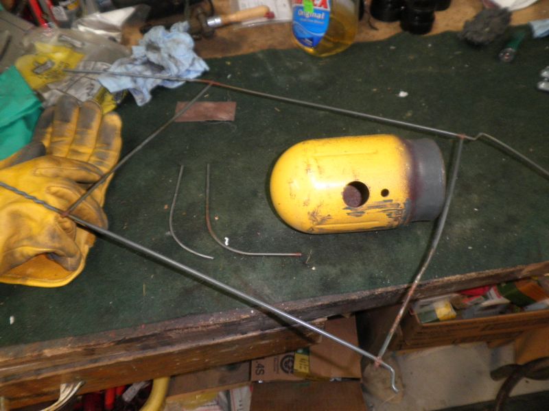

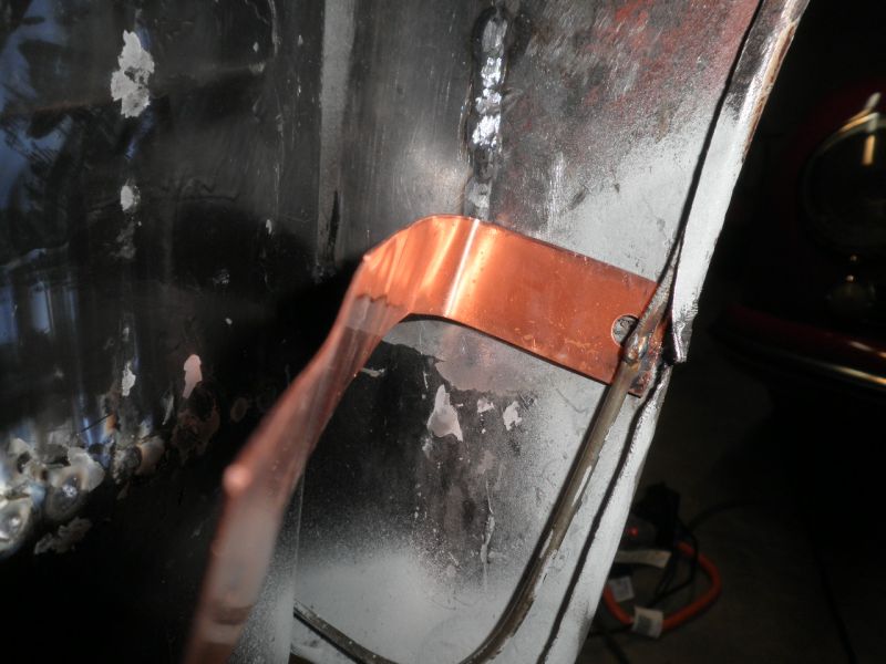

            I found an old political campaign sign which Bruce likes for the fender bead wire. Used the cap for my welding tank to form the wire to just about the right curve. Had to make it a little tighter on a smaller diameter tube:

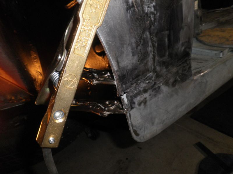

            My first attempt at welding the wire ends together:
            I clamped the old and new wires with miniature vise grips and thought I had a good weld, but did not. Started over by bending the old wire out a little to clear the fender and lined it up by hand and welded it:

            Then I welded in the remaining butt gap at the rolled edge and filed in the radius and butt weld. I also spent time with a shrinking disc on the long vertical weld for the rear of fender repair panel and raising a few more dents near the rocker fender joint from old accident damage. While there is always a few more details to take care of, like the ugly looking weld penetration on the inside of the butt joint, I am happy to have this outside are metal finished:

            • Very impressive Phil. Sounds like you're having a good time. Your right, Grandkids trump it all. This tune's for you and the rest of this bunch...
              Best,
              Joel
              http://espn.go.com/video/clip?id=11093209&ex_cid=espnapi_internal
              • Phil, the important thing is that you've got your priorities in the correct order! Oh yeah.... Nice job on the fender wire
                • Looking good Phil! So nice to see a political sign actually being put to good use. Sounds like you certainly have your hands full this summer but Keep up the great work as time allows! Justin
                  • Well done Phil. I use copper to keep weld where I want it also. Gordon
                    • Looks very nice Phil. Keep at it.
                      Did your rockers not come with wire in the end curvatures? All the ones I've bought were wired already, although I have had to do some gentle re-shaping to the curves.
                      Like you, I really love those shrinking discs!
                      Take care,
                      DG

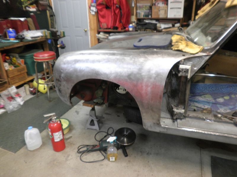

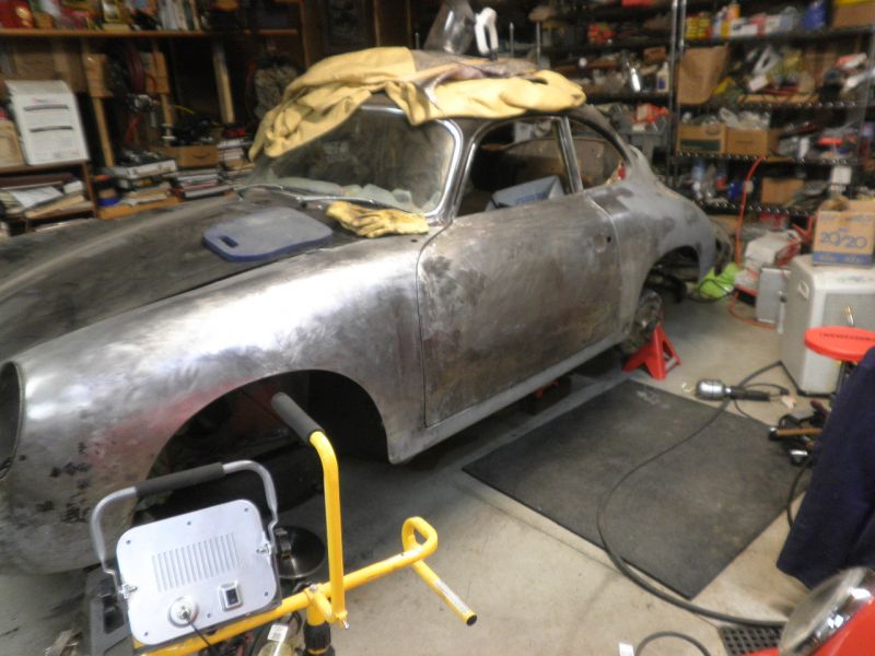

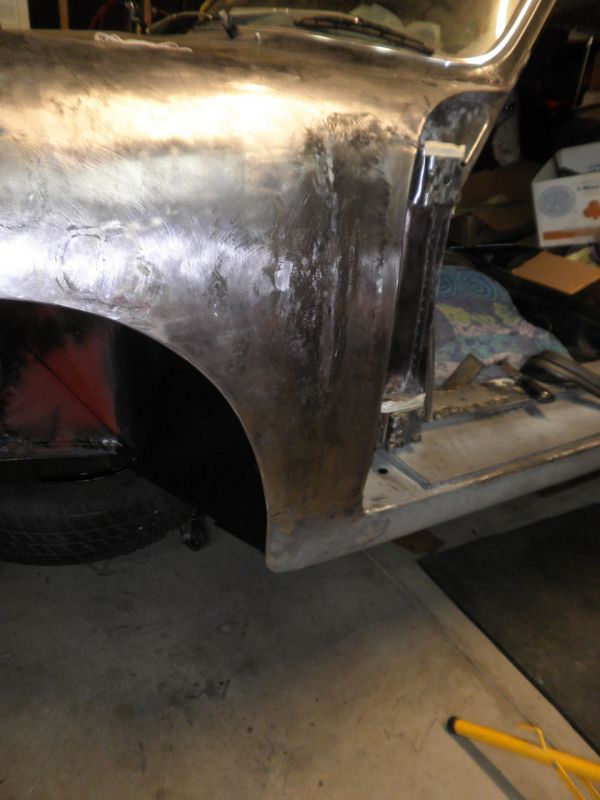

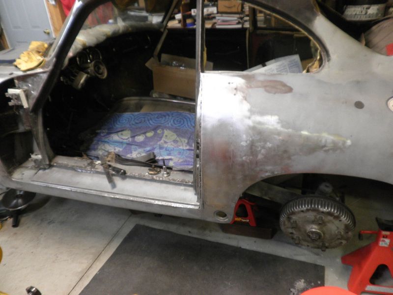

                      • At hour 1350. Got the rear wire formed for the rocker and welded in. Rolled the metal back over the wire and finished up the butt weld in the wire area. Went over the front of door and rear of door repair panels with a DA sander to even out the metal appearance and prep it for priming. Put the door back on to finalize the shape of the rocker at the front door lower corner. Also this freed up some shop room for the transaxle, which is coming out soon so I can get in and weld the quarter repair panel to the lock pillar.

                        Front fender DA sanded

                        Rear fender welded up and DA sanded.
                        Door installed for final contouring of rocker at lower front.
                        • Awesome Phil.....so nice to see the entire side practically done. Great pic and great work!
                          I hope you get 1300+ hours enjoying the car when finished! Drive time, show time, ice cream trips, car wash time... Ha ha, not that fixing 'em isn't fun!
                          • Beautiful Phil! What an amazing sense of accomplishment you must have felt this afternoon; who wouldn't after all you've had to go through just to make it this far. Congratulations on a job well done!
                            • Wow! You must feel great to see that light at the end of the tunnel getting closer. It looks great.
                              JP
