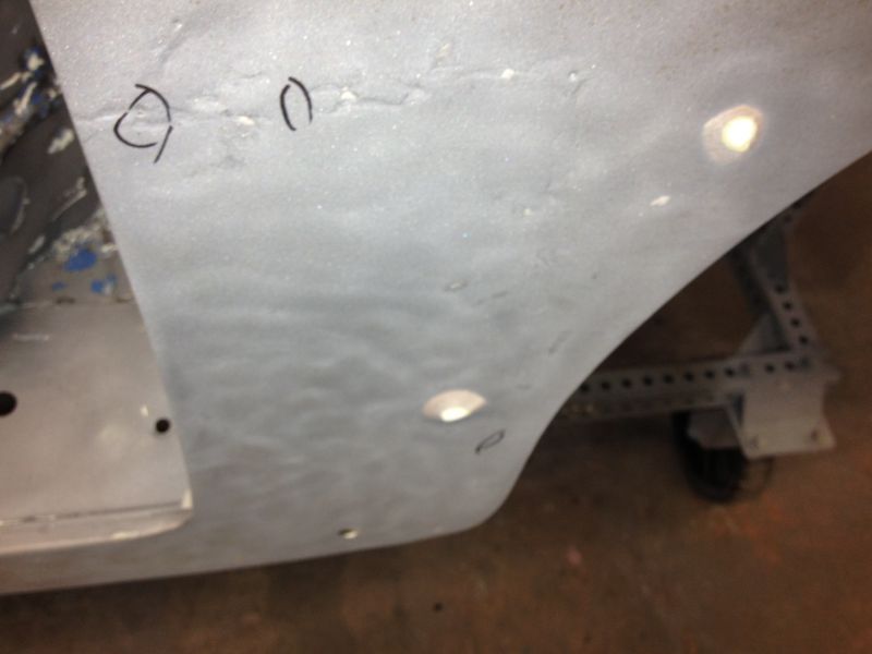

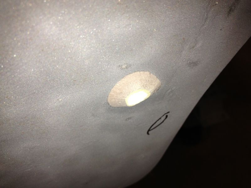

    Anyway, I wanted to share a 'first' (to me)- I just got back an SC Cab from my blaster. The car was disassembled and/or thoroughly masked and I asked that he just strip the paint and I'd deal with any filler. I guess he was showing off, but he removed all the 'mud' but for small mesa-like outcroppings. This pictures shows an area that was replaced on the right front fender's trailing edge over 30 years ago, Ivory paint on top and pink 'mud' under it. I hope I can do better now!

    You can see in the jamb that the 356 was originally Sky Blue. The owner says he just can't go back to that and that Ivory is all his son (and heir to the car) has known. Still, the choice will be made by the 23 year old who has taken a liking to his Dad's 356. I'm hoping for silver.

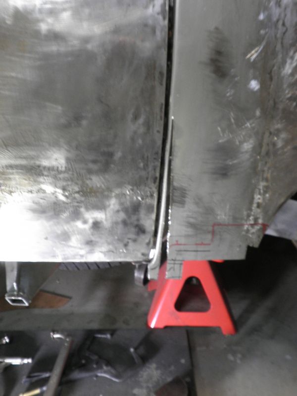

      I have remounted the rocker several times, hoping to finally weld it in place, but, not happy with the wider gap at the bottom 10" of my quarter repair panel. This was possibly created because the repair panel contour was not quite pressed down tight enough when I tacked the rear edge in place. Am considering slitting the last 10" to pull the bend forward and fill in with a small sliver. But at least am happy with the rocker fit.

        • At hour 1331. Well, it took 3 hours to "adjust" the bottom forward edge of the quarter repair panel. Had to do this before Bruce piped in and told me a better way to do it. Here you can see the wide gap at the bottom:

          So I got off my air tool with cutoff wheel and slit it open so I could move it forward to even out the gap:

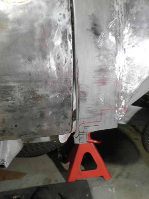

          Made a patch sliver to fit in the opening and tacked it in place:

          So now I can finally get serious about installing the rocker - yeah!
          • I'm glad to see you have been able to get some dedicated "work" time. My other job keeps on getting in the way for me Great job on the repaired repair. You're becoming quite proficient!
            JP
            [email protected]
            • Nice job on that section Phil! The attitude of panel just tends to creep as welding progresses in this area. I experienced a similar issue on my repair. Looks like your a step closer to going into lead. Keep up the great work!
              • Phil,
                I like that modification. Really worked out well for you. This cutting and inserting is interesting to see. Well done.
