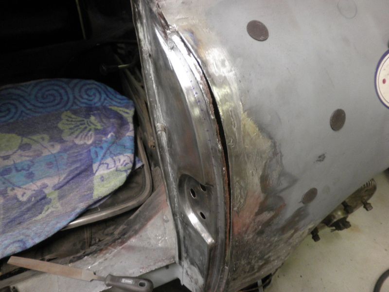

              I have been busy with several other projects but managed to remove the lead from the lock post to expose the rust. I think I will order one of the quarter panel repair patches for this area rather than struggle with making that double bend and curve.

                Hey Phil, I contemplated ordering the repair section as well but soon came to the conclusion that it was going to be leaded over again anyway so a hand made repair section would suffice. Hard to say from one photo but it looks repairable with a 90 degree filler strip and some heat as you go. Is the outer skin portion at the corner too thin or can you weld to it? Justin
                • #98
                  Thanks Justin. Good tip. I will crawl under and try to see how bad the outer skin is at the fold. I have already replaced the top 8" so know that is good. Just one bend I could handle, and weld it like you did at the outer fold.

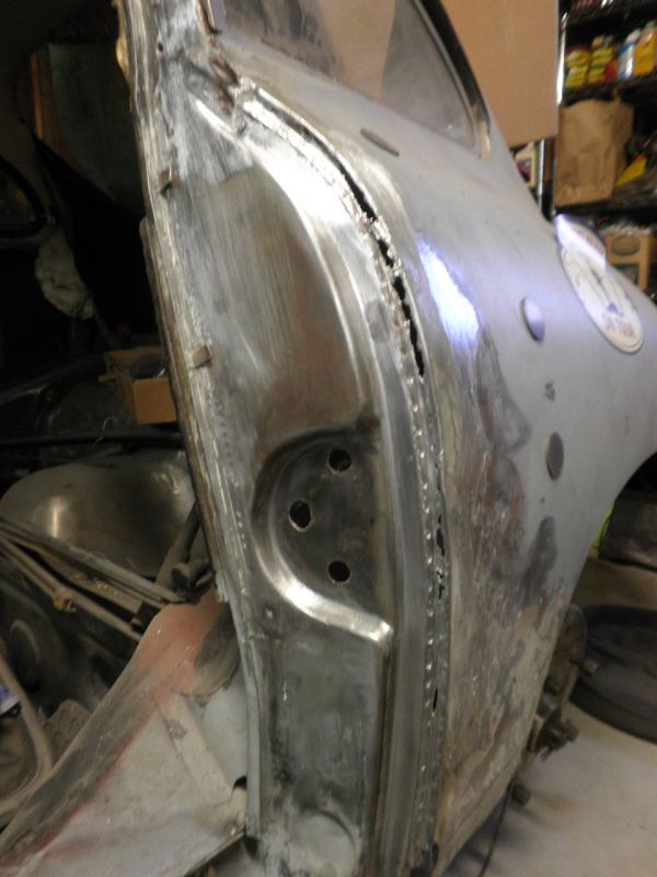

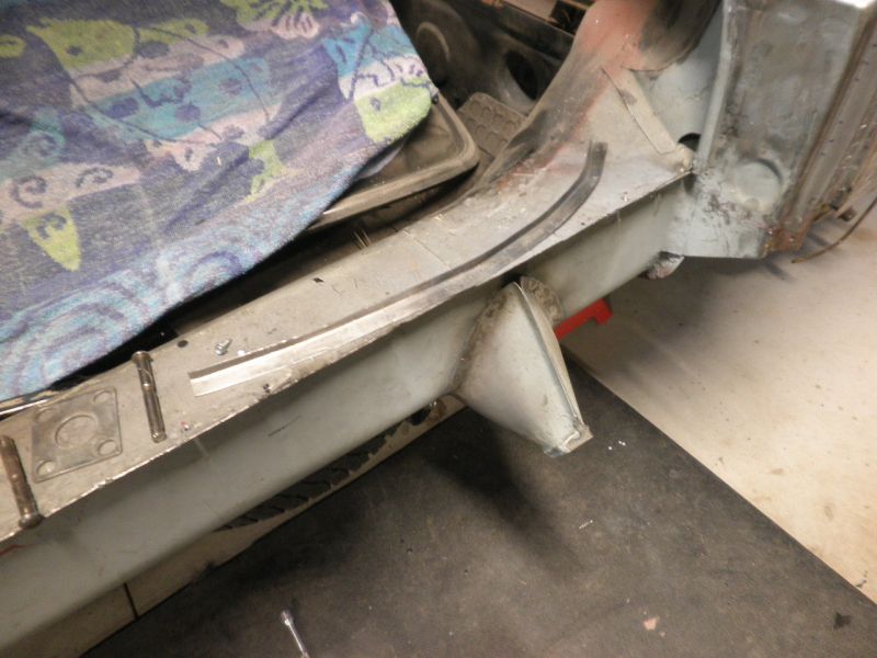

                    Quarter panel metal looks good underneath so made up a filler flange:

                    Cut out the rusted flange and ground down the sheet metal at all of the welds. Need to move the quarter cut back about 1/16" so flange will fit properly:

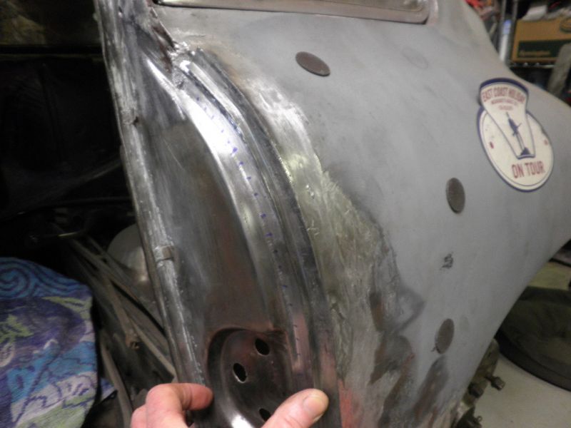

                    Trial fit of new flange:

                    • Nice work! Did you use a shrinker/stretcher?
                      JP
                      • Hi John
                        For the low crown area I just stretched the wide flange on an anvil, working my way along and test fitting as I went. For the high crown area I clamped the low crown wide flange in a vise used my mapp gas torch to stretch even more in 3 areas.
                        • That repair strip you made really turned out clean and you ended up saving quite a bit of the original metal! This is going to be nice repair all the way around. Looking forward to seeing it all welded up!
