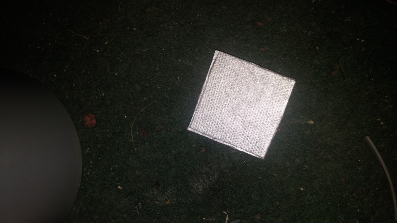

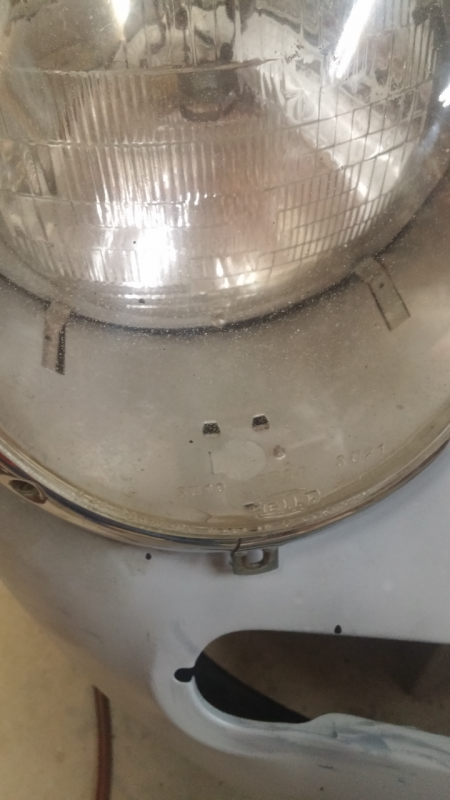

          • Blank off pieces turned out good enough for Foam Car. Spent some time looking for material with a tightly checked pattern, similar to pics that have been posted. My wife suggested the back of the thick, cardboard, "paper" plates. Bought a small pack of them and they look pretty good. I glued them to a piece of rubberized gasket making material and painted silver
            25cm square fits pretty good:

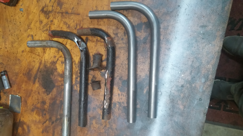

                  My next issue is the wiring conduits to the buckets. I would like to go all the way up thru the buckets as original but am having problems finding tight bend conduit. Inner diameter of the bend is about 3". OD of conduit is around 5/8" as I recall. I called one of our major suppliers to inquire about buying just the bent conduit, only longer at the bucket end. Said they did not make that part, but had some loose conduit and assured be it was long enough. After paying a pretty steep price and steep shipping, the parts are: a) larger diameter than original, and b) not any longer than what I had. A phone call did not end up to my satisfaction.
                  Here is what I have:
                  I thought about welding some straight conduit to the oversize, but that sort of defeats the purpose of a one piece, unwelded part.
                  Any suggestions? I don't think most electrical contractors can bend that tight and also would like it to be kink free in the bend.

                    • Thanks for the tips Bruce. Unfortunately it was RD. My fault for not asking for pics and dimensioned sketch. They dont make them and did not share their source. I will try Stoddard, where I bought the brackets I installed.
                      Wish I were nearby to your shop.
                      • The conduit on the left, above is long enough. I did not think it was, but installed it and protrudes into bucket at least 1". It came off a Stoddard bracket I bought years ago. Called them today and measured same as what I have, so ordered bracket just to get conduit.

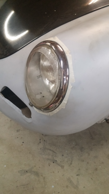

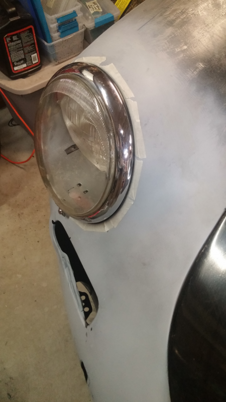

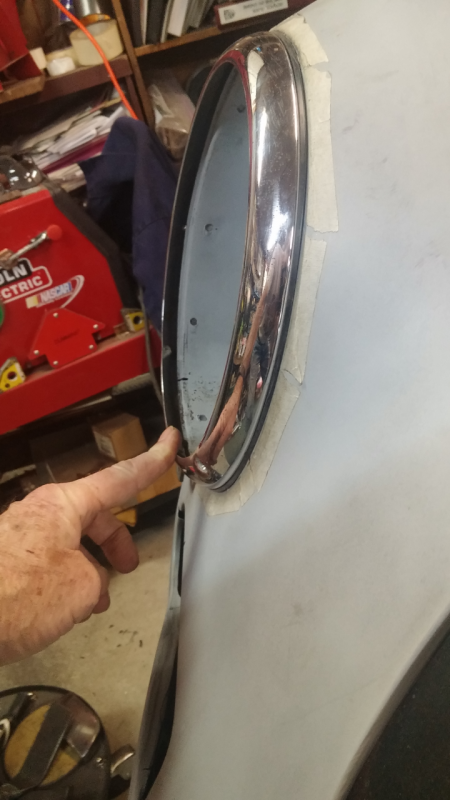

                          I like your idea of pop rivets. Besides for the next guy, IF the bucket needs to be moved if I screw up on gasket, can just drill out the rivets and slightly move it and hopefully not screw up paint job.
                          Got both side covered with .005" masking tape and put the thin Wolfsburg seals in. With old holes lined up the headlight assembly was a little loose. Pressed it in until snug, then did same on other side. Need to determine total paint thickness, as I just have self etch primer on now.

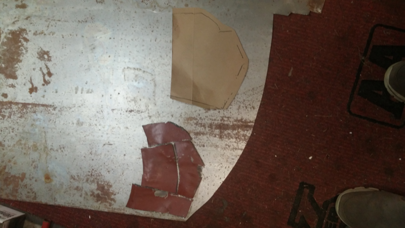

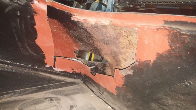

                          While waiting for conduit to arrive from Stoddard decided to bite the bullet and fill in this gapping hole in the engine compartment:
                          This was created years ago, before I had confidence in removing rear outer panel as Bruce suggested. There was a bad dent in the area above tail light. Complex curve there. In order to get to it I cut out the inner panel, but the hole was never big enough so ended up cutting out 4 pieces. Time to make one piece and get this fixed so I can install sound deadener and engine.

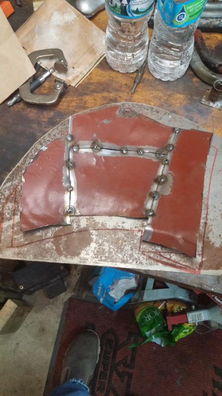

                          • See "Headlight Mounting Tips" thread that Justin started for my headlight saga. I got the jigsaw puzzle pieces tacked together to see how it fit in the hole. Fit pretty good, but a gap on one side from a piece I did not save, or lost.

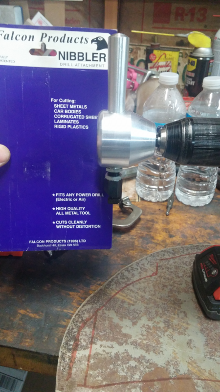

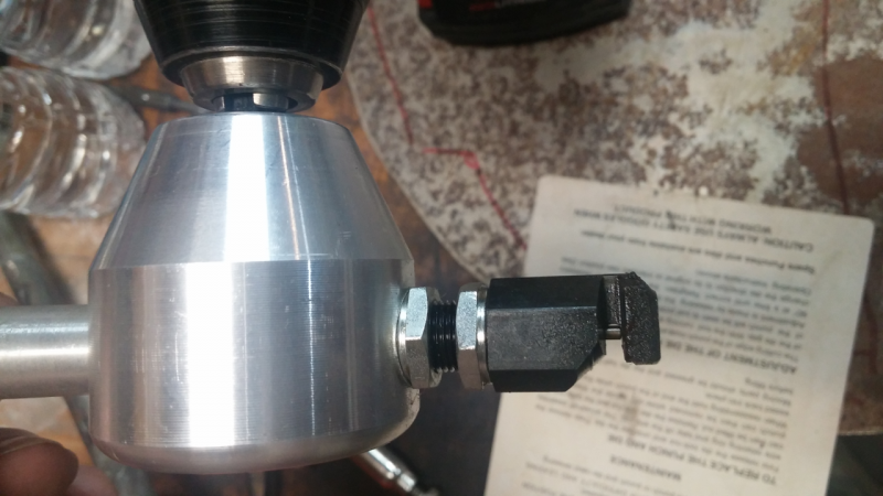

                            • If you saw the big sheet of metal above, my challenge was to cut out a piece to make a one piece patch. With all of my large horizontal surfaces covered, I remembered that I bought a drill operated nibbler when I first started this project 18 years ago, but had never used. Amazingly I found it and put it on my cordless drill. Worked great. I used tap thread cutting oil. These are still available.
                              I just used it with the sheet metal laying on the shop carpet you saw above, then swept off the offal.
                              Think I have my headlight installation problem resolved. See headlight fitting thread.

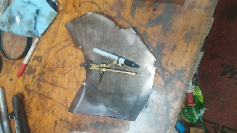

                              • Got the patch shaped for the hole in the inner rear panel. Used bead roller to get curved bend at top.
                                Here is trimmed patch and tool I used to get a line 1/2" from edged of hole. This is a less accurate version of the tape method I learned of and posted a while back.
                                I opened up the small pencil holder on a compass to hold a Sharpee marker and set at 1/2", went around the opening:

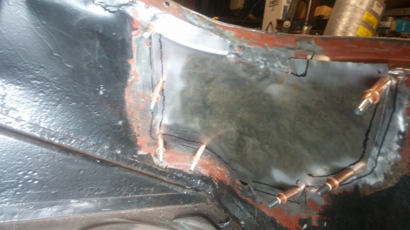

                                In the overlap area I drill holes for clecoe fasteners and installed the panel:
                                I then used the sharp tip of the compass to scribe it along the black mark 1/2" from the opening and marked the patch panel. I was also able to mark the back a portiong of the panel from behind thru taillite opening and from underneath. This helped confirm the marks on the other side, which are not as smooth due to trying to slide the scribe along and around the clecoes. So I trimmed the marks on the back first and they coincided pretty well with the ones from the compass. Time to weld this patch in.
