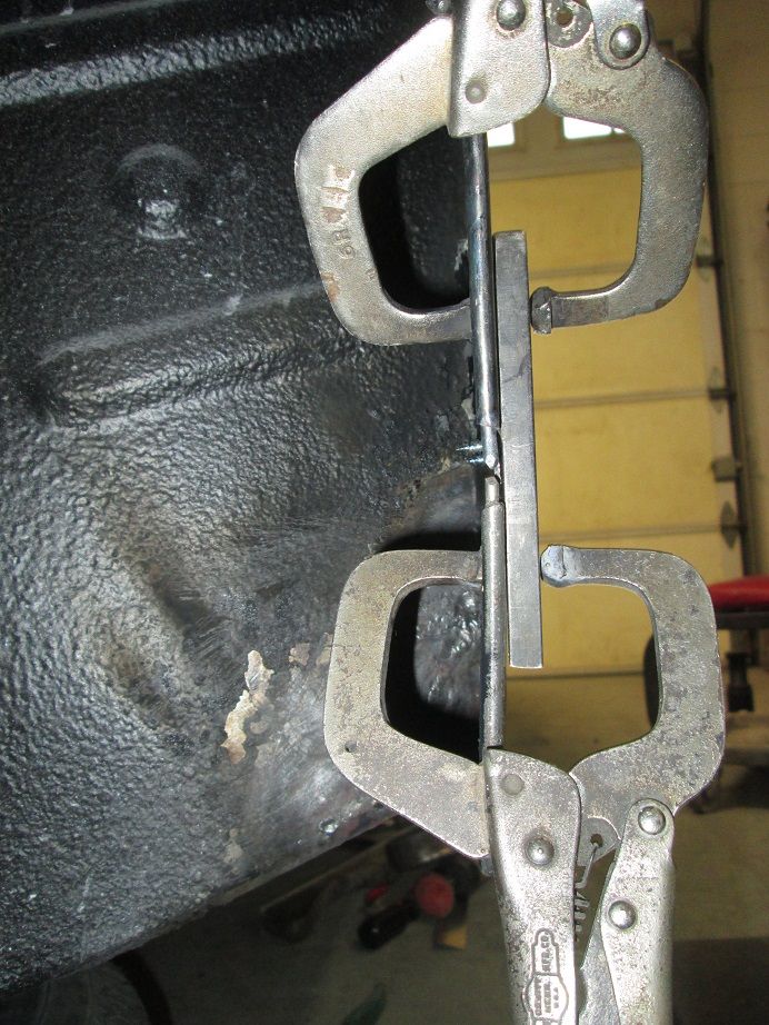

    Begin plug welding it to the drain tray and heeling over the vertical flange to the splash pan tightly.

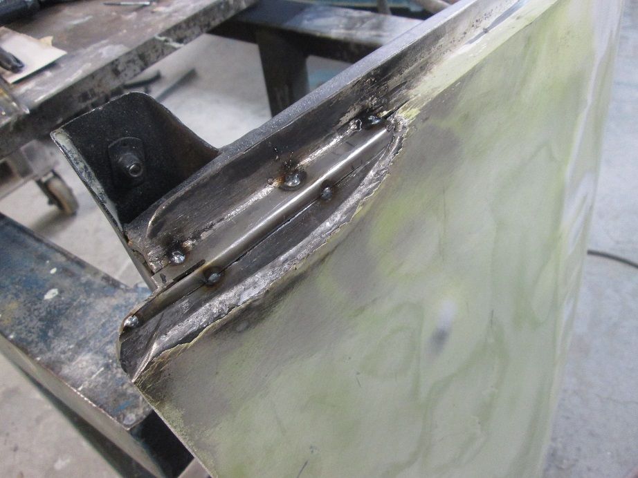

    Dialing in final adjusted position. Bend line for the rear flange etched.
    Folded over and on for another test fit. As close as I'm gonna get.
    Trim excess and then ready to mount for the final time.
    Begin tacking it in next.

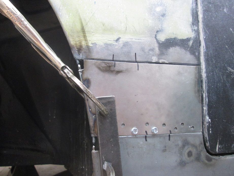

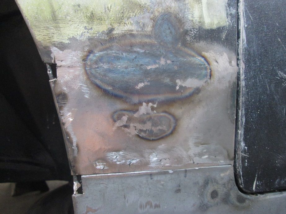

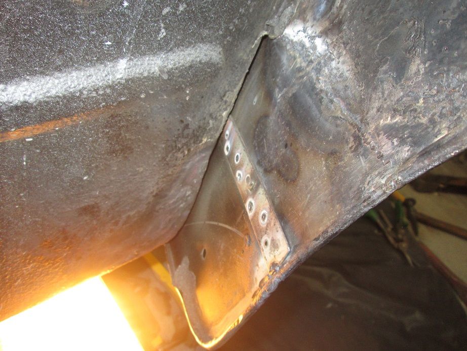

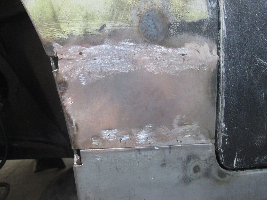

    • Welding in patch.

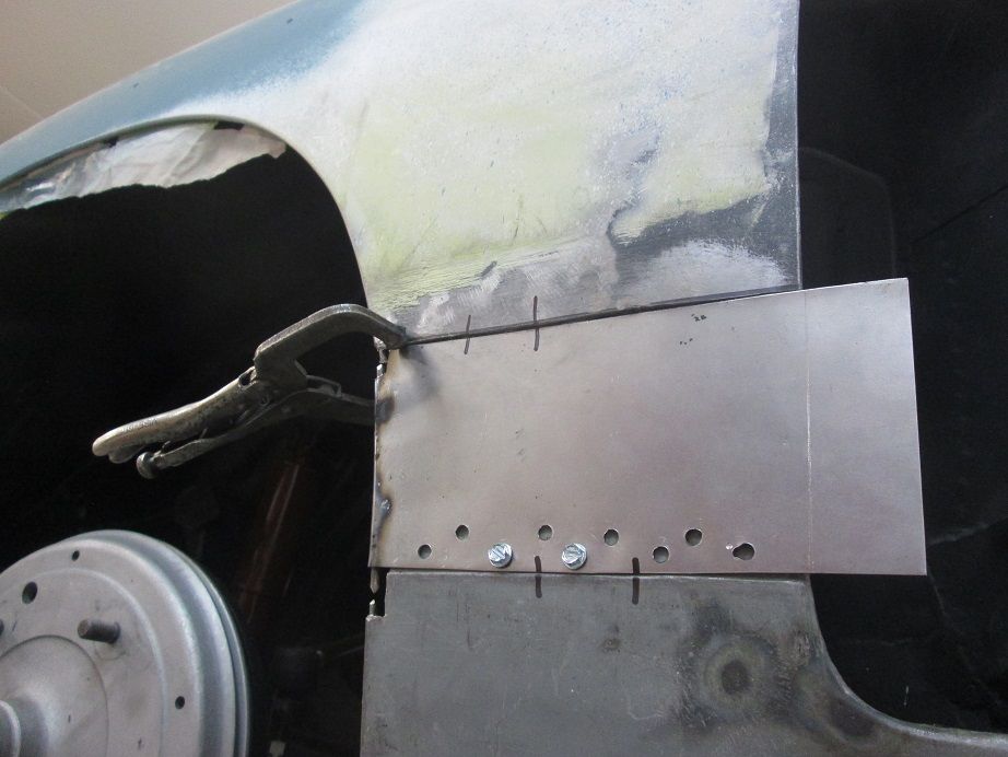

      Click image for larger version  Name:	IMG_2587.JPG Views:	0 Size:	85.3 KB ID:	106340
      Began with the wire leads.
      Click image for larger version  Name:	IMG_2588.JPG Views:	0 Size:	140.0 KB ID:	106341
      Clamped and set for alignment and pitch.
      Click image for larger version  Name:	IMG_2589.JPG Views:	0 Size:	81.8 KB ID:	106342
      Leads fused and plug welds done. Heading up top for that seam weld next.
      Click image for larger version  Name:	IMG_2591.JPG Views:	0 Size:	104.7 KB ID:	106343
      All seamed up with welds so far all dressed.

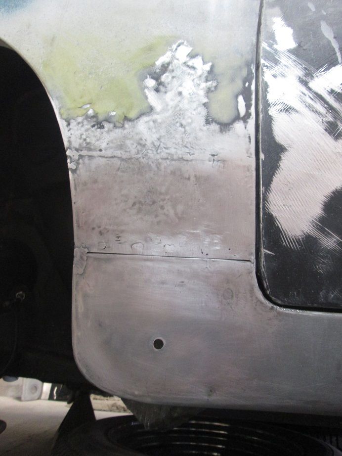

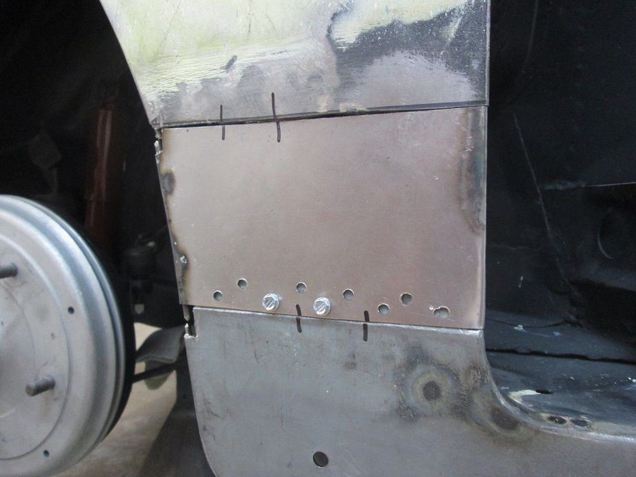

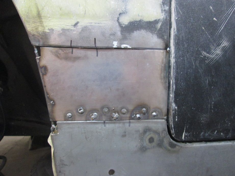

      • Click image for larger version  Name:	IMG_2595.JPG Views:	0 Size:	104.2 KB ID:	106346
        More welding and heat yet to go but I wanted to get the heavy warpage out now. A little torch heat with my shrinking hammer and dolly corrected it pretty quickly. Hammered it from the inside BTW.
        Click image for larger version  Name:	IMG_2597.JPG Views:	0 Size:	63.8 KB ID:	106347
        General contour good. Welding up those little windows next.

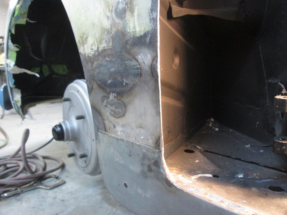

        Click image for larger version  Name:	IMG_2599.JPG Views:	0 Size:	95.8 KB ID:	106348
        Patch fully welded in.
        Click image for larger version  Name:	IMG_2601.JPG Views:	0 Size:	122.4 KB ID:	106349 Biggest pain again was welding around the back side of the rolled wired lip.
        Click image for larger version  Name:	IMG_2605.JPG Views:	0 Size:	79.2 KB ID:	106351 Like the rear this area will only need a skim coat of lead to take it in the rest of the way. Prepping for lead next.

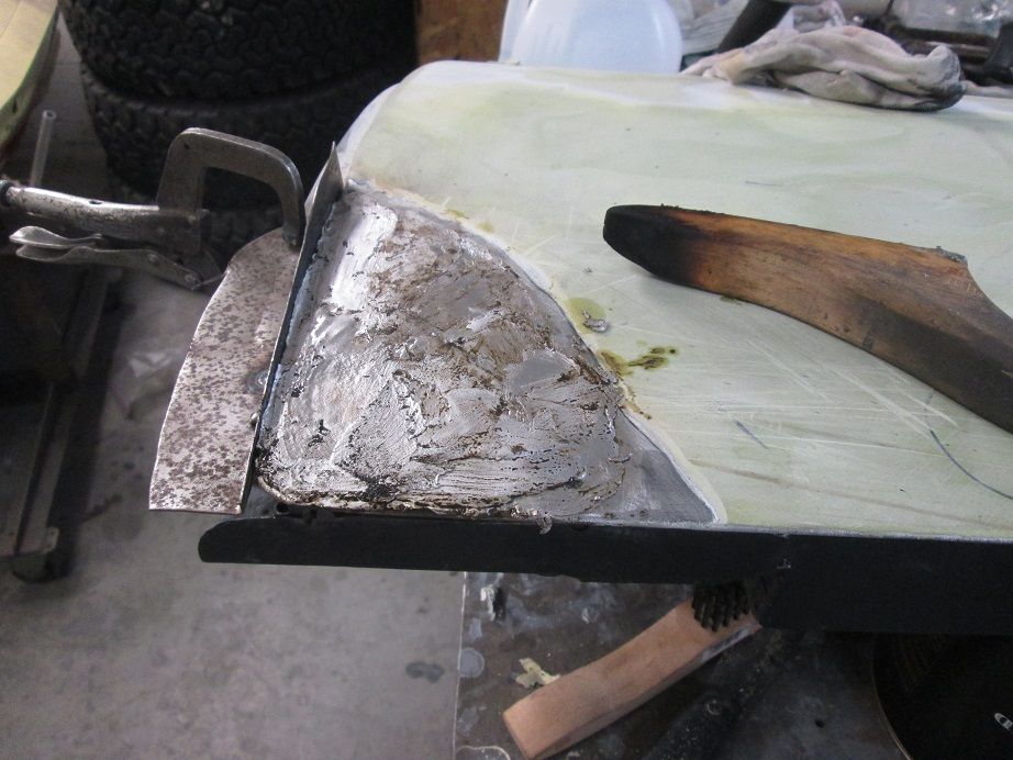

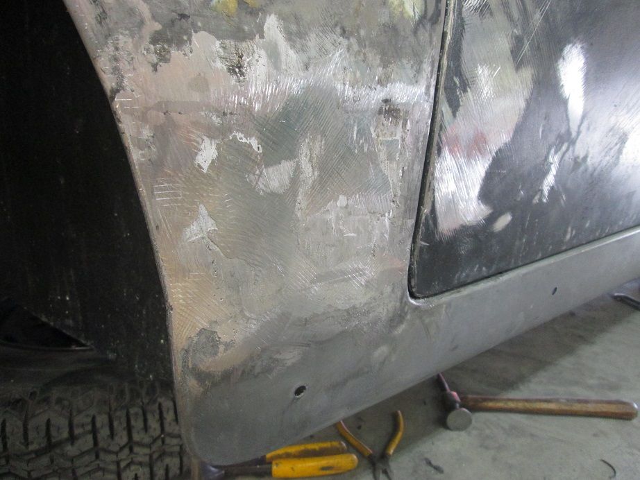

        • Leading front corner:
          Surface cleaned and ready for some tinning acid.
          Not perfect but will only take a swatch to bring it up the rest of the way.

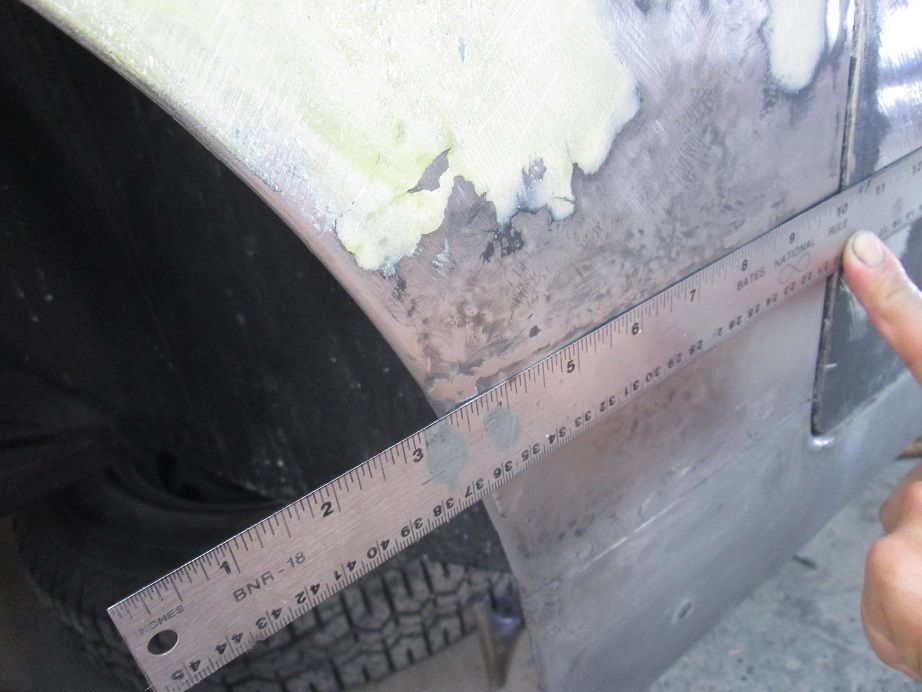

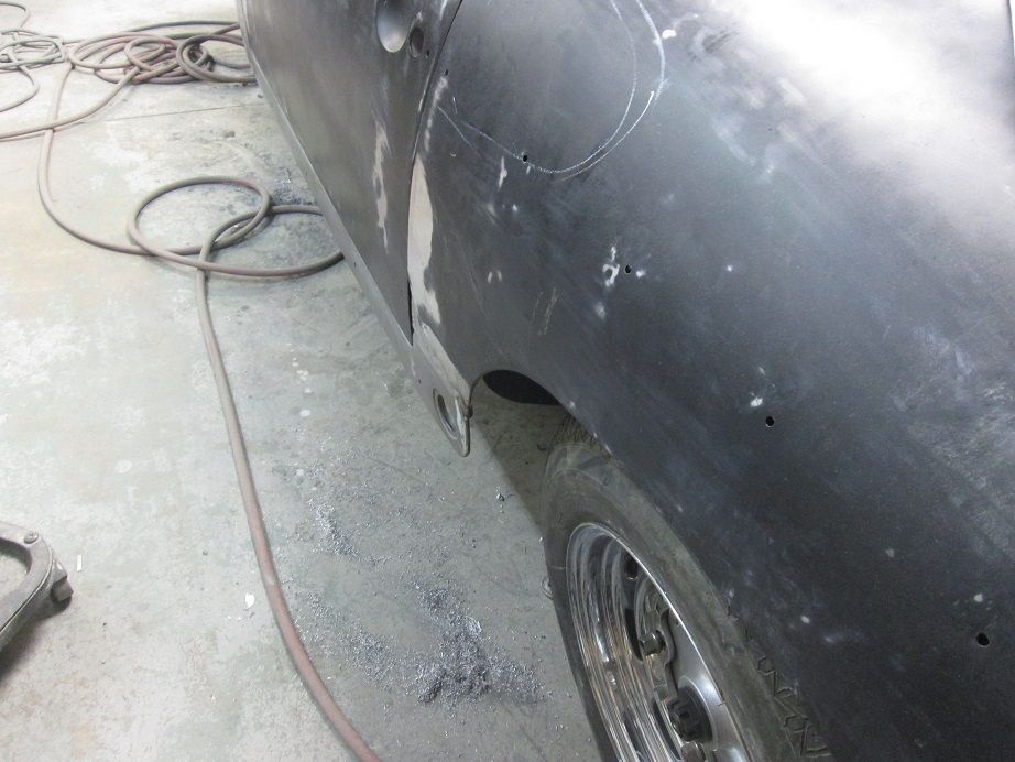

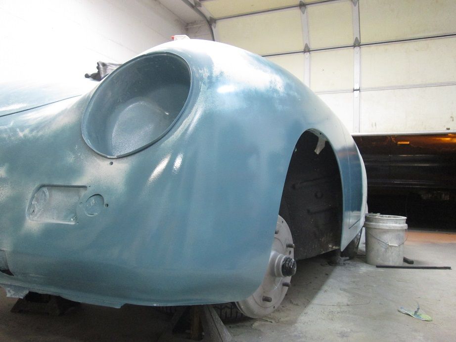

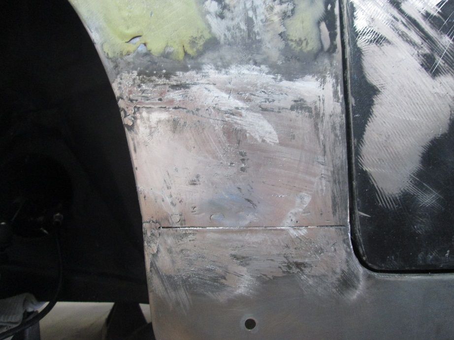

          • Click image for larger version  Name:	IMG_2608.JPG Views:	0 Size:	61.3 KB ID:	106382
            A lot of loose ends yet to tie up but I've got the general lower body profile I was after.
            Click image for larger version  Name:	IMG_2629.JPG Views:	0 Size:	57.7 KB ID:	106383

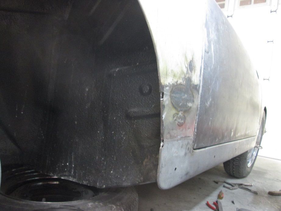

            Original rocker profile example which runs a touch flat off the quarter panel.
            Click image for larger version  Name:	IMG_2630.JPG Views:	0 Size:	90.1 KB ID:	106384
            nearly the same profile set here where again it was more of a hemmed in profile before. Following the OG example as much as I can but in the end the body has to flow smoothly overall.

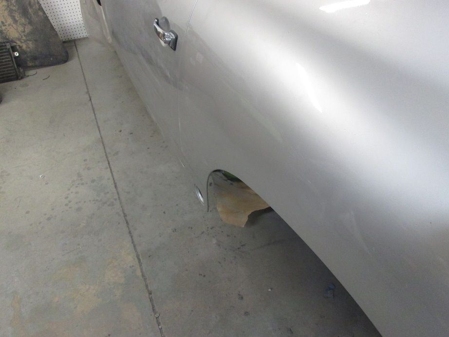

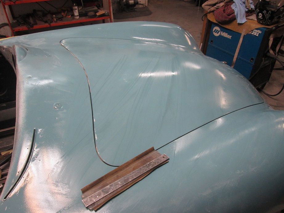

            Also began skimming the door working toward a flawless transition off the front fender. I'd be revisiting this upper corner BTW but that's much later.

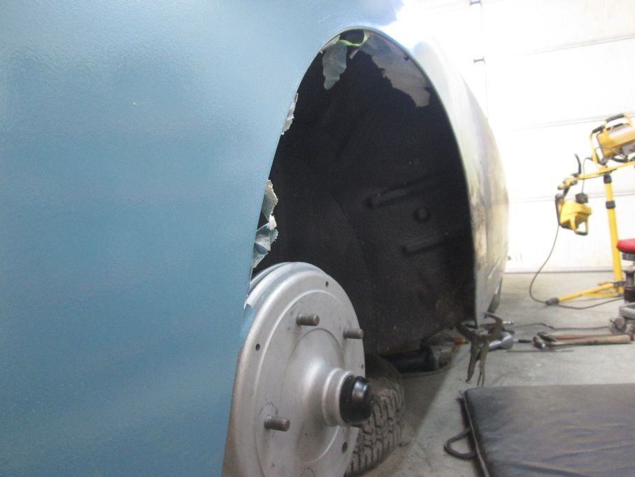

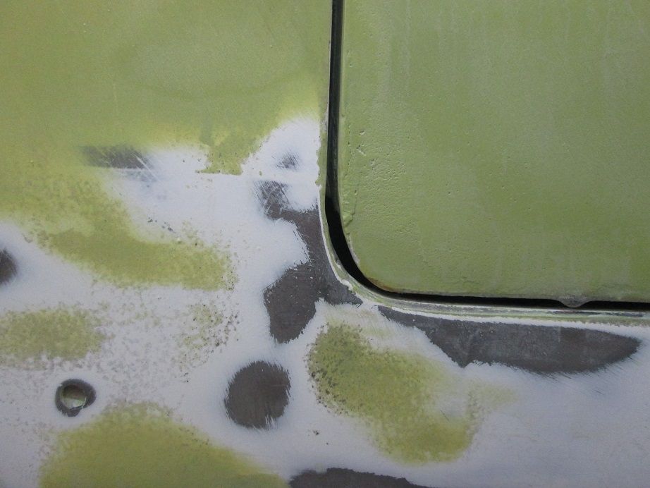

          • Begin bodywork on rocker and lower door.
            Click image for larger version  Name:	IMG_2720.JPG Views:	12 Size:	92.9 KB ID:	106444
            Prepping the new rocker for an initial coat of sealer.
            Click image for larger version  Name:	IMG_2722.JPG Views:	12 Size:	83.1 KB ID:	106445
            base coat applied. Rough but a general profile I'm happy with.
            Click image for larger version  Name:	IMG_2729.JPG Views:	9 Size:	70.3 KB ID:	106446
            Onto swatches of filler and repeated cycles of block sanding.

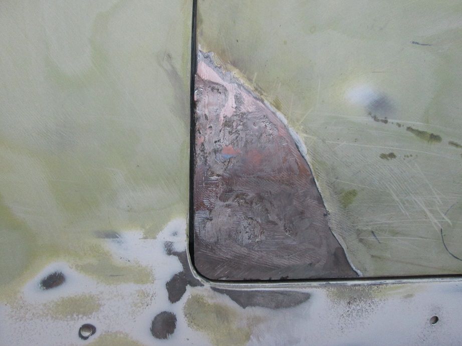

            Click image for larger version  Name:	IMG_2741.JPG Views:	13 Size:	76.2 KB ID:	106447

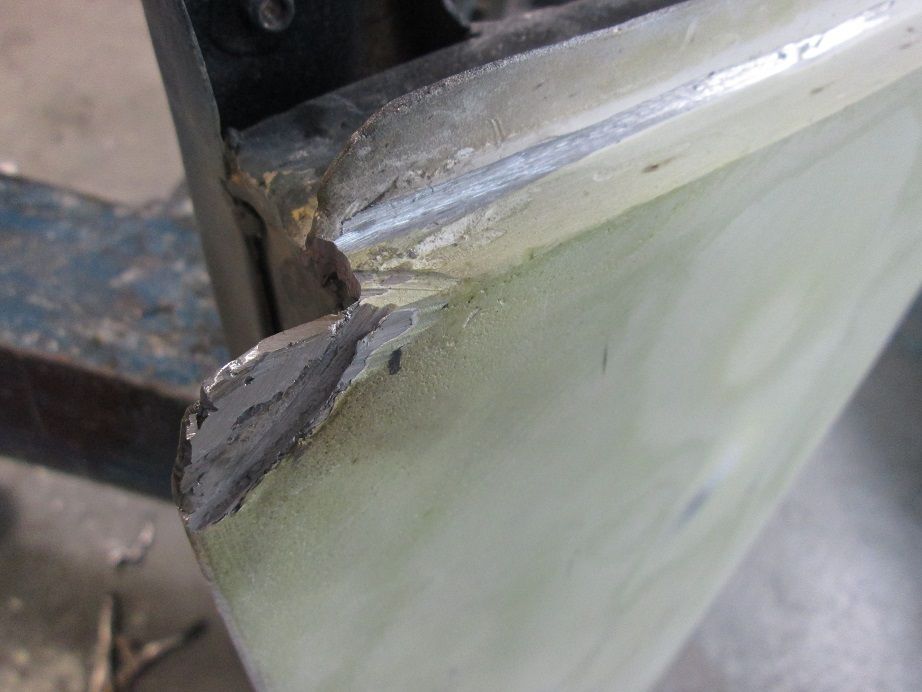

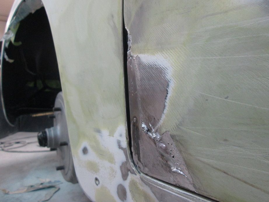

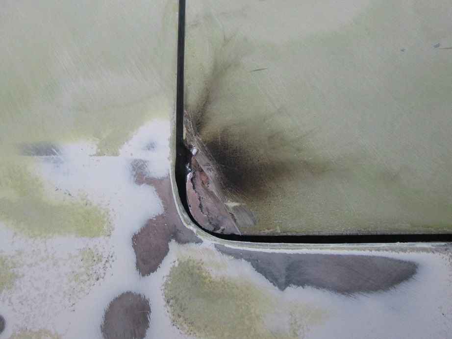

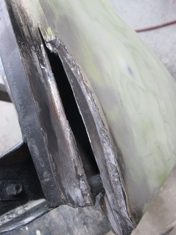

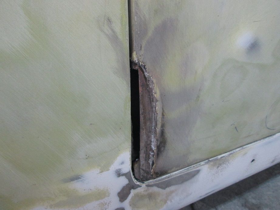

            As I began concentrating on shaping this corner I noticed the leading edge of the door was comprised of solder.
            Click image for larger version  Name:	IMG_2748.JPG Views:	10 Size:	67.7 KB ID:	106448
            This corner is an overhang so I wasn't comfortable leaving it. I wanted at least a steel leading edge for the solder to sit on versus being comprised completely of lead to make the corner. Solder ground back here and am in process of adding weld to build up the corner for a new profile shape. As you can see the lead runs little deep down through here. More on that next.

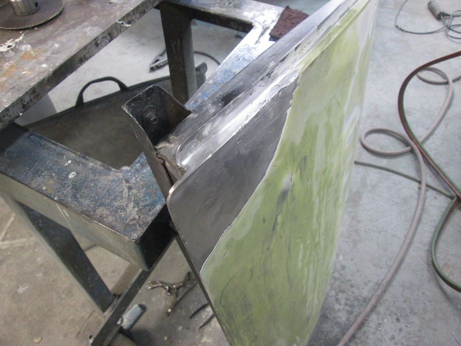

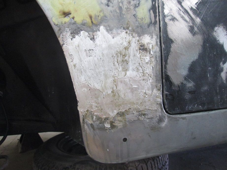

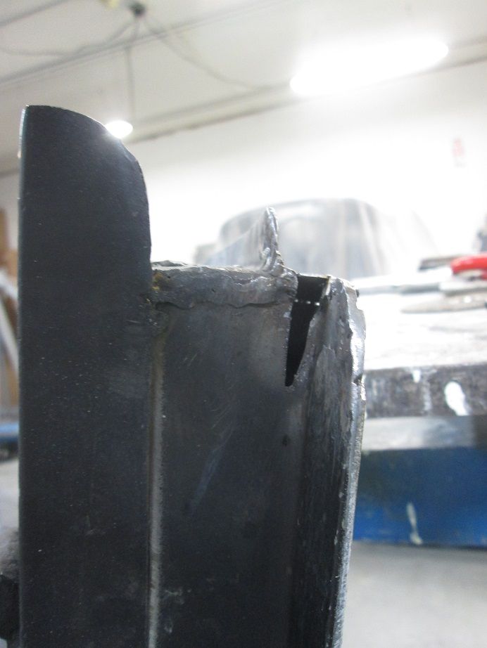

            • Lower corner redo

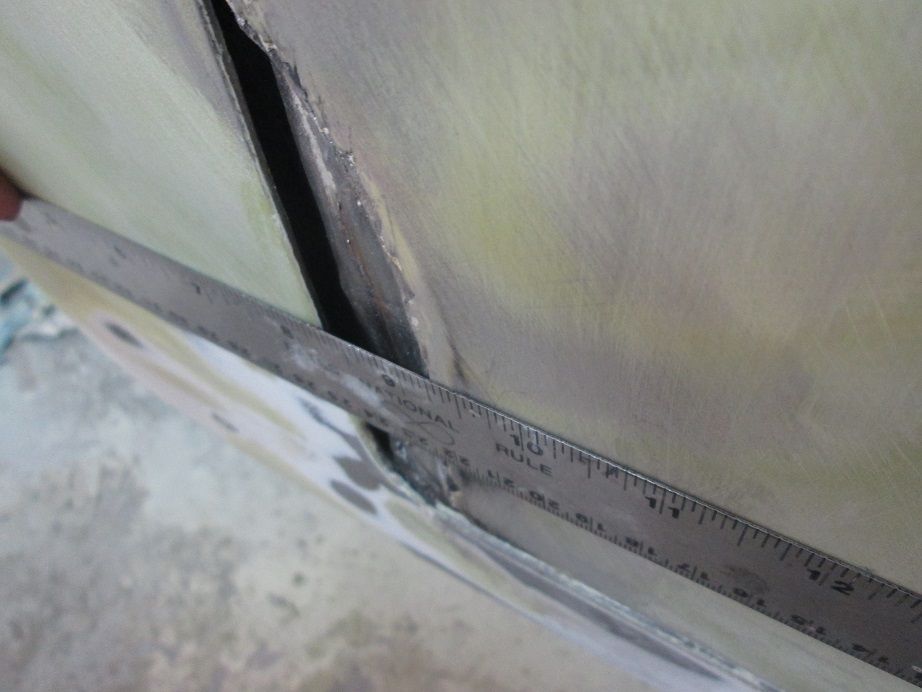

              Door remounted to begin file shaping that new leading edge for gap and shape against the rocker
              As that progressed the lead thickness through here was really bothering me and I as the filing went I felt less inclined to back fill this spot in more solder. Talking at least 4mm thick!
              If I hadn't disturbed it then I would have let this dog lay but I'm here so I might as well fix it. Melting back the rest of solder over this previously repaired area.
              Remounted to see just how far the metal has to come up. As you can see a fair amount of lead was used to create this body line.
              Like the rocker work before it will all still need filler to be perfect but only a skim coat. I'm shooting to cut the amount needed on this lower door edge by at least 3/4 before its over. More on this next.
              • Justin,
                I reckon like you I would never have seen that door lead! Thats a lot of lead. At least for me though, I am more happy to see that, as my drivers door after my welding did not need I guess much more than 2mm thickness of lead in places. I always thought 1mm was over the top but after seeing some original factory lead on my car in other places I noticed that it was also quite thick in places . I can say the lead seems to have stayed perfectly in position as the metal it was soldered to was in perfect clean condition.
                Look forward to seeing the door to rocker transition after you finish this. Again this car was supposed to be ready for paint when it came to you. You need to do so much homework before you make the choice of choosing the 356 bodywork repair company.
                  Hi Roy, Yes it was thick but being lead it was still stable. I just don't like creating or leaving features that are almost totally comprised of filler no matter what its made with if I don't have to. Absolutely, the factory did use lead very generously in places and I have seen areas where it ran this thick but that was a necessary evil in regards to factory production time; the car had to keep moving on down the assembly process as you well know. Today, its really only a question of money and how much time an owner is will to spend on it. As Bruce Baker has stated some owners want to come in at a set price so if that's the case examples like this door will get filled instead of being chased after. If you're up against the clock the level of work has to make sense for all concerned. I can't account for this particular project though as the shop did do a fundamentally sound job for the most part and the owner is very particular and will agree to the work and time it takes get it right. Each time I have run into an issue like this I always ask him first: Fix or Fill? Fix has been his standard response. So it couldn't have been a budget thing necessarily (within reason of course) with the previous shop. All I can surmise is that they just wanted it out the door as quickly as possible and where rushing for the exits toward the end. I've also found a few more weird detail mistakes I've had to fix so I just don't know?? As you said you have to do your homework.

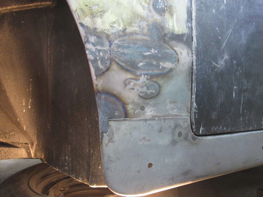

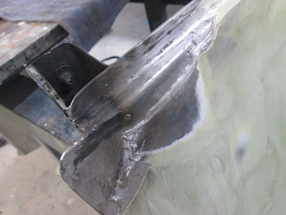

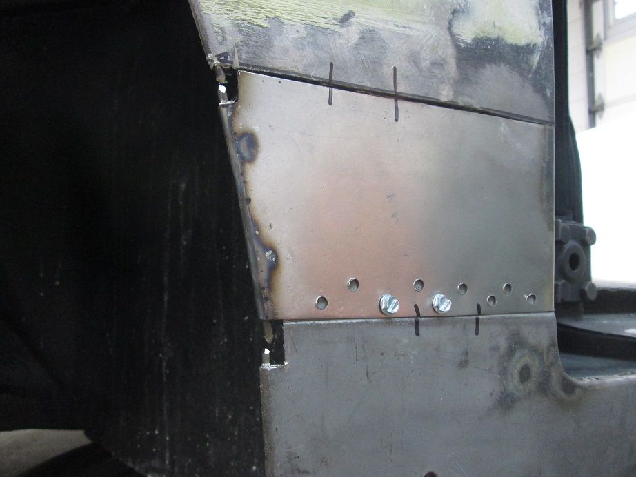

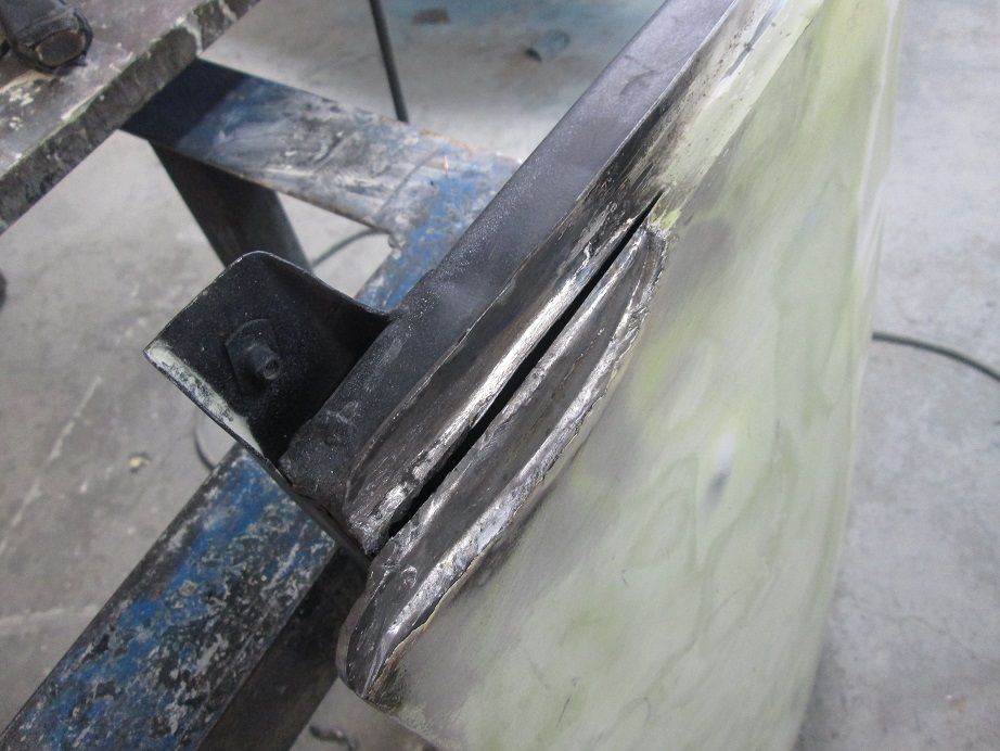

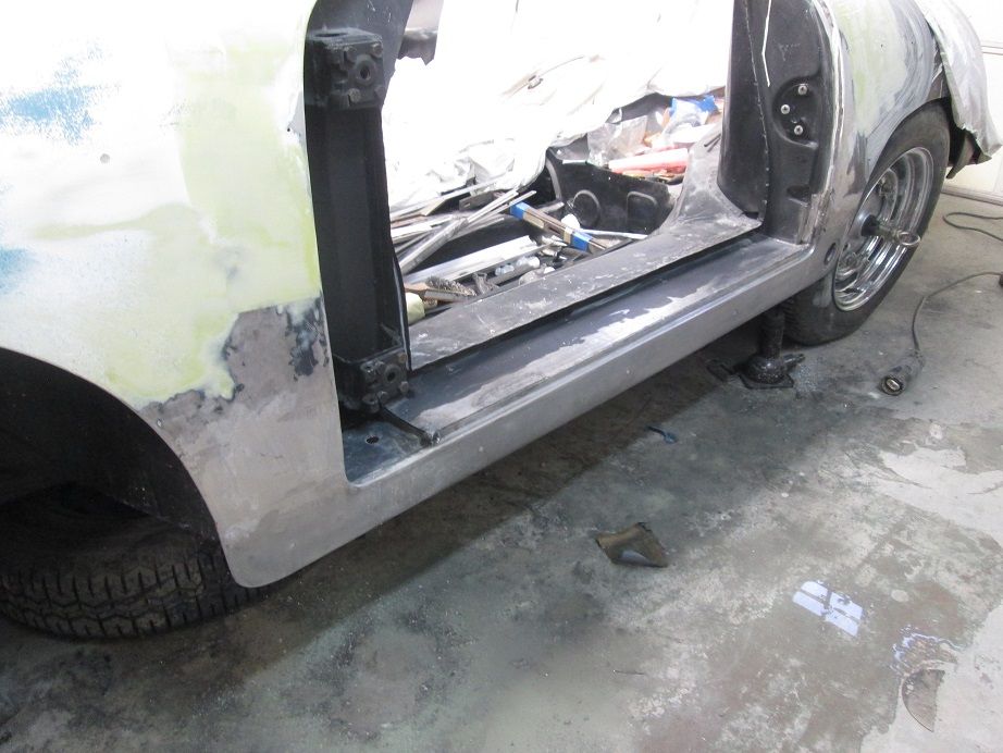

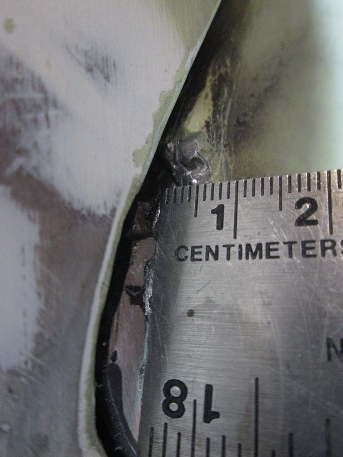

              • Raising the lower corner:

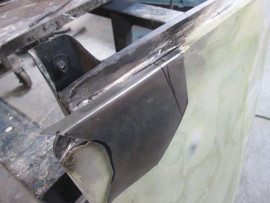

                Click image for larger version  Name:	IMG_2761.JPG Views:	0 Size:	90.8 KB ID:	106473
                Relief cut through the repaired area to kick it out but stopped just where it turns back to original. Its factory so no need chasing it further.
                Click image for larger version  Name:	IMG_2762.JPG Views:	0 Size:	82.1 KB ID:	106474
                Creating a new corner profile patch as the section found washes out flat. This will further reduce the need for lead solder.
                Click image for larger version  Name:	IMG_2764.JPG Views:	0 Size:	94.7 KB ID:	106475

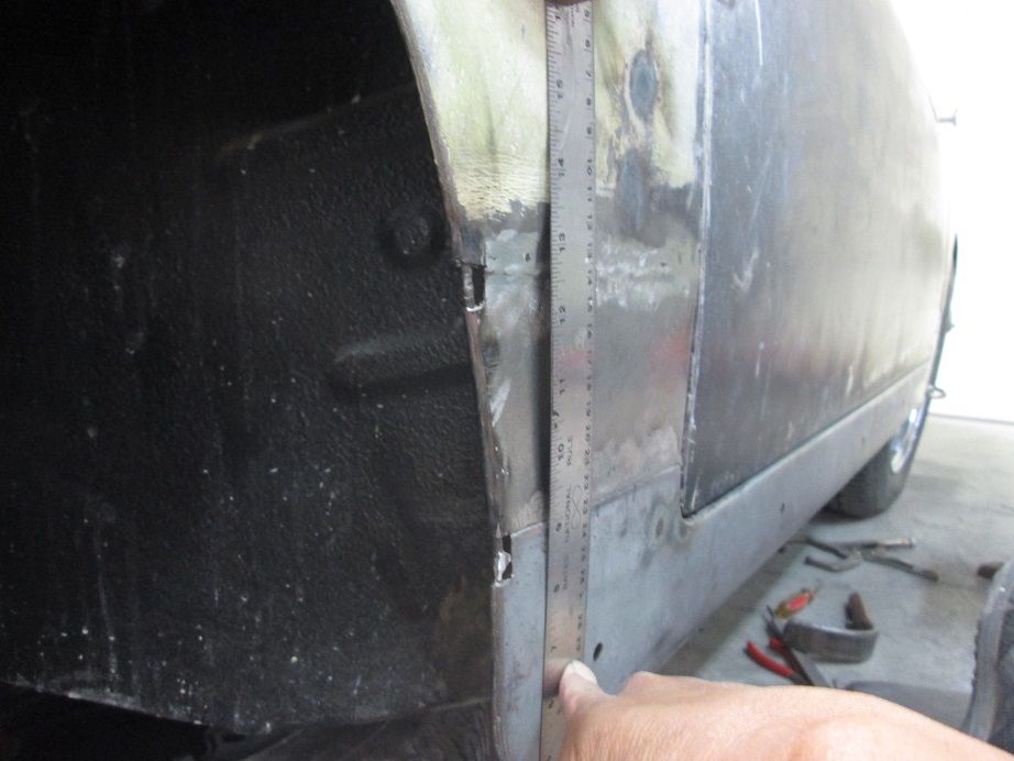

                Previous repair section removed and beginning to pry the bottom surface of this door outward.
                Click image for larger version  Name:	IMG_2765.JPG Views:	0 Size:	67.6 KB ID:	106476
                Mocked to see how much further it needs to come out if any. The skin surface is now running just shy of the rocker. The lead shelf behind it sits very high and most of it can now be leveled off.
                Feeling better about this corner already.
                Click image for larger version  Name:	IMG_2766.JPG Views:	0 Size:	89.5 KB ID:	106477
                Door skin surface raised to desired level. New corner patch section trimmed back and spotted in to lock that distance in. Again that nice step of lead behind this patch is now way too high and will be filed down.

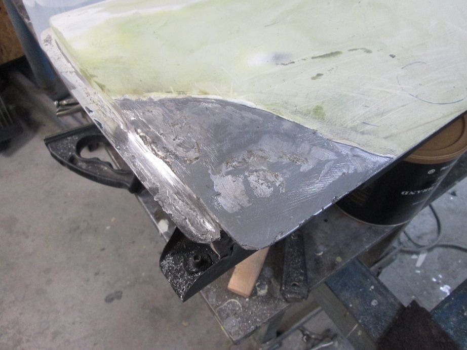

                  Had to get into the bottom a little to allow the movement I was after.
                  All buttoned back up.

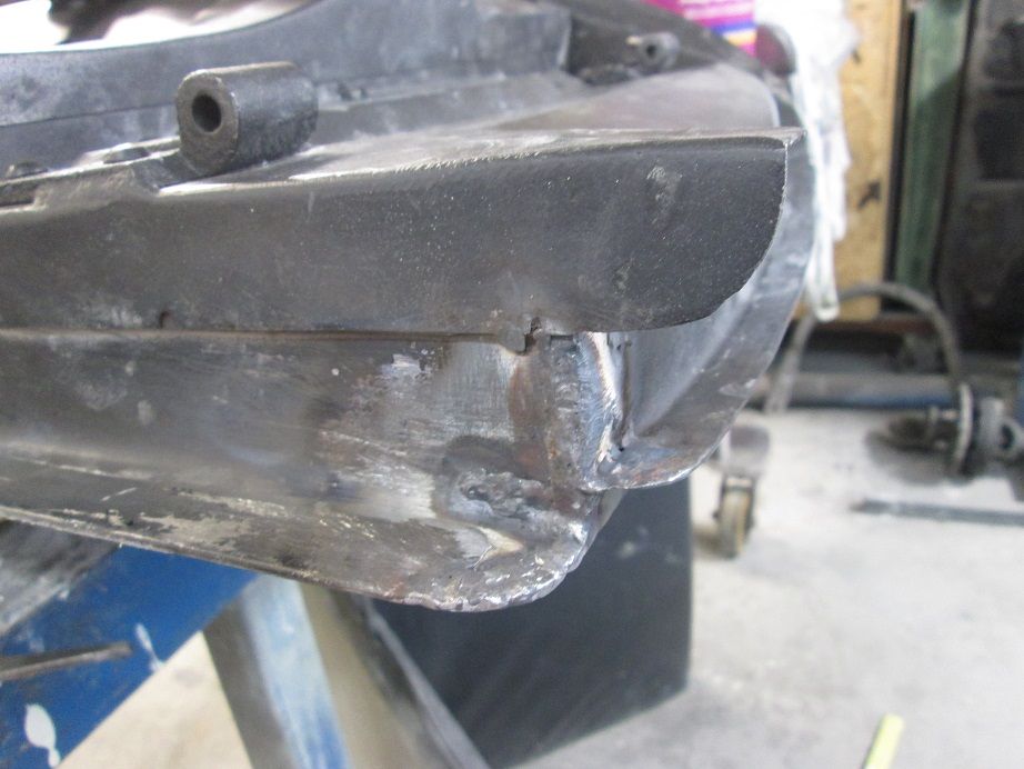

                  New corner also fully welded and dressed.
                  As found....
                  Still going to need some solder as it should but not nearly as much as before. Resoldering next.

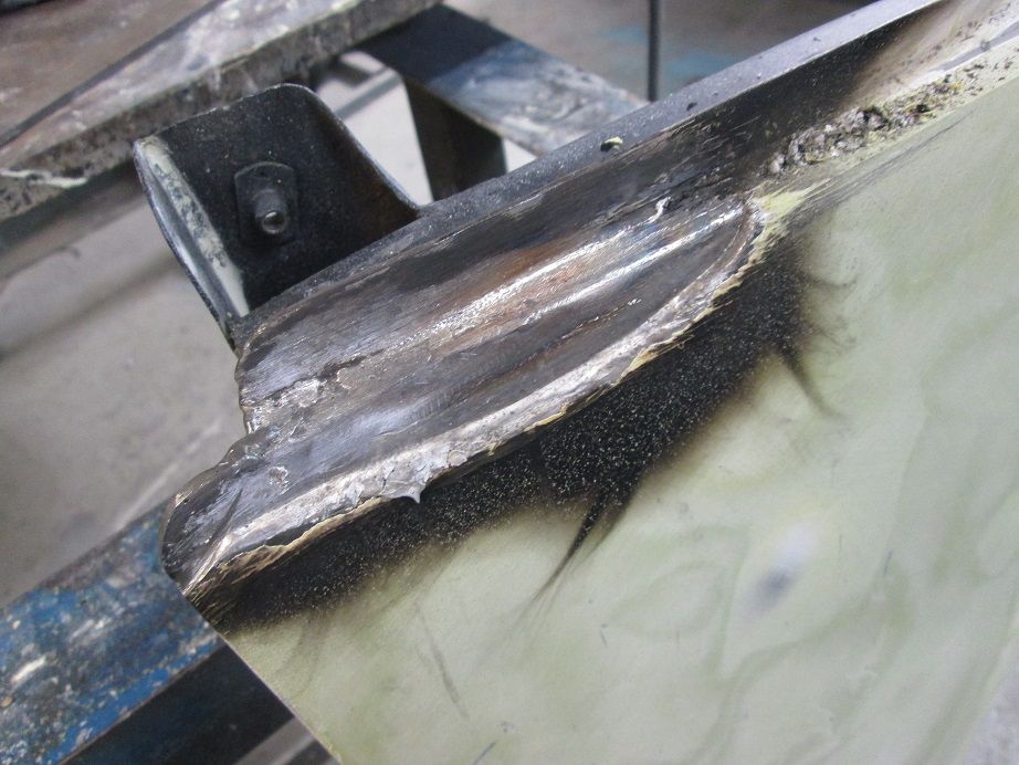

                  • Resoldering:

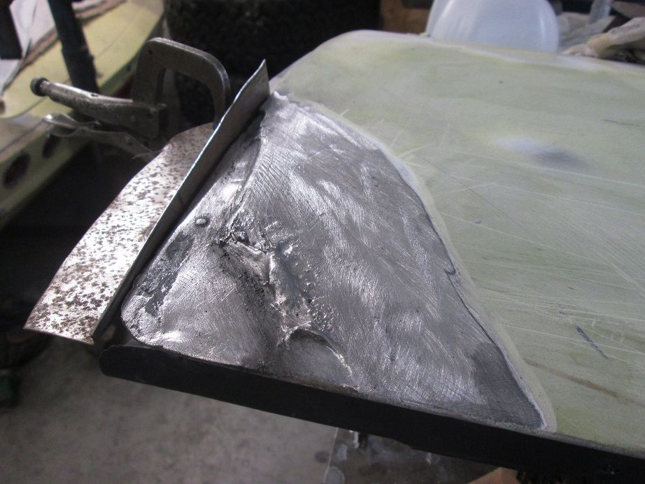

                    Click image for larger version  Name:	IMG_2780.JPG Views:	0 Size:	101.3 KB ID:	106509
                    I was foolishly filing the lead which was now too high but then it dawned on me to not waste but just reheat it and move it over where its now needed. Ready to do that here. Have my makeshift form for the leading edge in place.
                    Click image for larger version  Name:	IMG_2781.JPG Views:	0 Size:	98.5 KB ID:	106510
                    Like icing a cake...
                    Click image for larger version  Name:	IMG_2784.JPG Views:	0 Size:	87.0 KB ID:	106511

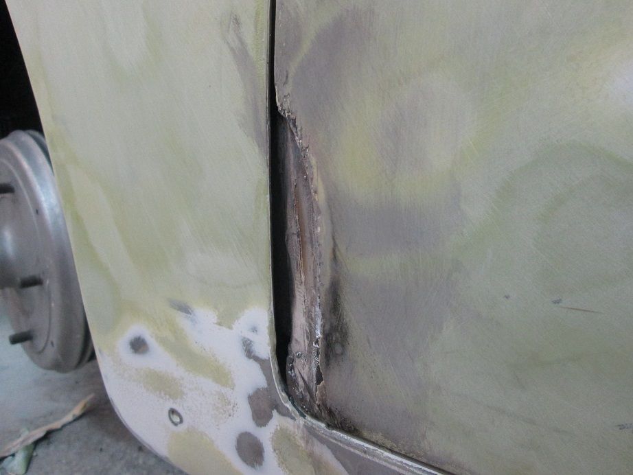

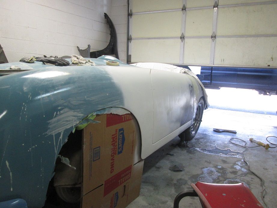

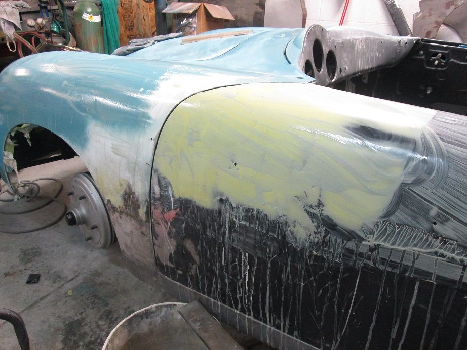

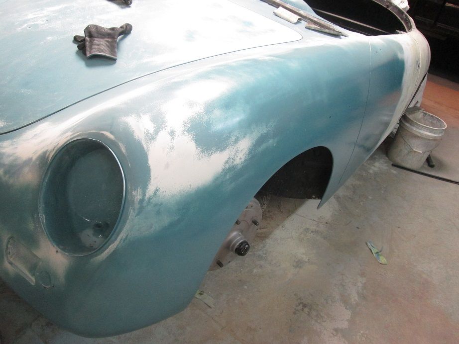

                    • back to body work: first work coat.
                      Click image for larger version  Name:	IMG_2801.JPG Views:	0 Size:	92.3 KB ID:	106515
                      Swatching and blocking with the car. High spots of metal along the door where disc shrinked as it progressed.
                      Click image for larger version  Name:	IMG_2805.JPG Views:	0 Size:	65.5 KB ID:	106516
                      Worked this area about as far as I could and it was now time to get it behind some sealer and then a quick work/color coat.

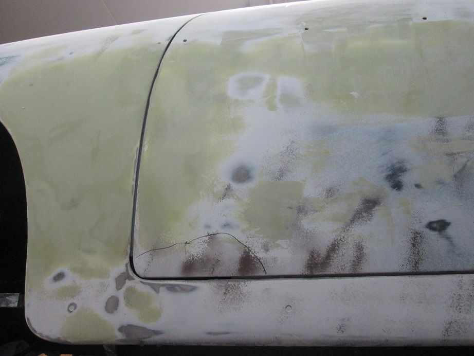

                      Click image for larger version  Name:	IMG_2811.JPG Views:	0 Size:	70.2 KB ID:	106517
                      Main thing I was looking for at this point was a good overall body contour as it transitioned into the door.
                      Click image for larger version  Name:	IMG_2802.JPG Views:	0 Size:	83.8 KB ID:	106518
                      Its still very rough at this point but the general refection across the gaps is what I was determining. A smooth consistent shape from rocker, fender to door that I can live with.

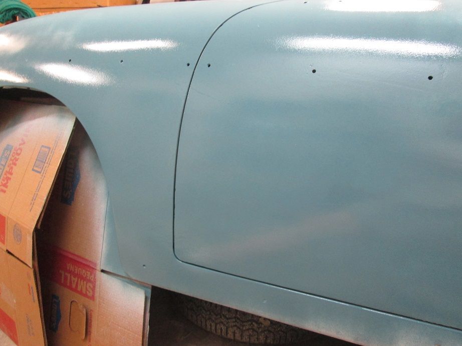

                      Click image for larger version  Name:	IMG_2812.JPG Views:	0 Size:	79.4 KB ID:	106519
                      She's getting there. Moved to the back of the door while this cured fully. That next.
