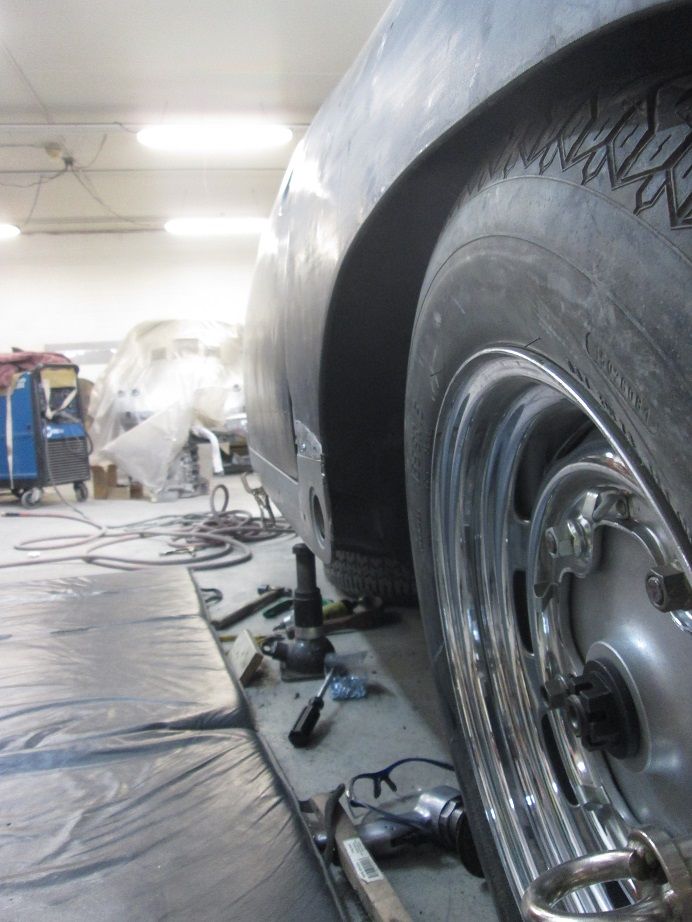

  • Click image for larger version  Name:	IMG_2393.JPG Views:	0 Size:	70.6 KB ID:	106218

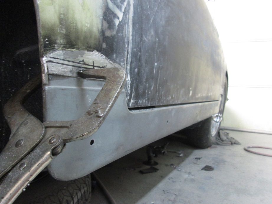

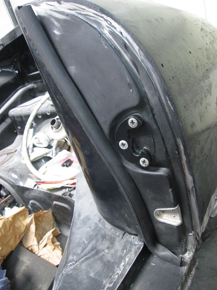

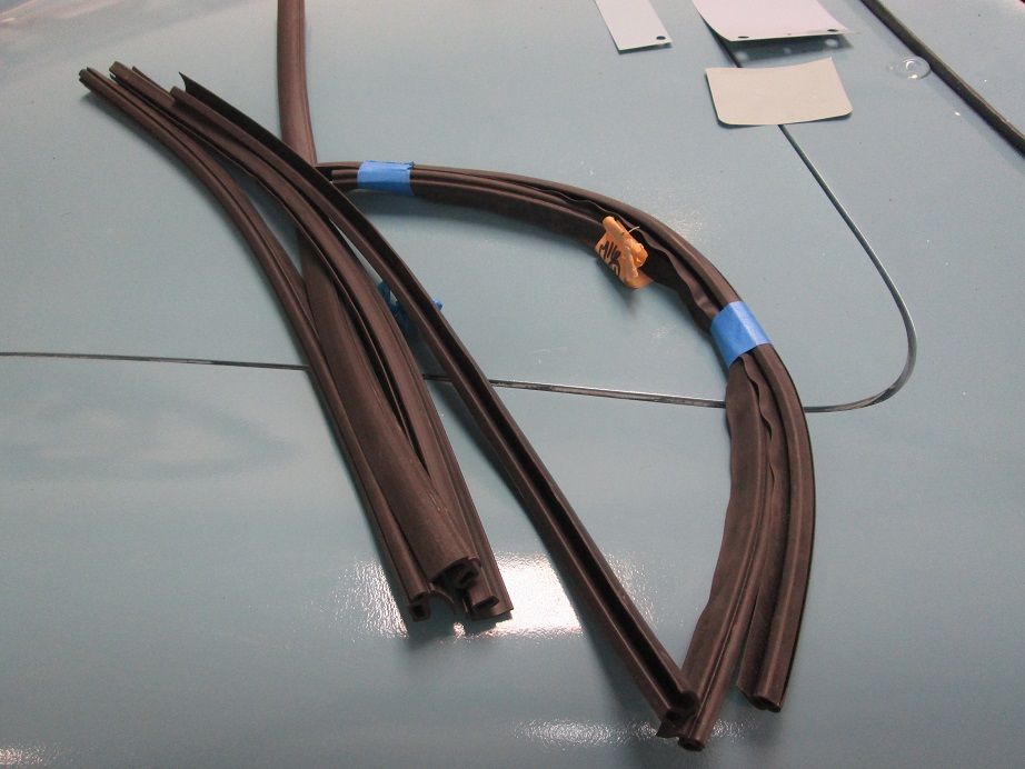

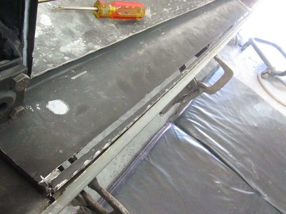

    Dug the door seals out so I can preload the latched door to dial in level with the new rocker and rear quarter panel.
    Click image for larger version  Name:	IMG_2412.JPG Views:	0 Size:	106.8 KB ID:	106219

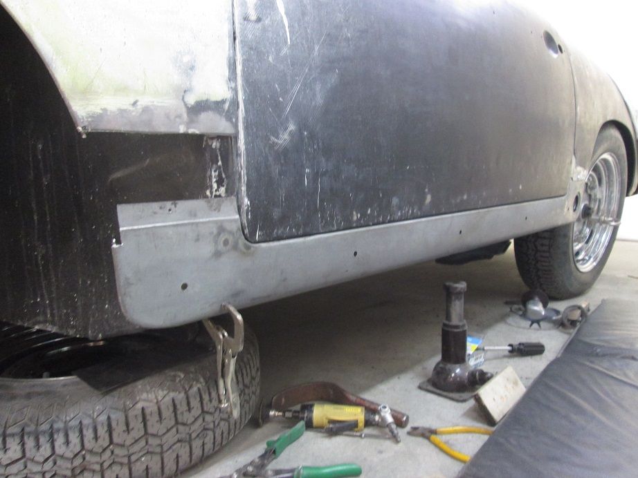

    Initial mock-up with tail left at the bottom. Much easier for mock-ups if I just cut that short but I didn't want to burn this new seal just for that.
    Click image for larger version  Name:	IMG_2432.JPG Views:	0 Size:	89.8 KB ID:	106220

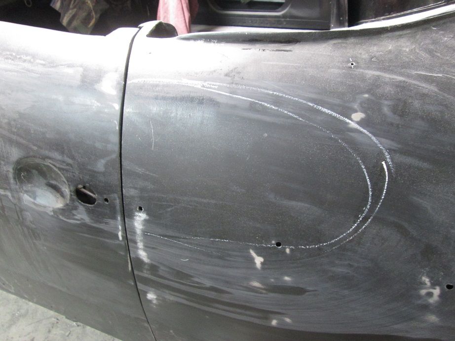

    Got the door latch adjusted for a nice transition off to the rear fender. What jumped out at me next was this huge flat spot in the body profile. Again black primer conceals a lot of sin.
    Click image for larger version  Name:	IMG_2430.JPG Views:	0 Size:	80.0 KB ID:	106222

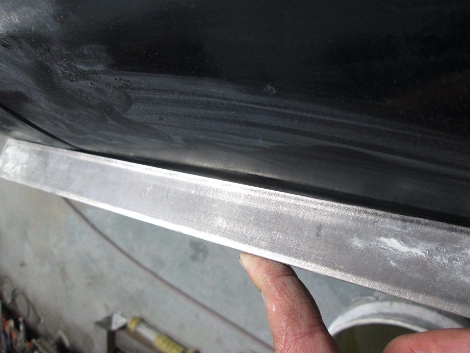

    With this straight edge you can see just about 4MM of slope to fix or fill.
    Click image for larger version  Name:	IMG_2399.JPG Views:	0 Size:	66.7 KB ID:	106221
    Worry about that later. Onto getting the back of the rocker dialed in and set. A tight rear gap and corner to also deal with.

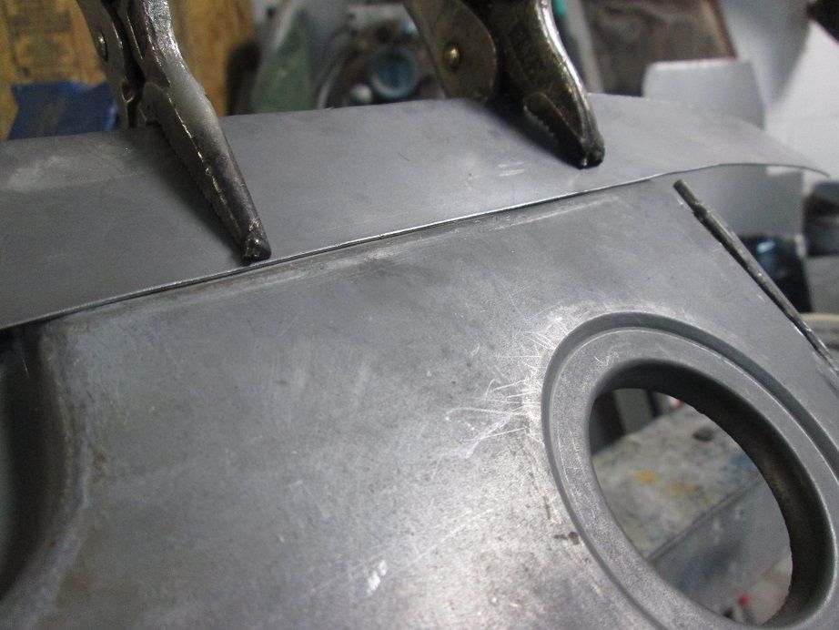

      Moved onto dialing in my best adjusted 3mm bottom gap with the edge of the door.
      Click image for larger version  Name:	IMG_2462.JPG Views:	0 Size:	92.2 KB ID:	106231

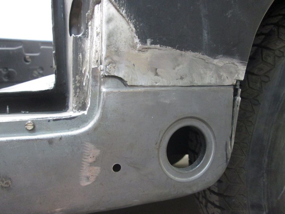

      A curve ball thrown up here but I now had the front of this rocker set in its final position. The edge contour carries on pretty smoothly onto the rocker. Notice the "new" wire lead on the fender side sits back a little? I wasn't done yet. That later...

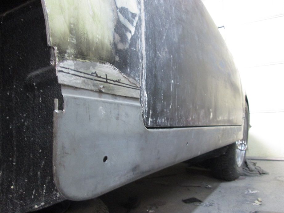

      • Onto the back.

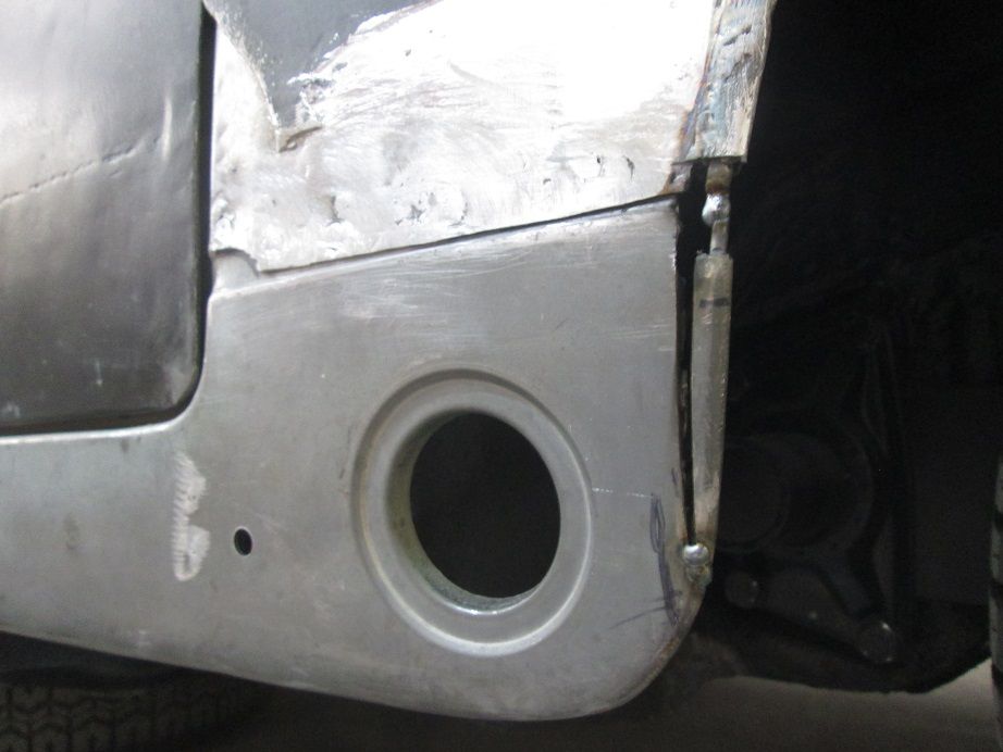

        New skin gapped and set outward to level with the latched door and seal.

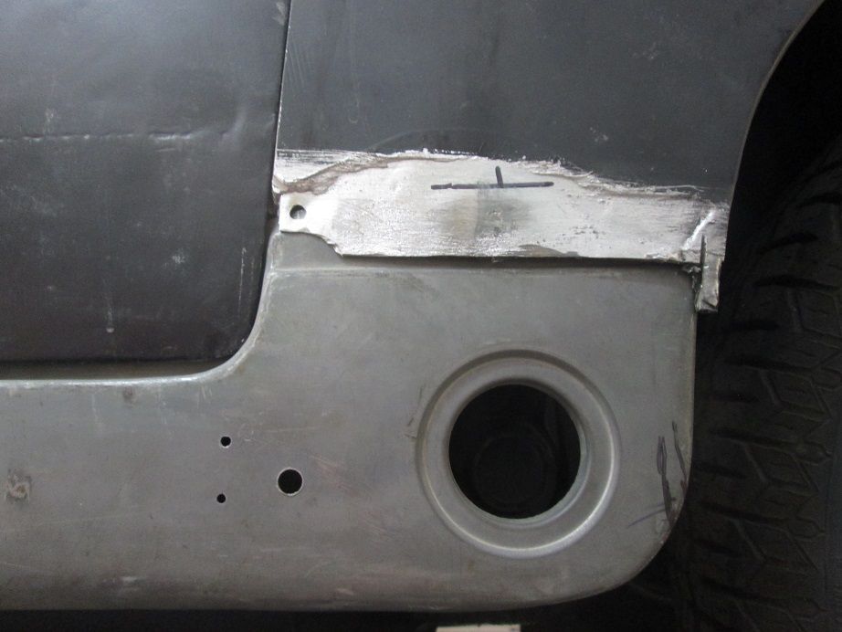

        Still sucked in too tight at the lap joint so I'll be relief cutting the fender to bring it out some.

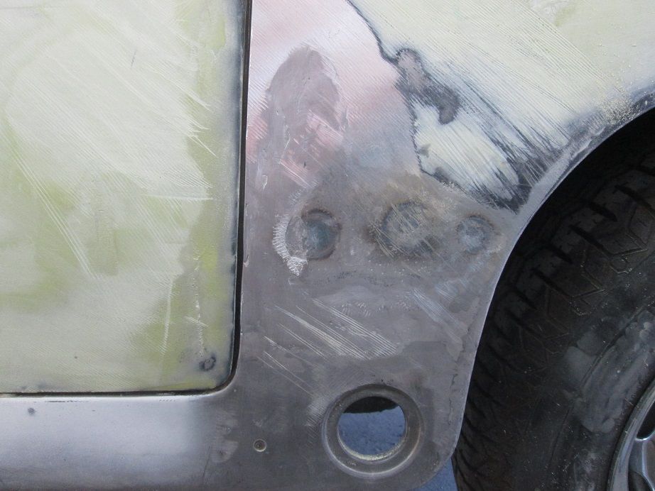

        The new rocker skin position now means I'll be extending the existing threshold out about this much to get the flanges flush for welding.

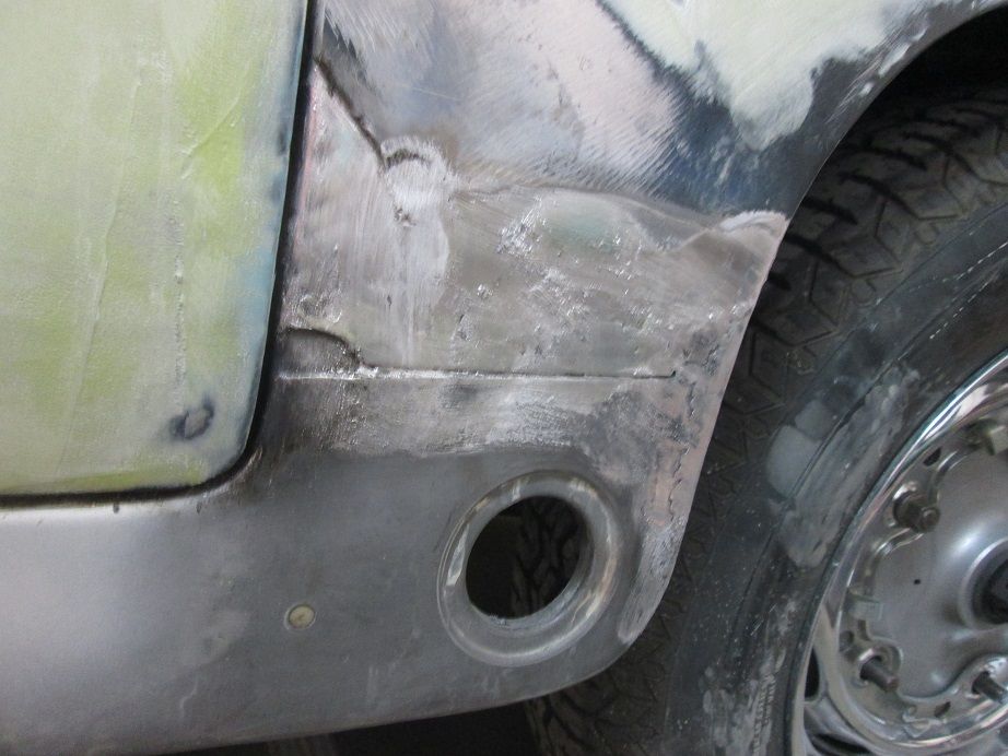

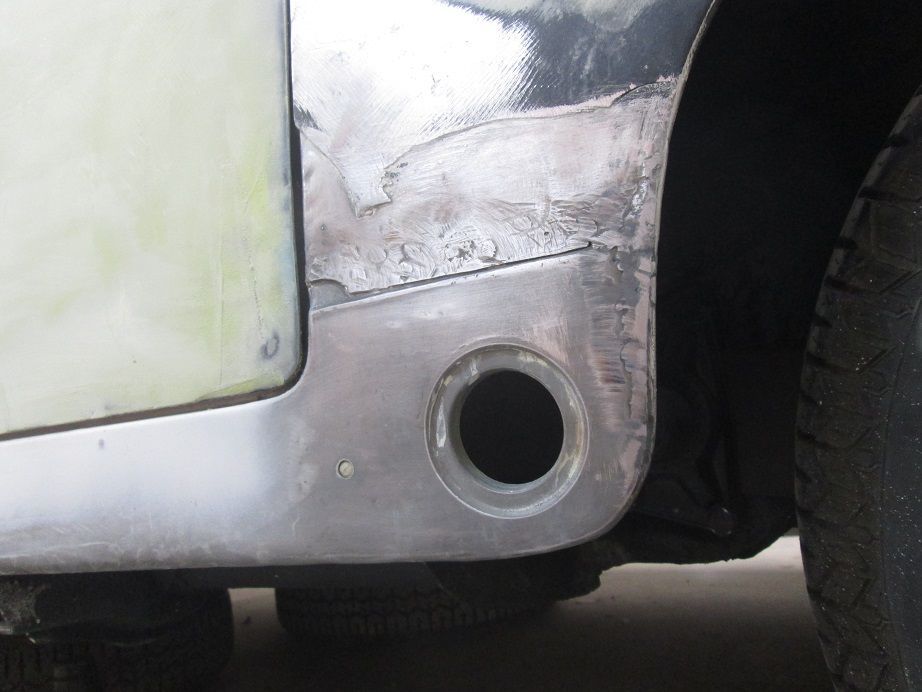

        Relief cut the edge on the rocker to lay back more gracefully and into alignment with the fender.

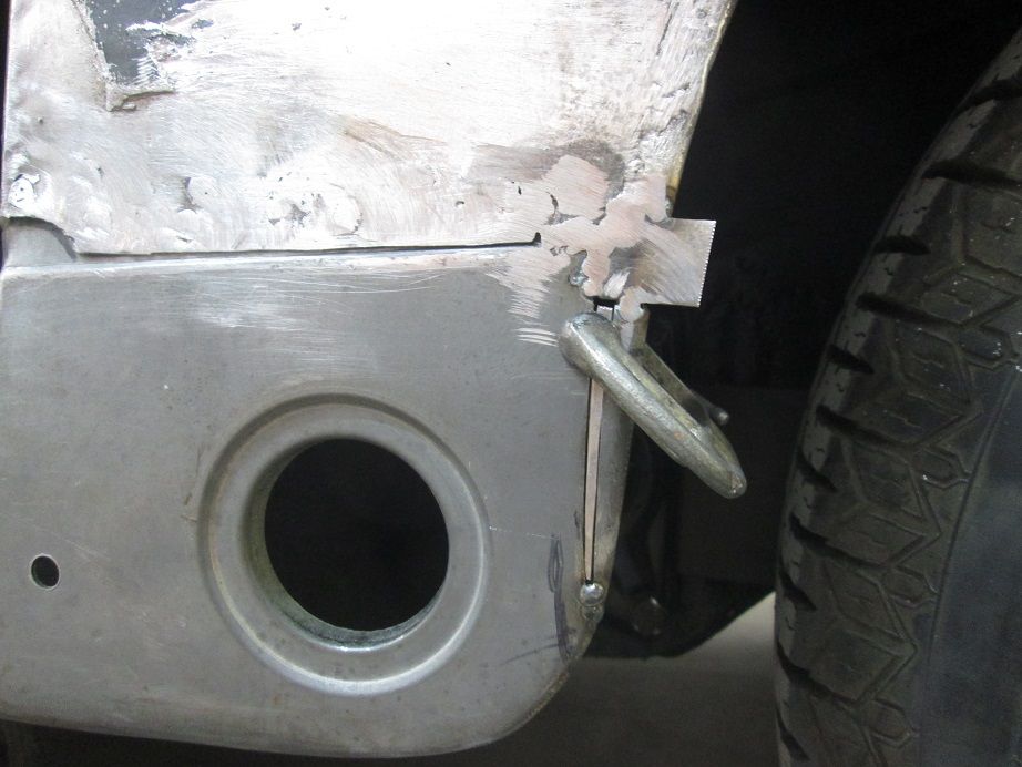

        Really happy with the new corner gap and contour. Will only need a swatch of filler if any to be perfect.

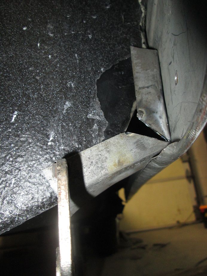

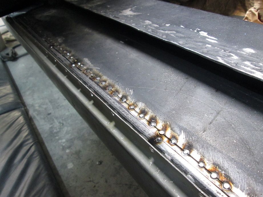

        • Extending the threshold.
          Click image for larger version  Name:	IMG_2469.JPG Views:	0 Size:	96.3 KB ID:	106239
          Relief cut in prep for a filler strip.
          Click image for larger version  Name:	IMG_2471.JPG Views:	0 Size:	77.8 KB ID:	106240
          Only had to relax the flange on the drain tray to get the needed distance. Small miracles.
          Click image for larger version  Name:	IMG_2480.JPG Views:	0 Size:	96.3 KB ID:	106241

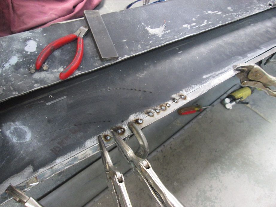

          New filler strip cut and carefully tacked in for flush on the car first.
          Click image for larger version  Name:	IMG_2484.JPG Views:	0 Size:	113.2 KB ID:	106242
          Now tacking the old flange section to it. A very time consuming PIA.
          Click image for larger version  Name:	IMG_2546.JPG Views:	0 Size:	90.2 KB ID:	106243
          Fully welded and dressed. Those where a pair of long seam welds and glad this was now behind me.

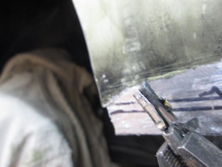

            With the skin out of the way I could just get at it with my die grinder.

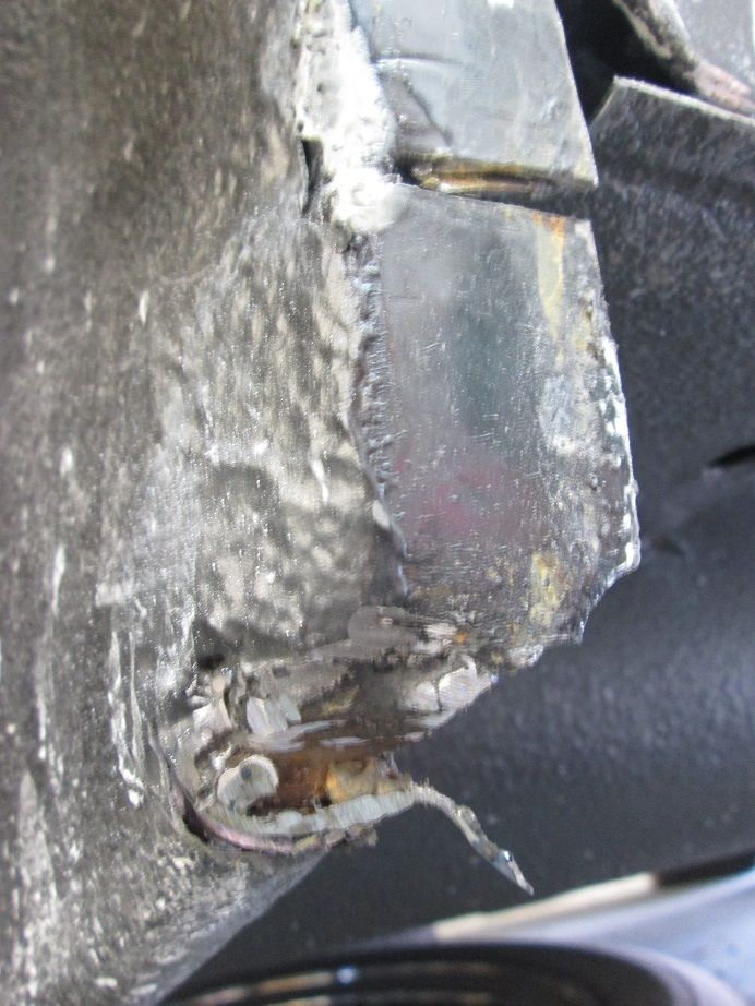

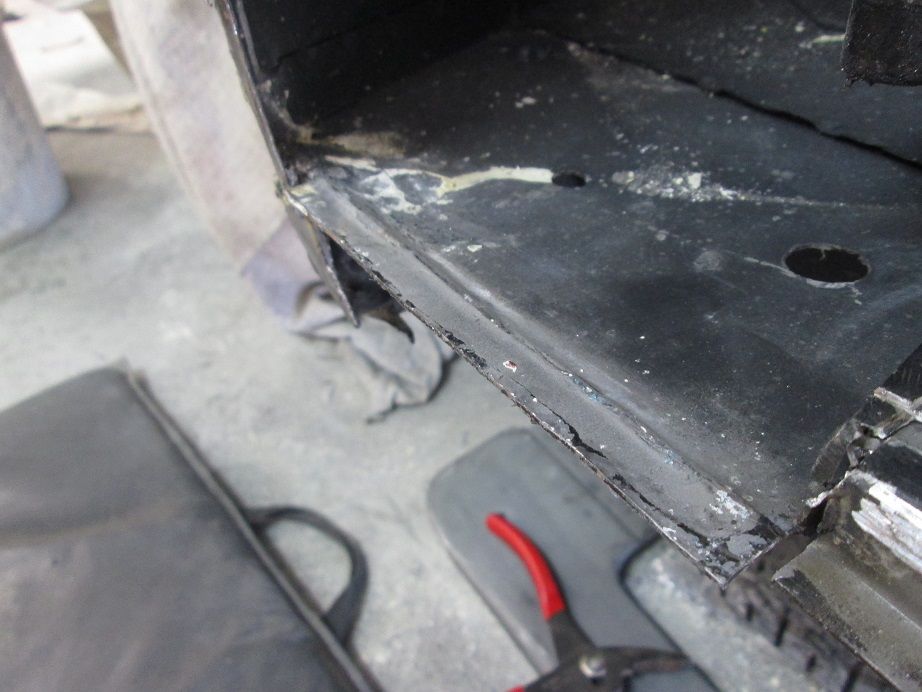

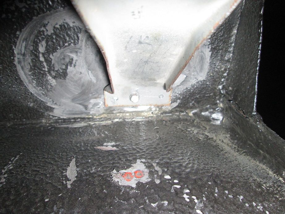

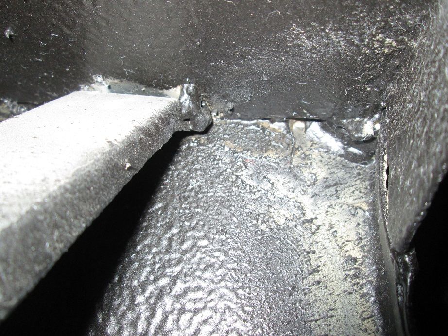

            Next issue was at the splash pan attachment point. Another large gob of wire weld hold the old skin to it to clean up. I'll also close that slit left in the outer flange as it zaps the rigidity in that area.

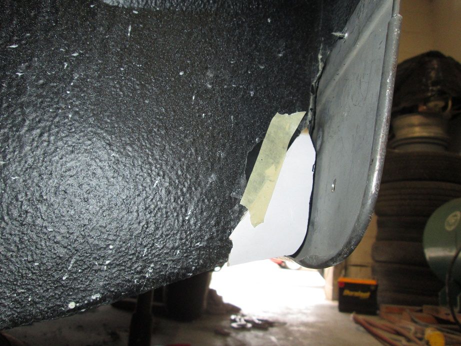

            Begin paper templates to create a new clean corner flange. Should only be a small gas welded tack holding these two together when its over.

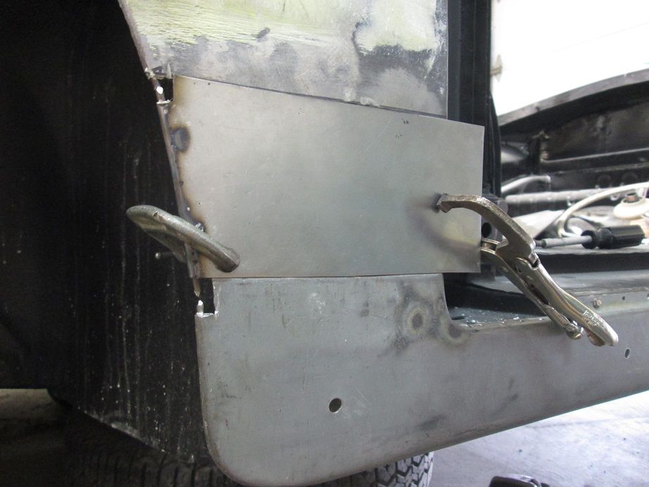

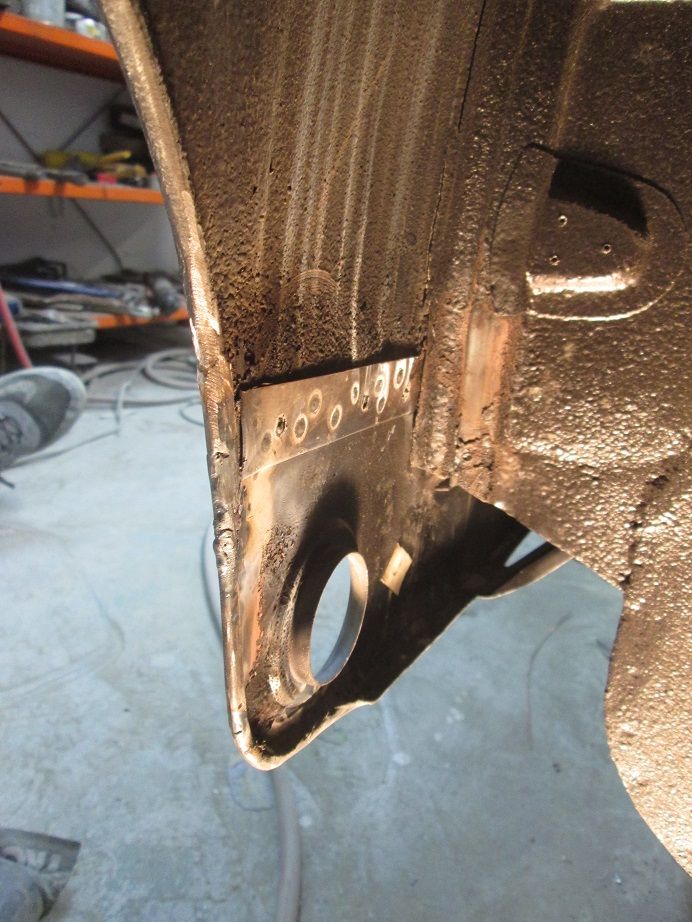

              Building out a new flanged 90 degree corner.
              Completed. Rocker mocked up to make sure they'd touch for a quick gas weld all the while not forcing the surface of the rocker to roll under as I'd previously found it.

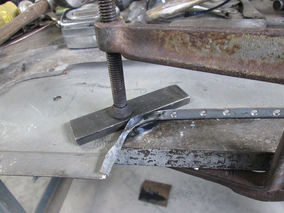

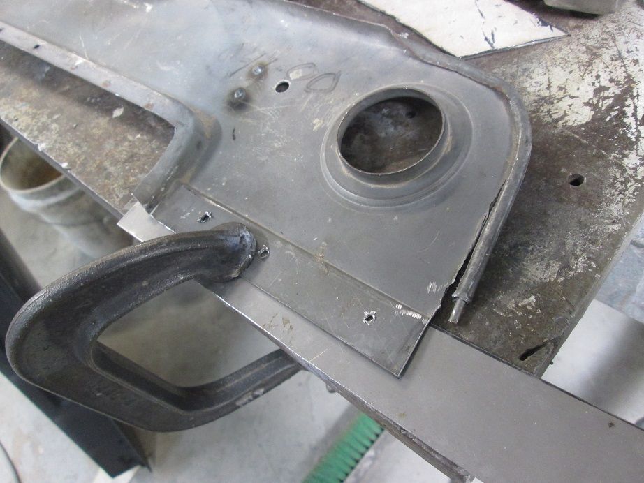

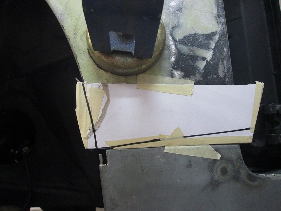

              Begin templates for the new "bridge" patch for the skin. Main thing was getting a graceful arch on that wired lip for a seamless transition when complete.

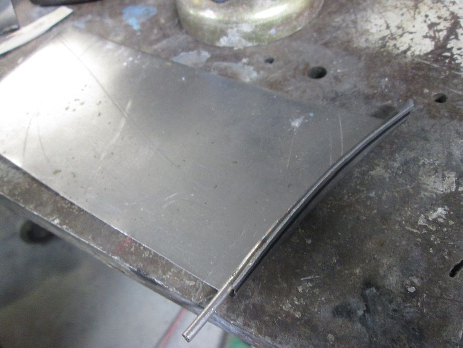

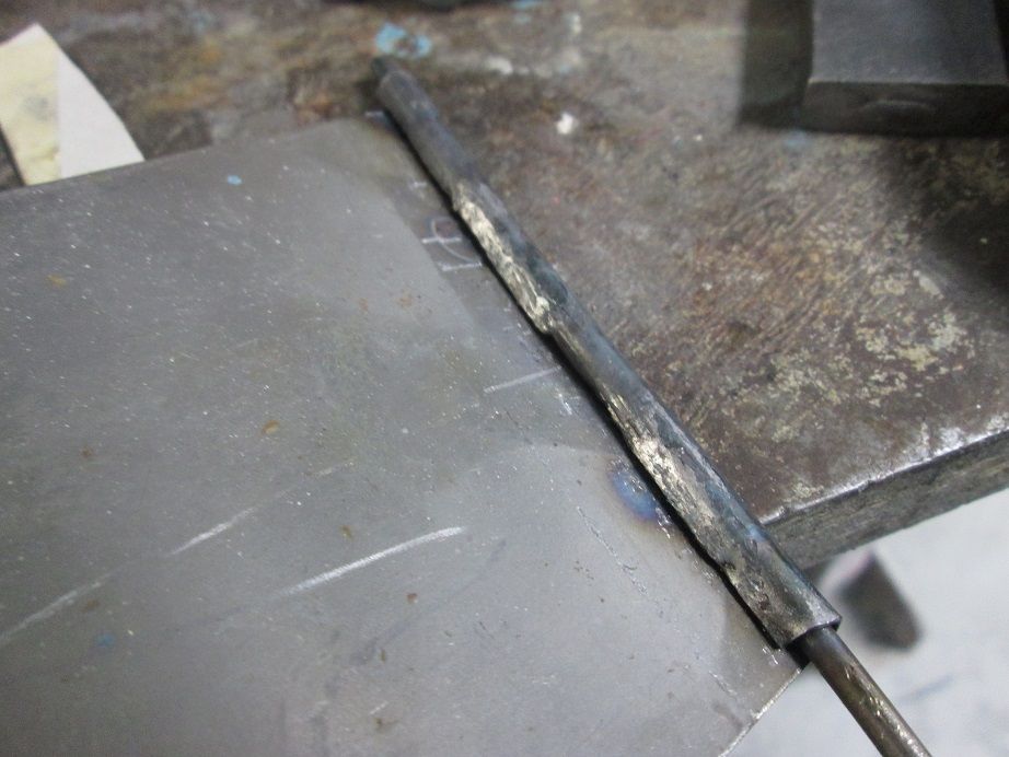

              Onto steel. Have the initial arched profile hammered over and now ready to wrap the wire in it.
              Lots of torch heat to make sure I maintain the curve and shape I need. A bit more to go here but synching up nicely around the wire.

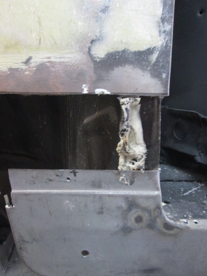

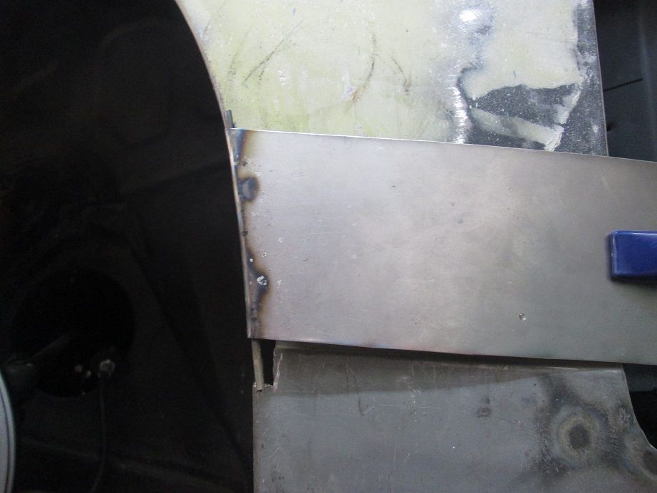

                As the fender is not original I decided to use the entire patch. Final cut line with box below marking out the wire lead that needs to stay behind.
                Click image for larger version  Name:	IMG_2536.JPG Views:	0 Size:	70.6 KB ID:	106263

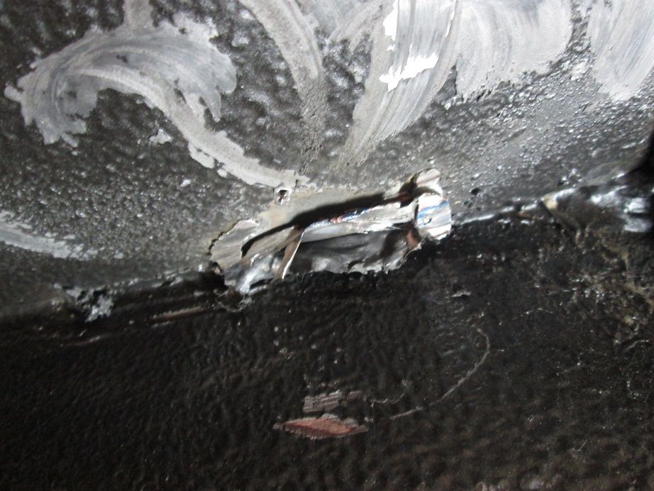

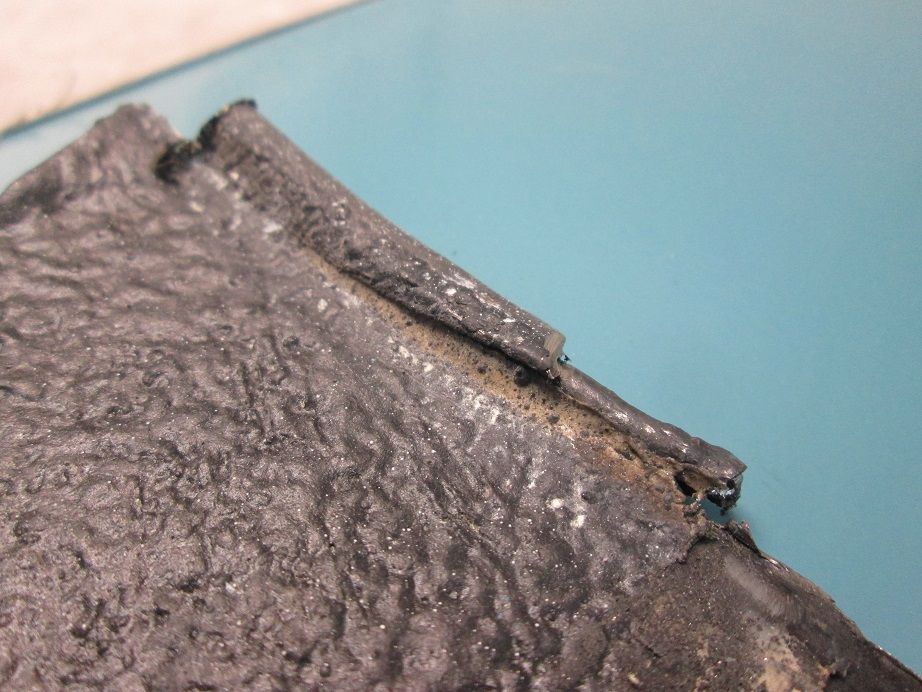

                Removed with tons of seam sealer lurking below.
                Click image for larger version  Name:	IMG_2535.JPG Views:	0 Size:	110.9 KB ID:	106264
                Apparently the wire rolled out at the other shop as it was just left and seam sealed over.
                Click image for larger version  Name:	IMG_2537.JPG Views:	0 Size:	76.2 KB ID:	106265
                Just about ready to install the new section.

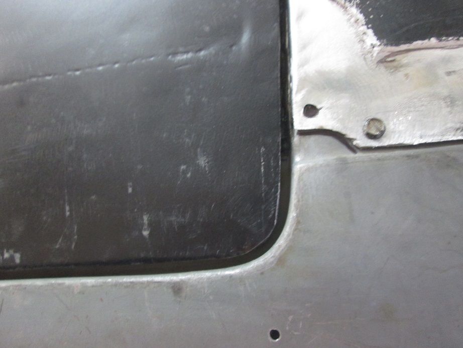

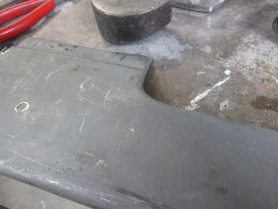

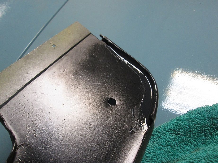

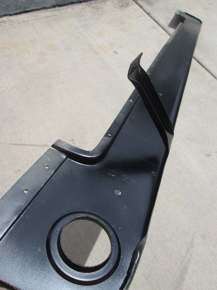

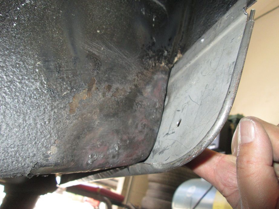

                • Rocker skin prep before final installation.
                  Click image for larger version  Name:	IMG_2500.JPG Views:	0 Size:	76.7 KB ID:	106289
                  there is a raised shoulder around this corner from the initial tooling process. I've left it alone in the past but this area always plays games with the levelness and transition off the door.
                  Click image for larger version  Name:	IMG_2501.JPG Views:	0 Size:	105.7 KB ID:	106290
                  This shoulder was hammered back even and in reaction the flanged corner shape relaxed a bit. The skin is clamped to my table here to keep it flat and the flanged corner was heated and hammered back in.
                  Click image for larger version  Name:	IMG_2539.JPG Views:	0 Size:	95.7 KB ID:	106292
                  Next was the step flanges on both ends. They are stamped a little deeper than the thickness of 20 gauge so to reduce filler it was clamped to my table again and a section of 20G. inserted. The step was then hammered back to the depth of this section.
                  Click image for larger version  Name:	IMG_2540.JPG Views:	0 Size:	83.9 KB ID:	106291
                  Now the surfaces will carry over much closer and reduce the amount of solder needed. Going back to what you where saying earlier Roy; had I not been through this before I wouldn't have thought to question these parts. I would have just installed them as is. I'm much more sanicle now. I expect nothing to fit out of the box.

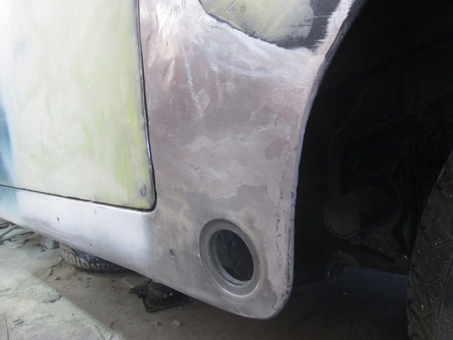

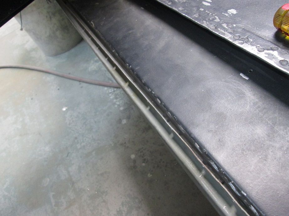

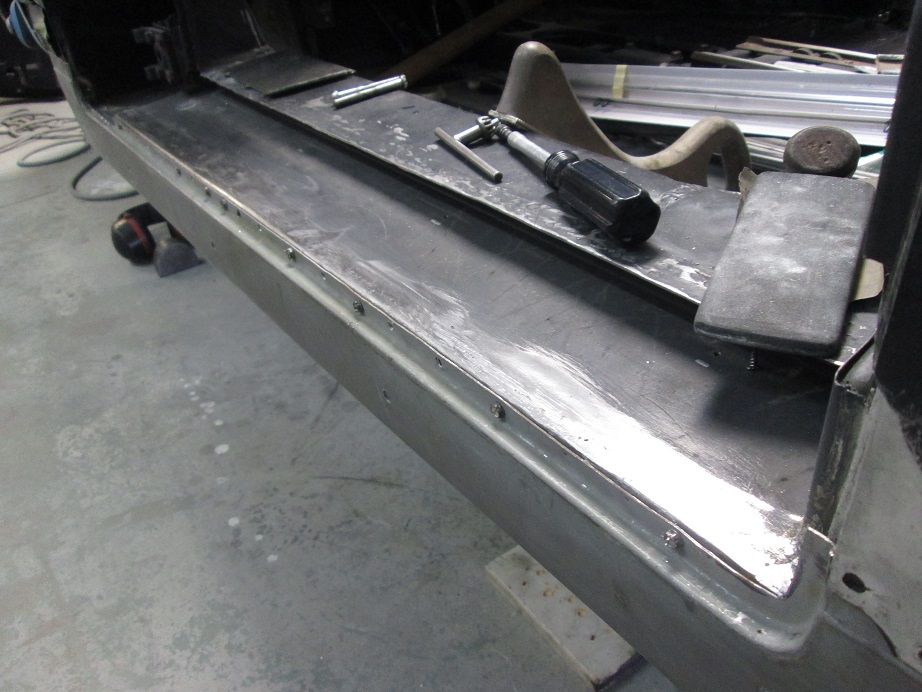

                  • Final installation:
                    Click image for larger version  Name:	IMG_2569.JPG Views:	0 Size:	127.7 KB ID:	106295
                    Always that "one more thing" to do before you can proceed. Seam sealer applied to the rolled wire corners that are well out of the heat affected zone.
                    Click image for larger version  Name:	IMG_2570.JPG Views:	0 Size:	83.1 KB ID:	106296

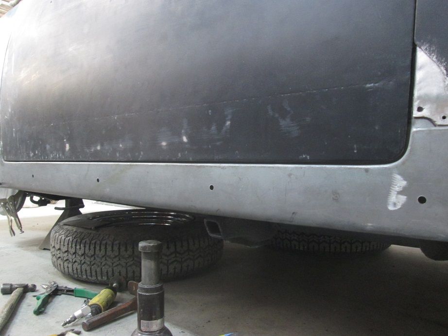

                    A long road with a ton of prep required to both the car and the new rocker but I finally made it to the final install.
                    Click image for larger version  Name:	IMG_2572.JPG Views:	0 Size:	71.5 KB ID:	106297

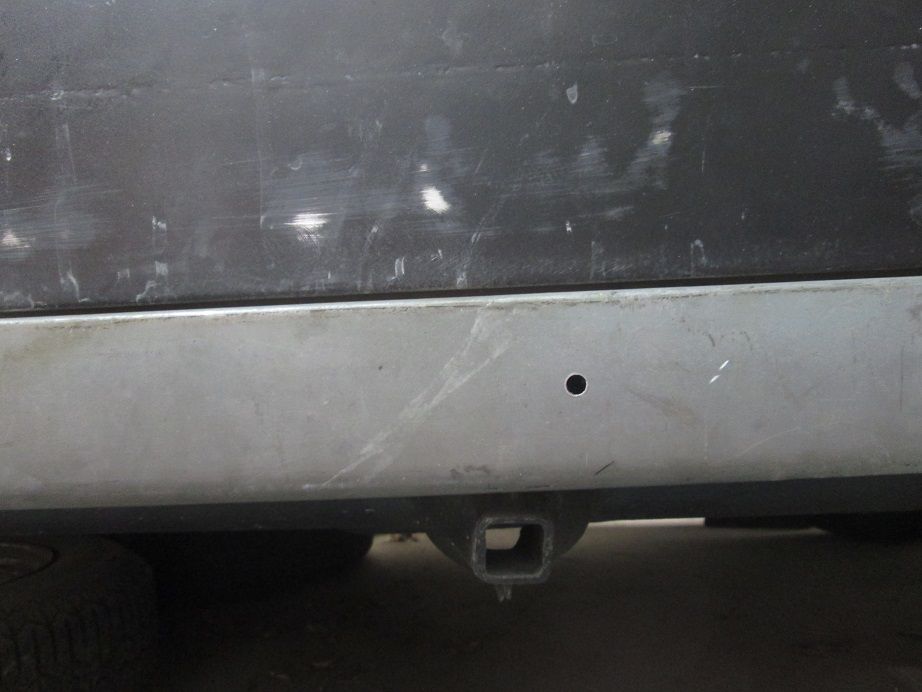

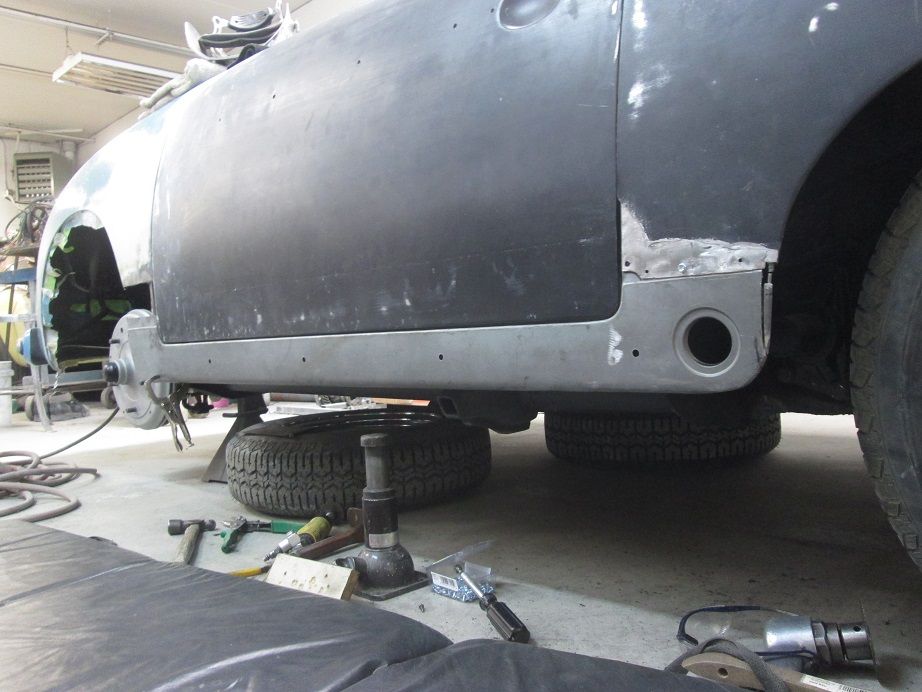

                    Best average 3MM bottom door gap and with no overbite.
                    Click image for larger version  Name:	IMG_2573.JPG Views:	0 Size:	92.6 KB ID:	106298
                    Rocker has a much better vertical profile without the Pre-A type roll under it showed up with. Also highlighting the smooth transition from door bottom to rocker here.
                    Click image for larger version  Name:	IMG_2571.JPG Views:	0 Size:	87.8 KB ID:	106299
                    Begin welding on that back flange first.
                    Thanks for stopping by!

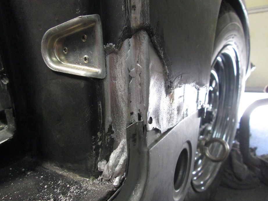

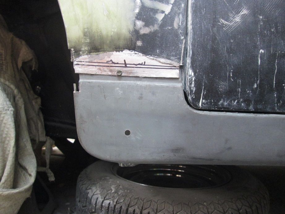

                    • welding up back corner.
                      Click image for larger version  Name:	IMG_2578.JPG Views:	0 Size:	77.0 KB ID:	106309
                      Plug welds first.
                      Click image for larger version  Name:	IMG_2609.JPG Views:	0 Size:	64.2 KB ID:	106310
                      Wire leads fused next.
                      Click image for larger version  Name:	IMG_2612.JPG Views:	0 Size:	81.2 KB ID:	106311
                      Last was a sheath to both rewrap and support the wire at the weld joint. Back filler strip inserted and ready to weld up.
                      Click image for larger version  Name:	IMG_2818.JPG Views:	0 Size:	117.8 KB ID:	106312

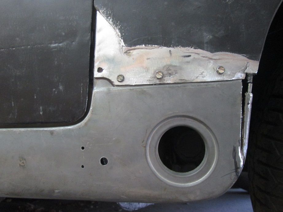

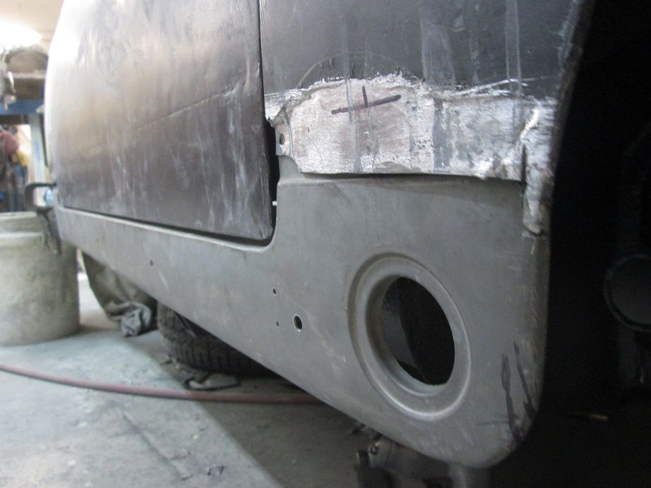

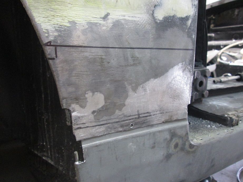

                      • Soldering rear rocker joint.
                        Click image for larger version  Name:	IMG_2824.JPG Views:	0 Size:	88.5 KB ID:	106315
                        Lead wiped with tinning acid and ready to apply some solder.
                        Click image for larger version  Name:	IMG_2826.JPG Views:	0 Size:	90.9 KB ID:	106316
                        really out of practice so it took a few applications to get I coated.
                        Click image for larger version  Name:	IMG_2828.JPG Views:	0 Size:	75.0 KB ID:	106317

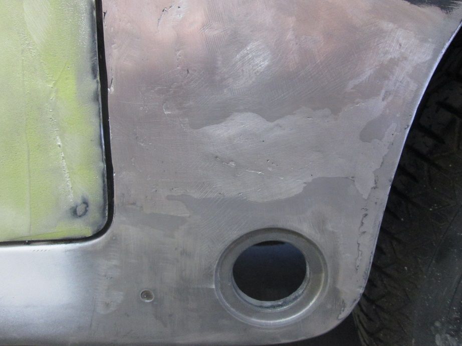

                        Excess lead filed and leveled to shape. Got the transition on that wired lip I was after.
                        Click image for larger version  Name:	IMG_2830.JPG Views:	0 Size:	67.0 KB ID:	106318

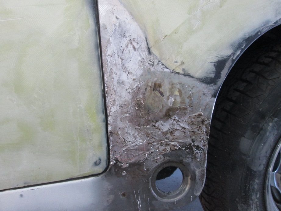

                        Just a skim coat to cover the joint was all that's really needed. Most of the features and lines will stay steel versus being formed from solder.
                        Click image for larger version  Name:	IMG_2831.JPG Views:	0 Size:	89.1 KB ID:	106319
                        Began heat shrinking some high spots as it went. Posting the front rocker work next.
