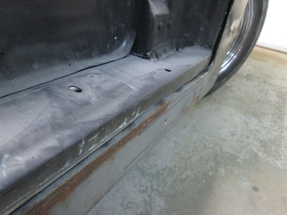

  • Threshold installation:
    Click image for larger version  Name:	IMG_4582.JPG Views:	0 Size:	126.8 KB ID:	107690 Threshold now in its best adjusted position and almost ready to begin the most tricky part of welding it up in and under the hinge.
    Click image for larger version  Name:	IMG_4584.JPG Views:	0 Size:	130.0 KB ID:	107691 It of course did not just fit perfectly. With the threshold mounted flush to the rocker skin I had a shortfall/ space at this forward inner flange. A small relief cut allowed the necessary movement outward I needed to close it up for a flush fit under here.
    Click image for larger version  Name:	IMG_4579.JPG Views:	0 Size:	166.7 KB ID:	107692

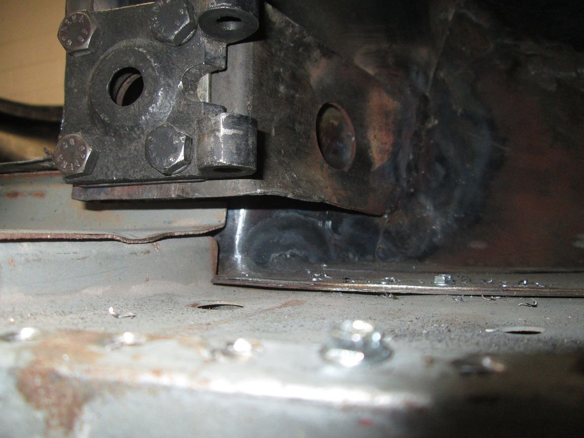

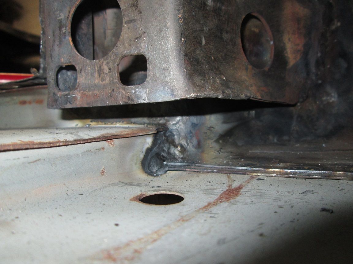

    Another small detail before I could mount the threshold on was adding in this 90 degree section that mounts and supports the back of it. This I've noticed seems to be a later T2 addition as my early T1 was just welded directly to the lock post from the top. The previous shop just welded directly like a T1 but while I'm in here I want to correct what I can.
    Click image for larger version  Name:	image_62118.jpg Views:	3 Size:	131.7 KB ID:	107693 Began welding the threshold panel in for good. Started with the hardest to reach area first; seam welding under the hinge mount.
    Click image for larger version  Name:	image_62119.jpg Views:	3 Size:	111.9 KB ID:	107694 With that inner area now behind me I could now add in the connection point off of the hinge mount.

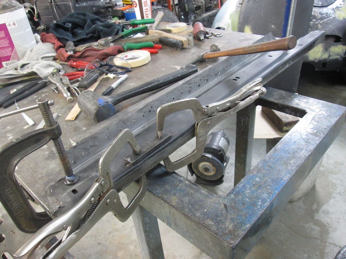

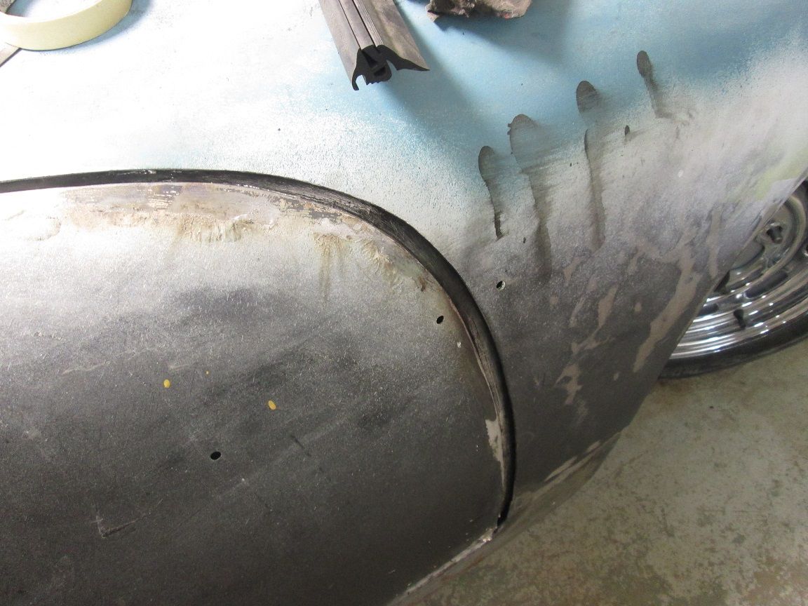

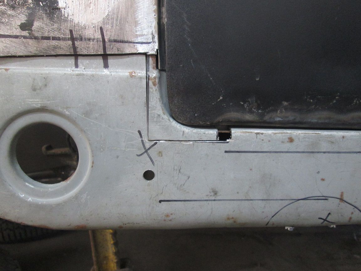

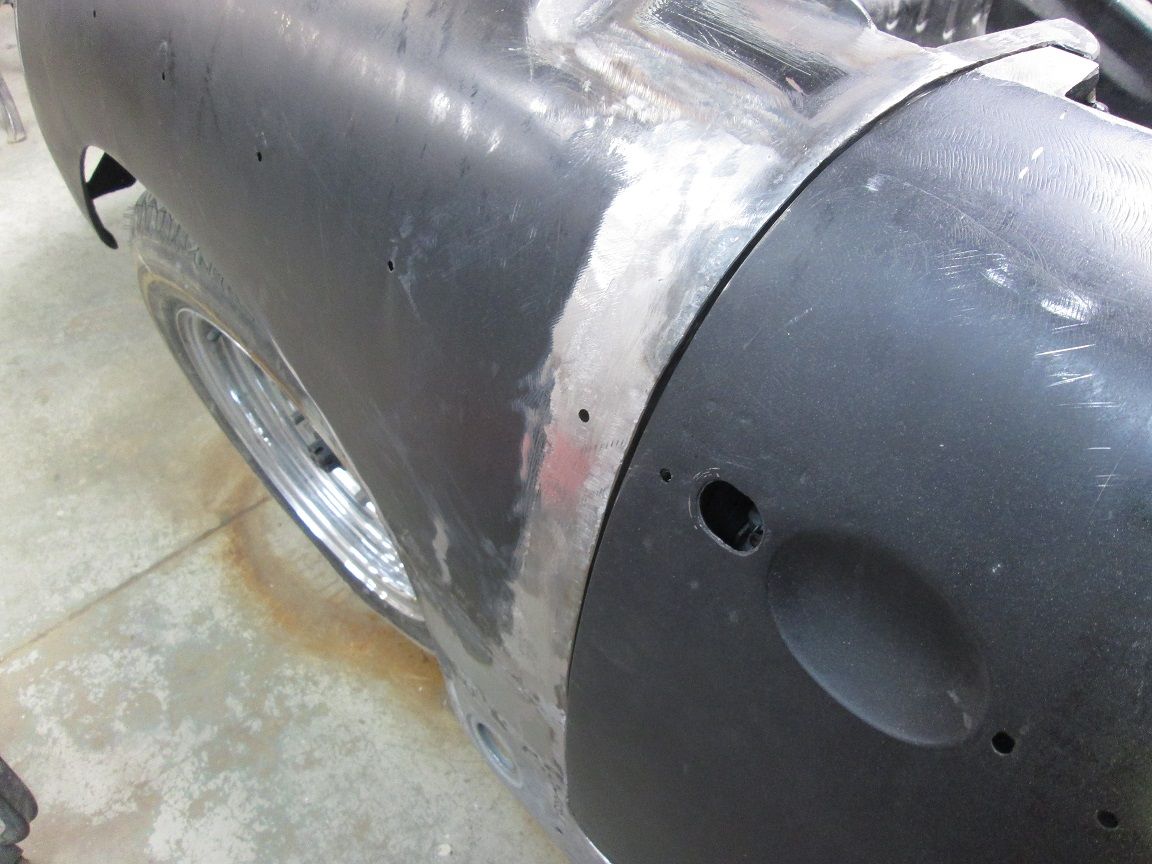

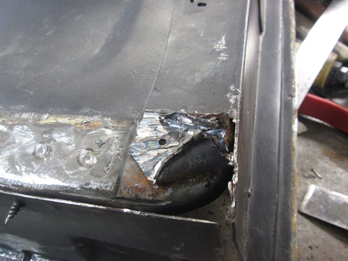

      • Rocker skin modification :
        Click image for larger version  Name:	IMG_4601.JPG Views:	0 Size:	138.4 KB ID:	107702 Rocker skin in its best adjusted position and now adding in the relief cuts to get the wired edges to line up for a seamless transition.
        Click image for larger version  Name:	IMG_4604.JPG Views:	0 Size:	128.8 KB ID:	107703Corner moved back a few MM's giving me the needed gaps on both sides. Only the corner of the door intrudes, Will trim the door back and reshape to finish out the gap.
ID:	107704 Relief cutting the rear edge for alignment now.
ID:	107705 The wired edge section just above it is rough and has suffers from some old accident damage. Easier and cleaner to replace this area with a fresh piece. Working on that next.
ID:	107706 Lots more prep work yet but its a bit closer.

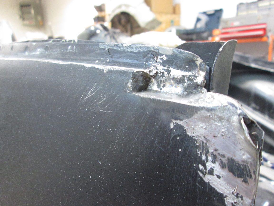

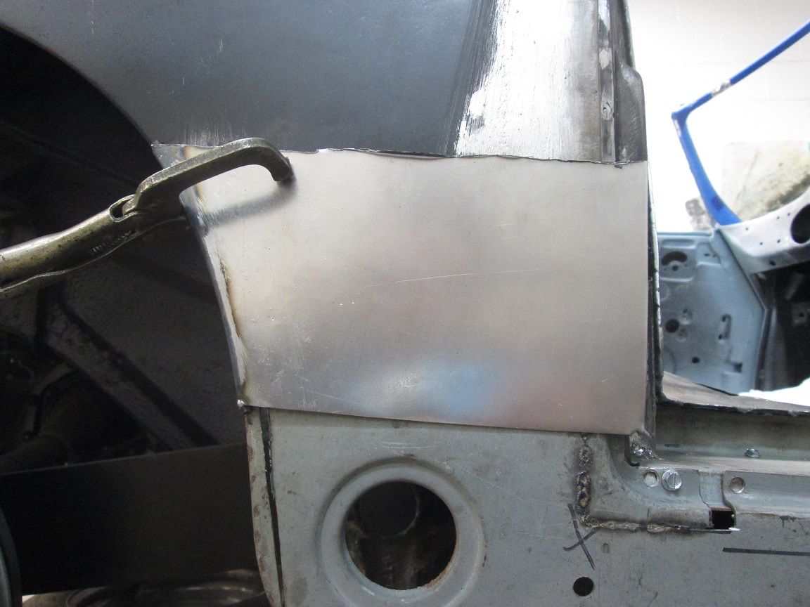

        • New repair section:
ID:	107708 Experimenting with some original sections to get the profile shape that I was after. This one was the best and I was tempted to use it but as you can see there wasn't enough to cover up the rest of that hole.
ID:	107709 Instead it became my template on fresh piece of steel.
ID:	107710 eventually got the flanged profile shape that carried on the line between these two panels.
ID:	107711 Just had to carefully roll a new piece of wire in it next.
ID:	107712 Newly shaped wired edge completed. Thankfully I didn't screw it up needed shape as rolled it over the wire. Final trimming and fitment next.

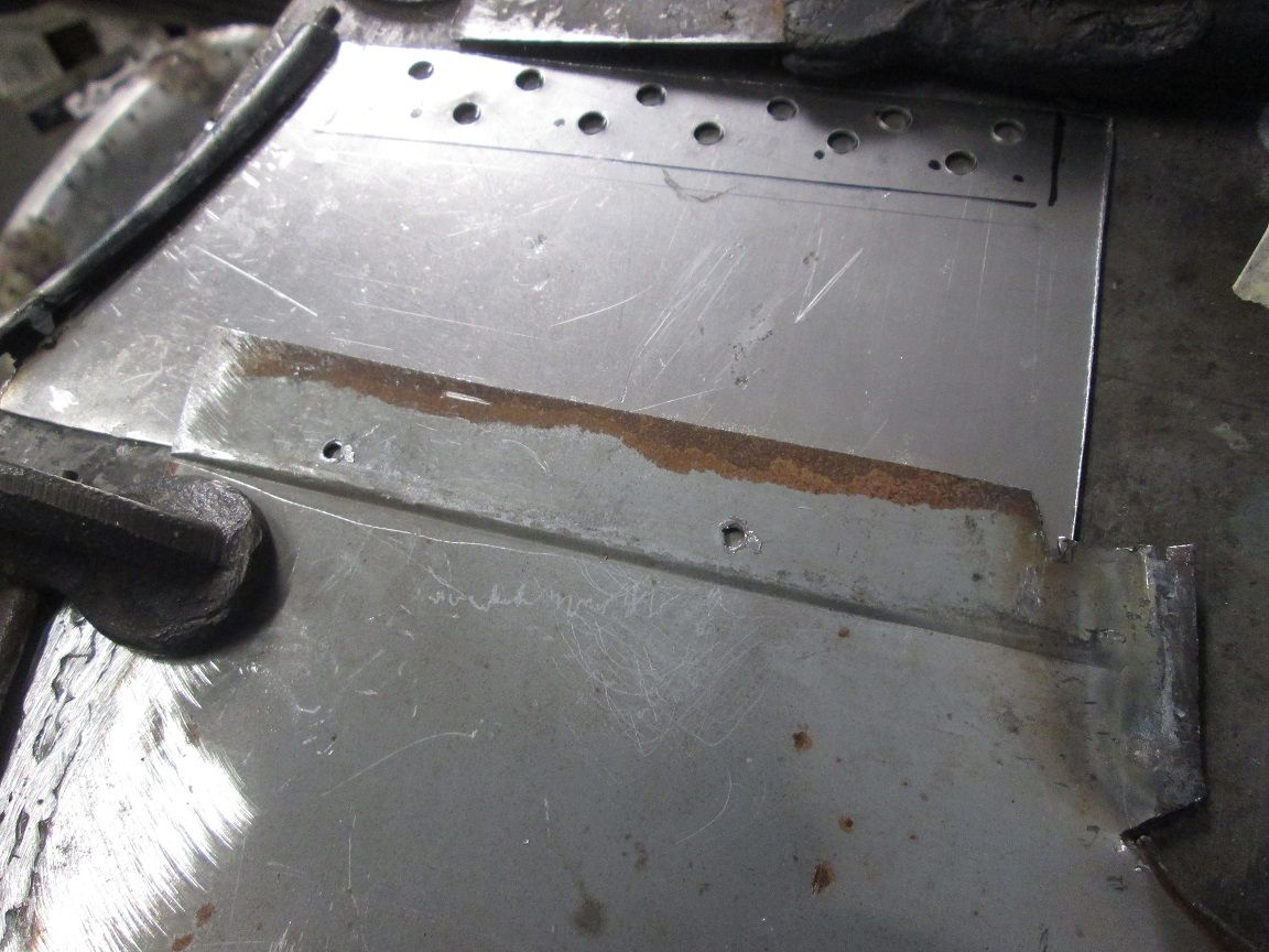

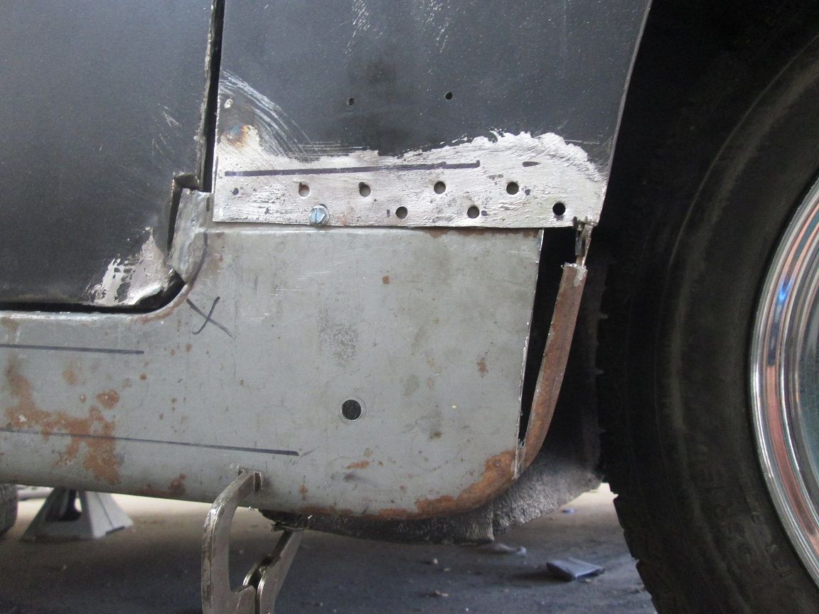

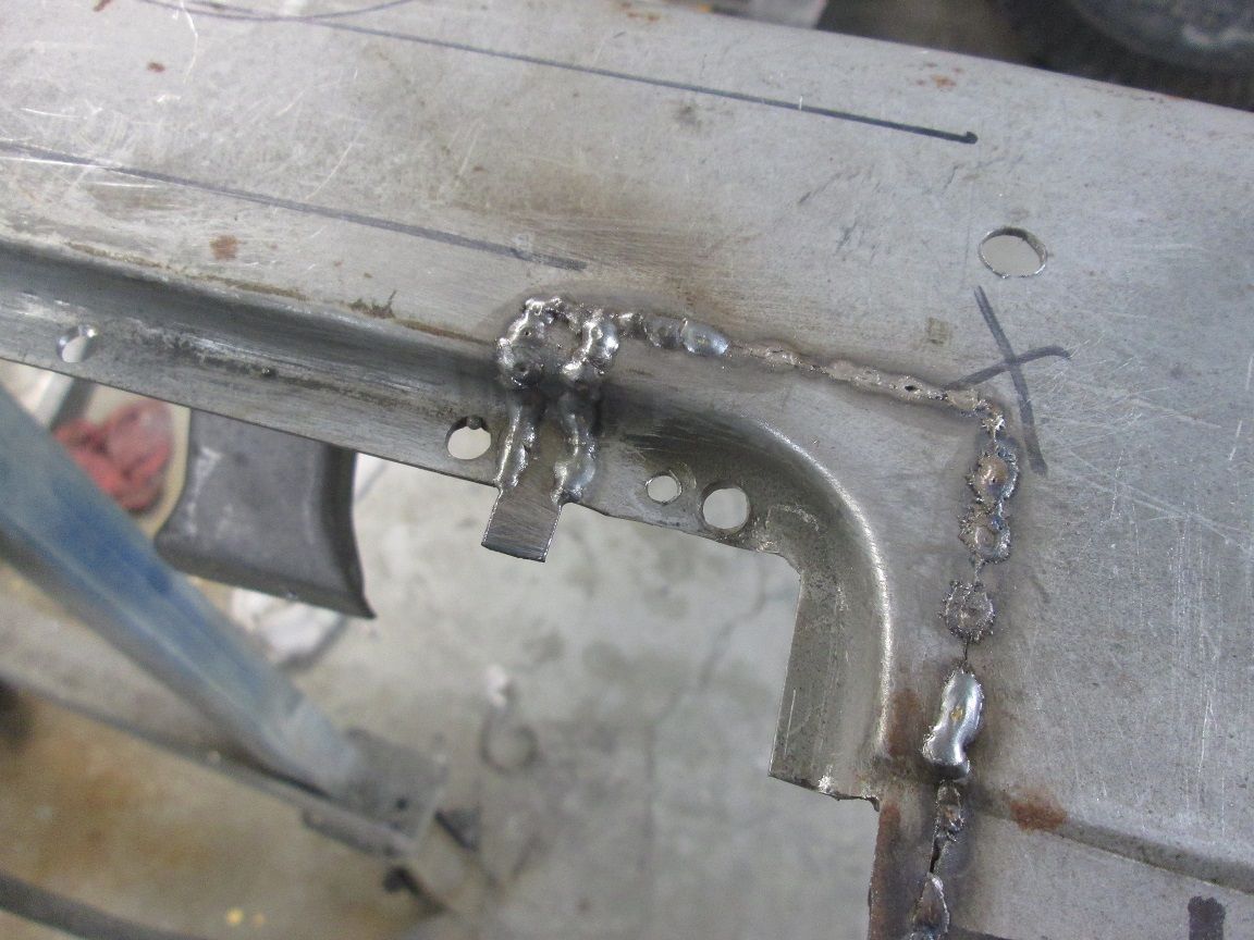

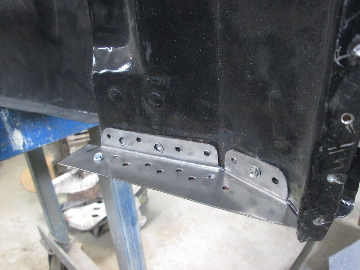

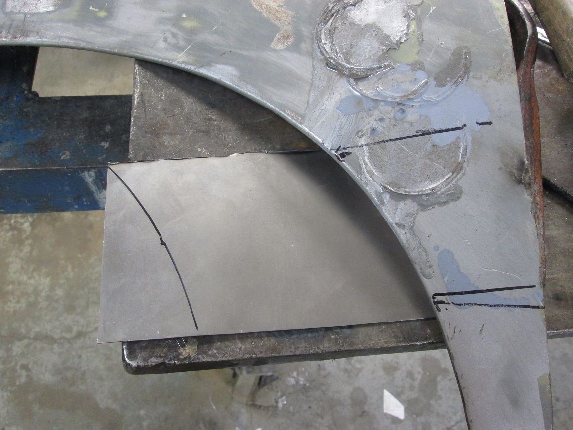

          • repair patch prep:
ID:	107717 New section just about ready to go in for good.
ID:	107718 Trimmed and fitted to final shape but a few things to finish up first.
ID:	107721 Had to soften the step flange for a more even final fit across the panels.
ID:	107719 Then I had to finish welding up the corner.
ID:	107720 And reshape the shouldered edge of the forward corner. All pettily little things but all had to be finished out before the panel can go on.

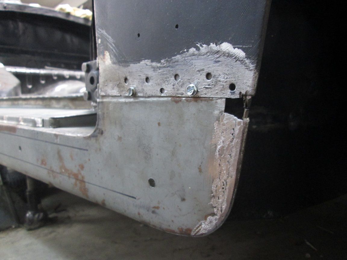

            • Splash pan Modification:
ID:	107723 Forward modifications all stitched up and just about ready to mount this rocker on for good BUT....
              As usual there are more slight changes that needed to be made to its mating surfaces. With the rocker now in its more correct vertical attitude the splash pan in this area is coming up way too short. Filling that huge gap with seam sealer is not an option

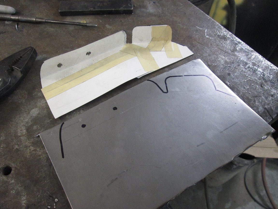

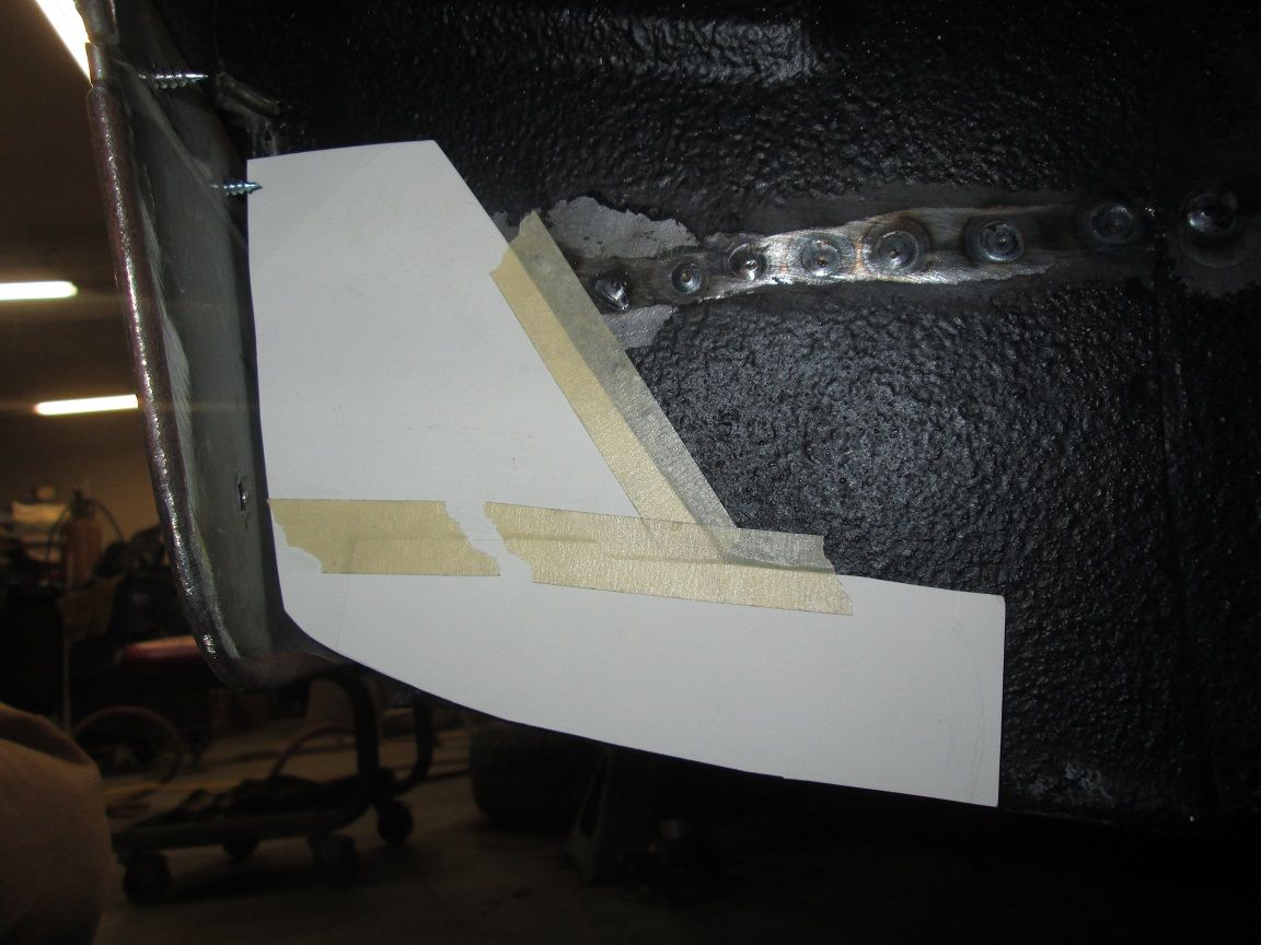

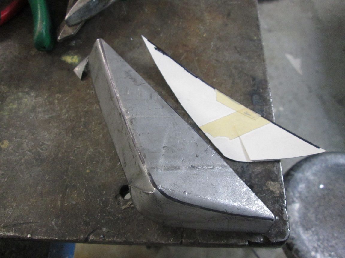

ID:	107725 So paper templates were next to create a contour that was going to give me a nice tight fit against the back of the rocker as well as carry on the bottom of its flanged edge seamlessly in the end.
ID:	107726 New flanged corner in steel.

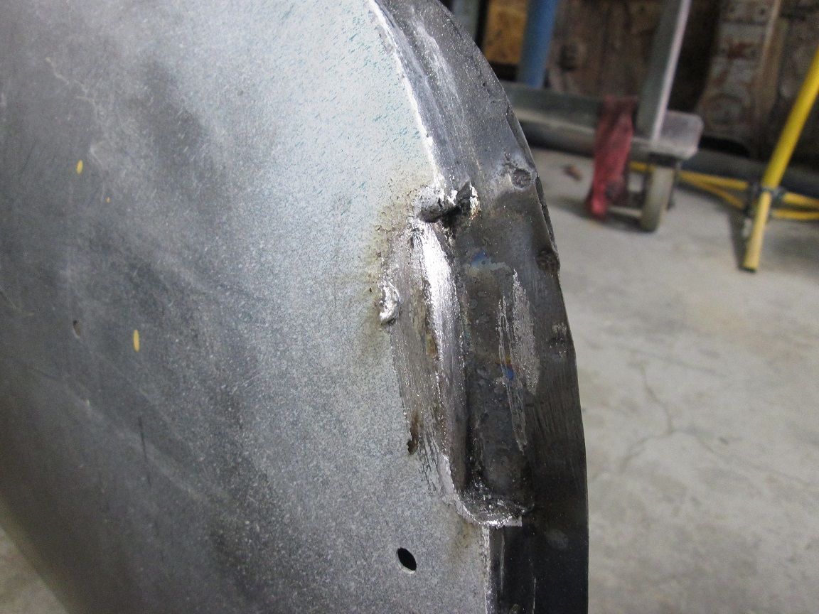

ID:	107727 There's the fitment against the back of the rocker that I'm looking for. Tacking this in next.

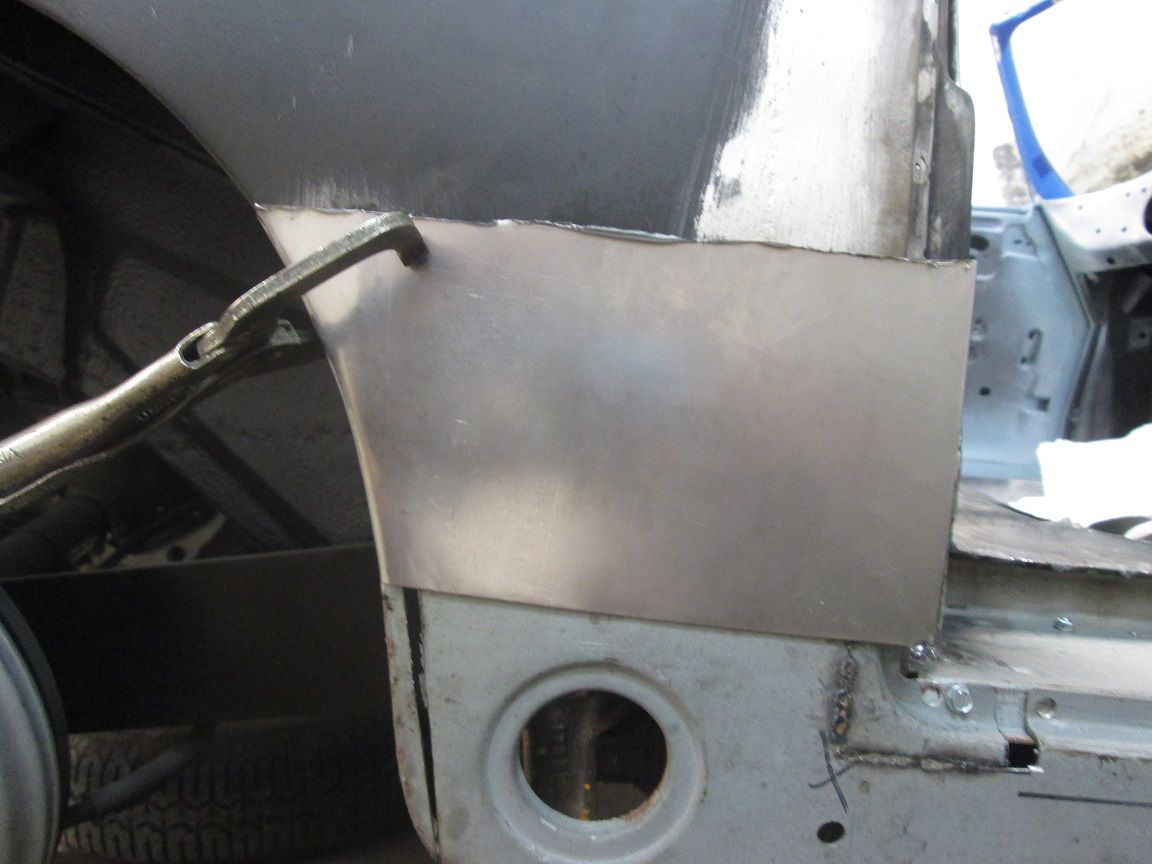

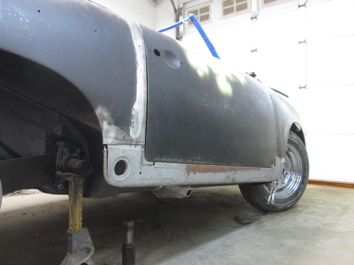

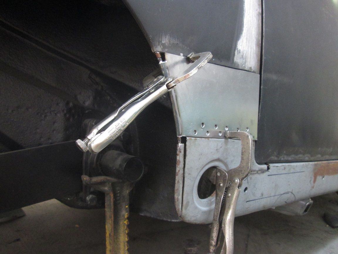

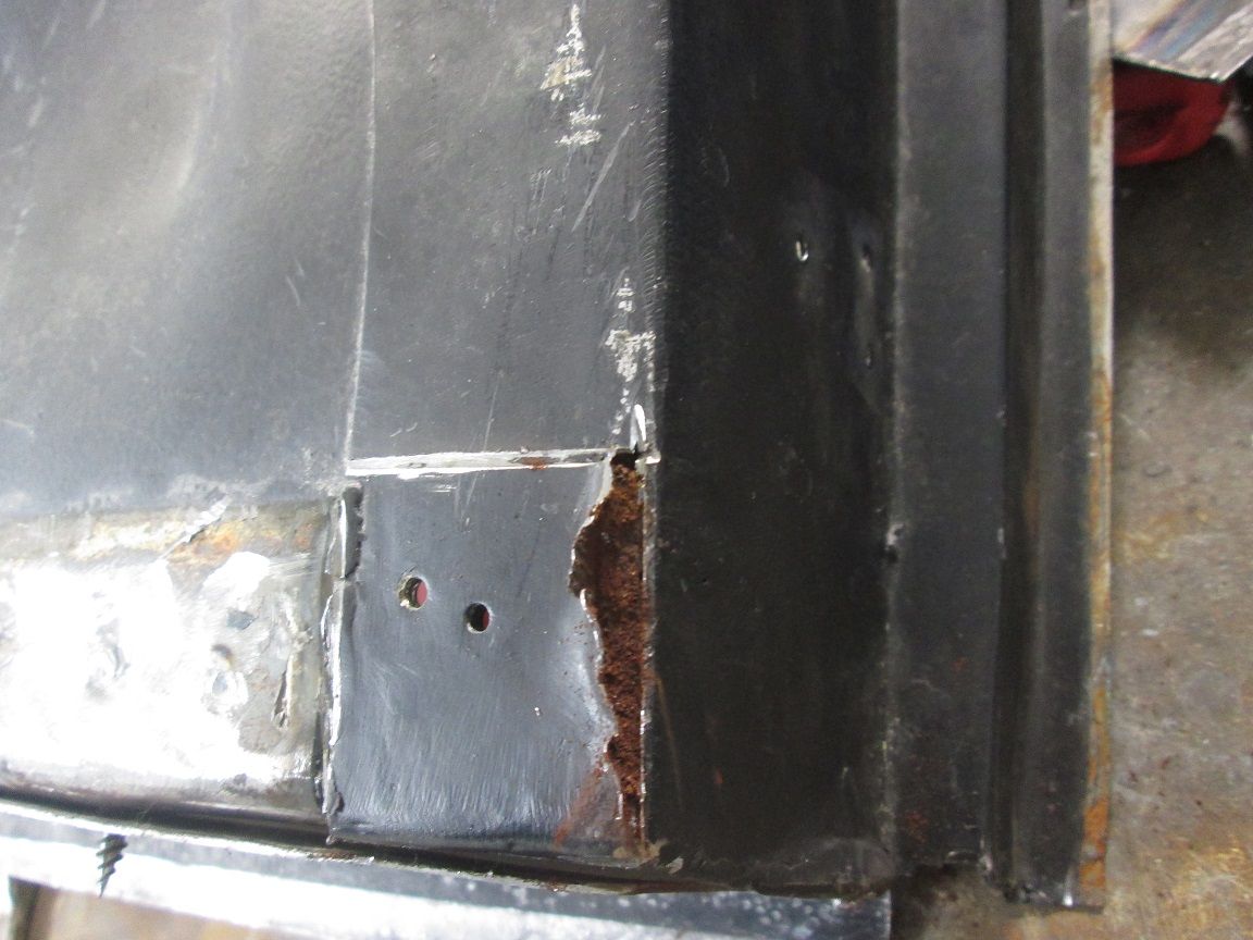

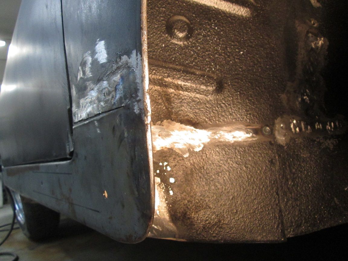

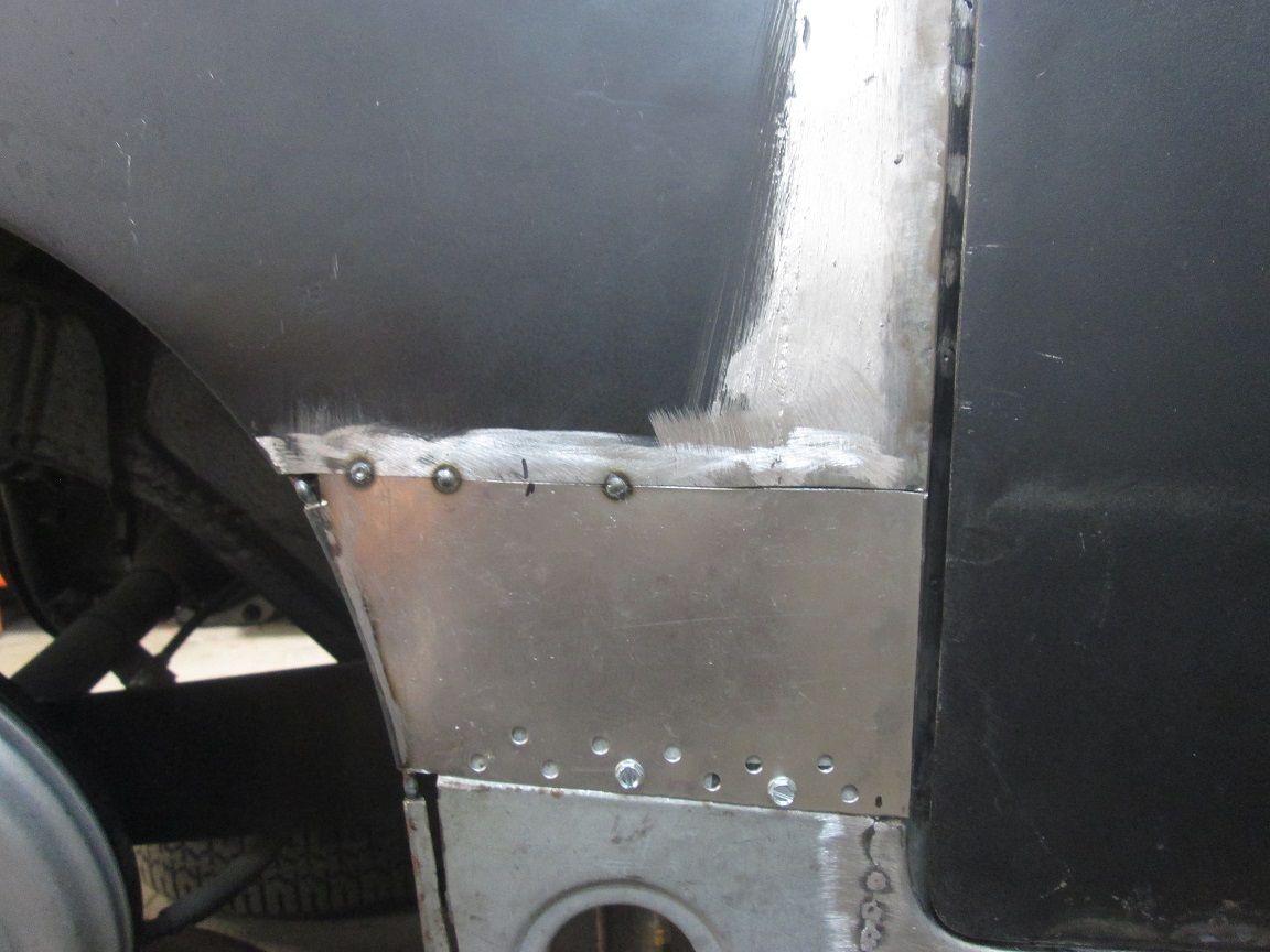

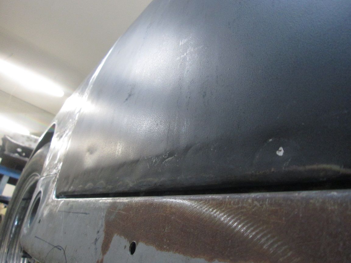

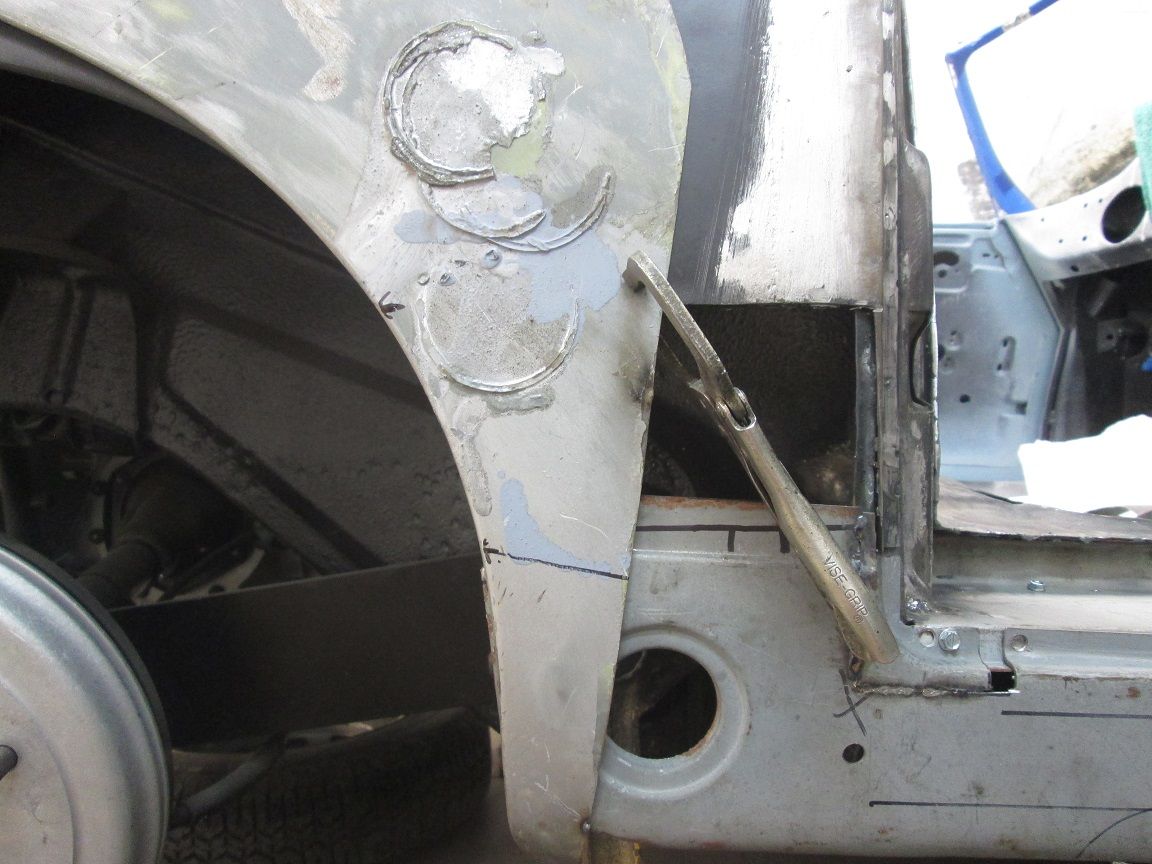

              • Rocker finally welded into place:
                New corner all stitched in and dressed with rocker skin now welded into final position.

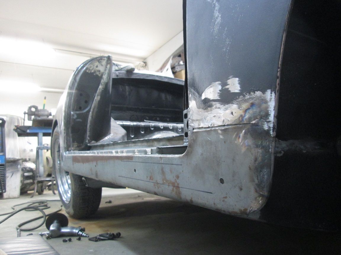

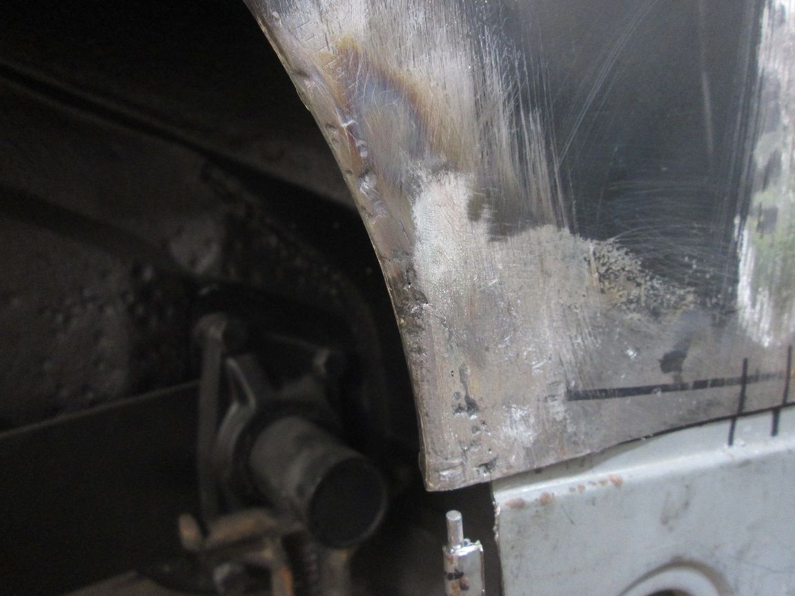

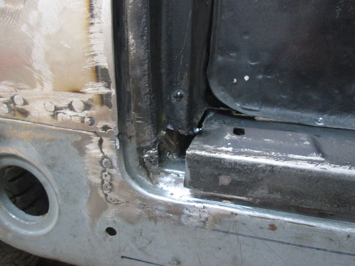

ID:	107737 Trickiest part a was smooth transition from splash flange onto the new corner section. Went as well as I could hope for; especially down inside here where it really can't bee seen once the car is finished.
ID:	107738 Onto welding up the leading wired edge and the lap joint.
ID:	107739 Moved to the back where a small roll patch had to be added to the leading edge as well as recontour the shape of the edge slightly to transition into the rocker.
ID:	107740 All welded but the leading edge at the door opening will need some more shaping later.

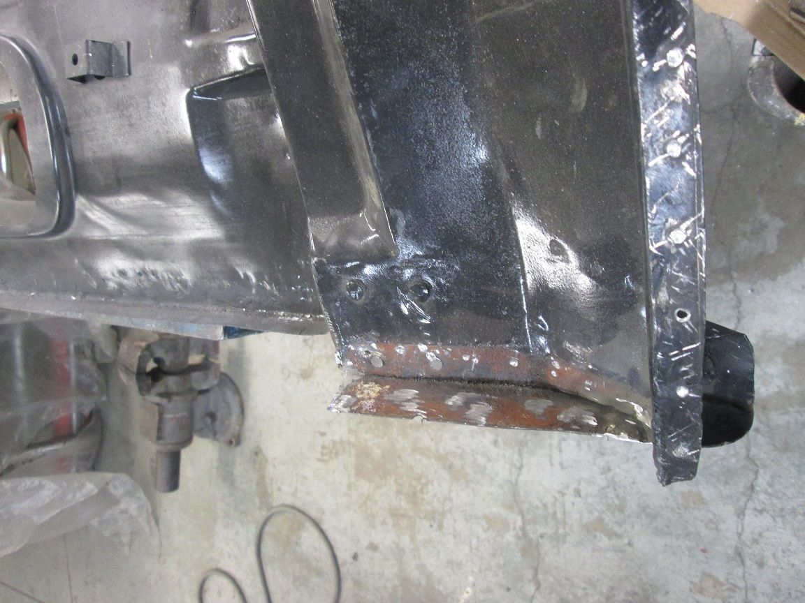

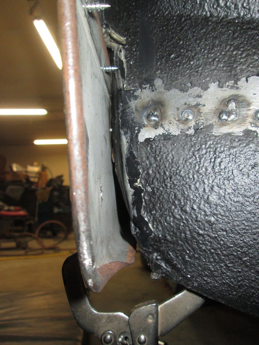

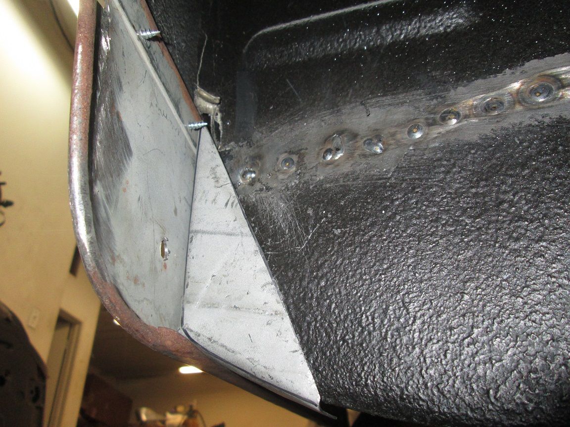

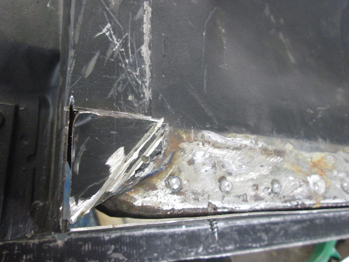

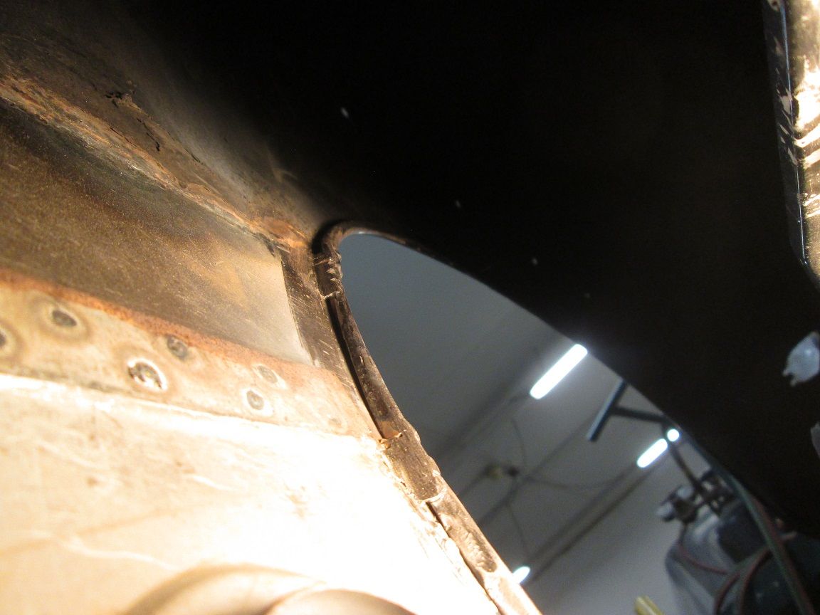

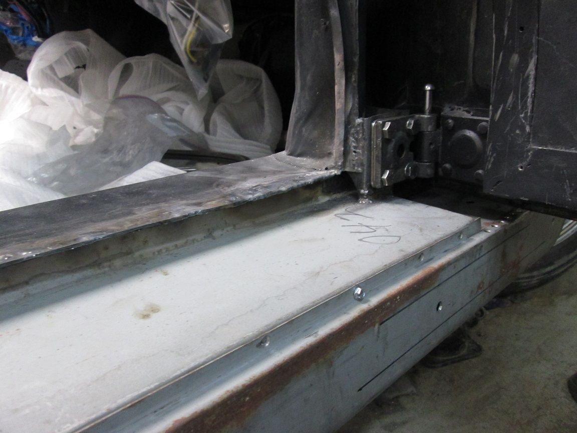

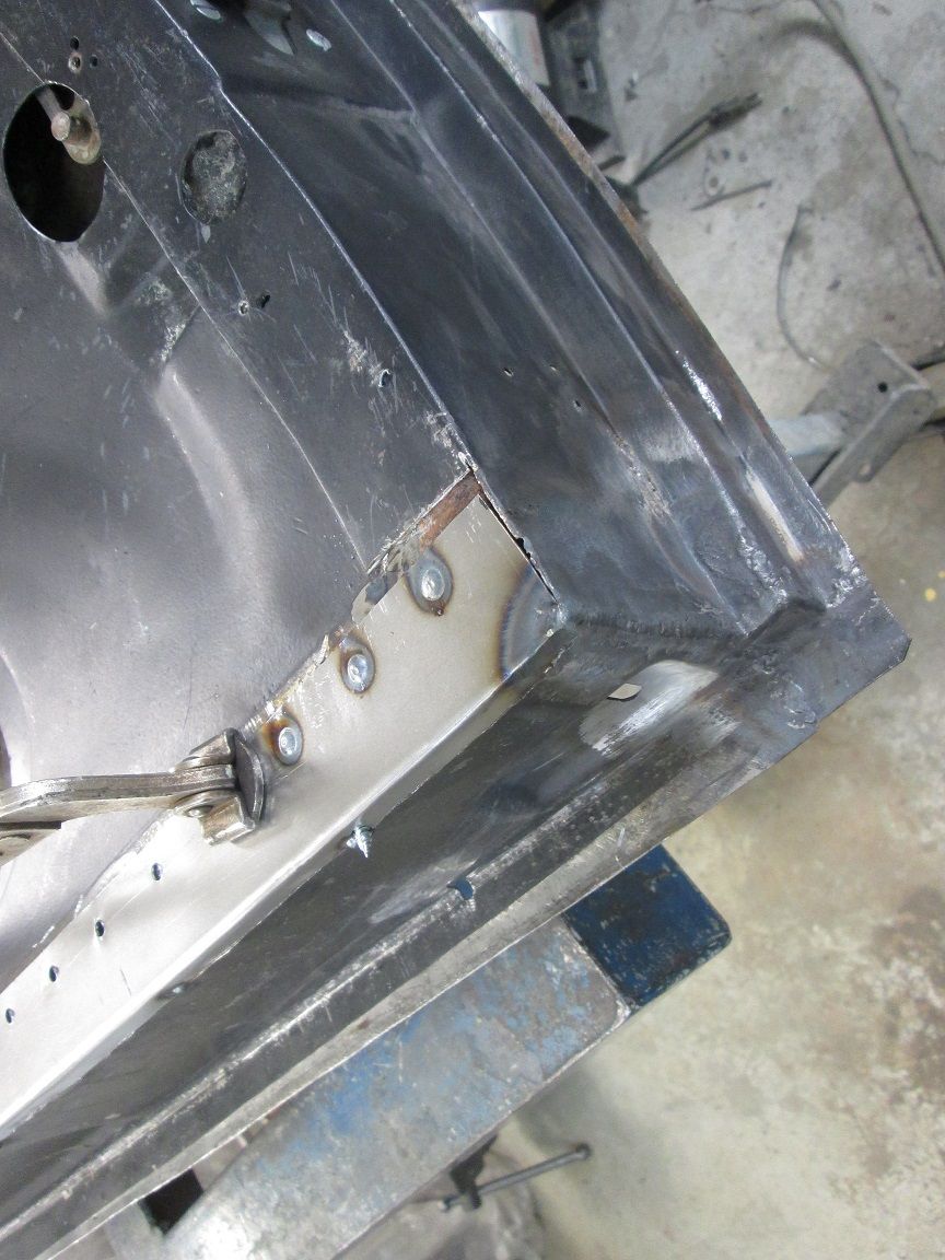

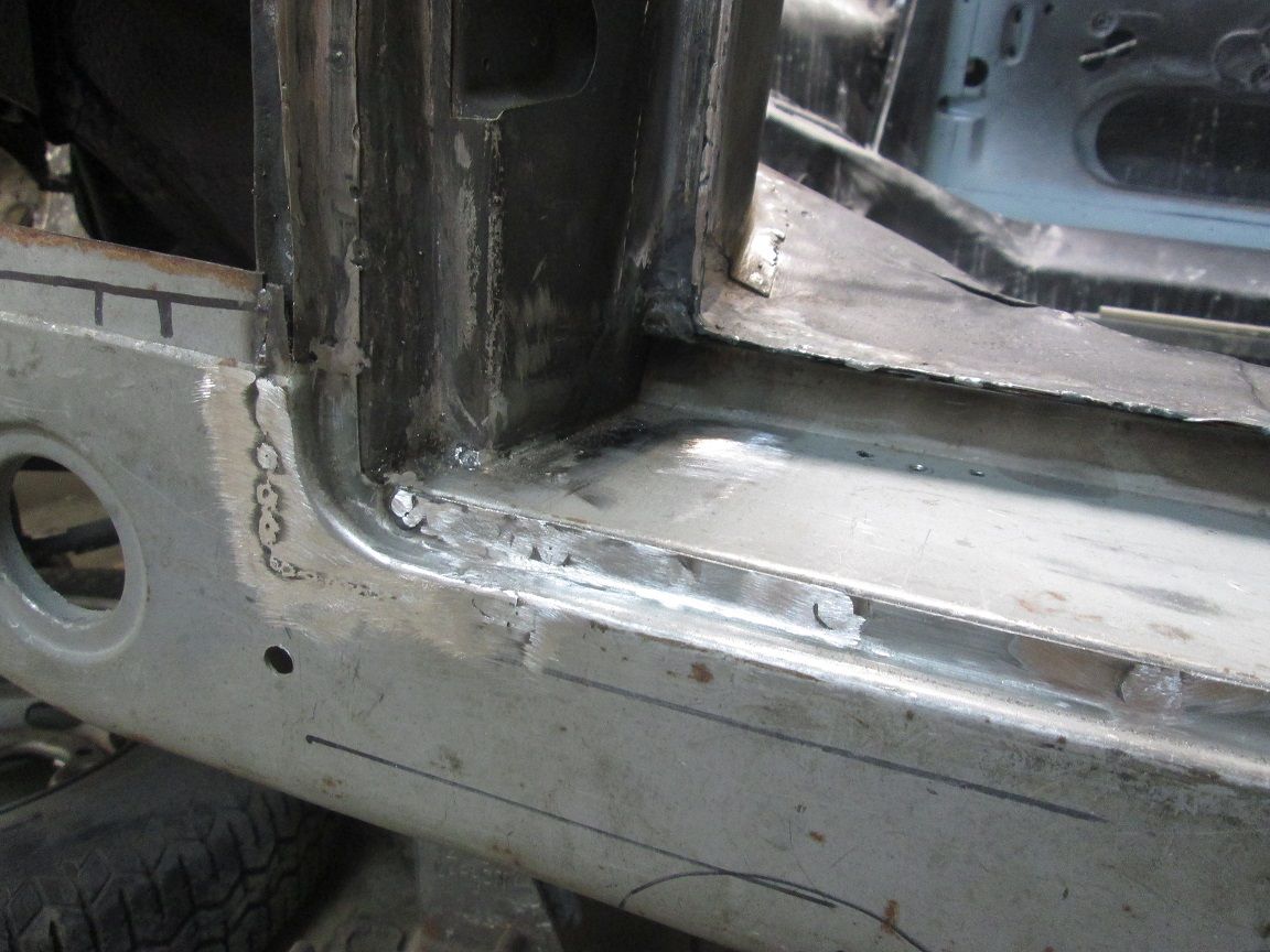

                • Welding up the rear of the rocker:
ID:	107742 Plug welding along the threshold and moving rearward.

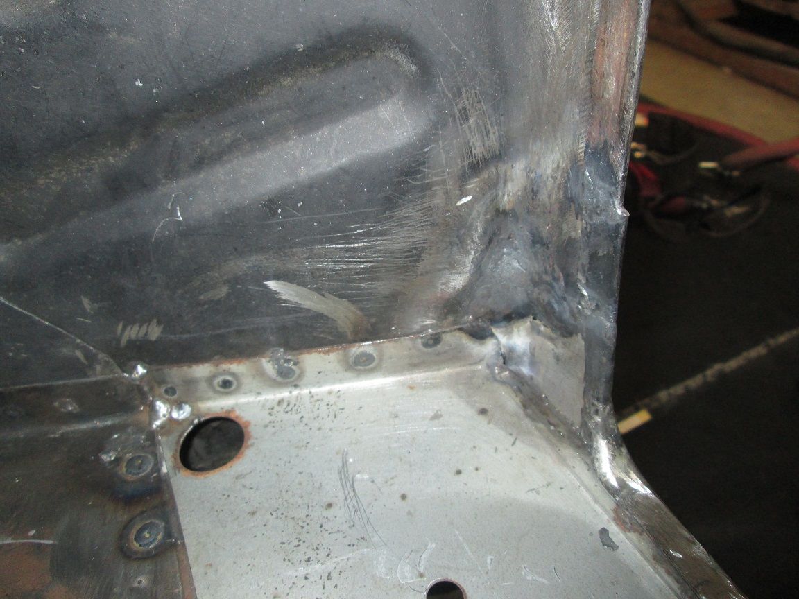

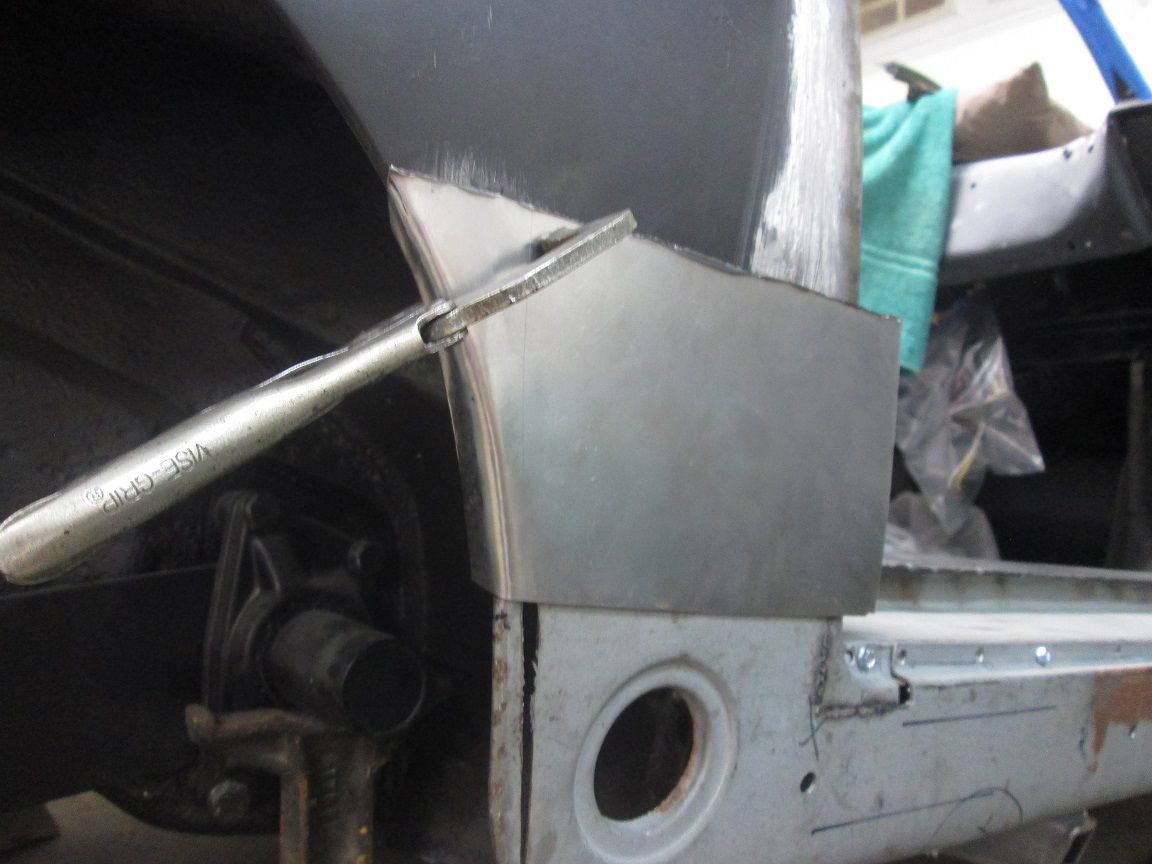

ID:	107743 Corner all stitched in.
ID:	107744 Now onto welding in the new repair section. Tacked with wire leads welded together.

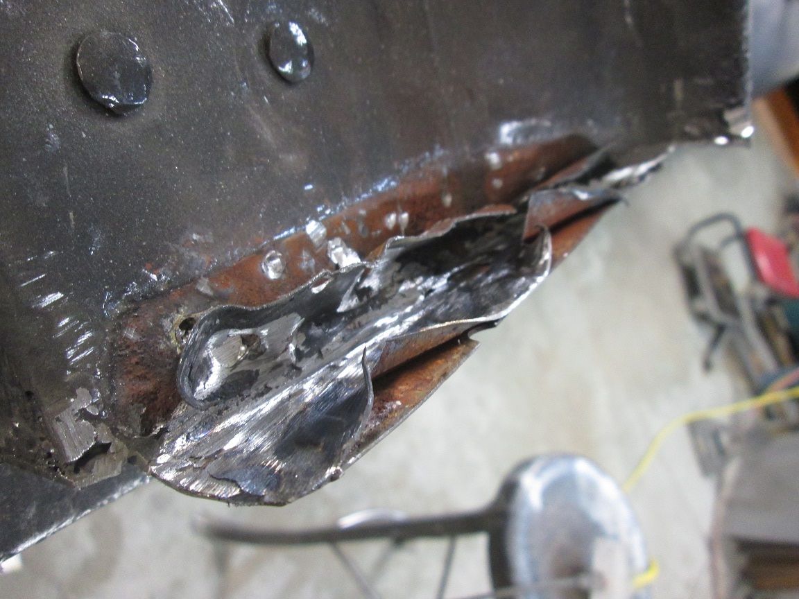

ID:	107745 All stitched in and dressed. More hammer and dolly work before it gets a swatch of solder but only some fine tuning remains.
ID:	107746 hardest part was laying on my back and reaching up in here to finish welding these joints up. Made it through without getting burned and just glad this was all over.

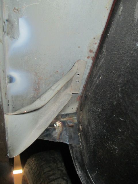

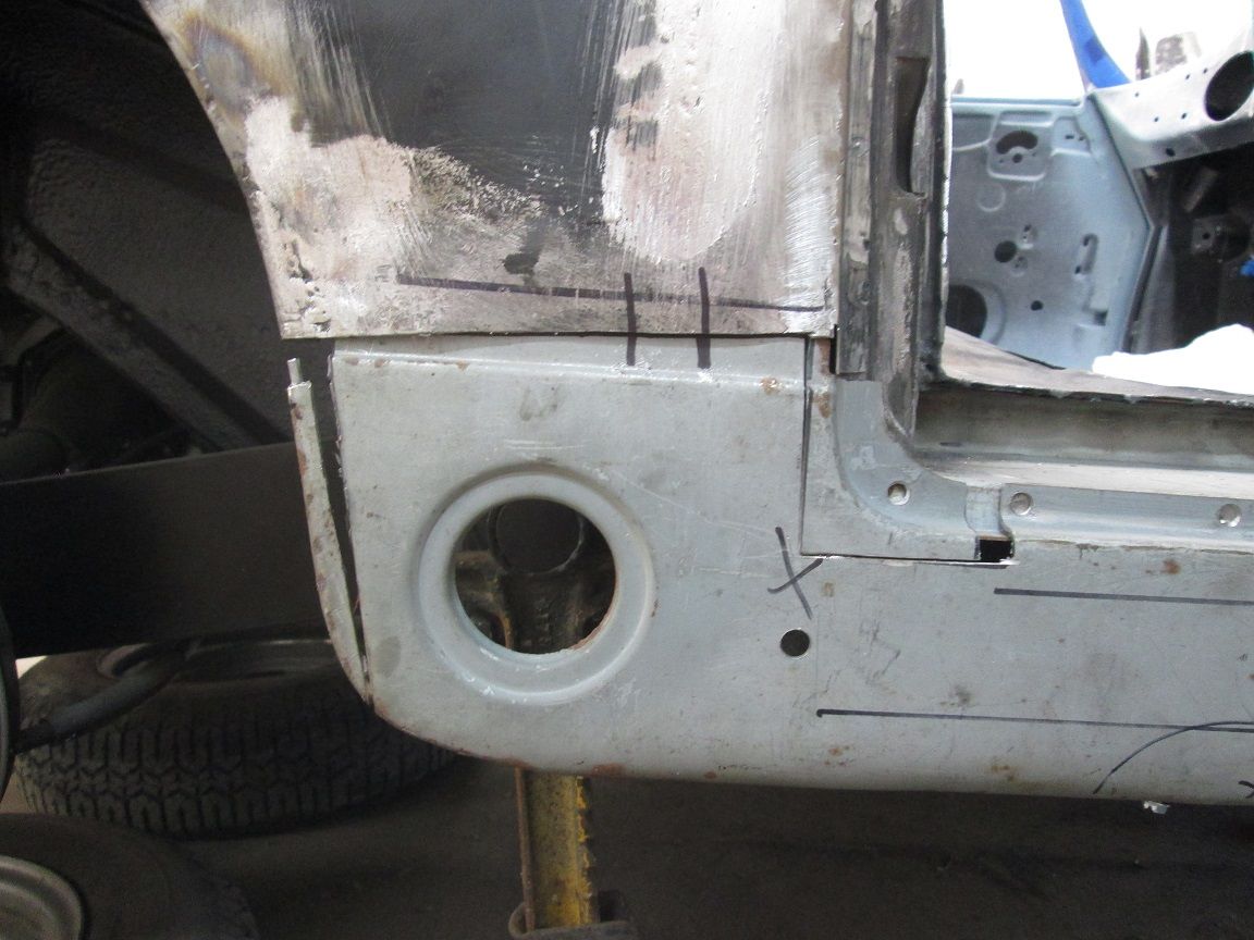

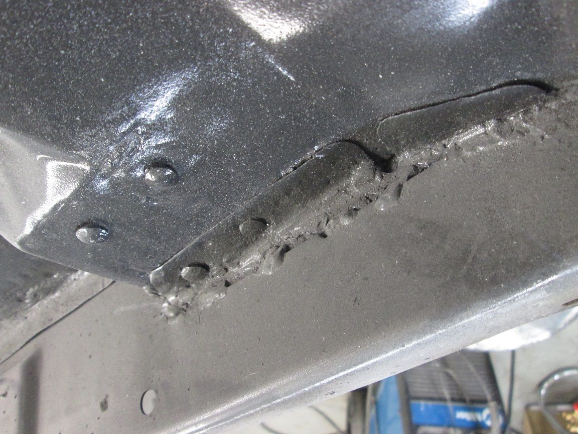

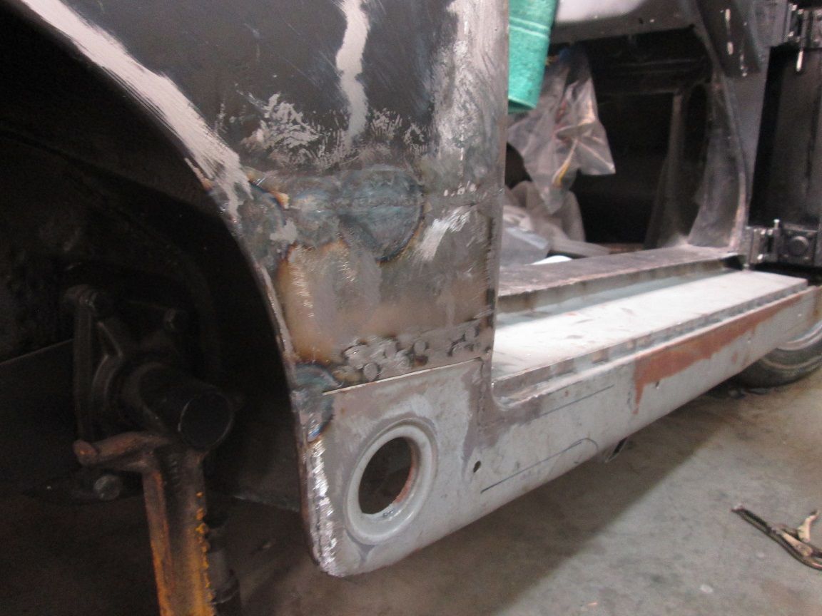

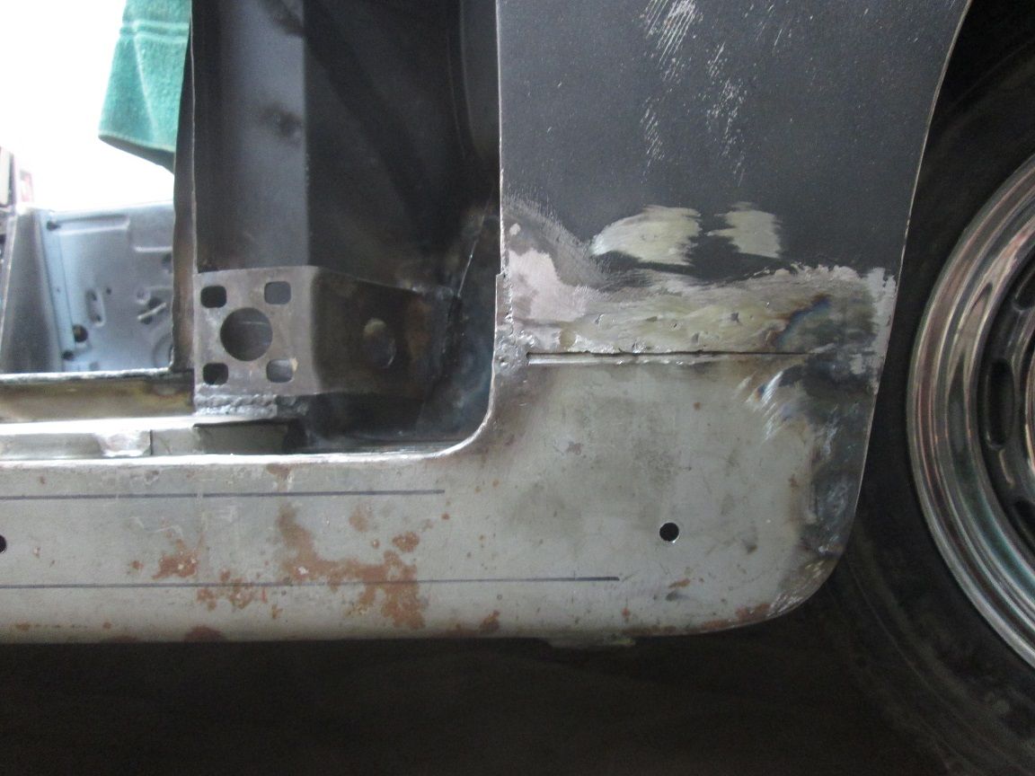

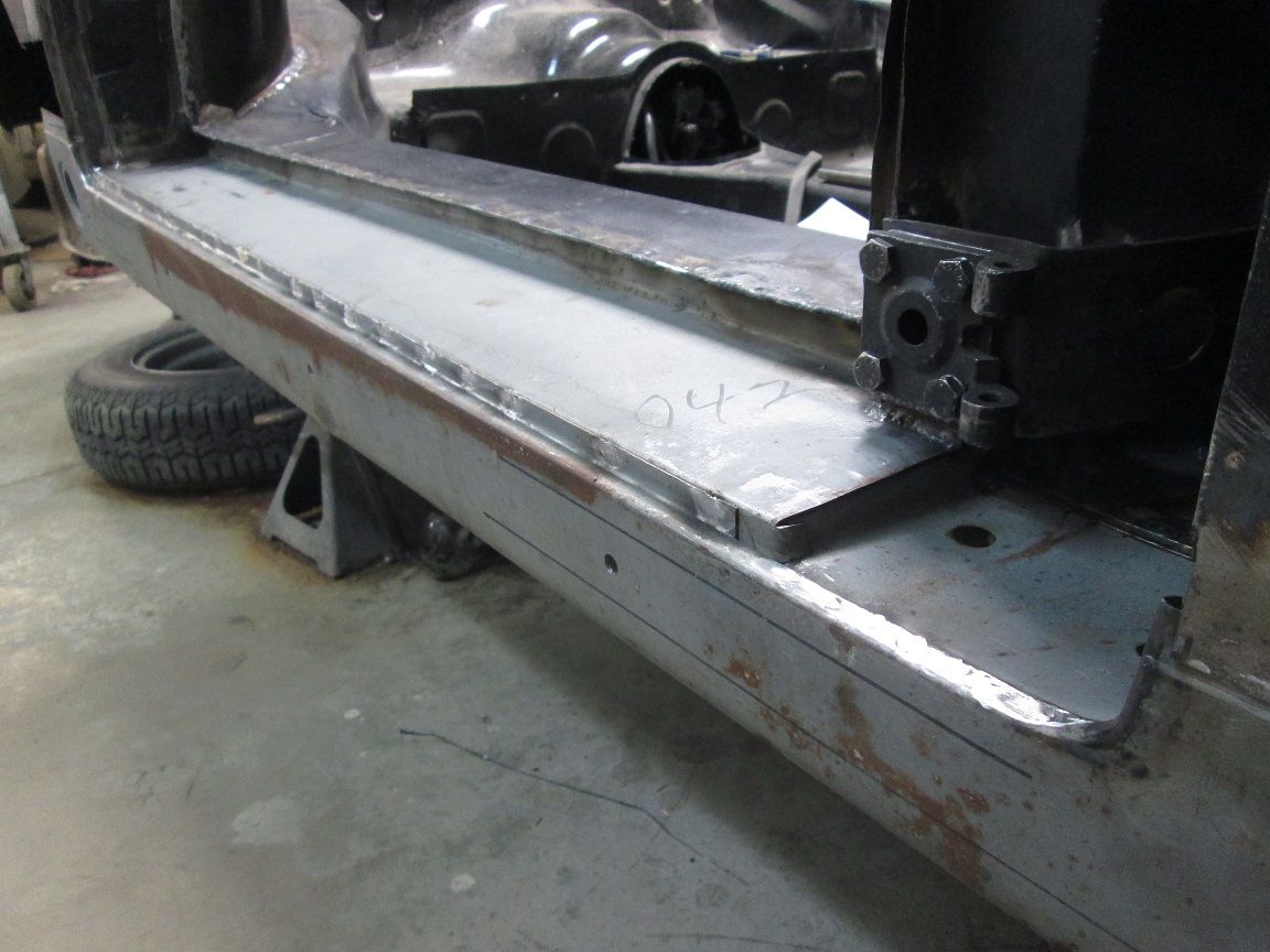

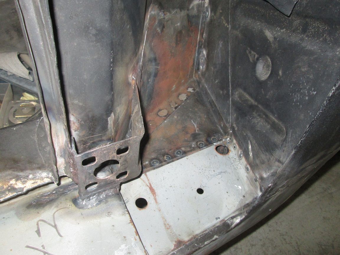

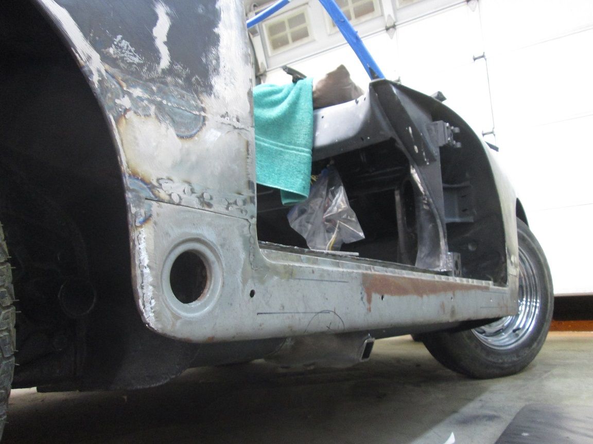

                  • Click image for larger version  Name:	IMG_4678.JPG Views:	0 Size:	112.0 KB ID:	107748
                    Rocker assembly at along last completely installed and set.

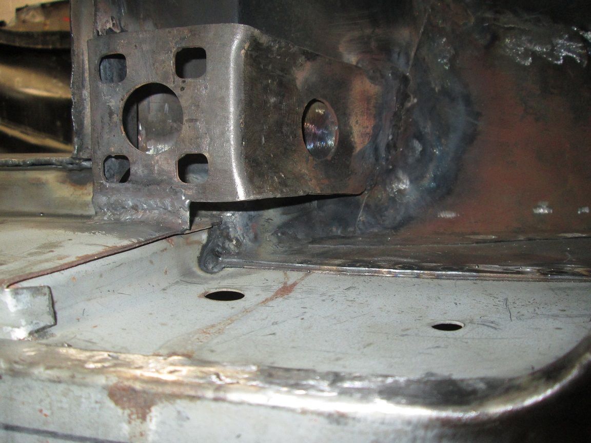

                    Click image for larger version  Name:	IMG_4679.JPG Views:	0 Size:	113.8 KB ID:	107749 A very long and involved road but this finally completes my steelwork correction duties on the right side of this car. As for the door itself that would be yet another chapter.
                    Click image for larger version  Name:	IMG_4681.JPG Views:	0 Size:	41.2 KB ID:	107750
                    The only item I did leave loose is this reinforcement bracket. I'm going to wait until the very end after the entire right side of the car is set just in case there are any last minute slight adjustments that need to be made to the angle of the rocker skin itself.

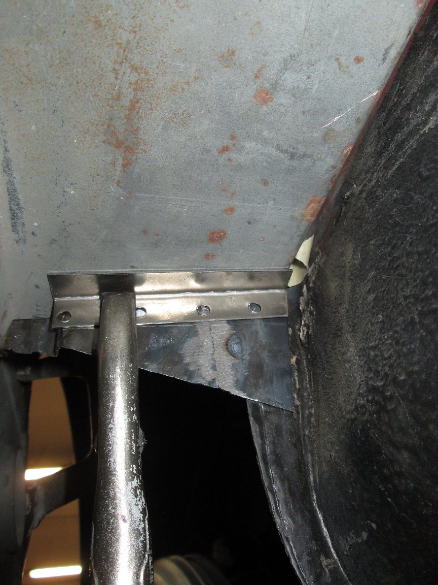

                    Click image for larger version  Name:	IMG_4690.JPG Views:	0 Size:	138.3 KB ID:	107751 Back to fitting the door with its new surroudings now.
                    Click image for larger version  Name:	IMG_4692.JPG Views:	0 Size:	114.8 KB ID:	107752 By sessions end I was having alot of issues with the way this door was rebuilt and skinned. The door bottom is a touch too wide and is encroaching into the skin creating that ridge in the surface. If I would have set the rocker out further to compensate for this then the line off the rear fenders would have been off giving the rocker sort of a stepped ground effect look. The rear fender is original so it was the baseline. Everything else on this side was the previous shops work so it was secondary. Now that all is finished and set the door needs some serious message.
                    That next...Thanks for looking!

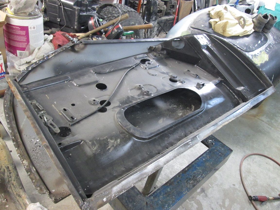

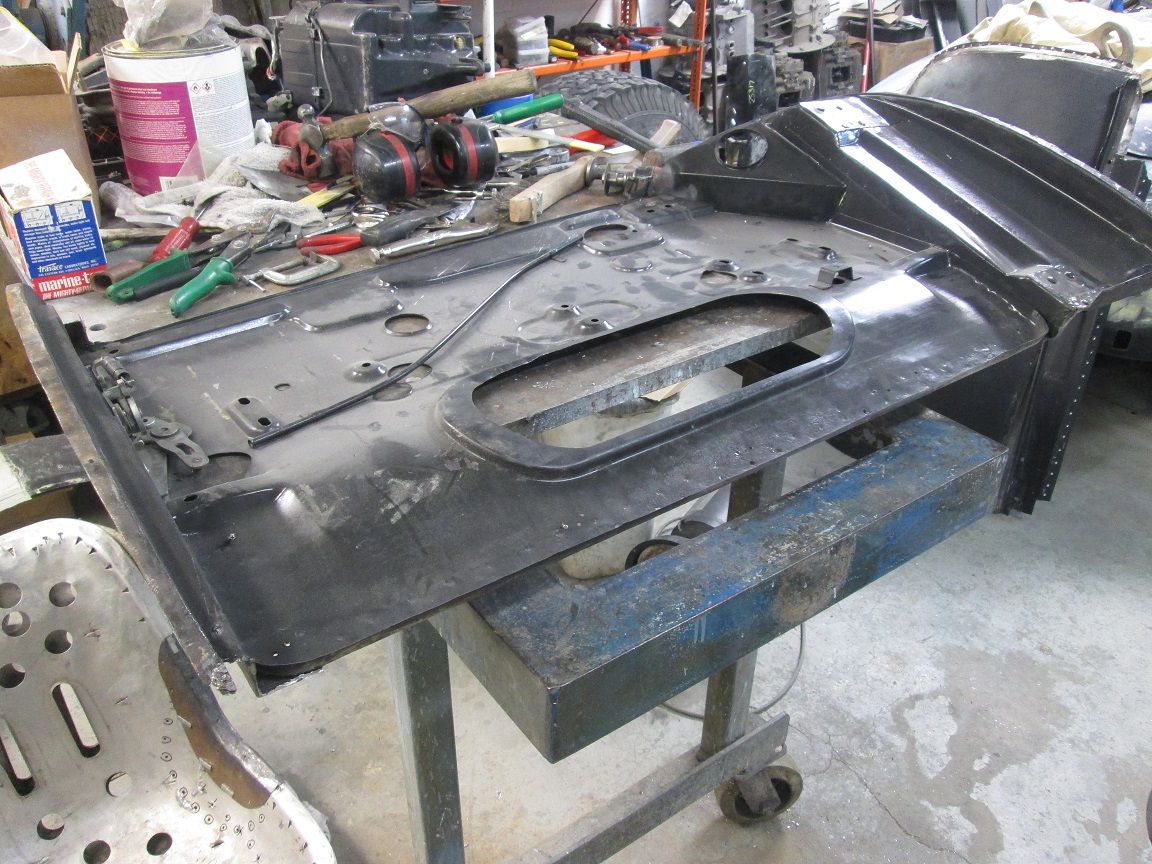

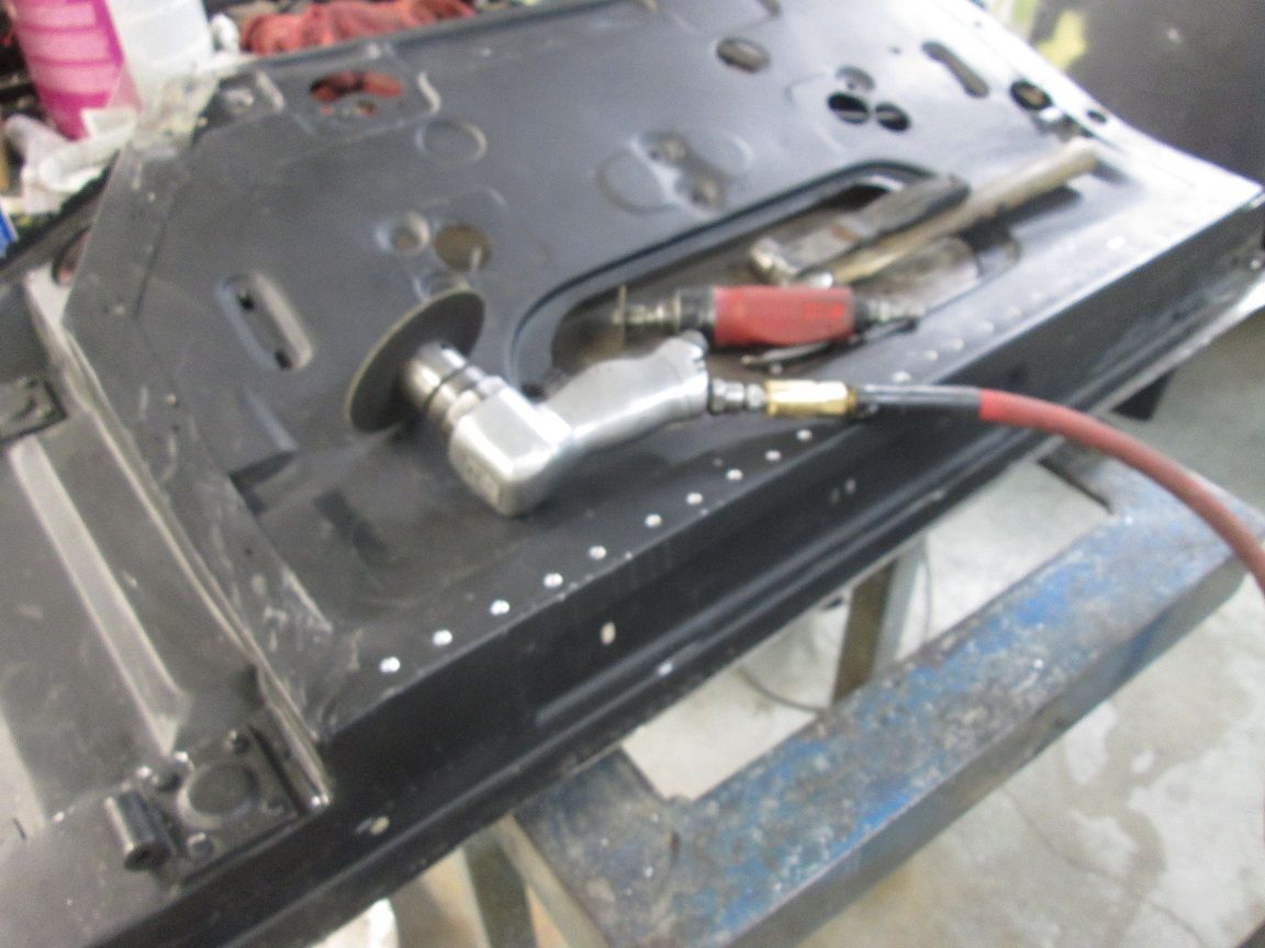

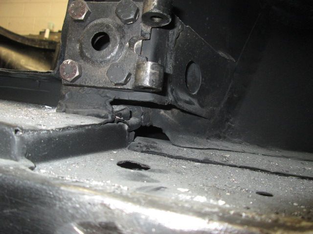

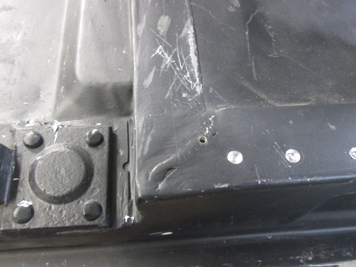

                    • Right door shell deconstruction.
                      Rather than continued relief cuts and other small changes around the edges of this door to get it to fit. It was decided that the end result would be much cleaner if it was just cut back apart and rebuilt again.
                      Click image for larger version  Name:	IMG_4696.JPG Views:	0 Size:	156.3 KB ID:	107798 Began by melting away the solder on the leading edge.
                      Click image for larger version  Name:	IMG_4695.JPG Views:	0 Size:	140.5 KB ID:	107799 I was surprised by just how much solder it had.
                      Click image for larger version  Name:	IMG_4698.JPG Views:	0 Size:	153.6 KB ID:	107800 I remounted the door to highlight just how much was there. Quite a shortcoming to backfill to create any sort of reasonable gap.
                      Click image for larger version  Name:	IMG_4701.JPG Views:	0 Size:	104.6 KB ID:	107801 Just shy of a half inch of solder needed to create a 3mm gap. This new skin left a lot to be desired between this shortfall and the bottom flange that was put in on a downward angle. Not the fault of the previous shop that put this door together but it at the same time these issues were not addressed by them either. All of this will be corrected before it goes back together.
                      Click image for larger version  Name:	IMG_4703.JPG Views:	0 Size:	115.3 KB ID:	107802 Backside not so bad.

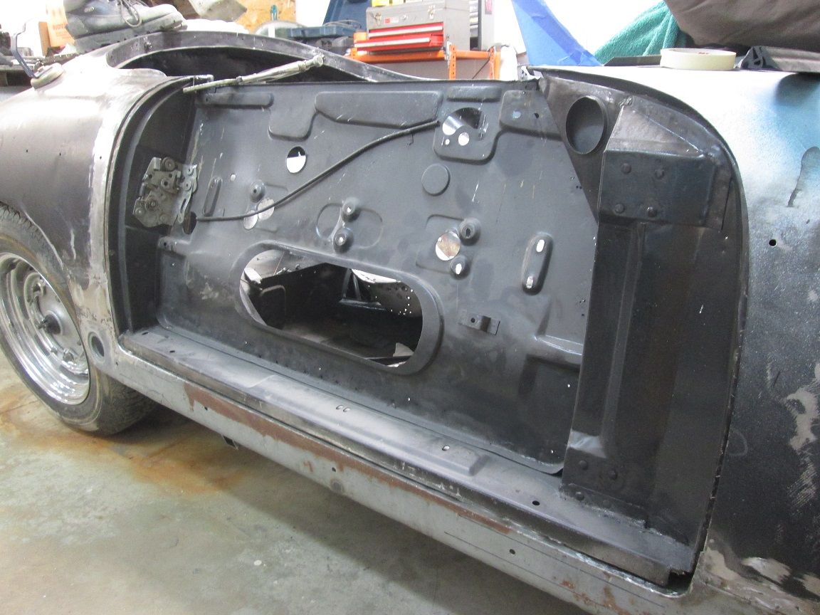

ID:	107804 Door skin free and removing the new frame bottom next.

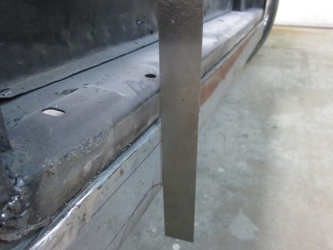

ID:	107805 Frame mounted to the car just for more basline confirmation before I removed the bottom.
ID:	107806 Here's that shoulder that was portruding into the skin creating that ridge in it.
ID:	107807 by contrast for the forward section of it seems to be a touch to far in.

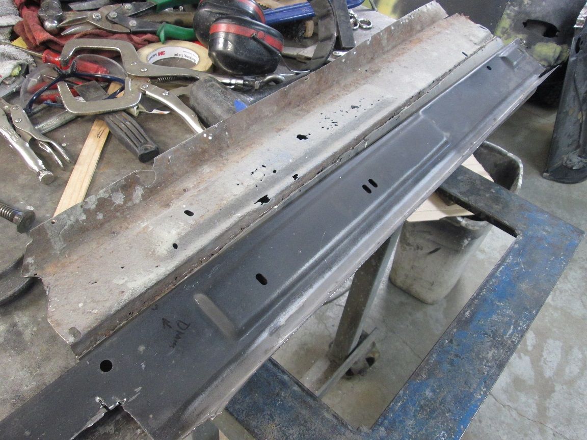

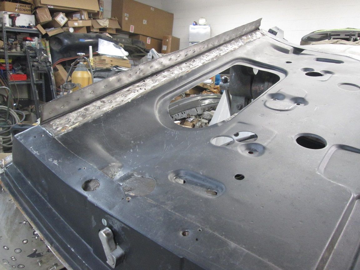

                        • Door frame prep: replacement bottom removal.

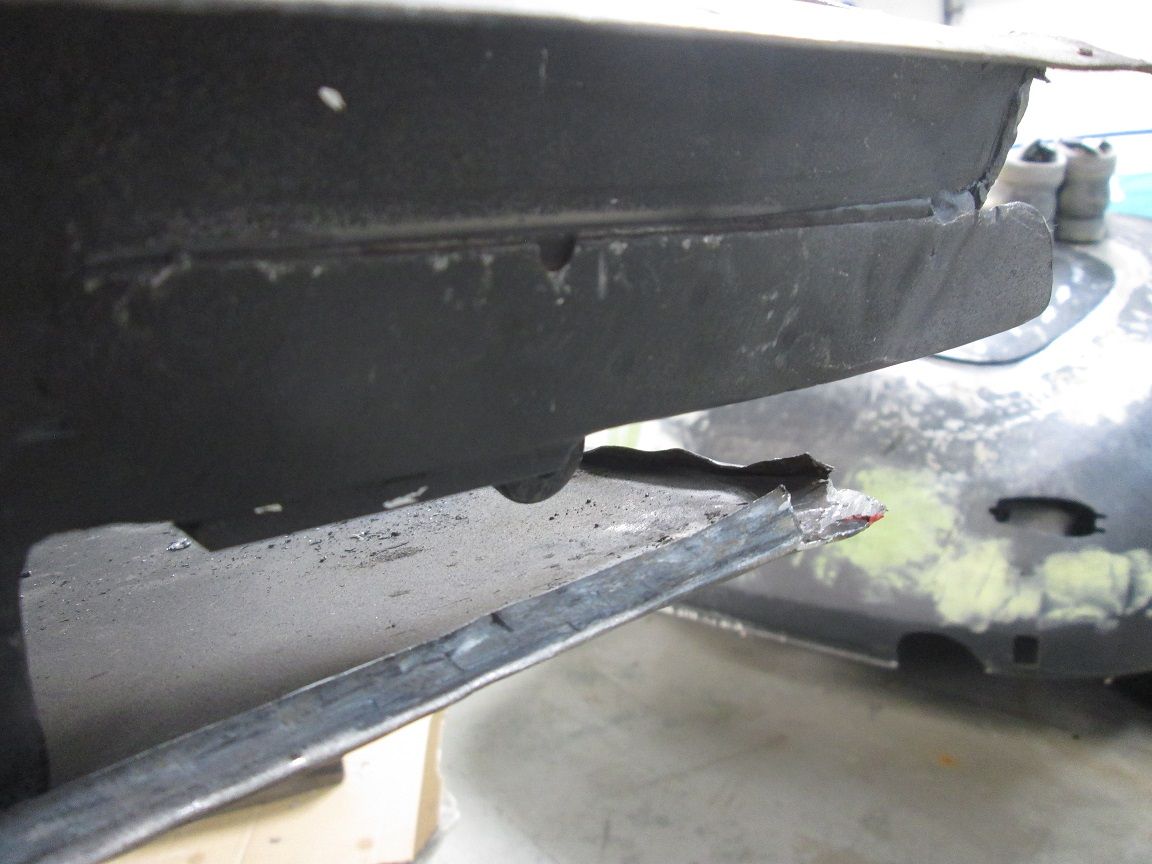

ID:	107809 Installation of this replacement bottom was quick and dirty.
ID:	107810 Double walled on the under side of this mess. Remnants of the original door bottom can be seen here. All will be cleaned and corrected before its over.
ID:	107811 Drilling spots welds and getting ready to remove this panel.
ID:	107812 Should be a clean lap joint here but they stopped just at the edge and just stitched it together. The remains of the original run under that vertical flange. I'll clean this up while I'm at it as well.
ID:	107813 Bottom removed. A lot of peripheral repairs also yet to do on this frame but I'm about done cutting things off.

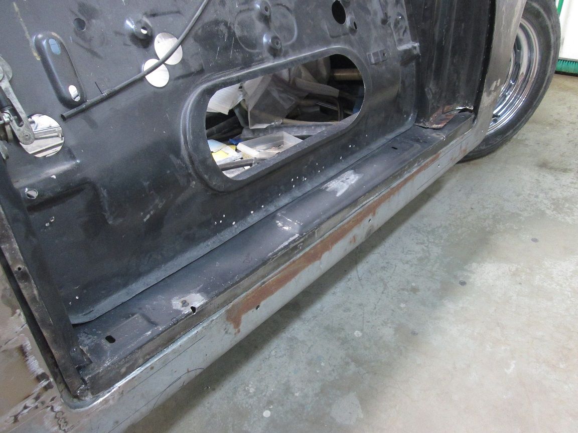

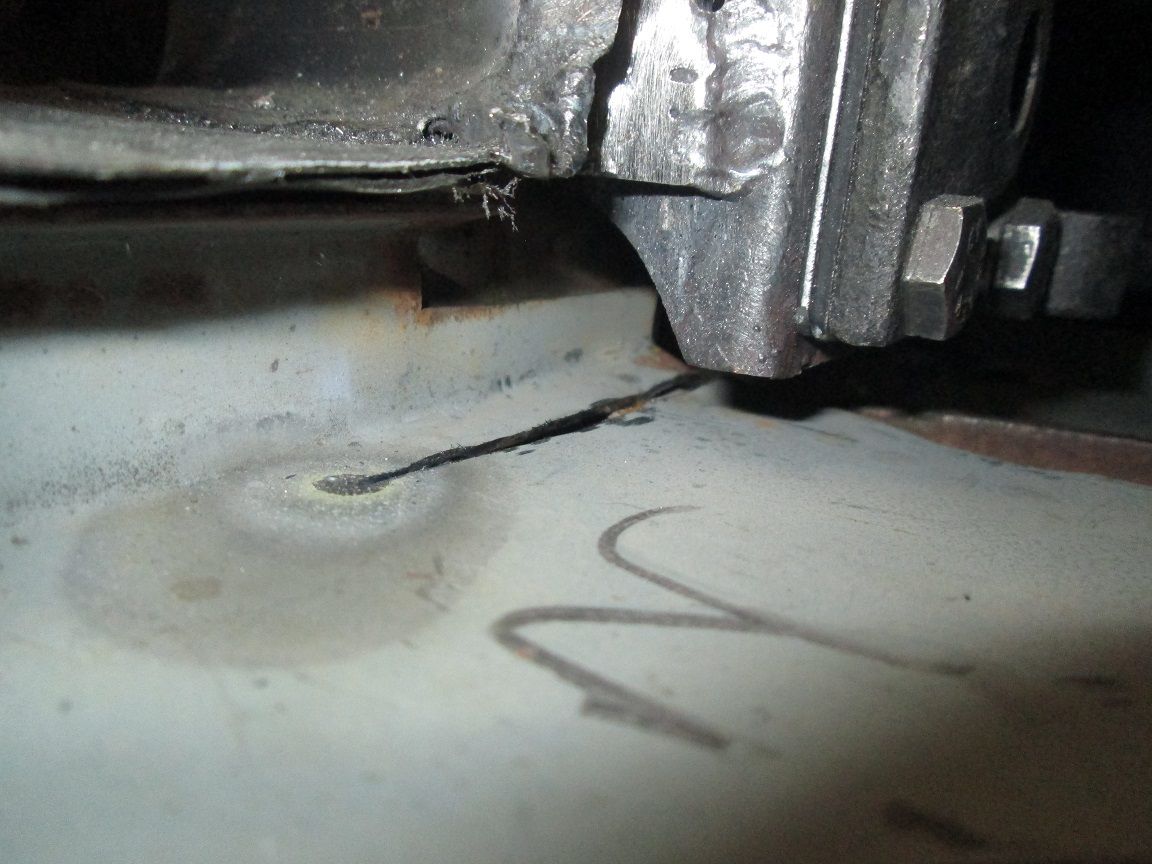

                          • Right door bottom prep:

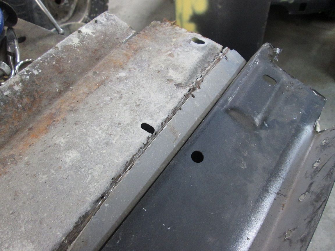

ID:	107818 Removing the remains of the old bottom that was left behind.
ID:	107819 Once I get the rust cleaned off this area will be ready to accept a new floor section.

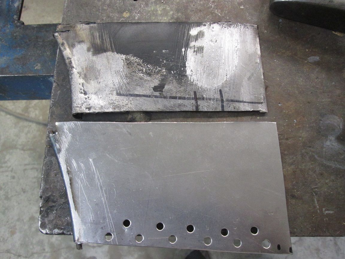

ID:	107820 New floor section template complete and now going onto metal.
ID:	107821 New section all set. Now onto getting the rest of the door bottom ready to go.
ID:	107822 Cleaning up some lines and details with it next.
ID:	107824 Original '59 door bottom drains bean shaped not round.
ID:	107825 They're both almost in the right spot but not quite.
ID:	107826 Correct drain added and will backfill what it came with.
ID:	107827 Frame remounted and latched to position the bottoms leading just shy of the edge of the rocker so it won't crowd into the door skin like before.
ID:	107828 Rebending the inner flange to accomidate this adjustment.

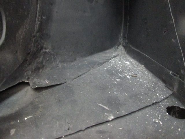

                              • more lower door frame prep:

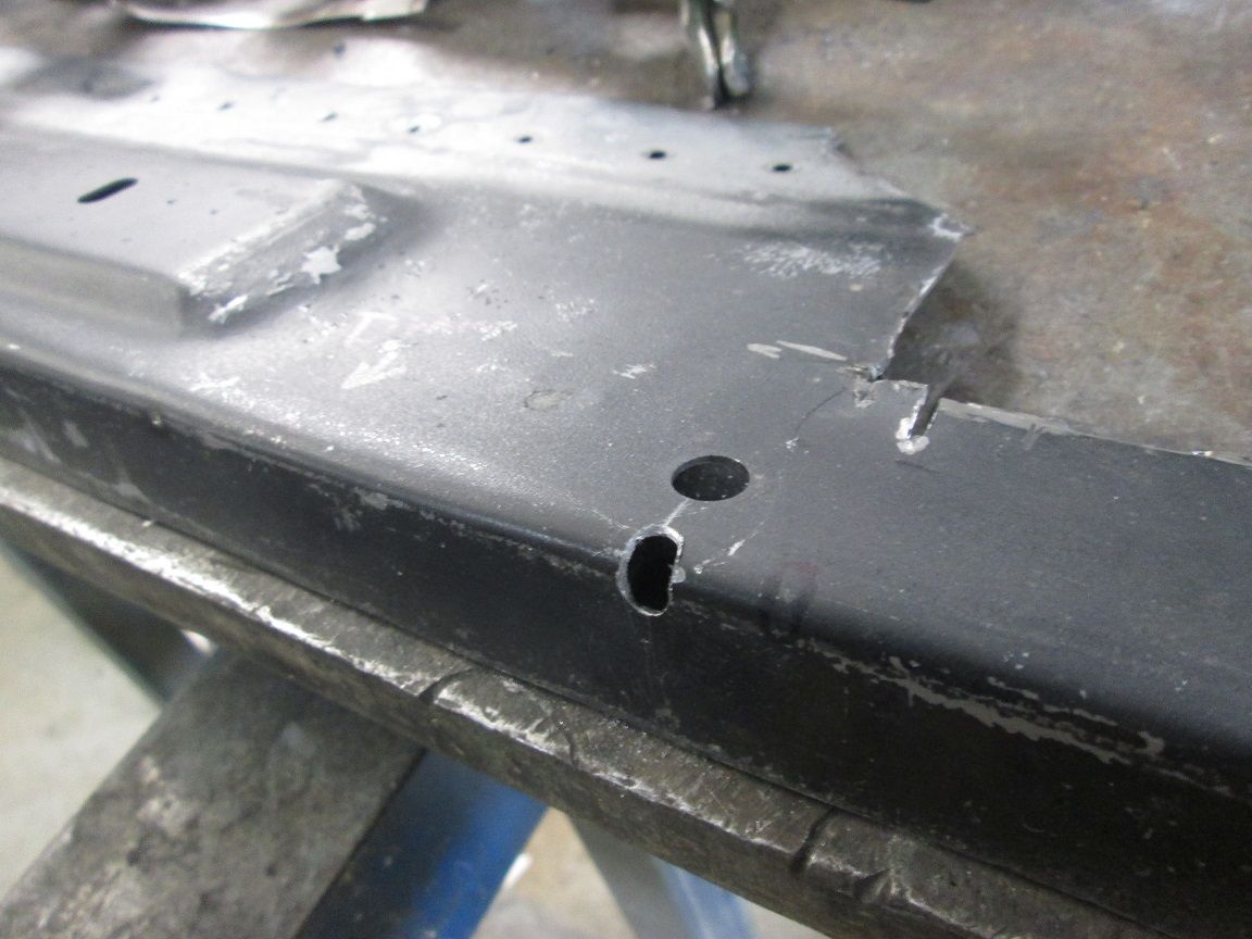

ID:	107833 Have some holes to backfill as part of the removal process.
ID:	107834 Also cutting away the vertical flanges to expose the remains of the old floor to recreate a full piece and a clean lap joint once its finished.

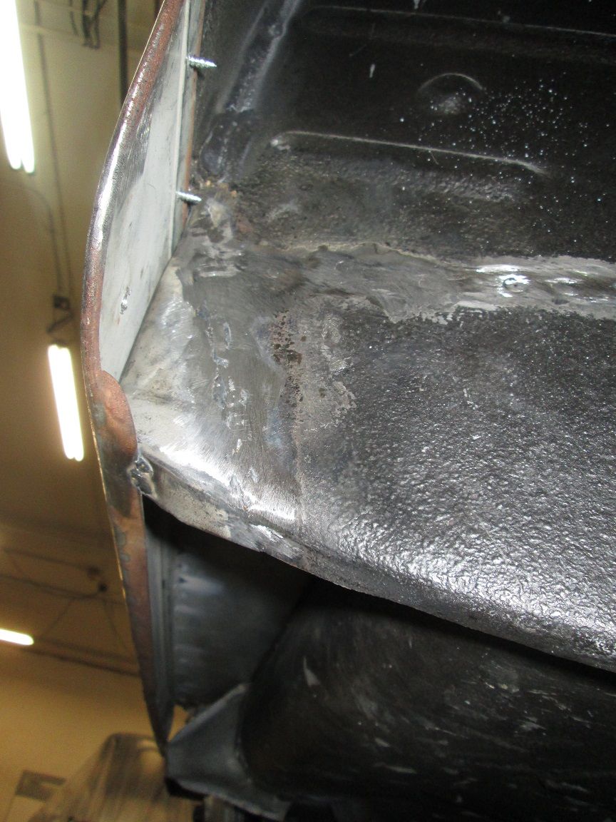

ID:	107835 Same treatment at the back . Taking care of that old rust left behind down in this pinch seam.

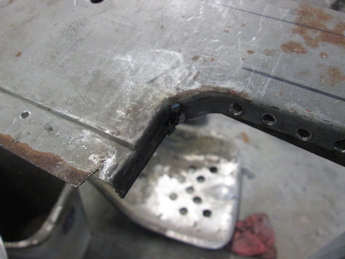

ID:	107836 Peeling it back down to the base wall.
                                Bottom corner with flanges rebuilt with a full length inner flange that's now ready for the final vertical flange lap joint detail.
