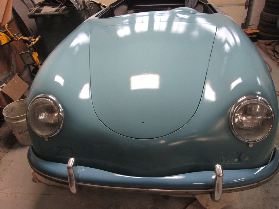

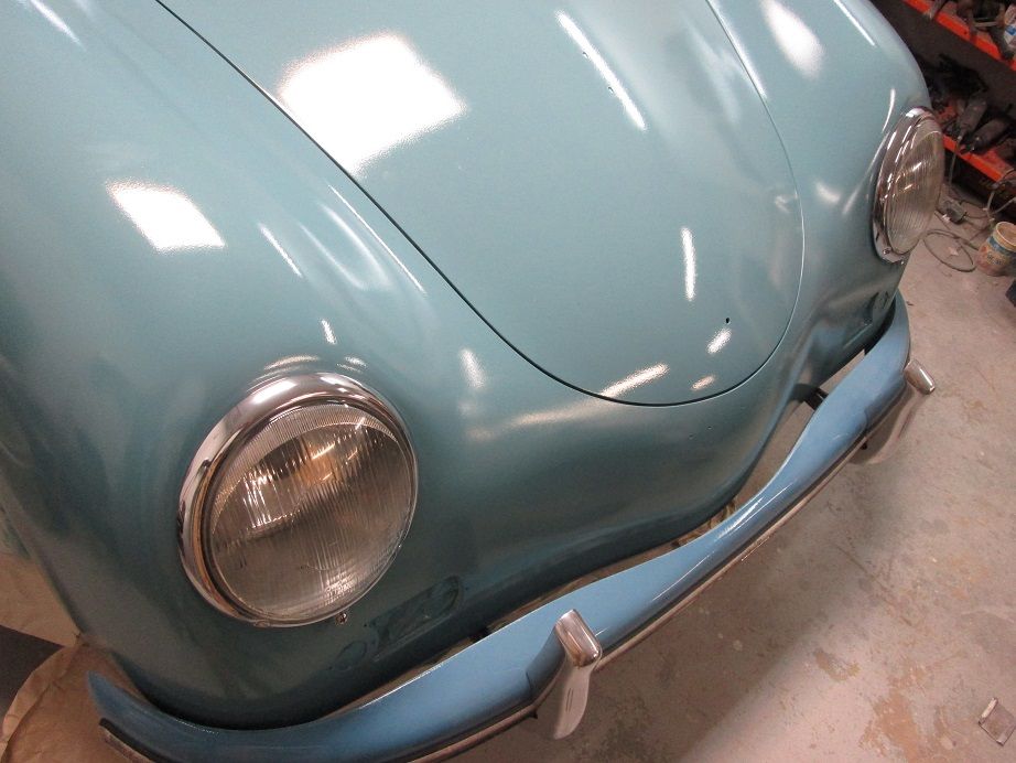

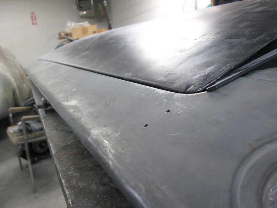

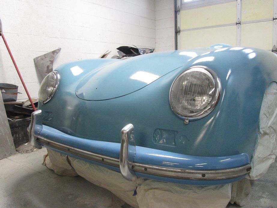

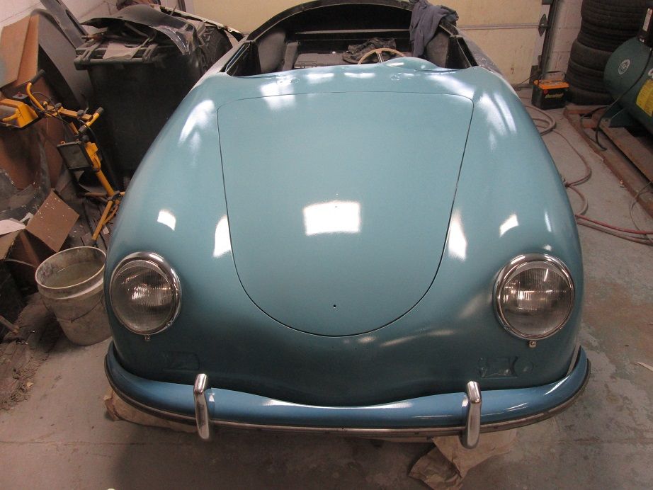

    A few mock up shots before I moved onto the left door and rocker.
    A few aspects of this project "ready for final paint".
    Onto the left door and rocker issues next.

      That is at least a 99% effort. looks gorgeous Justin.
        Thanks Phil!
    • #93
      Justin to me it looks perfection. You should feel very proud indeed of your work! I have learnt a lot with your slicing and bending everything to reduce filler to the minimum and not stopping till you get it perfect.
      Well done indeed.
        Thank you Roy! Not perfect but its at a level that I can leave well enough alone allowing me to move onto the next deal.

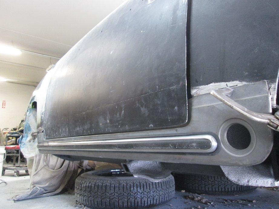

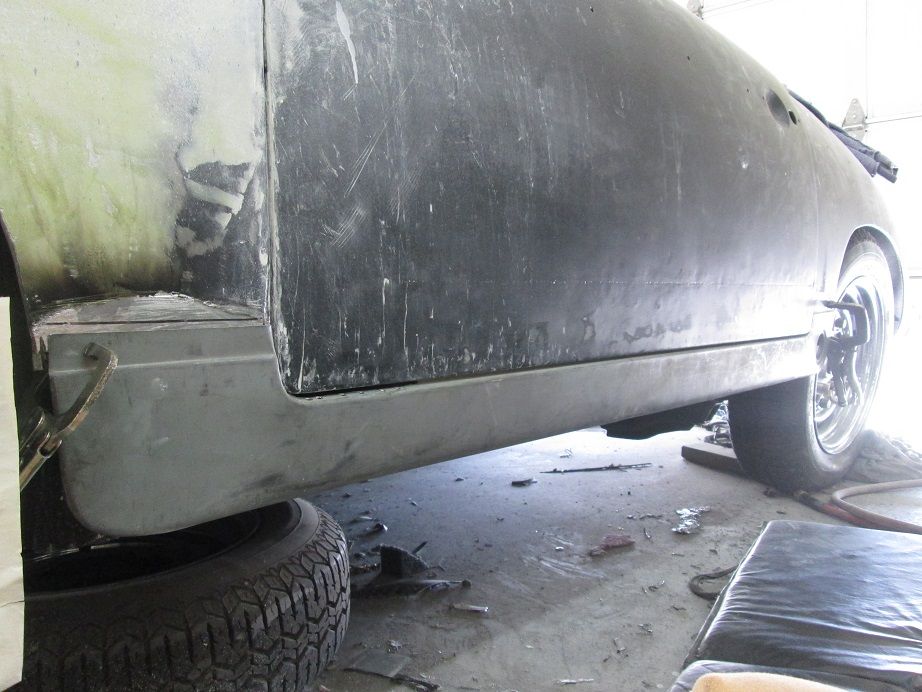

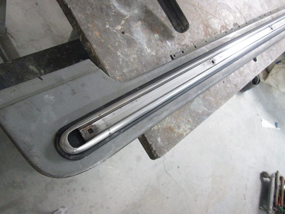

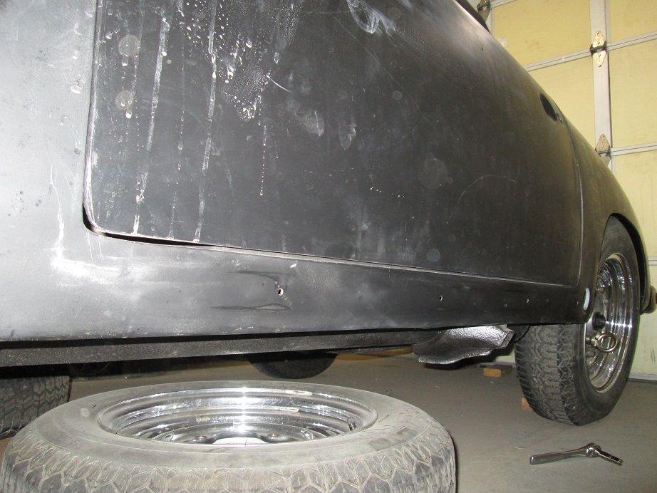

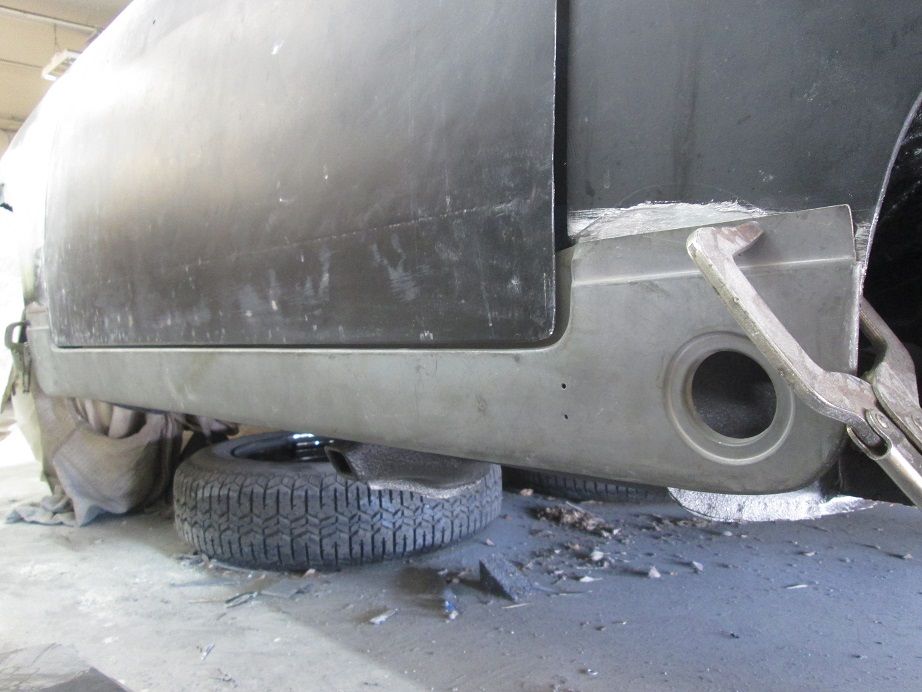

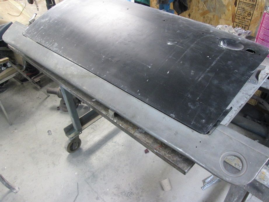

      Initial left rocker issues:

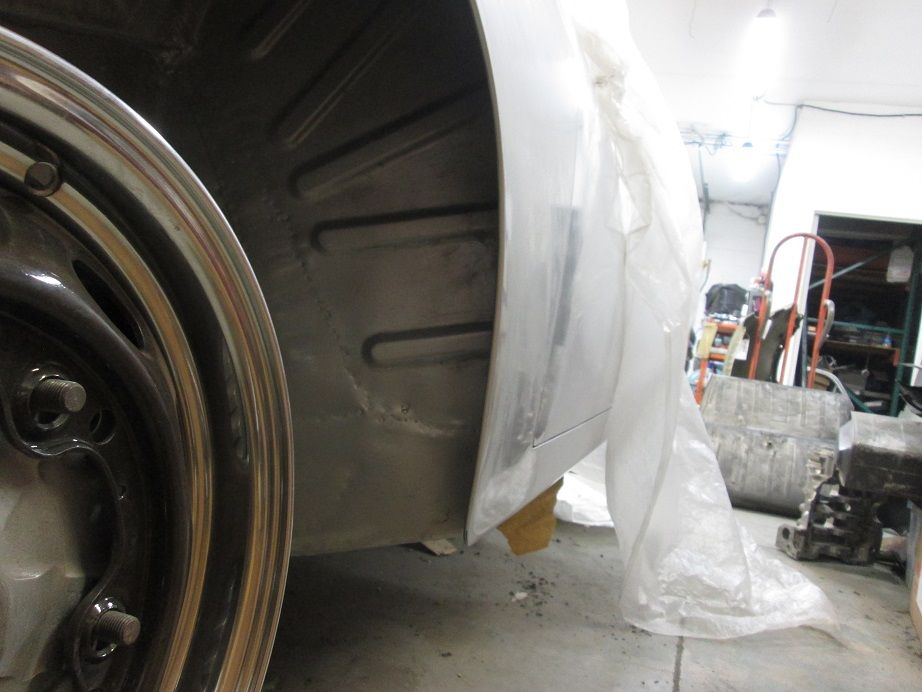

      Once I turned my attention to this area and got down eye level to it all sorts of issues began to jump out. (flat black primer hides a lot). This corner was particularly rough with a swooped up profile leading up to a squared off corner shape. A gap was present but not exactly a presentable contour shape.

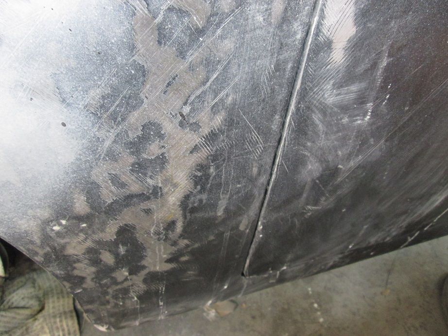

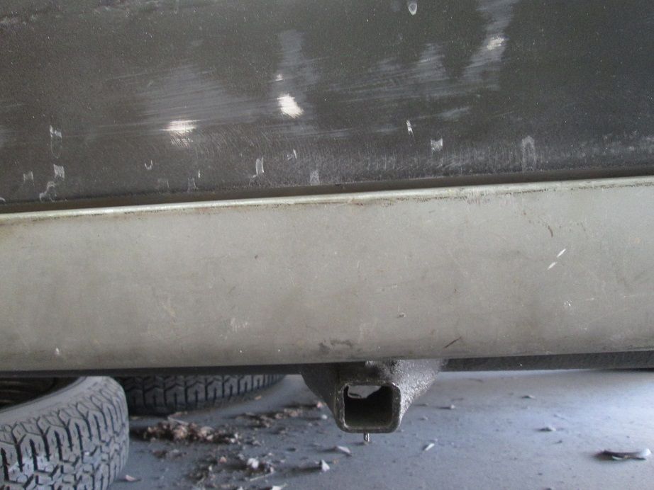

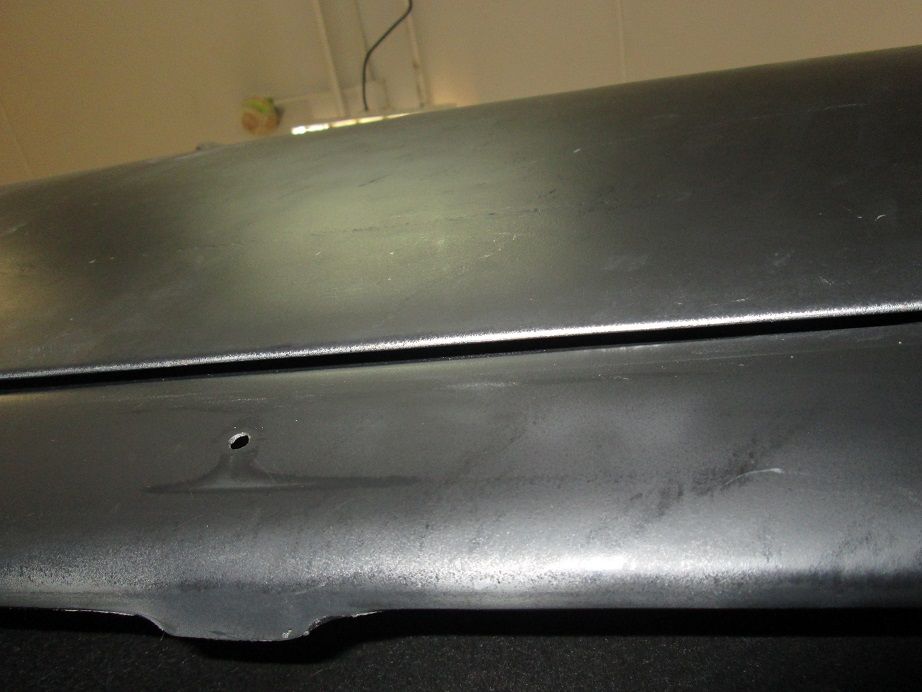

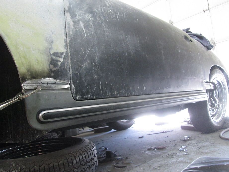

      Lower gap generally ran a little wide.

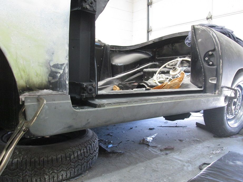

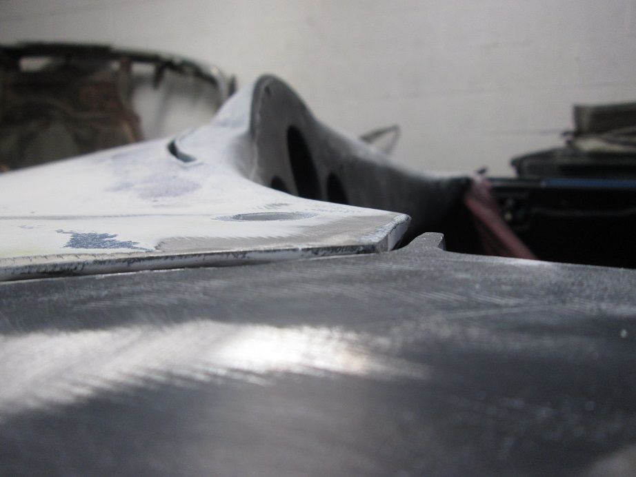

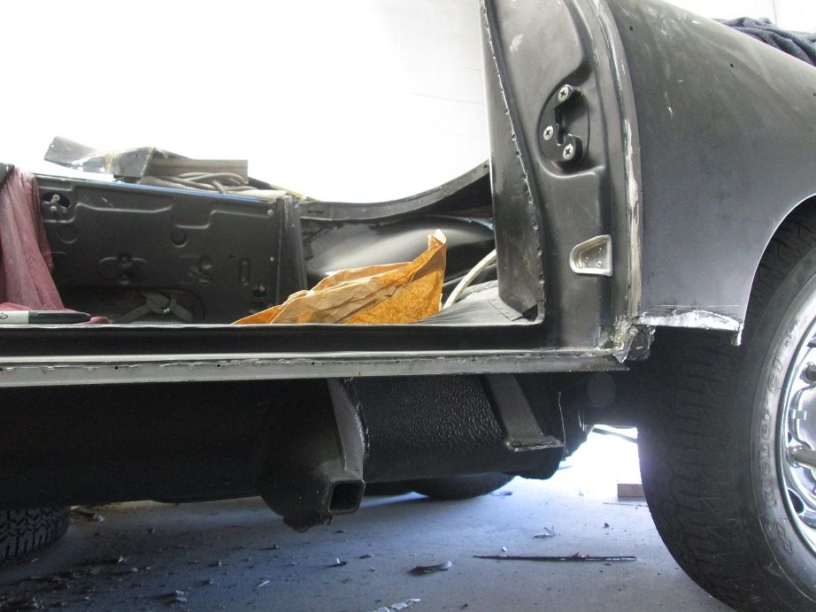

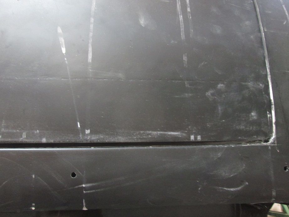

      But a major issue was that the bottom of the door overshoots the edge of the rocker. This is a tough one to deal with after the fact as it will require either relief cutting of the door or the rocker to bring them to level. The only other options would be to back fill it level Or just leave it and hope no one notices it since its on the bottom. The last two options where of course not a consideration so I just had to decide which side I was going to be cutting on. The drain relief is also wrong for an A car so it needed to be addressed as well.
      Another issue that my buddy noticed was that the bend profile along the inner edge was too soft and actually crowded out the eventual threshold hold strip. Don't who manufactured these rockers but this too would also have to be corrected. More later...

        Oh boy. Had same profile issue with foam car. I relief cut the rockers.
          Yeah, its one of those deals that really comes back to bite you if the door is not fully set and adjusted before the rocker goes on for good.

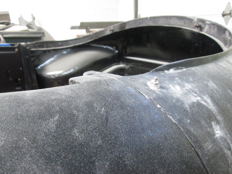

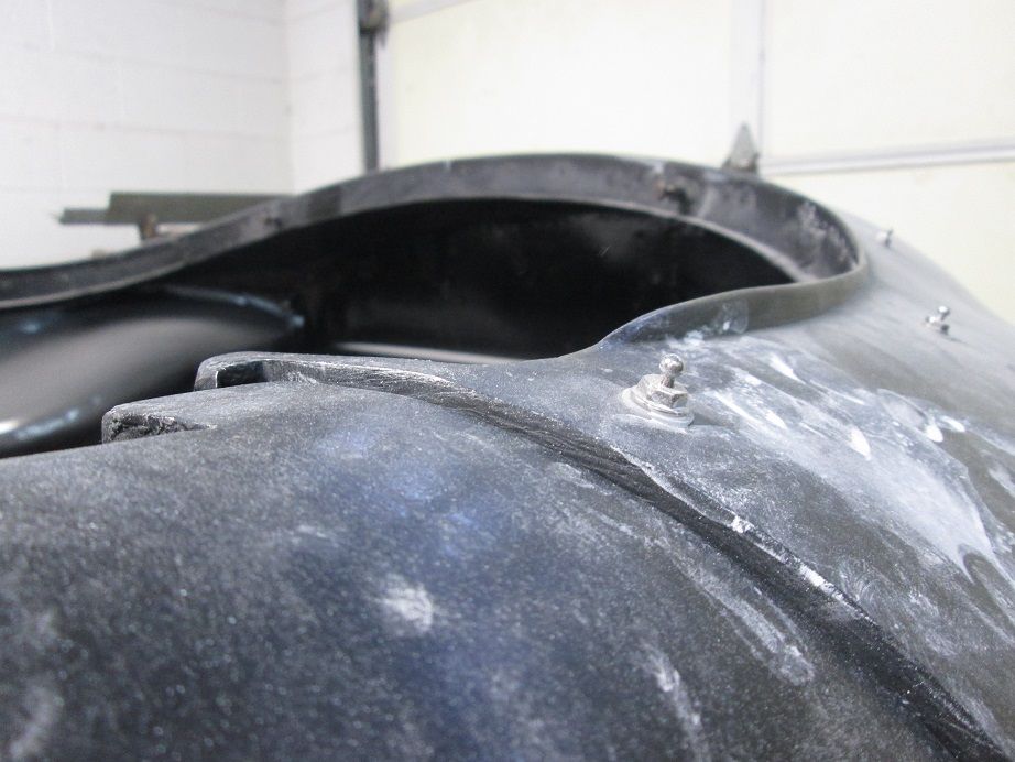

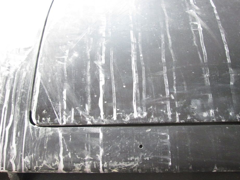

        Began working through the first few of many issues yet to come.
        Click image for larger version  Name:	IMG_1337.JPG Views:	0 Size:	66.8 KB ID:	106120
        Etched in a much softer turn.
        Click image for larger version  Name:	IMG_1338.JPG Views:	0 Size:	87.4 KB ID:	106121
        Ground through the rocker before I had the shape I was after.
        Click image for larger version  Name:	IMG_1349.JPG Views:	0 Size:	86.3 KB ID:	106122
        Also noticed that threshold edge itself was left just shy of a quarter inch too long.
        Click image for larger version  Name:	IMG_1351.JPG Views:	0 Size:	106.5 KB ID:	106123
        Zipping it back even with the vertical runs as it should be. The shop that performed these repairs sure had nice spot welder! Those are closest I've seen to the real thing. Must be that 30K spotter that Bruce has mentioned.

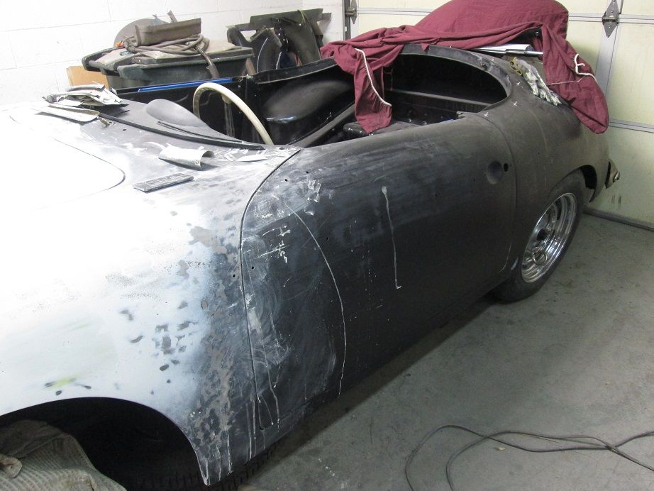

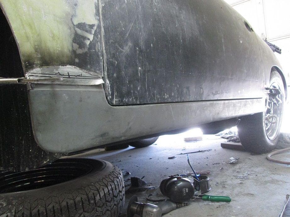

        Left the threshold area for now and went back to the fender to door transition.

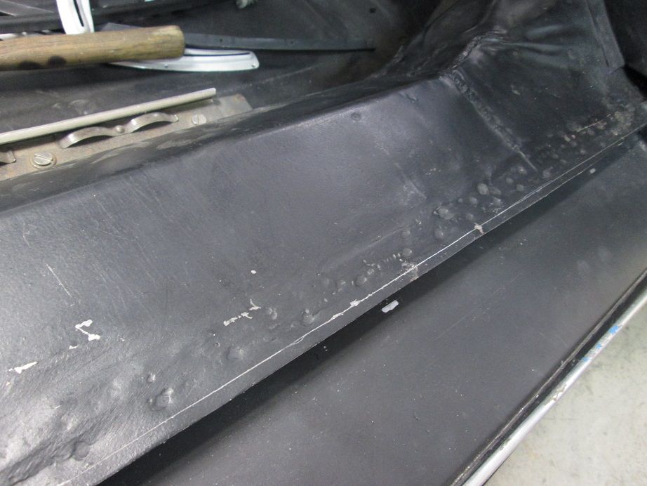

          As this progressed I took notice of this excessive rolled and rolled under profile both the upper run of the fender and this rocker had. More of a Pre-A feel rather than a flatter A profile.
          Click image for larger version  Name:	IMG_2153.JPG Views:	0 Size:	76.5 KB ID:	106128

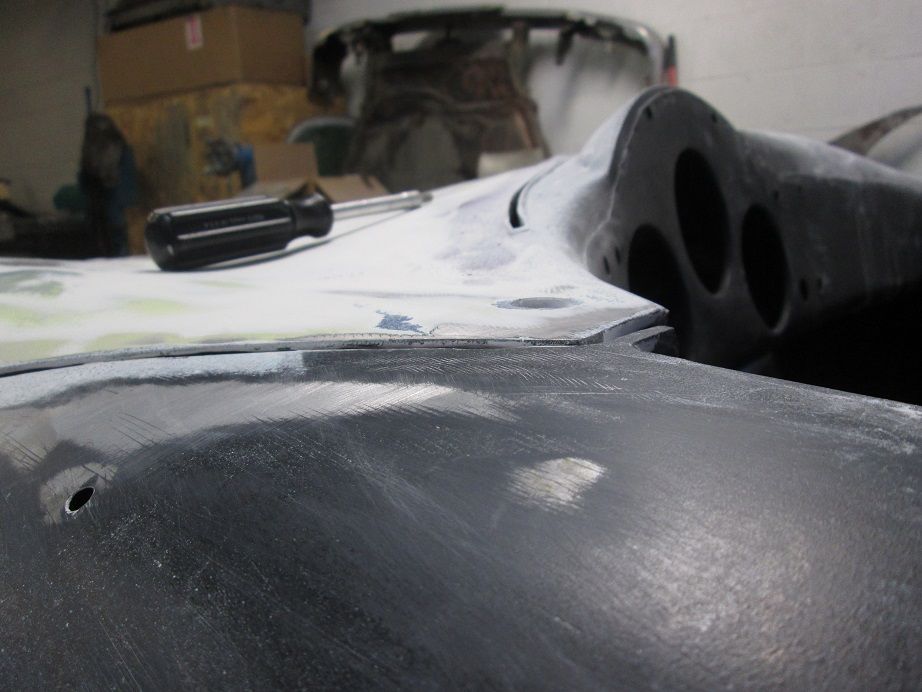

            • #99
              Click image for larger version  Name:	IMG_2199.JPG Views:	0 Size:	65.1 KB ID:	106137
              Of course we completely lost the bottom gap in the process.
              Click image for larger version  Name:	IMG_2200.JPG Views:	0 Size:	96.3 KB ID:	106138

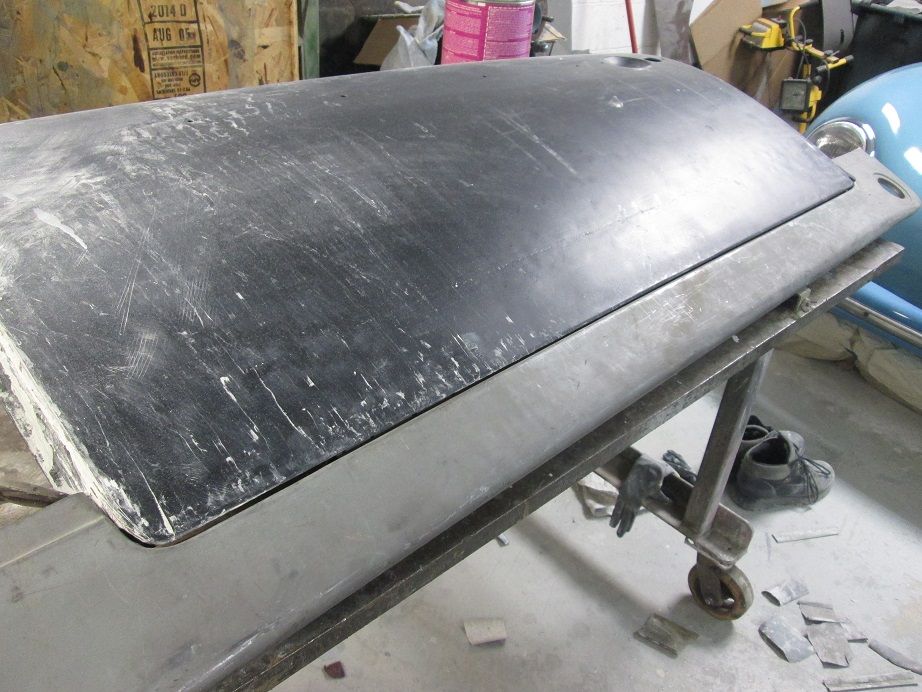

              • After some debate whether to relief cut the bottom of the door to fit the current rocker or remove the rocker entirely I finally settled on the latter. Too many issues with it and its installation to justify keeping it in place.
                Click image for larger version  Name:	IMG_2337.JPG Views:	0 Size:	109.3 KB ID:	106149
                No sense in disturbing the threshold portion so it would just be the outer skin. New (OLD) rocker assembly separated from its threshold here.
                Click image for larger version  Name:	IMG_2339.JPG Views:	0 Size:	114.1 KB ID:	106150
                A quick mock up against the door just to make sure gap and general contour where going to be achievable without cutting into the door or even this new skin.
                Click image for larger version  Name:	IMG_2341.JPG Views:	0 Size:	72.1 KB ID:	106151
                They'll go nicely together.

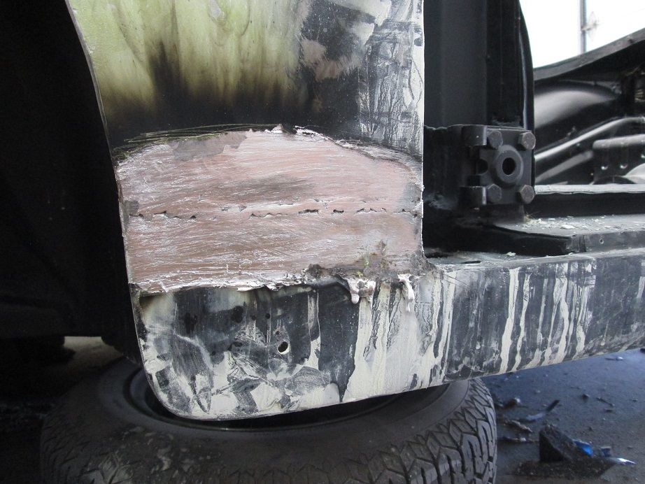

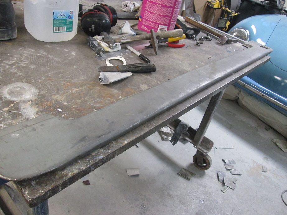

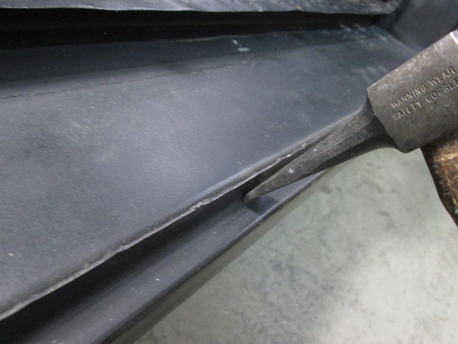

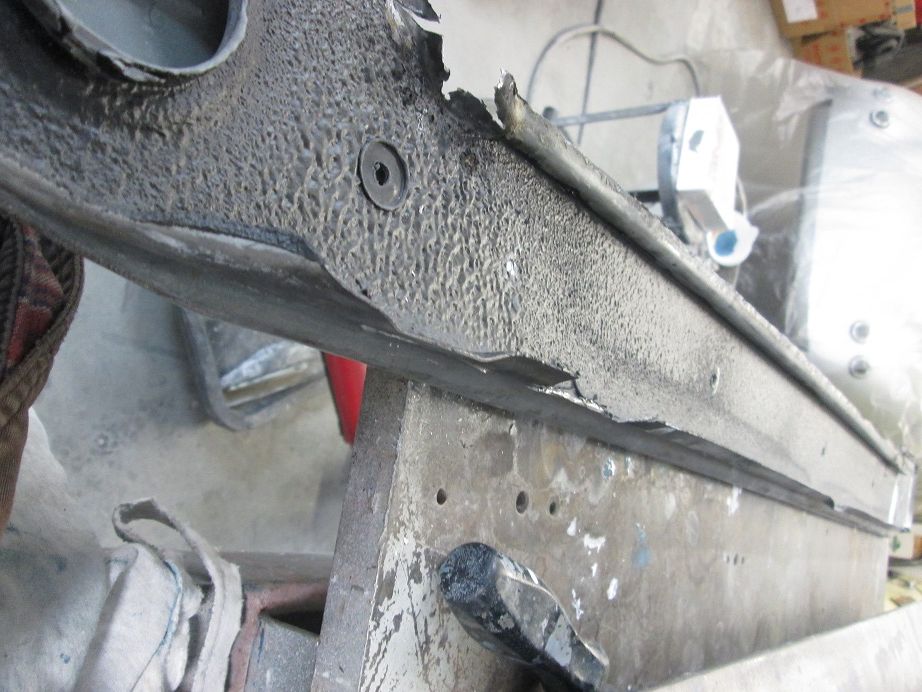

                Begin left rocker skin removal. Melting away the solder to get at the joint and to see what's going on under it all.
                  Pretty much the same thing going on up front.

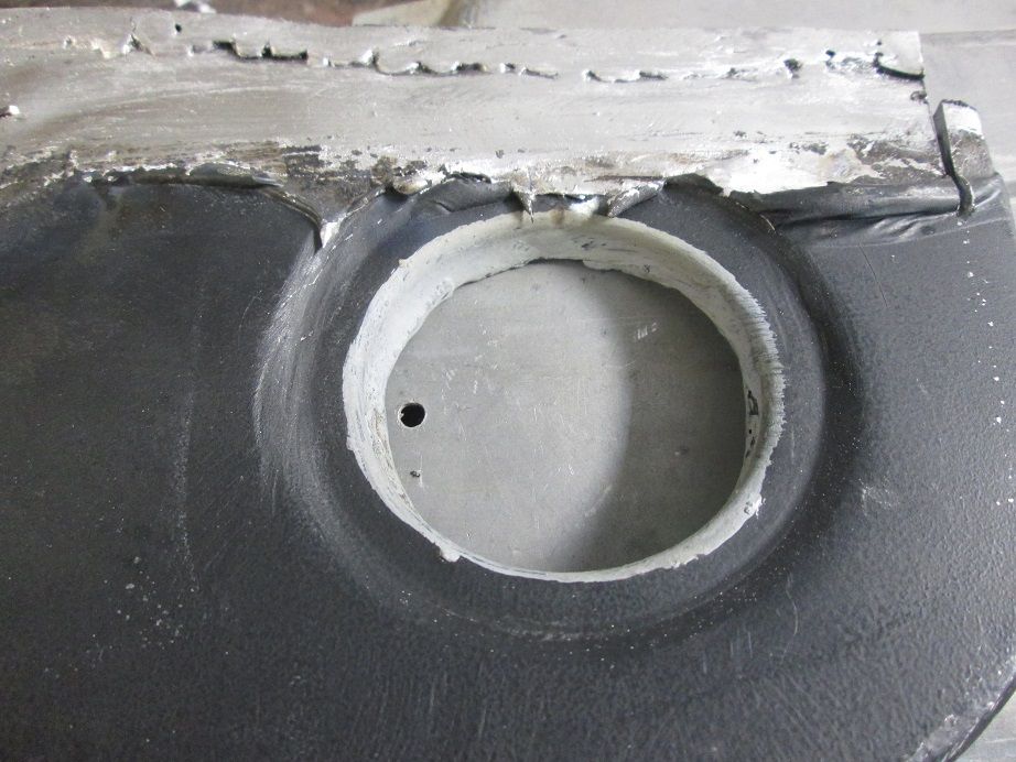

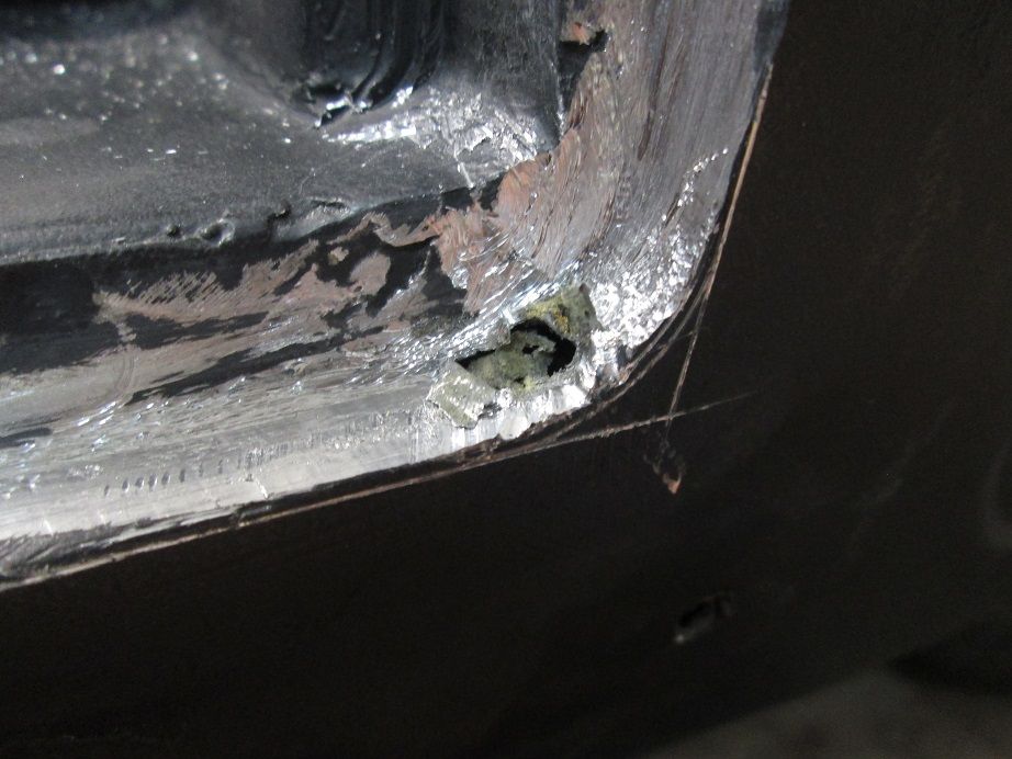

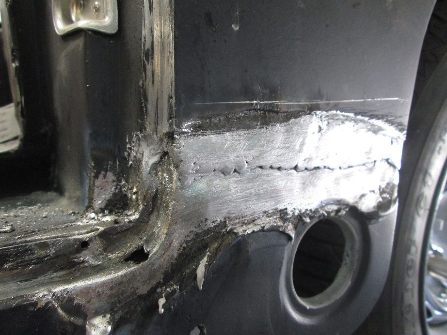

                  A lot of lead filler use along the bottom leading edge and it was still low through here as the bottom of the door was over shooting it so I was either cutting the door bottom or raising this area higher with even more body filler.

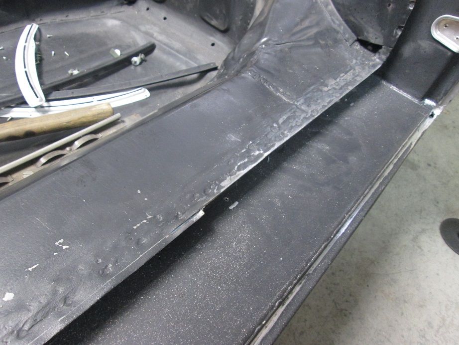

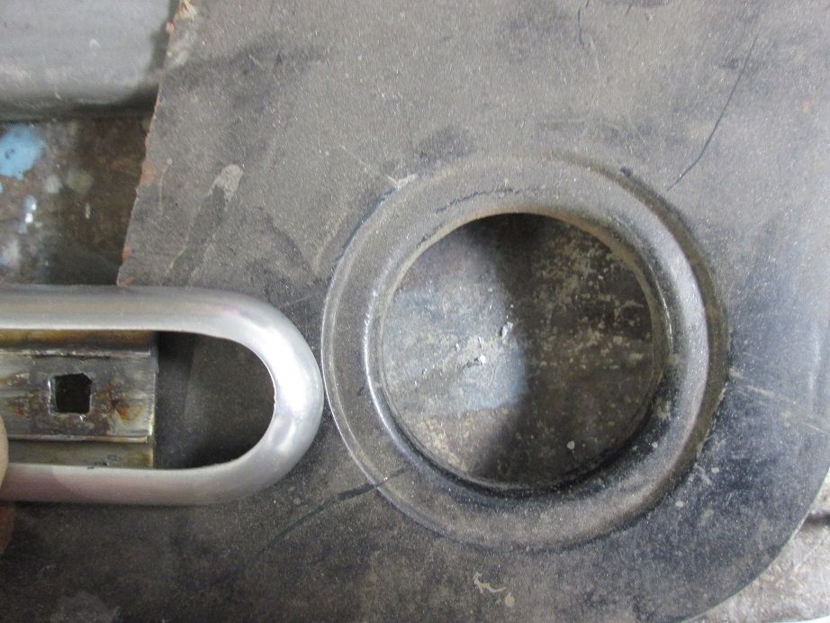

                  Even the torsion hole embossment shoulder and surrounding area was coated. As you can see the shoulder detail is washed out in places so had I left it I would be sculpting it in more filler to bring this detail back. The further I went the more I new I was on the right path.

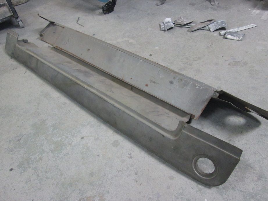

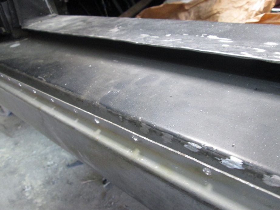

                  Rocker skin free with threshold left intact.
                  A ton of clean up and prep yet to come.

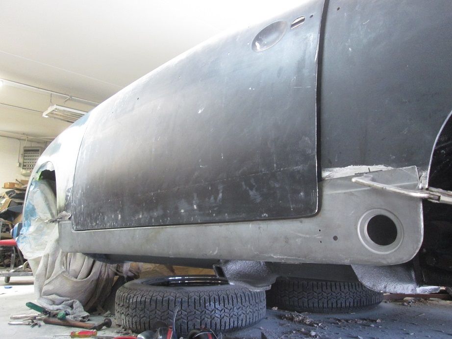

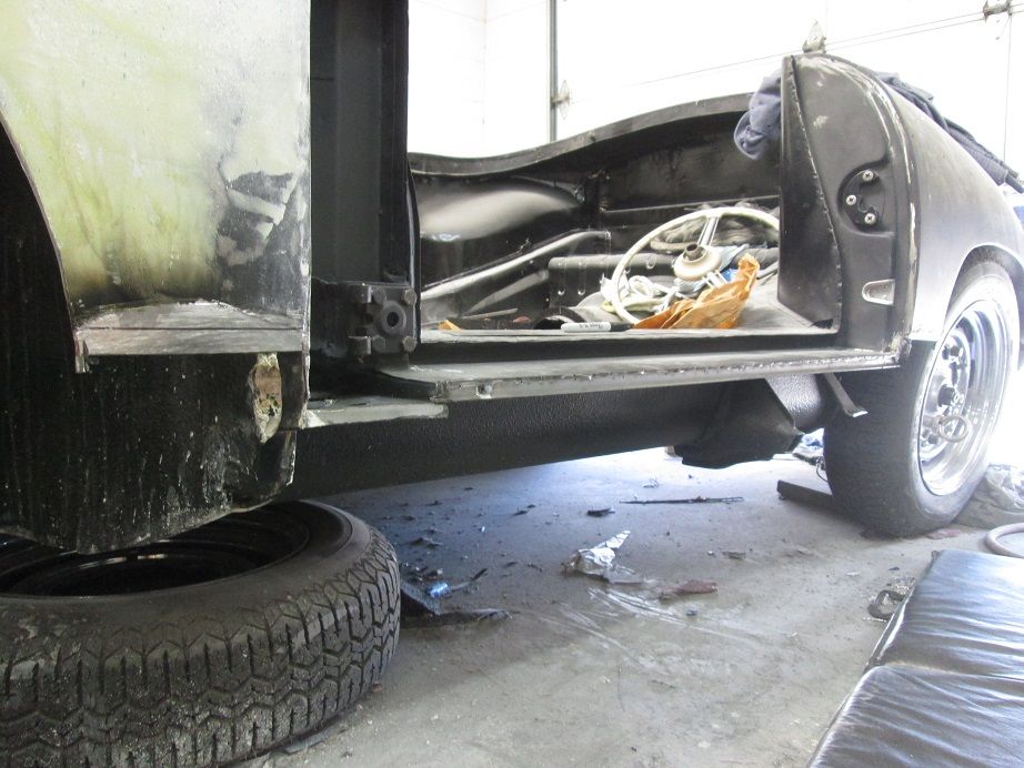

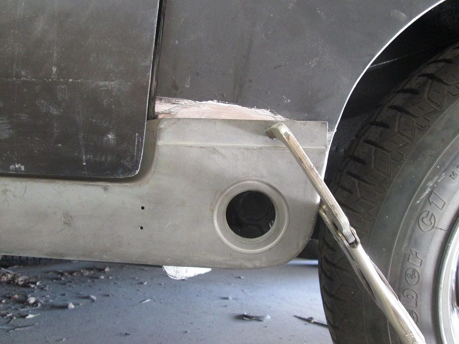

                  • Initial fitments to get my plan together.
                    Click image for larger version  Name:	IMG_2358.JPG Views:	0 Size:	105.1 KB ID:	106161
                    All the usual misalignments at the edges.
                    Click image for larger version  Name:	IMG_2359.JPG Views:	0 Size:	89.7 KB ID:	106162
                    But I was liking the fresh filler free look already.
                    Click image for larger version  Name:	IMG_2356.JPG Views:	0 Size:	107.0 KB ID:	106163

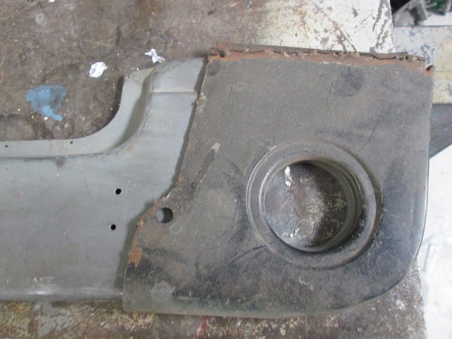

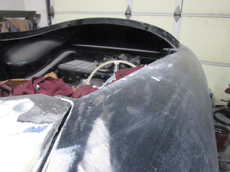

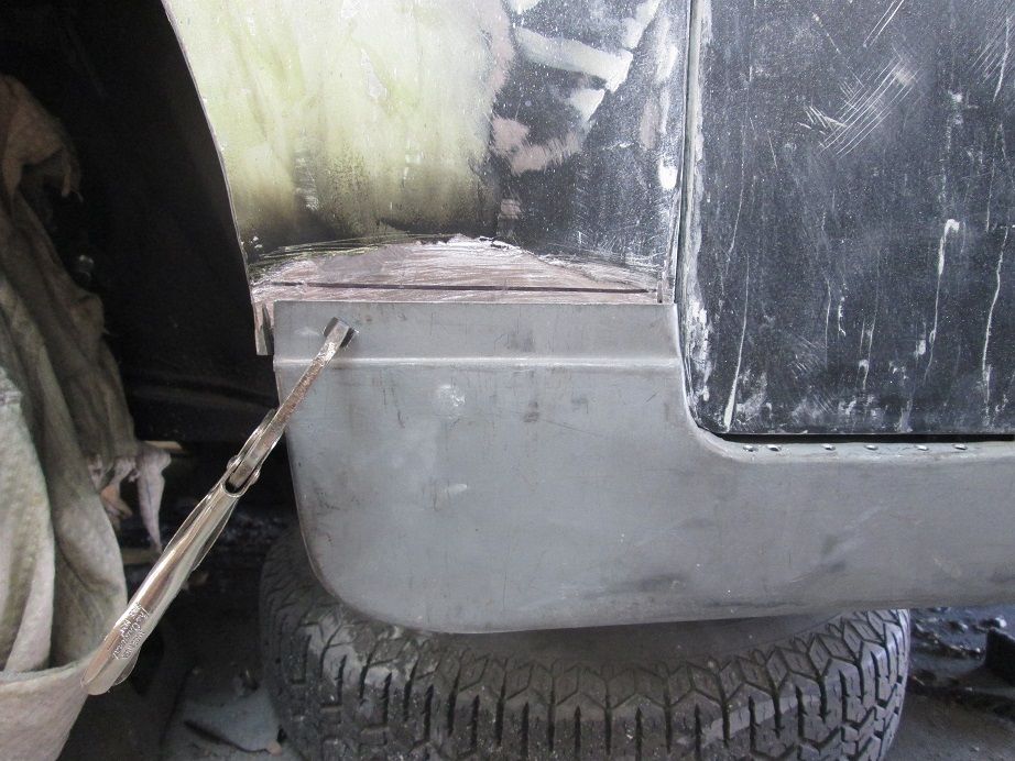

                    • Rocker fitment cont.
                      Click image for larger version  Name:	IMG_2370.JPG Views:	0 Size:	114.8 KB ID:	106167
                      Coming up a little short with the flange on the door side locked in but the approach angle of the wired edge seems pretty good.
                      Click image for larger version  Name:	IMG_2371.JPG Views:	0 Size:	87.3 KB ID:	106168
                      Backside lip lines up but the angle on the rocker is too steep. Have plenty of wiggle room at the doors edge so it was looking like I was sliding the rocker forward to align the front edge and relief cutting this back side to achieve a more swoopy/graceful angle with the rest of the wheel opening.
                      Click image for larger version  Name:	IMG_2366.JPG Views:	0 Size:	80.2 KB ID:	106169

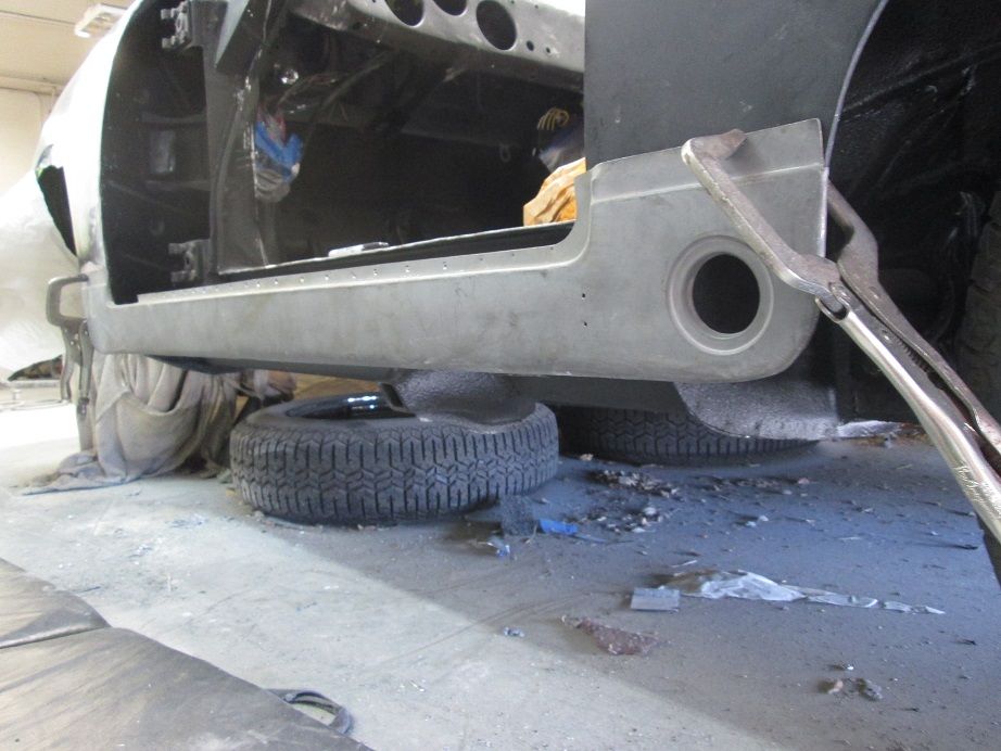

                      • Click image for larger version  Name:	IMG_2383.JPG Views:	0 Size:	89.0 KB ID:	106173
                        Back edge is now way short but it works out fine as it allows for a relief to lay it back into alignment with the fender edge at a much more graceful approach angle. The distance at the lower door corner there is much smaller requiring far less lead in the end. Its all falling into place. A little too well.
                        Did I mention what a total PIA this has been working a foot off the ground? I've been spoiled all these years doing this work on a rotisserie.
                        Click image for larger version  Name:	IMG_2376.JPG Views:	0 Size:	91.3 KB ID:	106174

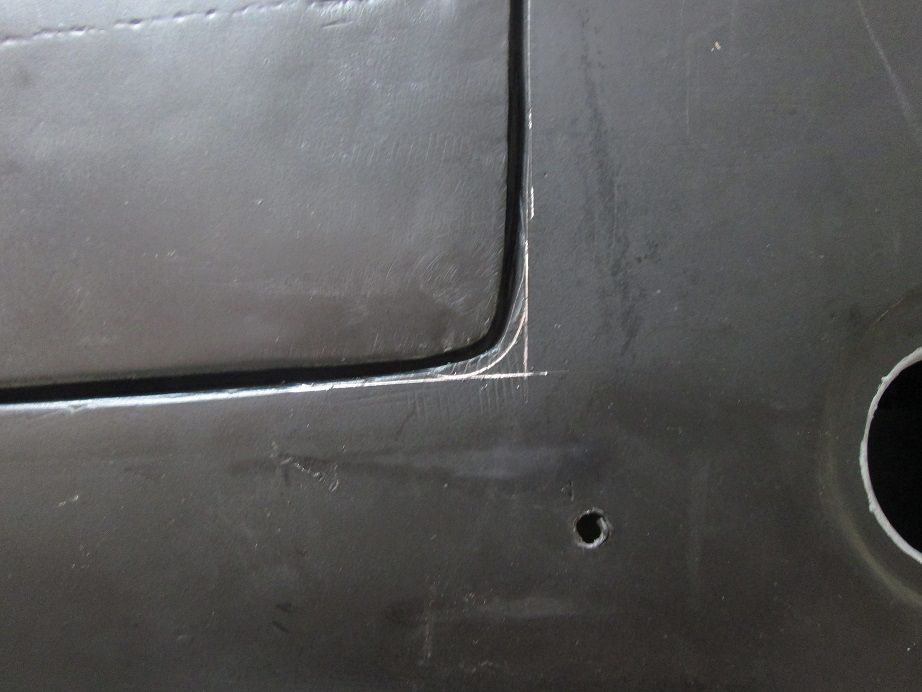

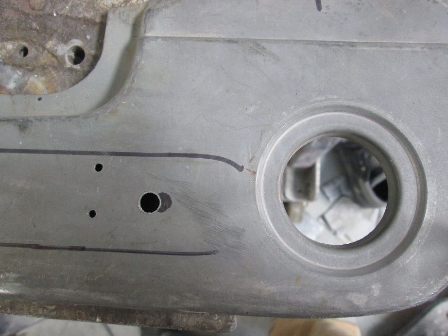

                        Took a little break from fitment as now was the time to locate and drill the holes for the deco with the ability to work with it flat on my table.
                        Click image for larger version  Name:	IMG_2372.JPG Views:	0 Size:	94.1 KB ID:	106175

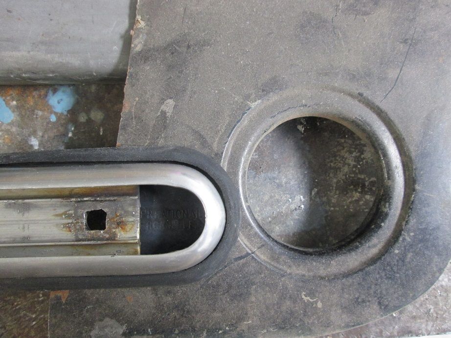

                        Fortunately I had this original for locating reference.
                        Click image for larger version  Name:	IMG_2373.JPG Views:	0 Size:	120.9 KB ID:	106176

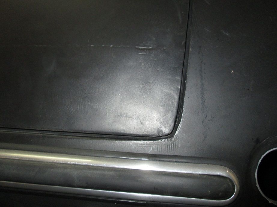

                        With the holes lined up the factory had the tip of the deco encroaching on the body plug a bit.
                        Click image for larger version  Name:	IMG_2374.JPG Views:	0 Size:	109.6 KB ID:	106177
                        With the seal removed the deco was positioned dead even with the edge of the embossment. So glad I had this part as I would have never thought to have placed it that close to the body plug opening. Original reference parts proving their worth once again.

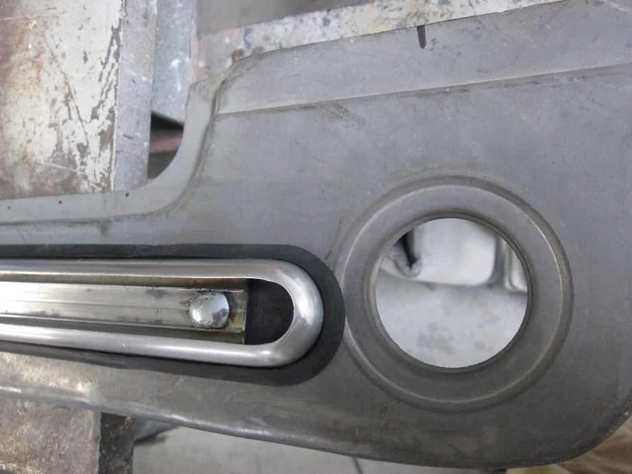

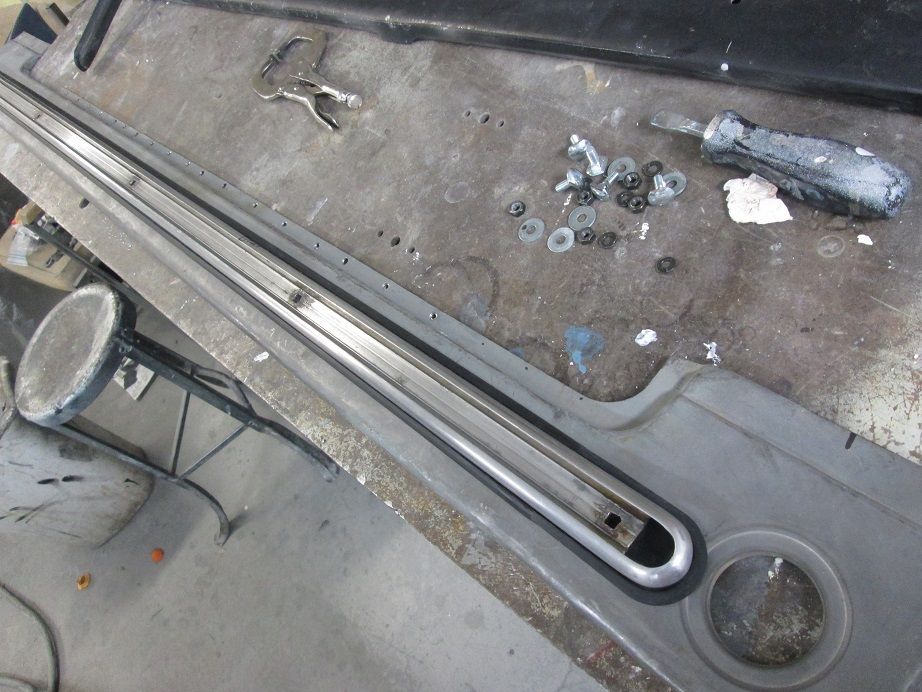

                        • Rocker Deco
                          Oriented and set to level with the rocker. Time to drill some holes
                          Holes were reamed to the same size as my OG example.
