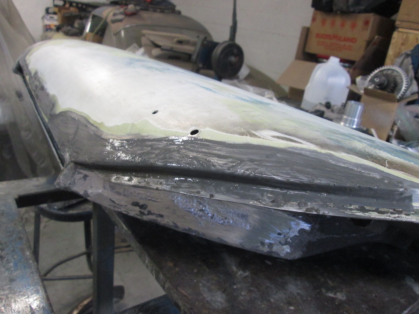

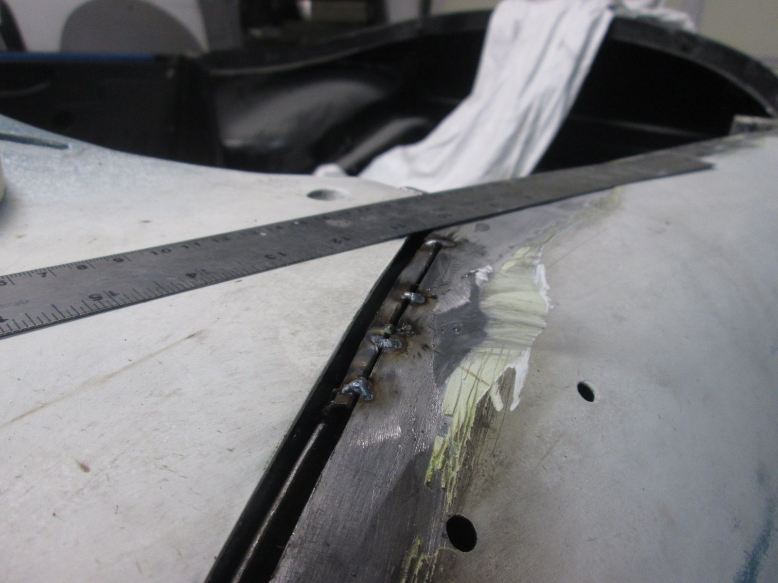

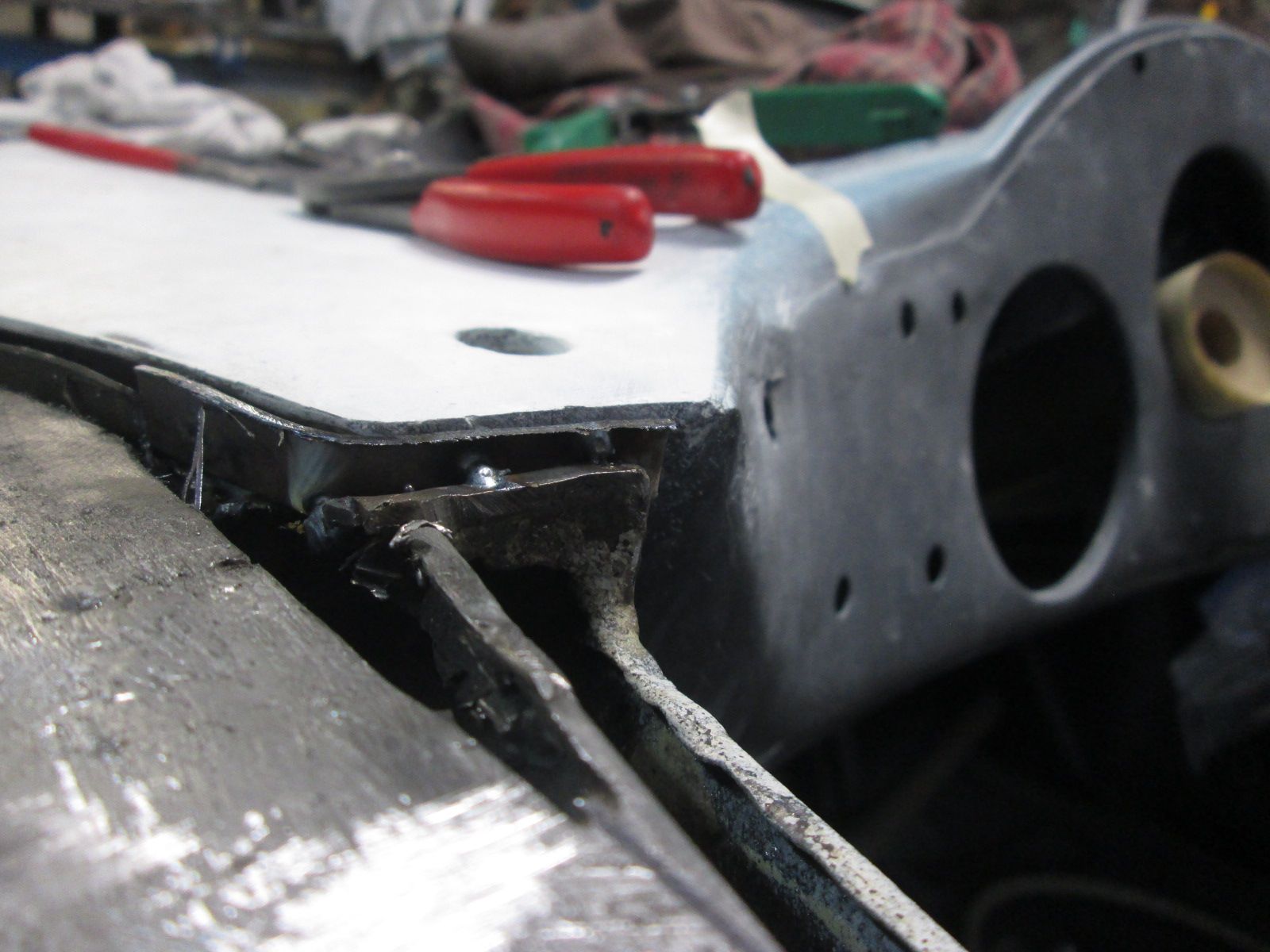

  • Tacking it back together:
    Click image for larger version  Name:	IMG_3275.JPG Views:	0 Size:	179.1 KB ID:	106801 New section tacked in and set just below the cowl height . Tack weld area highlights how much further up I'm taking it from where it was found.
    Click image for larger version  Name:	IMG_3277.JPG Views:	0 Size:	202.4 KB ID:	106802 To the inside the edge of it is tacked holding the "slope" in its new steeper and more forward position.
    Click image for larger version  Name:	IMG_3279.JPG Views:	0 Size:	216.9 KB ID:	106803 Now that I have my new baseline set I can begin reattaching the skin back onto this corner.

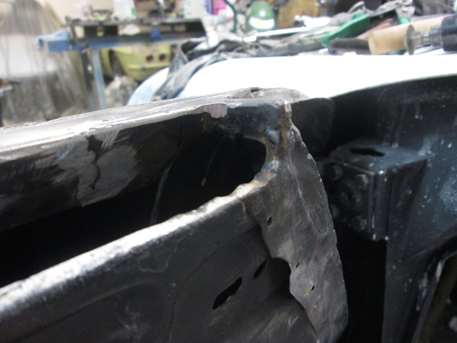

ID:	106804 New inner flange tacked and holding the skin in its new higher position.
ID:	106805 Before I committed to stiching it in I mocked up the door glass channel just to make doubly damn sure it was all still going to fit and work together, All set...

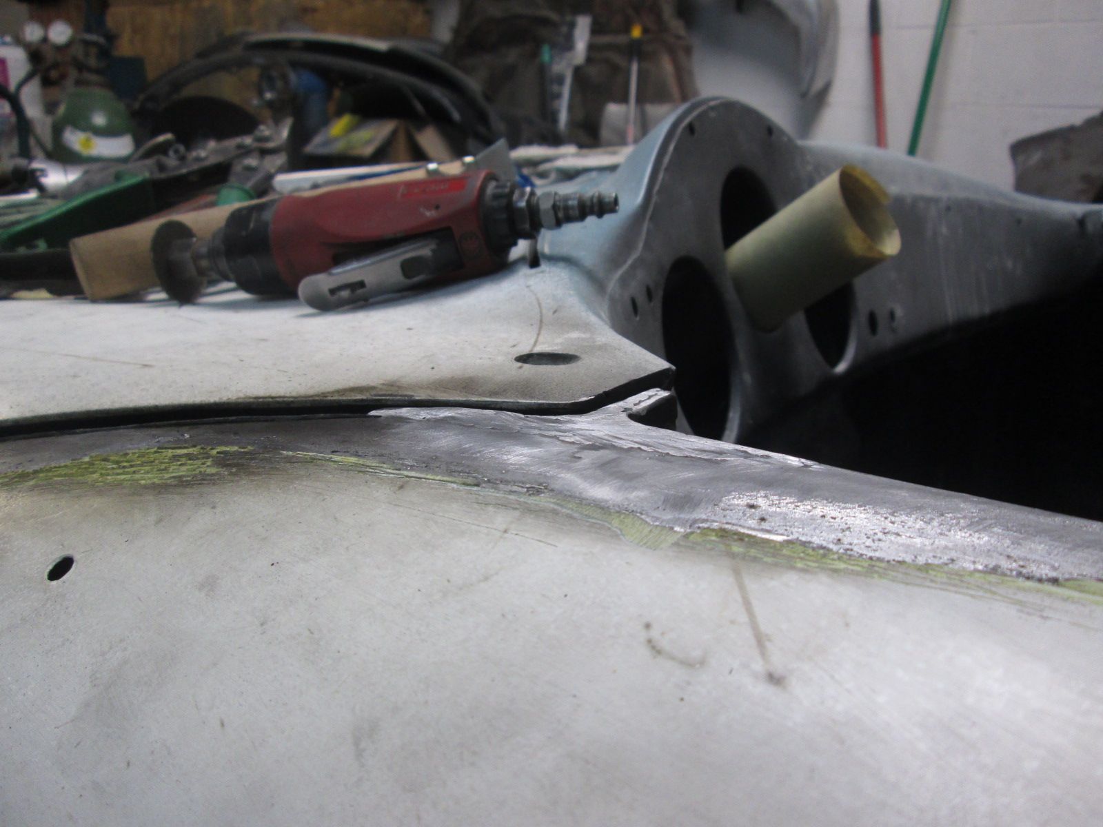

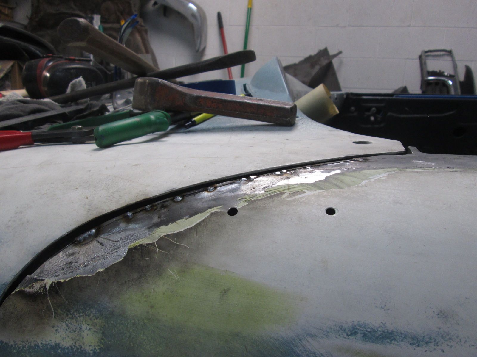

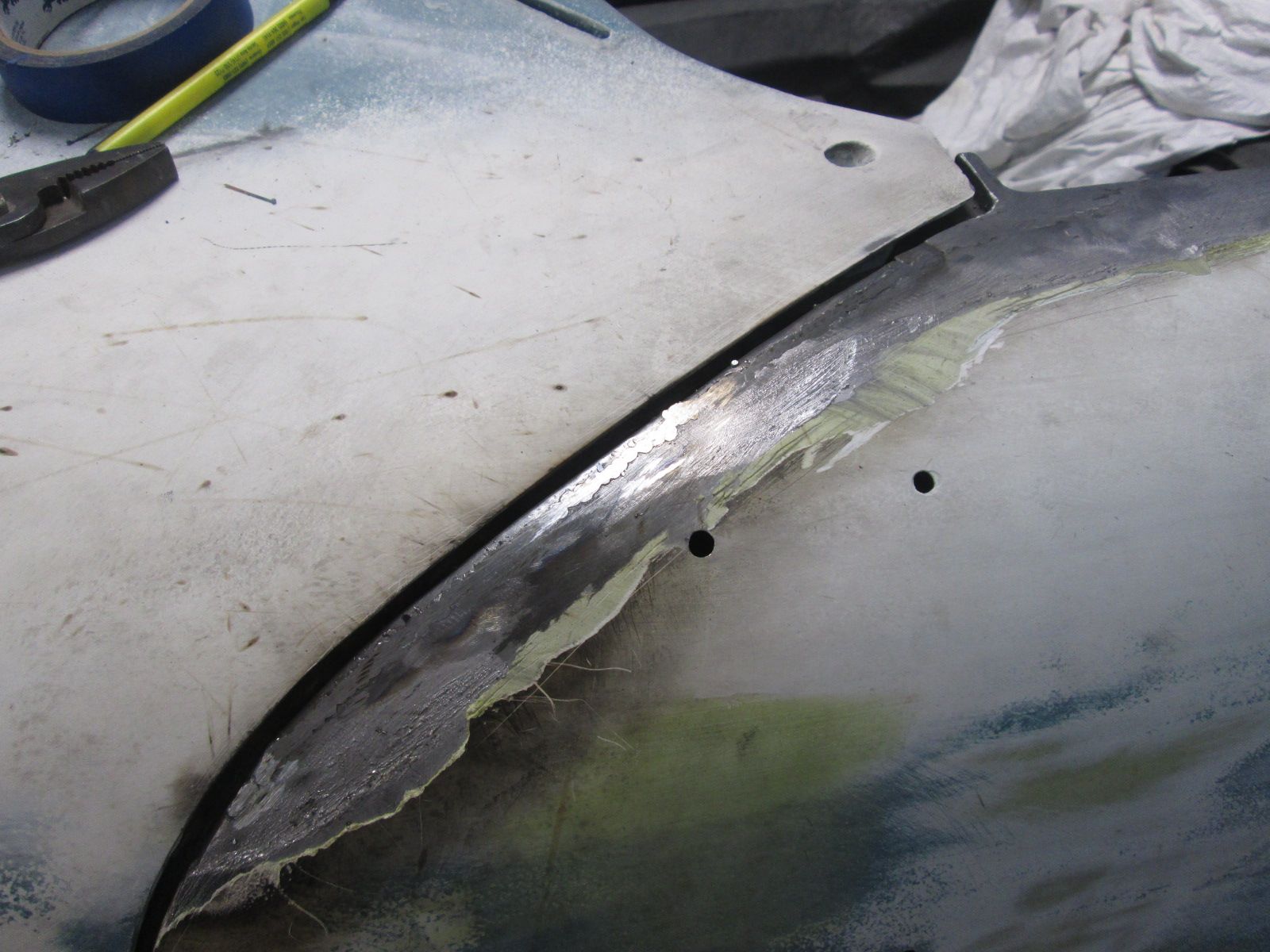

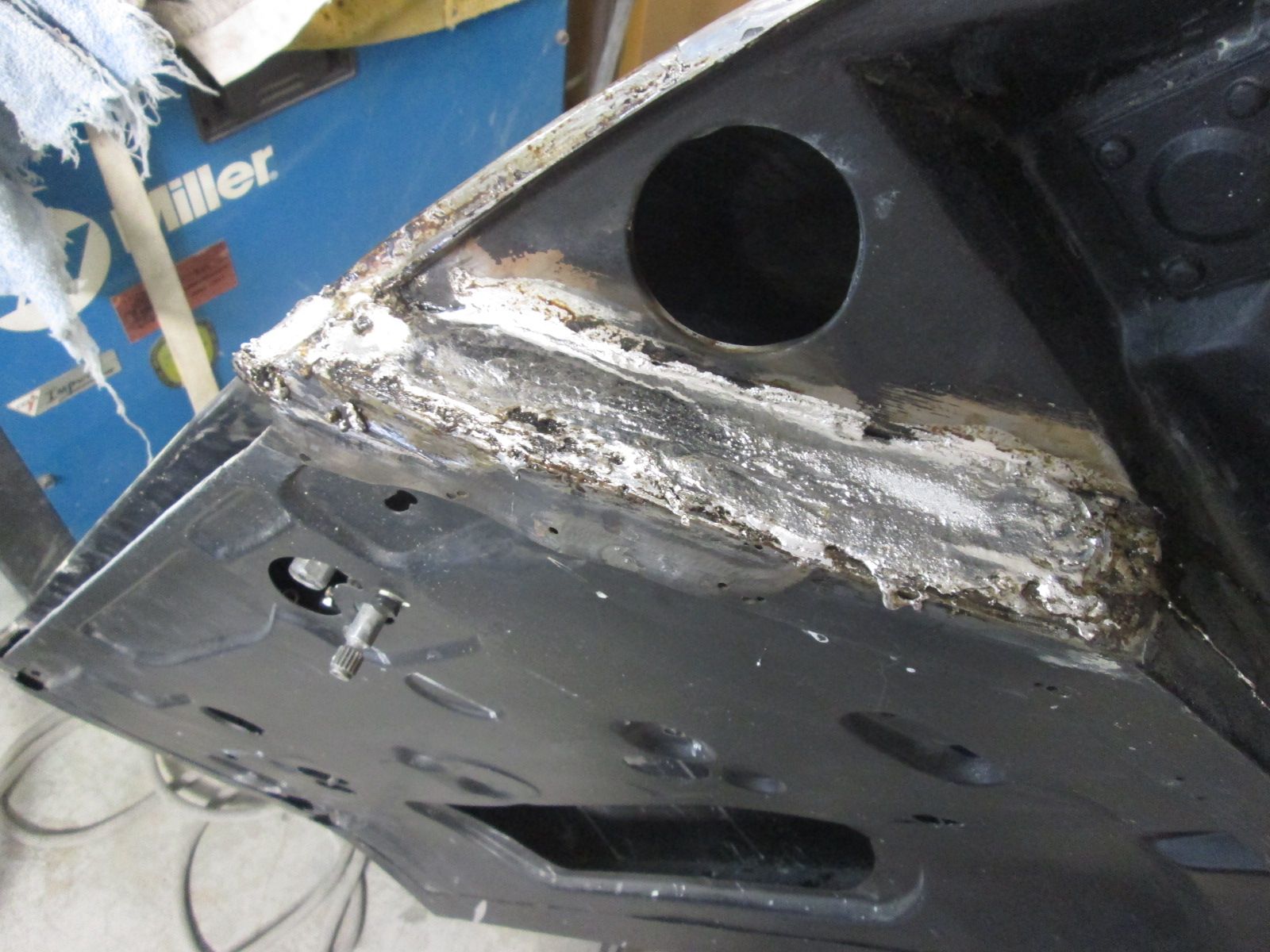

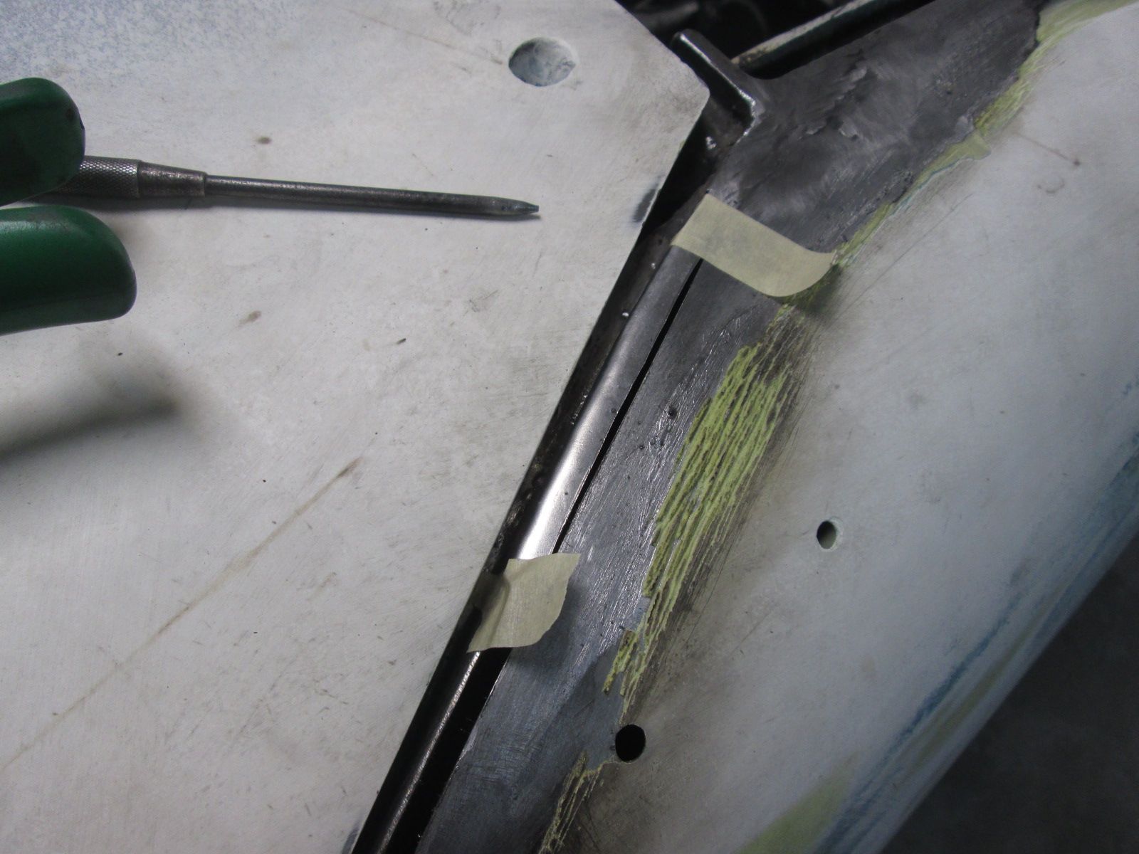

    • Getting it all stitched back together:
      Click image for larger version  Name:	IMG_3281.JPG Views:	0 Size:	198.4 KB ID:	106807 Window channel flange all stitched and set. I can begin adding sections of the skin back on now.
      Click image for larger version  Name:	IMG_3285.JPG Views:	0 Size:	220.1 KB ID:	106808 First little graft installed. Its a complex area so the only way I could do this and maintain control was in small bites.
      Click image for larger version  Name:	IMG_3286.JPG Views:	0 Size:	182.1 KB ID:	106809
      I left it a MM or so just below cowl to give me some wiggle room for some solder. My intent was never to eliminate it completely as it should have some. I just didn't want most of it to be comprised of lead.
      Click image for larger version  Name:	image_61540.jpg Views:	3 Size:	177.2 KB ID:	106810 Inner flange all set and dressed.
      Click image for larger version  Name:	image_61541.jpg Views:	3 Size:	218.1 KB ID:	106811 Upper jamb corner also now fully stitched together. I was fighting a bit of lead contamination so the welds where splattery but its done and will only need a swatch of solder to smooth things over.

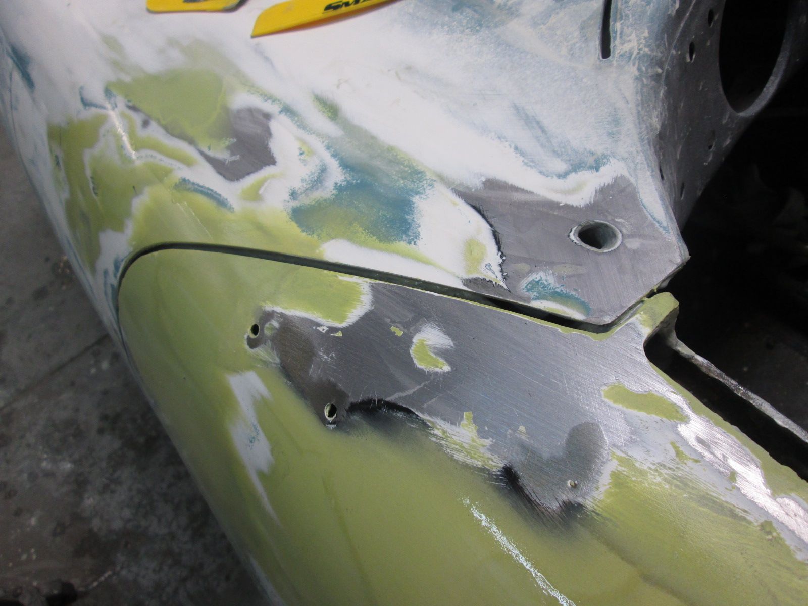

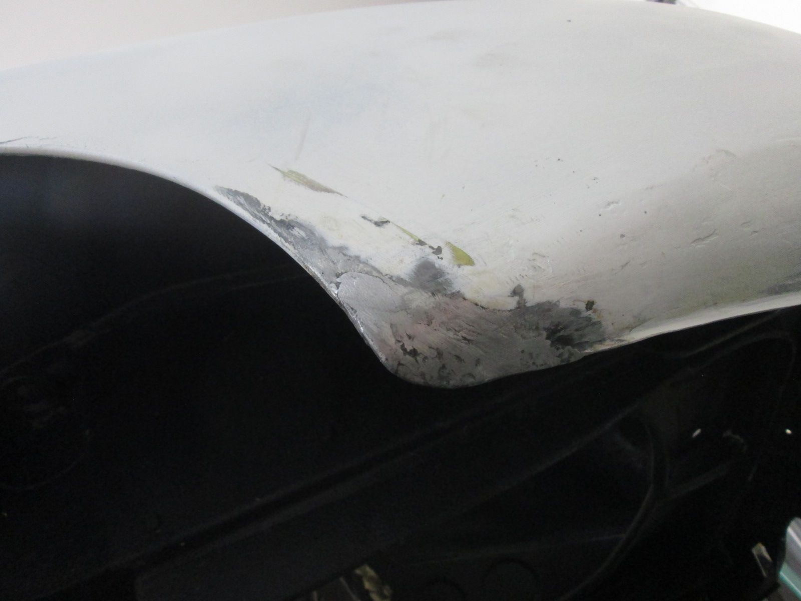

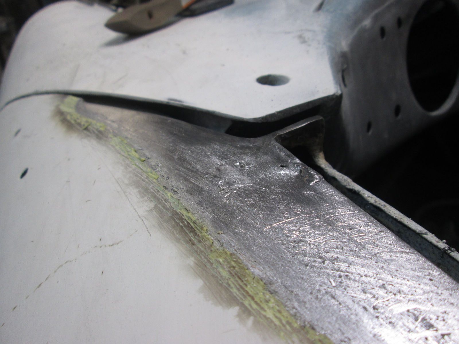

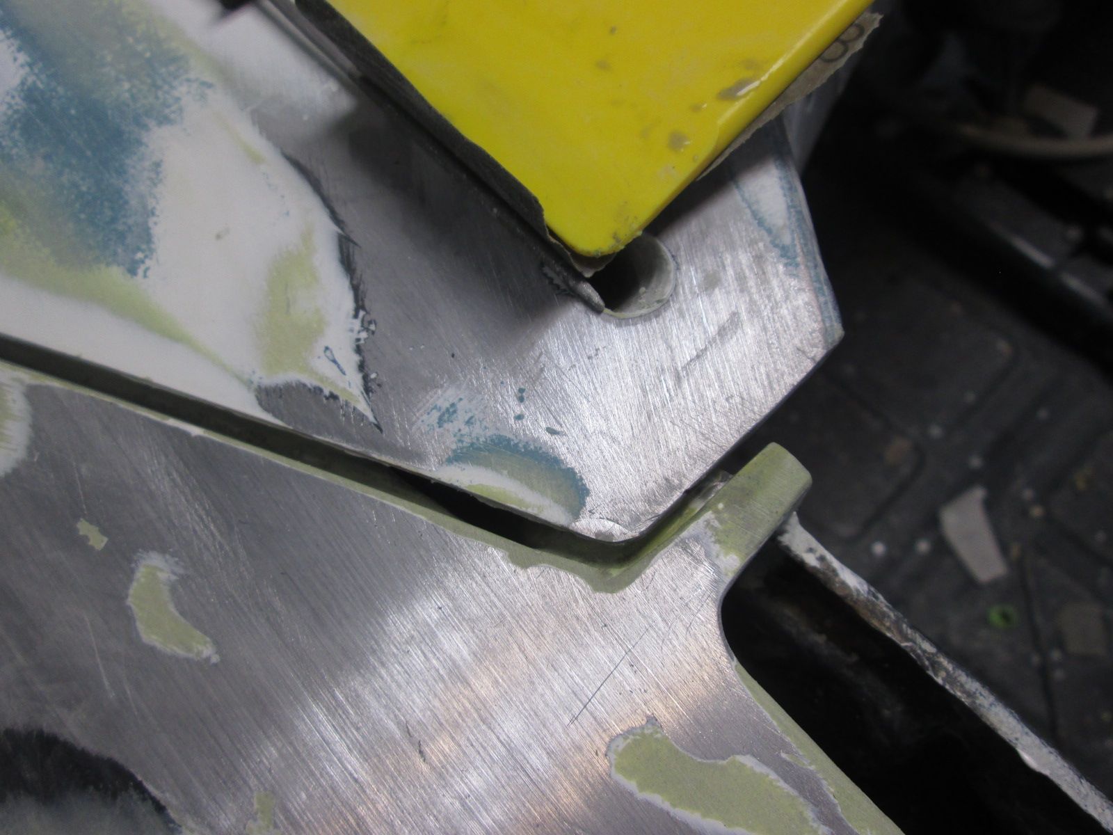

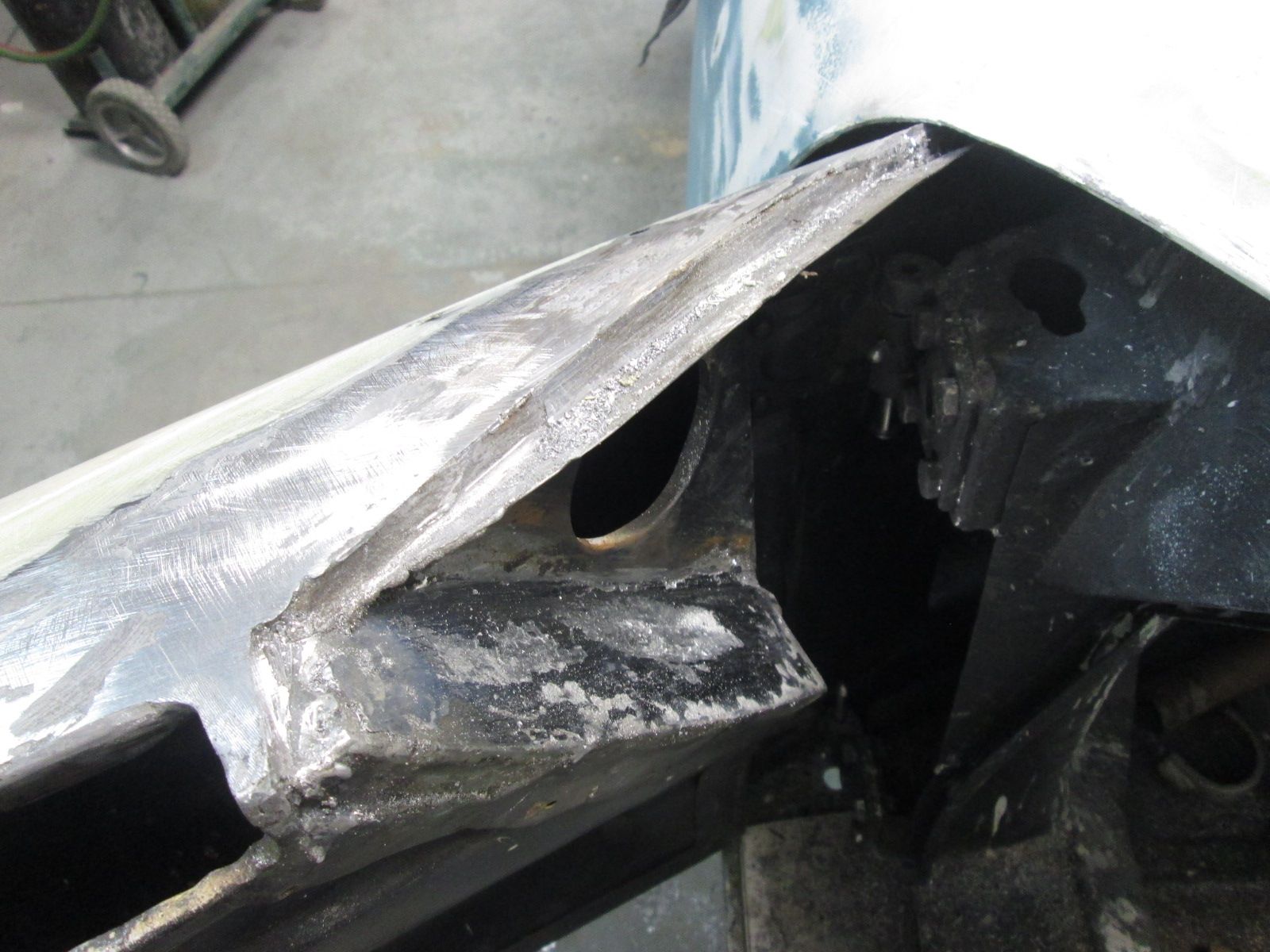

        • Detour metal work complete:

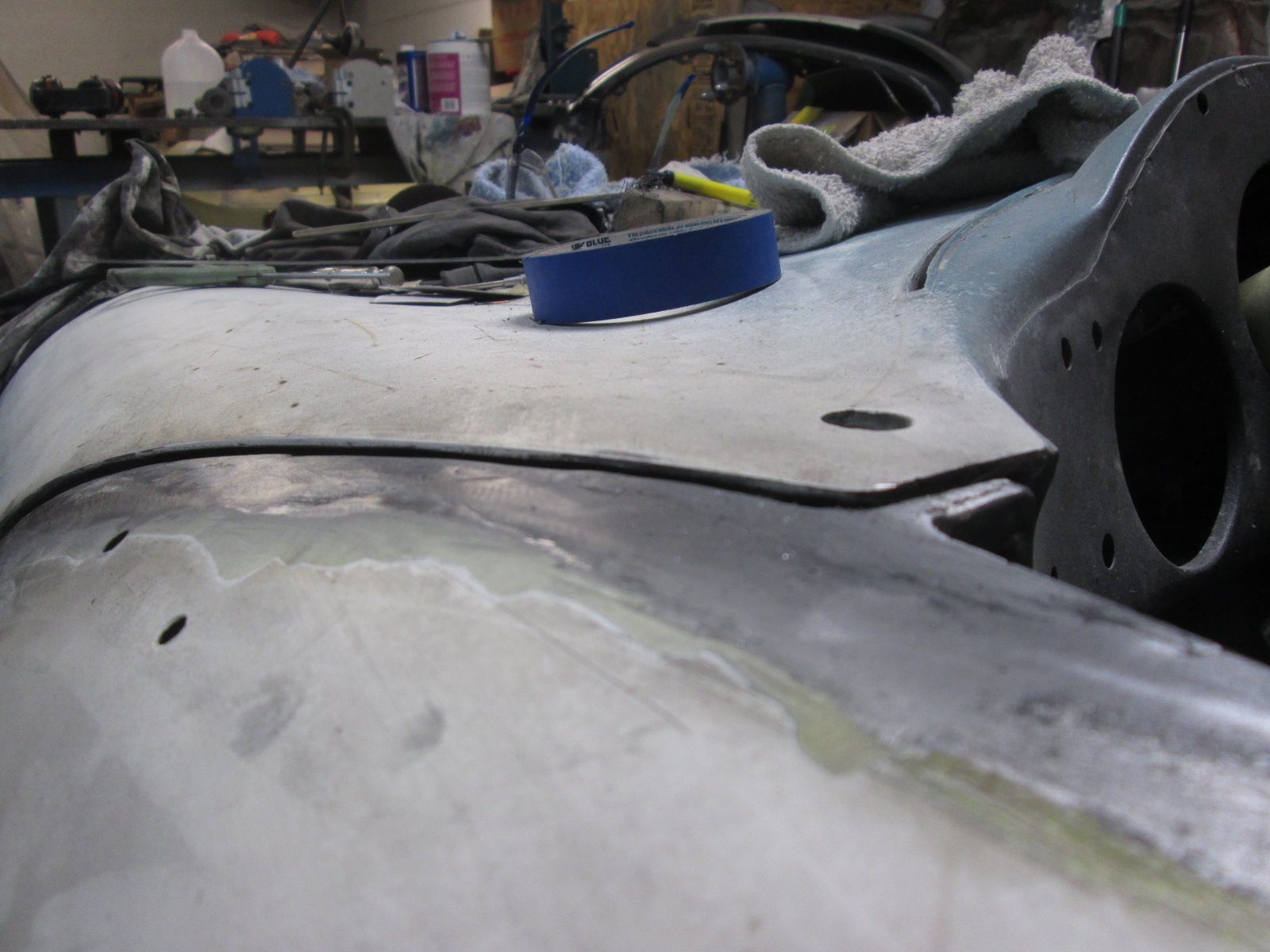

          Click image for larger version  Name:	IMG_3309.JPG Views:	0 Size:	217.1 KB ID:	106821 Fully stitched and just about dressed smooth. Following up with some hand filing next.
          Click image for larger version  Name:	IMG_3312.JPG Views:	0 Size:	209.7 KB ID:	106822 Chased it about as far as I can. Finally done...
ID:	106823 Achieved the raw gap and transition I was after before any filler.
          Area now ready for some resoldering; Coming up next.

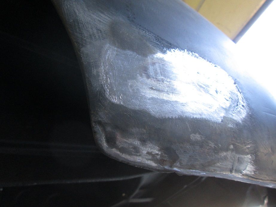

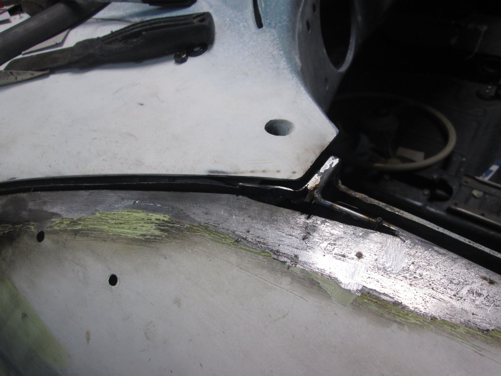

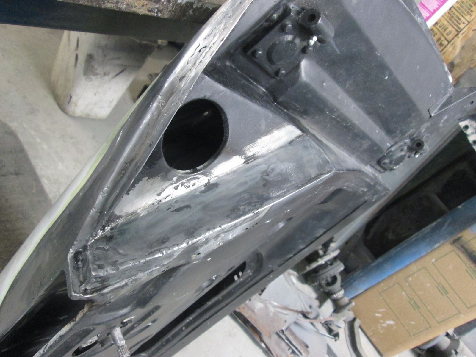

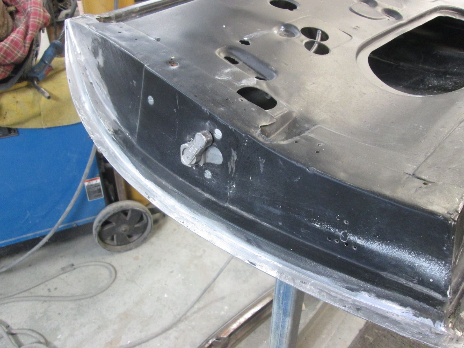

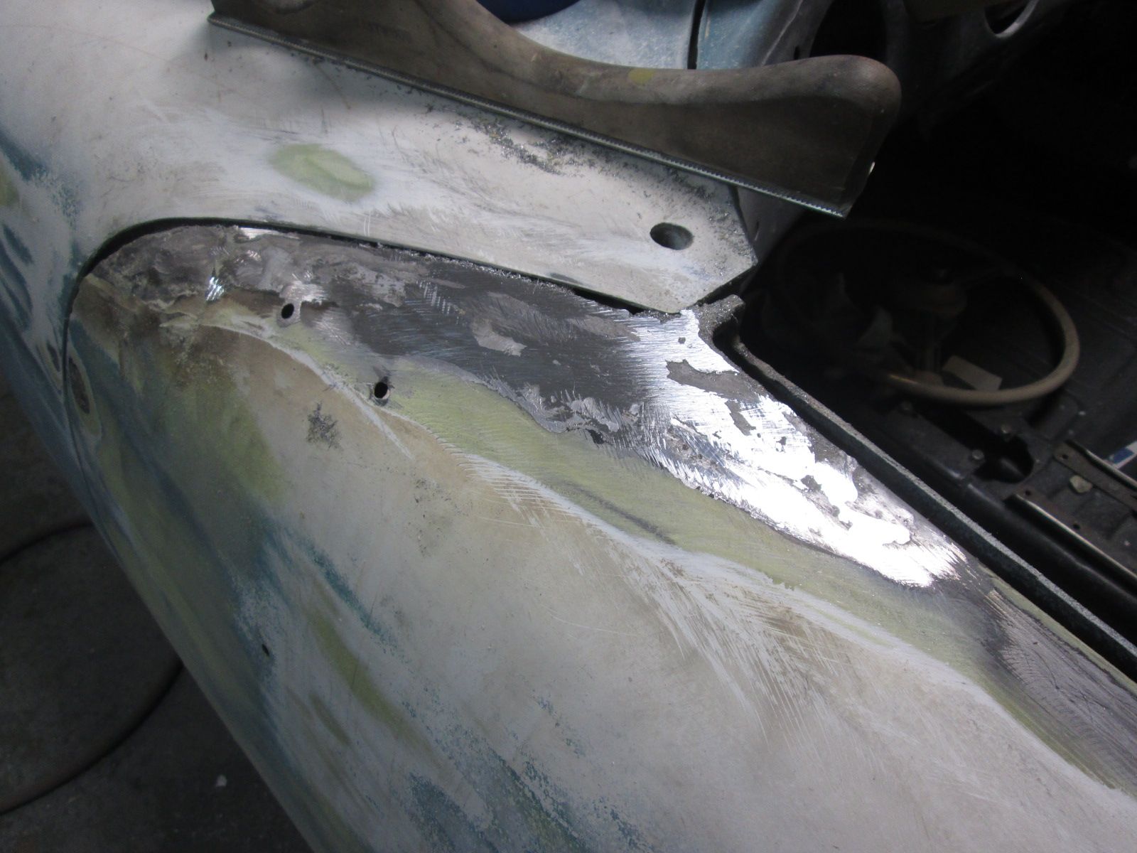

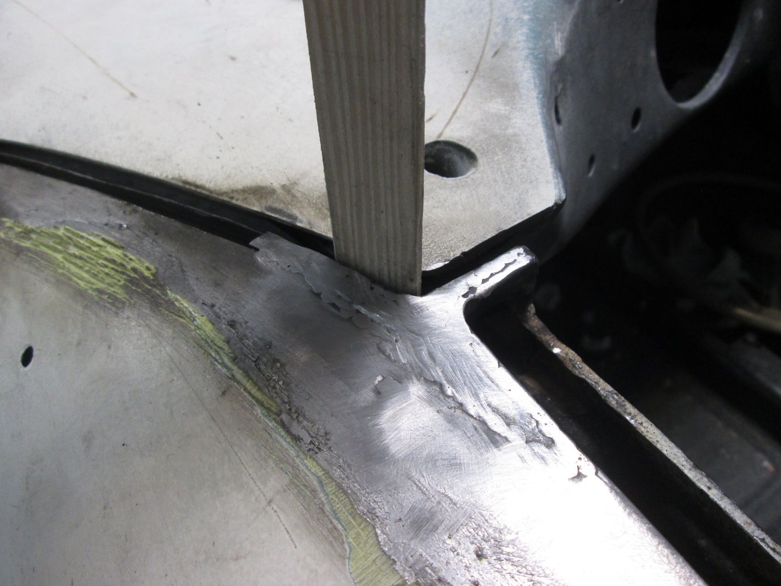

          • resoldering:
            Click image for larger version  Name:	IMG_3319.JPG Views:	0 Size:	229.4 KB ID:	106828 jamb ready for tinning acid.
            Click image for larger version  Name:	IMG_3320.JPG Views:	0 Size:	238.1 KB ID:	106829 Again, tricky to work it in where needed without losing it on the floor.
            Click image for larger version  Name:	IMG_3321.JPG Views:	0 Size:	206.5 KB ID:	106830 Tinning acid applied to the skin now.
            Click image for larger version  Name:	IMG_3322.JPG Views:	0 Size:	201.5 KB ID:	106831 Mounted back on the car for some initial filing.
ID:	106832 Lots of hand filing and shaping yet to come...

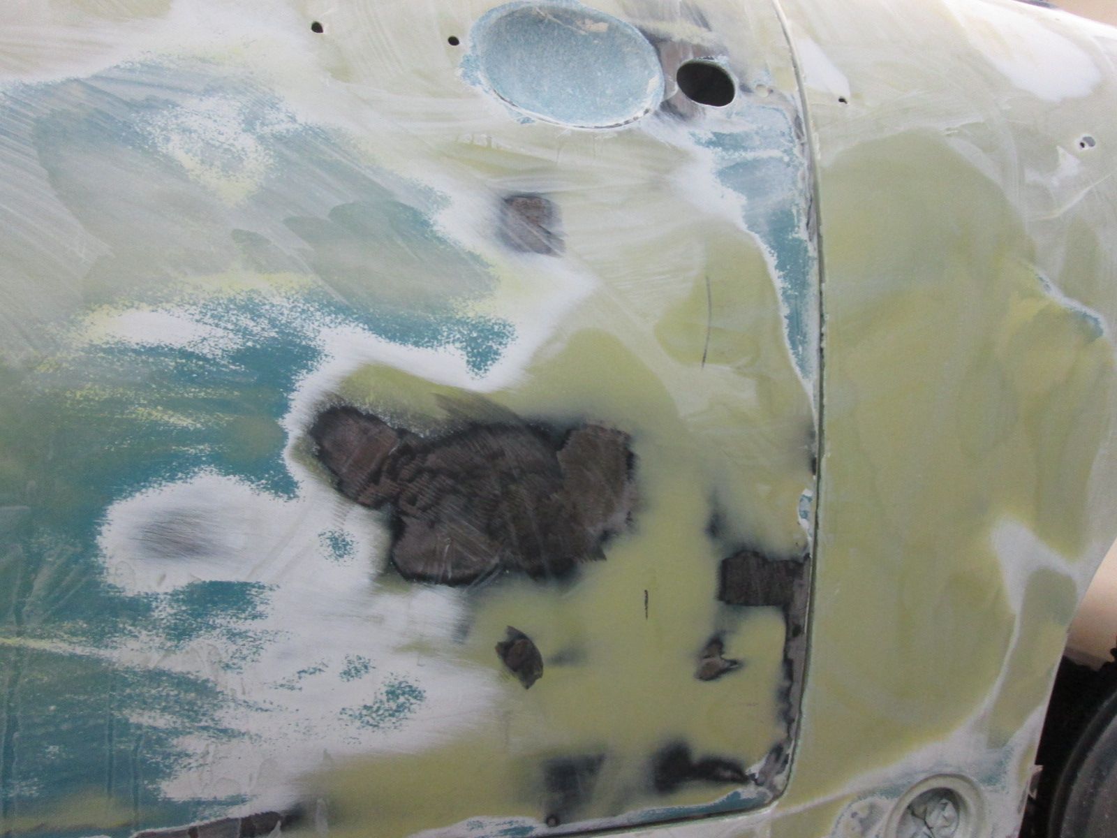

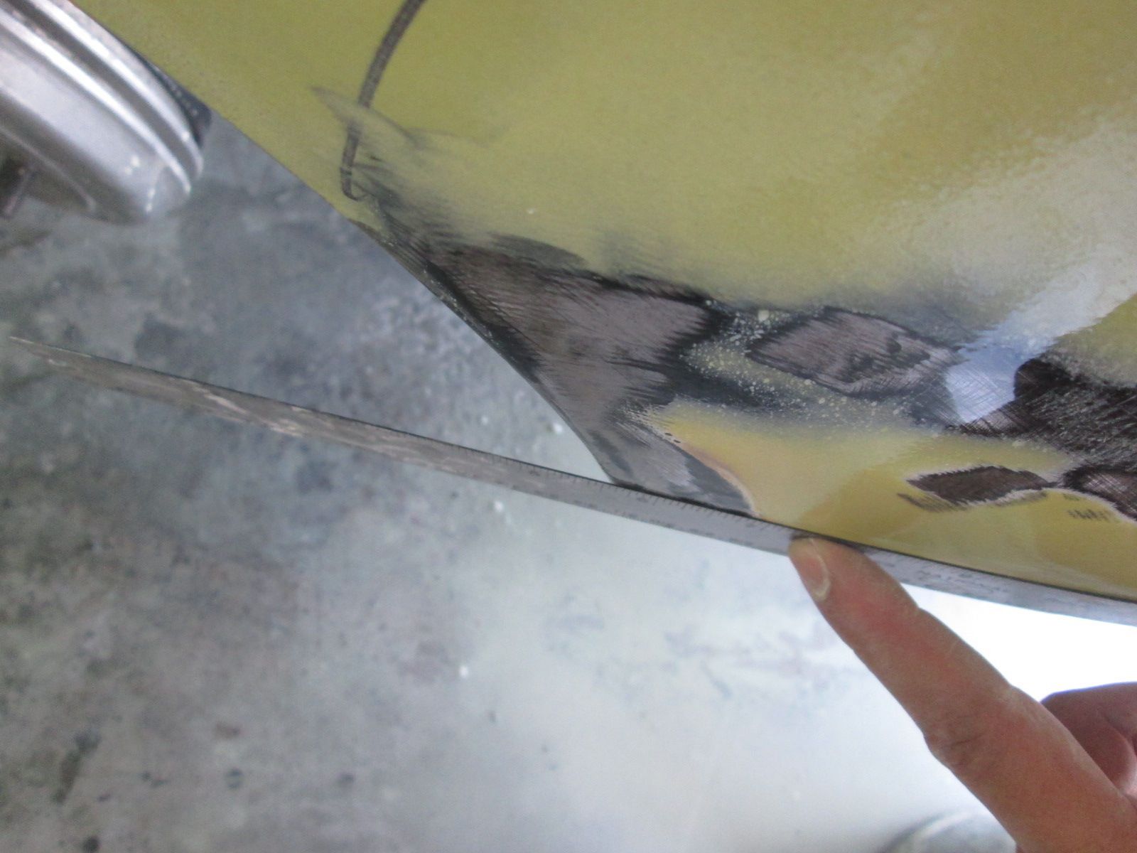

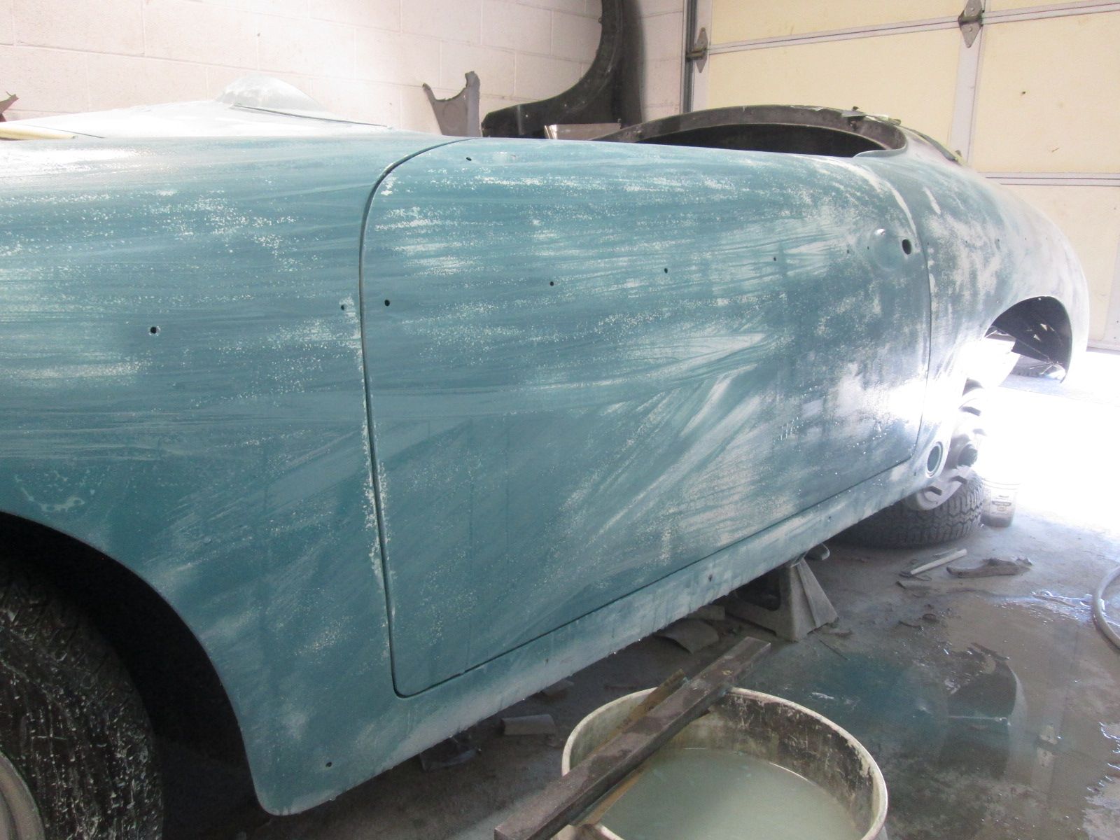

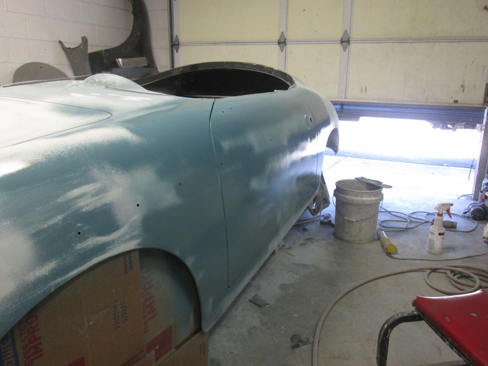

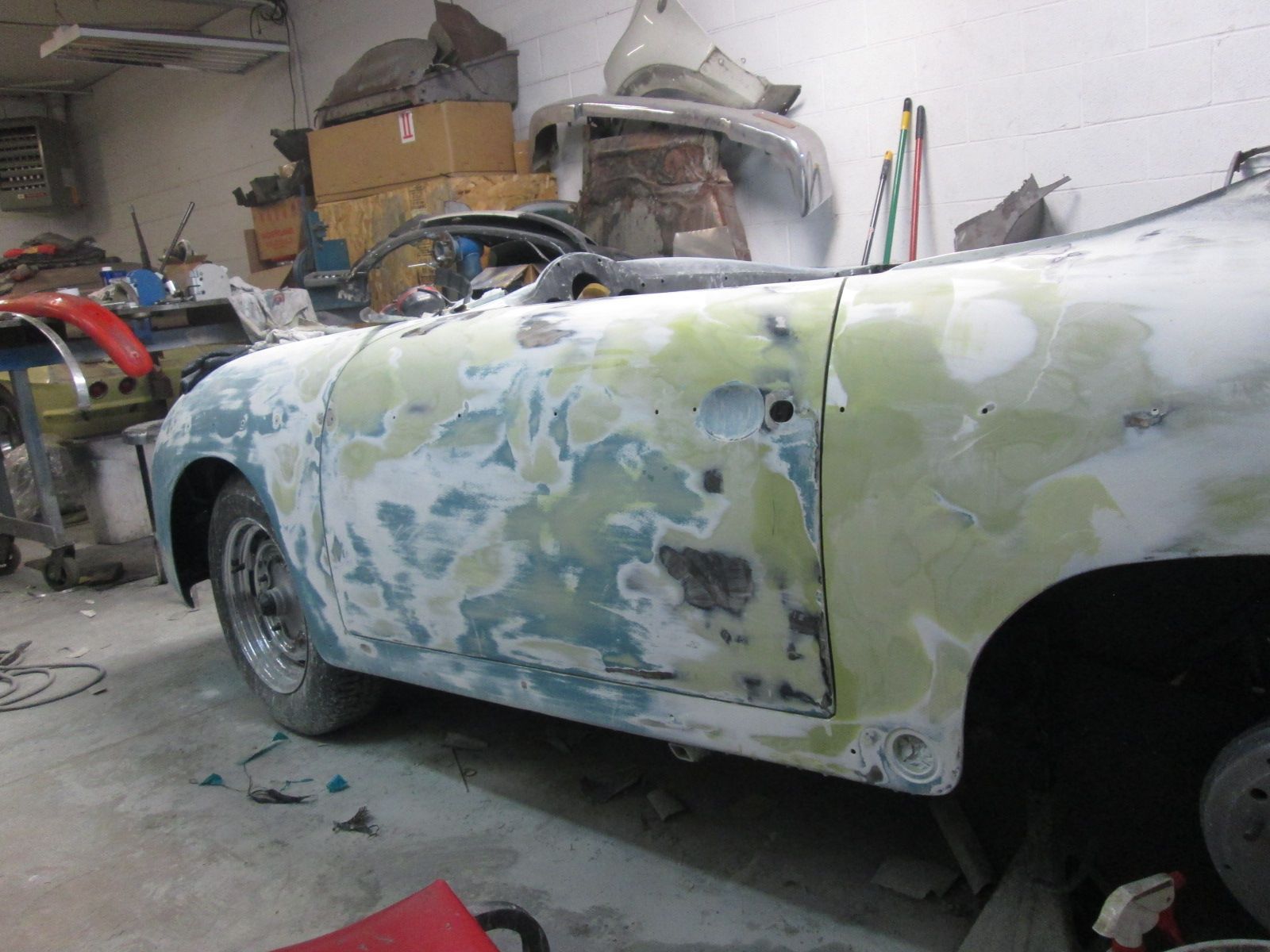

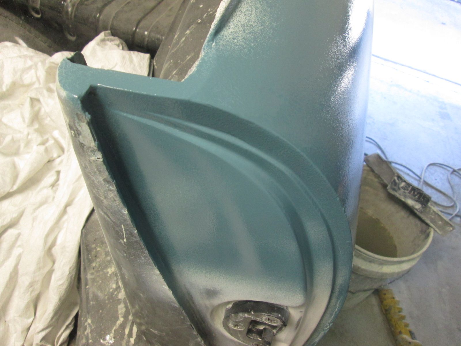

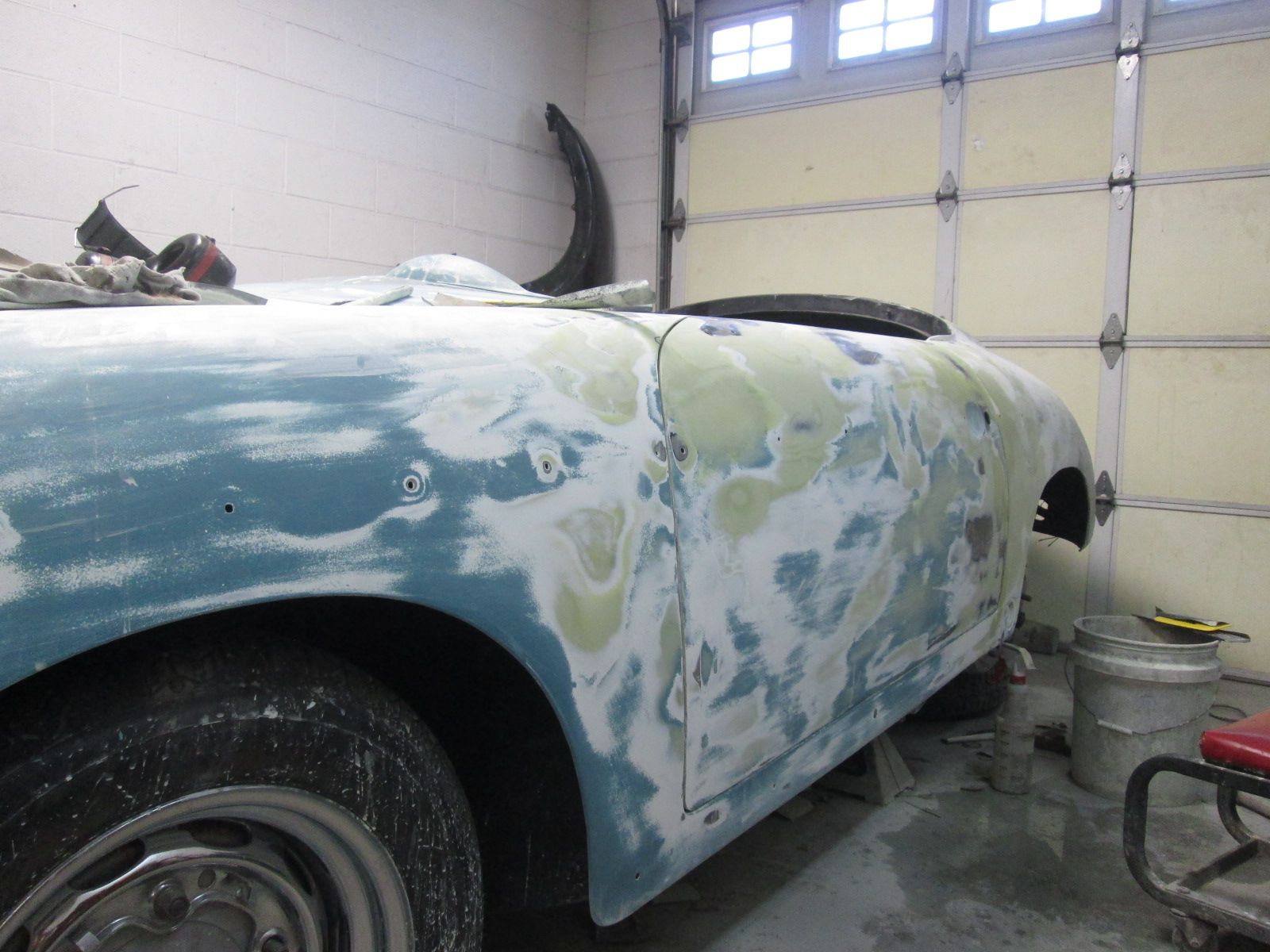

              • long blocking continued:
ID:	106840 Overall long blocking down the side continued.

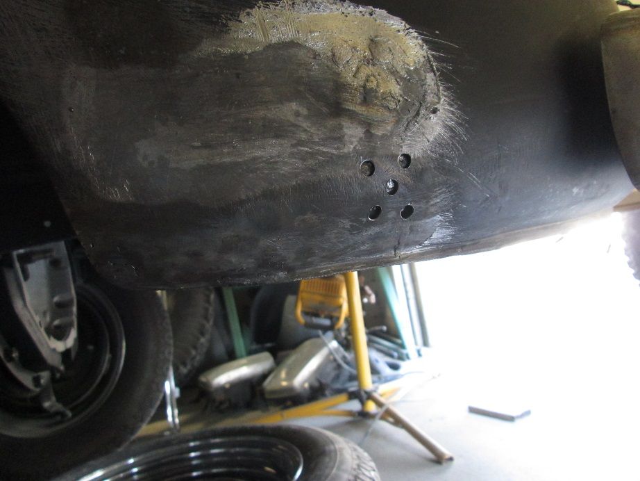

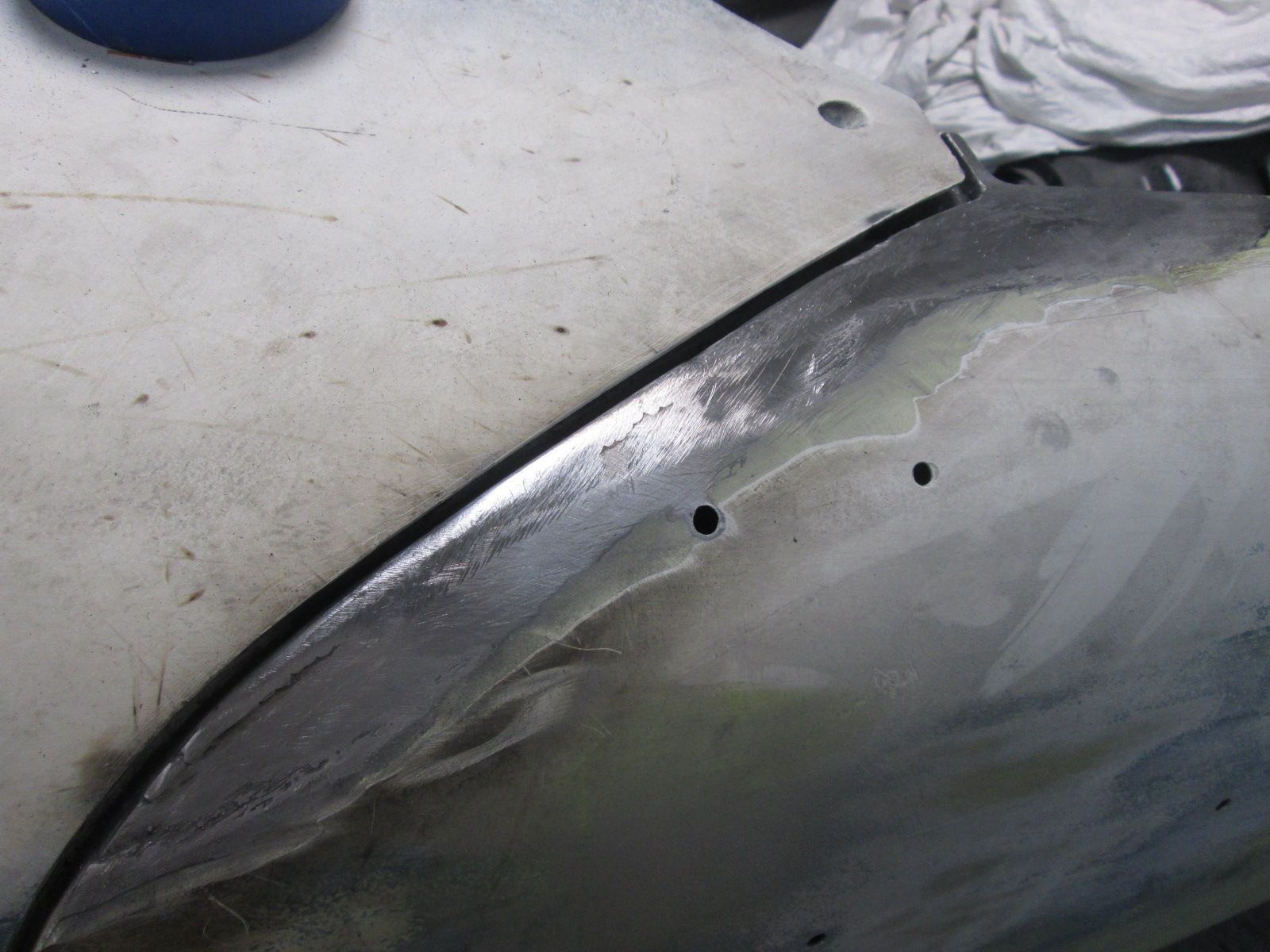

ID:	106841 Had this troublesome pregnant profile bulge that I had to shrink disc down in stages as it went.
ID:	106842 turned the trick as the lump subsided the filler got thinner on either side and the reflection got more consistent down the side.

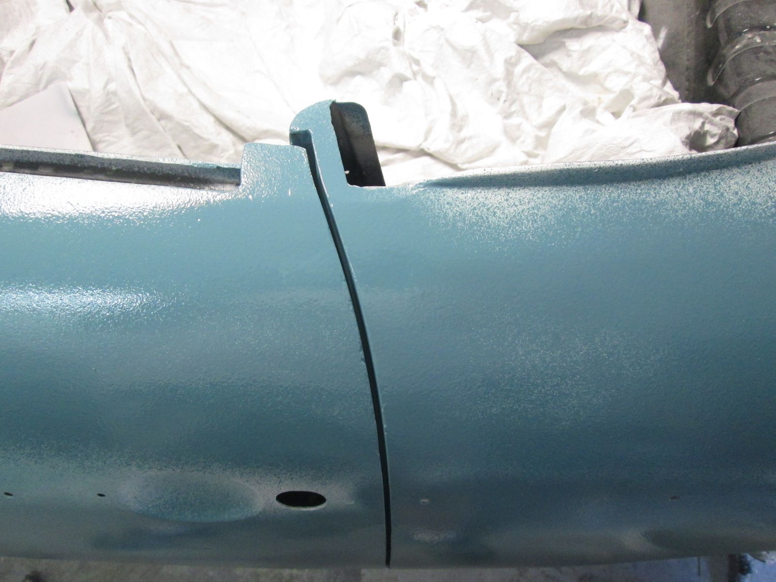

ID:	106843 chased it as far as I could and was now time again to get it all behind a uniform coat of sealer
ID:	106844 And a quick color coat and begin the process one more time.

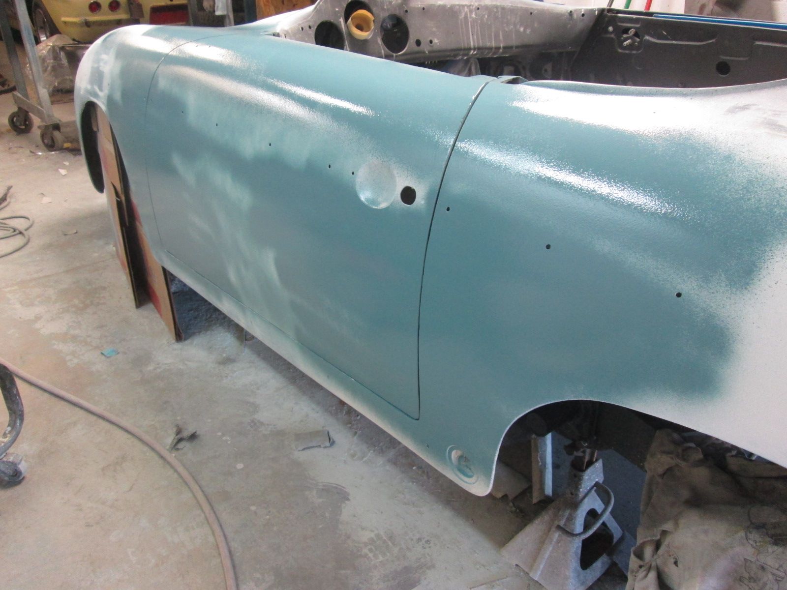

                • Detail shots of those previously reworked areas:
ID:	106846 Click image for larger version
ID:	106847 Click image for larger version
ID:	106848 Click image for larger version
ID:	106849 Click image for larger version
ID:	106850 Certainly not nearly finished yet but on the way. After it all cured it was back to long boarding for yet another round.

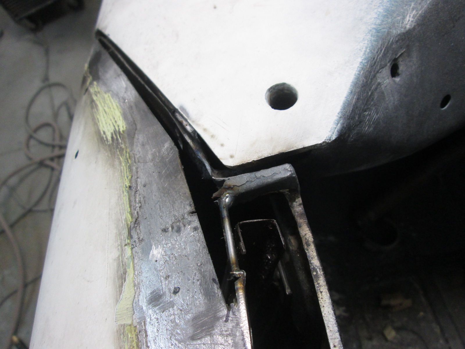

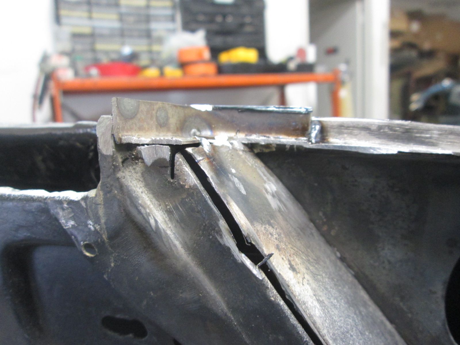

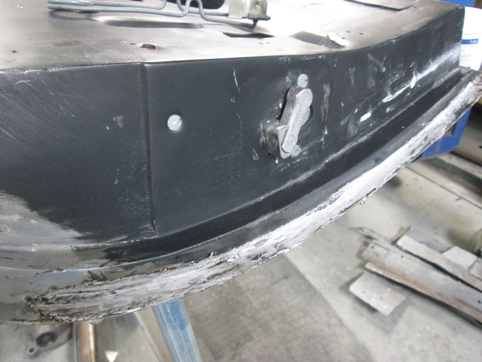

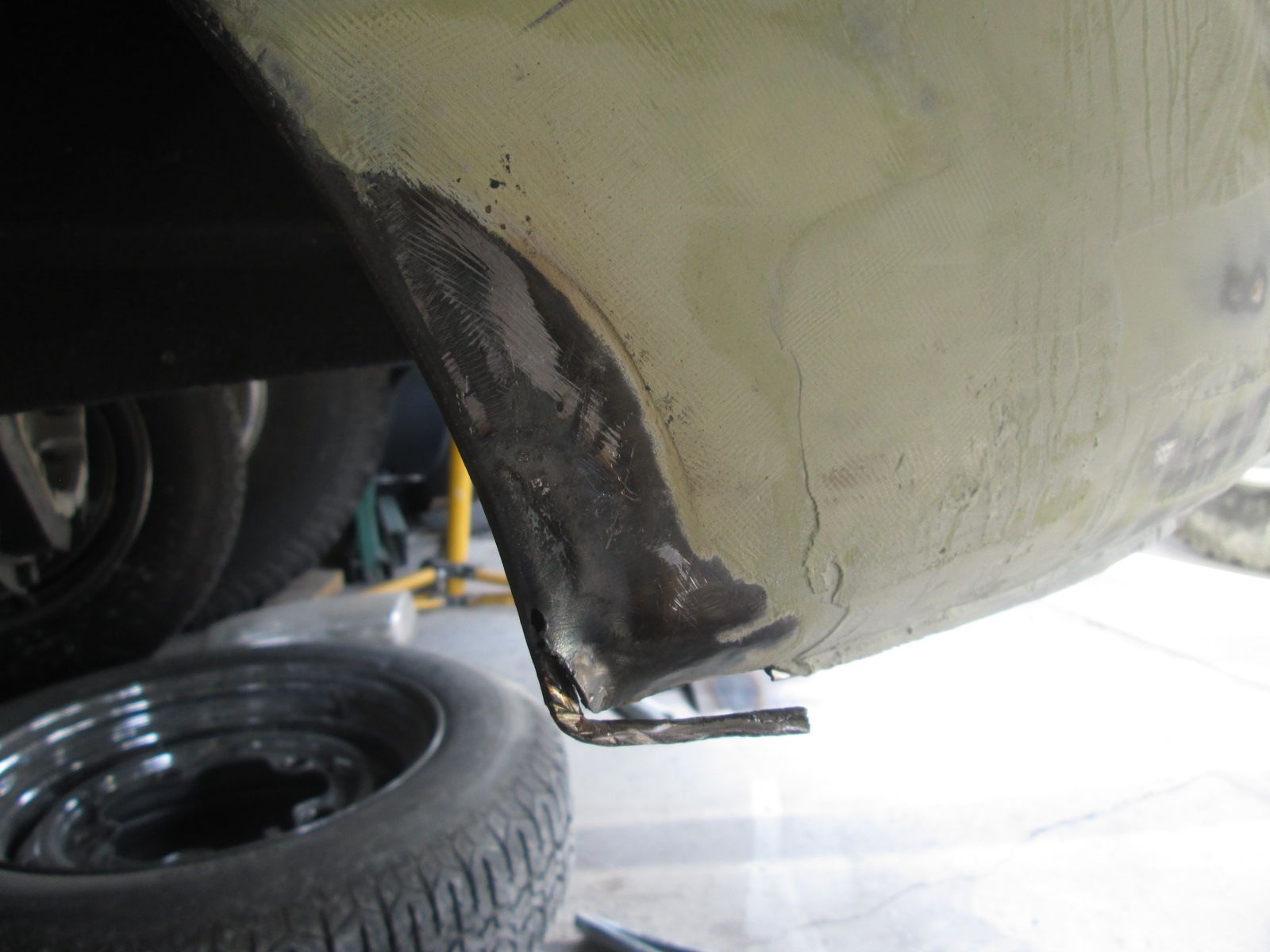

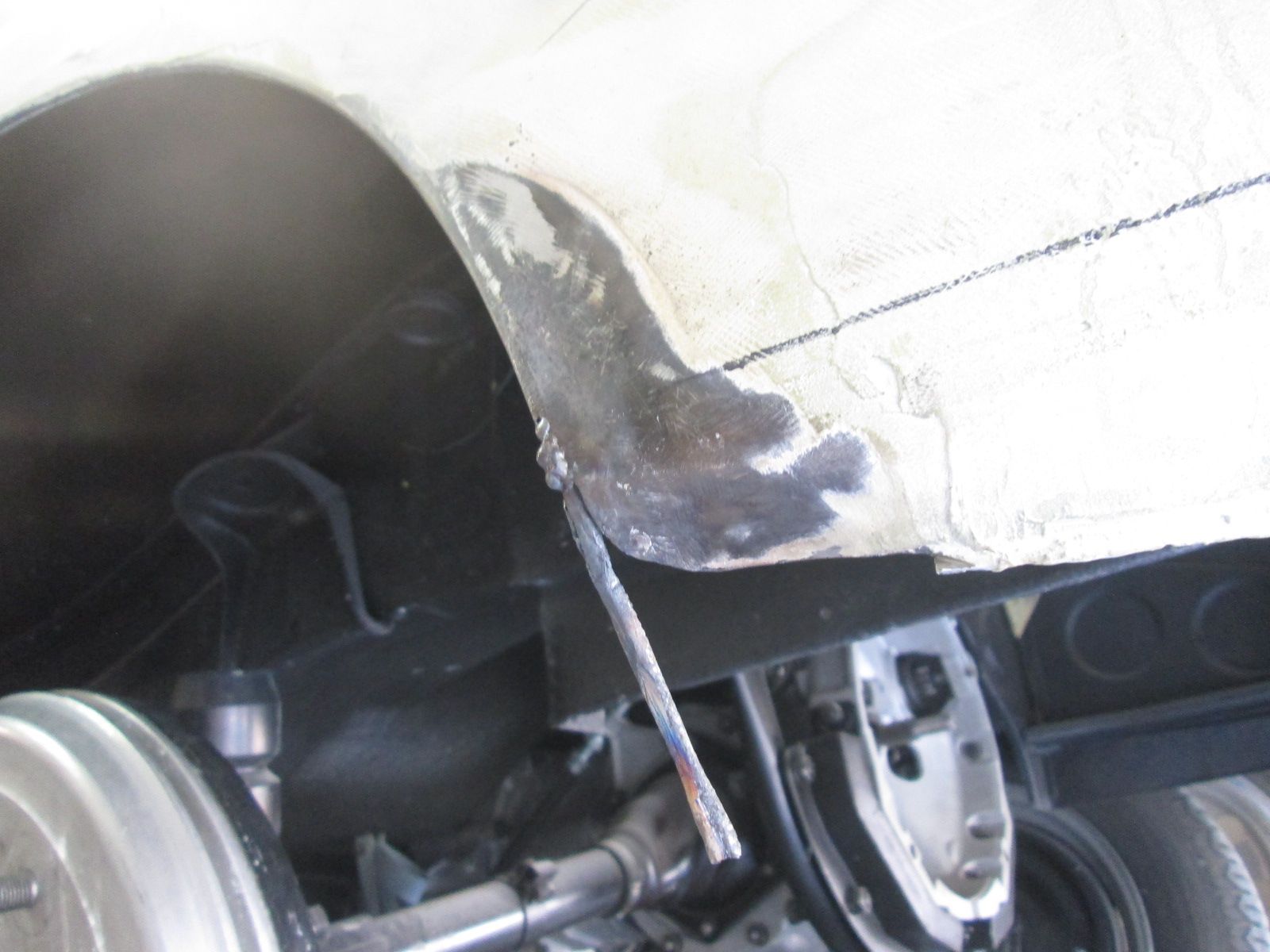

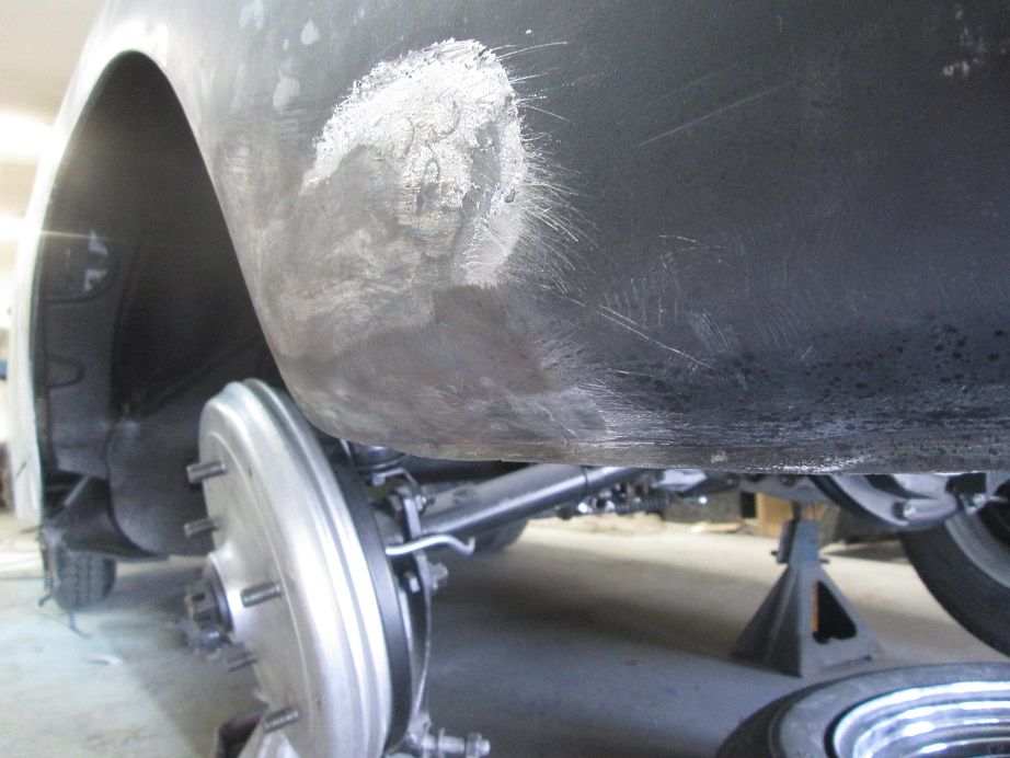

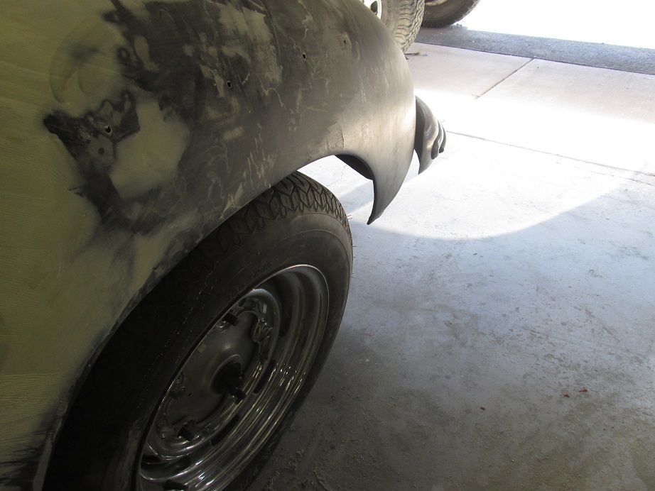

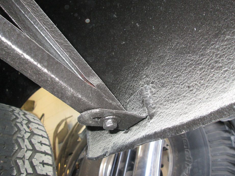

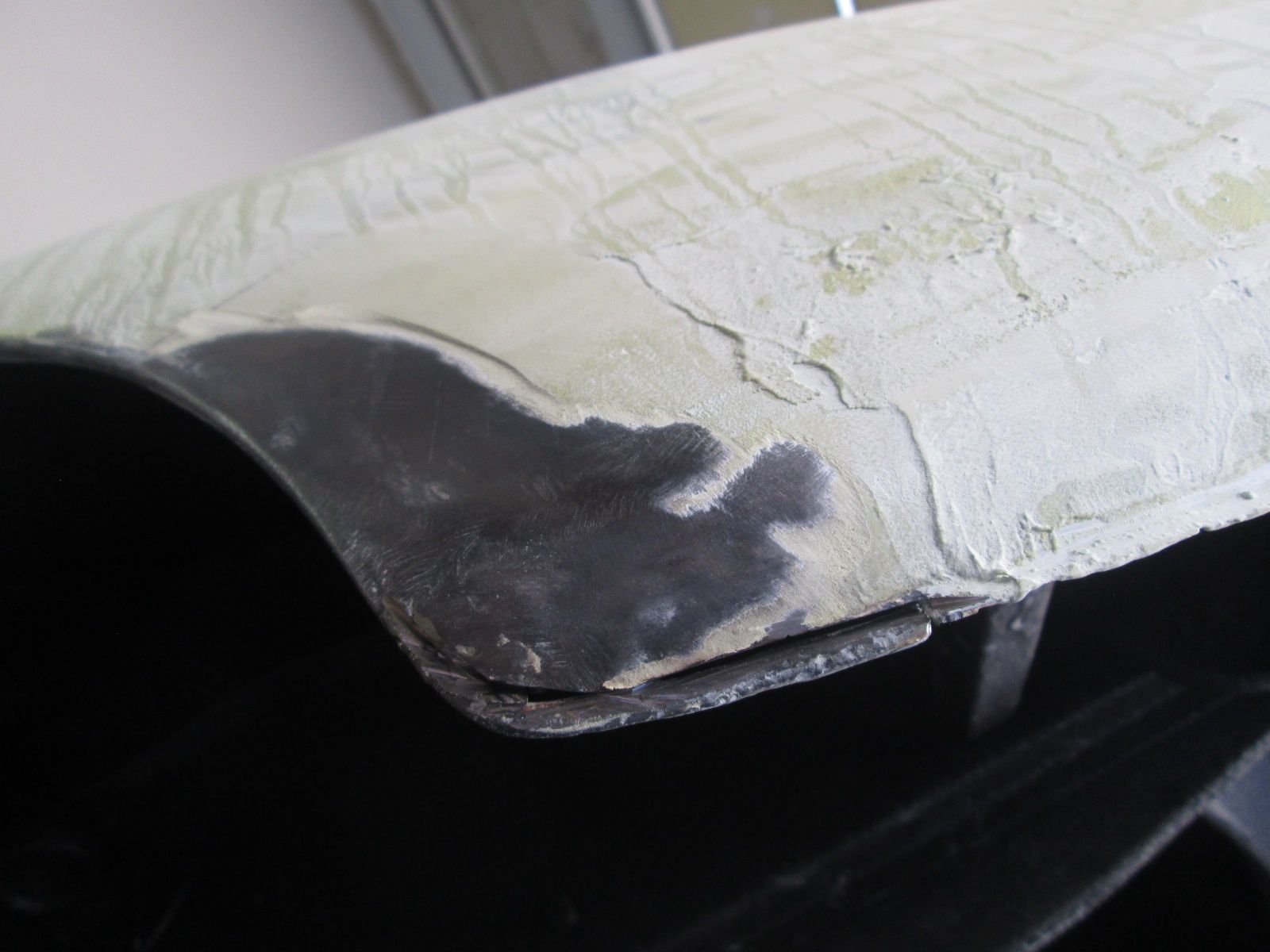

                  • Working my way towards the back.
                    Left lower corner:
                    Click image for larger version  Name:	IMG_2844.JPG Views:	0 Size:	69.5 KB ID:	106907
                    Bottom corner and lower skirt are a bit misshapen and flat from old accident damage in the distant past. Some lead was applied to the corner but to no real advantage as its still just not right.
                    Click image for larger version  Name:	IMG_2849.JPG Views:	0 Size:	69.7 KB ID:	106908
                    Confirmation again came from an OG reference example.
                    Click image for larger version  Name:	IMG_2850.JPG Views:	0 Size:	76.5 KB ID:	106909
                    Bottom lip just doesn't have that finished shape I'm used to seeing.
                    Click image for larger version  Name:	IMG_2858.JPG Views:	0 Size:	71.6 KB ID:	106910
                    Solder removed to expose exactly what was going on here. Old damage clearly shown.
                    Click image for larger version  Name:	IMG_2862.JPG Views:	0 Size:	141.2 KB ID:	106911

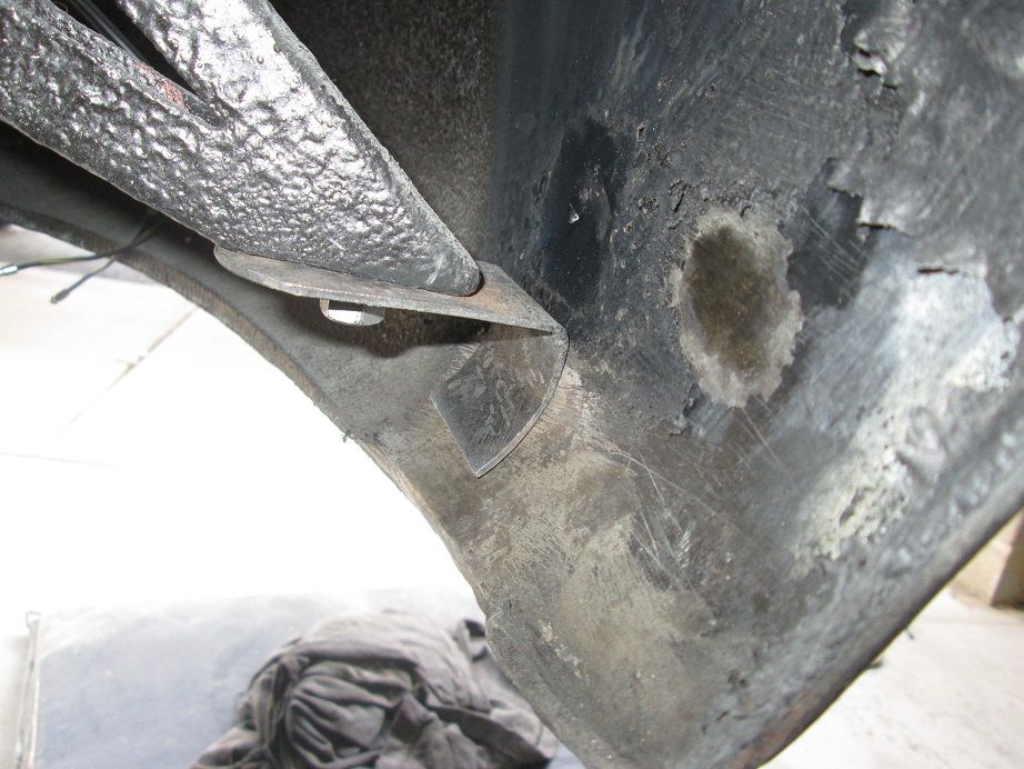

                    As work progressed I was noticing the corner lip seemed a little loose. I thought the bolt might need some tightening but I soon learned that the tang itself was not attached to the skin. Only the outward pressure was making it seem as though it was connected. Didn't pick it up immediately but it soon dawned on me that the tang itself had been mounted upside down as well. The mounting portion should be down low (as shown here) in the turn where the strength is. Not up into the "flats" of the skin where those plug welds that did not take are in this shot. At least I didn't have to break it free to correct. More later...
                    • Justin, What a job this turned out to be, but it will be a great result. Tangs mounted upside down I don't know what you can uncover sometimes.
                        Hi Roy, Yes, a lot more steel work than I imagined; I was just supposed to get it in paint....

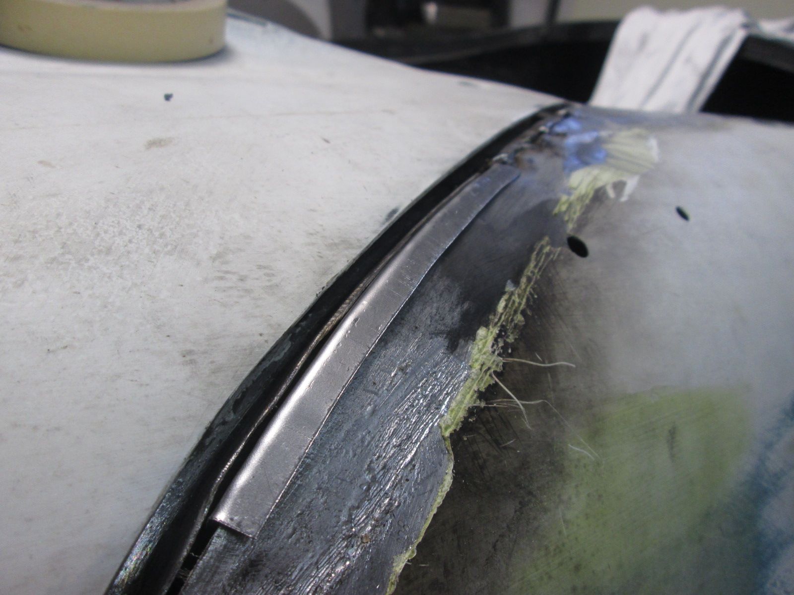

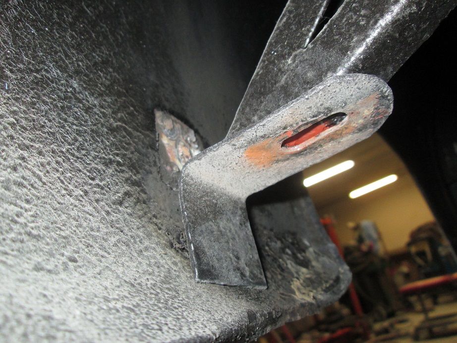

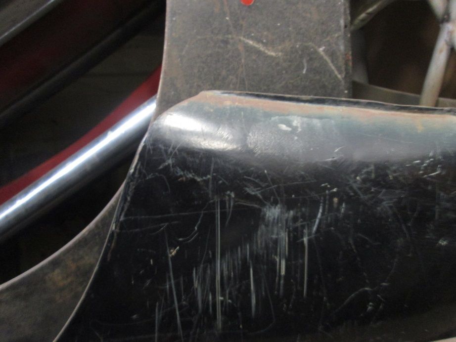

                    • Click image for larger version  Name:	IMG_2863.JPG Views:	0 Size:	162.0 KB ID:	106914
                      Finding all sorts of crazy things along the way Roy. At best they where at least consistent side to side as the right tab has been installed upside down as well. This one looks attached however with a considerable lap weld. Will take a little more doing to correct this one but I haven't crossed this bridge yet.
                      Click image for larger version  Name:	IMG_2864.JPG Views:	0 Size:	92.9 KB ID:	106915

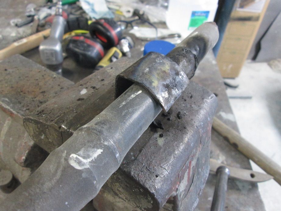

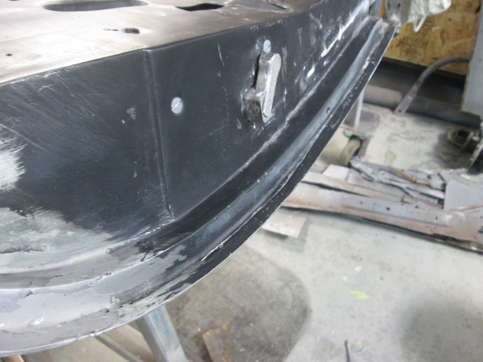

                      Recurving the tang profile to match the roll I'll be putting back into the lower skirt.
                      Click image for larger version  Name:	IMG_2865.JPG Views:	0 Size:	111.6 KB ID:	106916
                      Both parts curved with tang mocked up into bolted position. That is what I'm used to seeing in here...

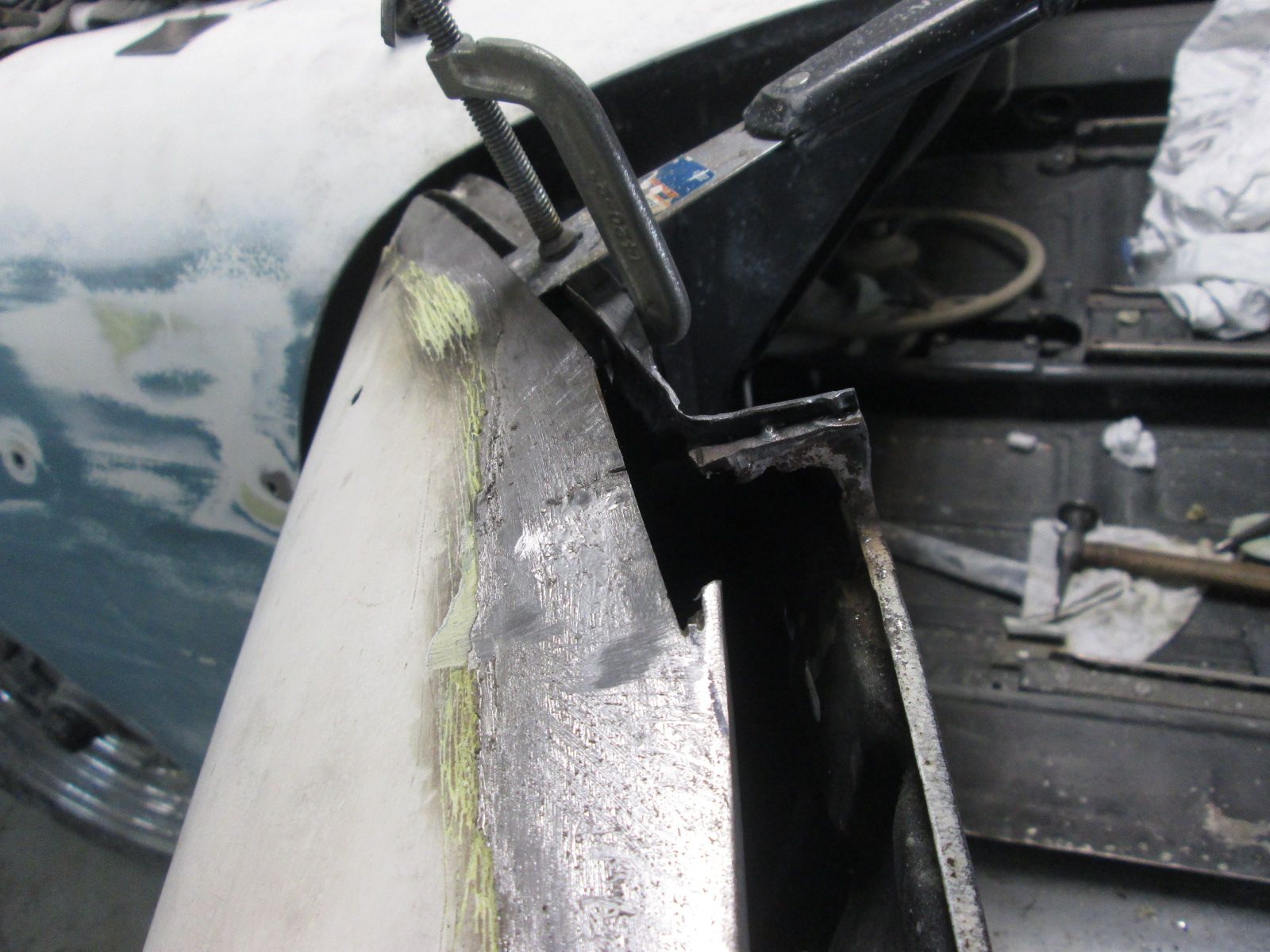

                      Click image for larger version  Name:	IMG_2872.JPG Views:	0 Size:	87.2 KB ID:	106917
                      Profile is most of the way there but the wired corner is giving me fits. Have to get the fender stabilized before I can go further with that.
                      Click image for larger version  Name:	IMG_2873.JPG Views:	0 Size:	79.1 KB ID:	106918
                      Ready to plug weld the tang back so I can get this fender supported and stabilized then its onto correcting the corner.

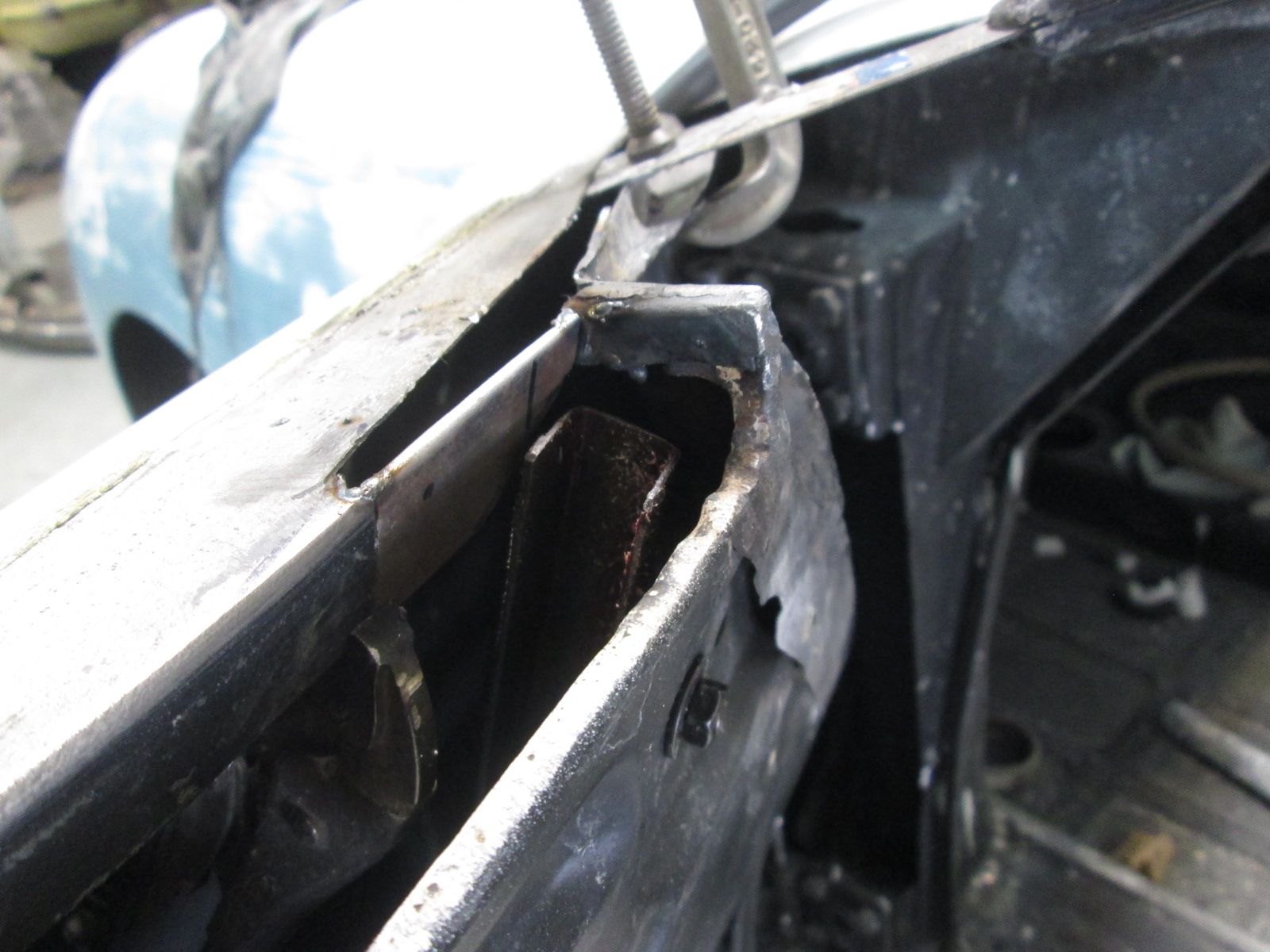

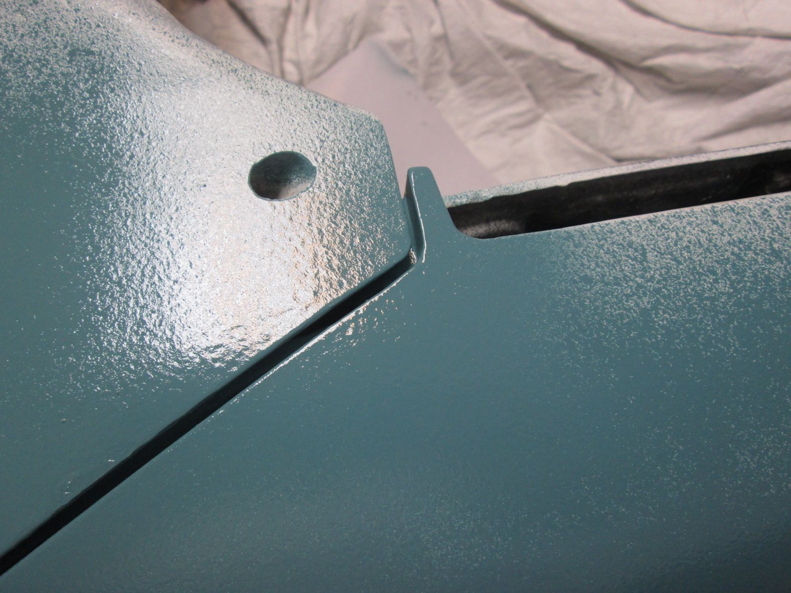

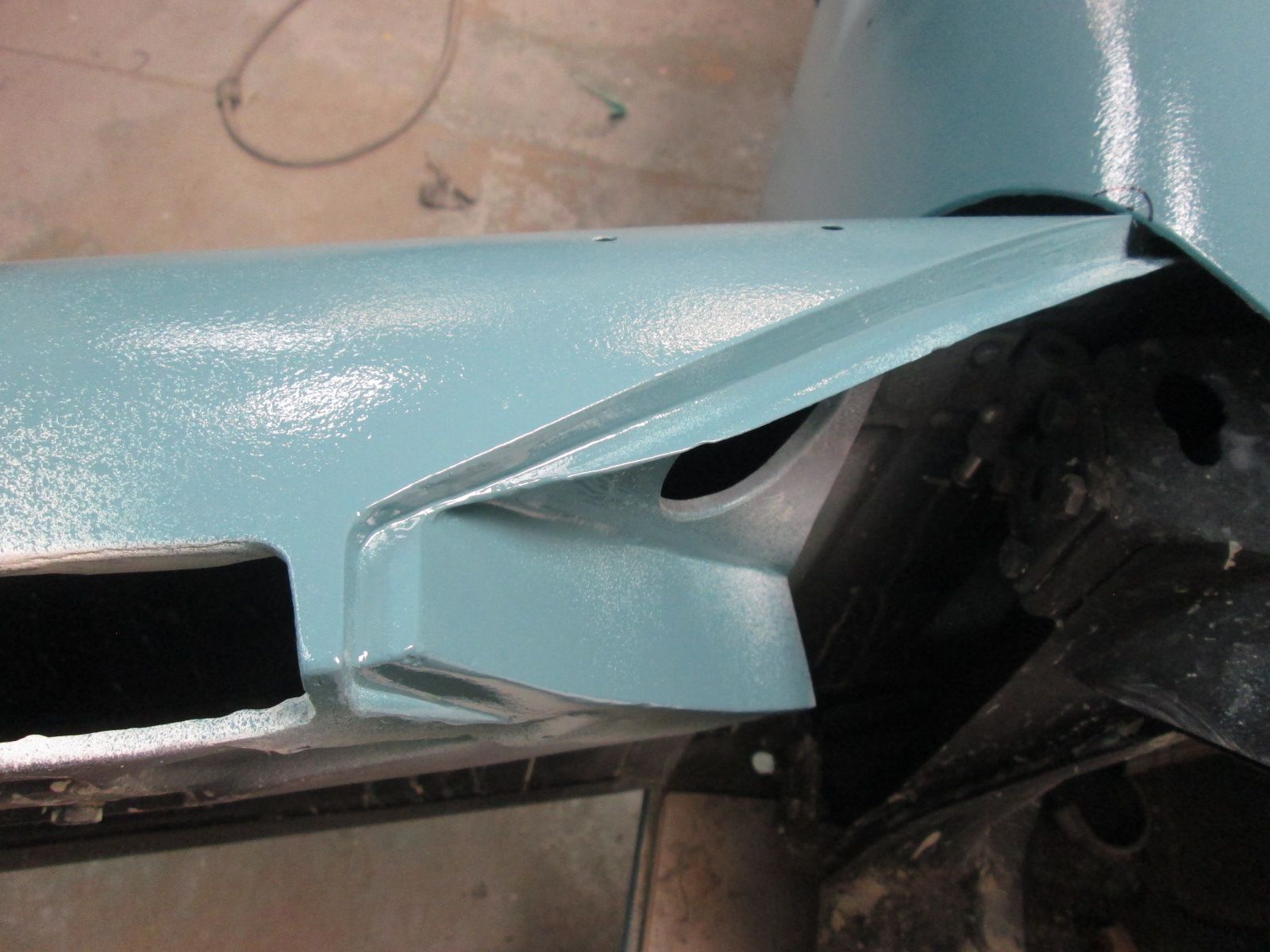

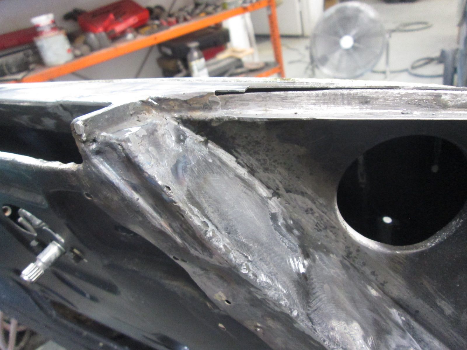

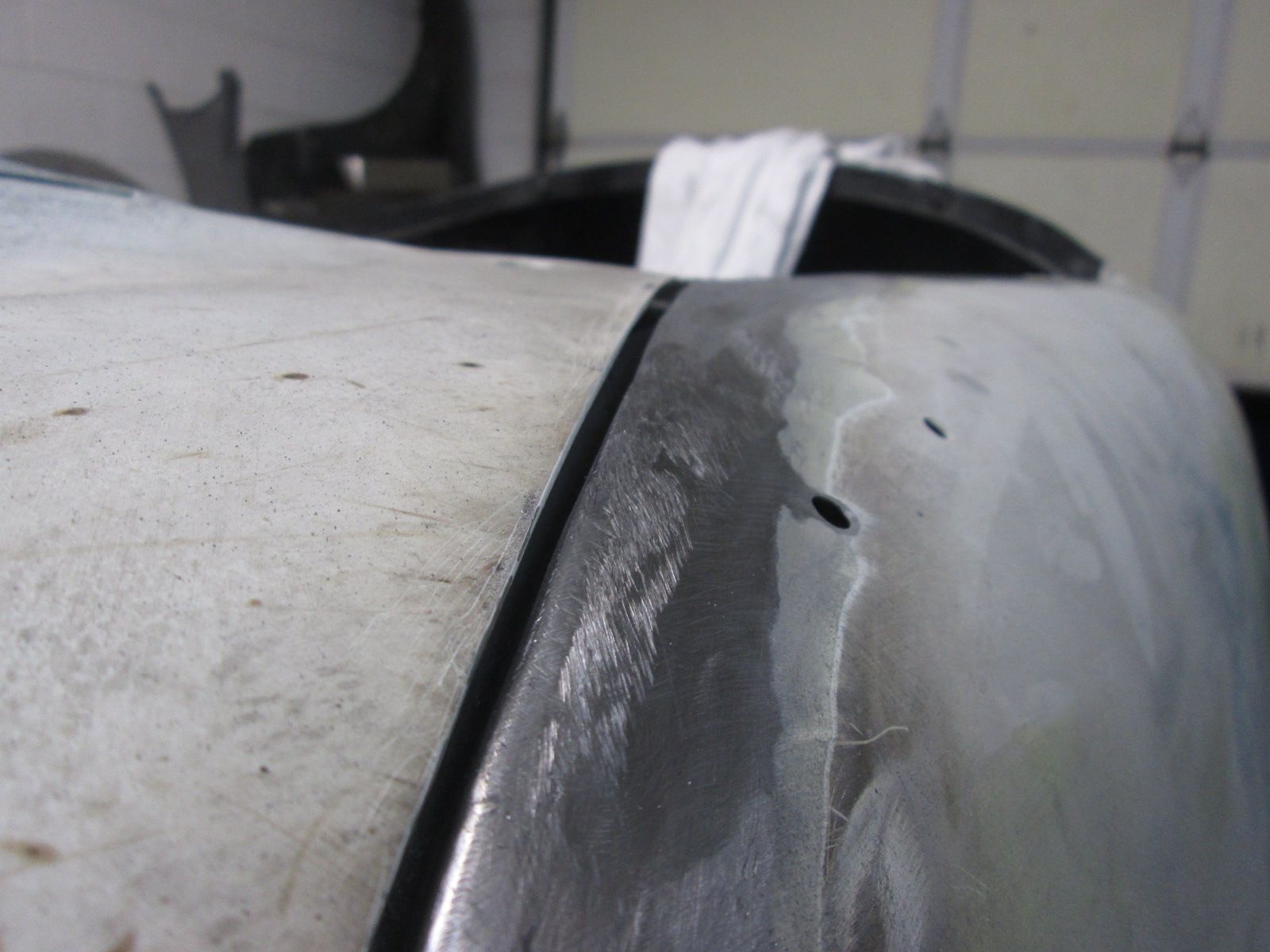

                      • Finishing out the rest of the left rear corner.
                        Click image for larger version  Name:	IMG_3472.JPG Views:	0 Size:	144.2 KB ID:	106963 Wire lip was now working against me and holding the flattened post accident shape. Easiest thing to do was to cut it free and break its back so I could reset it to the shape I was after.
                        Click image for larger version  Name:	IMG_3477.JPG Views:	0 Size:	143.5 KB ID:	106964 edge above the cut line was also rolling inward and tapering too fast in relation with the rest of the skin. I can't have this edge thick with filler to regain that line nor do I want a chamfered edge in the reflection of the eventual paint job if I left it alone. I'm looking to have the reflection end uniformly at the lip all the while not appearing loaded heavily with filler. Heating and rolling this lip outward here.
                        Click image for larger version  Name:	IMG_3484.JPG Views:	0 Size:	167.6 KB ID:	106965 Upper edge set and now beginning to reattach and reshape the wire lead.
                        Click image for larger version  Name:	IMG_3496.JPG Views:	0 Size:	165.9 KB ID:	106966 Just a skim coat now needed to carry the line all the way to the lip.
                        Click image for larger version  Name:	IMG_3501.JPG Views:	0 Size:	121.5 KB ID:	106967 corner fully welded, reshaped and dressed. A little solder added here to catch the remaining imperfections. All set and ready for some sealer. Onto the next deal.
                        • That series of photos explain well the work needed. It makes it look so easy to do. Of it takes hours and hours to do! Justin just how many people are asking you if they can join a queue with their 356!
                          Well done!
                            Thank you Roy! Sometimes its just easier to cut it free rather than wrestle with it as one piece. Especially these wired edges. Justin
