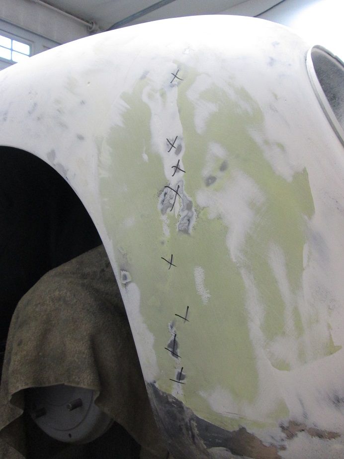

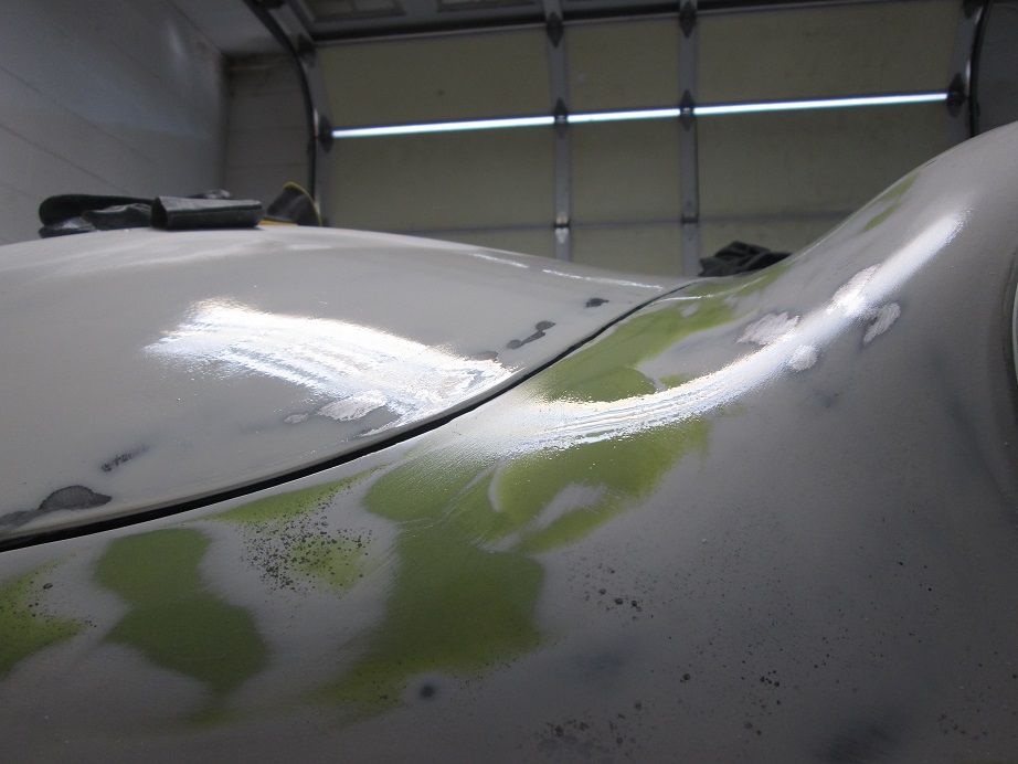

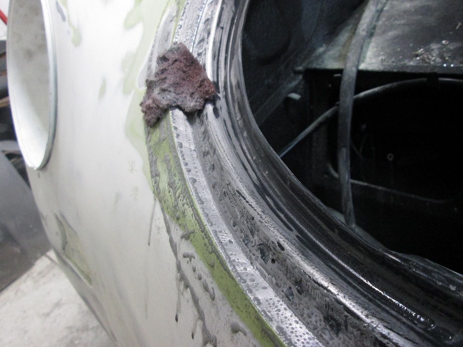

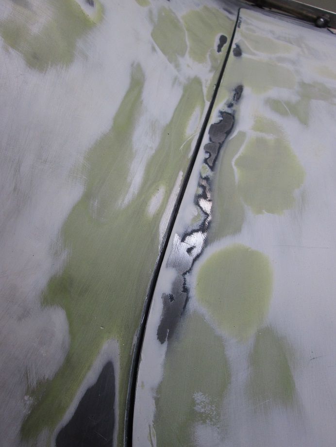

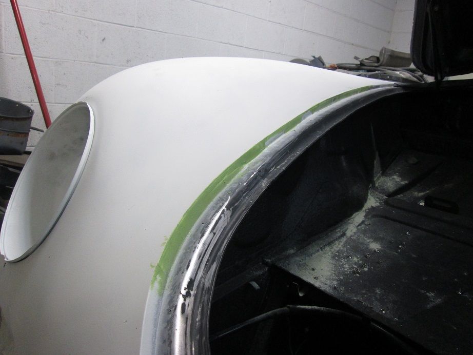

    Series of high spots along the weld joint in need of some heat shrinking.
    Now I can thin down the filler surrounding these spot.

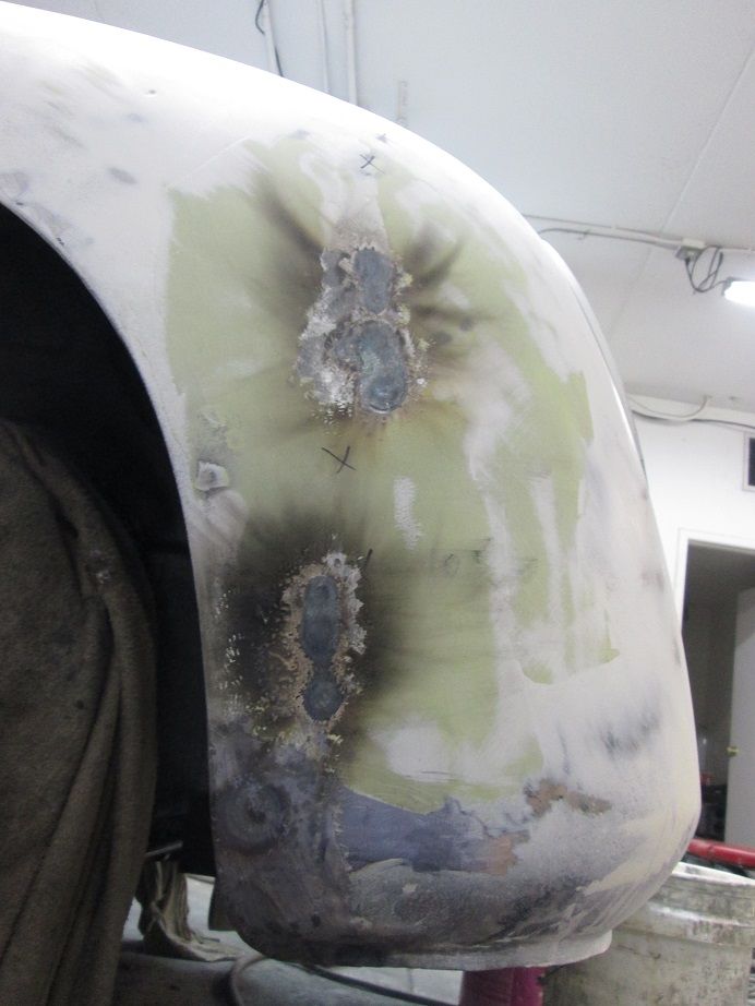

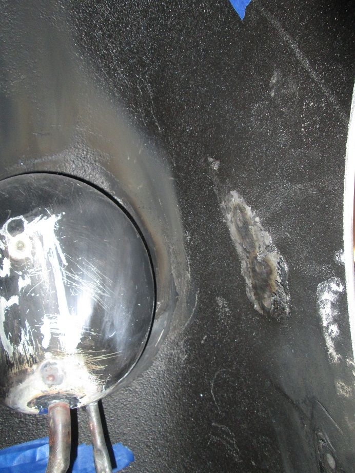

    Obliterating more of the rocker shootz but no choice.

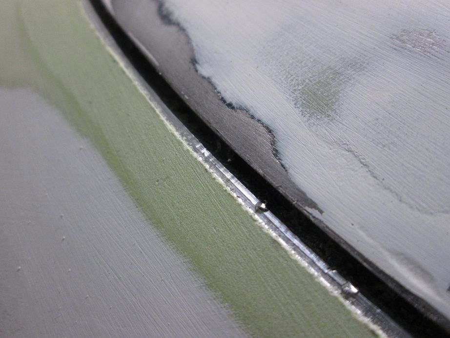

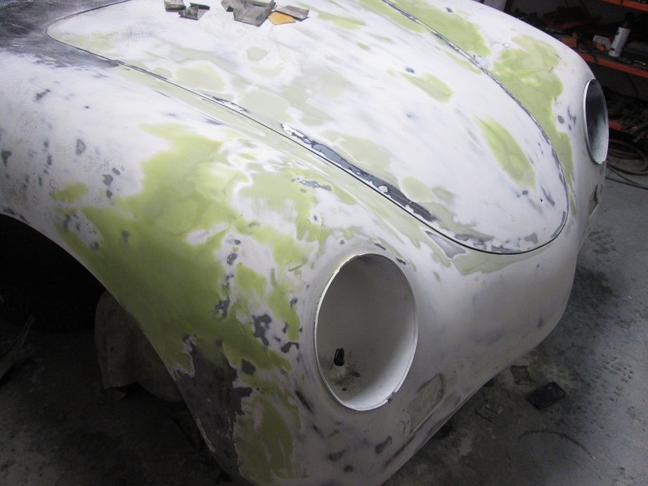

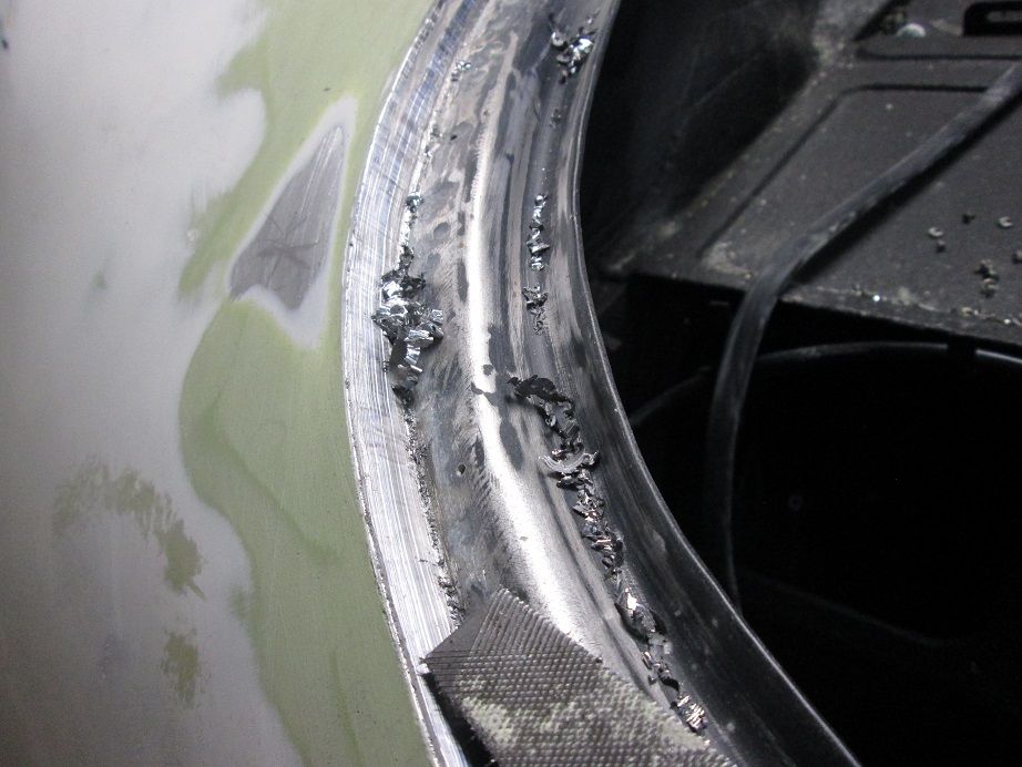

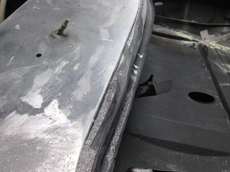

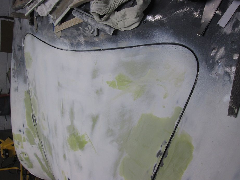

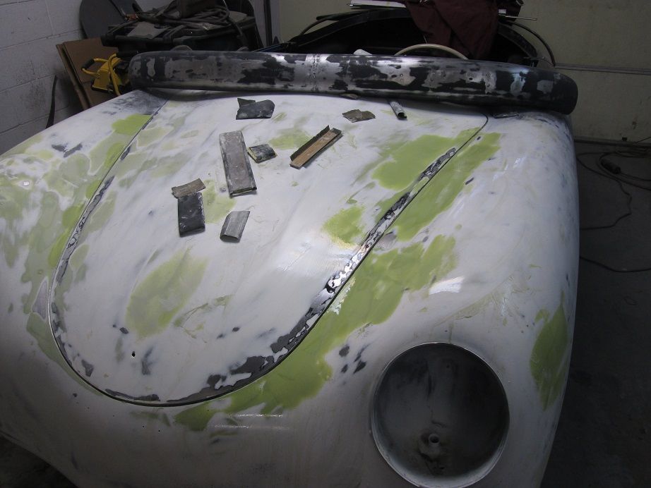

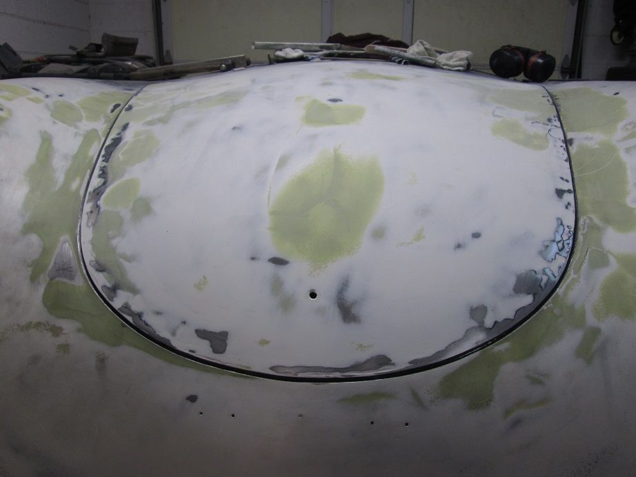

      Widening the hood gap.
      Click image for larger version  Name:	IMG_1620.JPG Views:	0 Size:	89.7 KB ID:	105868
      I prefer a smaller and tighter gap and I have let my personal preference lead me astray for a while. After going over an old discussion I had with Bruce Baker it became clear that I needed to widen this gap by at least another MM. Final gaps should be in the 3mm range +or- so a raw initial gap should be approaching 4mm so by the time you account for primer and final paint thickness your in this 3mm width range. This flat bastard file pictured above is just shy of 4mm and made for a perfect tracer scribe.

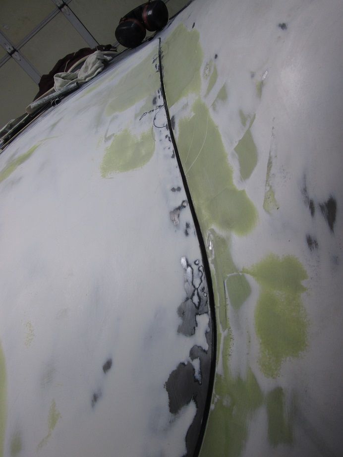

      Click image for larger version  Name:	IMG_1622.JPG Views:	0 Size:	86.9 KB ID:	105869
      Scribing around the back corners as even though the hood was moved forward these still ran tight. Lots of solder used in this area.
      Click image for larger version  Name:	IMG_1623.JPG Views:	0 Size:	81.6 KB ID:	105870
      newly established scribe line down front. The gaps would have been way too tight after final paint. Just fine for my personal taste but not correct.
      Click image for larger version  Name:	IMG_1626.JPG Views:	0 Size:	84.5 KB ID:	105871
      Now to bring the rest of the surface down level.
      Click image for larger version  Name:	IMG_1624.JPG Views:	0 Size:	98.1 KB ID:	105872
      Hood and seal removed (yet again) to allow plenty of unobstructed light so I could see what I was doing.

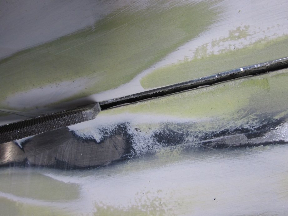

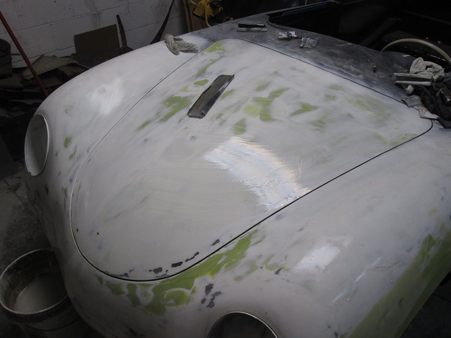

      • #65

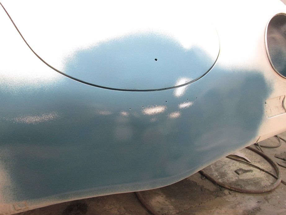

        Click image for larger version  Name:	IMG_1628.JPG Views:	0 Size:	86.8 KB ID:	105874
        Carefully whittling it down one pass at a time.
        Click image for larger version  Name:	IMG_1629.JPG Views:	0 Size:	89.3 KB ID:	105875
        A very slow and tedious process but getting there a section at a time. Surface to the left chased even.
        Click image for larger version  Name:	IMG_1655.JPG Views:	0 Size:	92.9 KB ID:	105876

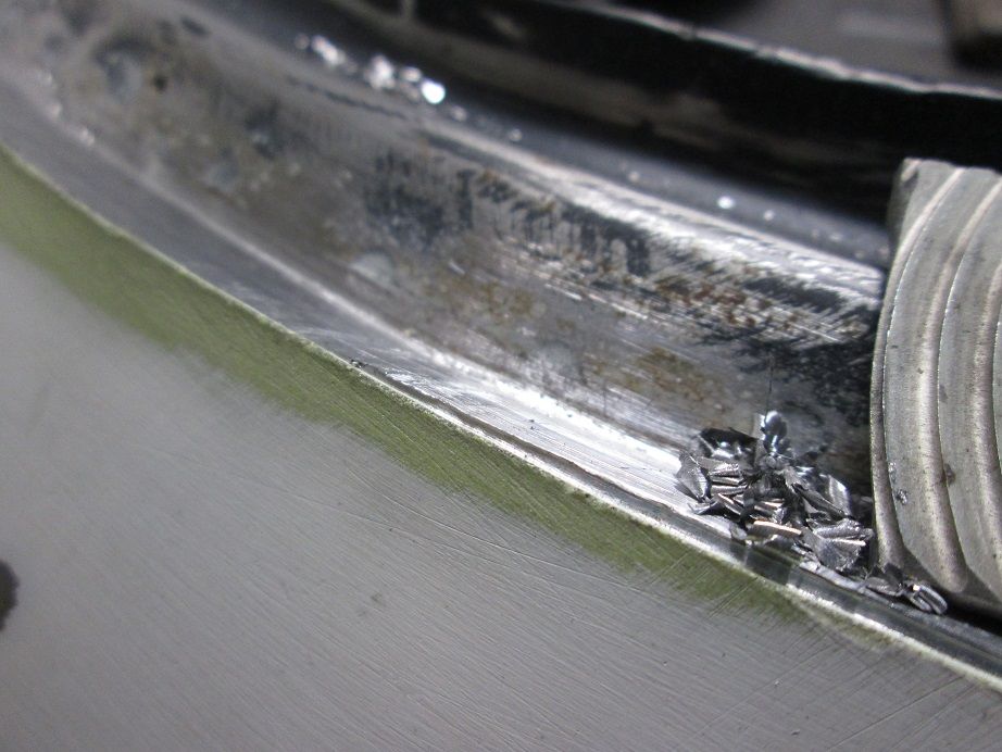

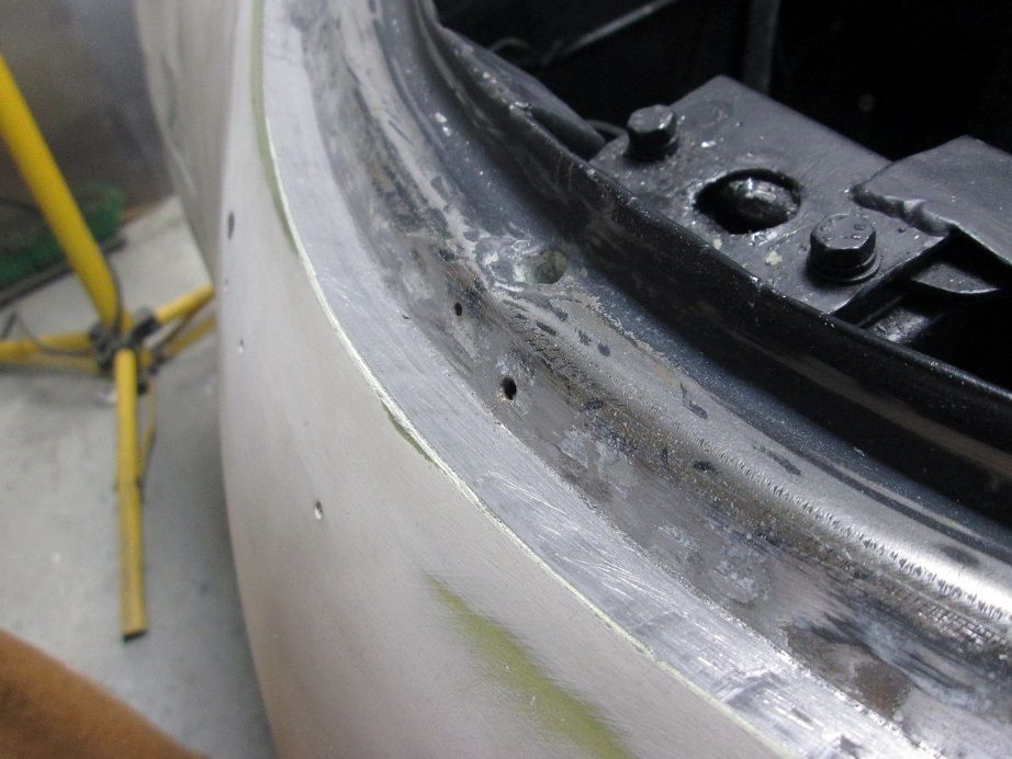

        This was small drain hole that opened at level with the initial surface when it arrived. As you can see a good 4mm now shaved off.
        Click image for larger version  Name:	IMG_1656.JPG Views:	0 Size:	89.4 KB ID:	105878
        Nose all but carved out now heading up the sides.

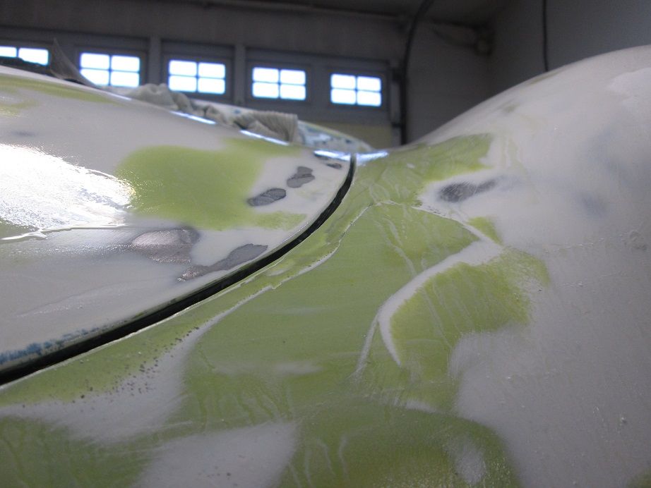

        • #66
          Newly widened gaps complete
          Click image for larger version  Name:	IMG_1663.JPG Views:	0 Size:	56.0 KB ID:	105880
          Opened a lot more generously than I like but its even and uniform on both sides and they'll only get narrower from here.
          Click image for larger version  Name:	IMG_1661.JPG Views:	0 Size:	63.9 KB ID:	105881
          Click image for larger version  Name:	IMG_1662.JPG Views:	0 Size:	53.4 KB ID:	105882
          Click image for larger version  Name:	IMG_1664.JPG Views:	0 Size:	77.4 KB ID:	105883
          Sides seem even with the rear but actually the rear gap runs a little too wide (after the earlier hood adjustment)and will be addressed later. One disaster at a time.

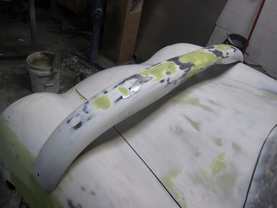

              The following session blocking and bodywork phase begins on the bumper. Fortunately it didn't require a whole lot.
              Simultaneously blocking the latest sealer coat.

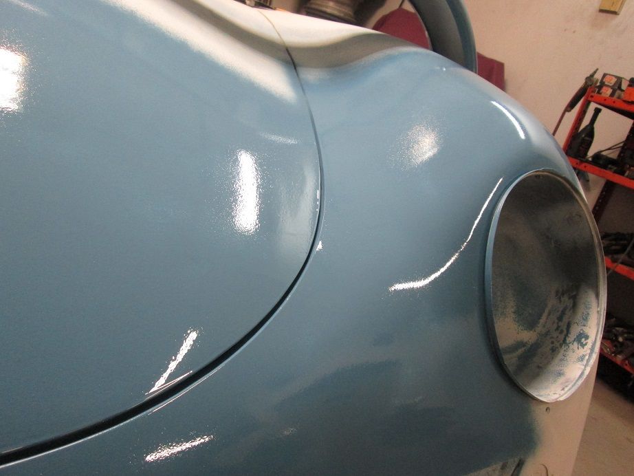

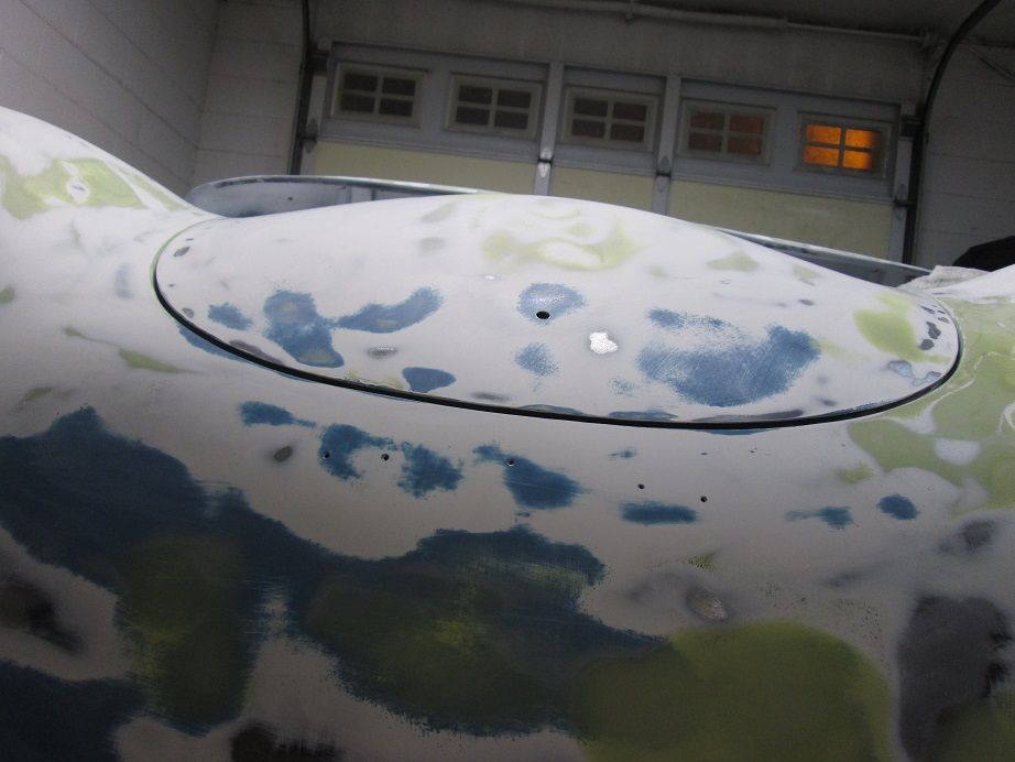

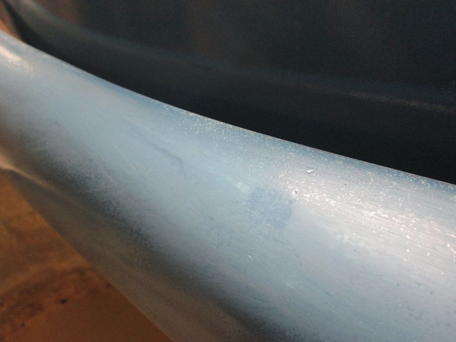

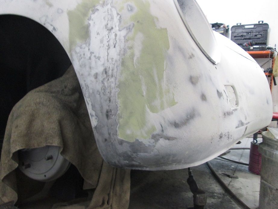

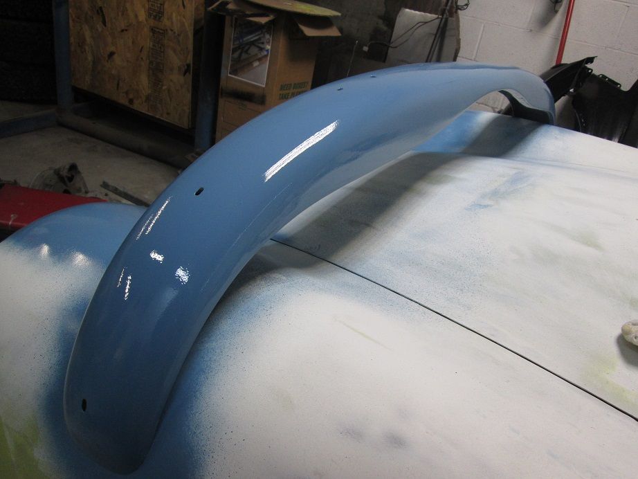

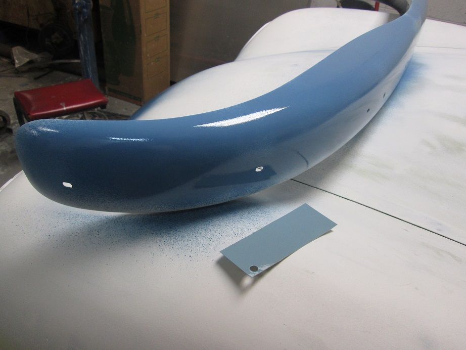

                First little test coat:
                Click image for larger version  Name:	IMG_1735.JPG Views:	0 Size:	62.3 KB ID:	105897
                Getting down to the nitty gritty
                Click image for larger version  Name:	IMG_1736.JPG Views:	0 Size:	67.4 KB ID:	105898
                Slicking the nicks and chips down in the jamb surface that will show.
                Click image for larger version  Name:	IMG_1708.JPG Views:	0 Size:	125.1 KB ID:	105899

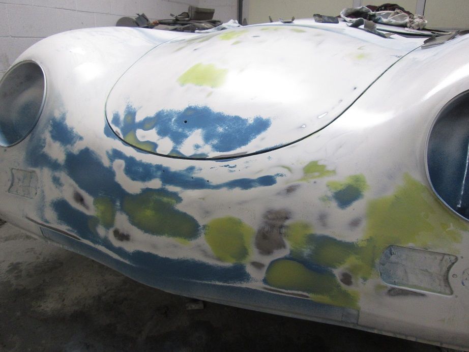

                At this point I need a little feedback in color so I'm mixing some old stuff together for an initial tracer coat. Man, some of this stuff goes back 15 years so it nice to be able to finally put it to some useful purpose.
                Click image for larger version  Name:	IMG_1743.JPG Views:	0 Size:	62.6 KB ID:	105900
                Front bumper was shot first. Turned out a little darker than this Meissen blue sample but for this job it just needs to be in the same family. We'll call this version "nice -n- blue".
                Click image for larger version  Name:	IMG_1741.JPG Views:	0 Size:	68.3 KB ID:	105901
                Only mixed up enough this time to get the bumper thoroughly coated but had just enough left over for a teaser; I was anxious to see the front in a little color.

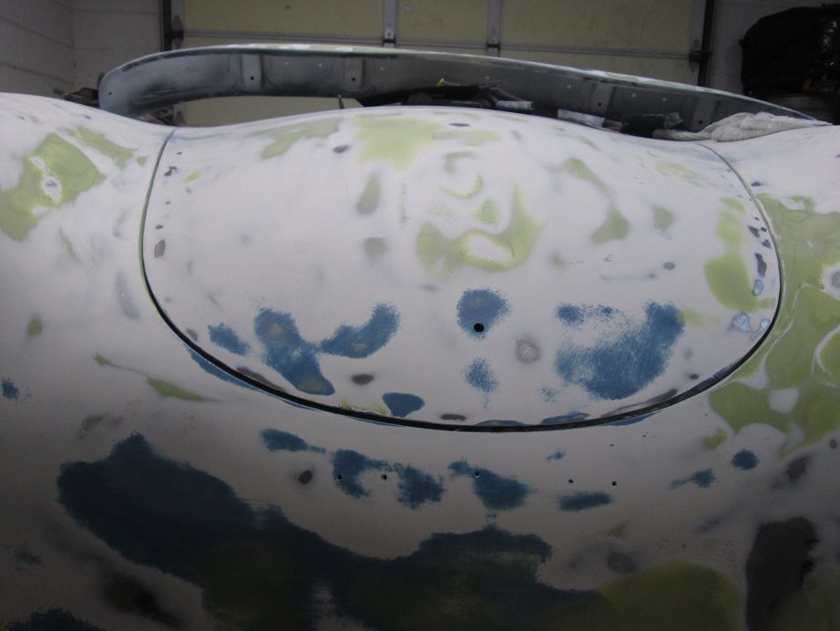

                  Super thin though and translucent. I just can't stand leaving waves and rollers in the reflection.

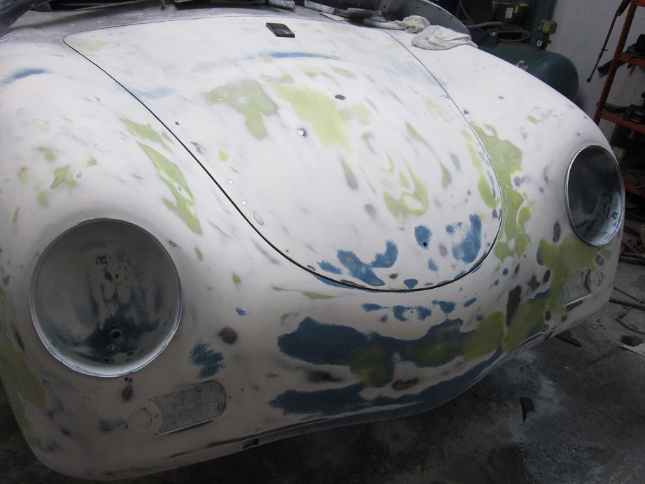

                  • #71
                    Front block sanding continues

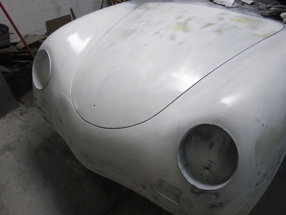

                    Click image for larger version  Name:	IMG_1783.JPG Views:	0 Size:	80.2 KB ID:	105910
                    Swatching in some areas
                    Click image for larger version  Name:	IMG_1785.JPG Views:	0 Size:	63.4 KB ID:	105911
                    But in other areas like this trough I am pushing to make the fillers and top coats as thinned out as possible without going backwards and losing the shape or contour. I've gone through several layers though here. The body is getting better while the filler is getting thinner. Gotta love that..
                    Click image for larger version  Name:	IMG_1787.JPG Views:	0 Size:	58.7 KB ID:	105912
                    Pushed the front as far as I can.
                    Click image for larger version  Name:	IMG_1788.JPG Views:	0 Size:	63.4 KB ID:	105913
                    Getting used to the gaps. What matters most is that it is consistent and even throughout.
                    Click image for larger version  Name:	IMG_1786.JPG Views:	0 Size:	75.6 KB ID:	105914
                    Another coat of sealer and a quick color coat next.

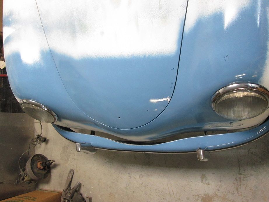

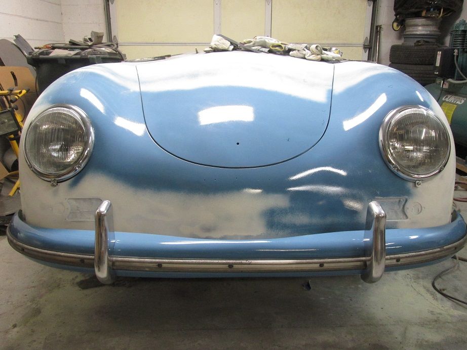

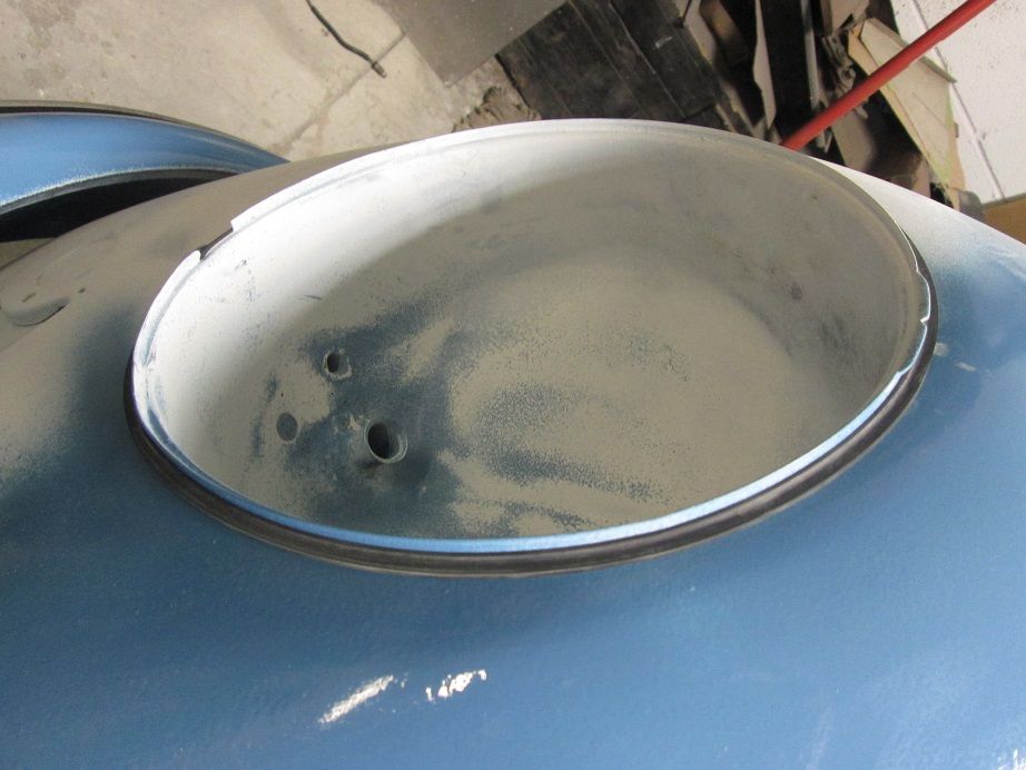

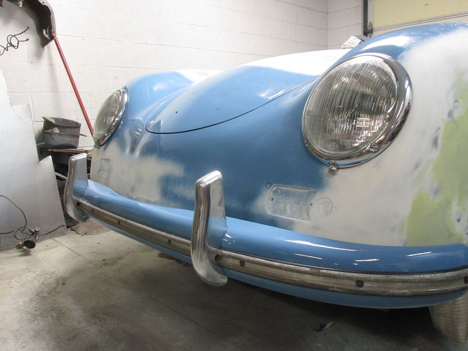

                      Once everything dried I mocked up the front bumper completely just to make sure. All that's left now is to sand this coat smooth and shoot the final color on.
                      • #74
                        Quick front end mock up
                        While I was at it I thought I'd mock up the headlamps too.
                        Base seals snug in nicely.
                        Head lamps seat down fully with the seals in. So far so good.
                        Happy with the final bumper fitment as well.
                        The consistent reflection across that hood gap was very promising.
                        Onto the back of the hood to cowl next. A whole new adventure.

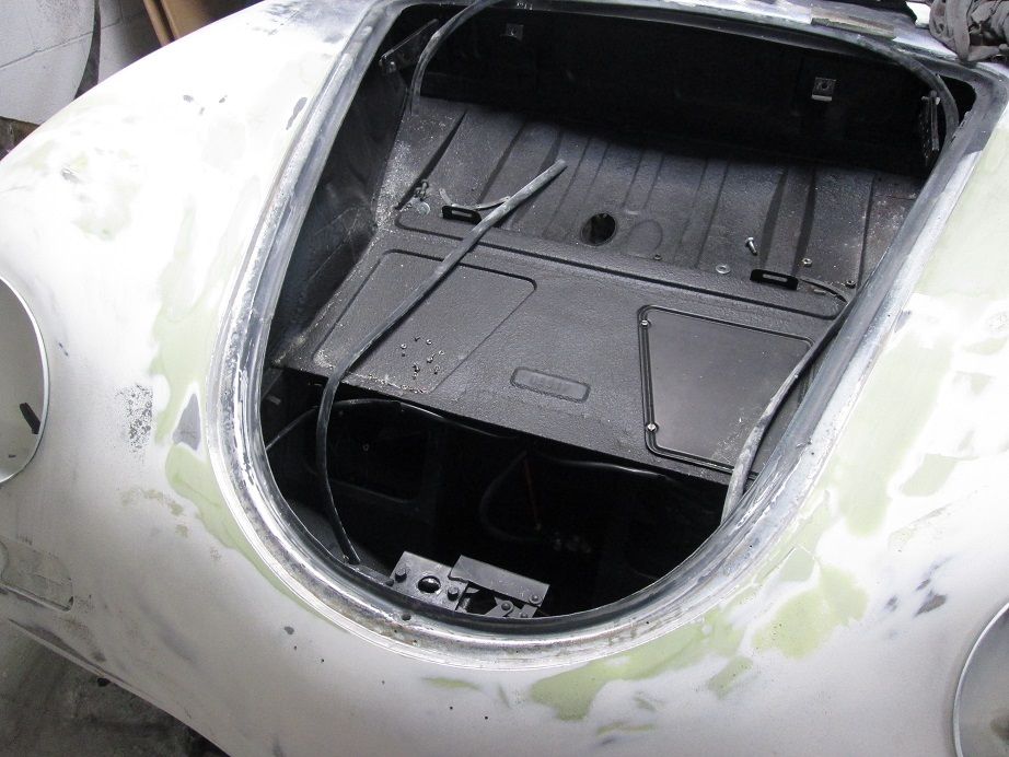

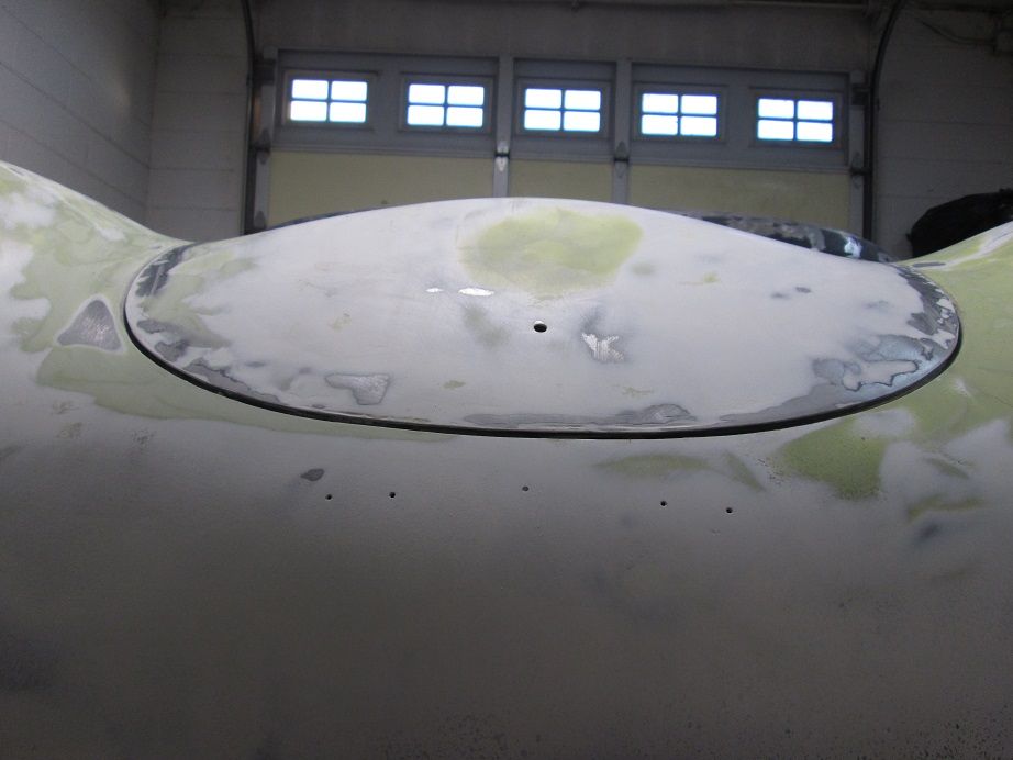

                          Onto the front cowl to hood transition issue.

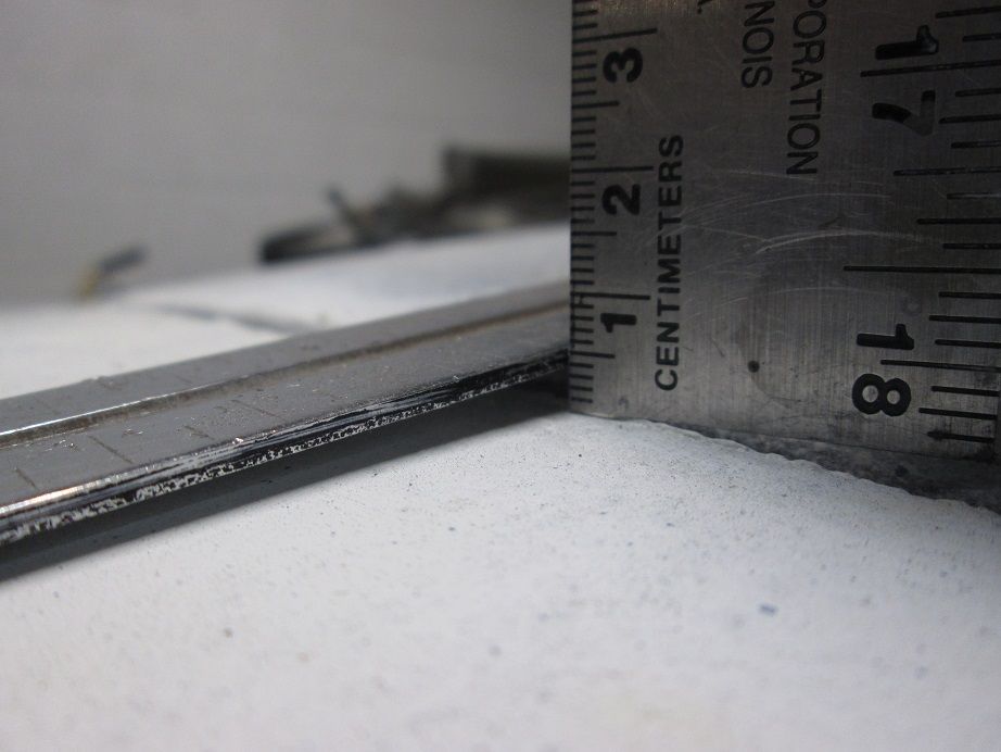

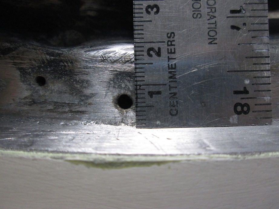

                          Click image for larger version  Name:	IMG_1838.JPG Views:	0 Size:	45.0 KB ID:	105939
                          Now with the hood all but set at the front and up the sides it was now time to face this rear misalignment and transitional contour issue. Both the back edge of the hood and the leading edge of the cowl are curling downward as they meet.

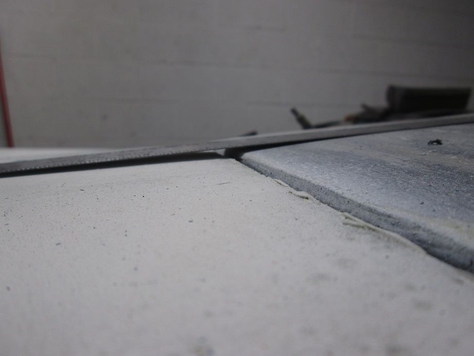

                          Click image for larger version  Name:	IMG_1839.JPG Views:	0 Size:	60.2 KB ID:	105940
                          Looking at about a 4MM height discrepancy from the hood up to the cowl. Both back corners are close its just really low in the middle.Click image for larger version  Name:	IMG_1847.JPG Views:	0 Size:	74.1 KB ID:	105941
                          Certainly unacceptable to have a 4MM+ of filler on the edge of this hood so I was exploring my options. Began first by attempting to tap up the leading edge.

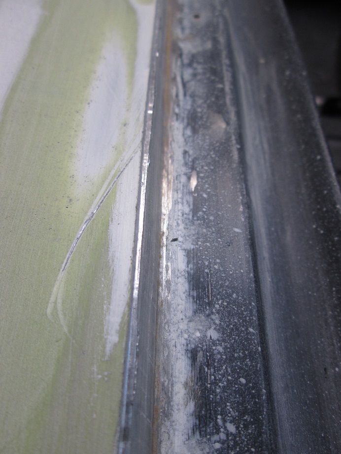

                          Click image for larger version  Name:	IMG_1848.JPG Views:	0 Size:	59.4 KB ID:	105942
                          The result was mixed at best. The very edges of the two panels where more even but as you can see there was a sway-back profile; completely unacceptable. My next thought was to file the holes in the hinge and bring the entire back end up. This would have turned the trick here and smoothed this area out but in doing so would force the nose of the hood downward completely destroying the line and contour I just spent all that time on correcting. This was an oversight when the front end group was installed and this is pretty much the fitment on the day it was delivered here. The rake and height should have been set and established much more closely then the entire front end built around thisbase line. Well the die has obviously been set so I have to make this hood fit with what we've got.
                          Click image for larger version  Name:	IMG_1849.JPG Views:	0 Size:	124.9 KB ID:	105943
                          The hood has been raking the seal forward as it closes so this was more confirmation that the back of does need to come up. My fix coming up next.
