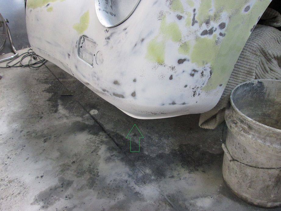

    Lower left corner contour.
    Click image for larger version  Name:	IMG_1435.JPG Views:	0 Size:	97.3 KB ID:	105625
    With the body in white the cornered edge really began looking out of place to me. (green arrow)
    Click image for larger version  Name:	IMG_1434.JPG Views:	0 Size:	53.9 KB ID:	105626
    Checking my original reference confirmed it. The corner is much more graceful and rolled under.
    Click image for larger version  Name:	IMG_1440.JPG Views:	0 Size:	70.0 KB ID:	105627
    The way the nose and fenders are set together now means that there is just too much metal here to make the turn. It has to go somewhere so this excess forces the corner down to make the turn.

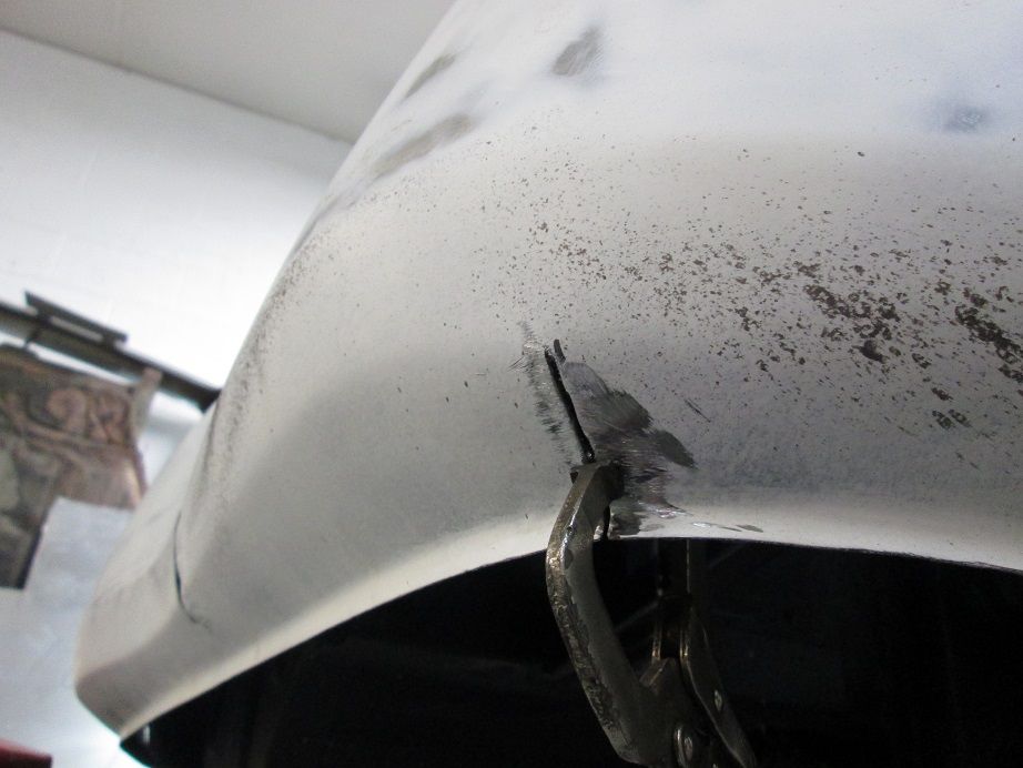

    A quick relief cut fixes that.

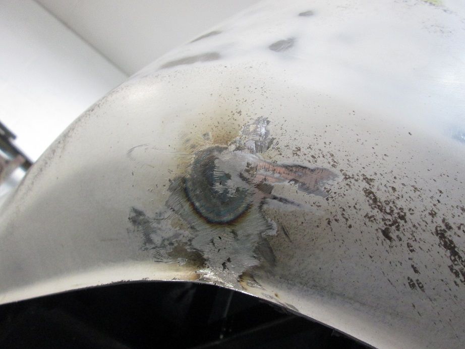

    Click image for larger version  Name:	IMG_1441.JPG Views:	0 Size:	87.8 KB ID:	105628

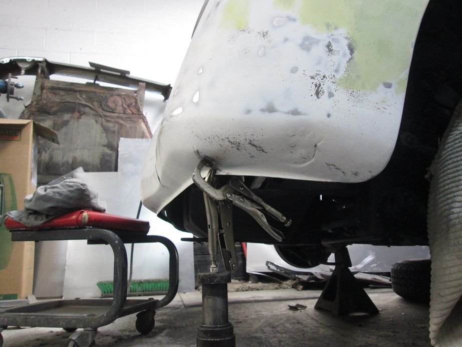

    Just about ready to throw on a tack weld but I wanted the corner loaded and set where I need it before I joined it back together. Bottle jack pushes it up where I'd like it.
    Click image for larger version  Name:	IMG_1443.JPG Views:	0 Size:	73.9 KB ID:	105629
    Welded and dressed. Still required a heat shrink spot to soften the turn. Stubborn...

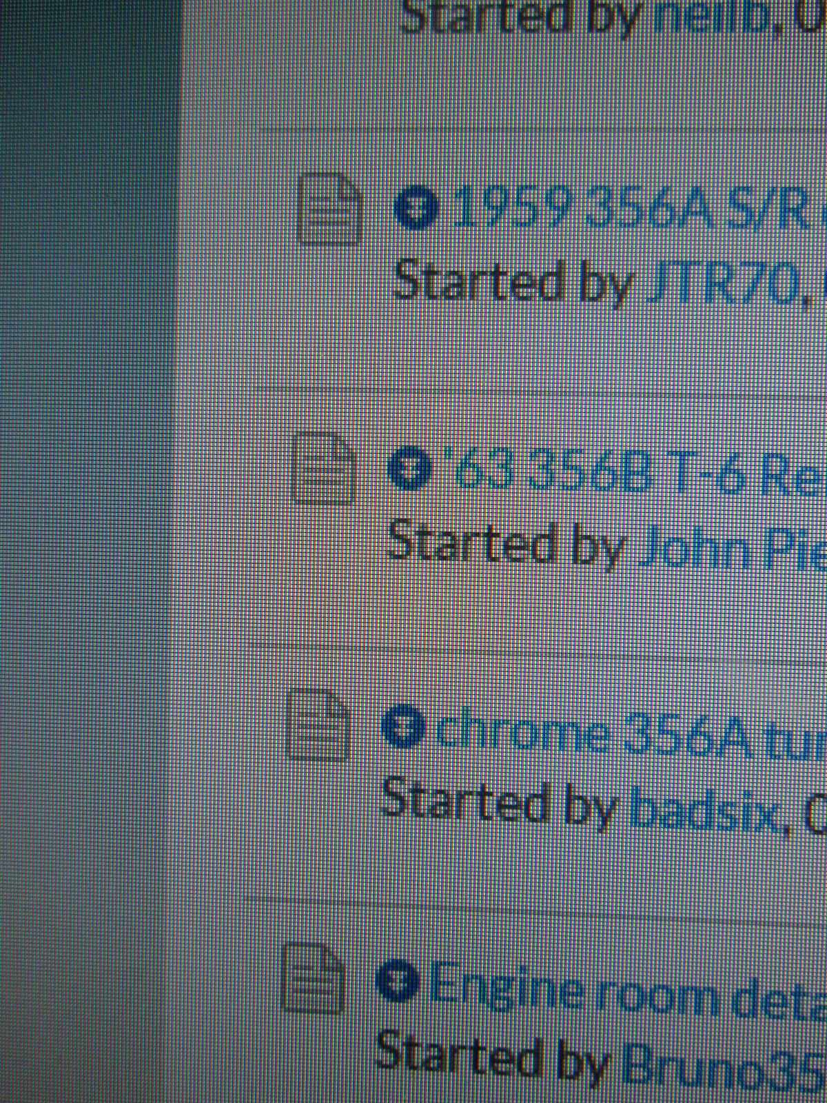

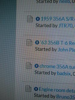

        Justin, been catching up on this thread and really like the way you have solved some of the bodywork problems. Good photos and explanations. Tell you something else. I found on opening the forum and then selecting the thread area then looking over to the right the notification of when the last post was added to the thread. Along side that is a small blue box with 2 arrows in it. By clicking that small box it takes you directly to the last entry made. Now previously I missed using that box and was always going to the start of the thread sometimes years back in time.
        Have I been daft in not seeing or realizing that small box takes you to the last thread entry??
        Makes a big difference!!!! People as daft as me might be making the same mistake?? Or is it I am just getting old !
          Hey Roy, No its not just you I've had other guys ask. Yes, the rectangular blue box will take you to the latest post and so will these blue circles to the left of the title in the above photo. They'll disappear after your first view but the other icon you mentioned is always there. Again its still a new system for us all.

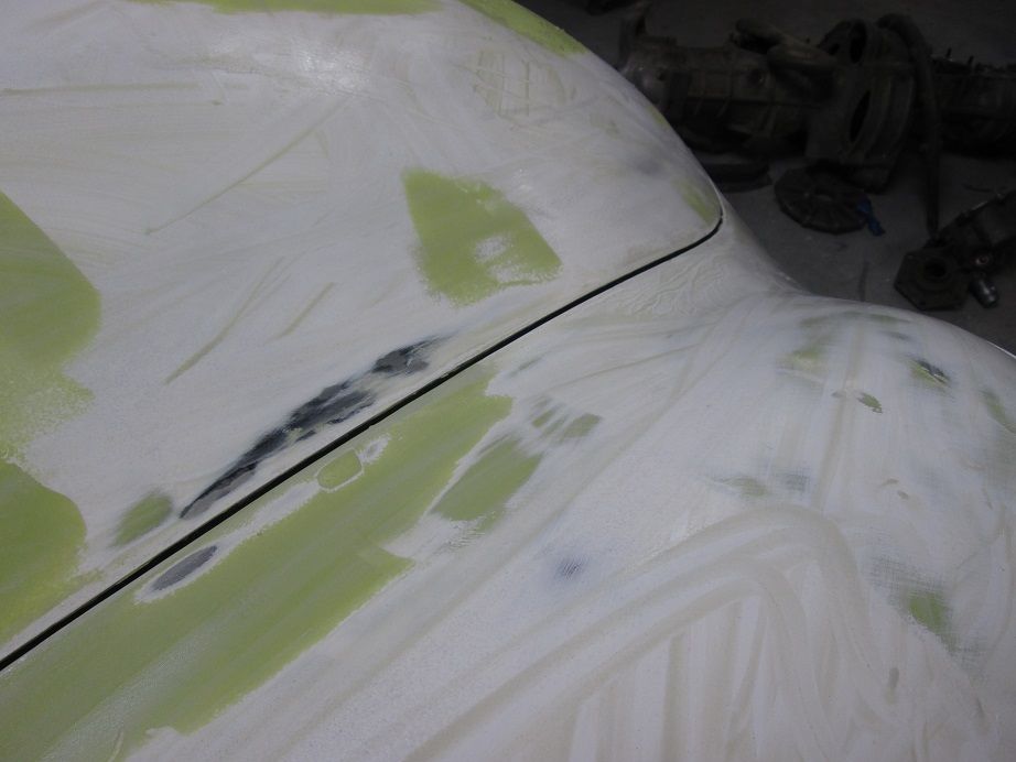

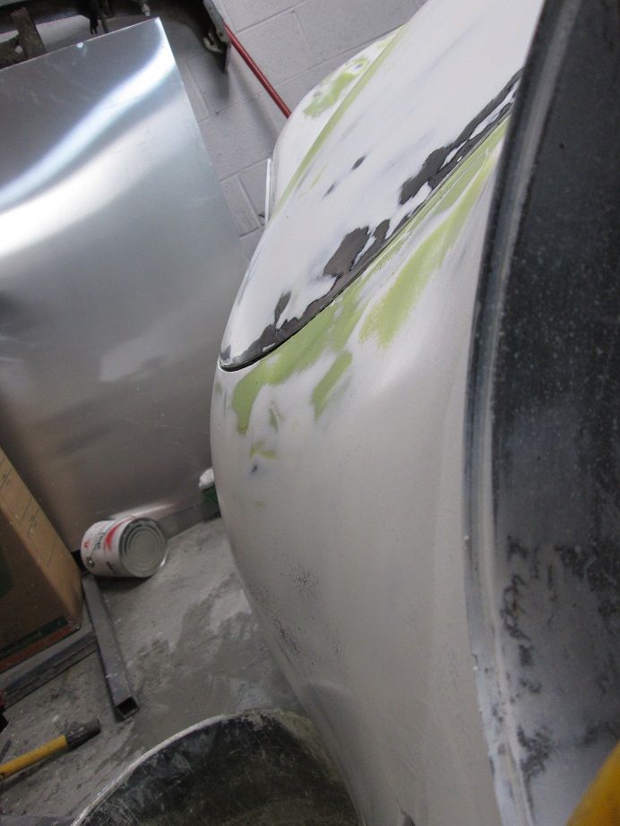

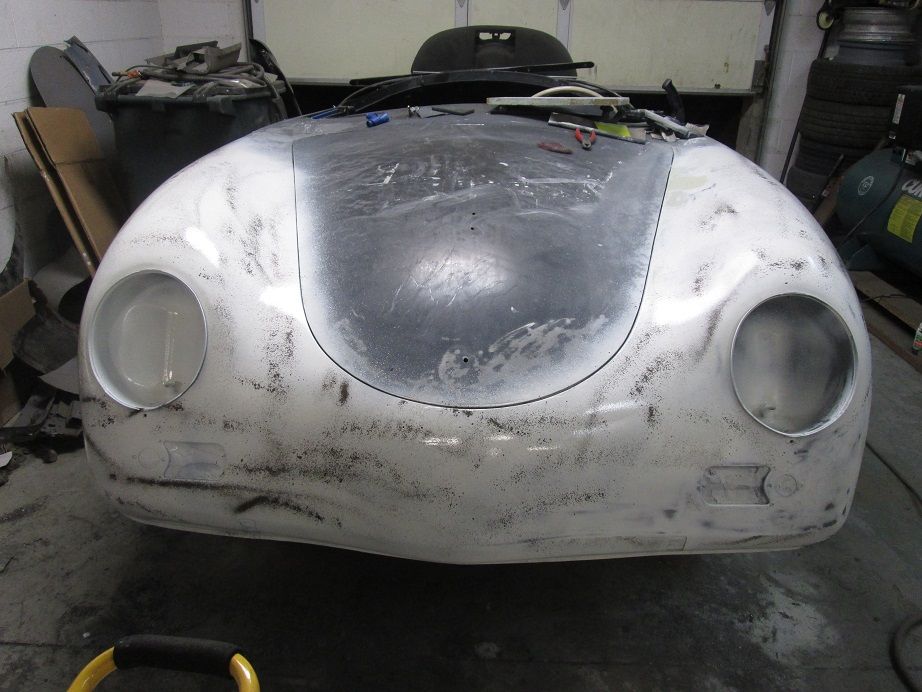

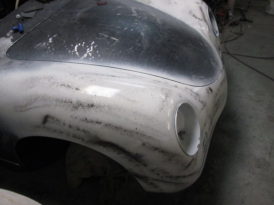

        Bodywork phase on the front end continues.
        Click image for larger version  Name:	IMG_1463.JPG Views:	0 Size:	96.9 KB ID:	105687
        Click image for larger version  Name:	IMG_1465.JPG Views:	0 Size:	89.3 KB ID:	105688

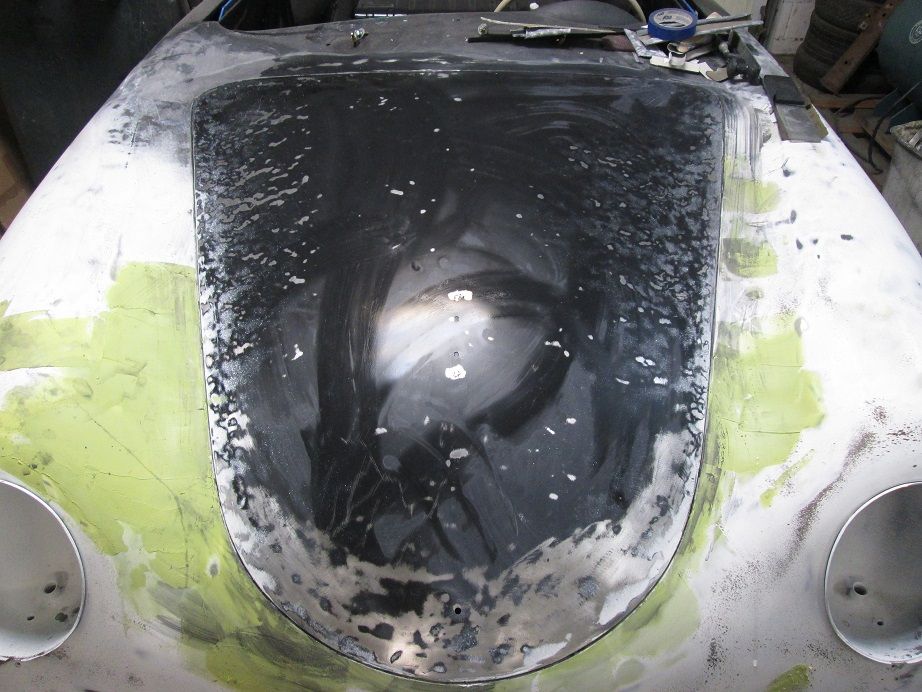

        Begin block sanding the sealer to find the low spots.

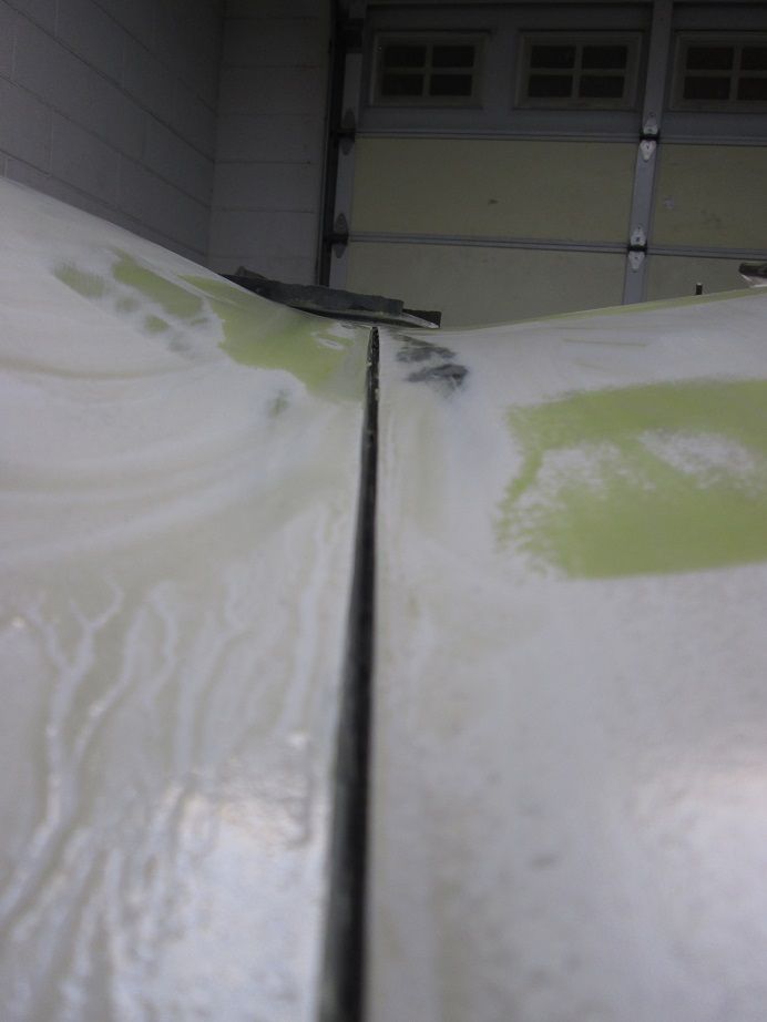

        Click image for larger version  Name:	IMG_1466.JPG Views:	0 Size:	100.8 KB ID:	105689
        Working from the edge of the hood outward.

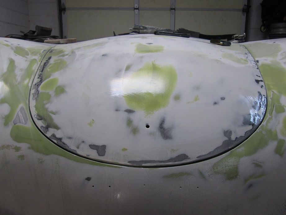

        After several passes the smooth taper and transition off the hood I was after is taking shape.
        The lump at the emblem in the profile shape I was dealing with at the beginning now gone.

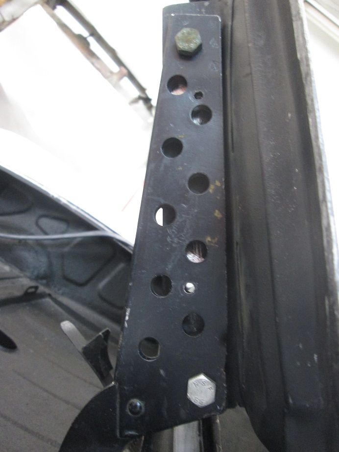

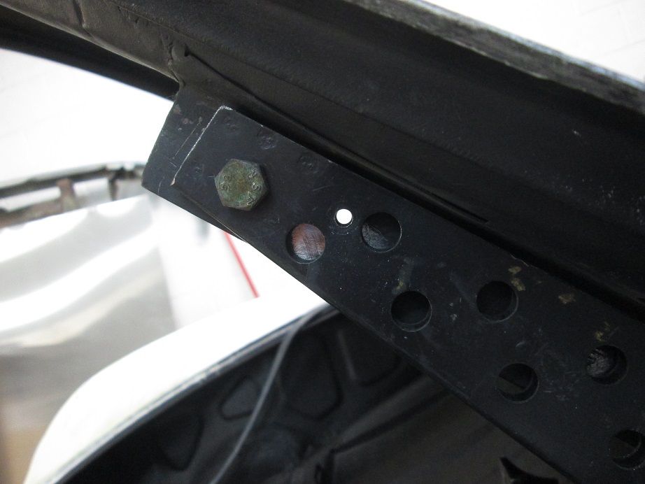

          Hinge detail: With the hood now reset in its best adjusted position I Welded up the old alignment holes on the hood mount flanges.
          And redrilled them to the hinges new position. One of the details guys in the know look for when you have your hood open at a Porsche event.

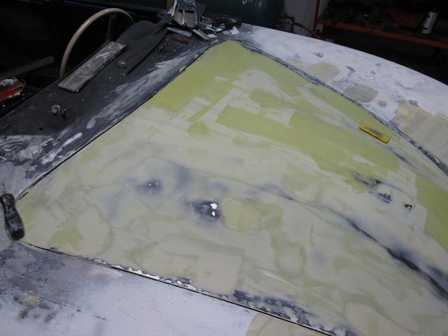

            Skimming and blocking continued:
            Swatch and sand.
            You can see that its only requiring less than credit cards thickness of filler to chase out that lump in the contour I was dealing with initially.

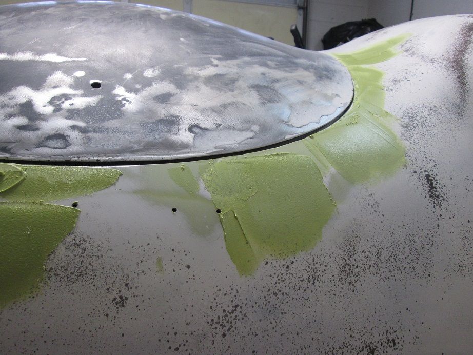

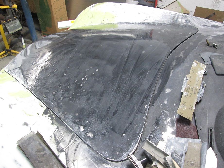

            After several rounds I'd chased it about as far as I could so it was now time to get it all behind a uniform coat of sealer and begin the process again.
            In sealer and ready to chase it all again.

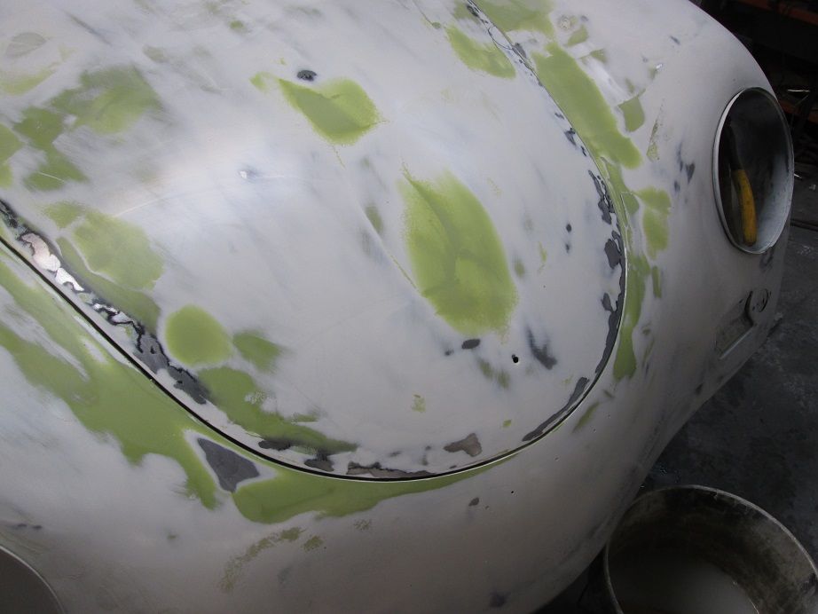

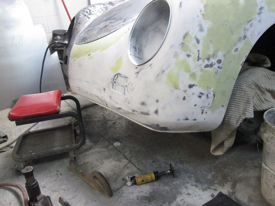

              Hood gap chasing continued.
              Click image for larger version  Name:	IMG_1563.JPG Views:	0 Size:	41.3 KB ID:	105781
              Okay with the left side gap so far.
              Click image for larger version  Name:	IMG_1564.JPG Views:	0 Size:	36.0 KB ID:	105782
              But the left was running way too tight. I had opened it as it made the turn as it was all lead but just after the weld joint from nose to fender it turned all steel.
              Click image for larger version  Name:	IMG_1565.JPG Views:	0 Size:	34.8 KB ID:	105783

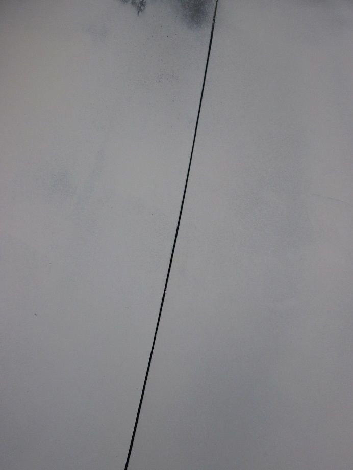

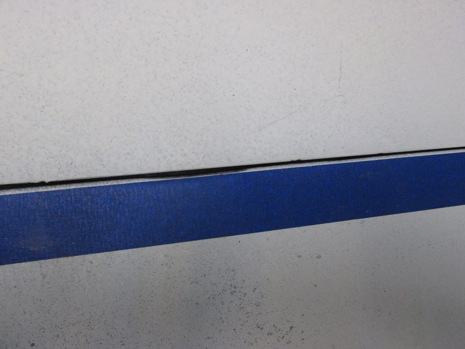

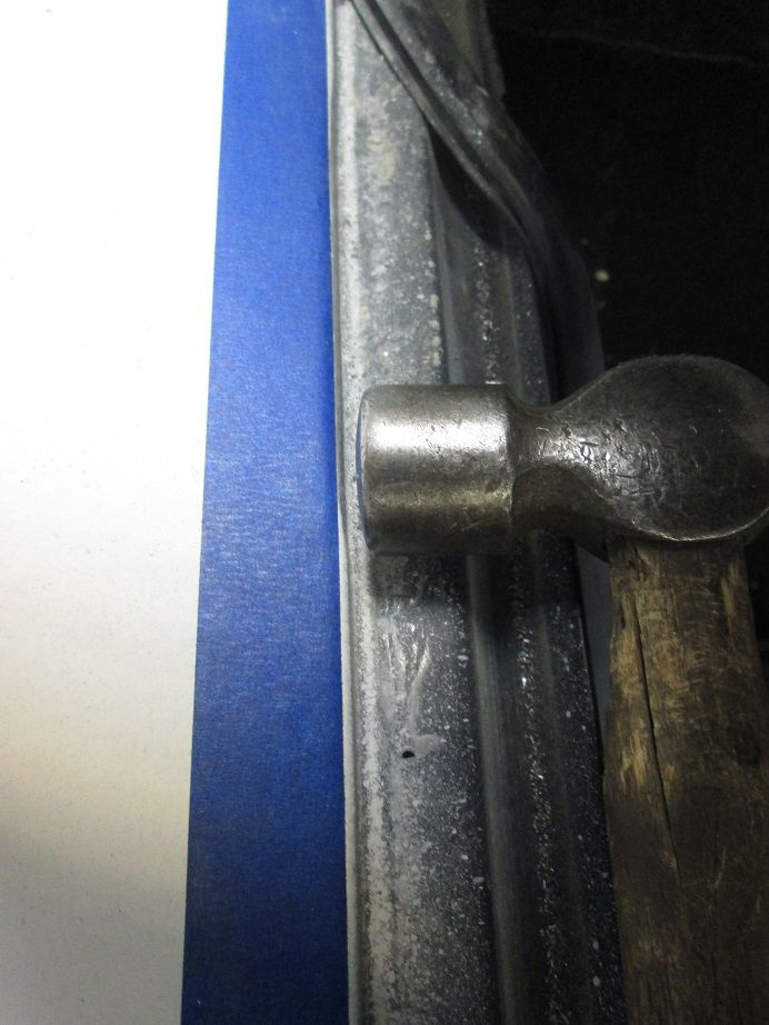

              This middle run was tight and with no filler to carve out I was weighing my options. Could relief cut it but was trying to avoid that.
              Click image for larger version  Name:	IMG_1569.JPG Views:	0 Size:	79.8 KB ID:	105784
              Then I experimented with tape marking the gap I needed and carefully ball pinging the shoulder back. This turned the trick!
              Click image for larger version  Name:	IMG_1568.JPG Views:	0 Size:	70.8 KB ID:	105785
              Had to go very slowly and carefully for uniform shoulder but it was yielding the result I wanted. Another benefit was that the hood sat higher than the fender through here and once an area was tapped it swelled up nearly level with the latched hood. A complete win/win here.
              More later...

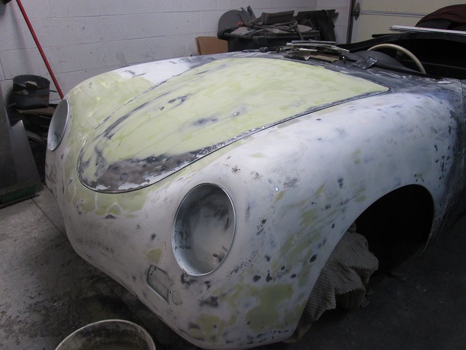

                Dodged a bullet on that one Justin. Nice job. At what point is the weatherstrip installed?
                  Thanks Phil! The seal has been installed all throughout the process. You can see it laying off to the side in photo 4 above. This is one aspect that really couldn't be conveyed in these series of photos. I must have had that seal off and on over 50 times through out. When I shot the sealer it was off then reinstalled then partially removed as needed as the work went, repeated then repeated again. This was a real PIA time consuming part of the process to say the least.

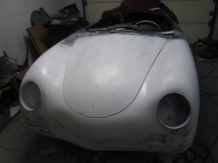

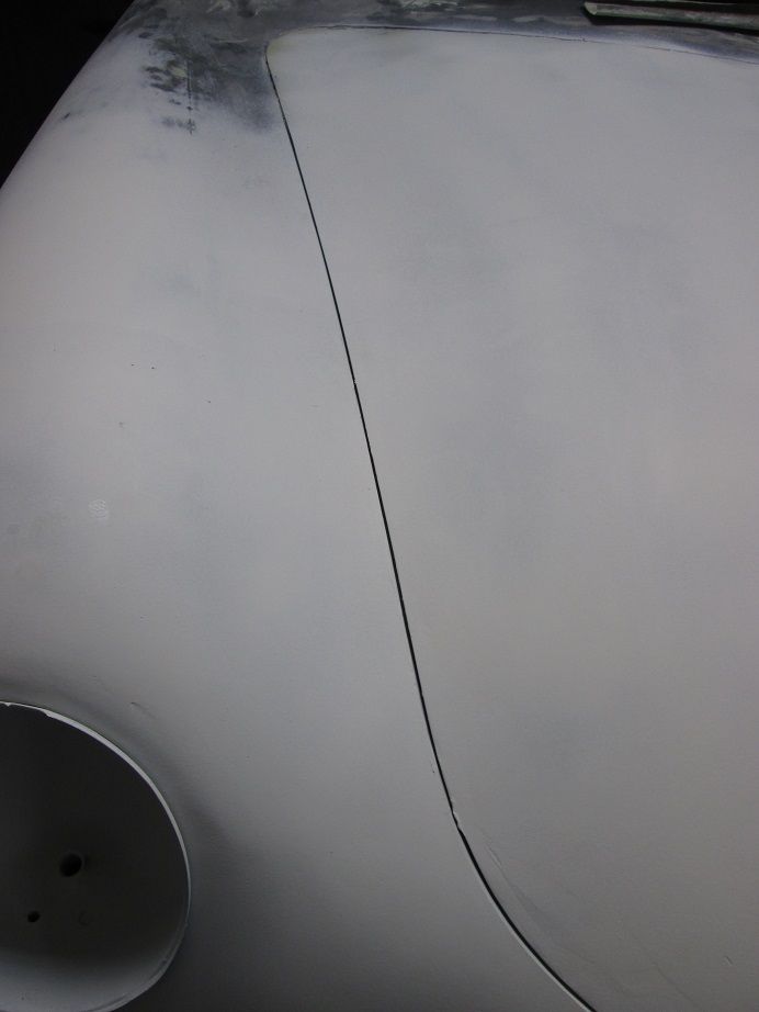

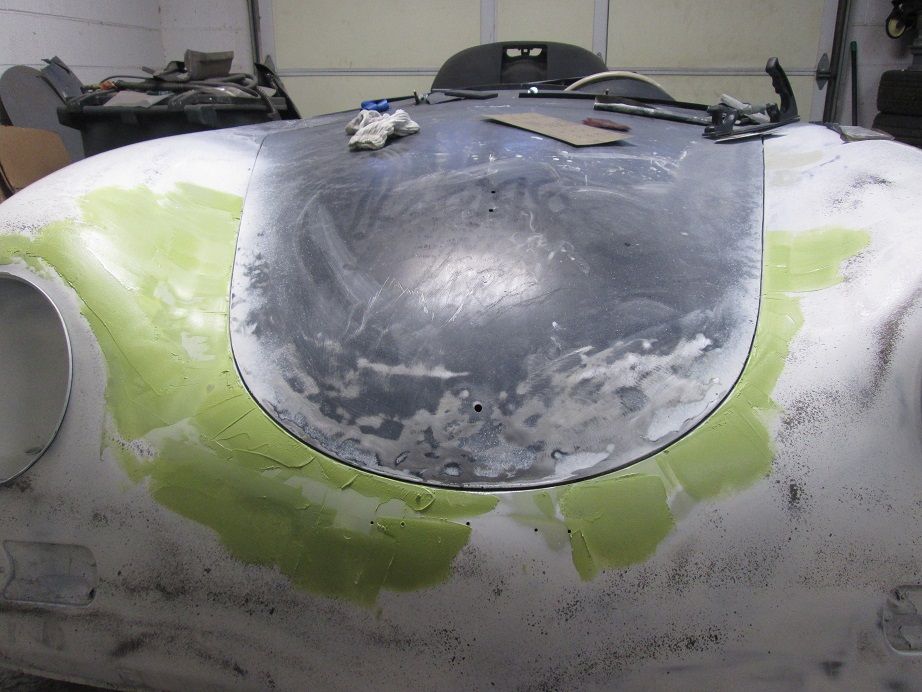

                More swatching and sanding across the hood over to the fenders.
                Click image for larger version  Name:	IMG_1597.JPG Views:	0 Size:	60.0 KB ID:	105798
                Click image for larger version  Name:	IMG_1589.JPG Views:	0 Size:	54.8 KB ID:	105799
                Right gap finally opened up even with the left side.
                Click image for larger version  Name:	IMG_1588.JPG Views:	0 Size:	41.1 KB ID:	105802

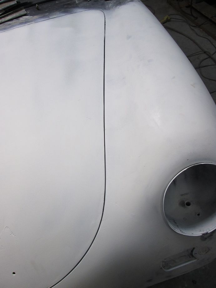

                Even and smooth transition from the edge of the hood onto the fenders.
                Click image for larger version  Name:	image_60867.jpg Views:	3 Size:	68.9 KB ID:	105800
                Smooth and consistent nose to hood profile with out that humped profile it showed up with.
                Click image for larger version  Name:	image_60868.jpg Views:	3 Size:	61.2 KB ID:	105801
                Just about ready for another round of sealer. Which means the trunk seal has to come back out again.
                Thanks for stopping by!

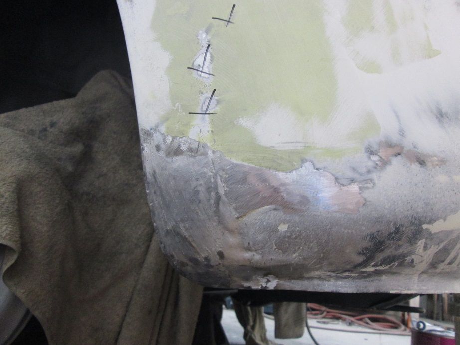

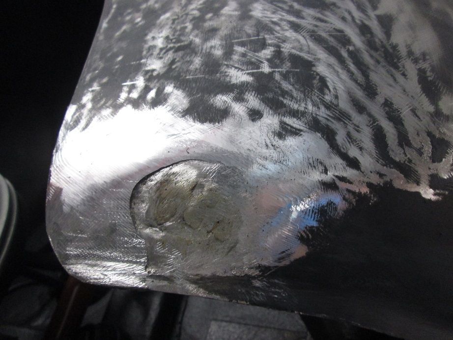

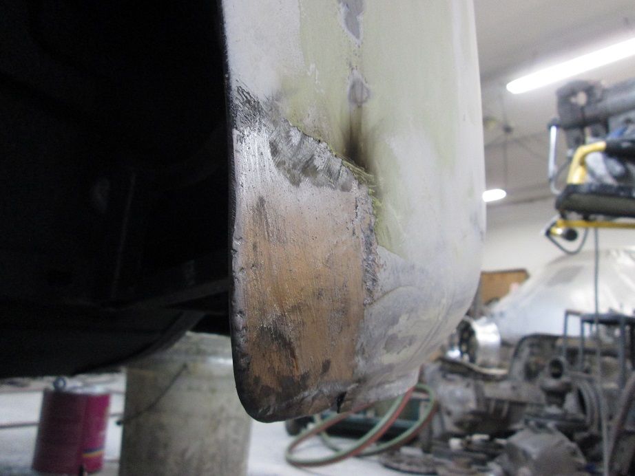

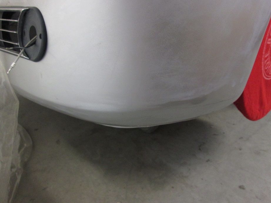

                  Right lower front corner:

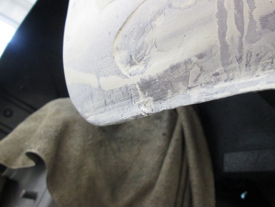

                  Click image for larger version  Name:	IMG_1599.JPG Views:	0 Size:	63.5 KB ID:	105821

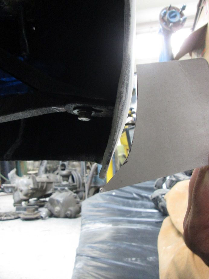

                  Needed a break from block sanding so I tackled this lower right front corner. Its too flat and too fat with solder. Paper template profile shape based on my OG reference car.
                  Click image for larger version  Name:	IMG_1602.JPG Views:	0 Size:	71.6 KB ID:	105822

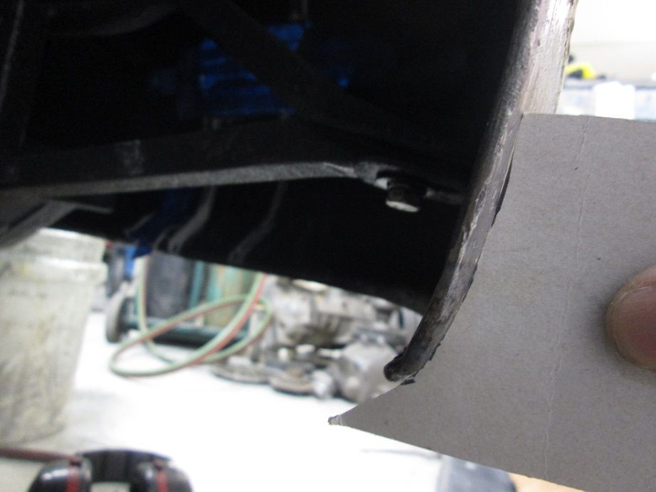

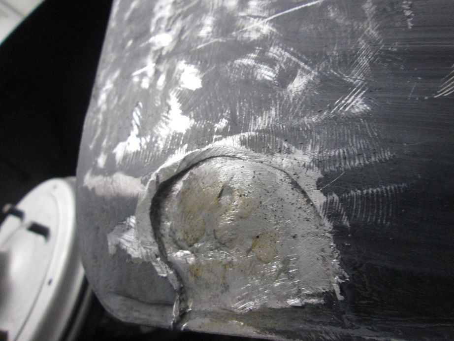

                  Lead pretty much comprises the illusion of a rolled lip. The end of the wire where it meets that flange was set to the outside of this flange the lead was there to also burry this small problem.
                  Click image for larger version  Name:	IMG_1604.JPG Views:	0 Size:	71.7 KB ID:	105823
                  Lead removed and in process of heating and rolling this bottom leading edge under as it should be. Already relief cut ahead of that wire issue.
                  Click image for larger version  Name:	IMG_1605.JPG Views:	0 Size:	57.8 KB ID:	105824
                  New Rolled profile shape. Close enough...
                  Click image for larger version  Name:	IMG_1607.JPG Views:	0 Size:	76.1 KB ID:	105825
                  Wire lead at flange corrected and all welded back up. Greatly reduced the need for filler here. Heading up that weld joint to heat shrink a few high spots highlighted in marker.
