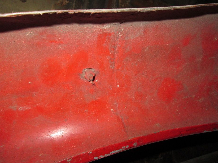

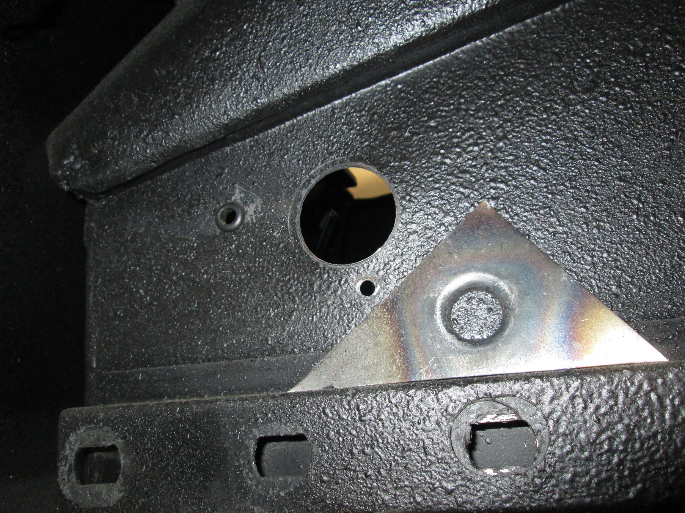

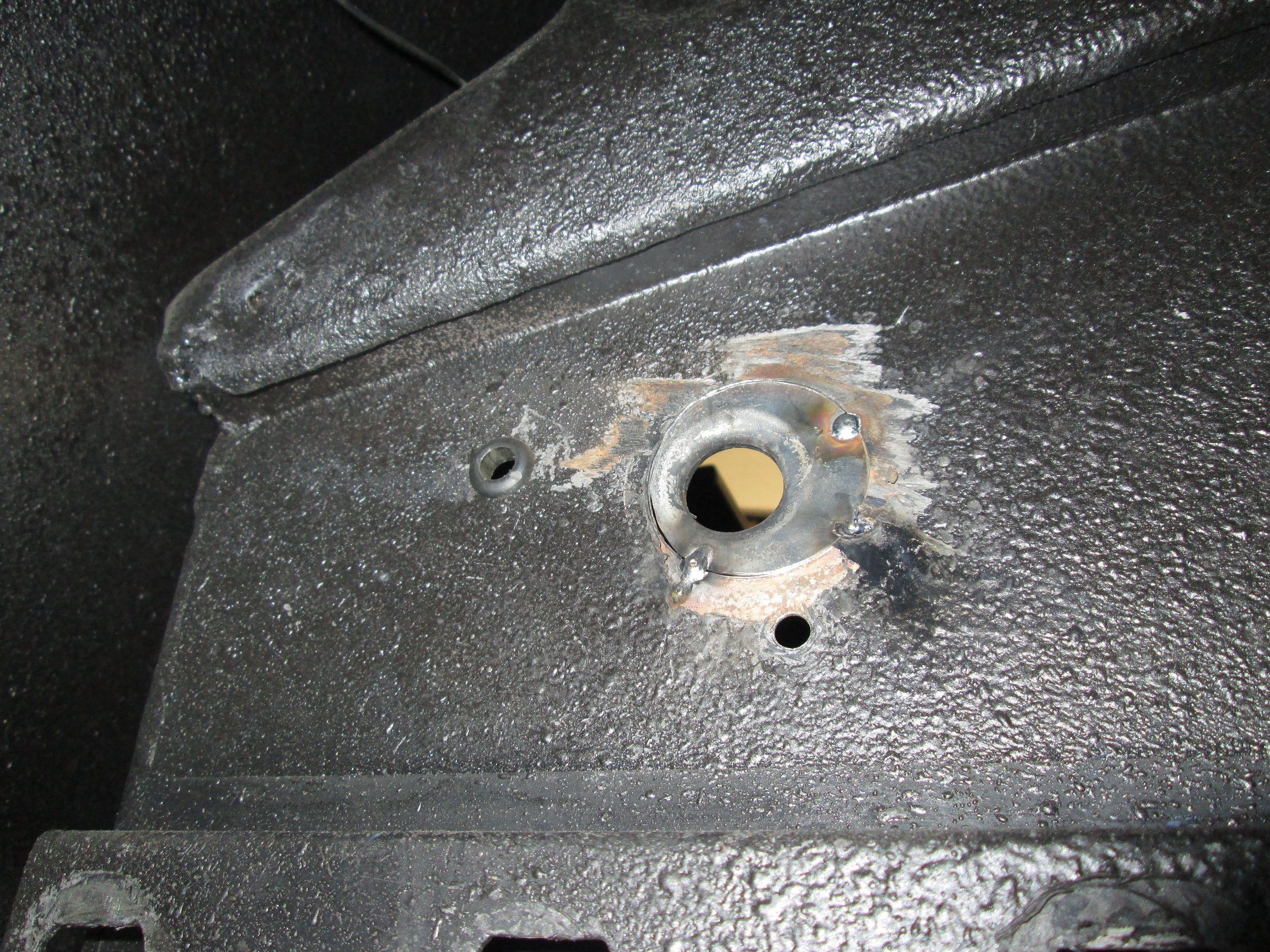

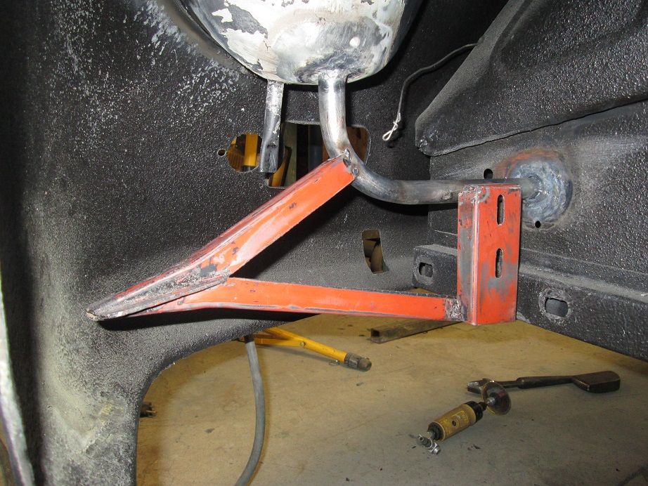

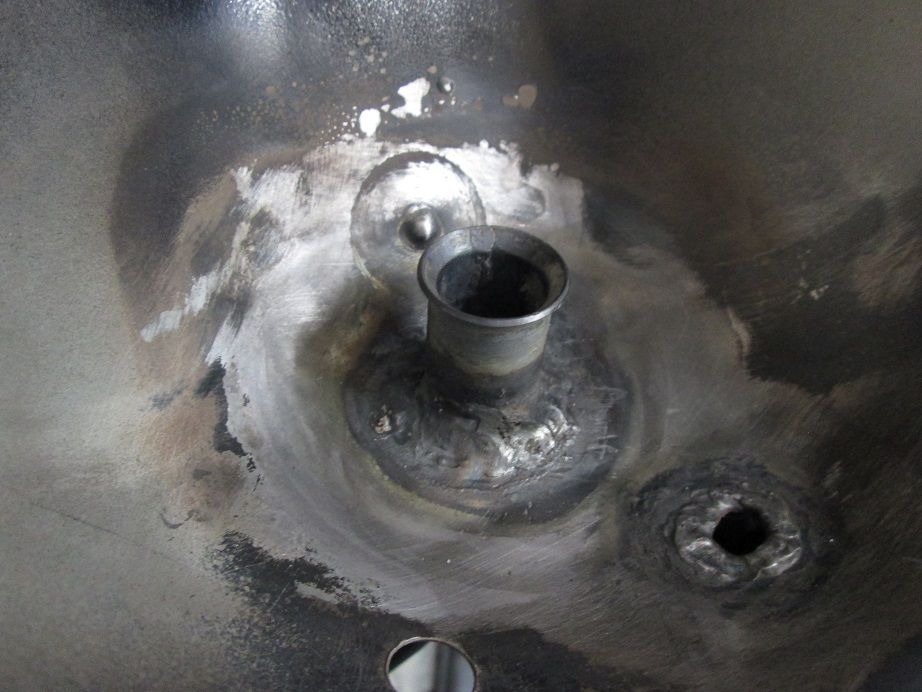

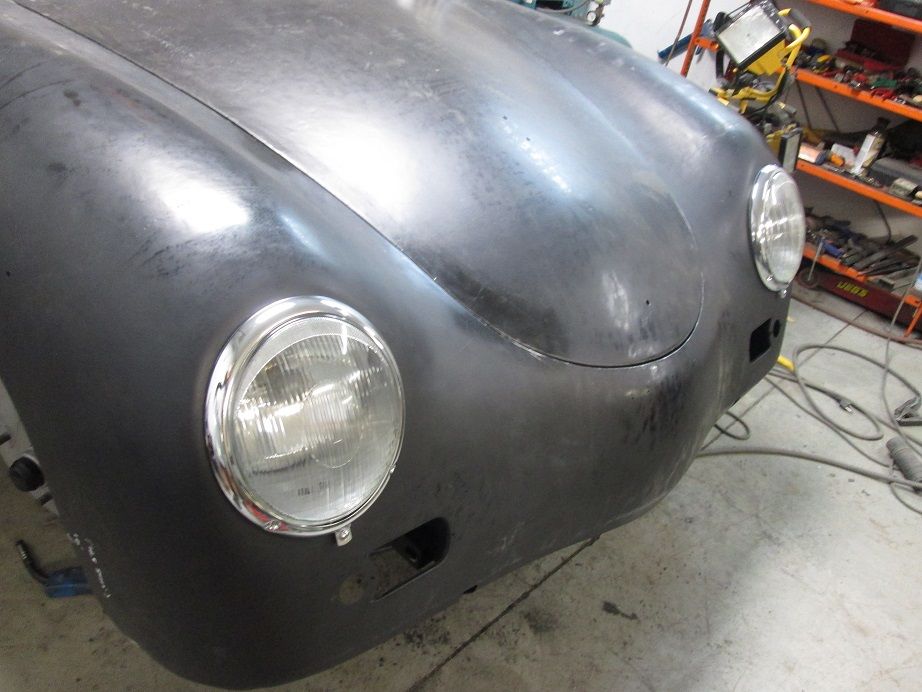

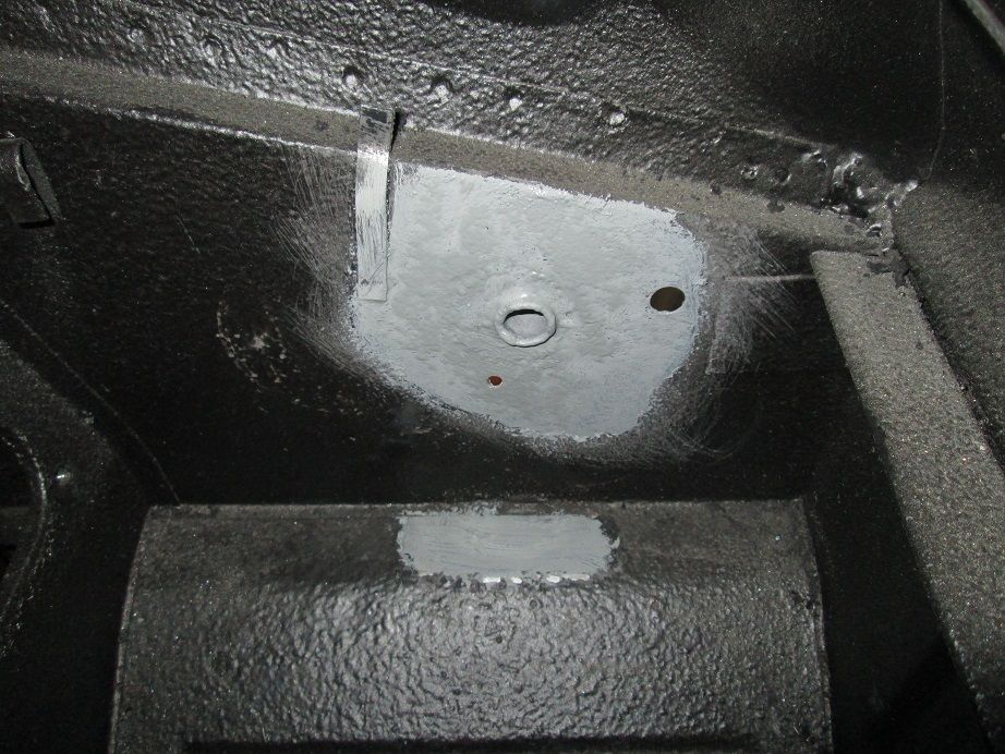

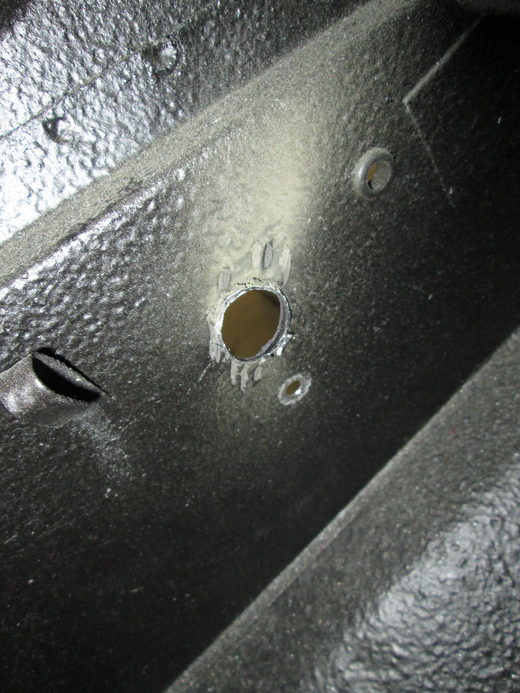

    Prepping the car itself for bucket and conduit reinstall.Click image for larger version  Name:	IMG_0916re.JPG Views:	1 Size:	773.1 KB ID:	105203

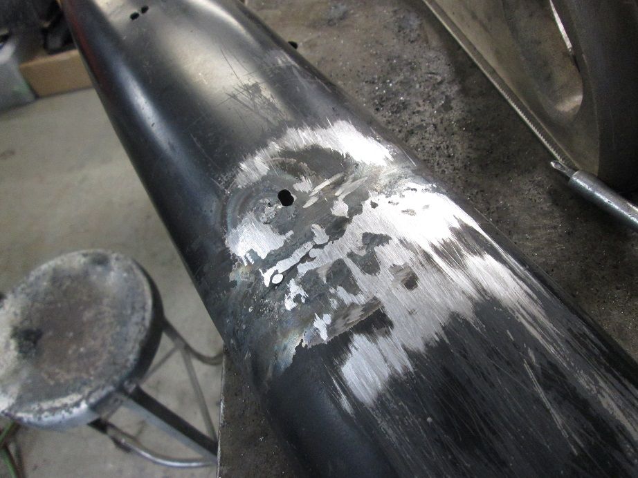

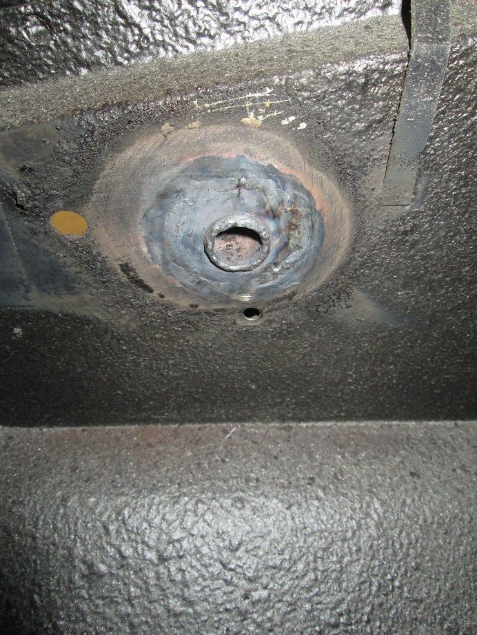

    Conduit hole was not rolled and shoulder as originally. Its placement is also a little off which was helping to dictate that downward angle of the brace I found.
    Click image for larger version  Name:	IMG_0917re.JPG Views:	1 Size:	834.9 KB ID:	105204

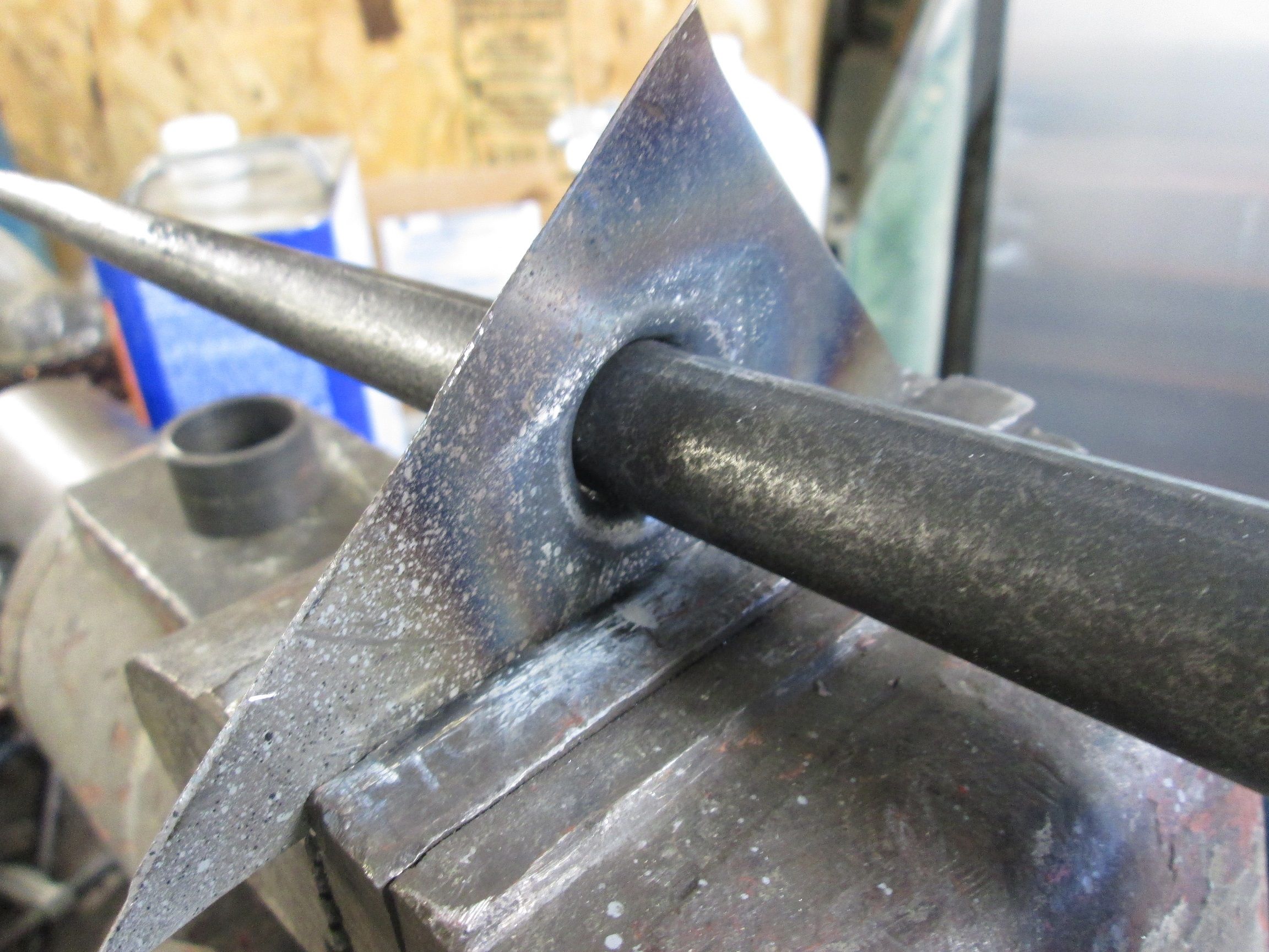

    Best solution was to punch the area out make a new shouldered hole and have the option to offset the hole placement as needed.
    Click image for larger version  Name:	IMG_0914re.JPG Views:	1 Size:	549.0 KB ID:	105205
    Flare punching a new opening for the end of the conduit.
    Click image for larger version  Name:	IMG_0915re.JPG Views:	1 Size:	480.1 KB ID:	105206
    Now the edges of can be fuse welded together as found originally.
    Click image for larger version  Name:	IMG_0918re.JPG Views:	1 Size:	983.2 KB ID:	105207

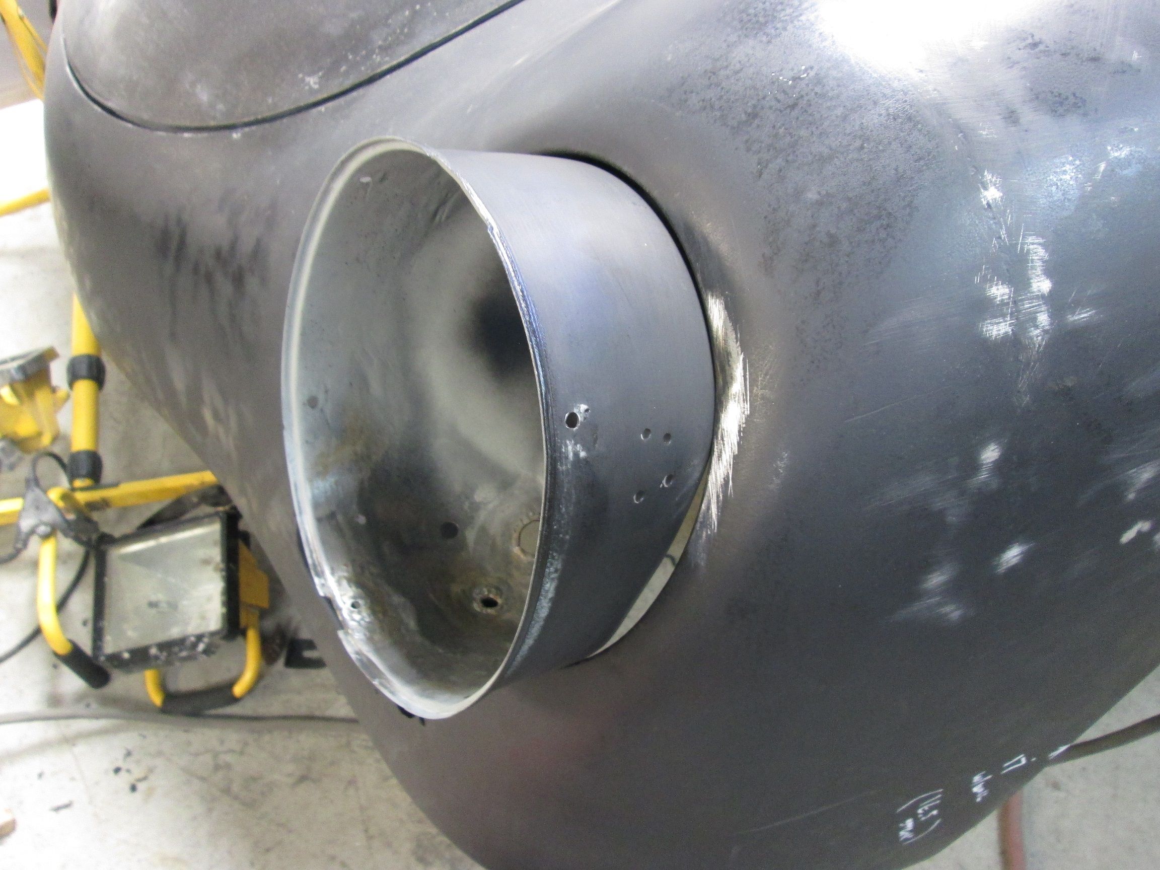

    Ready to install. Headlight bucket will go back in first then I can start fitting the conduit which will then tell me exactly where this new hole needs to be.

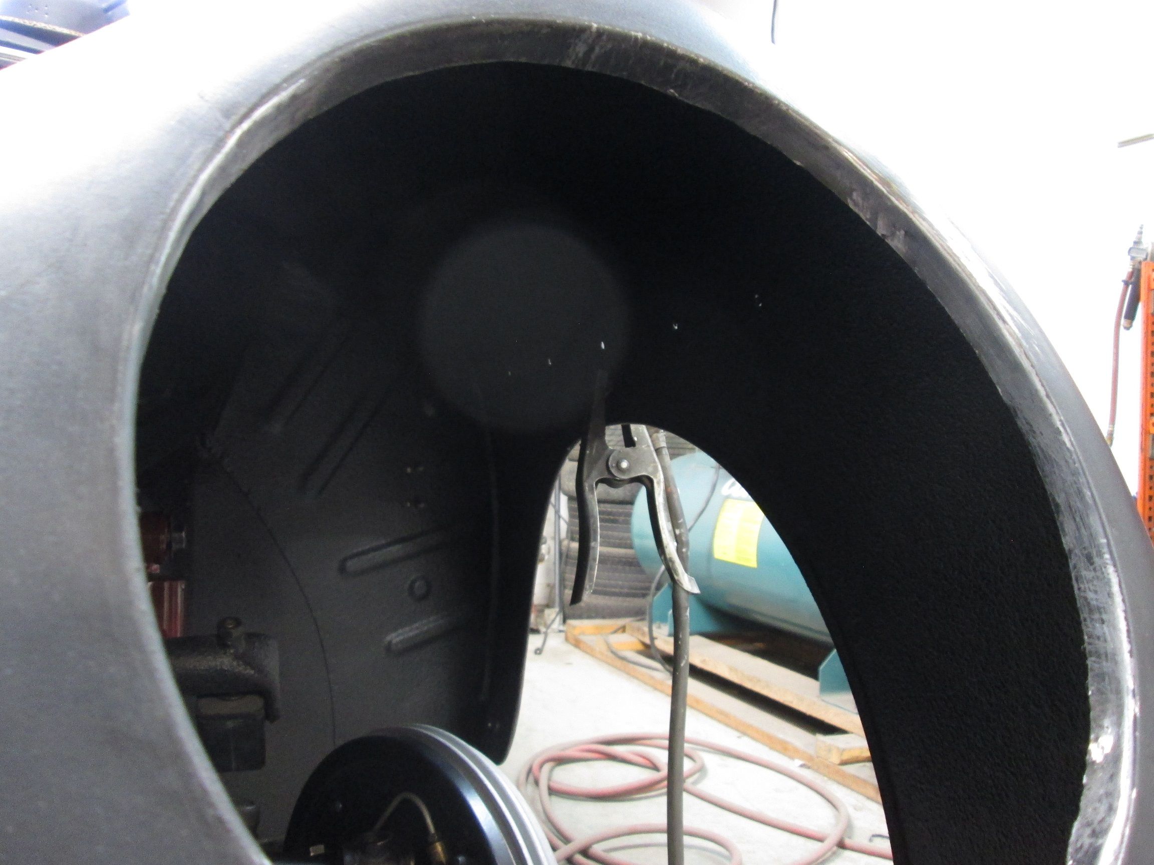

      Headlight bucket reinstall

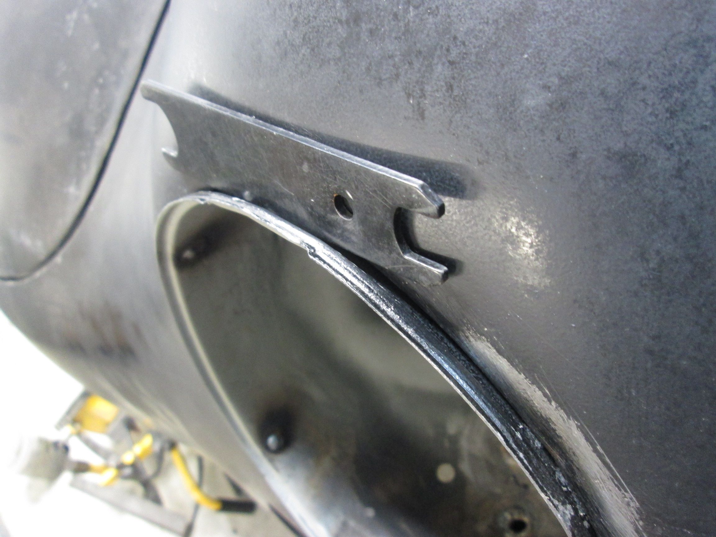

      Click image for larger version  Name:	IMG_0901re.JPG Views:	1 Size:	387.8 KB ID:	105209

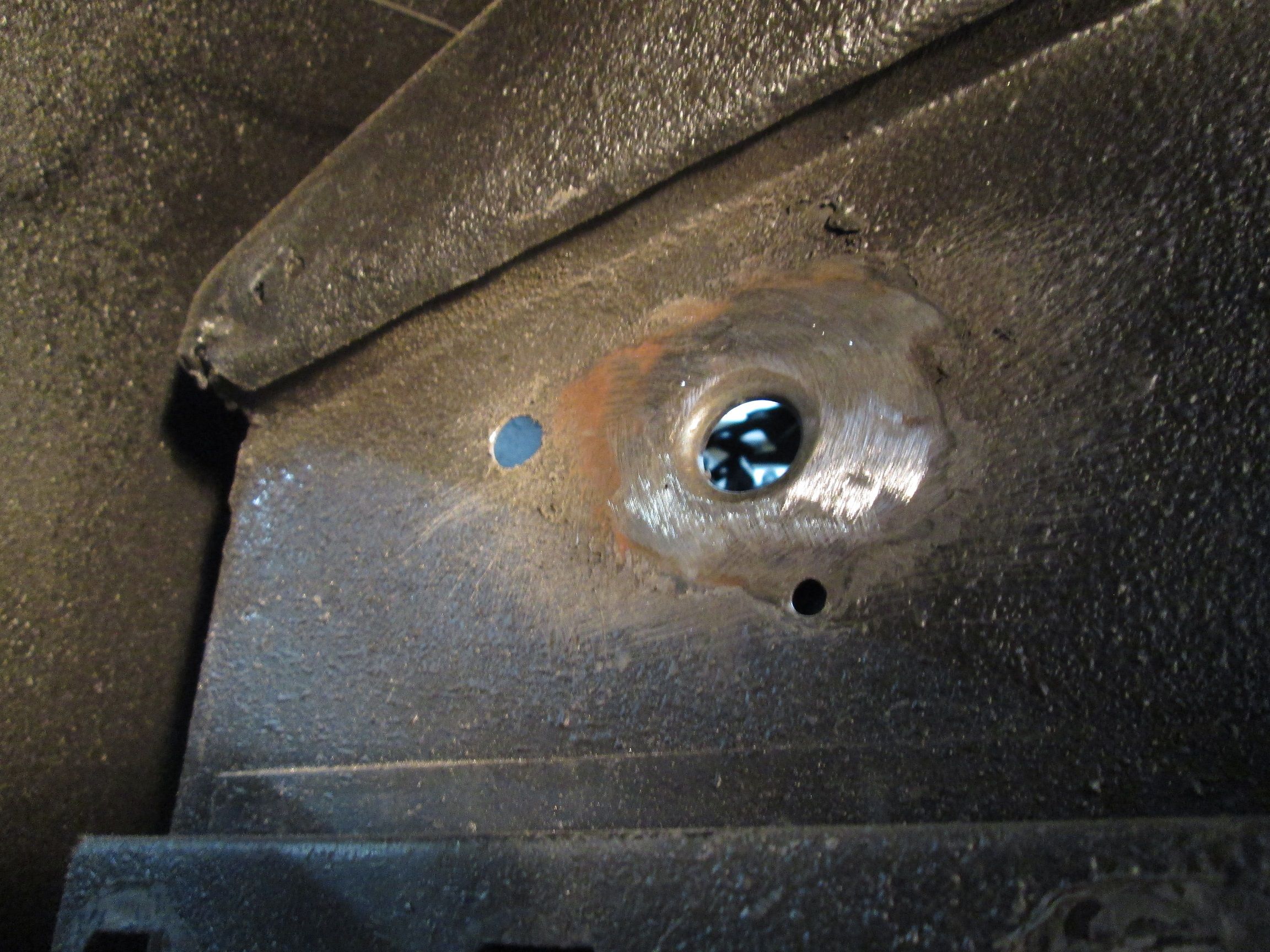

      Before it could go in I had to repair the inner mating flange where it was drilled and damaged from digging the bucket out earlier. I tell you, it was always "one more thing" before I could reassemble. It seemed like an endless list of prep work before it could begin to go back together.
      Click image for larger version  Name:	IMG_0902re.JPG Views:	1 Size:	512.4 KB ID:	105210
      Now was finally the time to begin tapping it back home.
      Click image for larger version  Name:	IMG_0904re.JPG Views:	1 Size:	529.1 KB ID:	105211

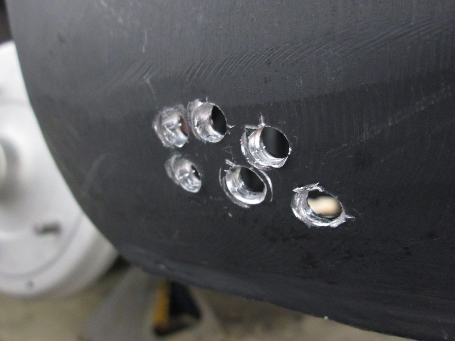

      Plug welded back into its best adjust position. This small spanner wrench was coming in at just 3mm in thickness and made for a great spacing guide as it went.

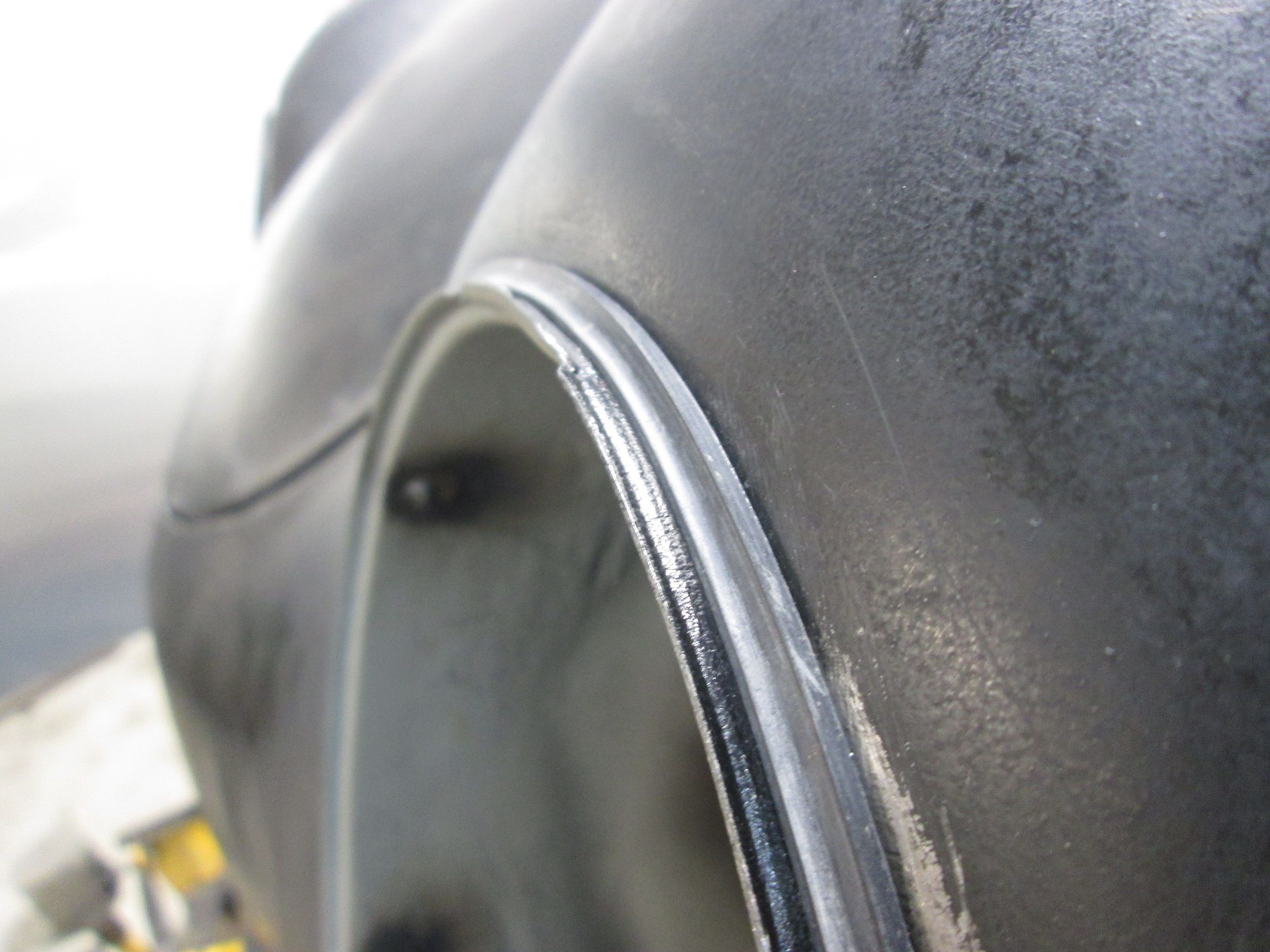

      Now for the true test of fully mounting a light unit with the seal. All set. Time to reinstall the conduit.

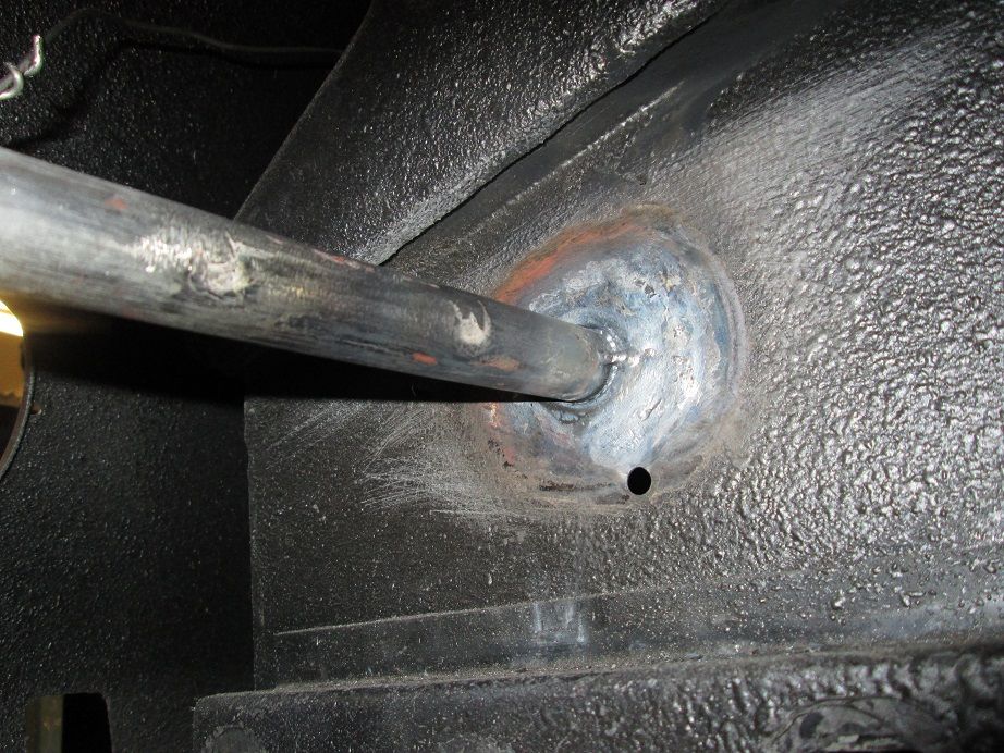

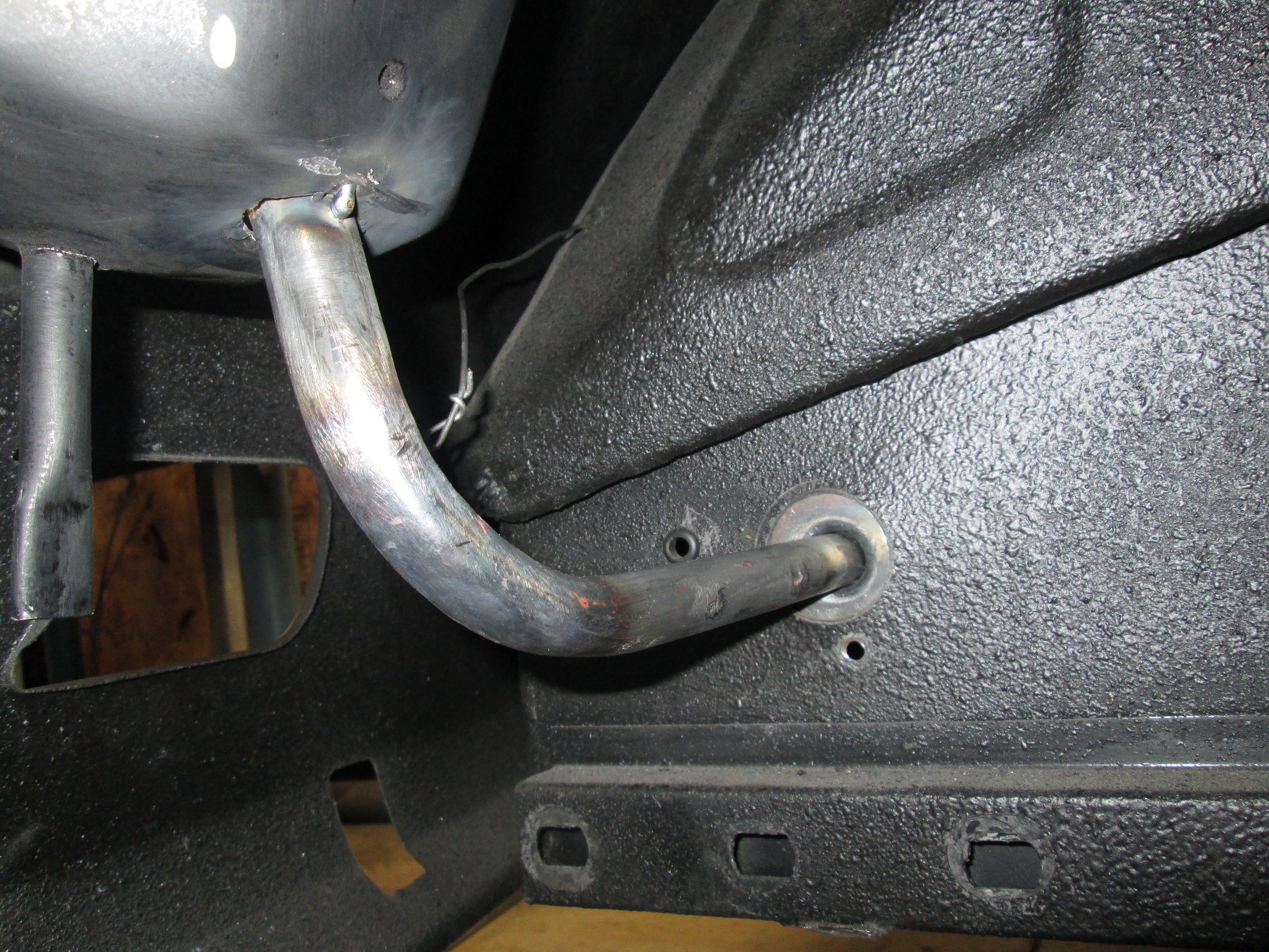

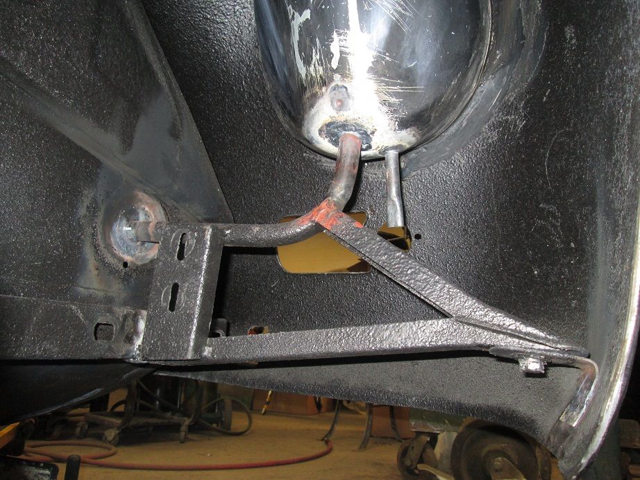

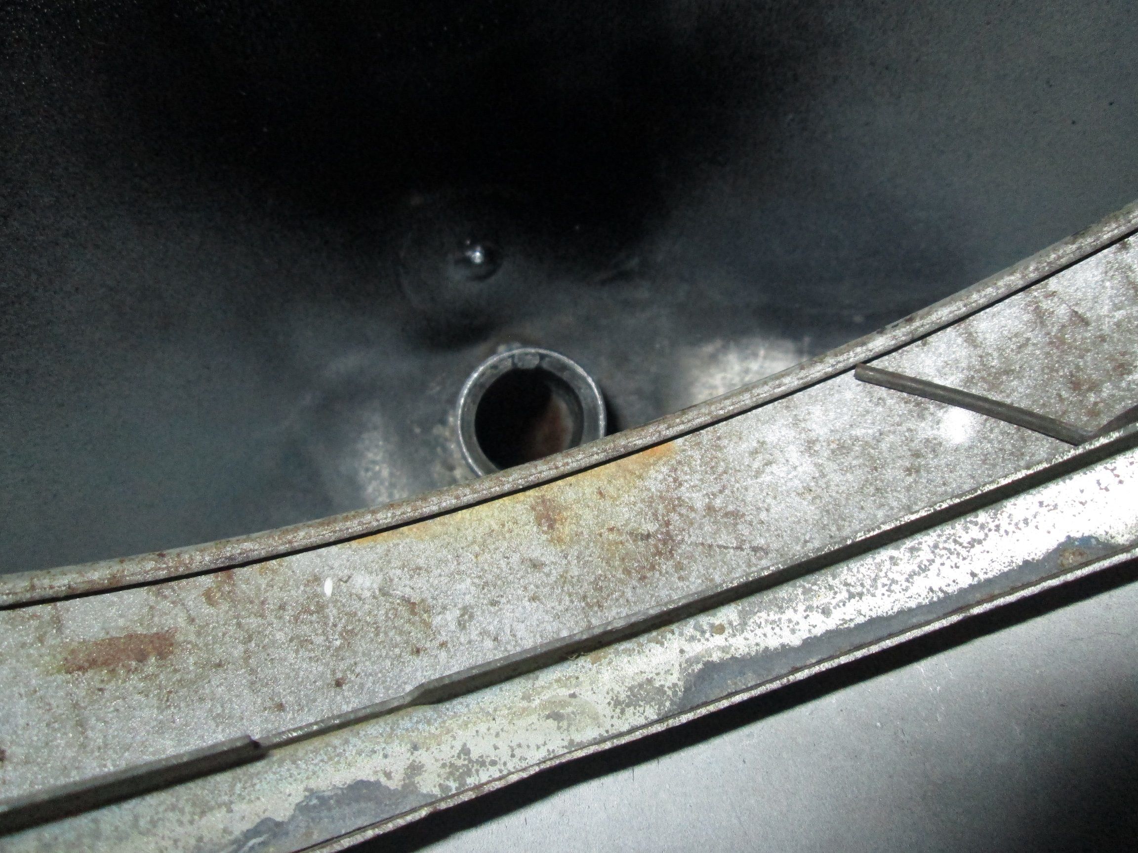

        Conduit installation
        Click image for larger version  Name:	IMG_0909re.JPG Views:	1 Size:	486.2 KB ID:	105215
        Feeding it in. It of course bound up and fought a little.Click image for larger version  Name:	IMG_0921re.JPG Views:	1 Size:	670.8 KB ID:	105216
        Shooting for the squarest and best set position for the tube as possible but also had to make sure it didn't stick up too high and interfere with the headlight assembly. mocked up to ensure clearance here.
        Click image for larger version  Name:	IMG_0922re.JPG Views:	1 Size:	865.9 KB ID:	105217
        With all that set and confirmed I gave it a quick tack to the bucket. Adjusting the other end on the battery box side next. BTW this tube didn't just set right in. I had to heat the elbow and relax it so the horizontal run would lay level while allowing the vertical end to stand up straight in the bucket. Always something....
        Click image for larger version  Name:	IMG_0924re.JPG Views:	1 Size:	636.0 KB ID:	105218
        Want the conduit to run as square as it can off the trunk wall. Having the freedom to now manipulate the holes final position makes that possible.

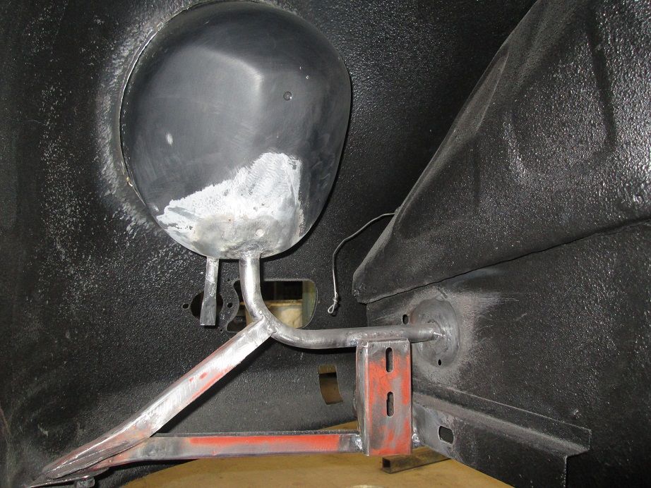

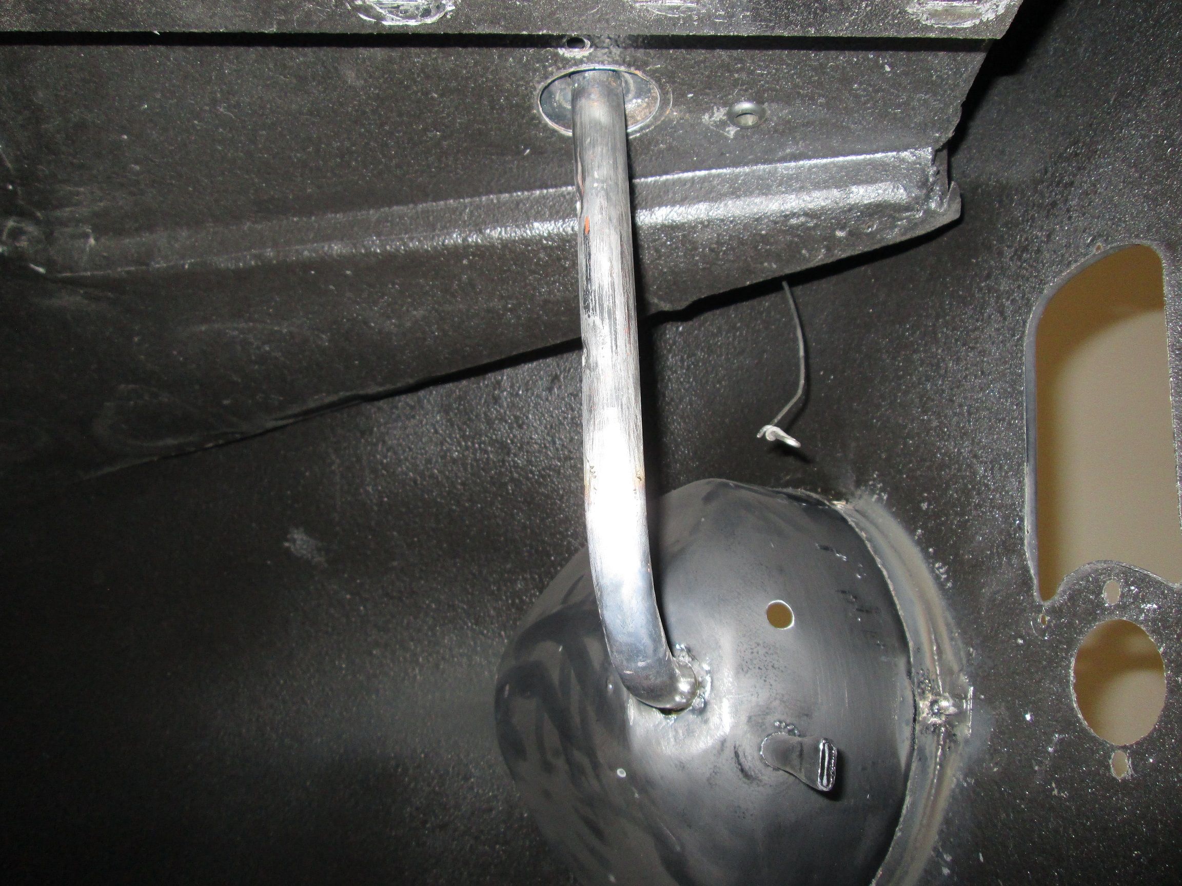

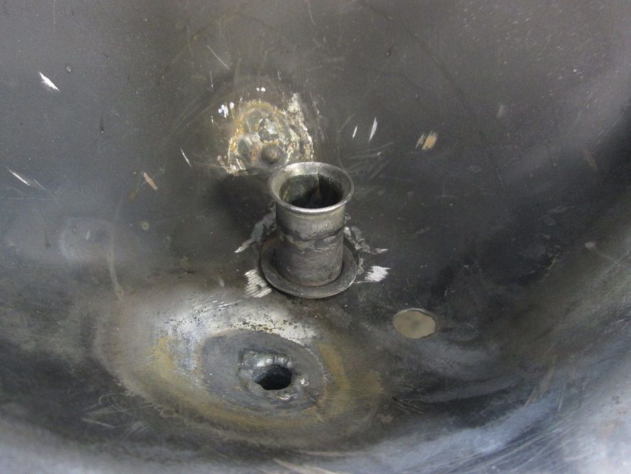

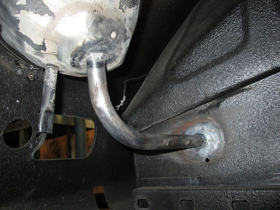

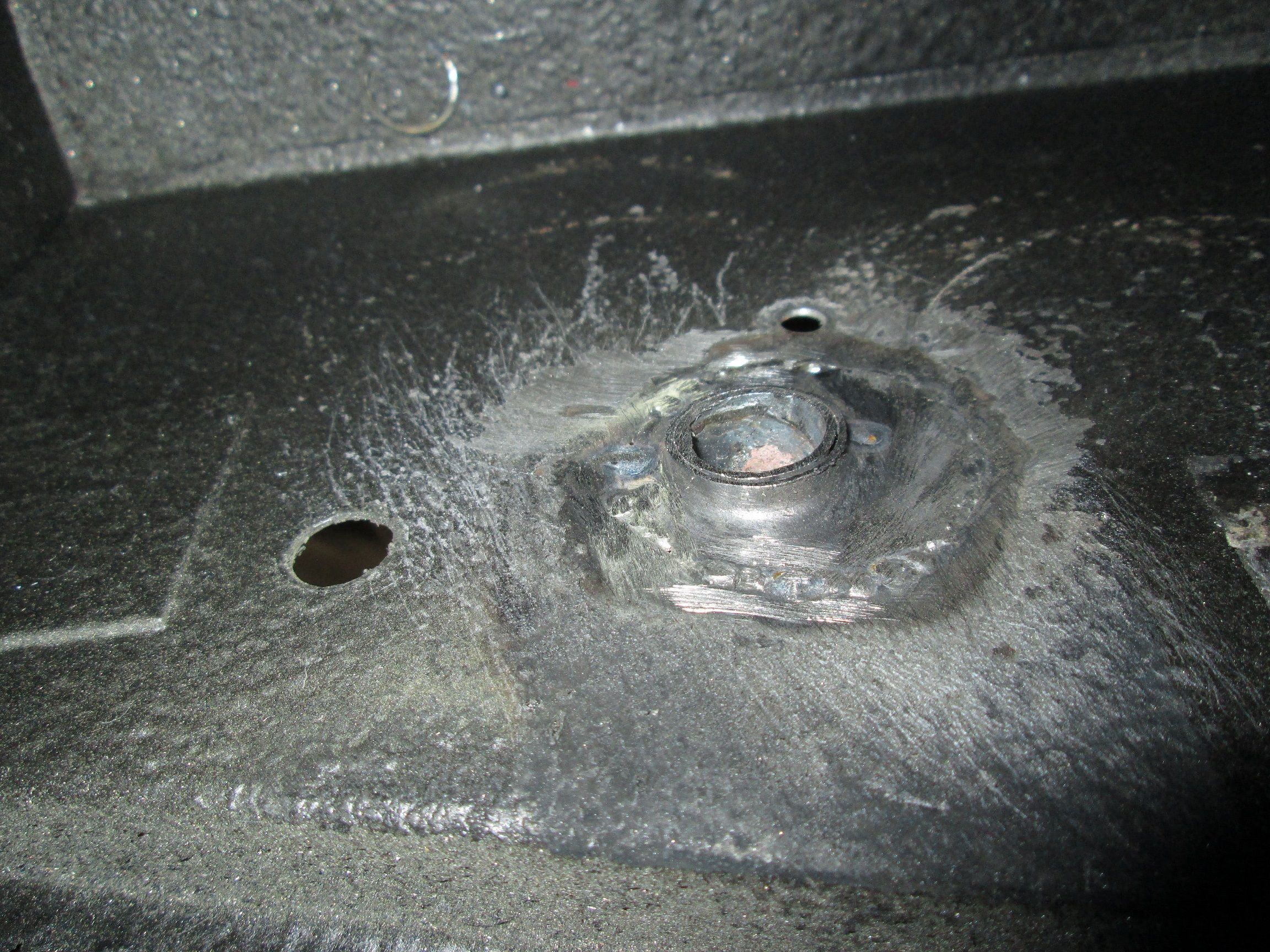

          Finishing out conduit prepClick image for larger version  Name:	IMG_0933re.JPG Views:	1 Size:	1.05 MB ID:	105220

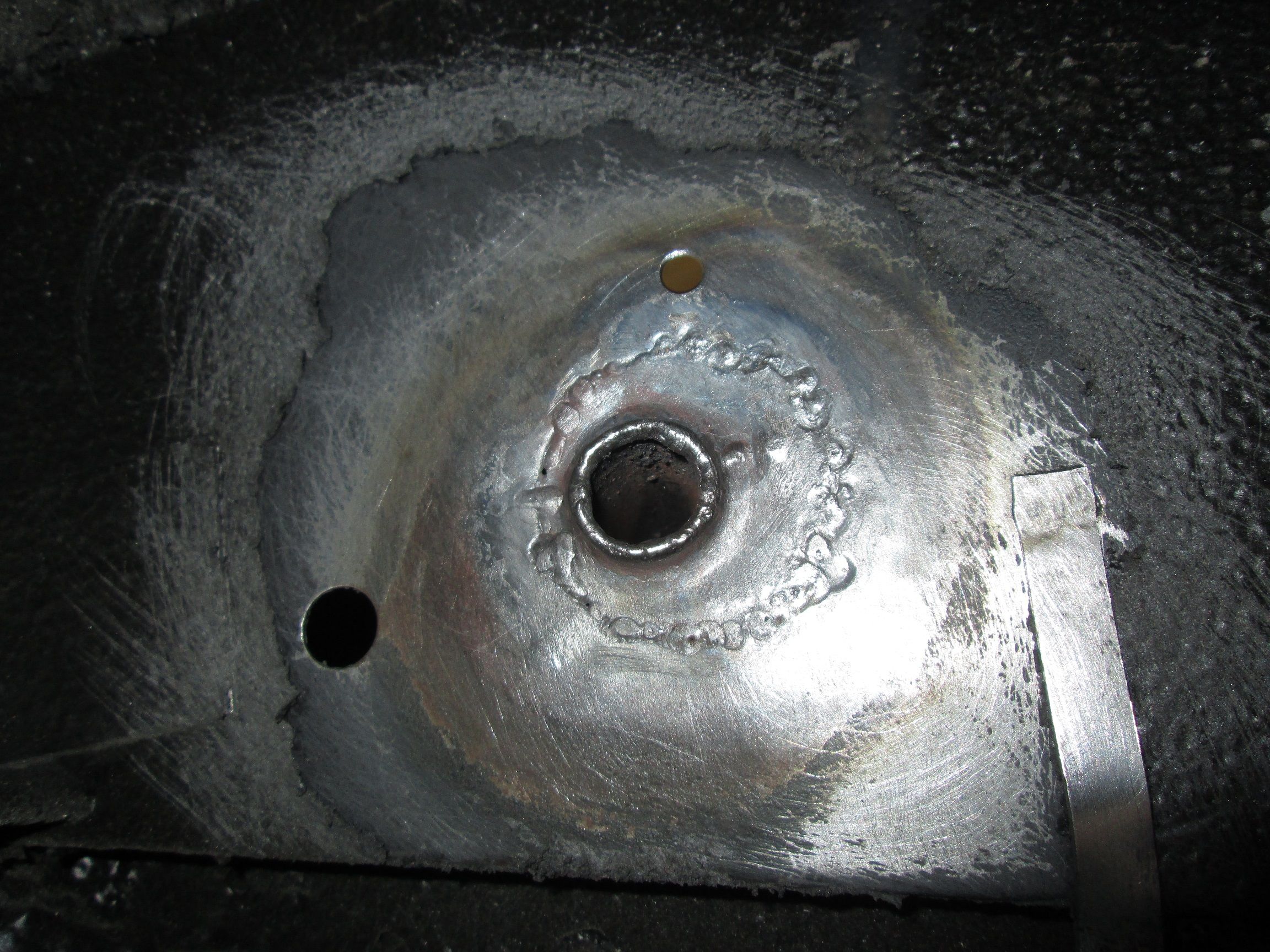

          New conduit hole tacked into final adjusted position. Its clearly off center and moved forward a few MM's which really helped getting that tube in the sweet spot.
          Click image for larger version  Name:	IMG_0934re.JPG Views:	1 Size:	648.1 KB ID:	105221
          Fully welded and finished
          Click image for larger version  Name:	IMG_0936re.JPG Views:	1 Size:	874.6 KB ID:	105222
          Conduit installed for the final time and ready to fuse the edges together as originally done.
          Click image for larger version  Name:	IMG_0937re.JPG Views:	1 Size:	694.4 KB ID:	105223
          Ends fused as originally done.
          Onto welding up the bucket side.

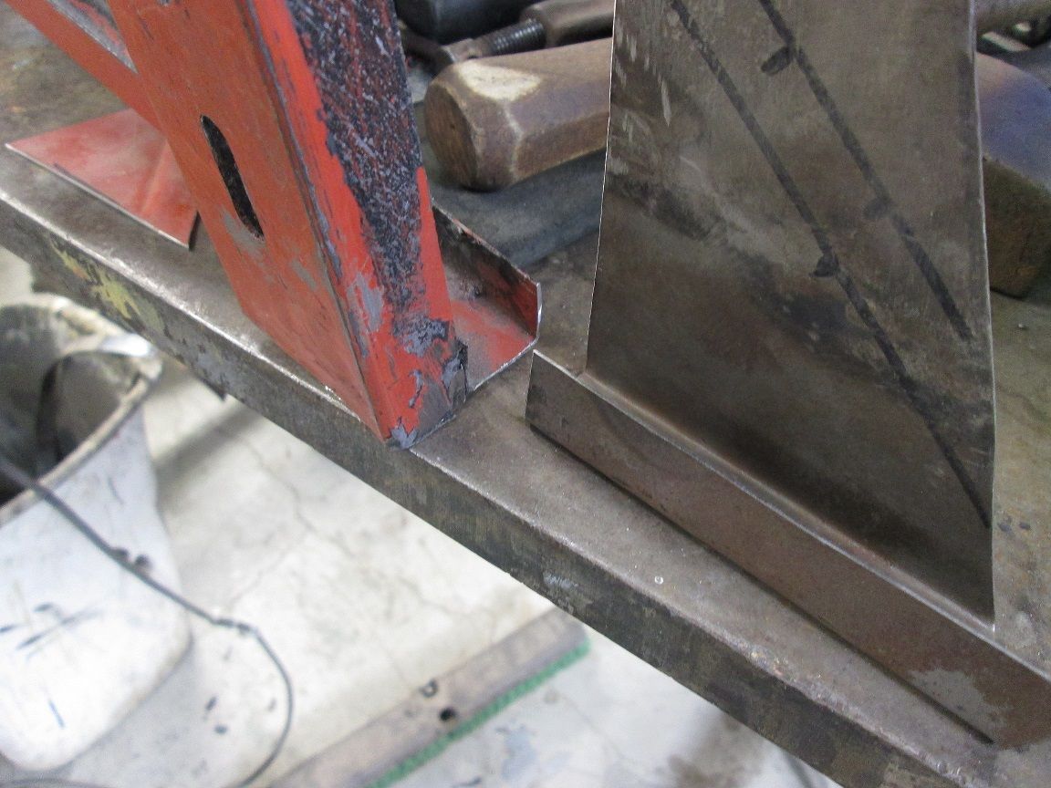

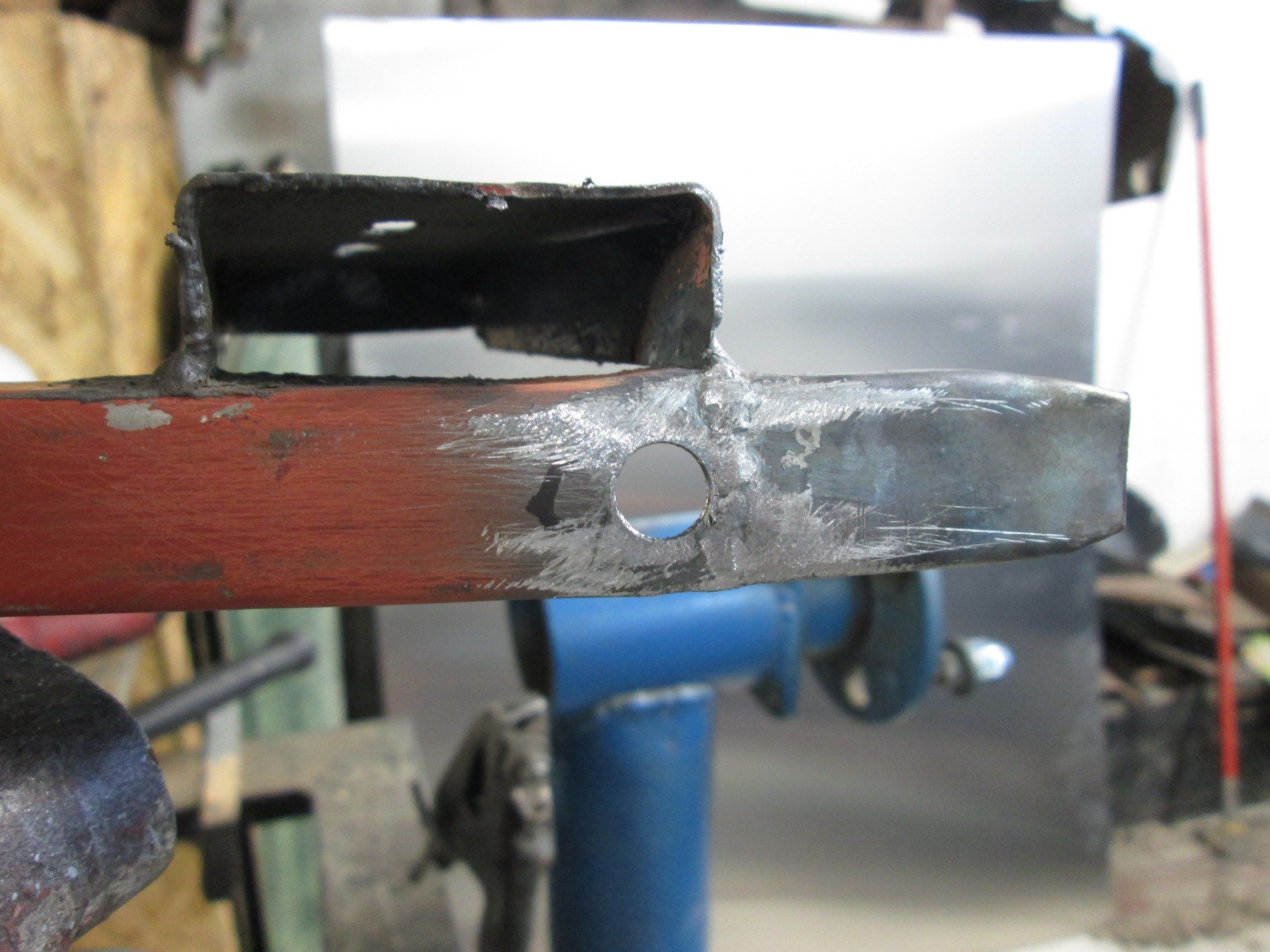

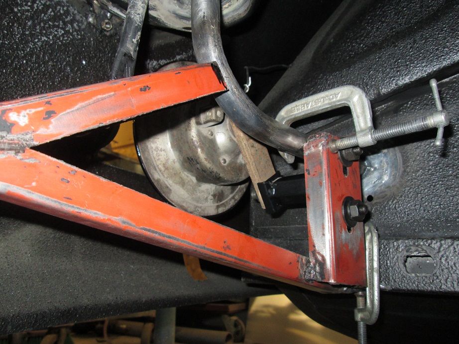

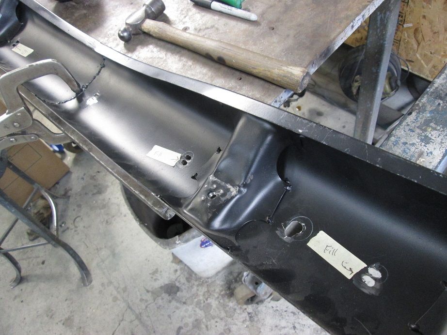

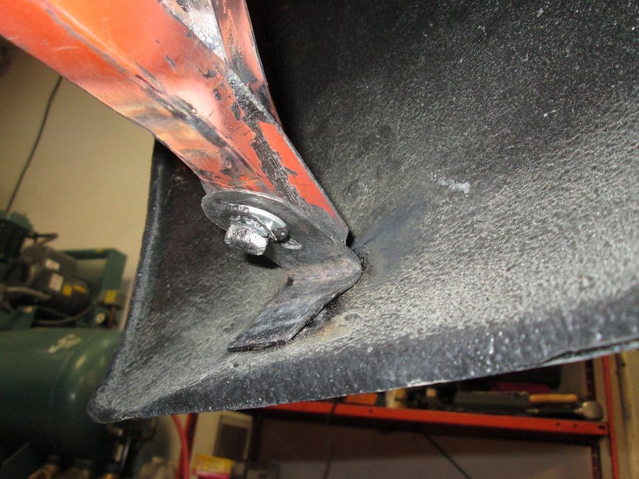

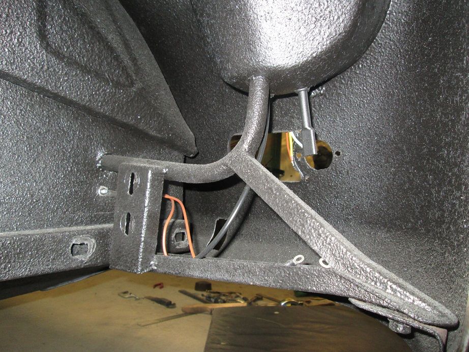

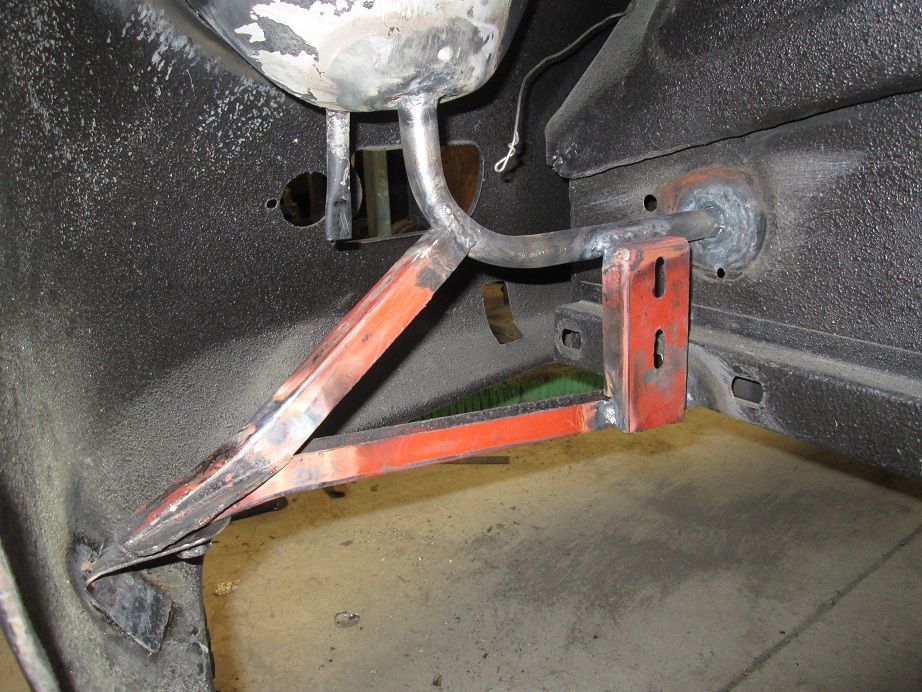

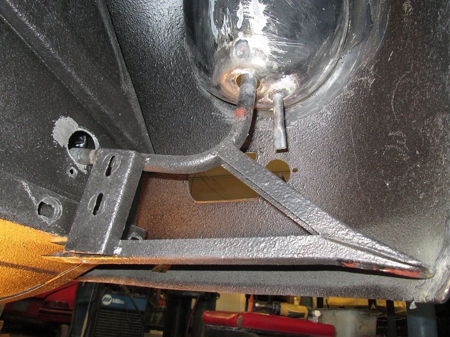

            Lower brace prep

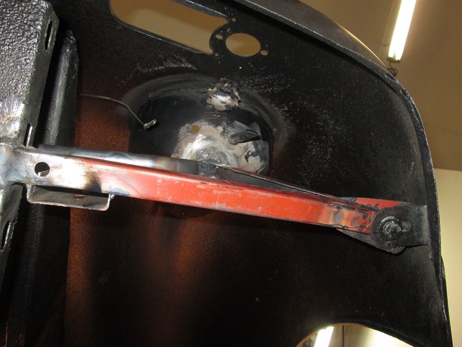

            Begin refitting lower brace but a repair to do first.

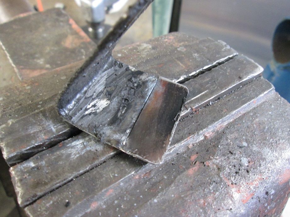

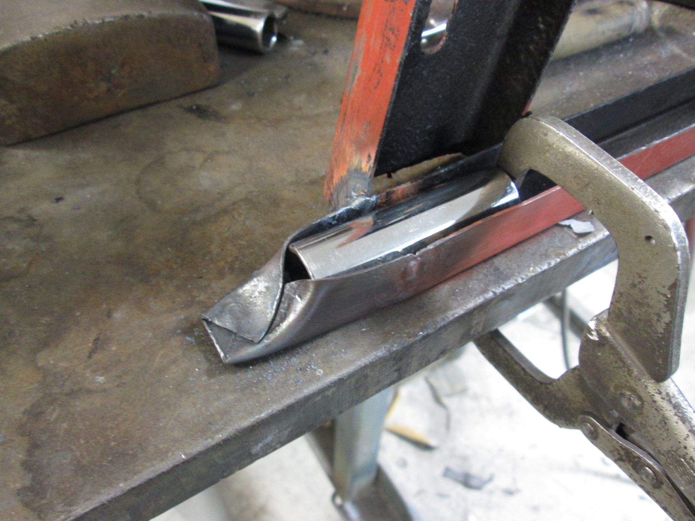

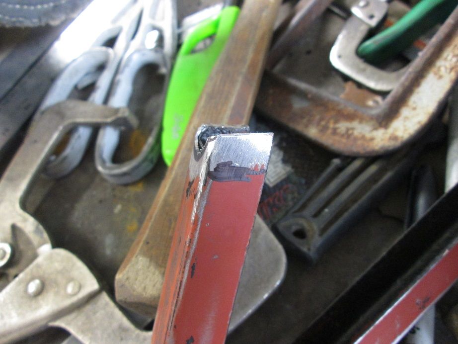

            Just have to add a small section of channel back on.
            New section installed. Beating the edges over at the tip as done originally.
            Original brace had a small drain hole just ahead of the attachment point.
            Replicated.

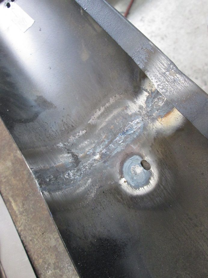

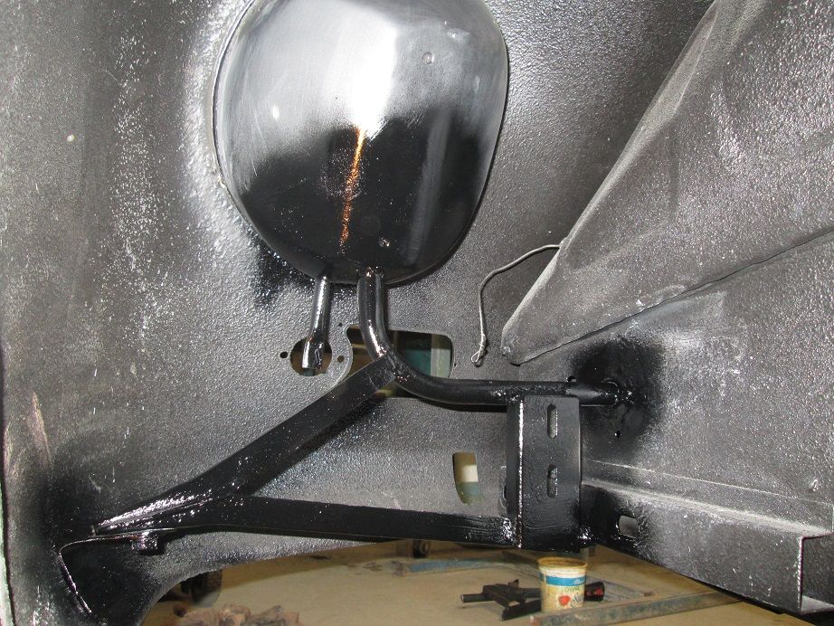

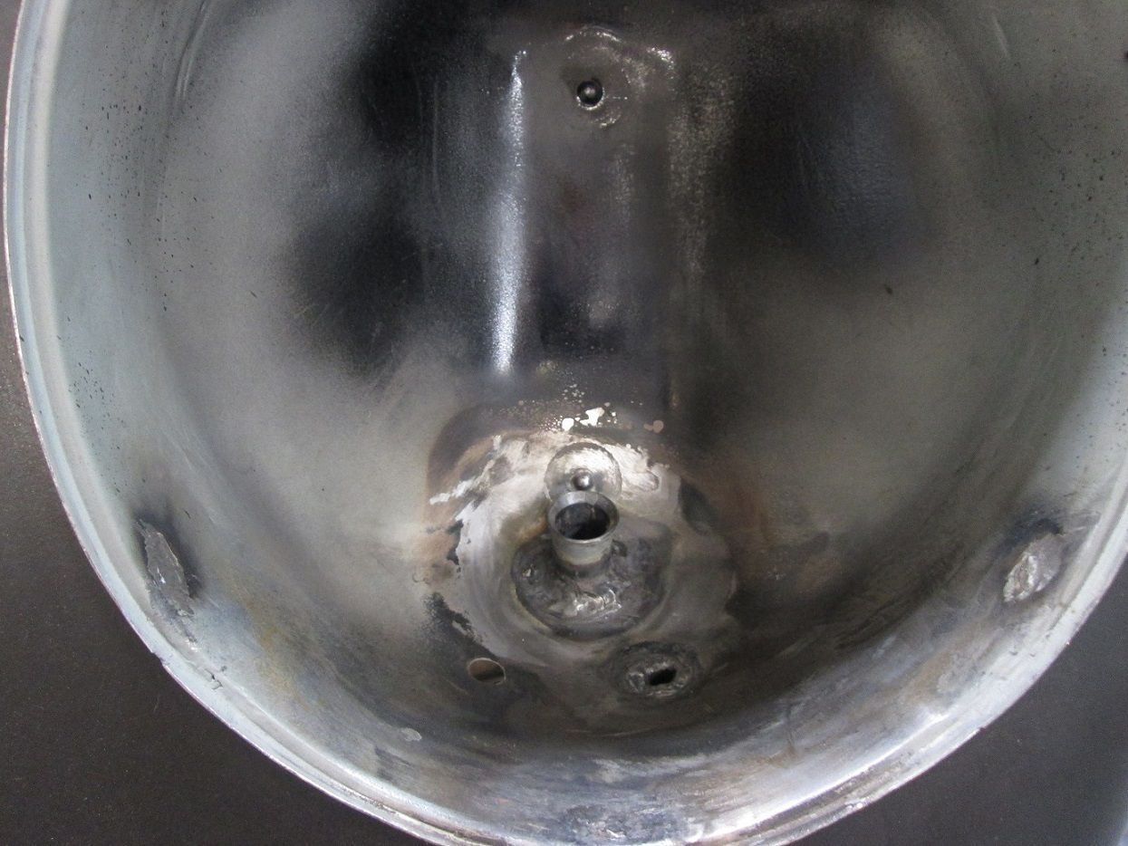

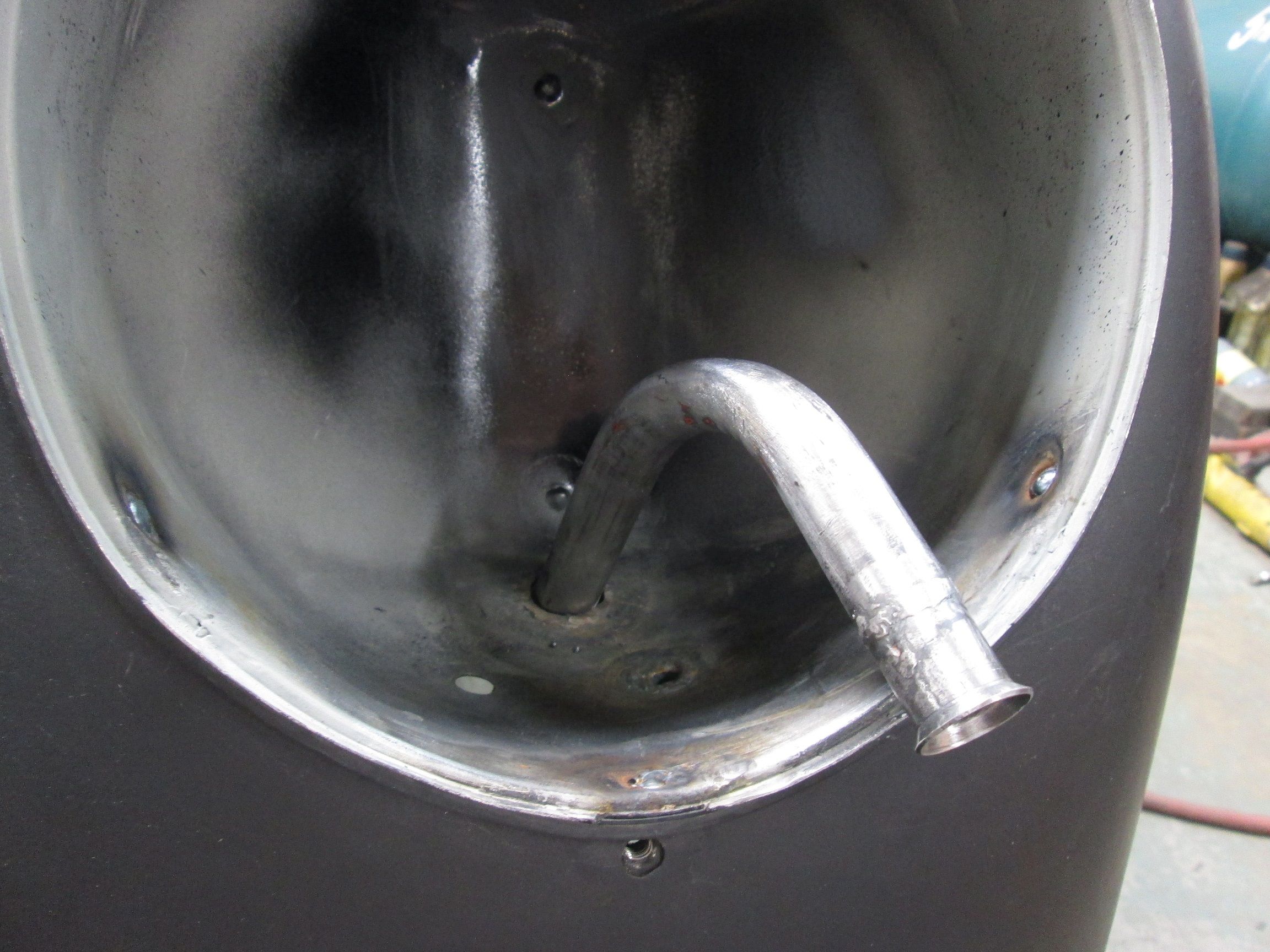

              Finishing out the conduit weld details
              Click image for larger version  Name:	IMG_0942.JPG Views:	0 Size:	150.2 KB ID:	105256
              Fully rewelded . Brain faded by painting the bucket before I finished the gas welding. Duh
              Click image for larger version  Name:	IMG_0943.JPG Views:	0 Size:	141.6 KB ID:	105257
              Runs square off the battery box wall as close as possible.
              Click image for larger version  Name:	IMG_0941.JPG Views:	0 Size:	164.3 KB ID:	105258
              Outer tack weld detail on either side of the tube replicated.
              Click image for larger version  Name:	IMG_0939.JPG Views:	0 Size:	86.4 KB ID:	105259
              gas weld detail at base and around new metal drain tube.
              Click image for larger version  Name:	IMG_0940.JPG Views:	0 Size:	152.4 KB ID:	105260
              Bucket and tube completed. Now to finish out the rest of the brace.

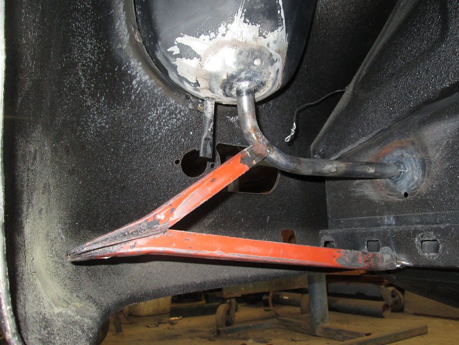

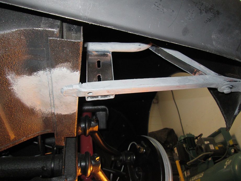

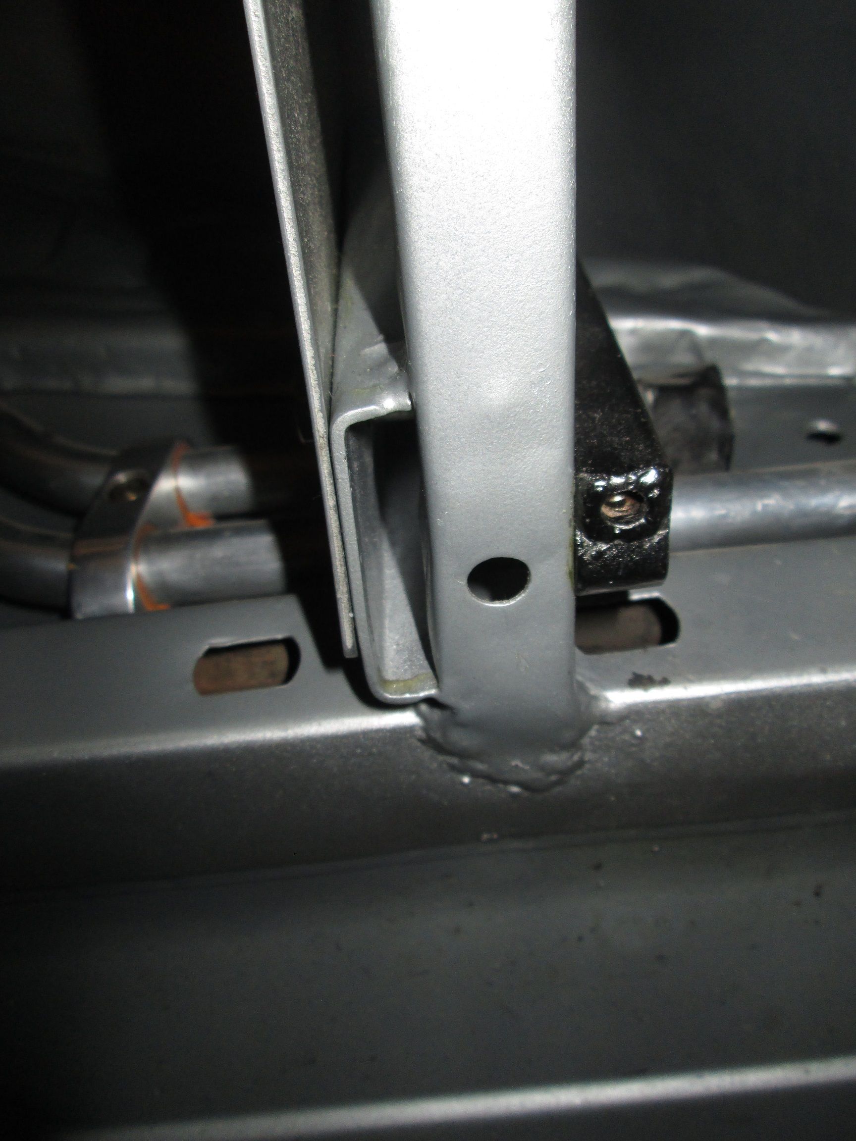

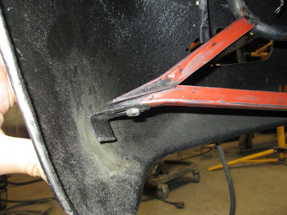

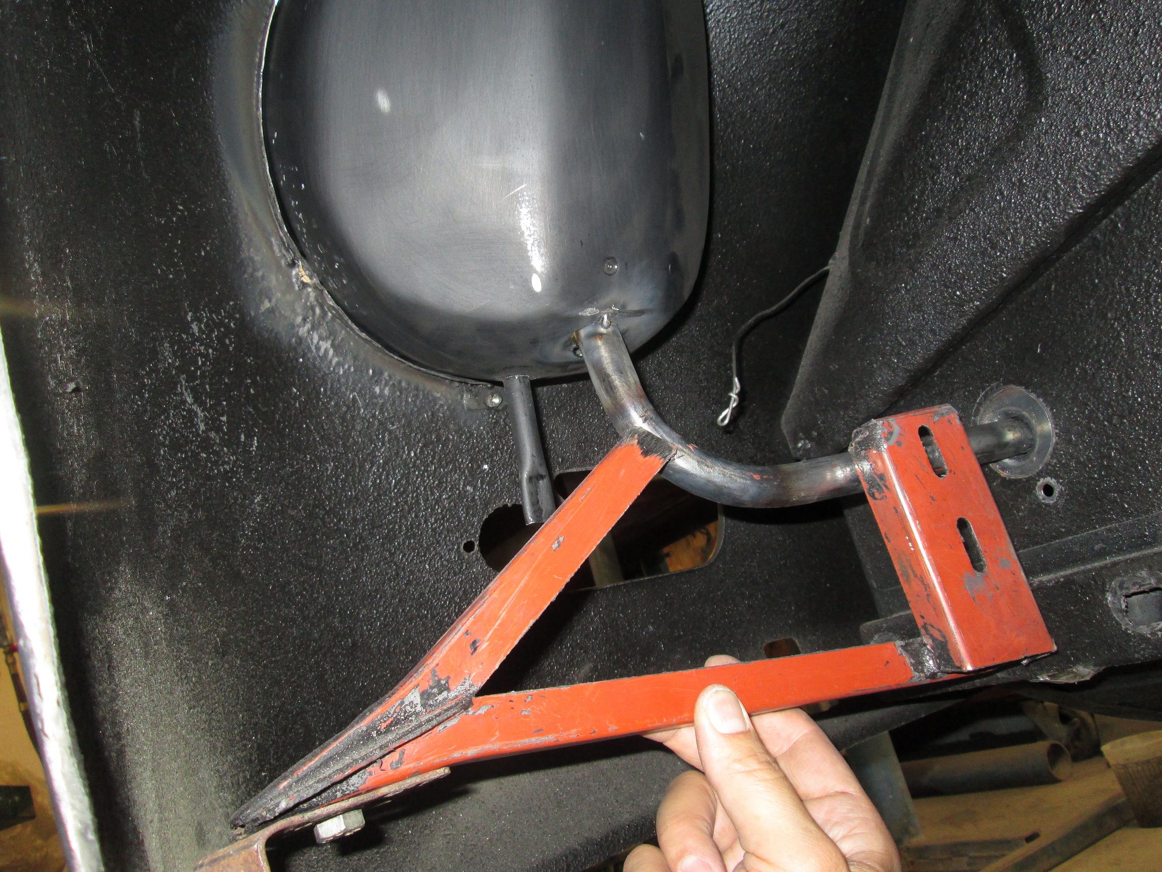

                Lower brace final refitment.
                Dialing in best average fitment between what the OG reference car is telling me and what is going to work for this particular car and its new pieces. Click image for larger version
                Changed it so much that the upper run is actually too long for my purposes now. Always nicer subtracting than having to add back on.
                Before I could commit another horn mock up was needed so I could be sure it wasn't pointing downward like I found it.
                Sits level and the horn positions nicely in the opening. Its finally ready.

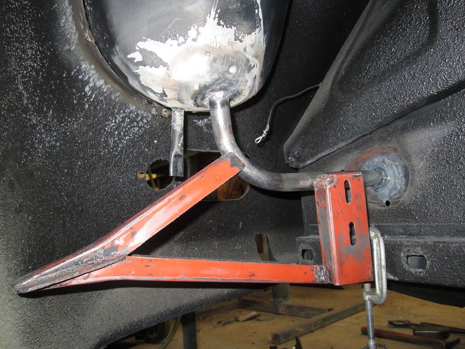

                First tack welds.

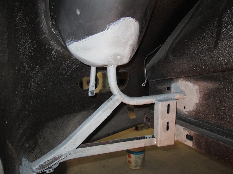

                  More brace

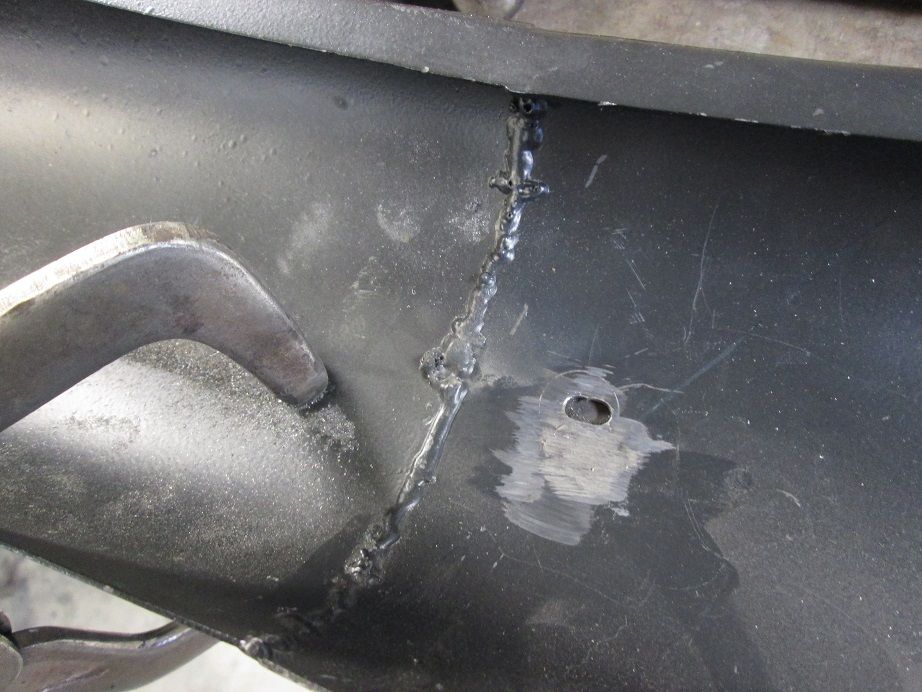

                  Click image for larger version  Name:	IMG_0958.JPG Views:	0 Size:	142.2 KB ID:	105269
                  As good as the horn mock up was I still had a depth issue with the mount itself. It was only two more welds to get it free so now was time if I was going to correct it.
                  Click image for larger version  Name:	IMG_0963.JPG Views:	0 Size:	105.5 KB ID:	105270
                  Notched just a touch to allow some slight forward movement. Now tacked where I need it. Its never straight forward...Always something.
                  Click image for larger version  Name:	IMG_0957.JPG Views:	0 Size:	125.8 KB ID:	105271

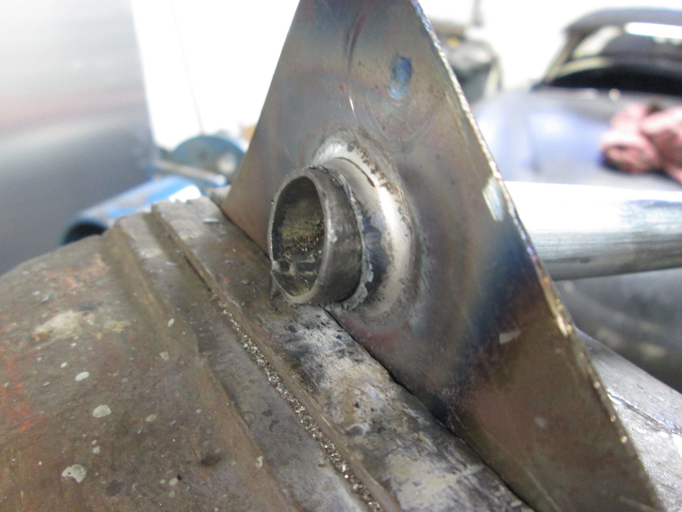

                  The final piece! Tab prep
                  Click image for larger version  Name:	IMG_0960.JPG Views:	0 Size:	114.1 KB ID:	105272
                  Adding back in a few MM's to the bottom so it will look the part.
                  Click image for larger version  Name:	IMG_0961.JPG Views:	0 Size:	126.7 KB ID:	105273
                  Now that brace is completely set into position the tab can be located to mount flush against it. Securely plug welding it from the outside over the entire mounting surface versus just zapped at the bottom edge as found.

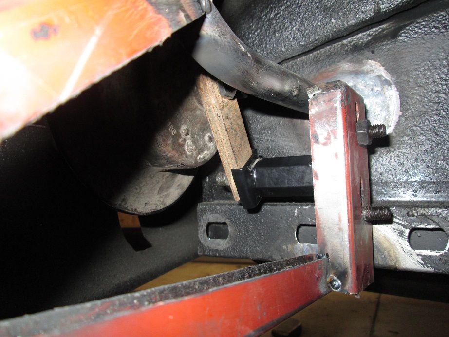

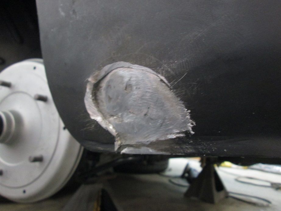

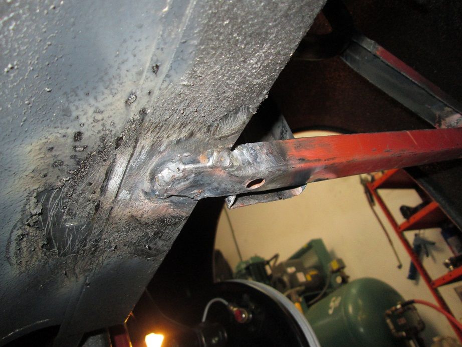

                    Left fender brace and bucket correction repairs finally complete.
                    Click image for larger version  Name:	IMG_0966.JPG Views:	0 Size:	155.9 KB ID:	105275
                    Fully installed with all gas weld details replicated. A lot more time and work than you think to both remove and prepare all the parts for reuse.
                    Click image for larger version  Name:	IMG_0967.JPG Views:	0 Size:	108.3 KB ID:	105276
                    Gas welded and shouldered more closely to the bracket as my reference car shows.
                    Click image for larger version  Name:	IMG_0968.JPG Views:	0 Size:	131.6 KB ID:	105277
                    Tab now fully secured and won't pull away from the fender as was found.
                    Click image for larger version  Name:	IMG_0970.JPG Views:	0 Size:	94.6 KB ID:	105278
                    Runs perpendicular with chassis and holds all the components where we need them. Done welding

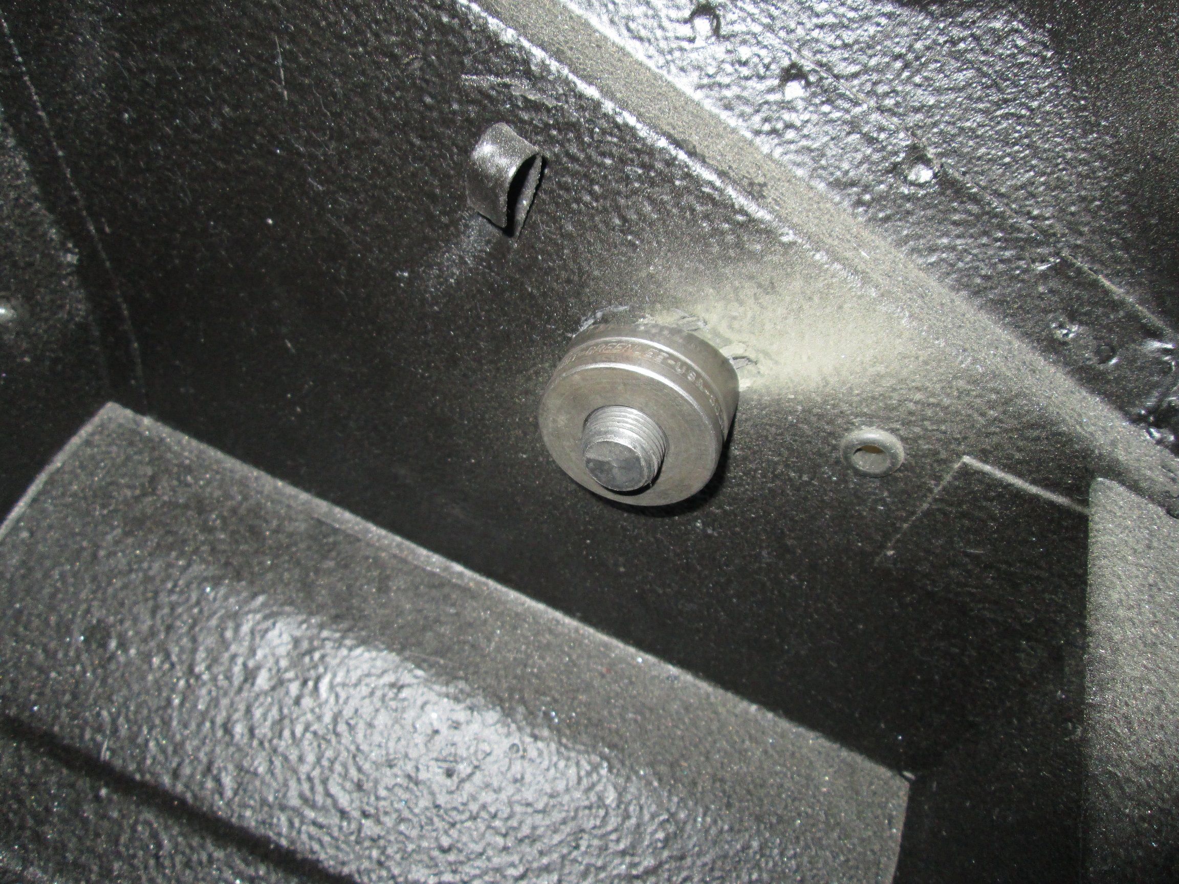

                      Sealer

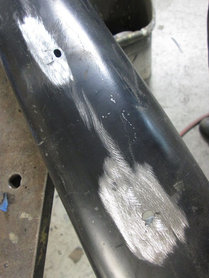

                      Scrubbed back everything that was burned and crispy in preparation for some sealer.
                      Not pretty but I decided it best to just brush it on. Click image for larger version
                      I just couldn't have a cloud of light grey overspray floating in and around all this beautifully detailed suspension. The build sequence is completely upside down at this point so all I can do is the best that I can.
                      Another round of rocker shootz should conceal the brush marks easy enough.
                      Will shoot some black on this just to ensure full coverage.

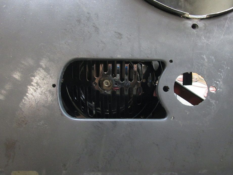

                          It all fits.

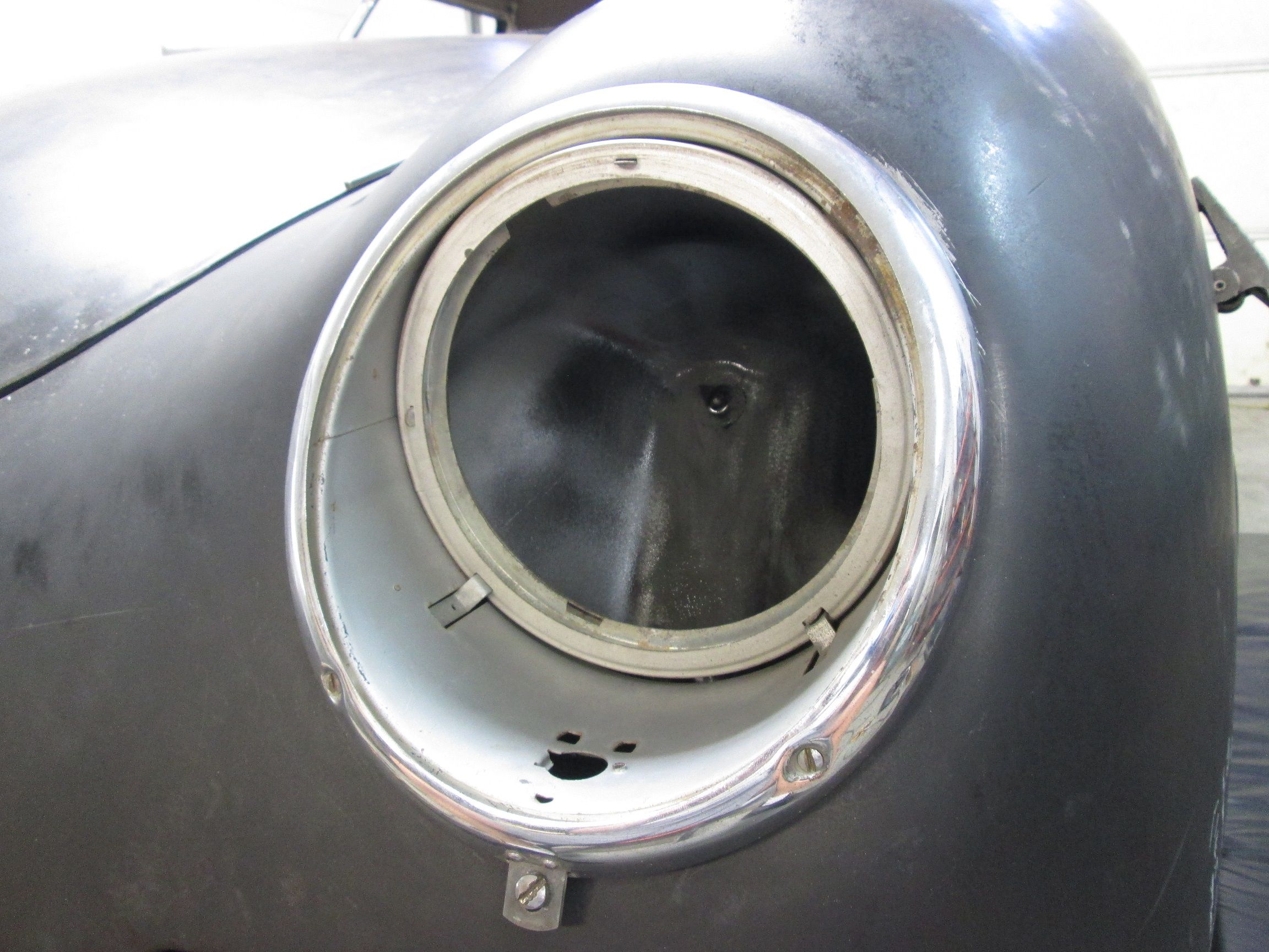

                          Headlight units mounted back in with seals. Have a bad contour issue from the edge of the hood to where the emblem mounts on the nose.
                          Click image for larger version  Name:	IMG_1104.JPG Views:	0 Size:	93.1 KB ID:	105303
                          I'll come back to that problem later. I wanted to change gears and do something different so I moved to the front bumper next. The fender braces really took it out me at this point. I'm use to doing that kind of work on a rotisserie not laying on my back a foot off the floor with grinding and welding sparks landing on me. I've been spoiled.

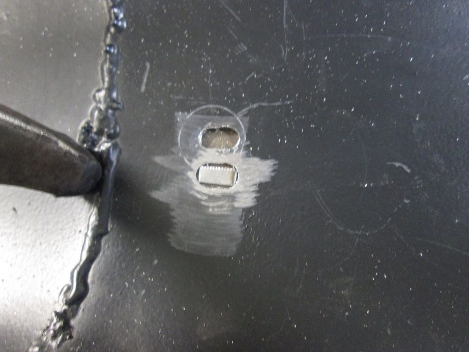

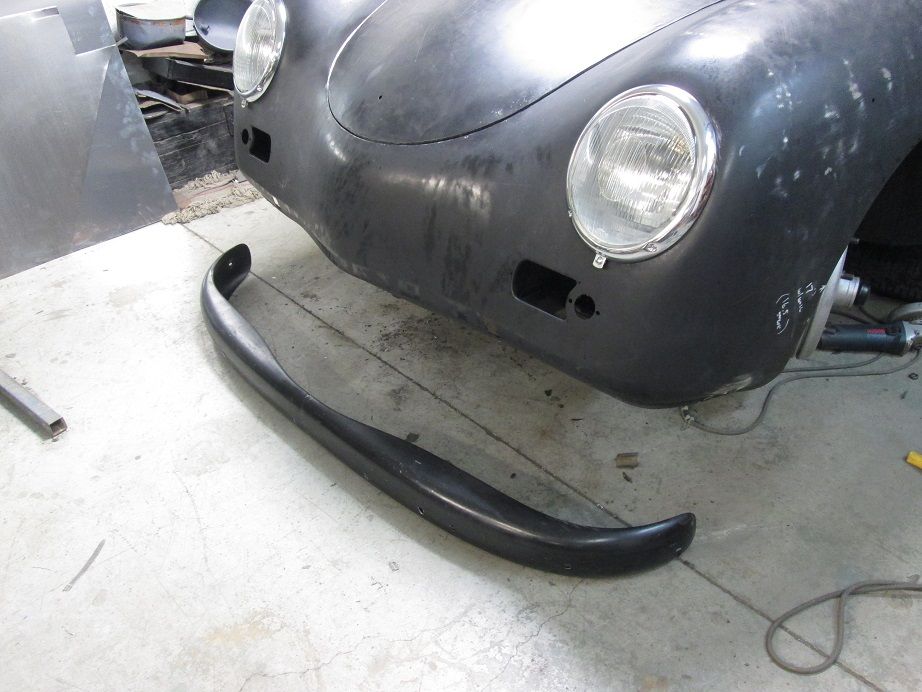

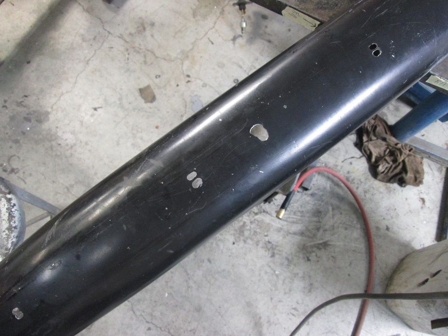

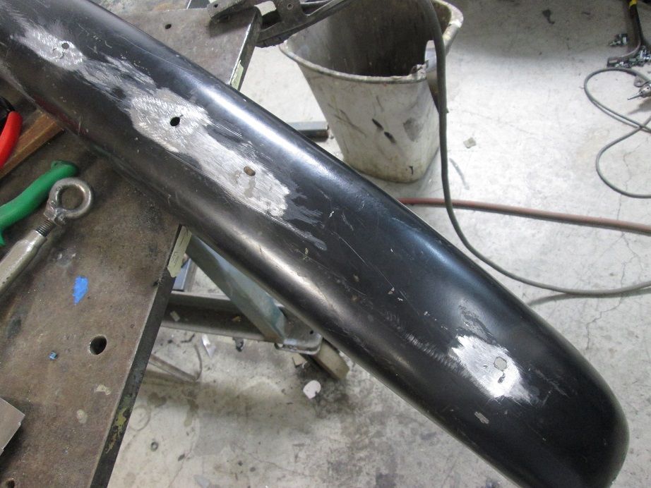

                            Front bumper prep.
                            This one is a reproduction, a really nice one but a few things had to be addressed.
                            Click image for larger version  Name:	IMG_1118.JPG Views:	0 Size:	89.4 KB ID:	105310
                            Deco trim and bumper guards have been fitted at least twice.
                            Click image for larger version  Name:	IMG_1106.JPG Views:	0 Size:	106.6 KB ID:	105311
                            Even though not ever really seen we want it to look like it hit on the first try.
                            Click image for larger version  Name:	IMG_1105.JPG Views:	0 Size:	79.1 KB ID:	105312
                            Quick little plugs to close things up easier.
                            Click image for larger version  Name:	IMG_1114.JPG Views:	0 Size:	102.4 KB ID:	105313
                            All but set. Just have to hand file the bumper guard hole up a bit.
                            Click image for larger version  Name:	IMG_1117.JPG Views:	0 Size:	103.4 KB ID:	105314
                            Onto the next deal.

                              Click image for larger version  Name:	IMG_1107.JPG Views:	0 Size:	102.4 KB ID:	105316
                              This bumper is two halves seam welded at the center just the original but MIG welded.
                              Click image for larger version  Name:	IMG_1109.JPG Views:	0 Size:	93.0 KB ID:	105317
                              Originals where gas welded.
                              Click image for larger version  Name:	IMG_1110.JPG Views:	0 Size:	107.7 KB ID:	105318
                              This can always be seen at some angles so I wanted to get this detail correct. Dressed the shoulder of the wire weld nearly flush.
                              Click image for larger version  Name:	IMG_1111.JPG Views:	0 Size:	92.8 KB ID:	105319
                              Followed up with my torch. Done and looks the part.
                              Click image for larger version  Name:	IMG_1112.JPG Views:	0 Size:	103.3 KB ID:	105320
                              Bumper had a noticeable low spot at the weld joint before I began work on. After some torch heat the area was very aggregable to some pick and file work to bring the area up to reduce filler.
