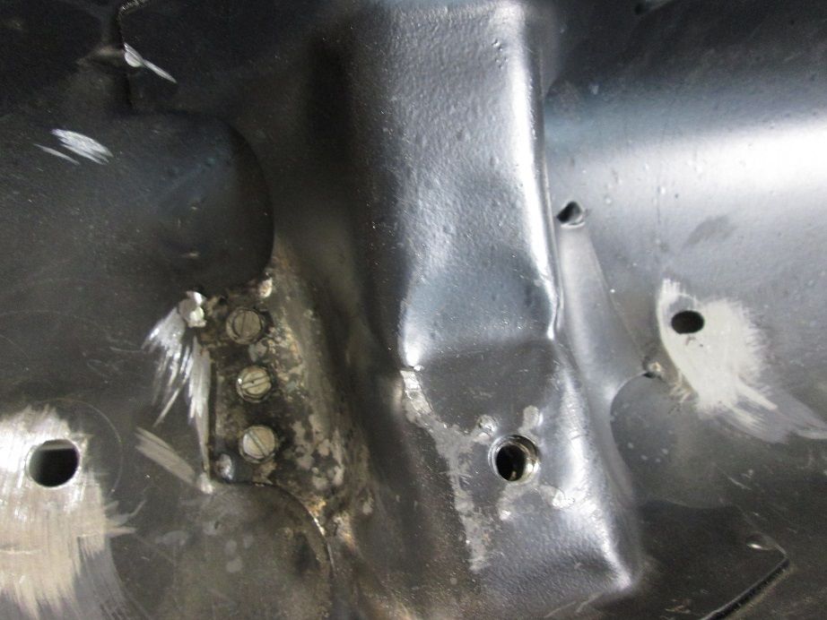

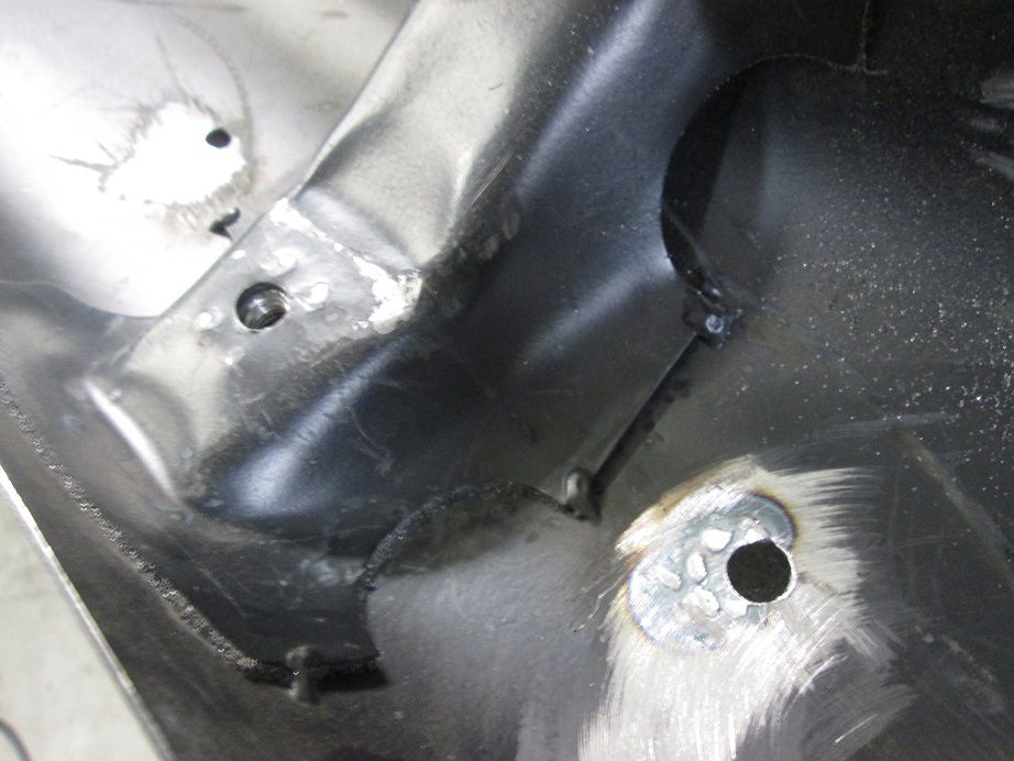

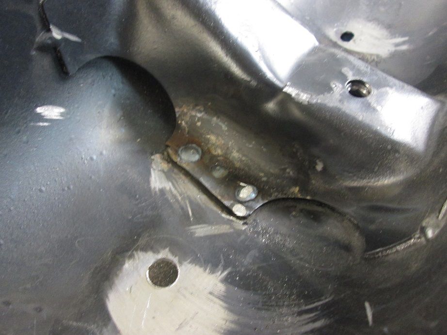

    Front bumper mounting pedestals.
    Click image for larger version  Name:	IMG_1119.JPG Views:	0 Size:	84.0 KB ID:	105327

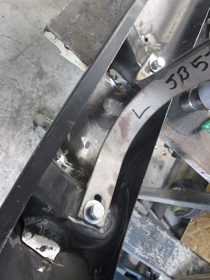

    Noticed all four of the inner mount stand-offs where only tack welded in and with a large air gap as the above photo high lights. Between road vibration and wind buffering these would crack loose eventually.
    Click image for larger version  Name:	IMG_1132.JPG Views:	0 Size:	85.3 KB ID:	105328

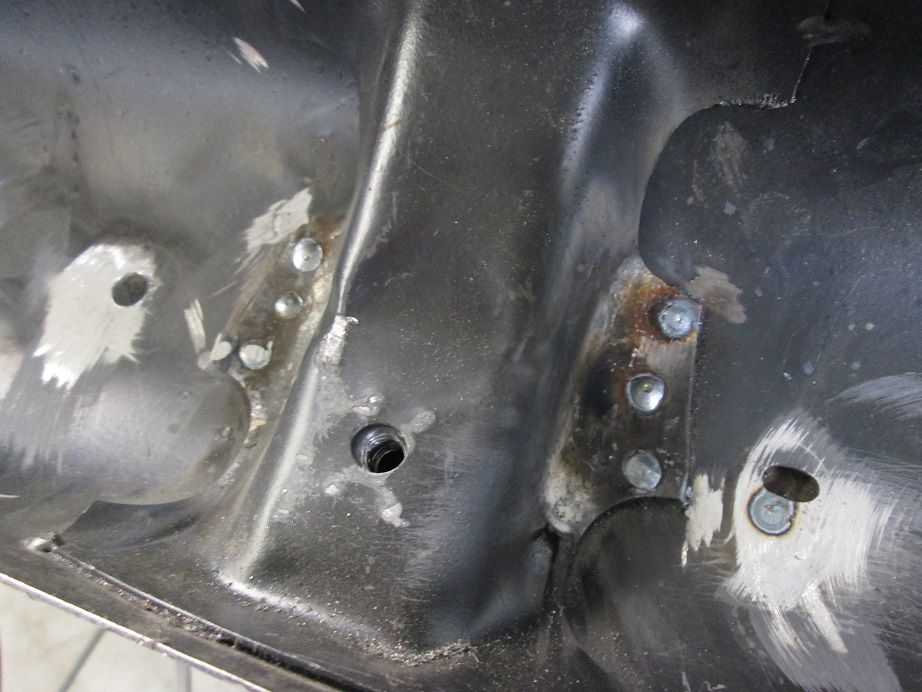

    Cut away the tack welds a side at a time then set screwed the mounting flanges down tight like they should be.
    Click image for larger version  Name:	IMG_1133.JPG Views:	0 Size:	86.0 KB ID:	105329
    Finished off with plug welds.
    Click image for larger version  Name:	IMG_1134.JPG Views:	0 Size:	95.7 KB ID:	105330
    Not coming free anytime soon.

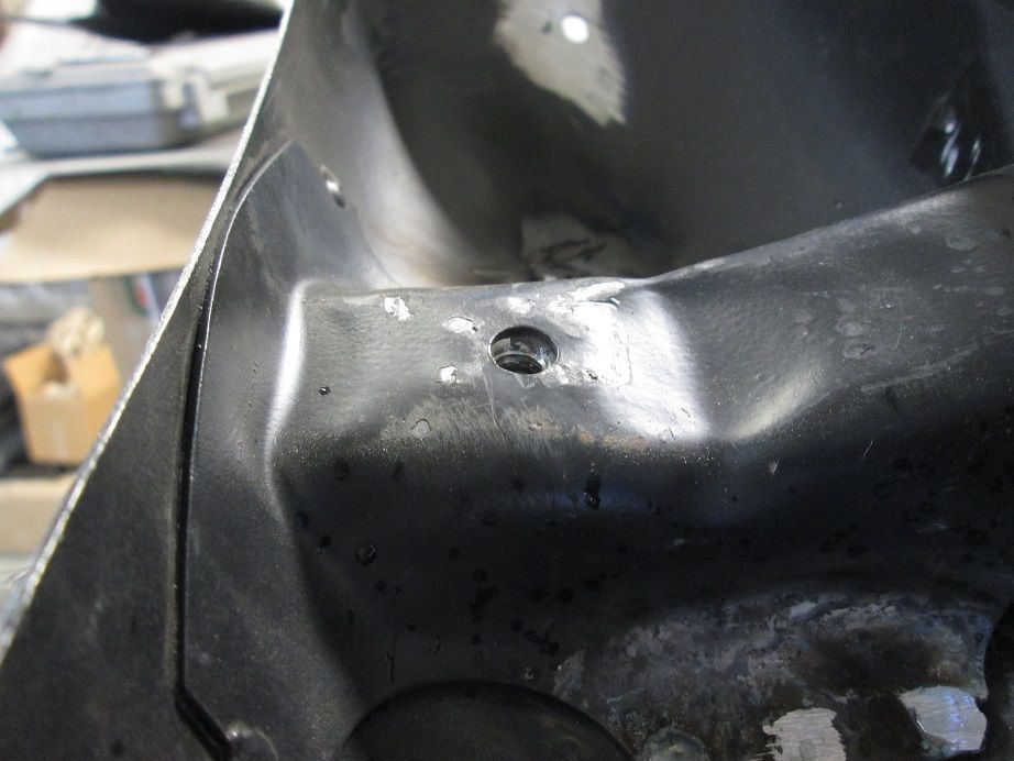

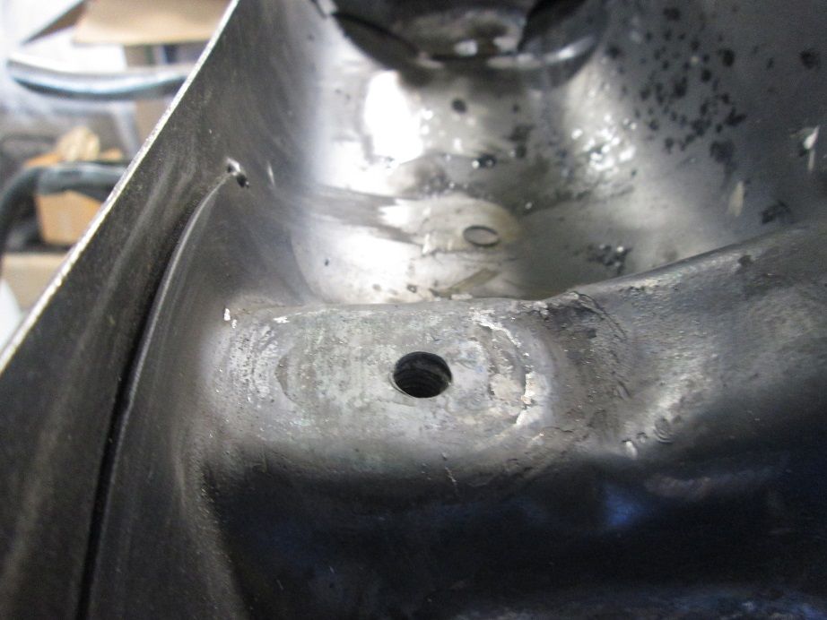

ID:	105331 Last issue I had was with the mount surface for the bumper irons. Lumpy and peaked at the hole making a poor contact surface for the iron itself.
      Some heat and light hammering squared the surface off nicely.

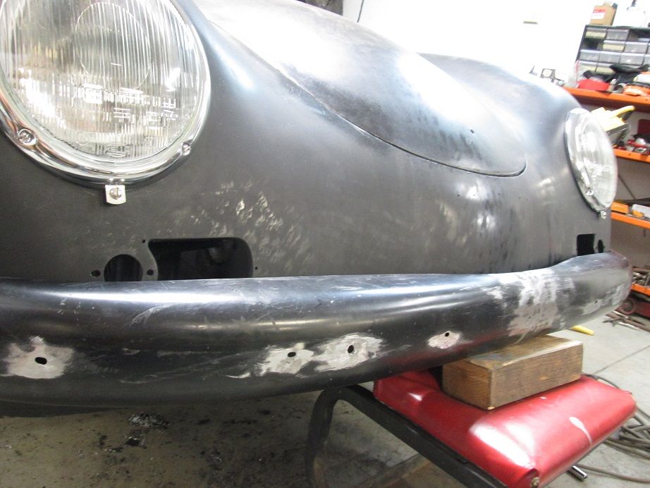

      • #34

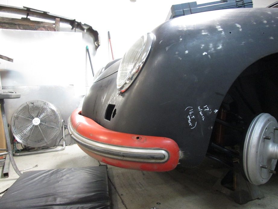

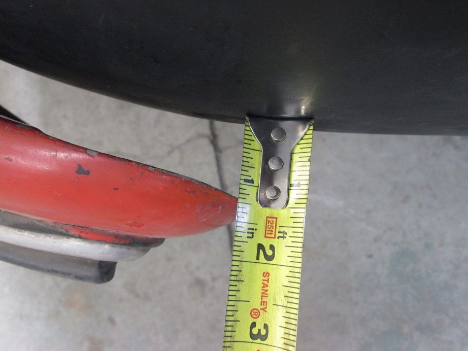

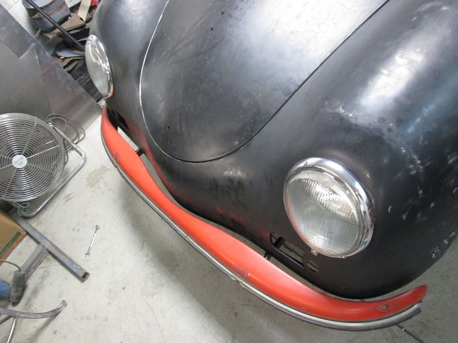

        Front bumper mounting and adjustment.
        Click image for larger version  Name:	IMG_1162.JPG Views:	0 Size:	94.0 KB ID:	105371
        Since the front end group is new and the bumper is as well I needed a mock up with an original bumper just so I could see what was what.
        Click image for larger version  Name:	IMG_1158.JPG Views:	0 Size:	81.4 KB ID:	105372
        This OG unit actually adjusted and gapped out beautifully with the nose of this car. A few promising sign.
        Click image for larger version  Name:	IMG_1167.JPG Views:	0 Size:	76.8 KB ID:	105373
        After a bit of jockeying it was fitting as well as the original.
        Click image for larger version  Name:	IMG_1170.JPG Views:	0 Size:	77.6 KB ID:	105374
        Gapped and contoured nicely against the nose.

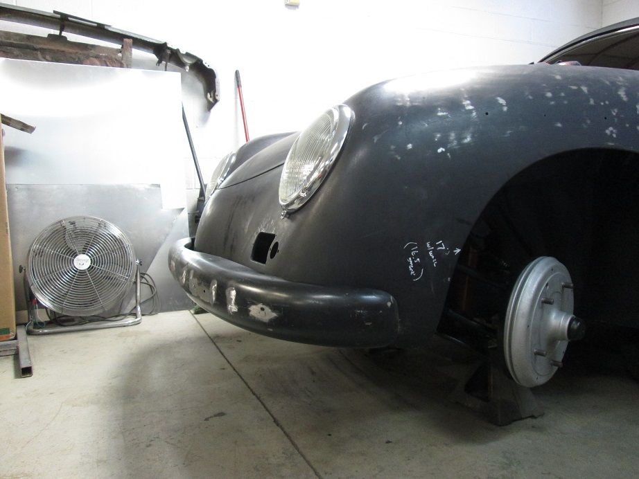

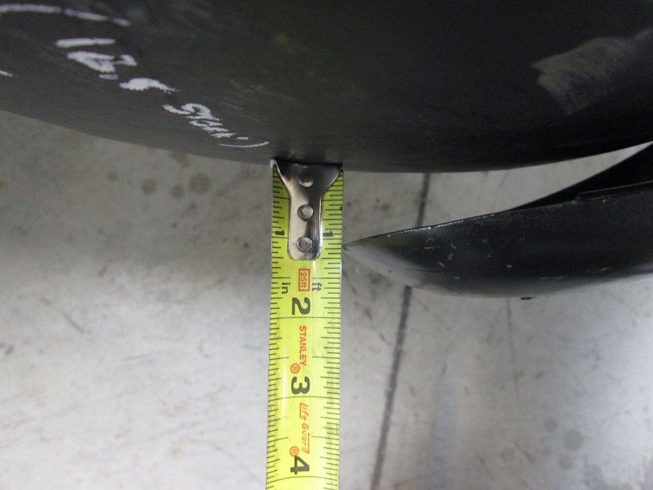

        Ends where coming out even at just over an inch.

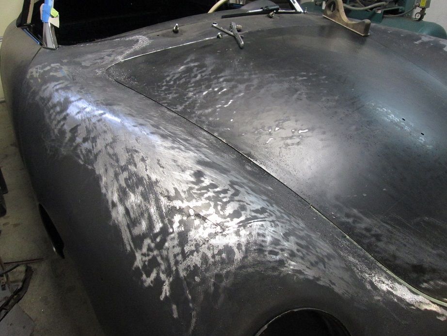

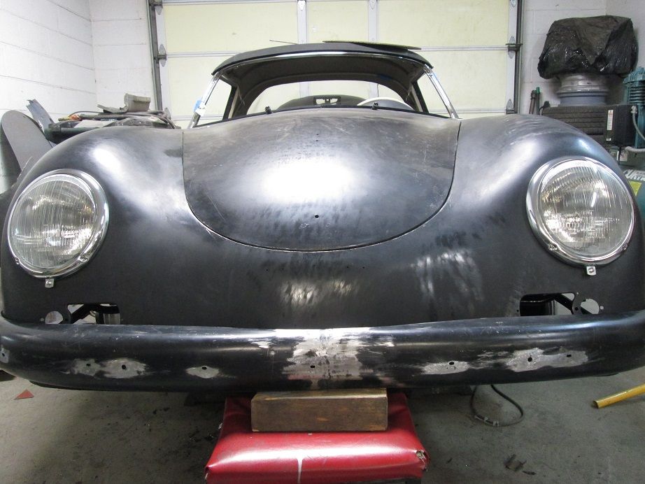

        • #35
          Click image for larger version  Name:	IMG_1174.JPG Views:	0 Size:	61.1 KB ID:	105378

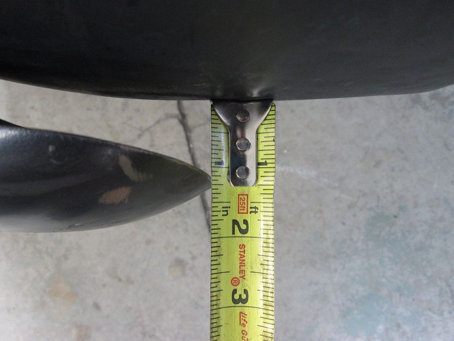

          About the same on the right.
          Click image for larger version  Name:	IMG_1165.JPG Views:	0 Size:	68.0 KB ID:	105379
          And the original for contrast. As close as I was going to get.
          Click image for larger version  Name:	IMG_1098.JPG Views:	0 Size:	81.3 KB ID:	105380
          Onto the next deal. Contour issues nose to trunk. That up next.

          • #36

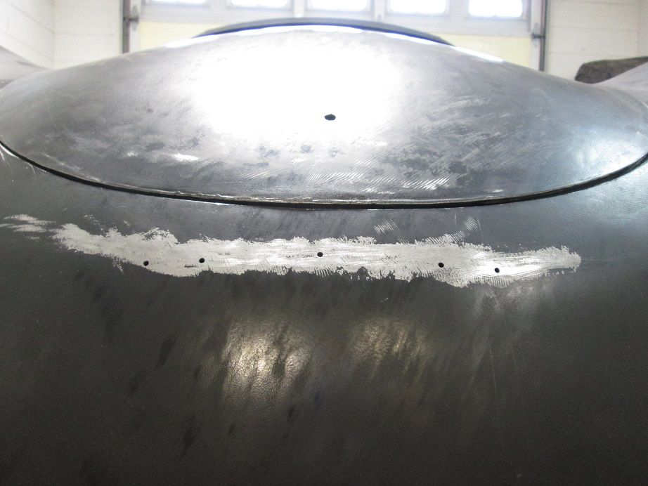

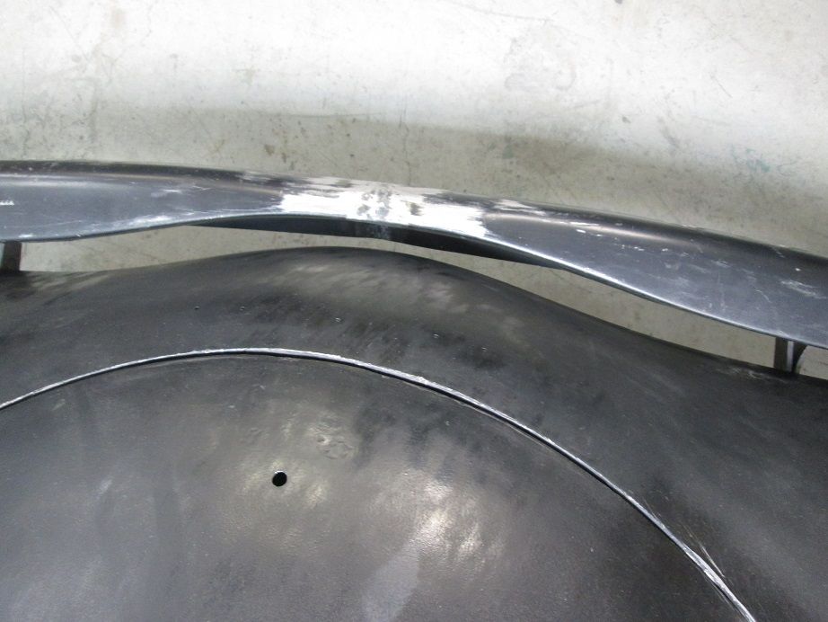

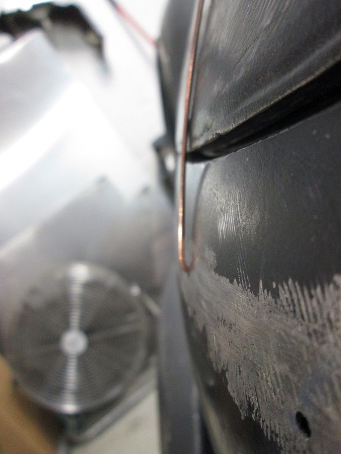

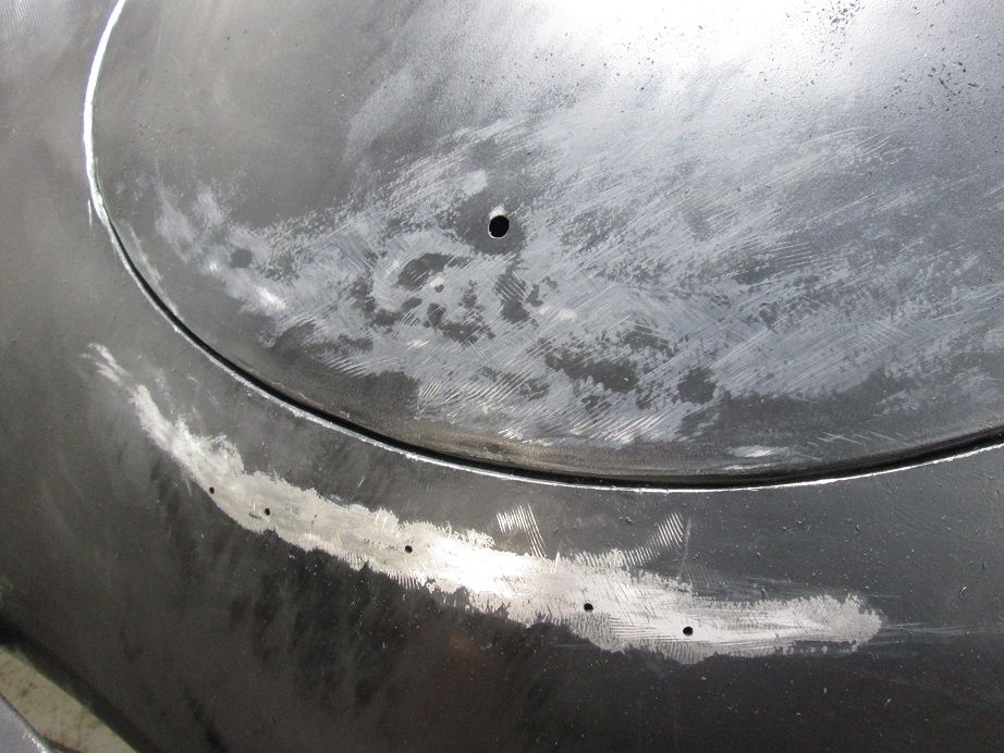

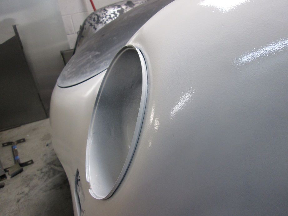

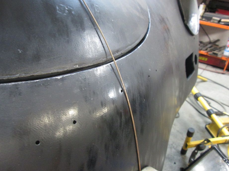

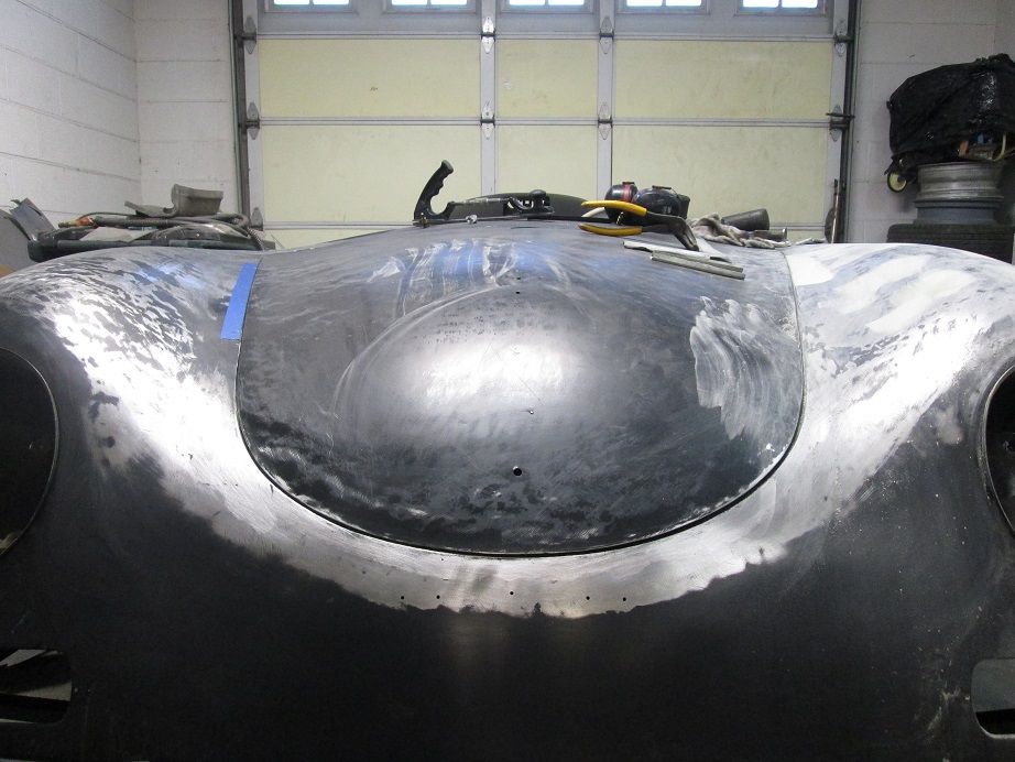

            Body contour issue at the nose.
            Click image for larger version  Name:	IMG_1176.JPG Views:	0 Size:	111.1 KB ID:	105404
            A really bad lump in the profile shape right at the emblem and now highlighted with a quick filing. Should be a smooth graceful transition but a notable ridge here then quickly drops in to meet the edge of the hood. Can be overlooked in flat black primer but a reflective surface is really going to draw attention to this issue. With the emblem in position it might well draw your eye away from it and maybe that's what the shop that built this car was thinking but I can't leave that.
            Click image for larger version  Name:	IMG_1204.JPG Views:	0 Size:	64.1 KB ID:	105405
            Since the die has been set the least invasive thing I could was to move the hood forward a few MM's creating a little overbite. The plan now is to skim coat the lip between these two points to eliminate or least to soften that ridged profile.
            Click image for larger version  Name:	IMG_1207.JPG Views:	0 Size:	87.2 KB ID:	105406
            Moving the hood forward closed the initial gaps even tighter but there is a lot of lead through here so I can reestablish them.
            Click image for larger version  Name:	IMG_1208.JPG Views:	0 Size:	79.7 KB ID:	105407
            I'll have to add about another credit cards thickness of filler to raise this low area between the hood and the lump but I'll also be removing additional filler to open up the hood gap so its a trade off but one that corrects this oversight.
            More on this later. Thanks for looking!

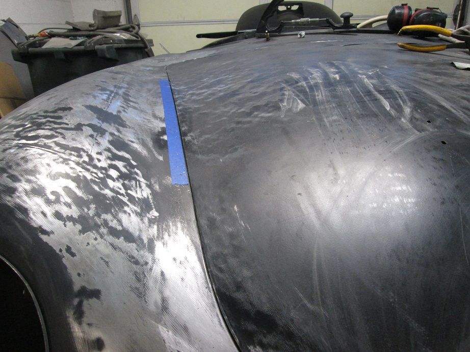

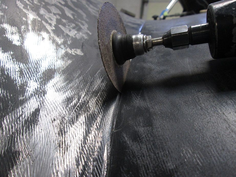

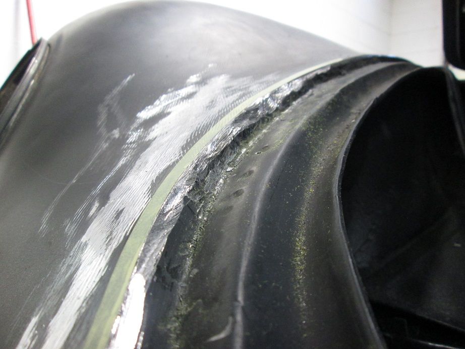

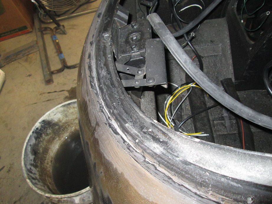

              Carving out the new hood gap.

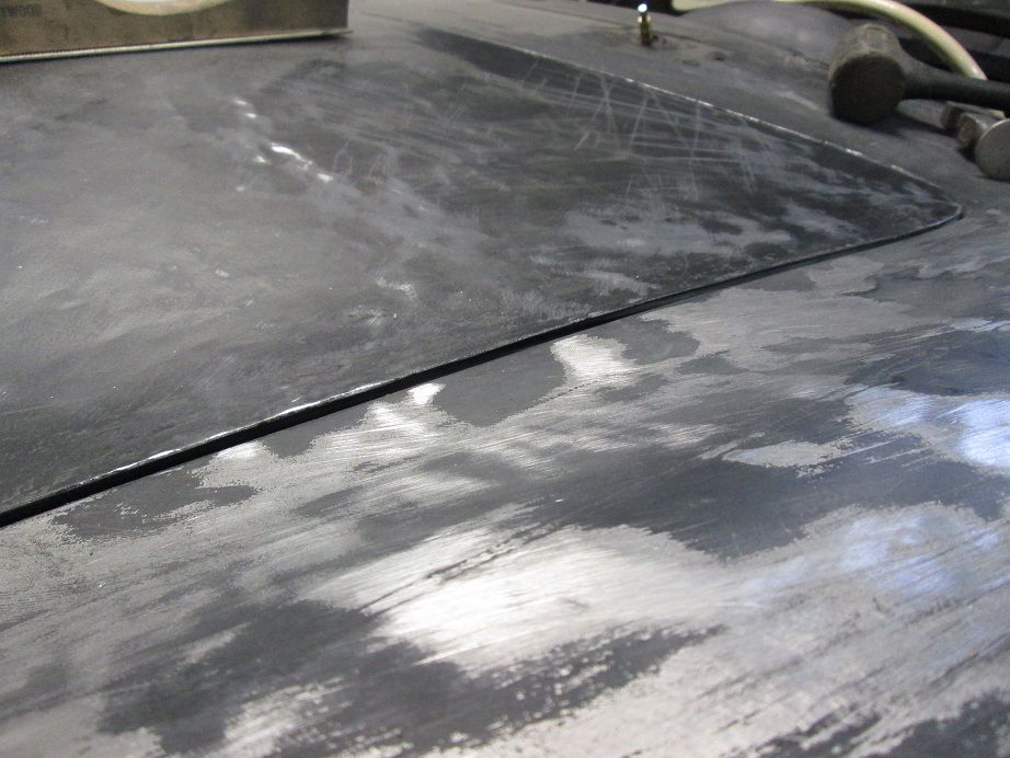

              Outlined a basic 3mm gap in tape against the readjusted hood with seal.
              Slowly bringing the shoulder down to the edge of the tape.
              Another (among many) against the latched with seal reinstalled.

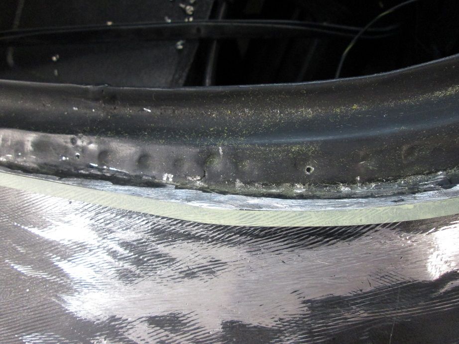

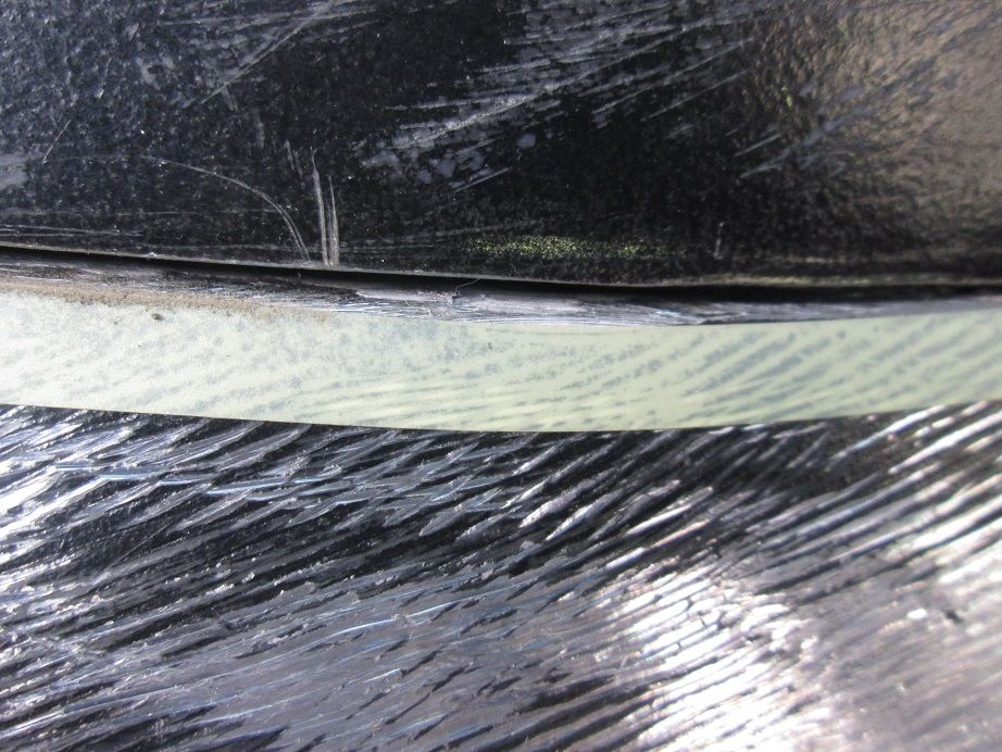

              Continue widening.

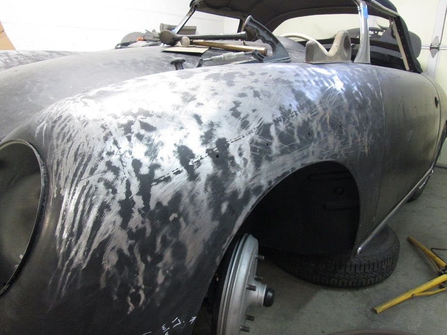

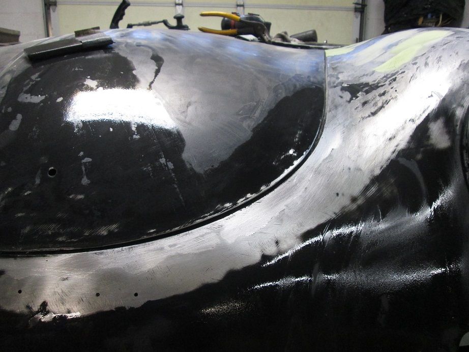

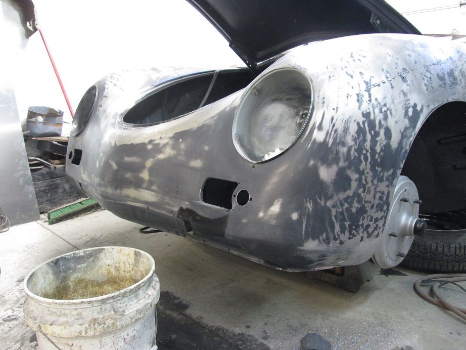

                Begin looking at the entire front end group shape as a whole.
                Light body filing just to highlight the low and high spots. The low section under the edge of the hood is coming into focus.
                The hood has been through the mill. It was kinked at some point, the skin removed just as Phil is doing right now messaged and reassembled. Lots small irregularities but nothing serious. (so far)
                Same thing going on over here. Only small stuff but flat black primer sure makes the surface seem a lot nicer than it really is.
                Rollers and height discrepancies along the edge of the hood but expected and will be addressed shortly.

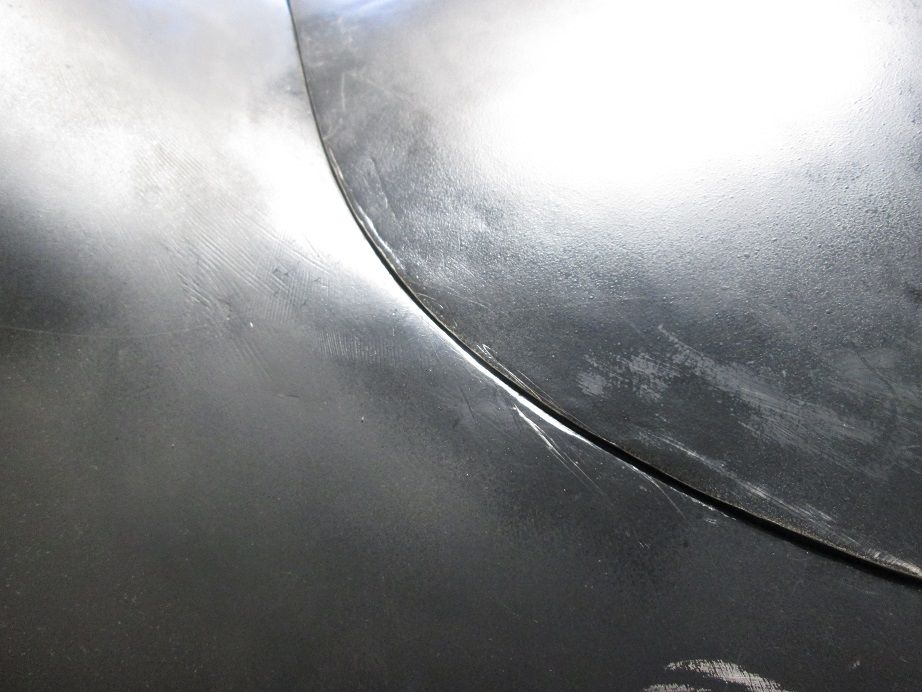

                  Hood gaps
                  Tedious job of hand filing the inner surface for gap and shape.
                  Slowly started whittling the lead down to the shape I was after. A lot of lead use so I had plenty to work with.
                  Hood seal reinstalled (for the hundredth time) and latched to check for final gap and shape. Left forward corner here getting really close. Heading up the sides next.
                  Right side gap is a lot tighter by contrast but marking out the desired gap with tape here.
                  Quite the repetitive process to develop and dial it in with the hoods new position but on the right track.

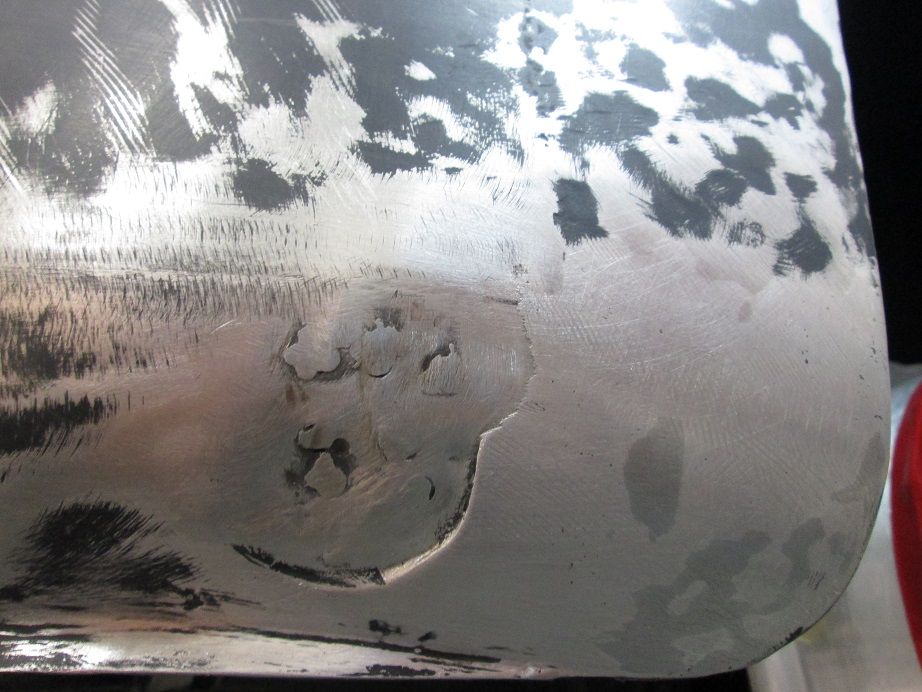

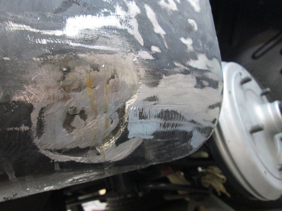

                    Prepping left corner and fender for some base sealer.
                    Lots of lead on this car and a good deal of it doesn't need to be there. This lower corner thickness can stand some thinning.
                    After some file shaping a solid several MM's removed. Basic shape and contour retained with a now reasonable filler thickness and spots of steel coming through. Much happier with this now.

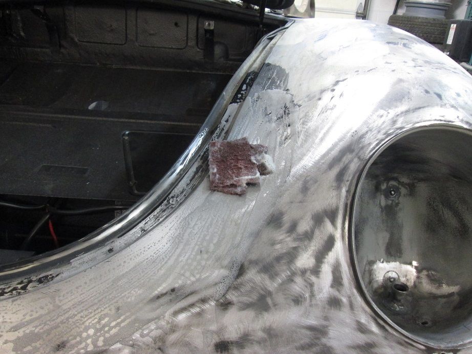

                    Exposed leaded areas thoroughly scrubbed with soapy water to make sure any tinning acid residue removed.
                    Behind initial sealer coat and now ready to begin the bodywork phase on this corner.

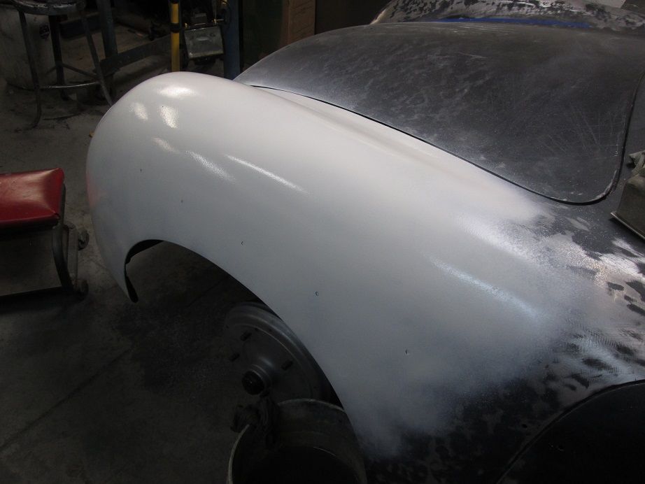

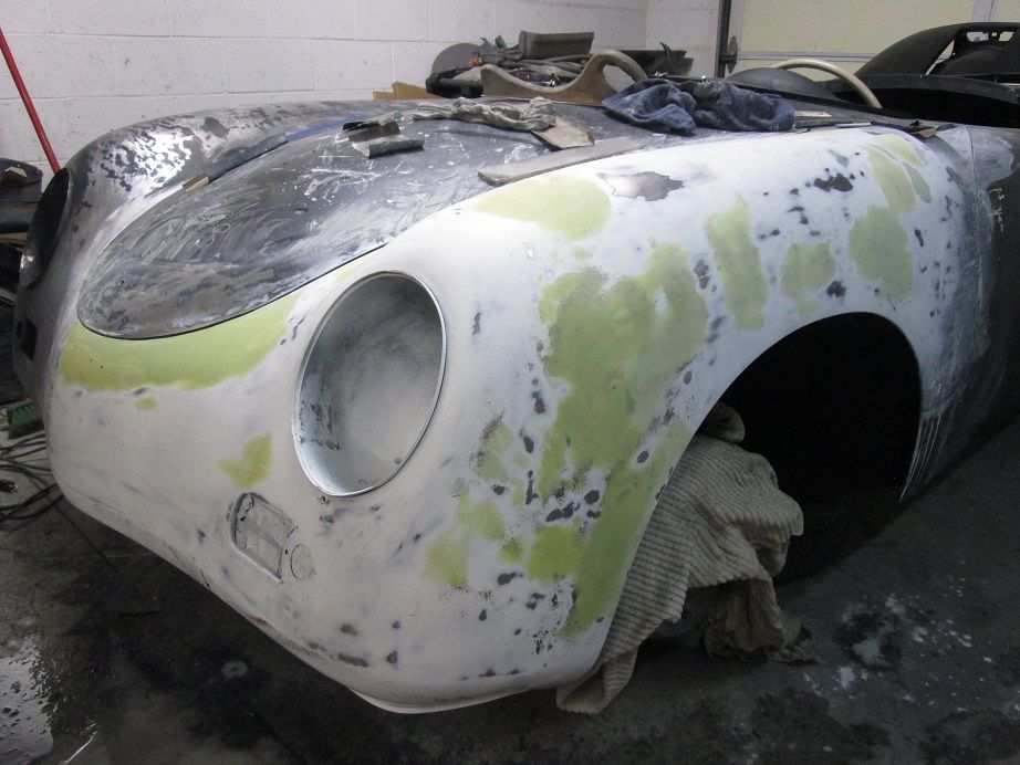

                    • #44

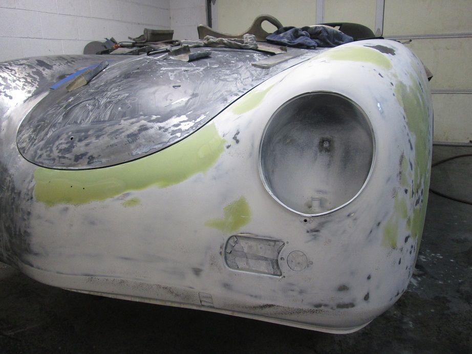

                      Begin bodywork phase left corner
                      Click image for larger version  Name:	IMG_1422.JPG Views:	0 Size:	59.9 KB ID:	105601
                      Those buckets really needed to come back in. So glad we corrected that,
                      Click image for larger version  Name:	IMG_1423.JPG Views:	0 Size:	61.0 KB ID:	105602
                      Good general shape but a lot of blocking and skim coating to get near perfect.
                      Click image for larger version  Name:	IMG_1430.JPG Views:	0 Size:	83.6 KB ID:	105603
                      Following day was initial block sanding on the sealer then swatching it where it was low.
                      Click image for larger version  Name:	IMG_1431.JPG Views:	0 Size:	93.5 KB ID:	105604
                      Bringing that area below the hood up for a smooth flowing transition. While in the middle of this another slight contour issue caught my eye. Posting that next.
                      thanks for looking!
