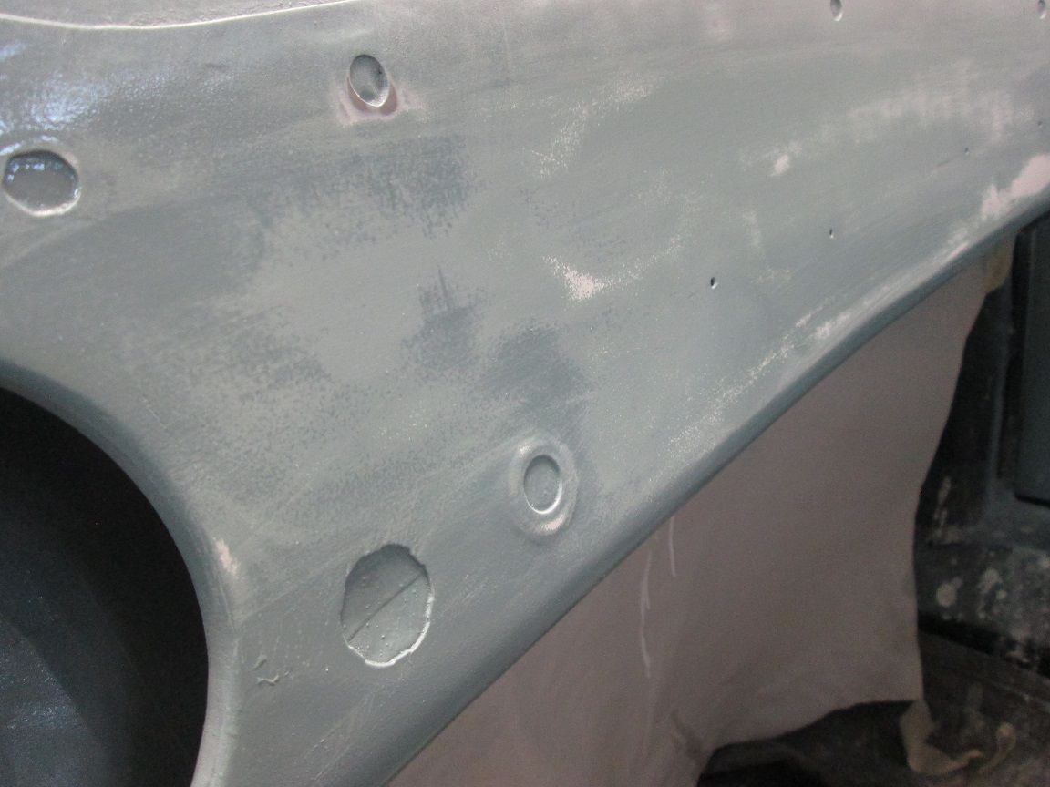

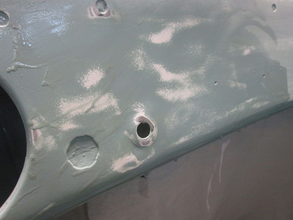

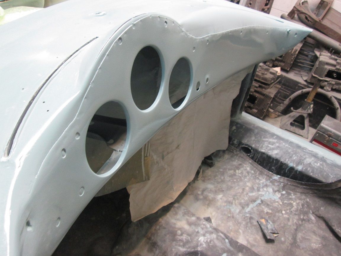

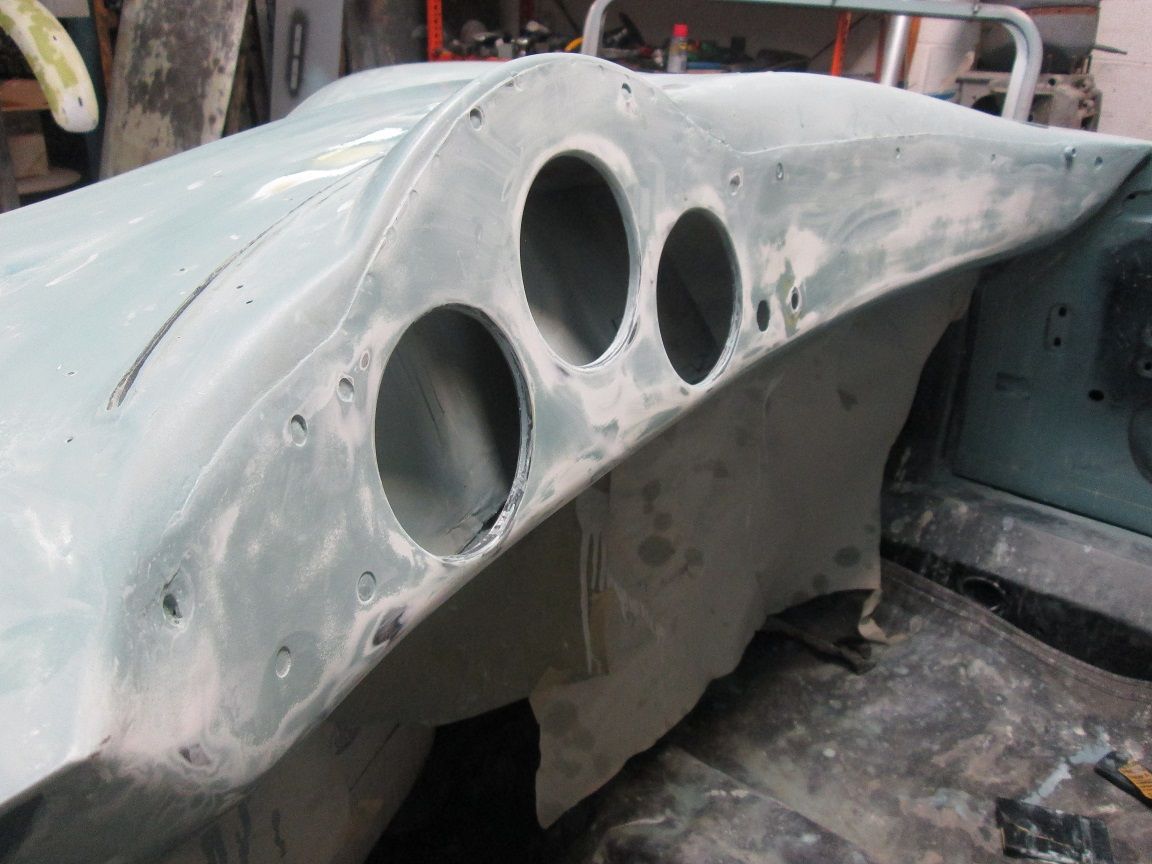

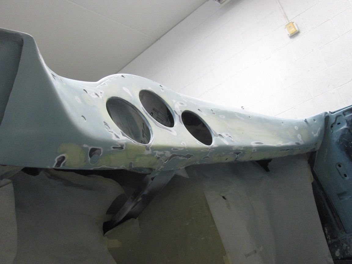

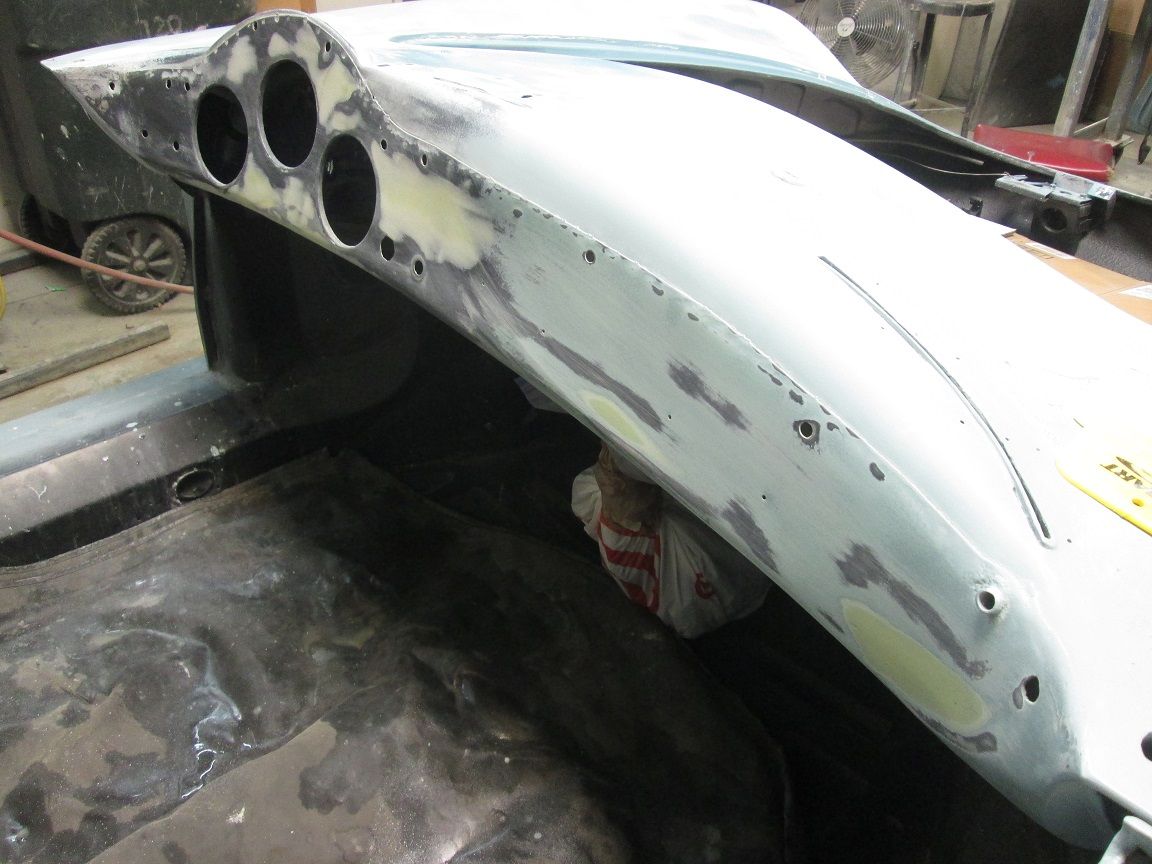

  • Dash body work phase:

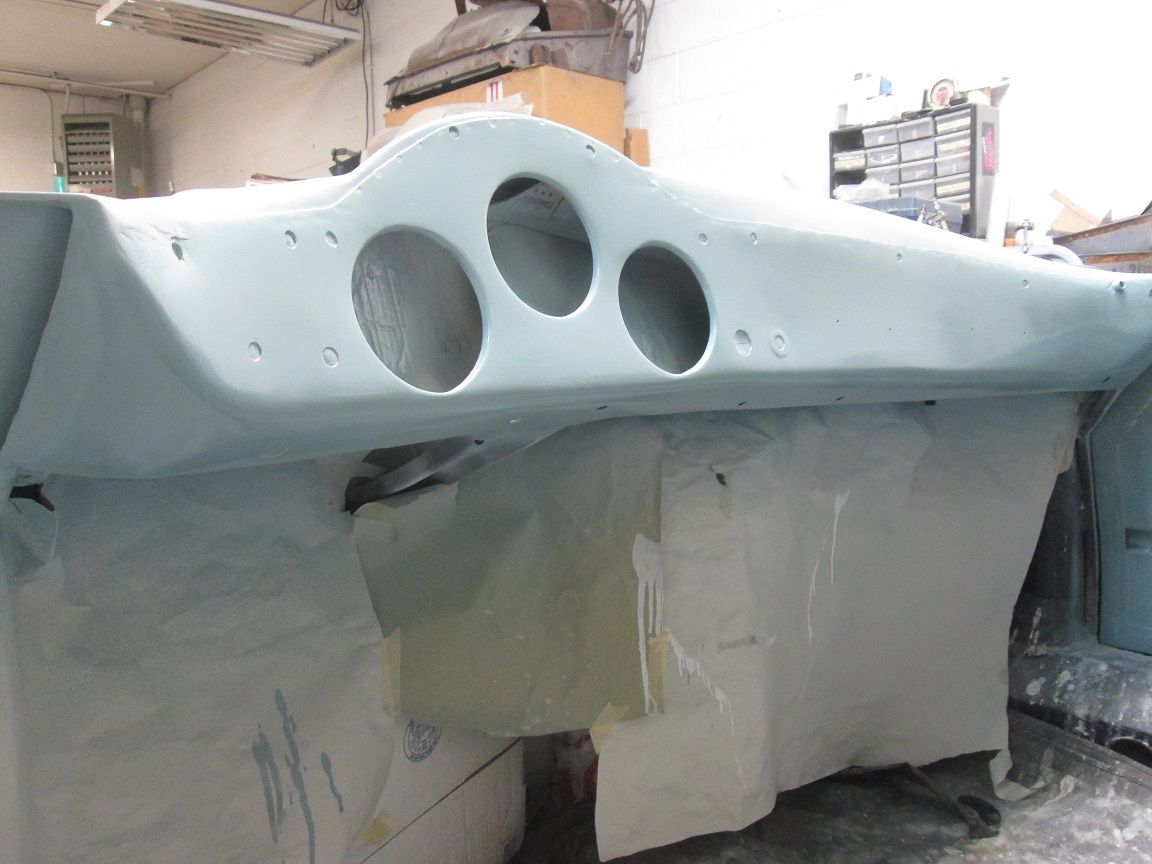

    Click image for larger version  Name:	IMG_6531.JPG Views:	0 Size:	125.7 KB ID:	109888 Begin swatching over the obvious low spots and imperfections.
    Click image for larger version  Name:	IMG_6535.JPG Views:	0 Size:	98.4 KB ID:	109889 First full sealer and work coat applied.
    Click image for larger version  Name:	IMG_6540.JPG Views:	0 Size:	110.3 KB ID:	109890 Next round of blocking to highlight the low spots which where everywhere.
    Click image for larger version  Name:	IMG_6576.JPG Views:	0 Size:	93.6 KB ID:	109891 Next round of swatching and block sanding including the entire lower flange run. These are thin veneers as the dash overall was pretty good but its just wavy from being manhandled through the years.
ID:	109892 Next round. closer still but not quite yet.

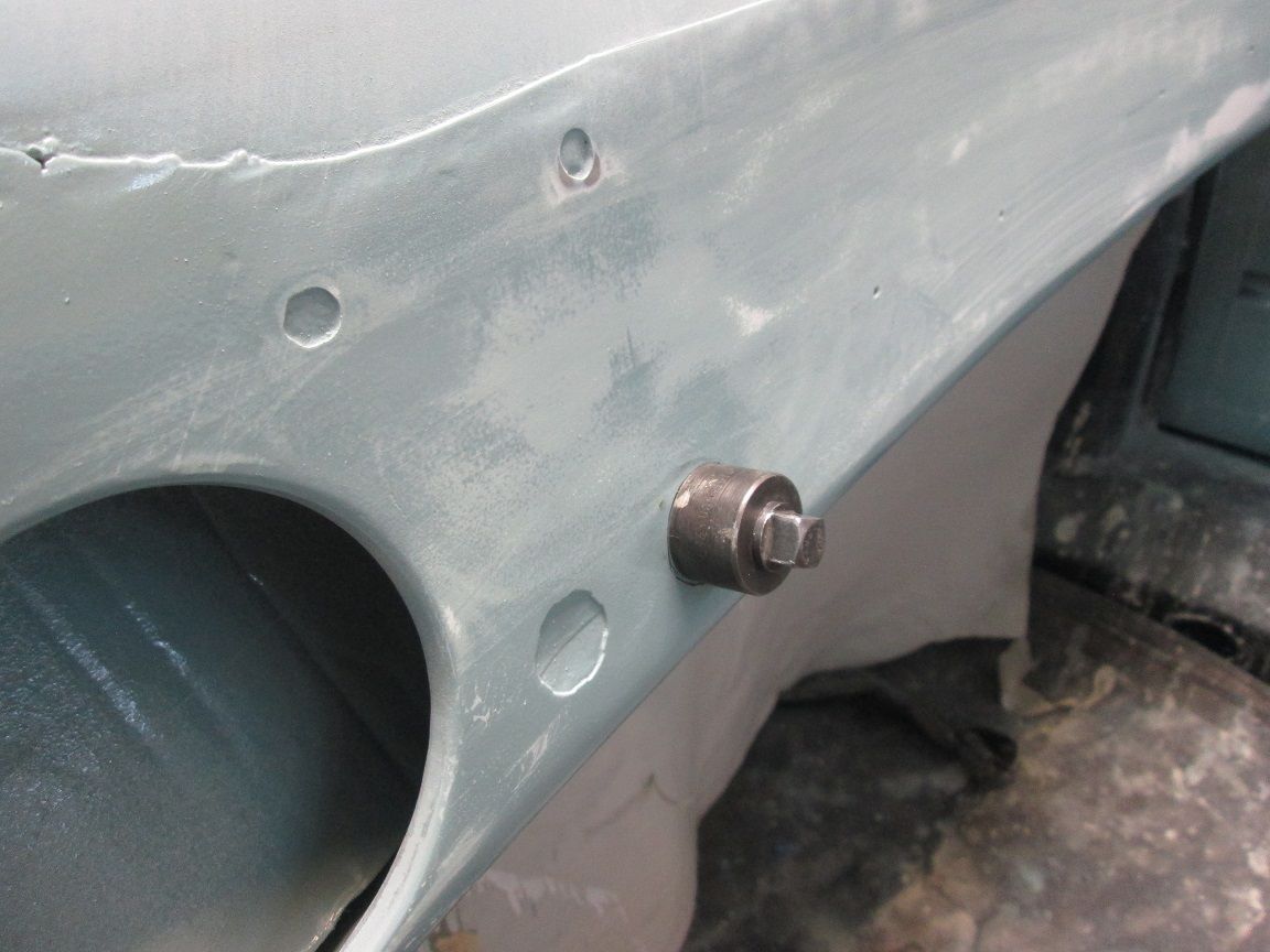

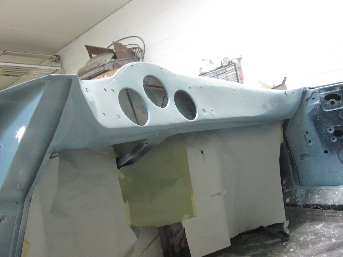

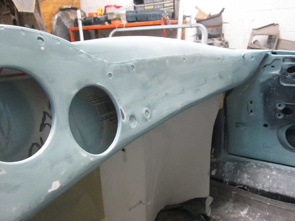

    • dash body work continued:

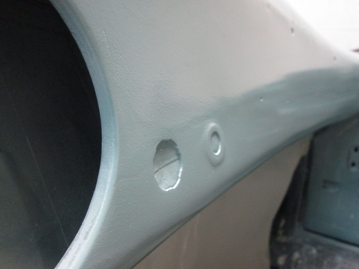

      Click image for larger version  Name:	IMG_6579.JPG Views:	0 Size:	85.0 KB ID:	109894Last little stumbling block was the embossed hole for the manual throttle pull cable. It had been slightly bent inward and off to one side.
      Click image for larger version  Name:	IMG_6582.JPG Views:	0 Size:	101.4 KB ID:	109895 Not by much but enough to disrupt the reflection to where I could not leave it. I couldn't just back fill around it otherwise I'd wash out the relief shape. Couldn't hit it back out with a hammer as I'd probably make more of a mess out of it than I started with. I had to both support and preserve that raised shoulder as I tapped on it.
      Click image for larger version  Name:	IMG_6583.JPG Views:	0 Size:	107.7 KB ID:	109896 After some rummaging around my shop for ideas I settled on using my smallest knock-out die punches. Its a standard size but it was close enough to the shoulder size to work. I turned the cutting edge around so it only supported and reinforced the shape as I snugged the bolt...not too tight though. Once snug I tapped on the die both from the back and on one side to bring it back up and level as close as possible.
      Click image for larger version  Name:	IMG_6584.JPG Views:	0 Size:	110.1 KB ID:	109897 That turned the trick. Not perfect but close enough to get away with it.
      Click image for larger version  Name:	IMG_6672.JPG Views:	0 Size:	118.1 KB ID:	109898Dash body work phase complete. Chased it about as far as I can. Another round of sealer then a light sand and the final color coats next.

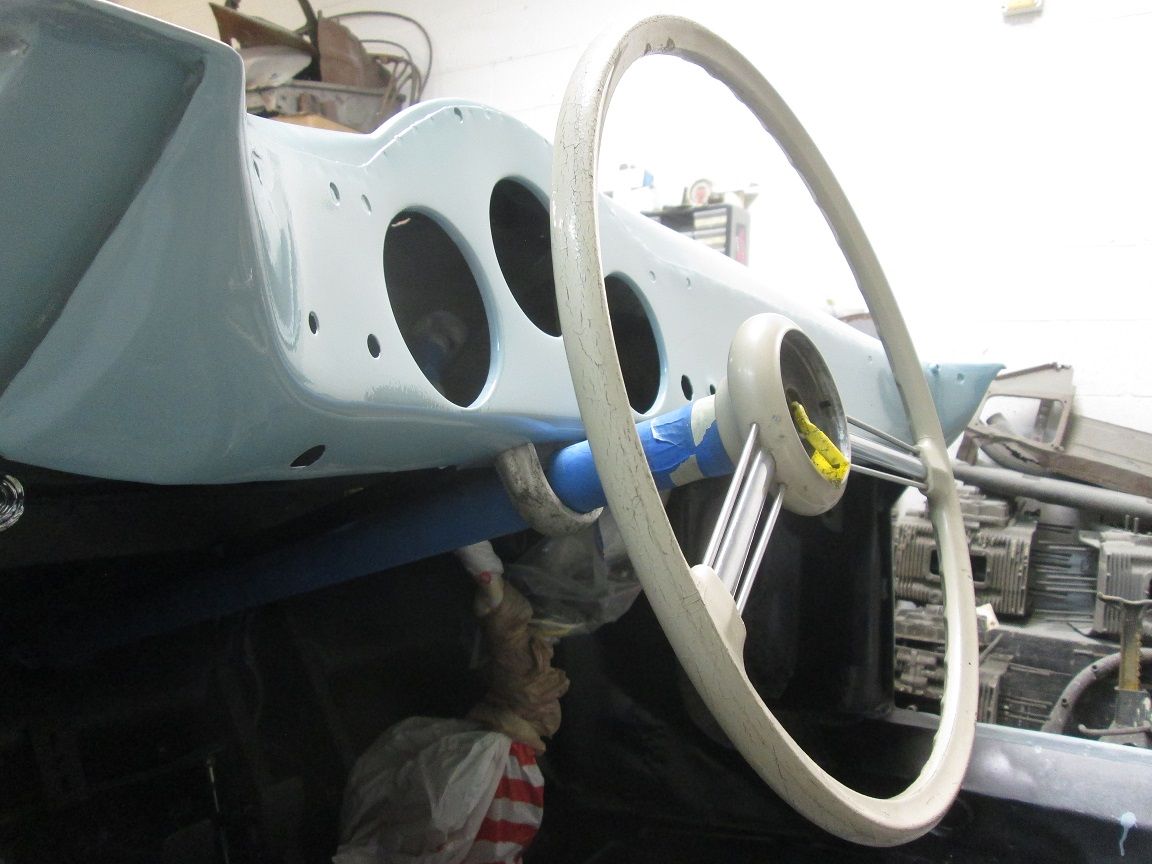

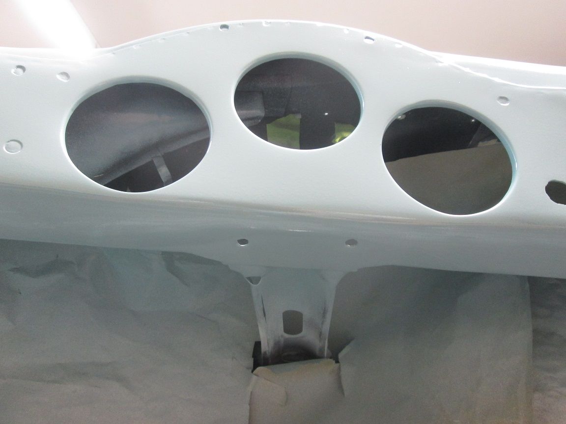

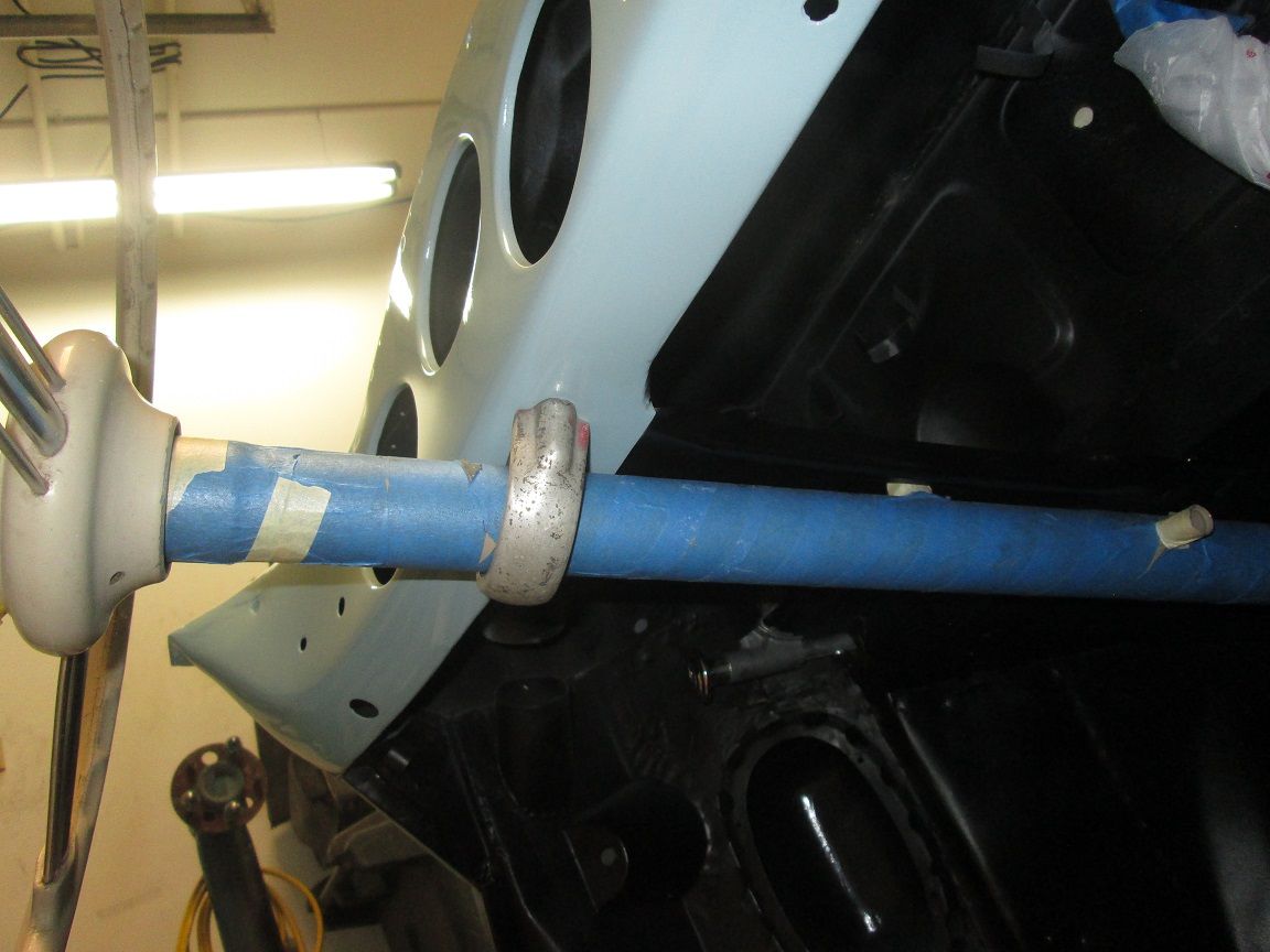

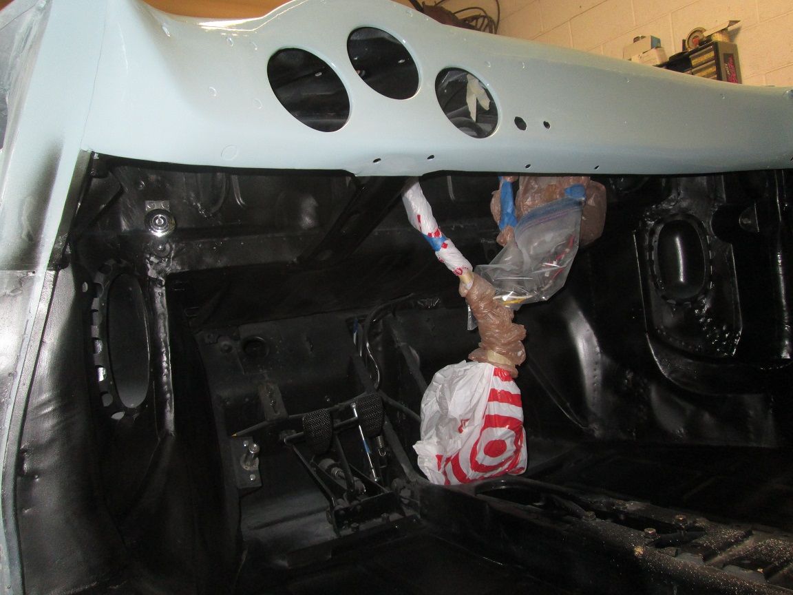

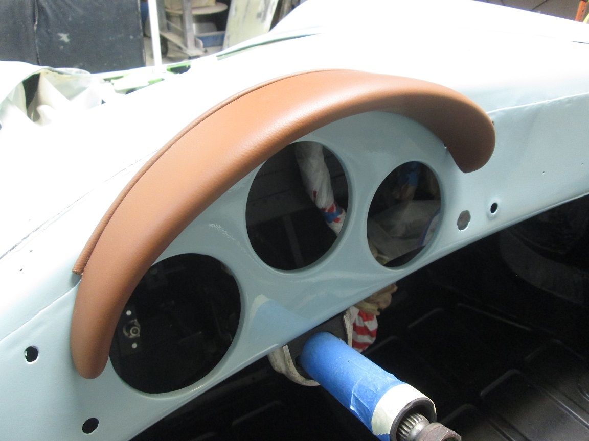

      • Dash face into final paint:
        Click image for larger version  Name:	IMG_6682.JPG Views:	0 Size:	117.4 KB ID:	109909
        Too much drama to paint this area in one shot along with the rest of the body so now was the time to knock it out.
        Click image for larger version  Name:	IMG_6684.JPG Views:	0 Size:	82.2 KB ID:	109910Especially trying to ensure good even coverage along this bottom flange and backside lip. You'd have to lean in way in there all the while trying not to touch the wet rockers and door thresholds with the air hose or yourself; no thanks
        Click image for larger version  Name:	IMG_6686.JPG Views:	0 Size:	83.2 KB ID:	109911Highlighting the newly repaired column mount area.
        Click image for larger version  Name:	IMG_6694.JPG Views:	0 Size:	122.4 KB ID:	109912 Once the dash cured I went ahead and blacked out the areas with overspray along with the column support so I could go ahead and remount the steering column assembly for my final time.

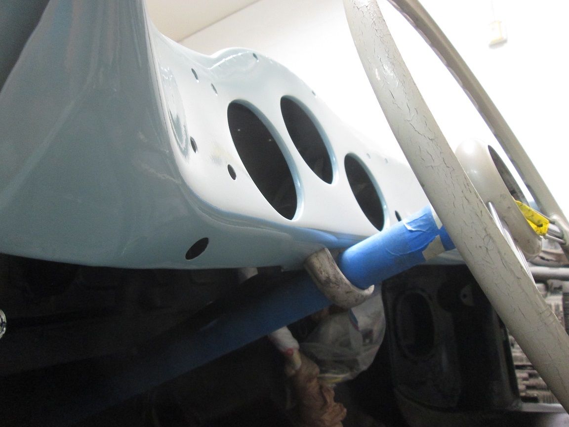

ID:	109913 Column installed so I have the luxury once again of steering this thing. All this will of course come back apart once again to remove the tape and reinstall the harness etc but not by me.

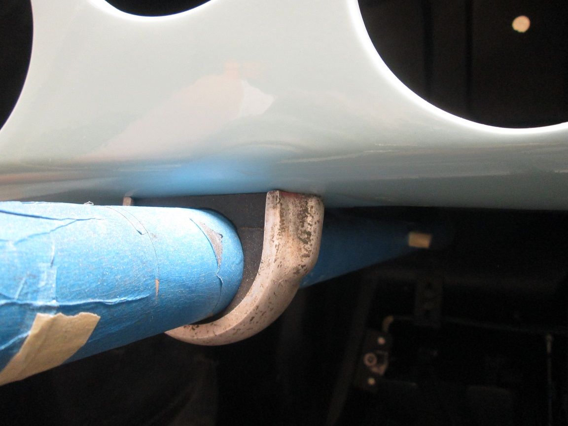

ID:	109915 Clean column clamp to dash fitment we were looking for.
ID:	109916Click image for larger version
ID:	109917Click image for larger version
ID:	109918 A quick glimpse of the color combination . It definitely has grown on me....
ID:	109919 Area completely back masked and back to getting the rest of the body ready for the booth.

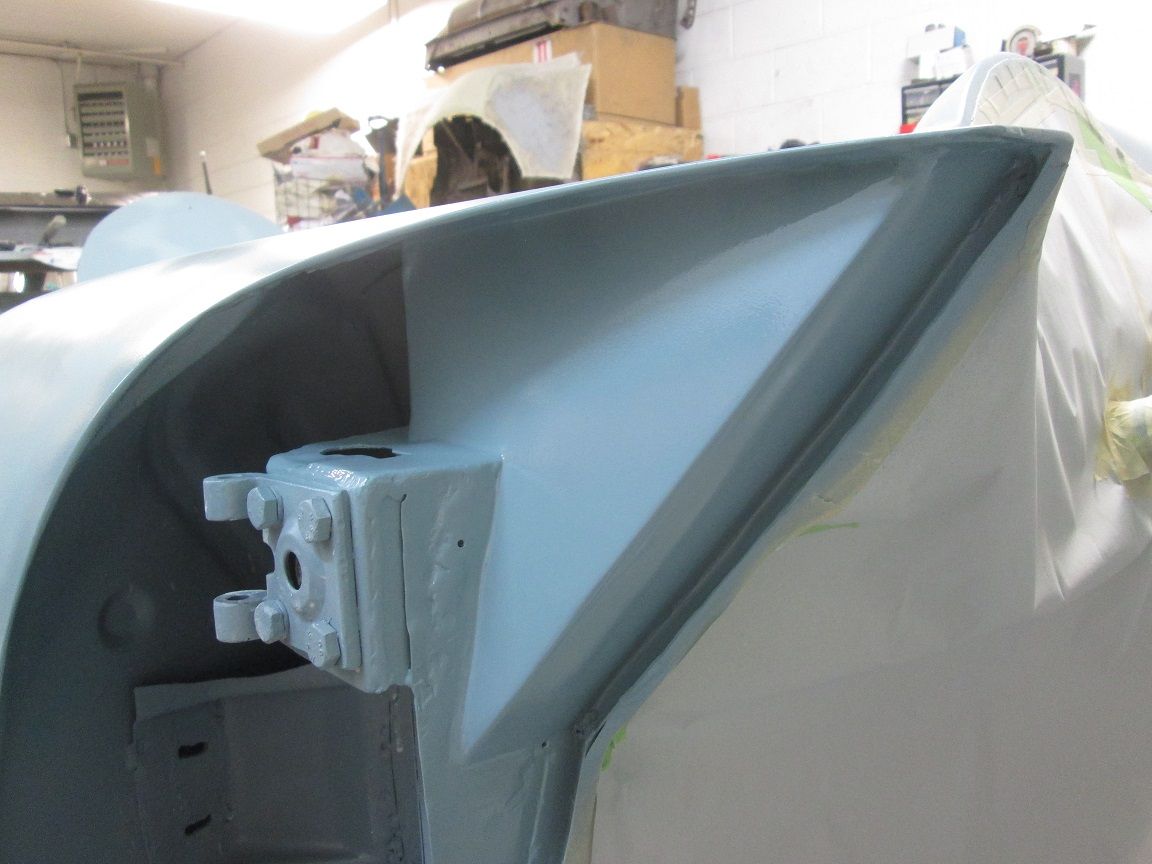

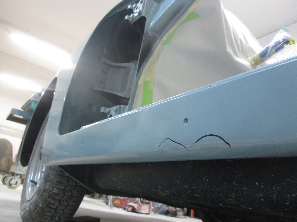

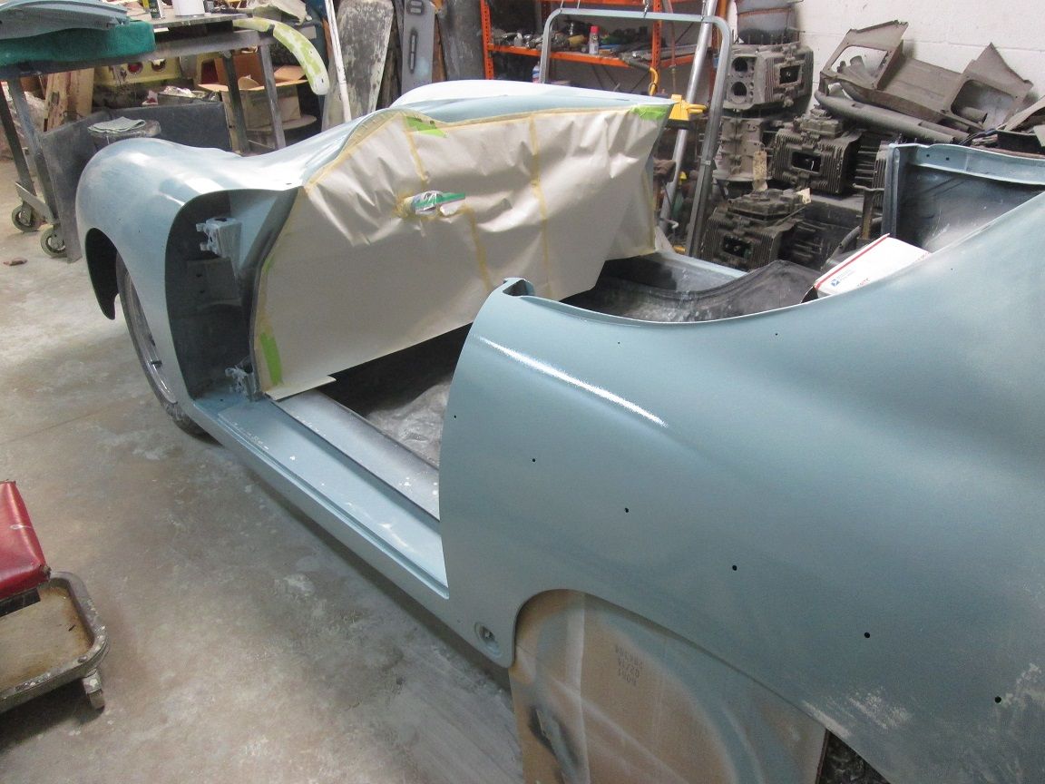

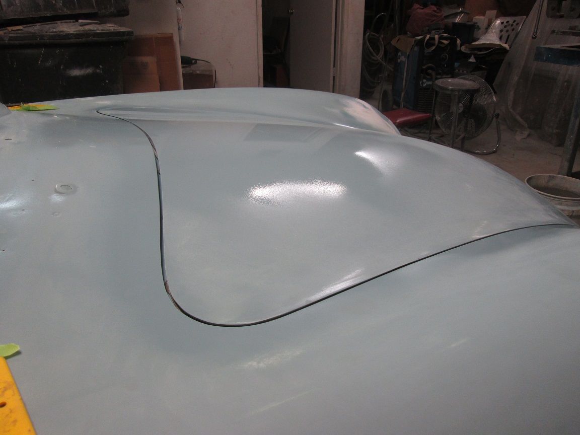

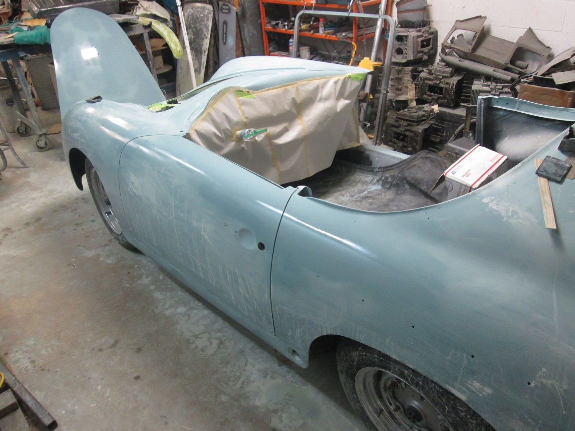

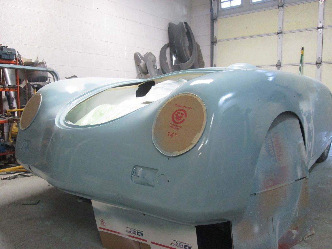

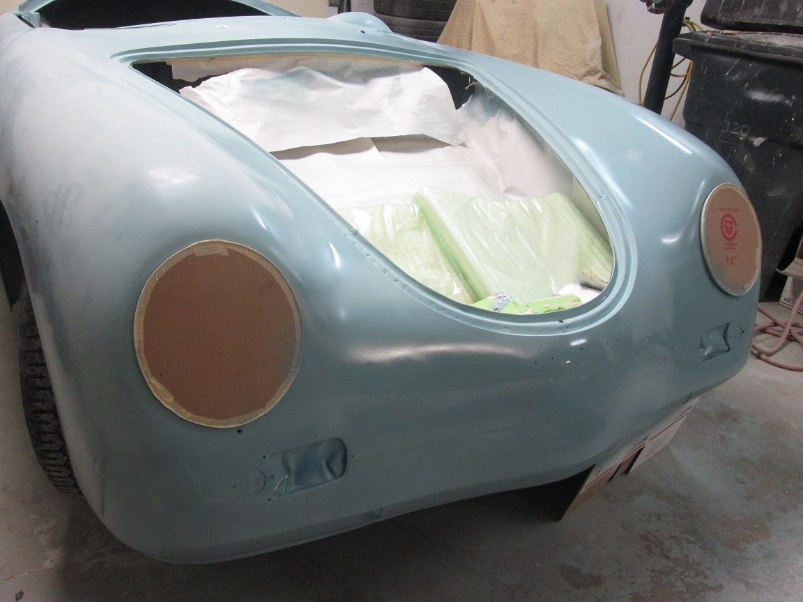

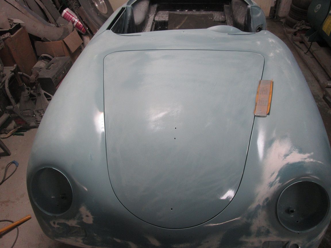

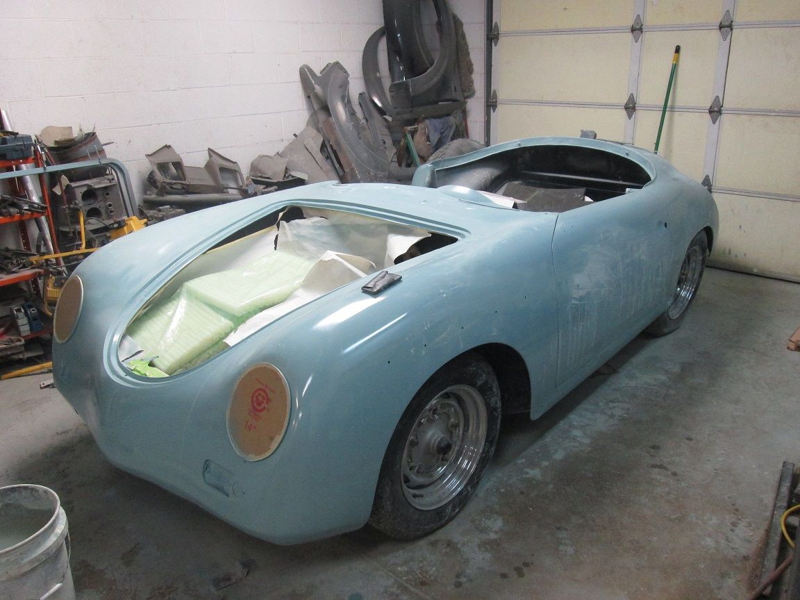

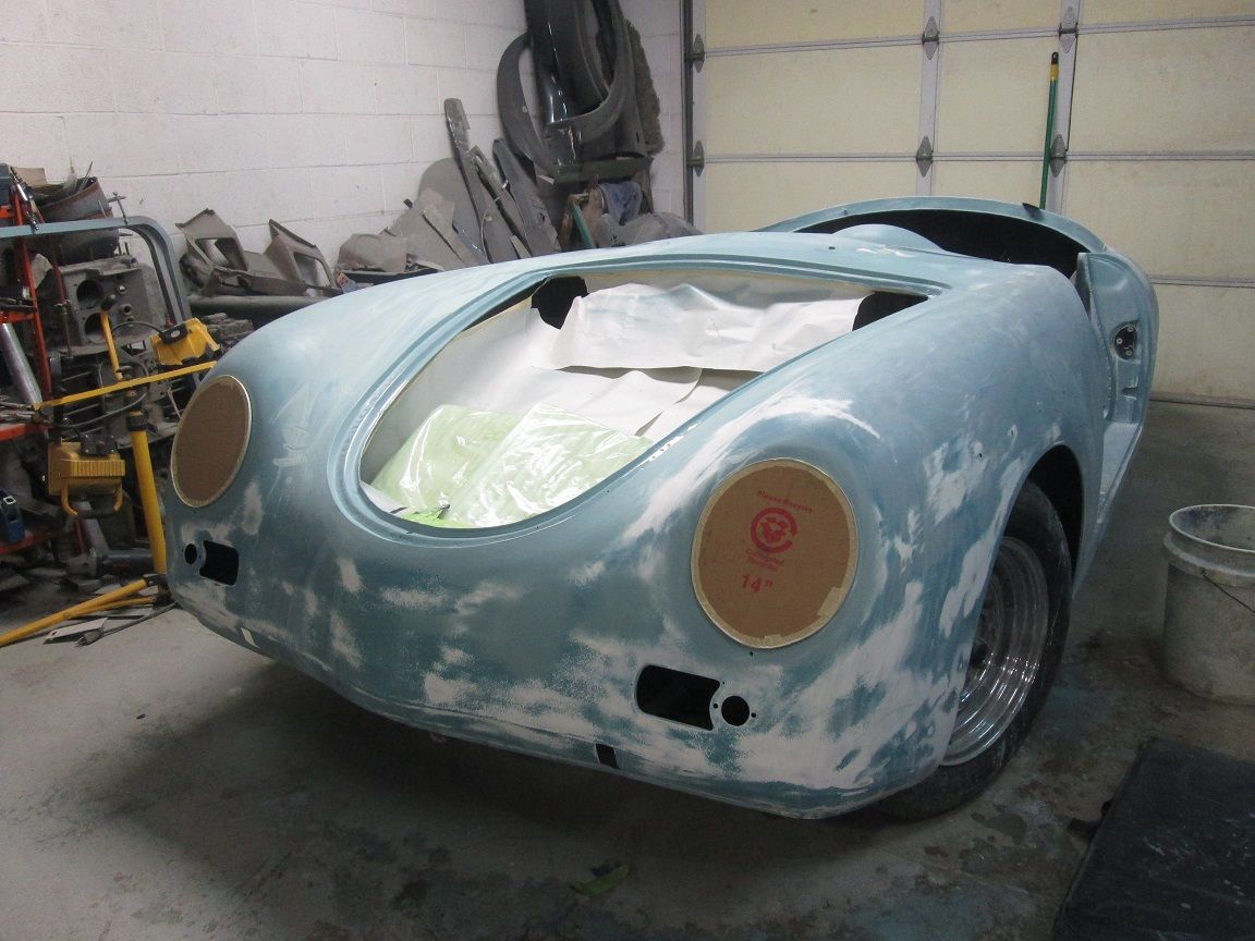

          • prepping body for the booth

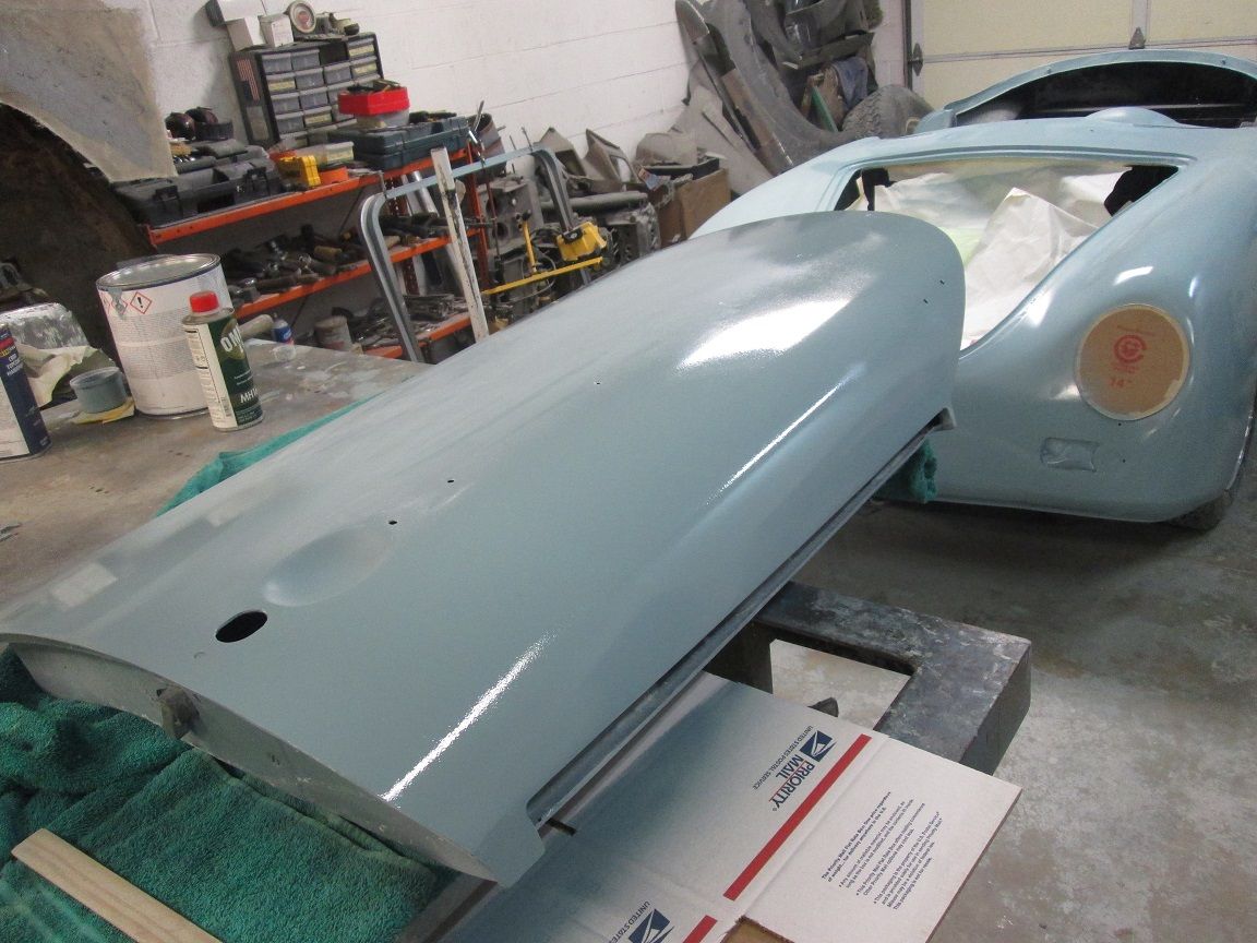

            Click image for larger version  Name:	IMG_6577.JPG Views:	0 Size:	106.7 KB ID:	109925As with the dash face I pre-painting the headlight buckets ahead of the body. I want uniform coverage with no runs in there so I'm giving them my full attention now. I hate painting these things anyway as they deflect the paint right back at you so I'm glad to get these done now. Final body painting day just a little more simpler.
            Click image for larger version  Name:	image_63533.jpg Views:	3 Size:	81.9 KB ID:	109926 Hood mocked up one more time to be absolutely certain before the final spray.
            Click image for larger version  Name:	image_63534.jpg Views:	3 Size:	101.6 KB ID:	109927 Final light block sand across the gaps.
            Click image for larger version  Name:	image_63536.jpg Views:	3 Size:	137.5 KB ID:	109929 Buckets carefully masked and taped off and ready for a final base coat of color.
            Final base coat applied. All set no more detectable blemishes.

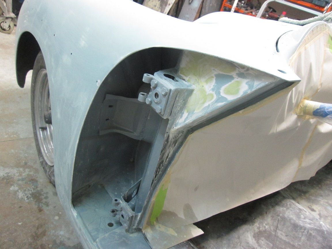

ID:	109932 This coat is my insurance policy to find any remaining blemishes that I don't want to find on final paint day. What I was looking for in through here was any remaining saw marks from all the previous rounds of block sands. No issues there.
ID:	109933 Front end group good to go.
ID:	109934 Moved down the left side one more time to check in and around the door opening.

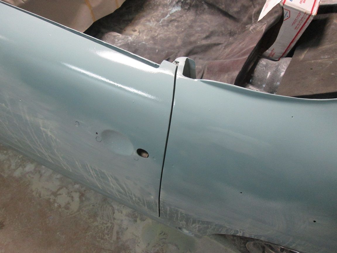

ID:	109935 had a few nagging issues with the door transition over the top to the body so this was a final top coat after several rounds of reworking that area.
ID:	109936Still a few flaws down on the lower rocker's edge to deal with but closing in on it.

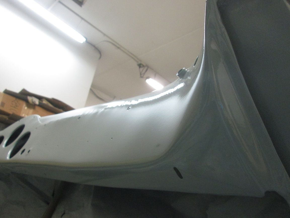

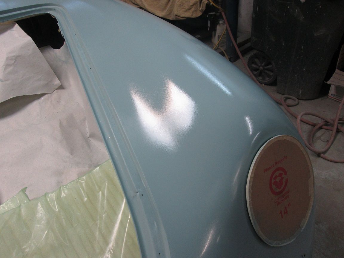

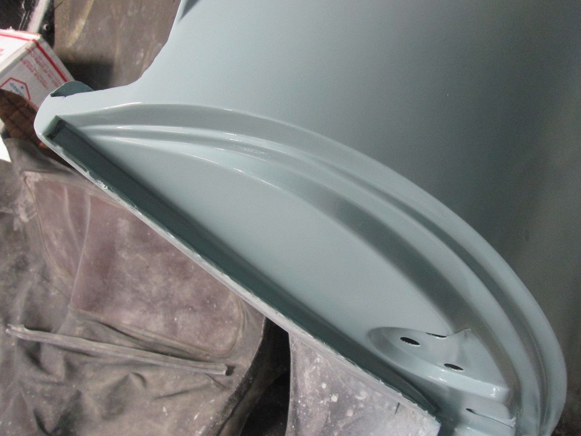

              • Left side final finishing:
                Click image for larger version  Name:	IMG_6720.JPG Views:	0 Size:	137.5 KB ID:	109985 Final base color/tracer coat before final paint.
                Click image for larger version  Name:	IMG_6721.JPG Views:	0 Size:	110.3 KB ID:	109986 had some last minute issues with the door to body transition on the upper profile. last work coat here and one more round of sanding.
                Click image for larger version  Name:	IMG_6722.JPG Views:	0 Size:	150.2 KB ID:	109987 Door is coming off for the final time and addressing the door jamb details.
                Click image for larger version  Name:	IMG_6743.JPG Views:	0 Size:	113.8 KB ID:	109988 final finishing on all the reveal areas and leading edges.

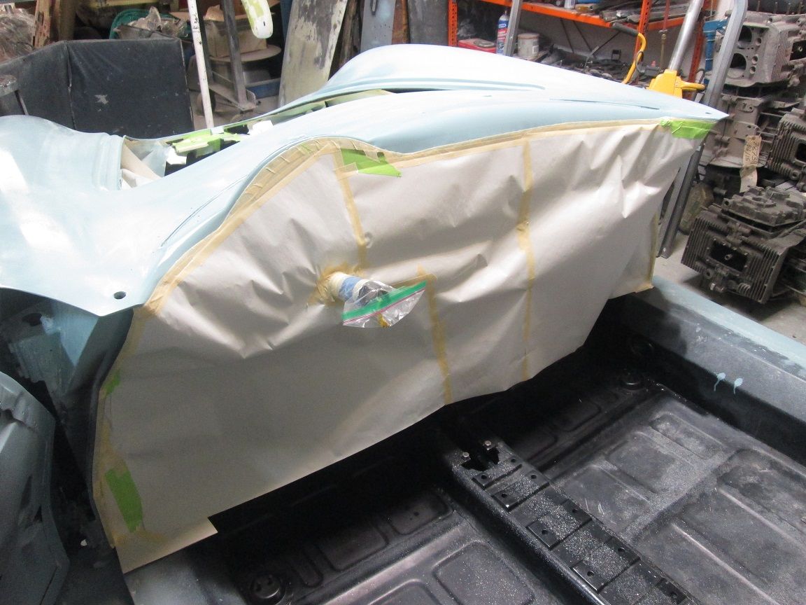

                Same with the threshold and striker; all the edges and reveal surfaces . Also cleaning up the torsion hole shoulder of excess paint thickness.

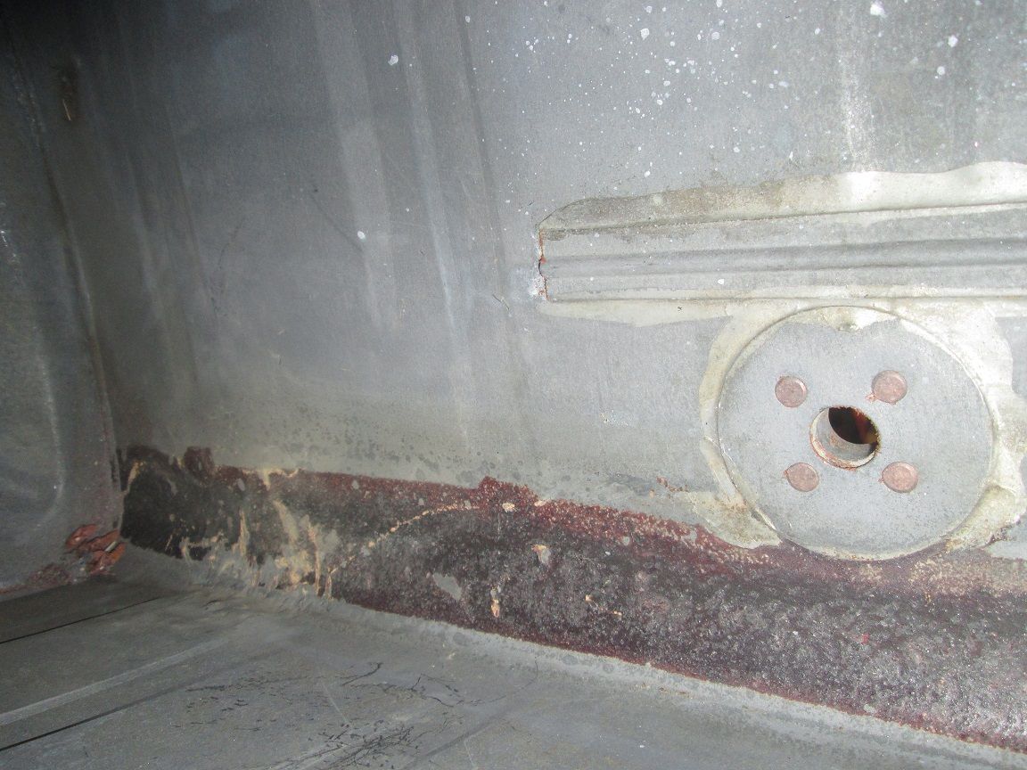

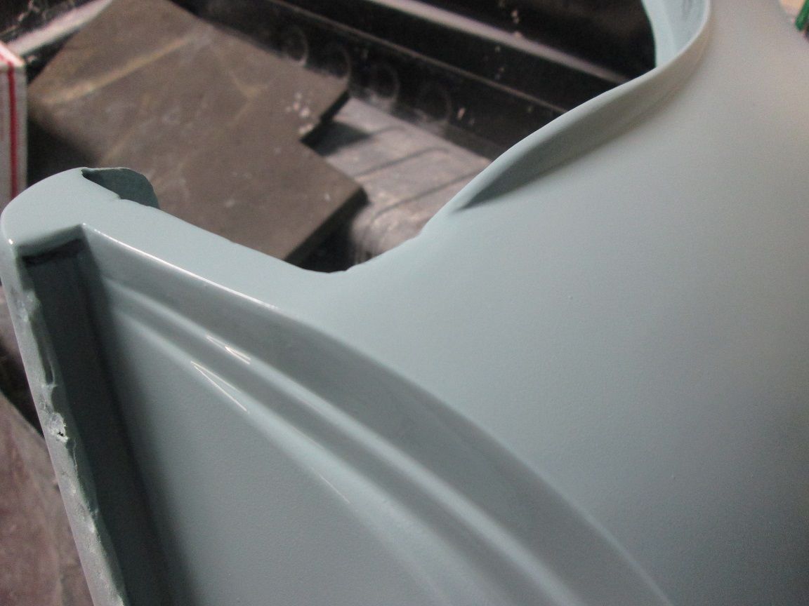

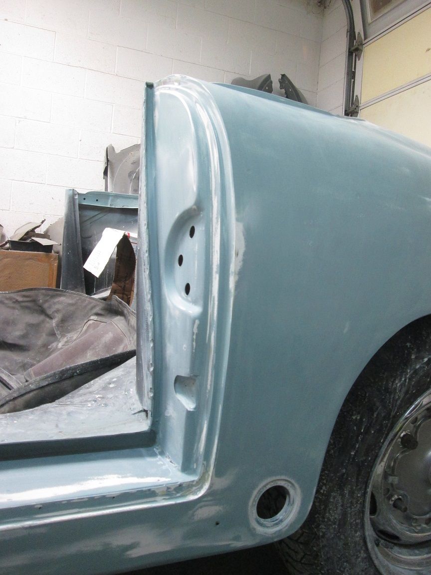

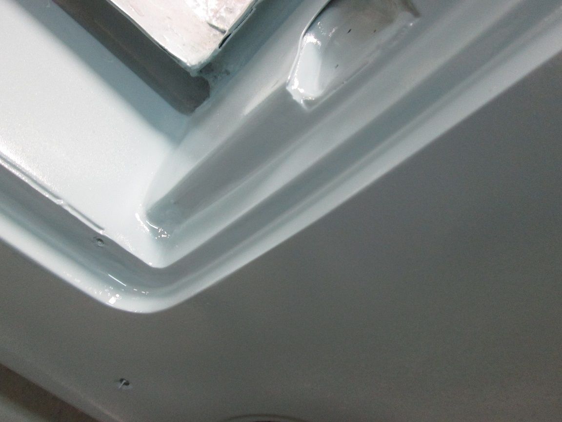

                • Left jamb detail work complete:
                  Click image for larger version  Name:	IMG_6747.JPG Views:	0 Size:	98.5 KB ID:	109991 Final tracer coat with no need to chase it further.
                  Click image for larger version  Name:	IMG_6749.JPG Views:	0 Size:	87.9 KB ID:	109992All edge and shape reliefs at a level I can live with.
                  Click image for larger version  Name:	IMG_6746.JPG Views:	0 Size:	90.1 KB ID:	109993 Finally chased out the last of nicks and other shape issues on these reveal profiles.
                  Click image for larger version  Name:	IMG_6745.JPG Views:	0 Size:	104.4 KB ID:	109994One last sand after this cures fully and its off to final paint.
                  Click image for larger version  Name:	IMG_6708.JPG Views:	0 Size:	163.5 KB ID:	109995The to do list is really getting small body wise so I'm Beginning the gas tank restoration in between cure times.

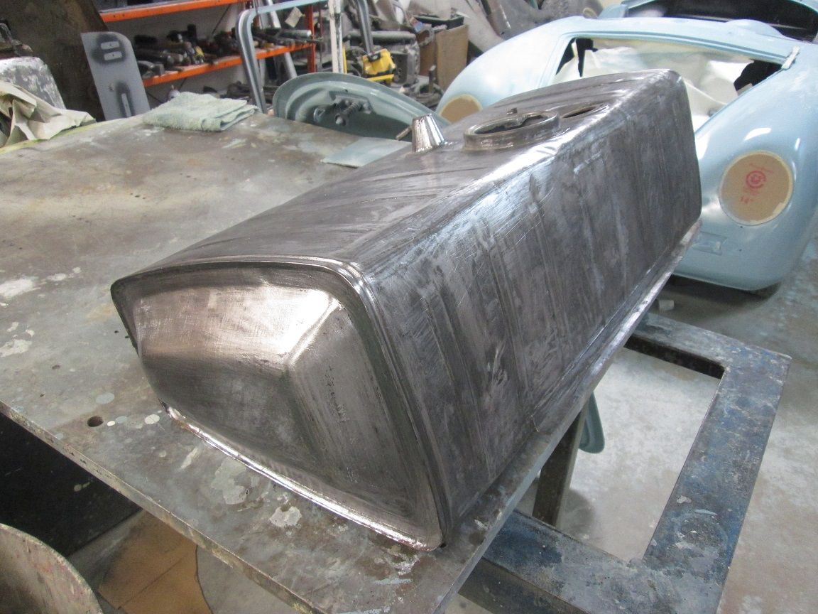

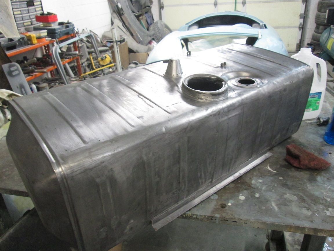

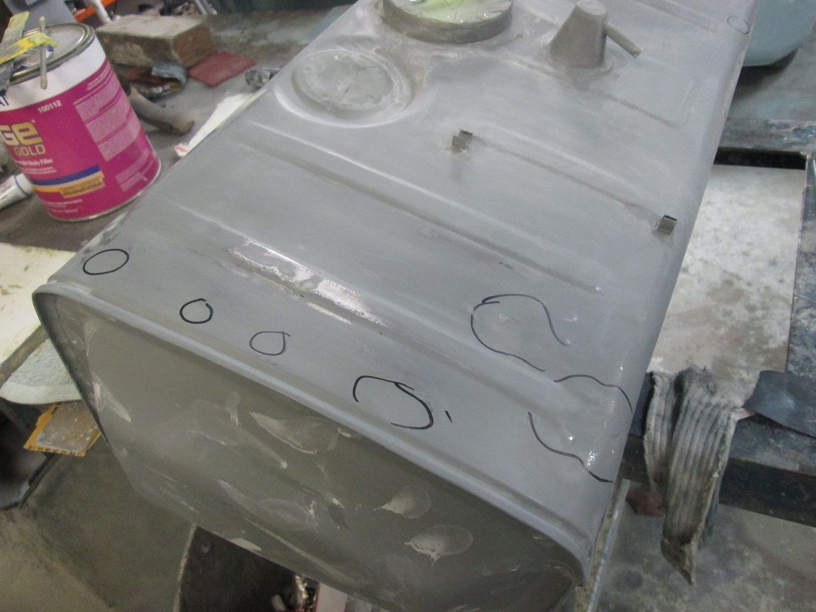

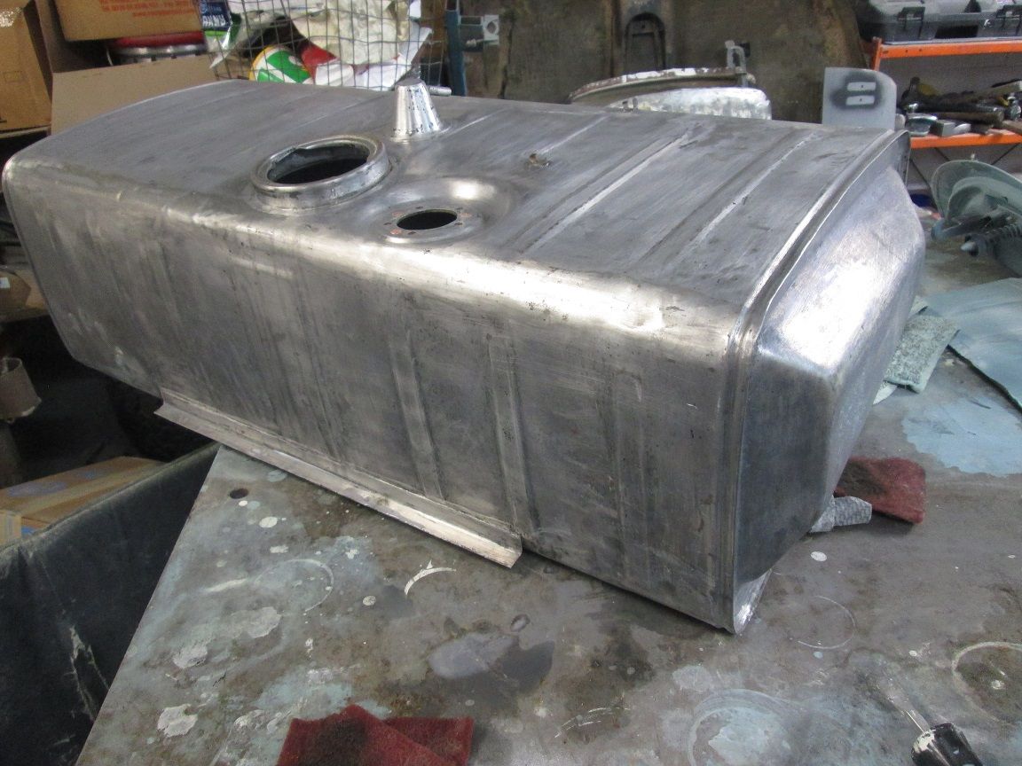

                  • Gas tank prep:

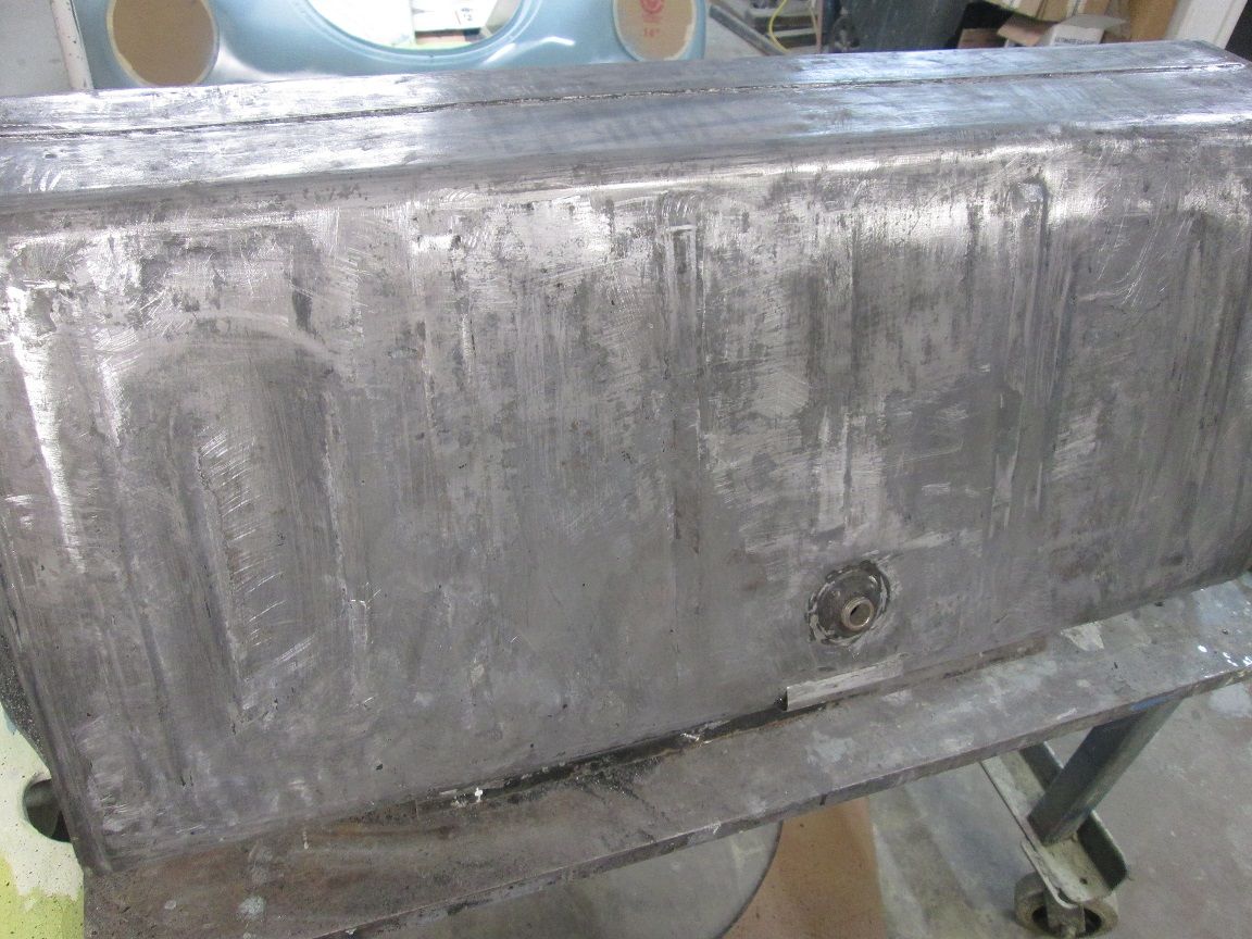

ID:	110021 The original tank to this car is actually very nice. The liner is intact with surface rust. Just some old shellac at the very bottom.
ID:	110022Outside bottom shows just as clean and nice.

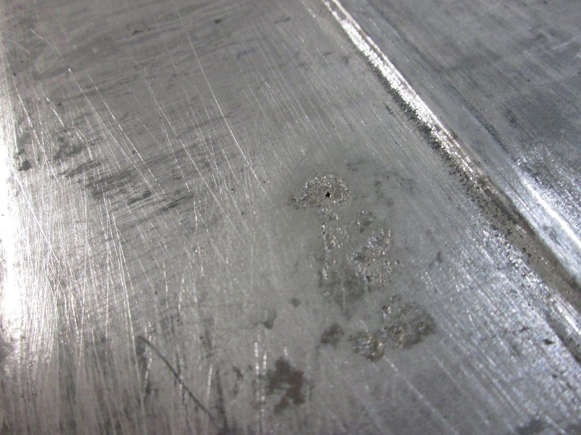

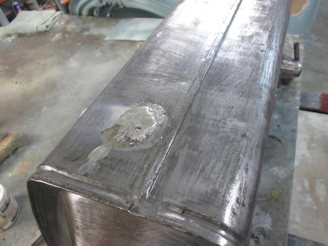

ID:	110023 Did find tow small pin holes on the vertical rear wall but as you can see it has rust from the outside inward from something holding moisture against it many years ago. If it had to rust out this is the version you want to find.
ID:	110024 Removed the last of the original paint. Amazing that the factory used no primer, the tanks went straight into paint much like an old radiator. It will be epoxy sealed this time around.
ID:	110025 But before that I went ahead and soldered up the two pin holes on this back wall.

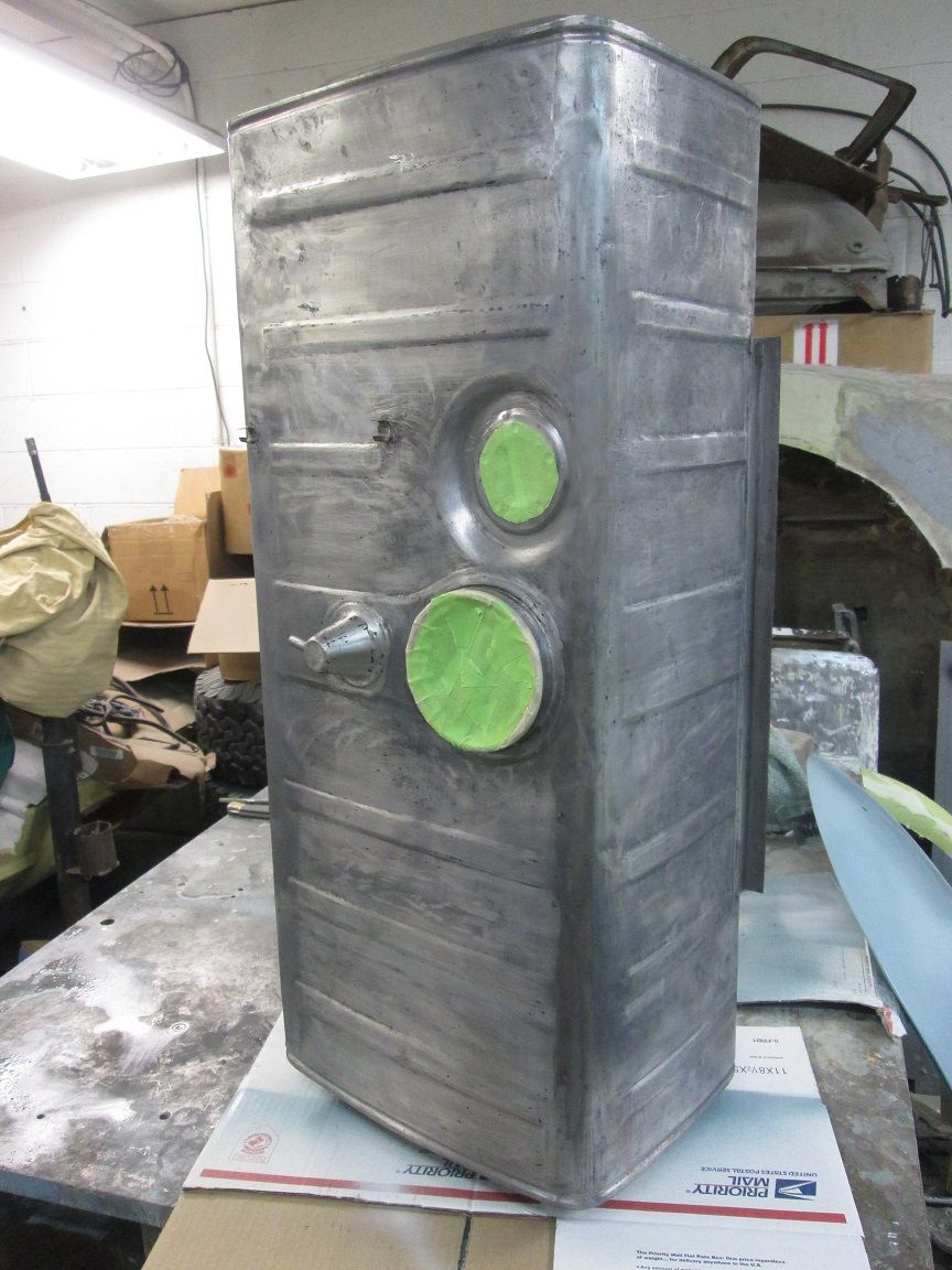

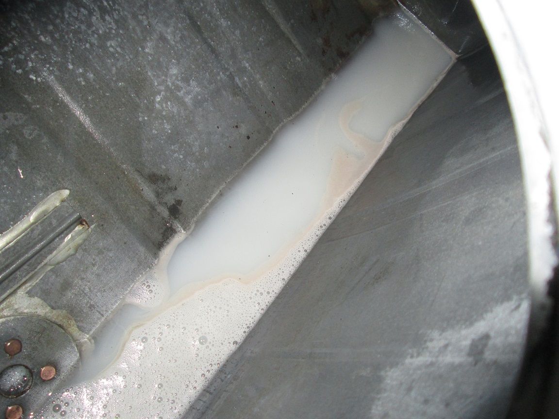

                    • Final cleaning before primer:
                      Click image for larger version  Name:	IMG_6727.JPG Views:	0 Size:	154.5 KB ID:	110027 Filed and finished out the solder repairs so I could begin cleaning it up for primer.
                      Click image for larger version  Name:	IMG_6728.JPG Views:	0 Size:	137.6 KB ID:	110028 Scrubbing the surface with soapy water and scotch-brite pad.
                      Click image for larger version  Name:	IMG_6729.JPG Views:	0 Size:	134.9 KB ID:	110029 While I was at it I cleaned up as much of that old shellac as I could.
                      Click image for larger version  Name:	IMG_6730.JPG Views:	0 Size:	150.5 KB ID:	110030 Clean and bright . Ready to mask off the openings.
                      Click image for larger version  Name:	IMG_6731.JPG Views:	0 Size:	149.3 KB ID:	110031
                      Epoxy primer next...

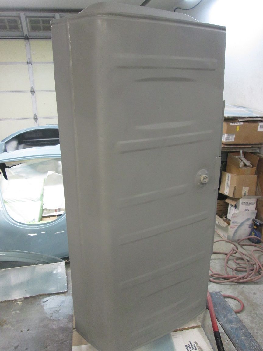

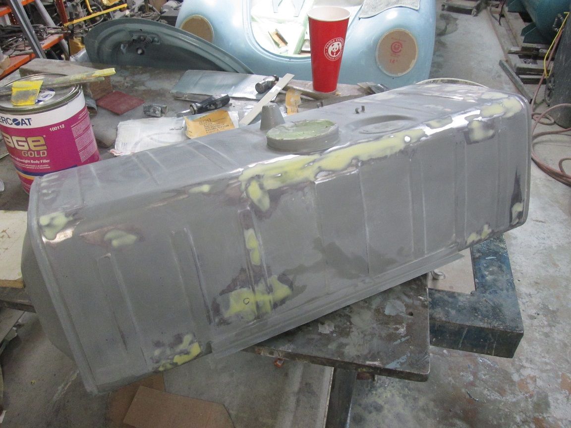

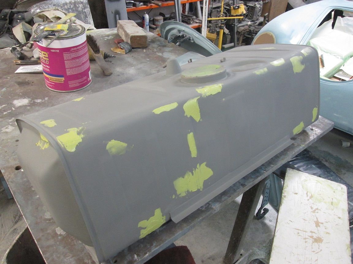

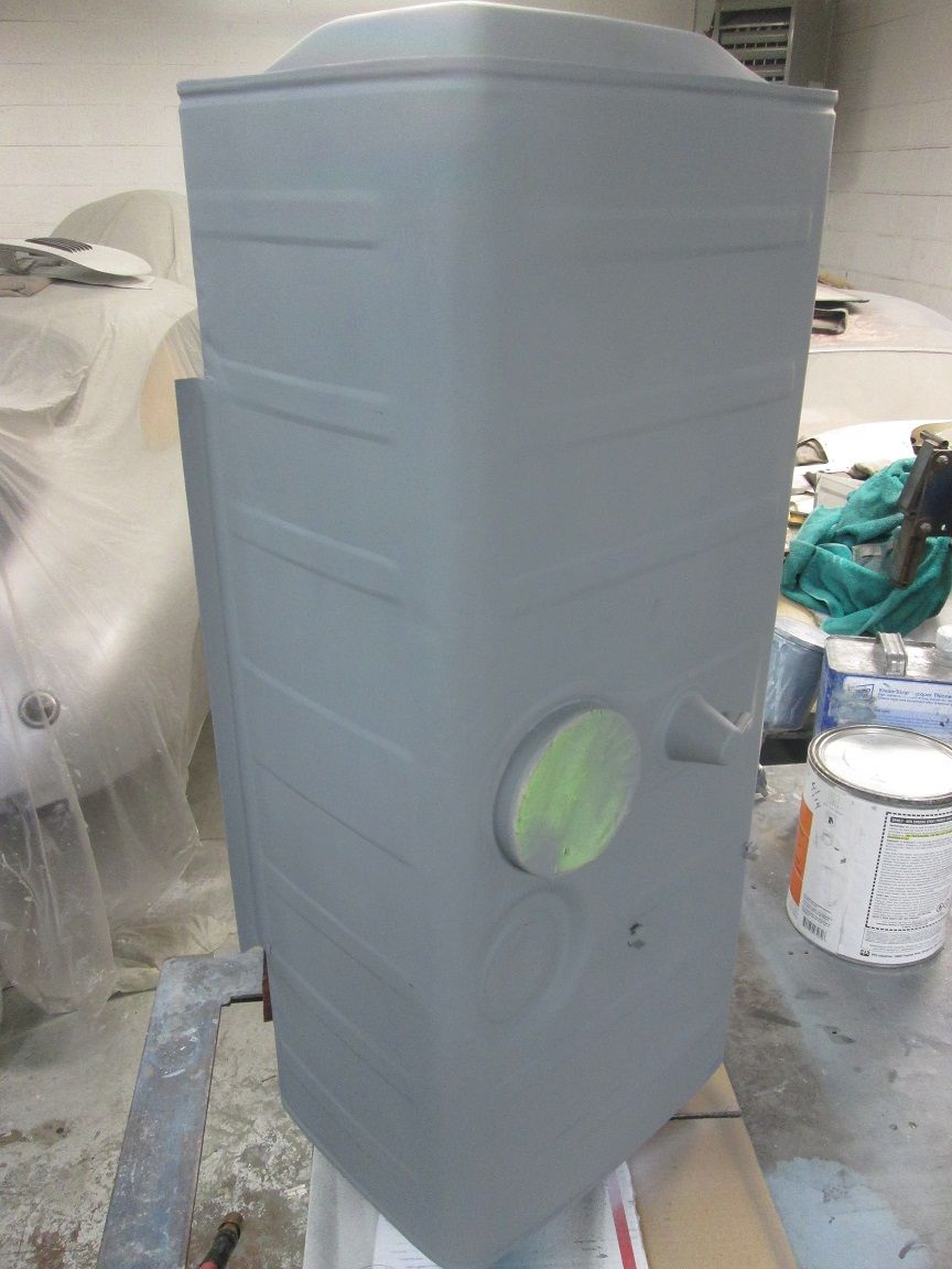

                      • Sealer and some body work:

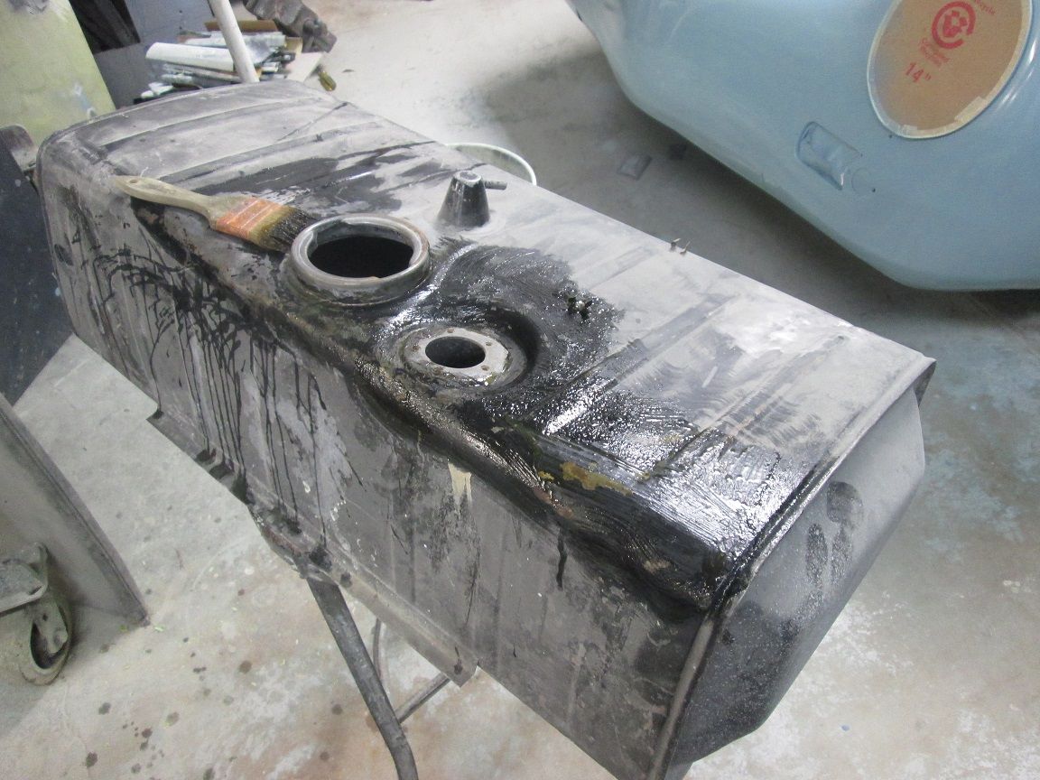

                        good coat of DP 40
                        All the way around

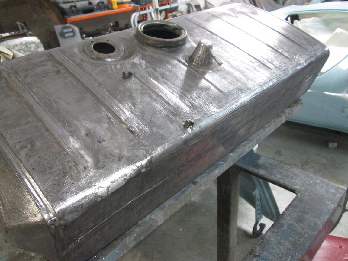

ID:	110037 Once it cured it was onto smoothing out some small dings on the surfaces that will show.
ID:	110038 Of course I found more as it went.
ID:	110039 Pretty much got all the ones that stood out. Not going for perfection just a nice presentation. Another round of epoxy then a test coat.

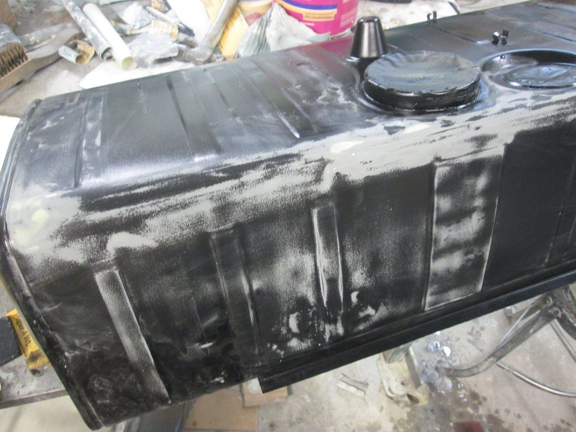

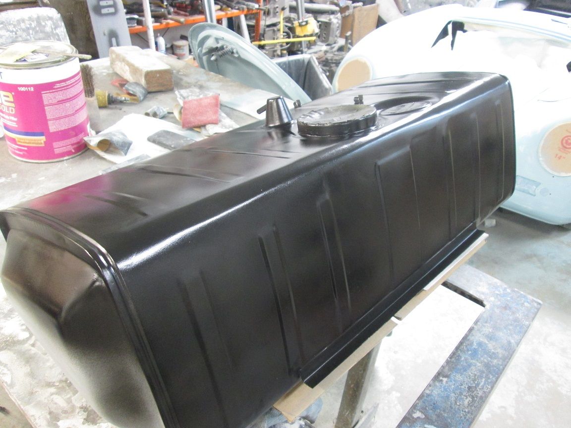

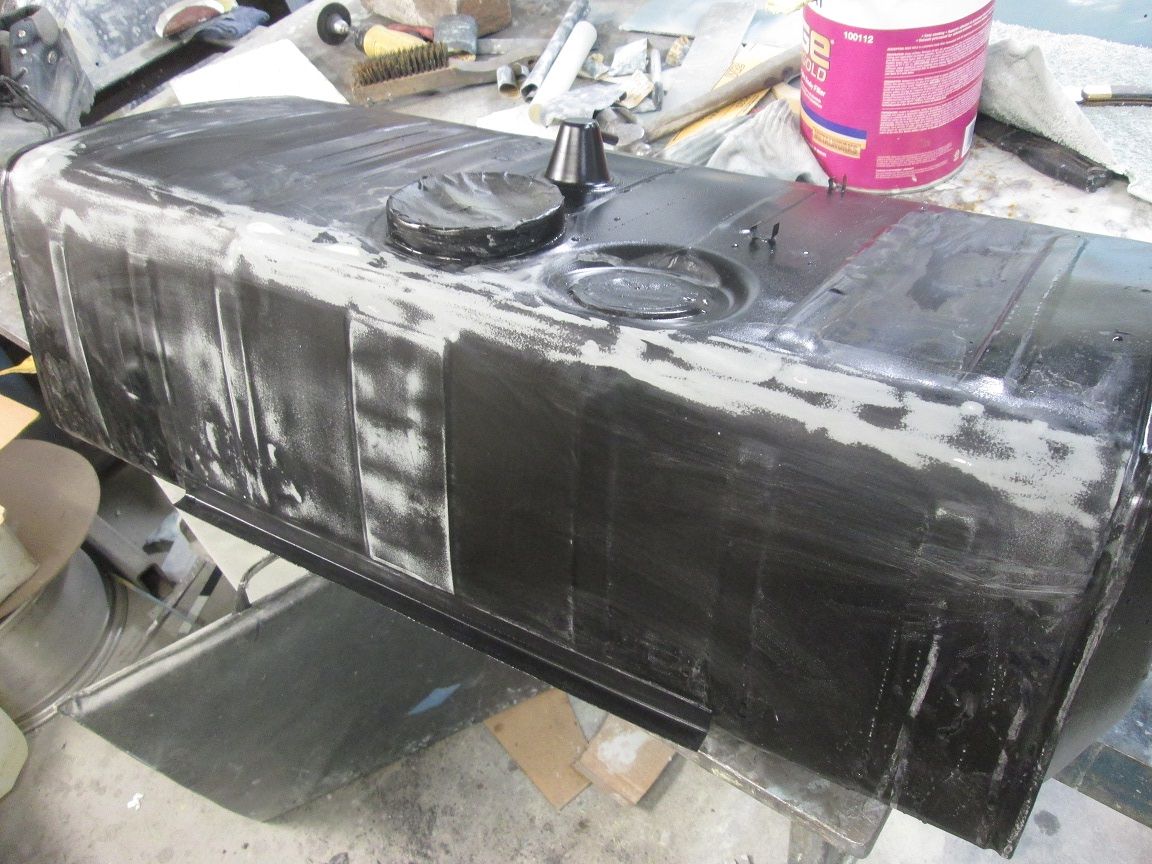

                        • Satin black test coat:

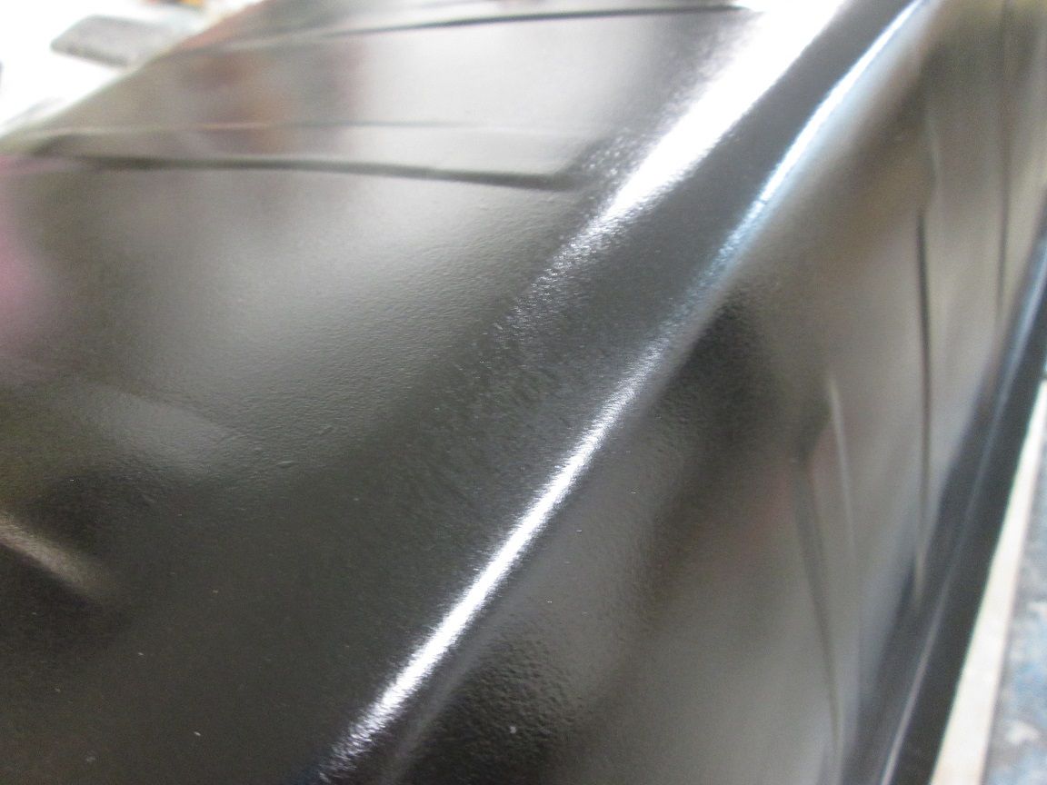

ID:	110041 First test coat to see what I had.
ID:	110042 I'm good with this version. Not too flat and not too shiny...
ID:	110043 Back to blocking sanding.
ID:	110044 and finishing out the remaining flaws that I needed to chase.

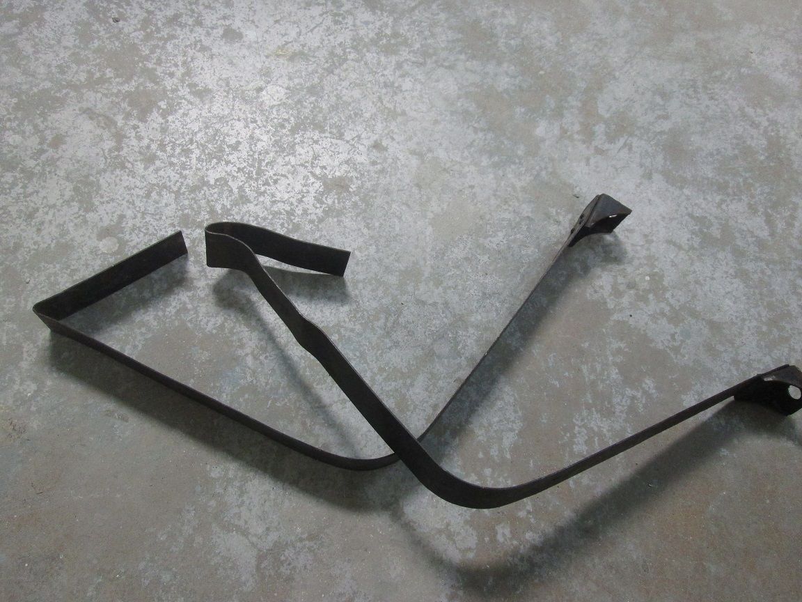

ID:	110045 Straightening and cleaning up the OG straps next.
