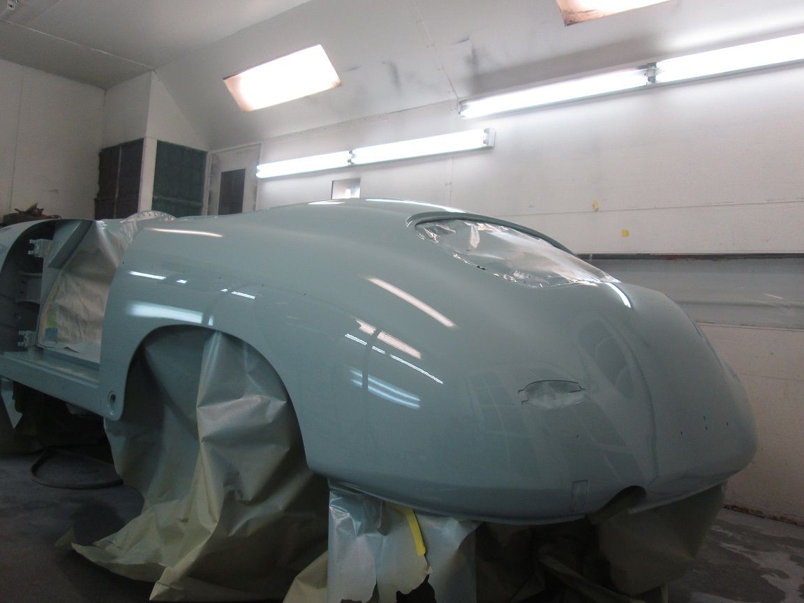

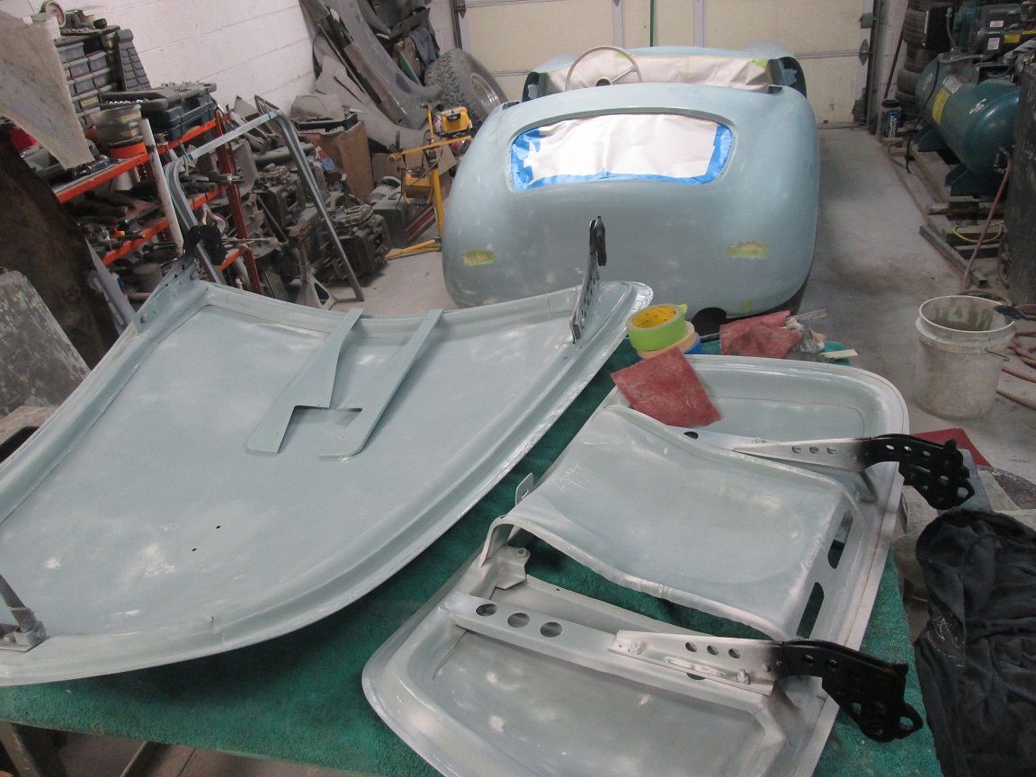

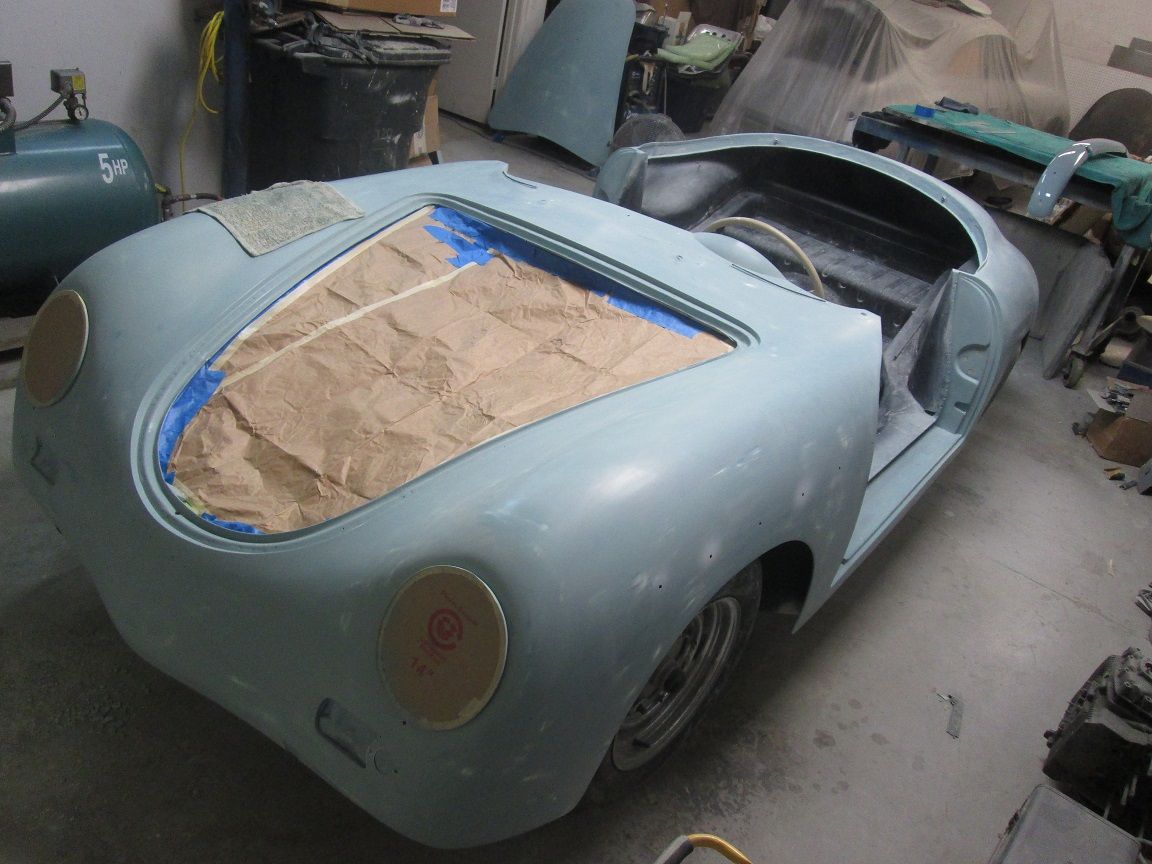

  • All but ready to paint...

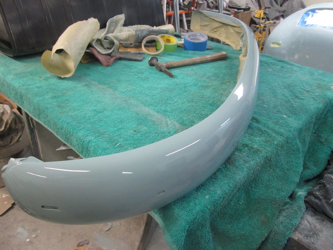

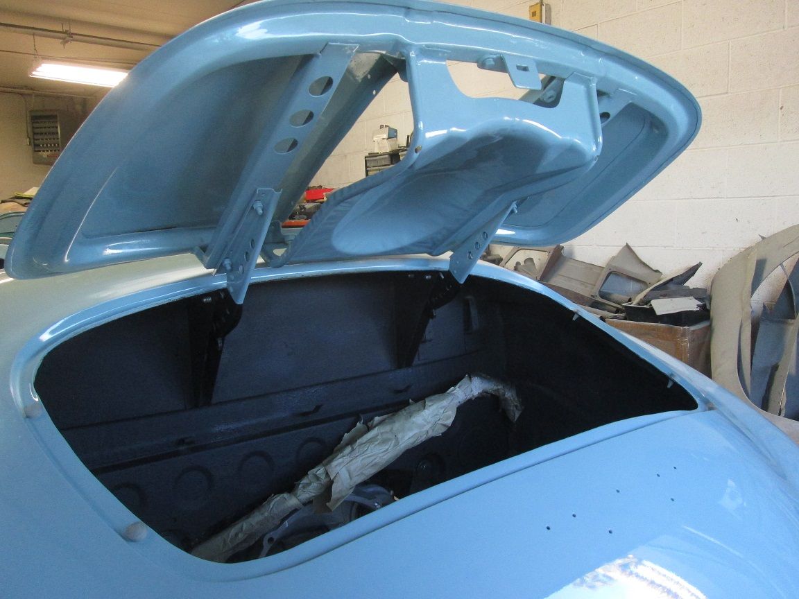

    Click image for larger version  Name:	IMG_6953.JPG Views:	0 Size:	164.7 KB ID:	110292 Back taped the inside and got the rear bumper in its final top coats completing all the final painting I dared to do here.

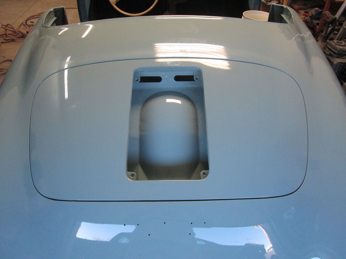

    Click image for larger version  Name:	IMG_6946.JPG Views:	0 Size:	145.5 KB ID:	110293 Much less complicated concerning overspray to finish off the back of hinges in black now instead of waiting until after final paint.

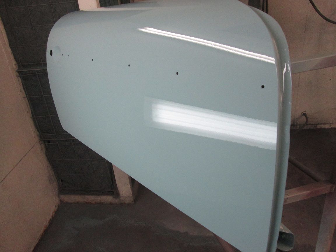

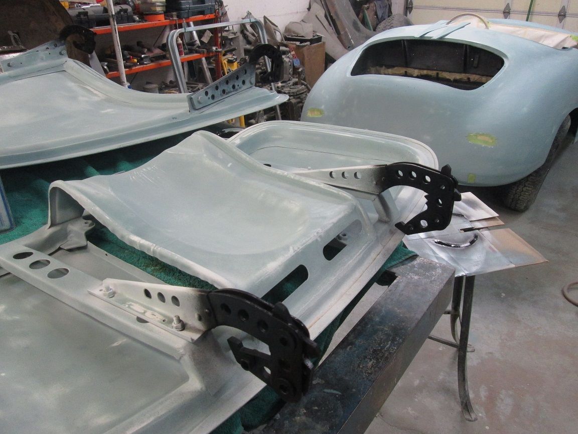

ID:	110294 Onto back taping these hinges which wraps up my preping duties on the closing panels.

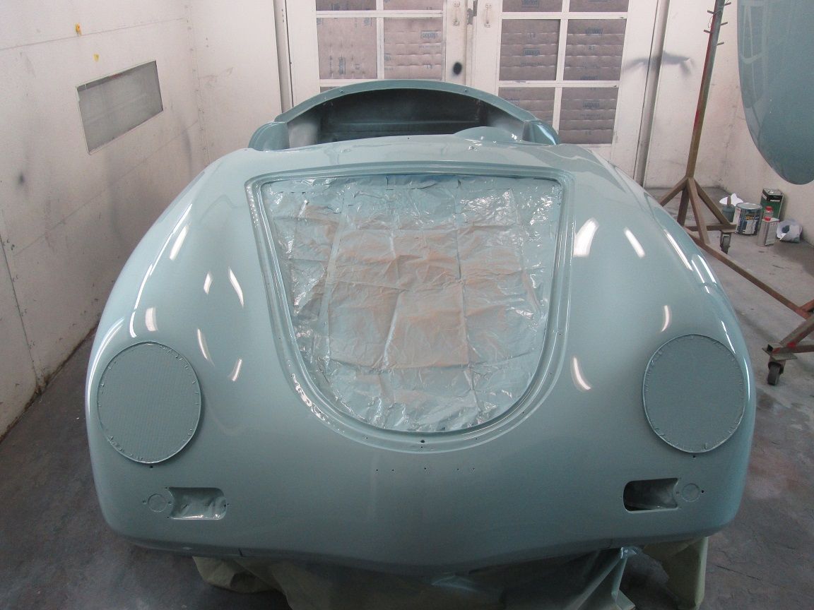

    Click image for larger version  Name:	IMG_6966.JPG Views:	0 Size:	130.8 KB ID:	110295 All my basic masking now complete. Once its in the booth we'll run a perimeter skirt all the way around the bottom.
ID:	110296 The following evening I went over to the body shop to confirm and we went to work cleaning and power washing the inside of their spray booth. That's Elias manning the power washer and broom.

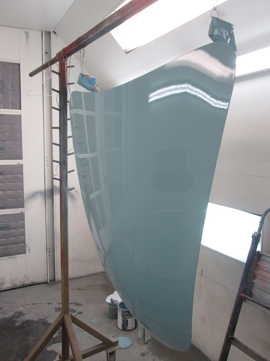

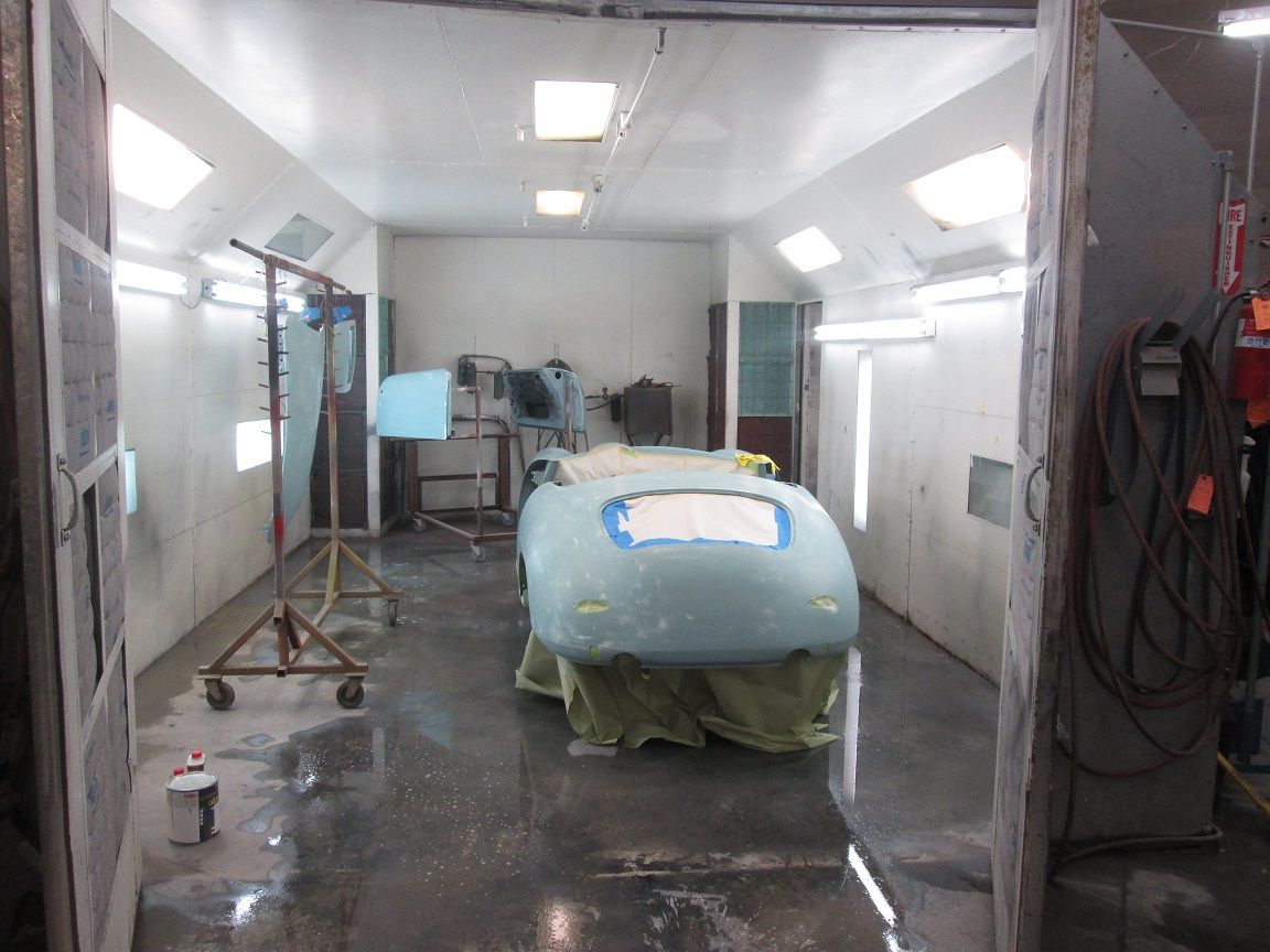

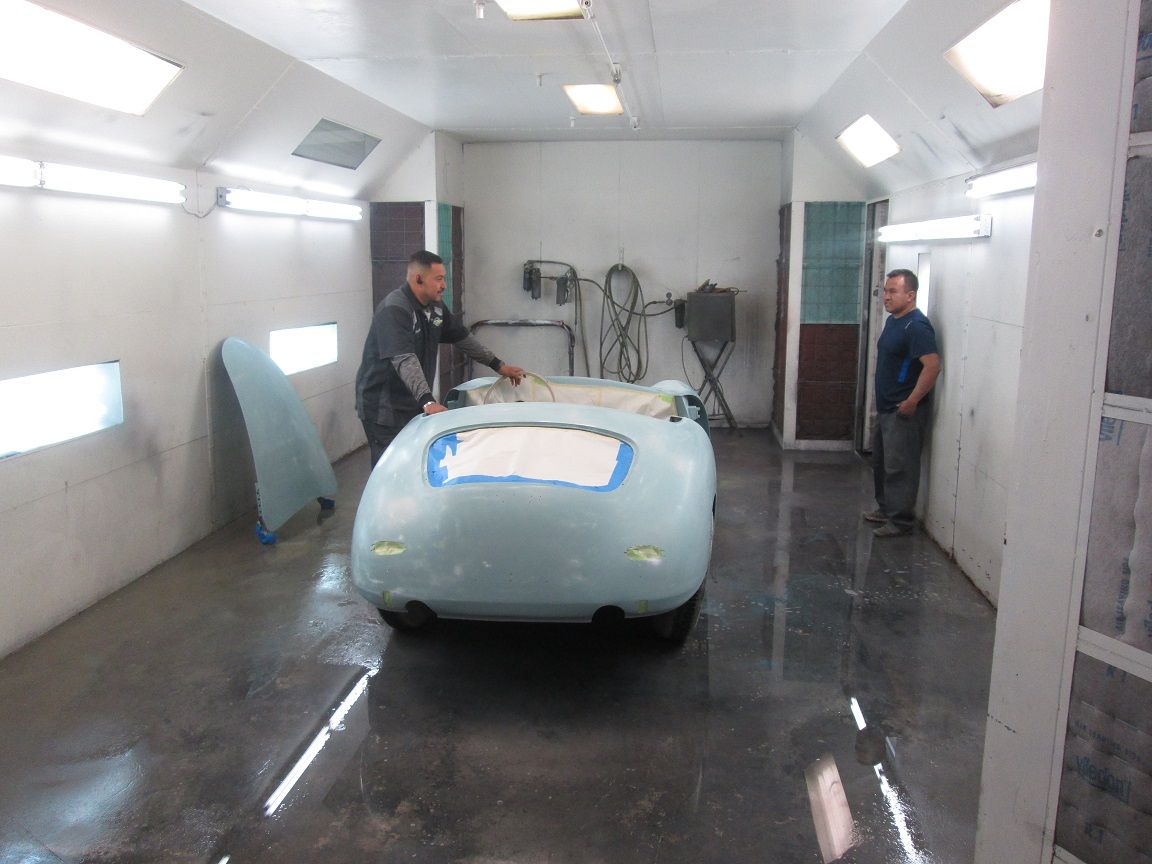

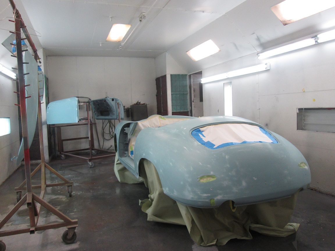

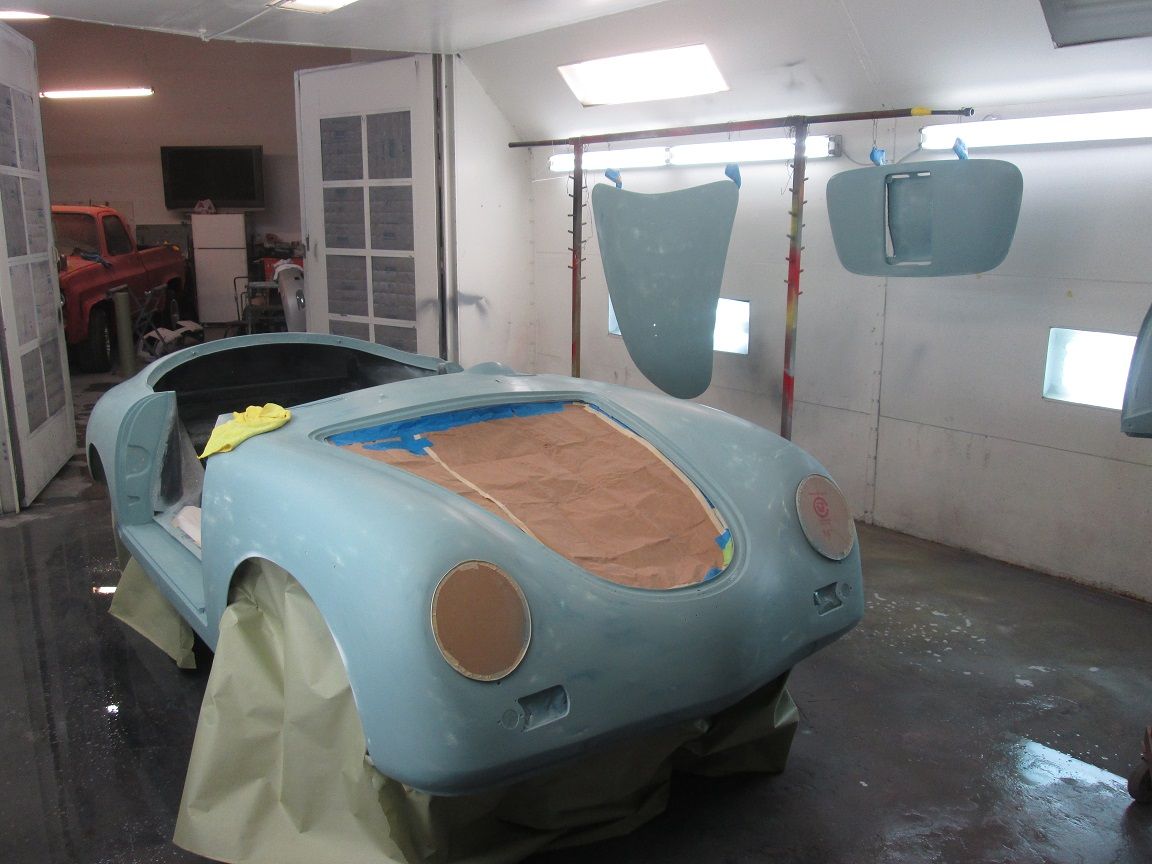

    • At long last......its into the booth!
      Click image for larger version  Name:	IMG_6968.JPG Views:	0 Size:	111.4 KB ID:	110298 Now onto final staging. Ricardo(left) the owner of the shop and the guy doing the painting talking things over with his right hand man Elias.
      Click image for larger version  Name:	IMG_6969.JPG Views:	0 Size:	113.8 KB ID:	110299 My buddy Mark loaned me his painting stand specifically built for holding 356 doors which came in very handy.
      Click image for larger version  Name:	IMG_6973.JPG Views:	0 Size:	109.8 KB ID:	110300 Car up on jack stands with a final perimeter wrap.
      Click image for larger version  Name:	IMG_6976.JPG Views:	0 Size:	113.3 KB ID:	110301 Hood and decklid also now hung and ready. A final wipe down in process.

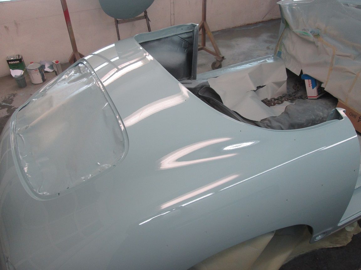

      Click image for larger version  Name:	IMG_6974.JPG Views:	0 Size:	130.1 KB ID:	110302She's all ready to go and its now in Ricardo's hands. Drum roll please...

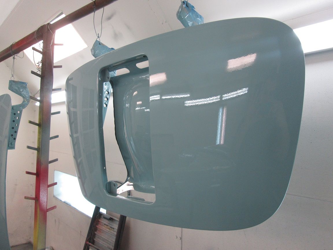

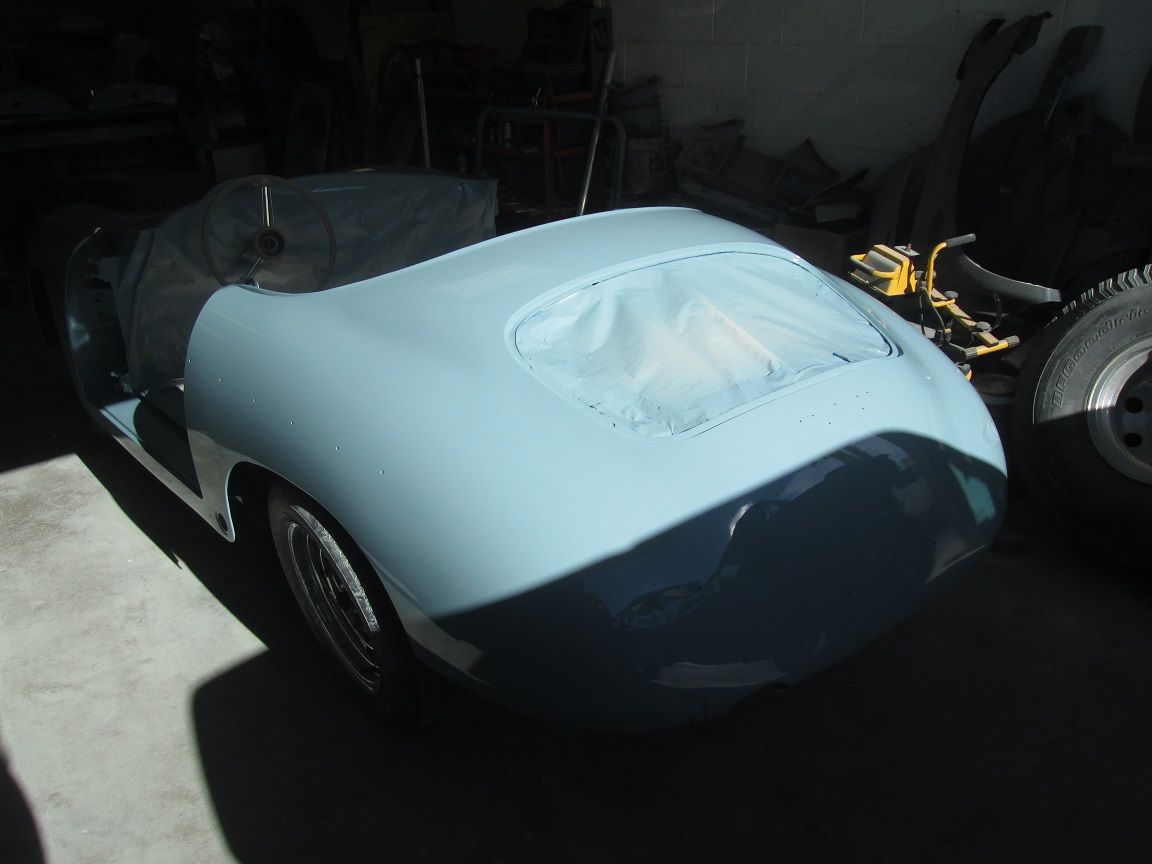

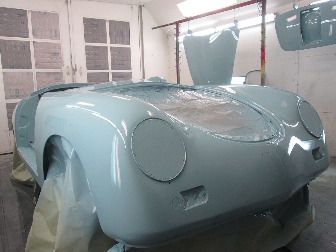

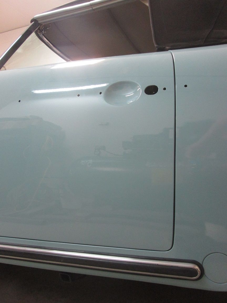

      • Painted! (one week ago)
ID:	110312 Click image for larger version
ID:	110313 Click image for larger version
ID:	110314 Click image for larger version
ID:	110315 Click image for larger version

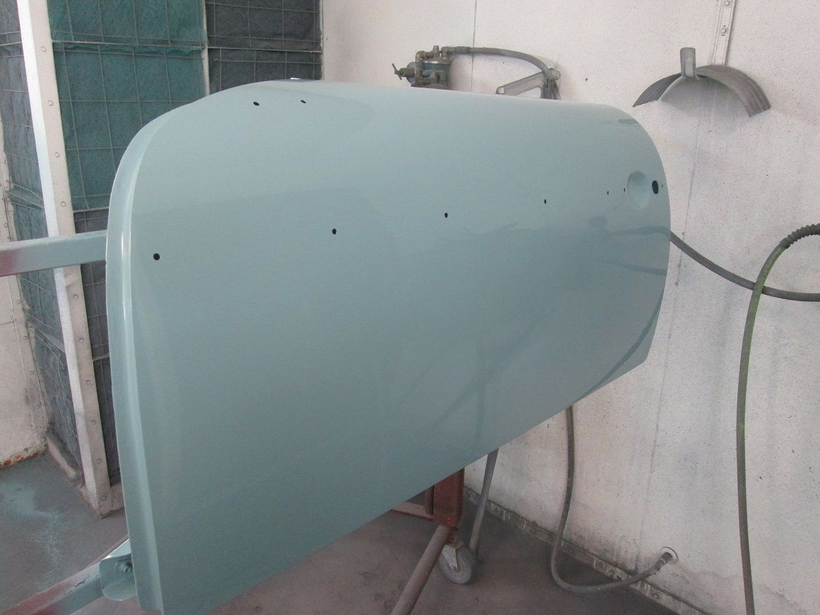

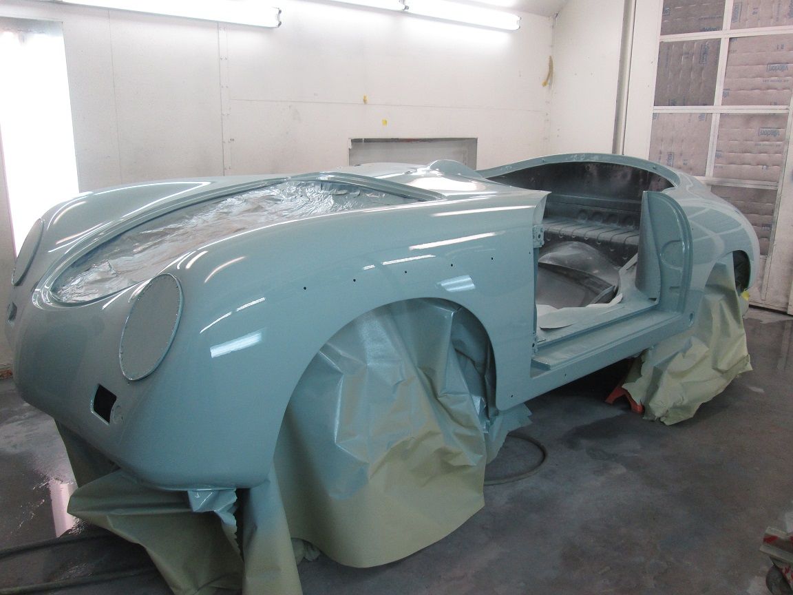

        • Part2
          Ricardo did a great job of laying that paint on for me. He really hammered it on with a good overall gloss as I told him that we really didn't have the luxury of color sanding out a lot of mistakes after the fact. We got a couple of small runs and sags in it as that's the fine line you walk when you go for a high shine but I can cut and polish those out.
ID:	110318 Click image for larger version
ID:	110319 Click image for larger version
ID:	110320 Click image for larger version
ID:	110321 Click image for larger version
ID:	110322 Safely back into my shop the following morning. The next big hurdle is getting the windshield frame installed. Prepping for that next.

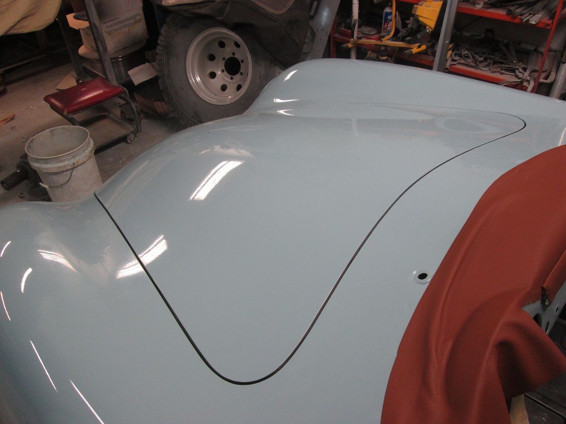

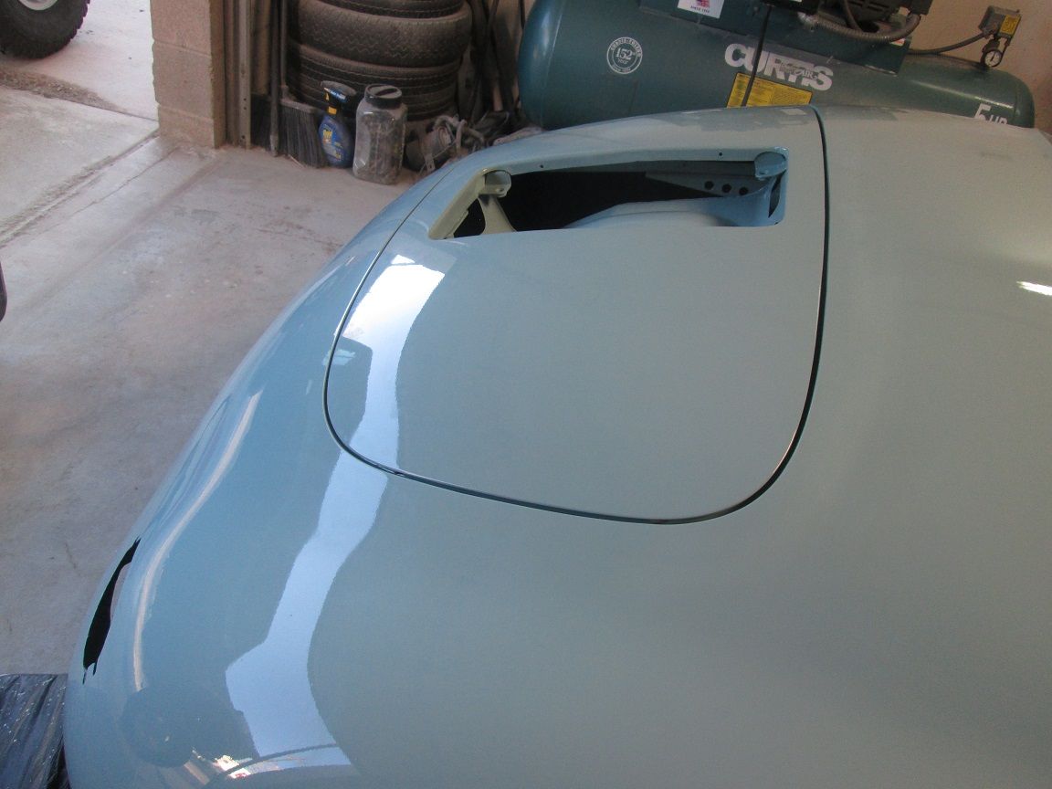

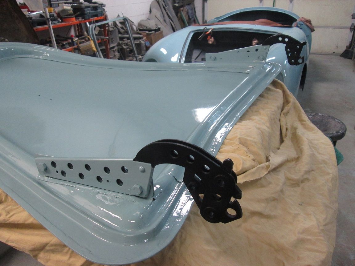

                Began with the deck lid:
ID:	110427 Peeled the tape on my back masked hinges in prep for the lids final install.
ID:	110428 Lid installed for the final time. I must have removed and installed this thing a hundred times like the rest of the closing panels but a final painted surface really increases the danger and stress factor.
ID:	110429 Fully latched in its final position. I was already spot sanding/polishing some lint that always seems to find a way in the process.
ID:	110430 Highlighting the reflection shapes across the gaps here.
ID:	110431 Onto the hood installation next.

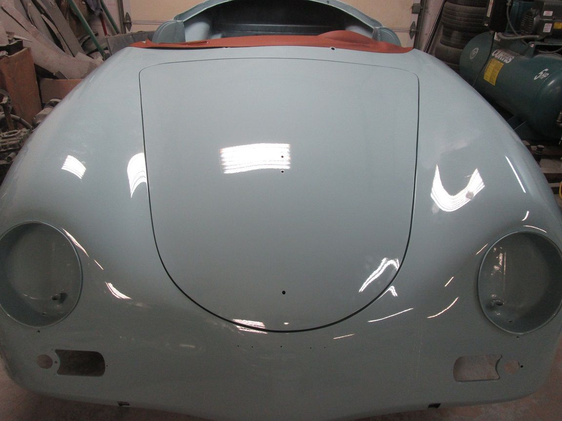

                • Final hood installation:

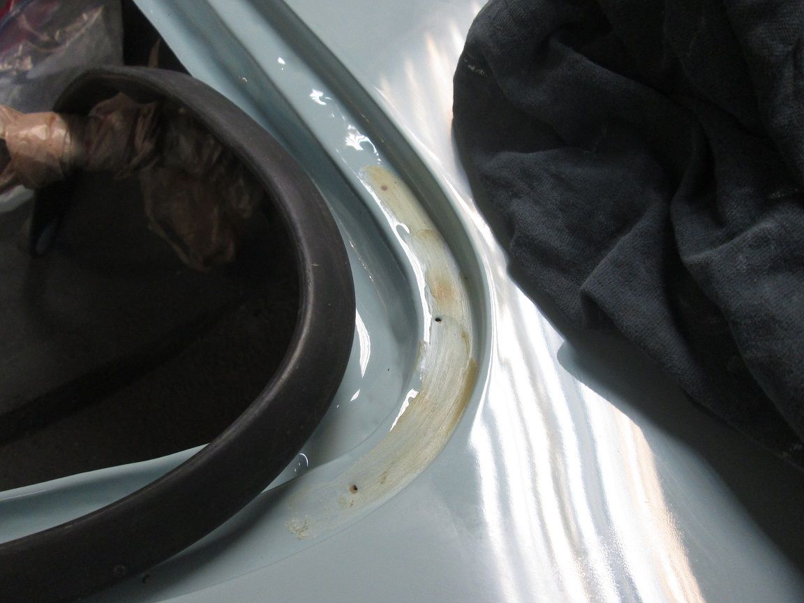

                  Click image for larger version  Name:	IMG_7020.JPG Views:	0 Size:	104.4 KB ID:	110433 The seal has to go on first. I like adding a veneer of grease in and around those metal corner clamps just for an additional rust inhibiter
                  Click image for larger version  Name:	IMG_7021.JPG Views:	0 Size:	112.0 KB ID:	110434 Seal all set with its joint placed to the right side corner just behind the lowest screw on the mounting clamp. This is where all the concourse guys say it goes....
                  Click image for larger version  Name:	IMG_7022.JPG Views:	0 Size:	129.7 KB ID:	110435 Back tape peeled revealing the black out detail just before mounting.
                  Click image for larger version  Name:	IMG_7024.JPG Views:	0 Size:	97.8 KB ID:	110436 Installed for the final time and latched.Phew! All done here.

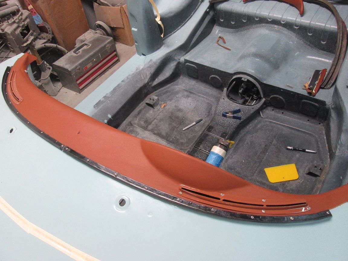

                  Click image for larger version  Name:	IMG_7025.JPG Views:	0 Size:	96.8 KB ID:	110437 As you can I was also skinning the dash top in preparation for the windshield installation. I'll back up and show more on this next.

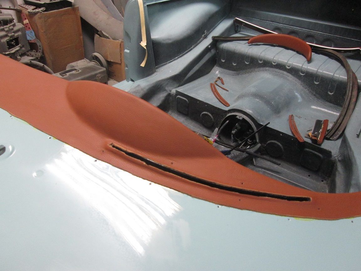

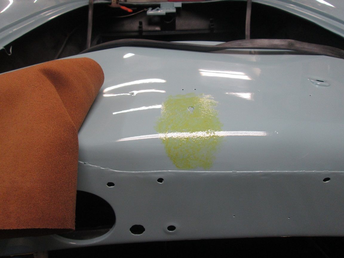

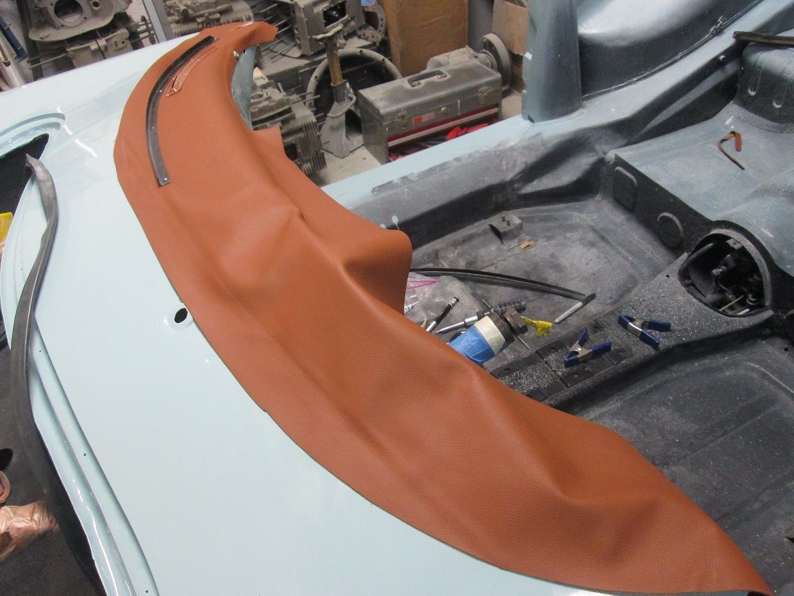

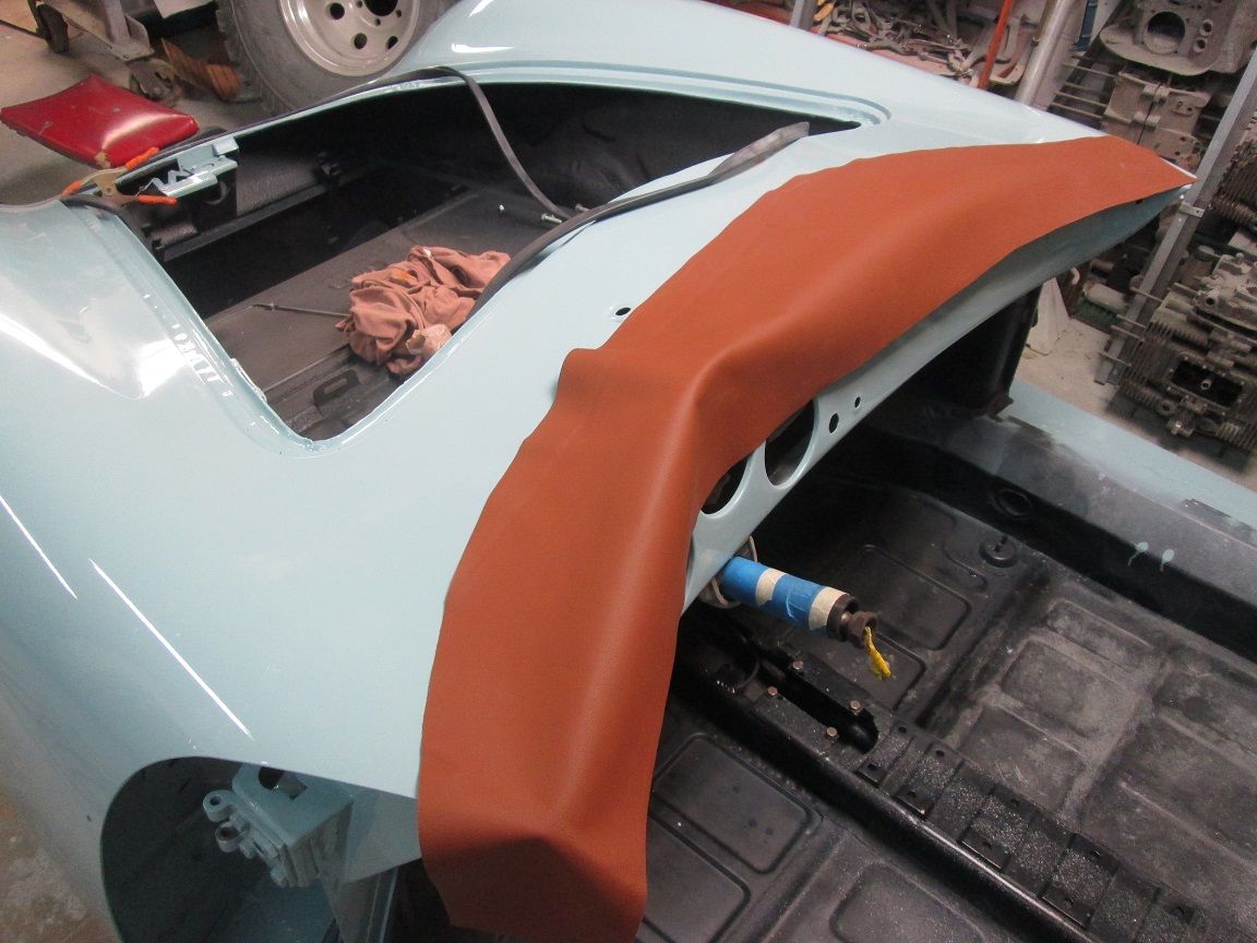

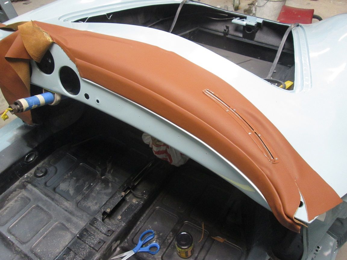

                  • Dash top skinning:

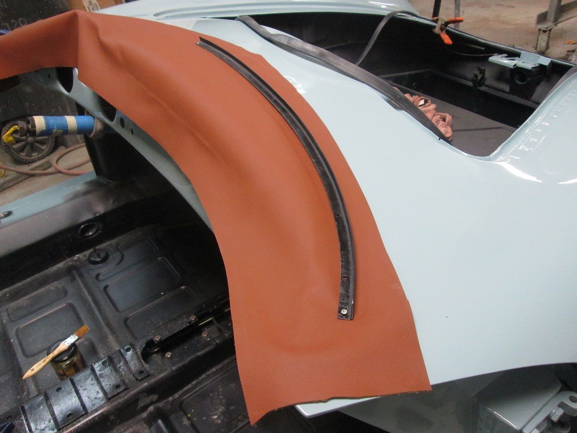

ID:	110439 Locating the skin in most centered position to ensure I didn't run short anywhere once I started gluing. I bounced back and forth with the hood seal install.
ID:	110440 Once I had it located I laid down my first section of landau glue and worked my way from the center outward.
ID:	110441 I continued gluing to the right side first as it was the much easier and straight forward shape to cover. A nice confidence builder.
ID:	110442 Once secured I began opening up the relief shapes for the defroster and the grab handle.
ID:	110443 Now ready to taken on the more complicated shape of the gauge cluster. More on this later...

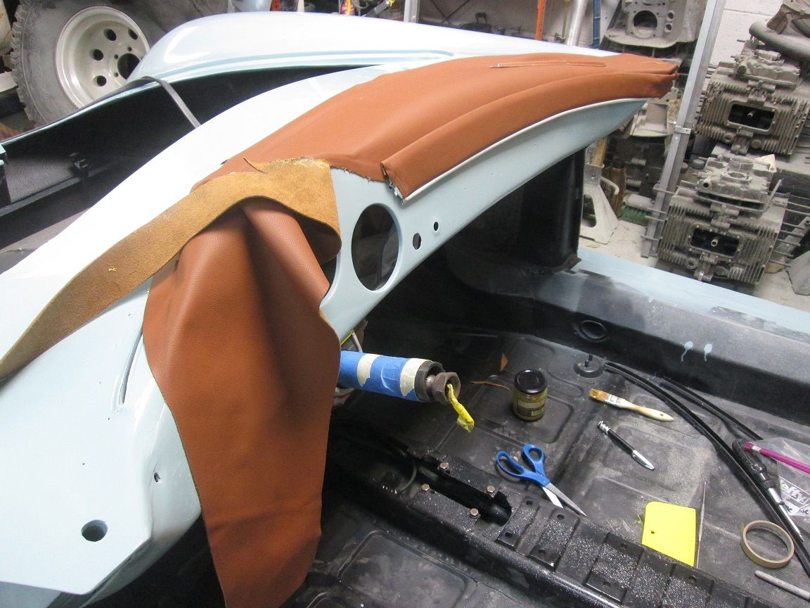

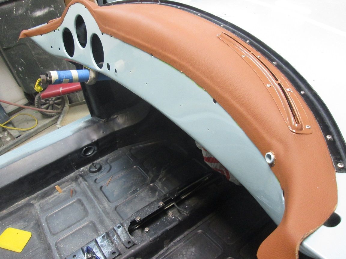

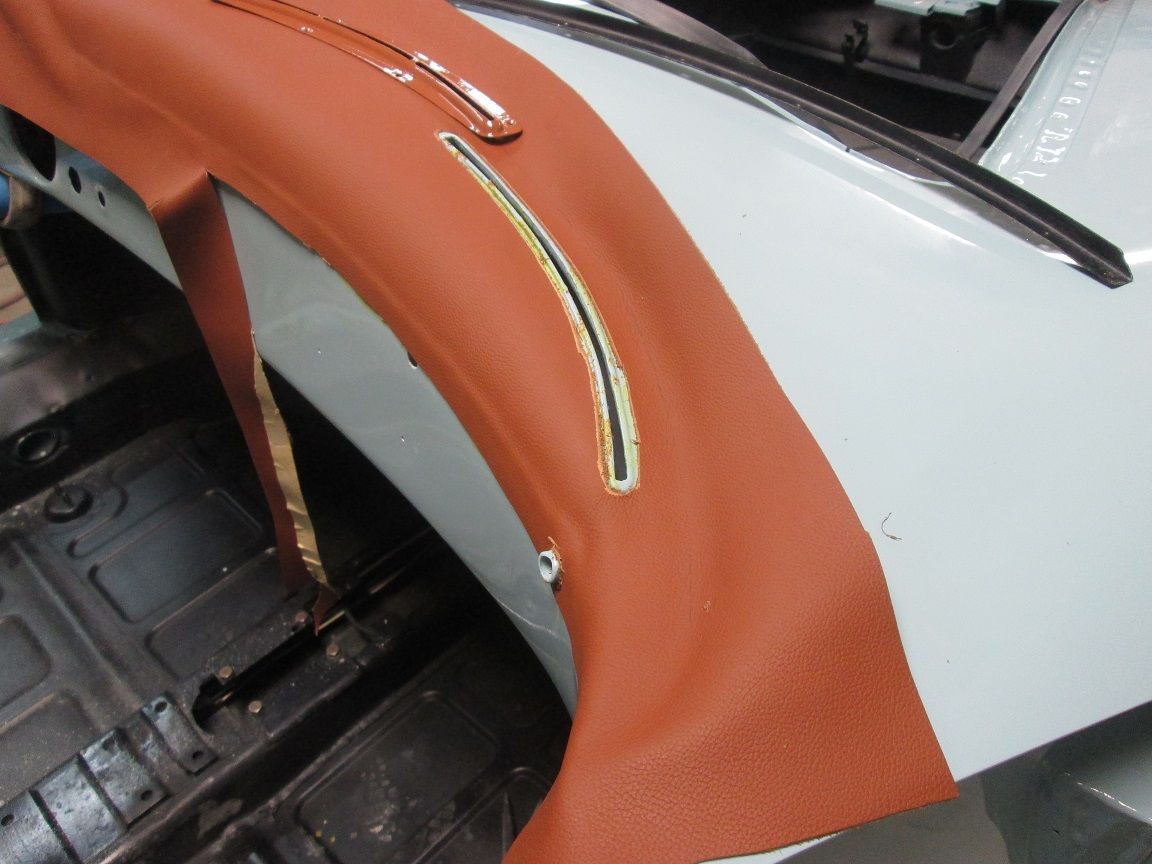

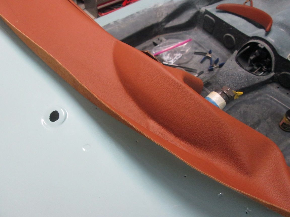

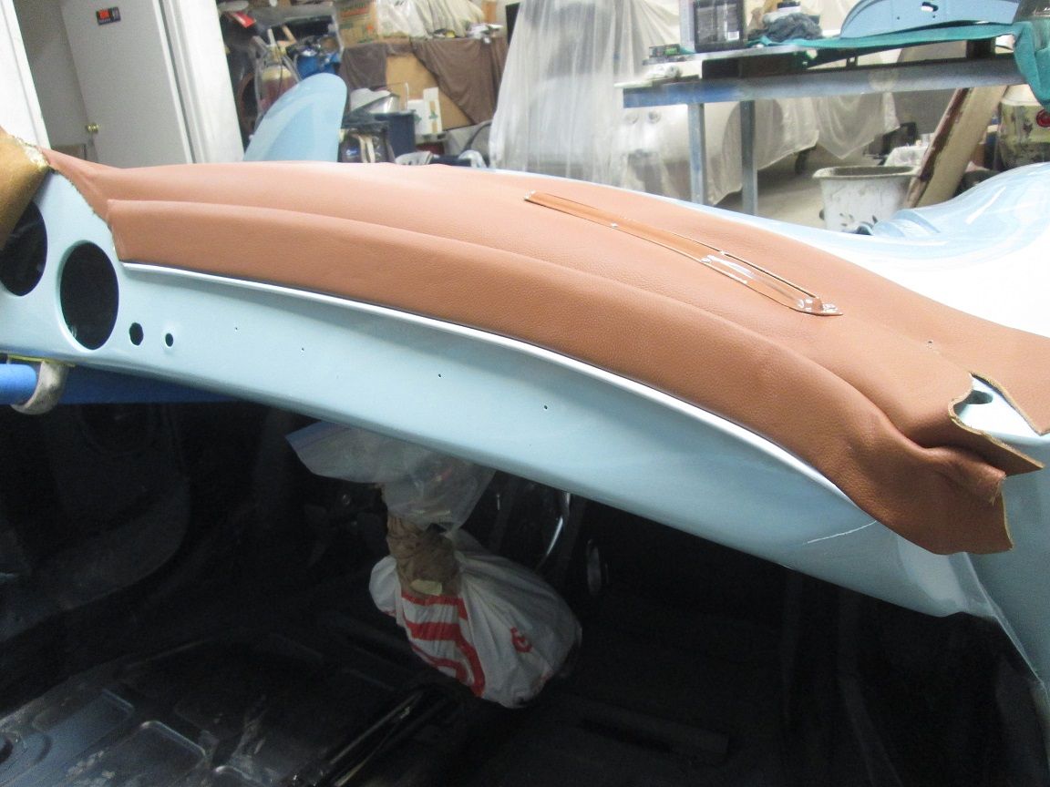

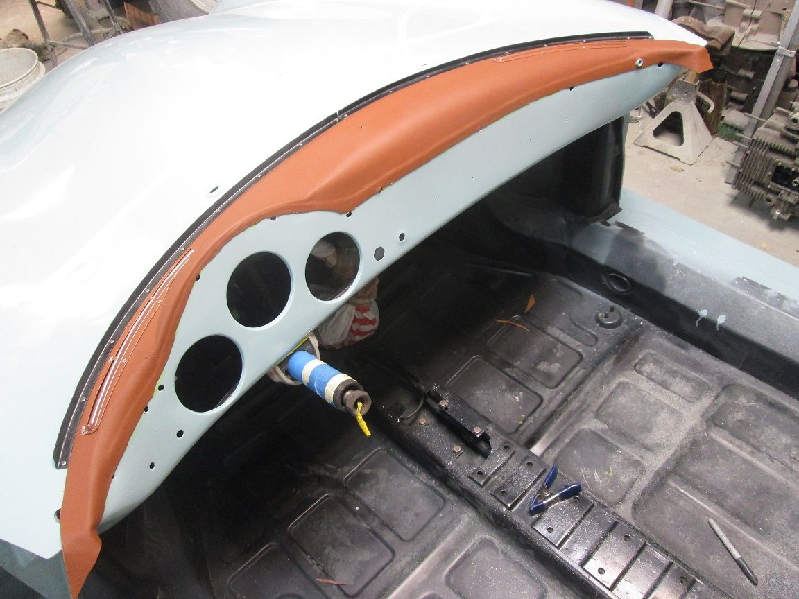

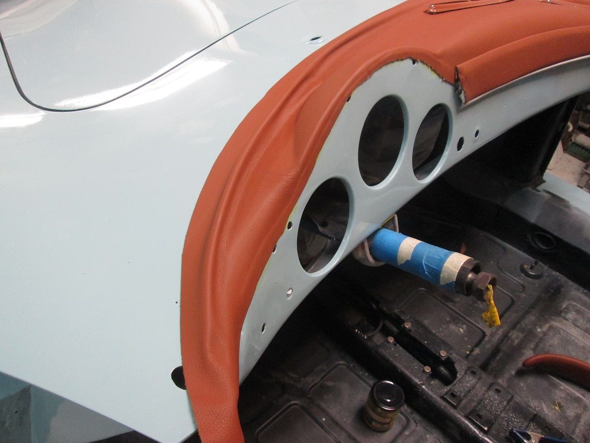

                    • Dash skinning continued:
                      Click image for larger version  Name:	012.JPG Views:	0 Size:	106.4 KB ID:	110448 Steadily getting that leather to lay down tight around this compound shape.
                      Click image for larger version  Name:	011.JPG Views:	0 Size:	160.6 KB ID:	110449 Making my way to the outside all the while staying extra aware so I didn't screw this up. Mocked up the lower base just to have a look.
                      Click image for larger version  Name:	010.JPG Views:	0 Size:	130.8 KB ID:	110450 Taking shape...
                      Click image for larger version  Name:	008.JPG Views:	0 Size:	119.4 KB ID:	110451My job is just to tuck the top corner in. Autos international will handle this lower section.
                      Click image for larger version  Name:	IMG_7027.JPG Views:	0 Size:	106.3 KB ID:	110452
                      After a few attempts this outer contour laid down tight. Had to leave the back flap loose to allow the needed shrinking and stretching along the way. Tough part is over and its all down hill from here. My camera couldn't decide whether the leather was light brown or a reddish-copper color. I was liking this redder version.

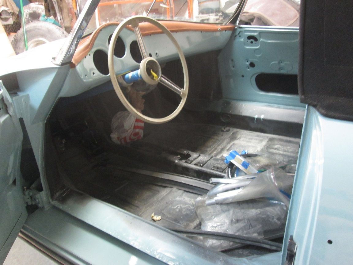

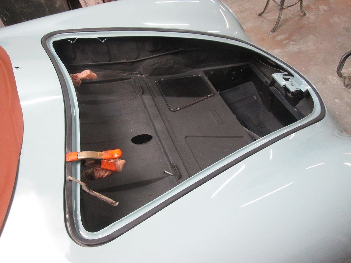

                      • Click image for larger version  Name:	IMG_7044.JPG Views:	0 Size:	122.3 KB ID:	110454 Left side now finished. Excess trimmed with vent opened.
                        Click image for larger version  Name:	IMG_7048.JPG Views:	0 Size:	142.8 KB ID:	110455Lower frame and vent covers installed. Now ready to accept a windshield.
                        Click image for larger version  Name:	IMG_7049.JPG Views:	0 Size:	141.9 KB ID:	110456Seems straight forward enough but that gauge relief shape definitely throws a curve in there.
                        Click image for larger version  Name:	IMG_7050.JPG Views:	0 Size:	133.2 KB ID:	110457Just have to finishing out the corners.
                        Click image for larger version  Name:	IMG_7066.JPG Views:	0 Size:	101.2 KB ID:	110458Corners finished completing this phase of the installation.
                        Thanks for stopping by!

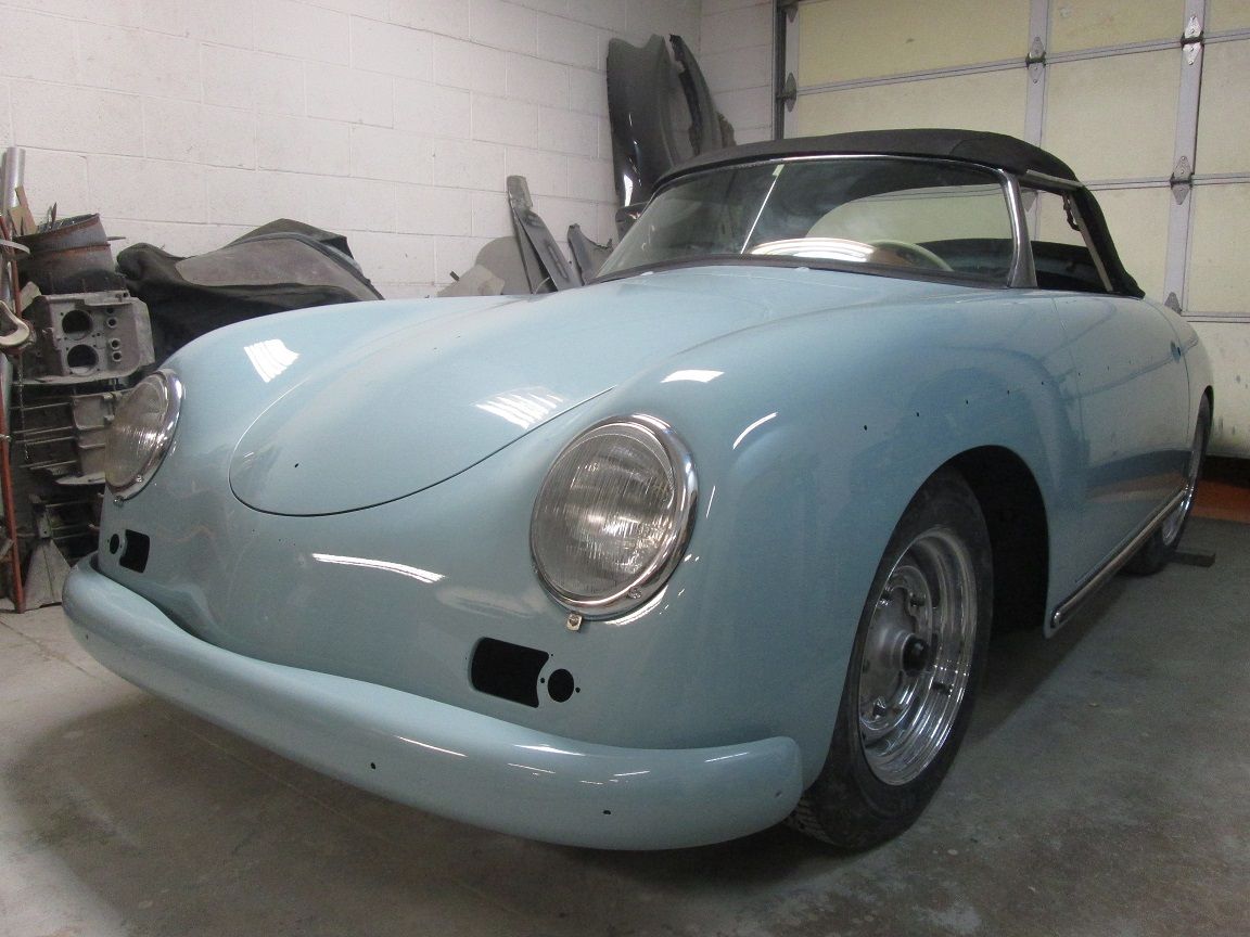

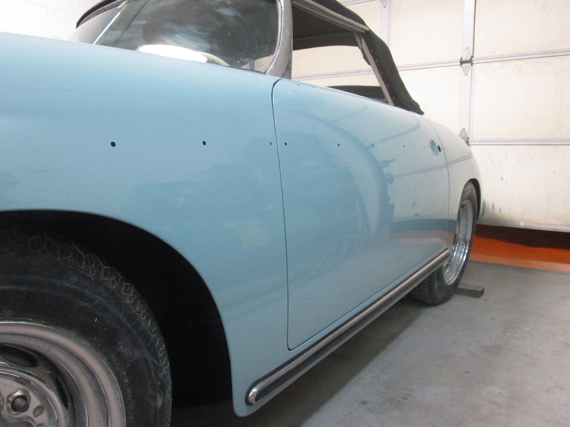

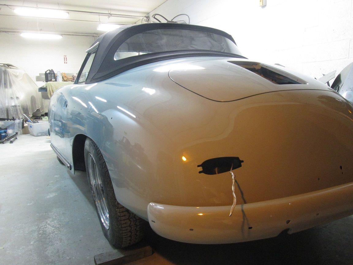

                        • I was under the gun to get the car ready for pick up so I didn't take any shots until it was reassembled and headed into the trailer. Below are some random shots in no particular order just before it was loaded.
