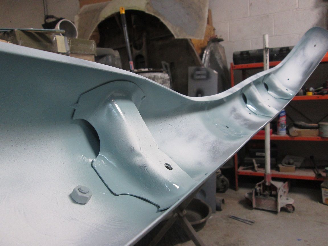

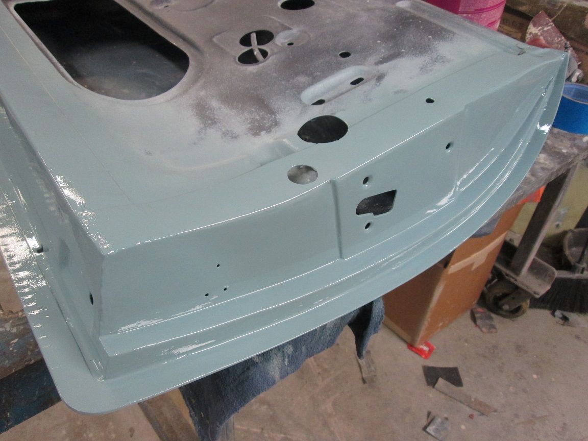

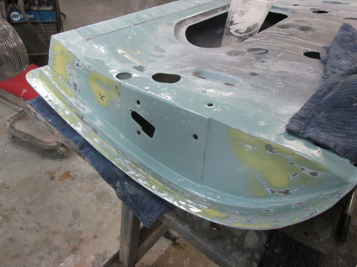

  • More lid work:

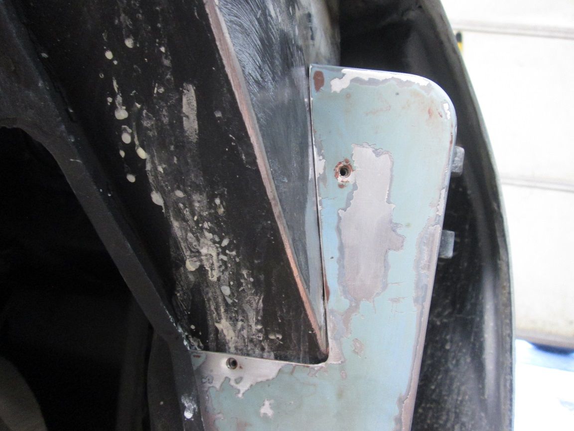

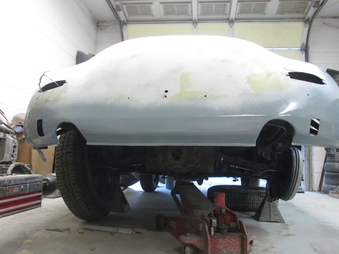

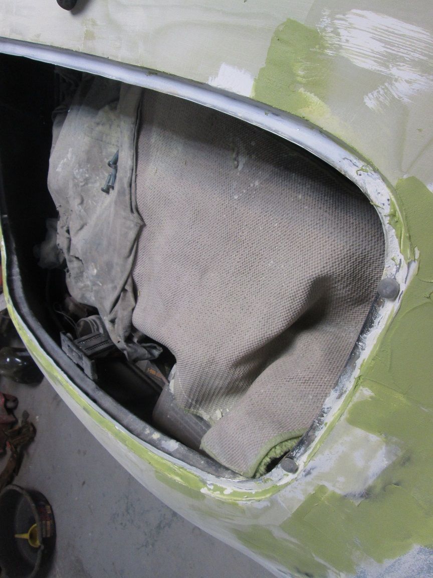

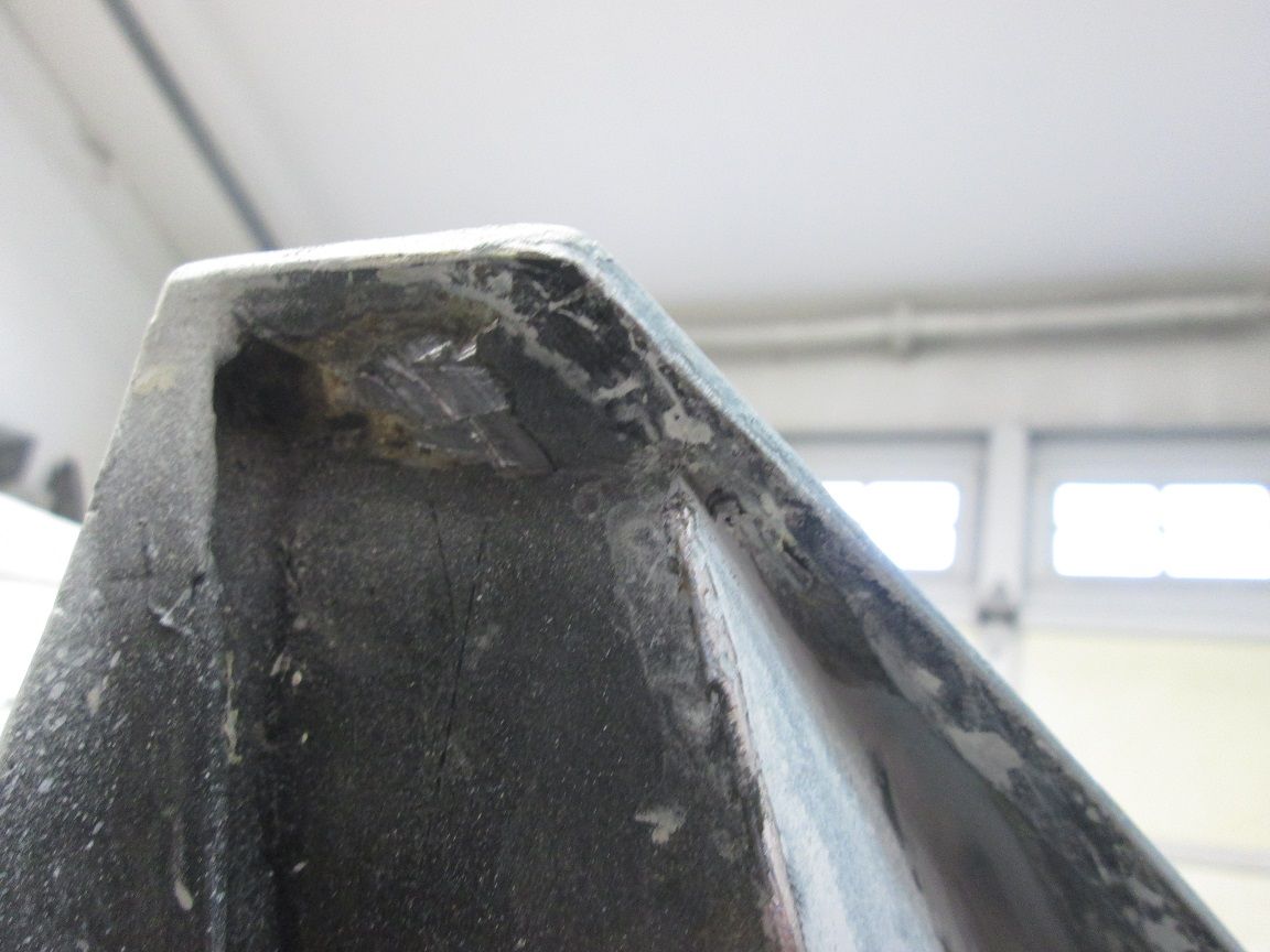

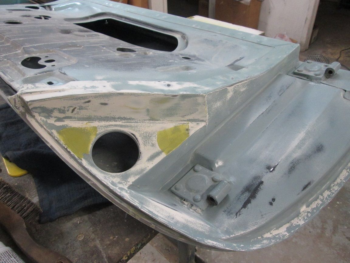

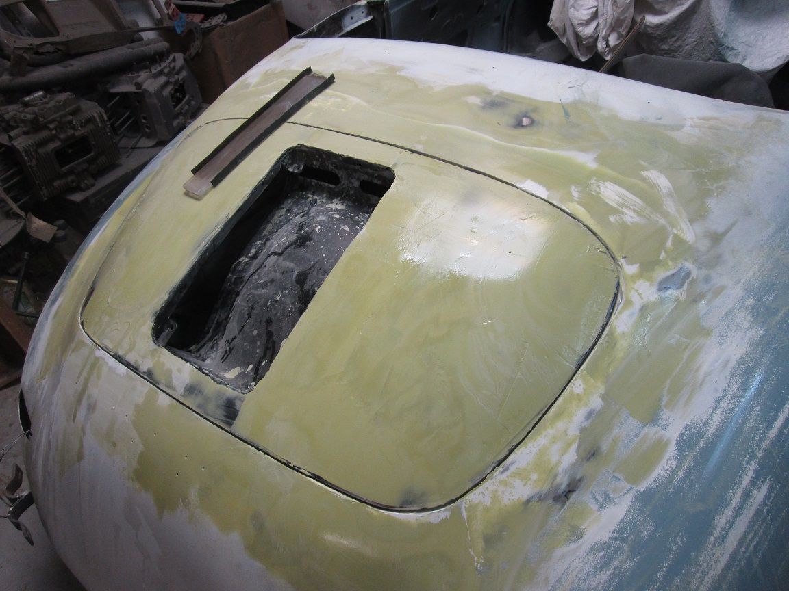

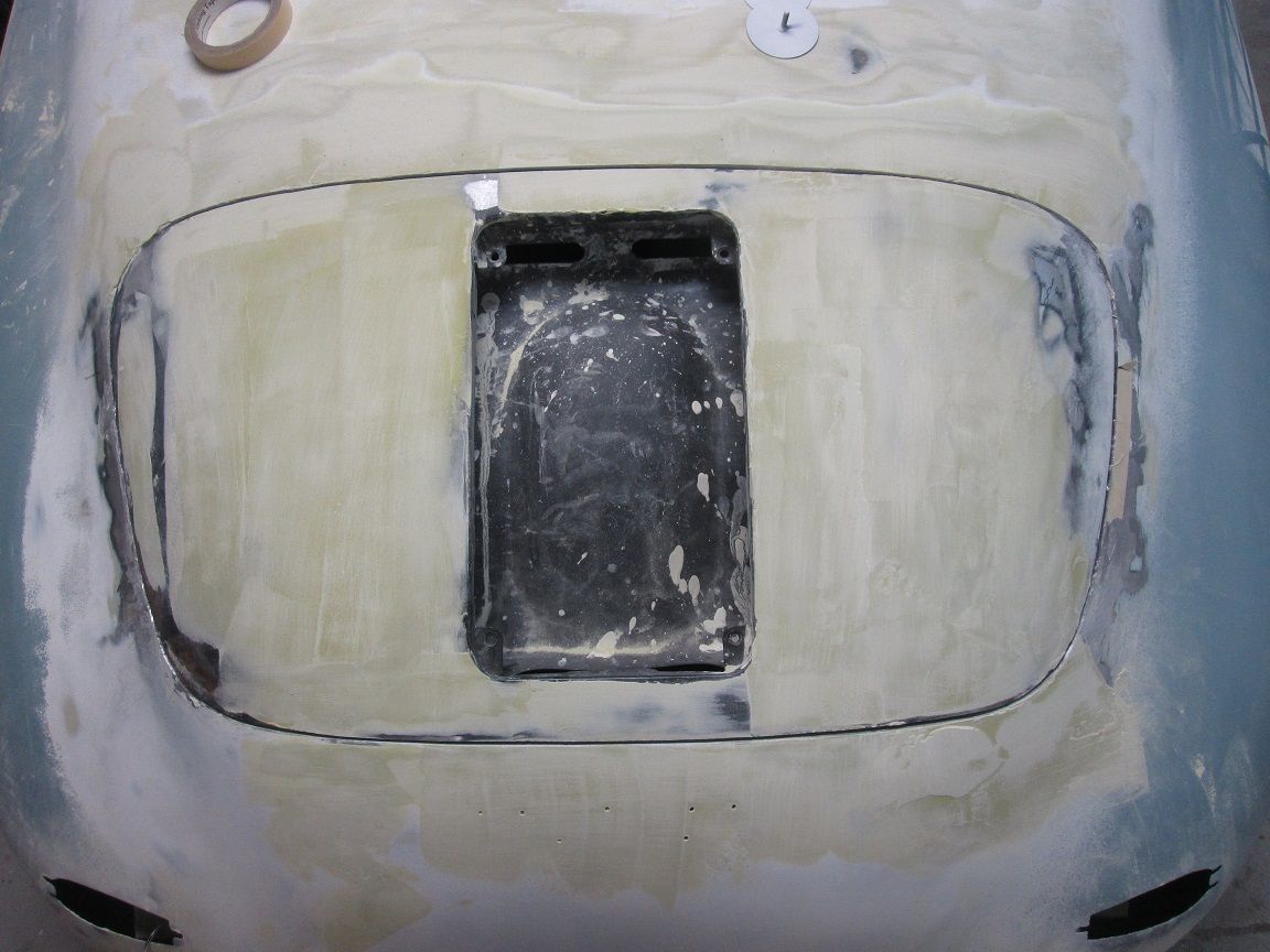

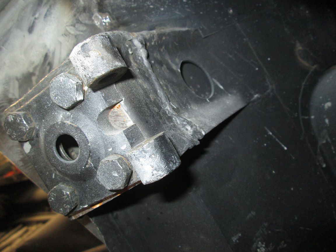

    Click image for larger version  Name:	IMG_6033.JPG Views:	0 Size:	120.3 KB ID:	109339 Once I had the edges of the stitched back together it was remounted and swatching and blocking continued.

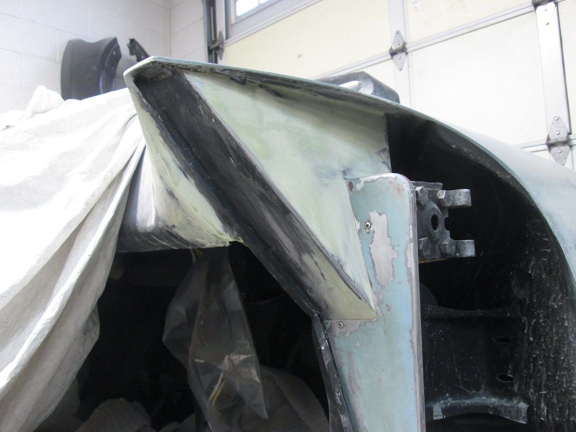

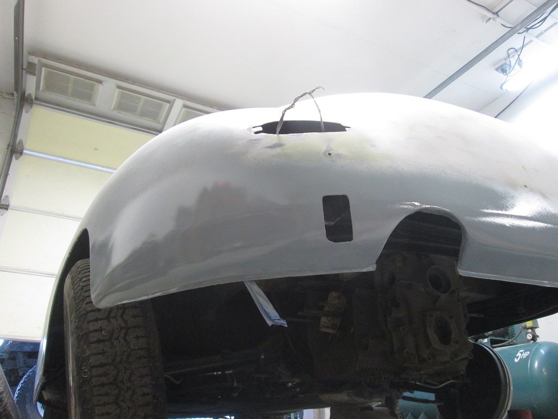

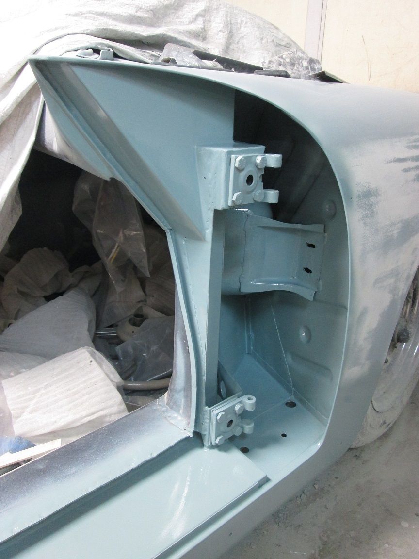

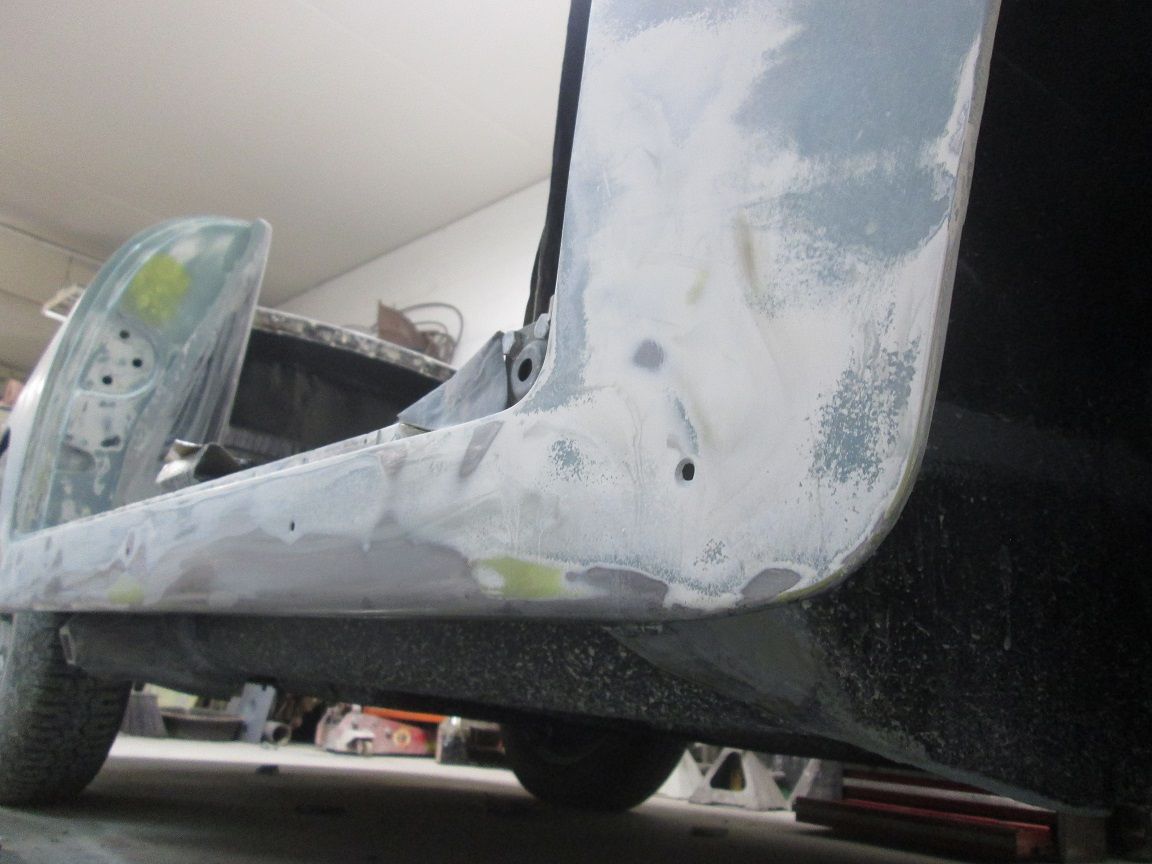

    Click image for larger version  Name:	IMG_6042.JPG Views:	0 Size:	136.5 KB ID:	109340 Had a contour issue with this right side. The upper edge/corner was a touch too low and the angle of the cowl in relation to the rest of the lid where just not matching and flowing. Both the lid and surrounding area suffered previous accident damage so it was pretty much expected.

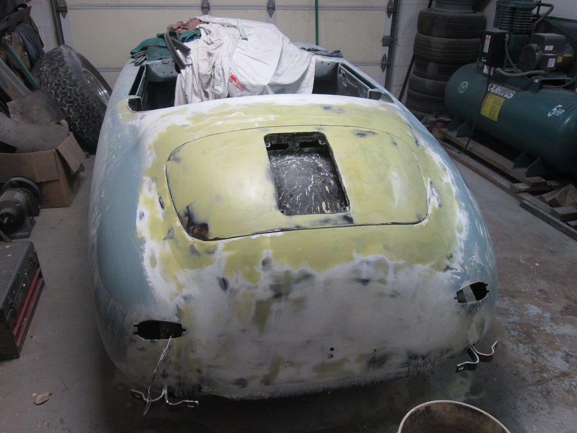

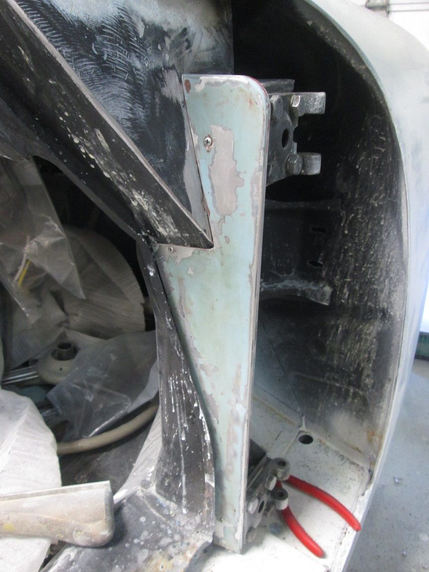

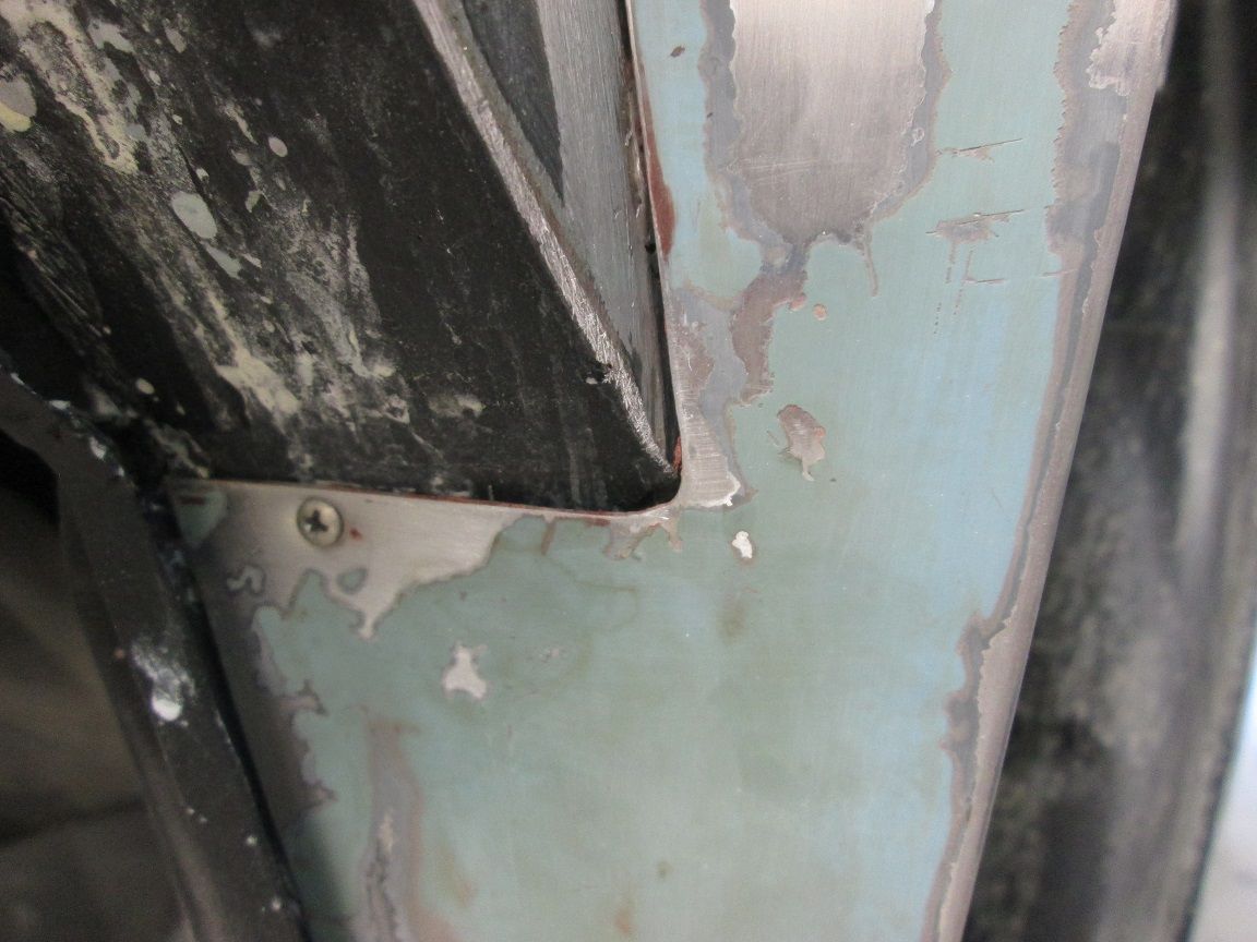

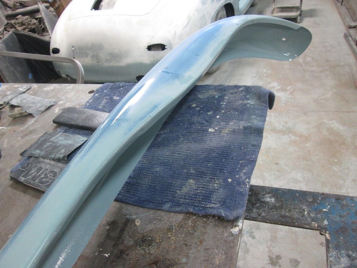

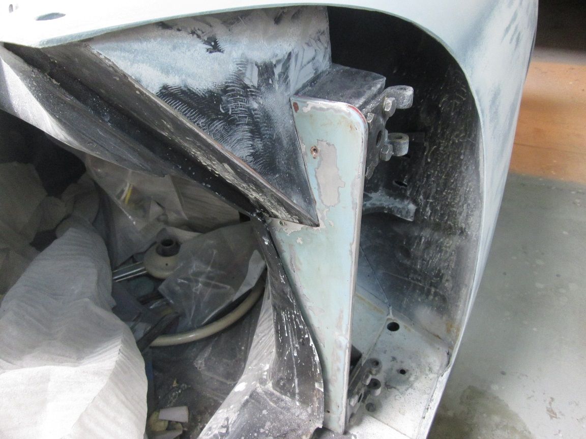

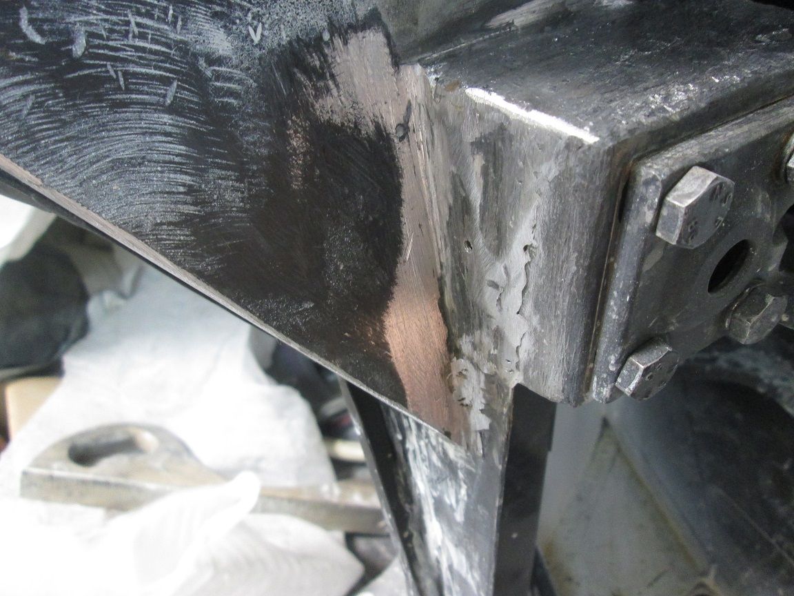

    Click image for larger version  Name:	IMG_6056.JPG Views:	0 Size:	168.6 KB ID:	109341 Subframe was relief cut to allow the edge of skin to come up and to bring the contour shapes of both cowl and the lid into better alignment.

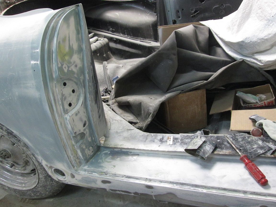

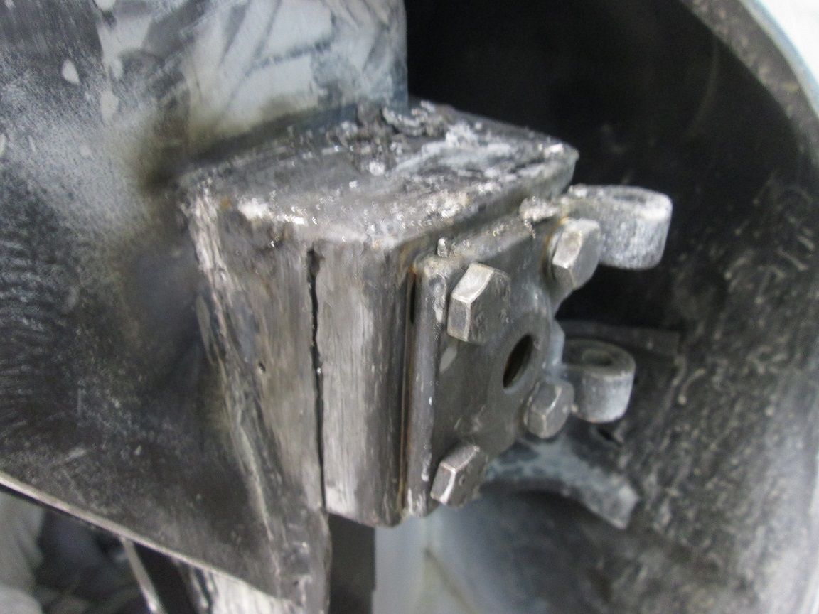

    Click image for larger version  Name:	image_63163.jpg Views:	3 Size:	147.9 KB ID:	109342

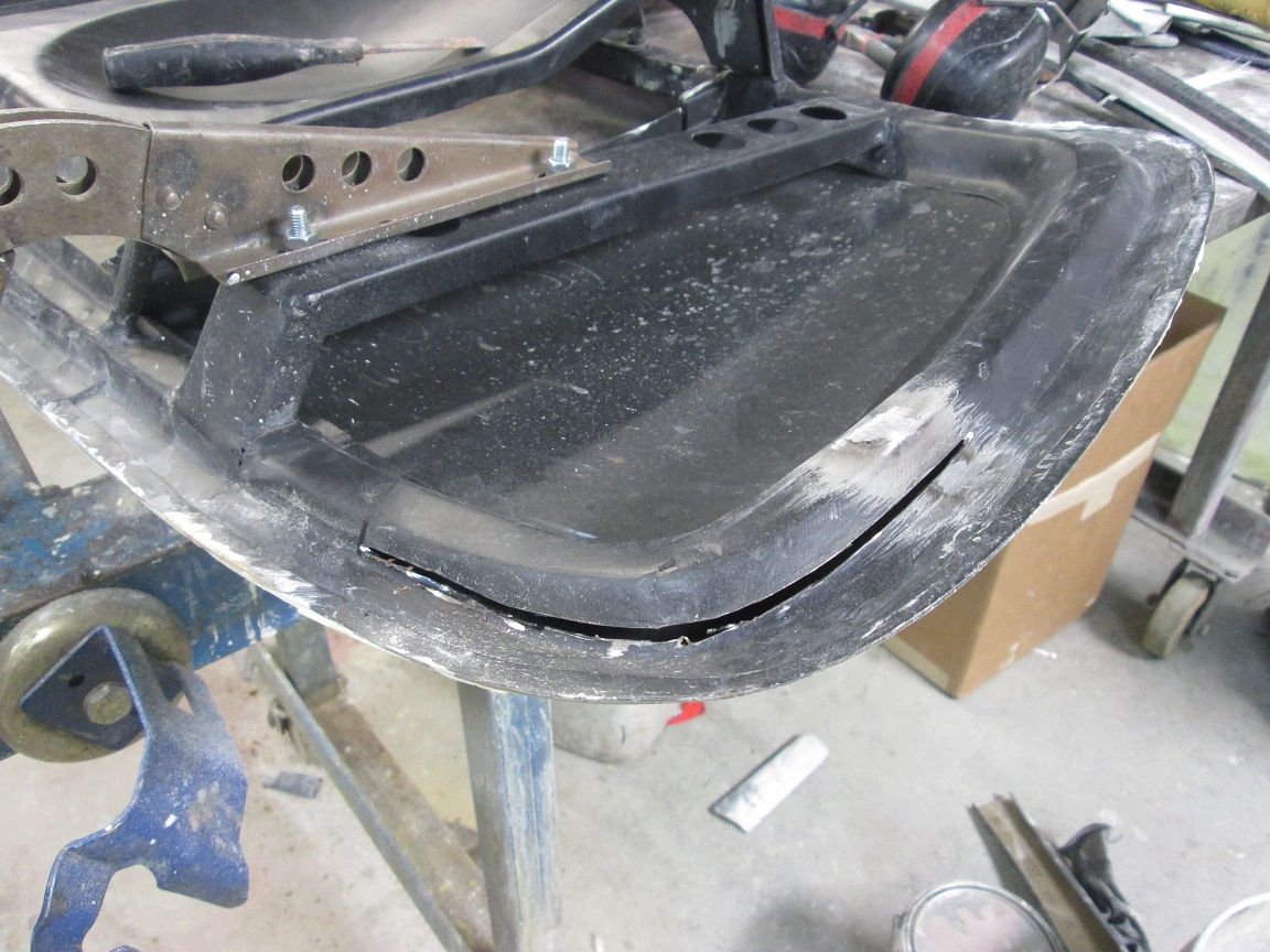

    Begin smoothing out and detailing the trough areas while I had the lid off
    Click image for larger version  Name:	IMG_6060.JPG Views:	0 Size:	133.1 KB ID:	109343Substructure tacked into needed position and lid remounted. Block sanding continued and the contour and fitment were much improved. I was able to thin out the filler quite a bit as it went. Always the outcome I'm looking for.

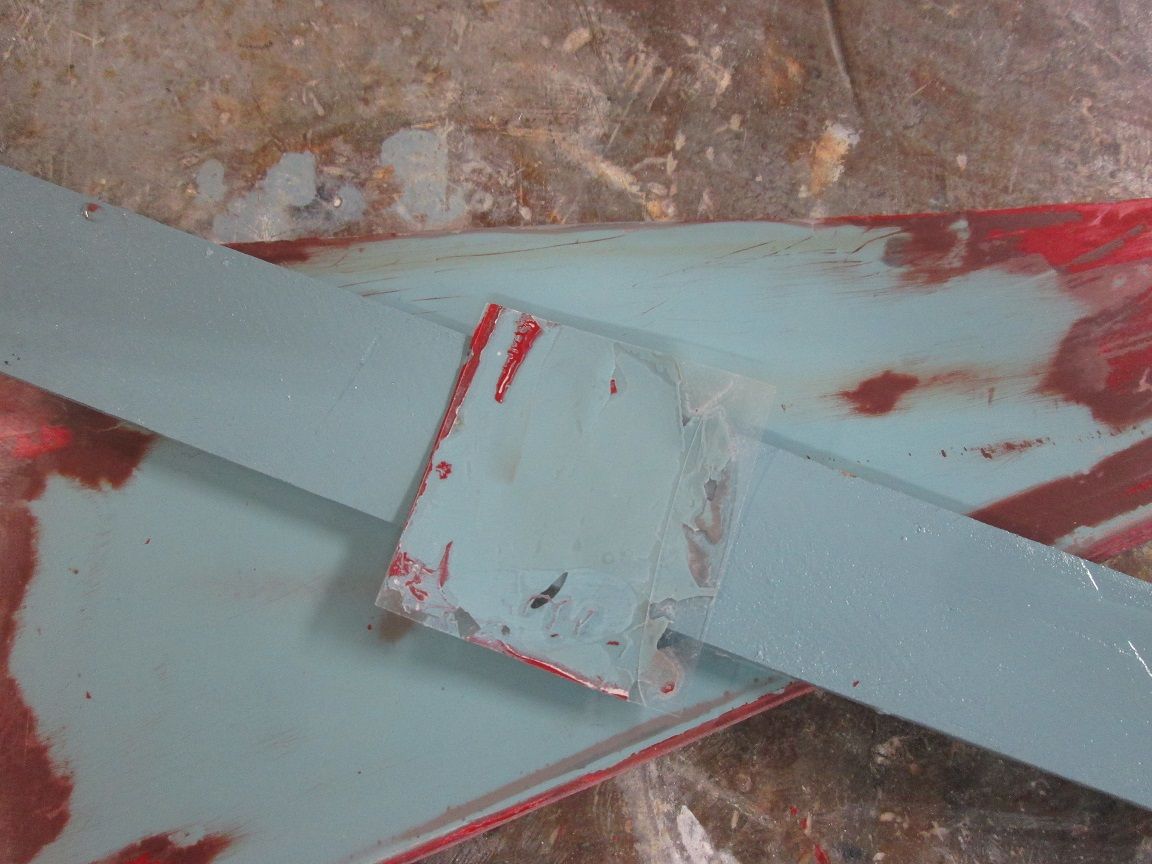

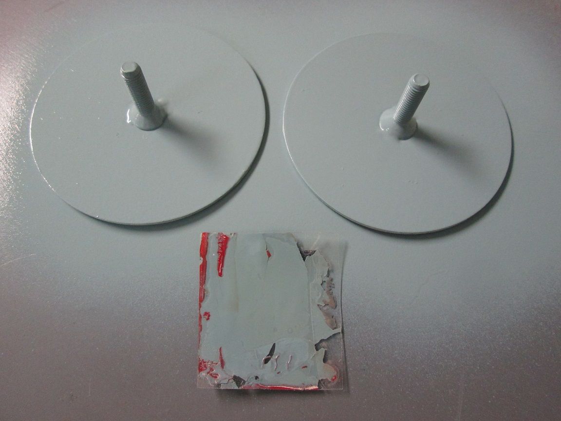

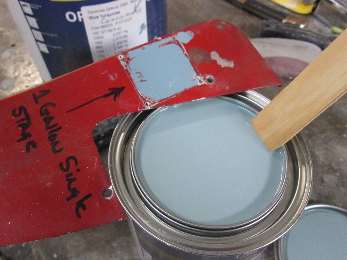

    • Original version of Meissen blue for this particular car matched and mixed.

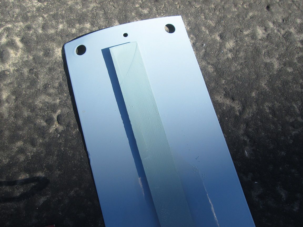

      Click image for larger version  Name:	IMG_6071.JPG Views:	0 Size:	125.0 KB ID:	109397
      Original paint sample just under the ID tag was just large enough for a camera match. Purchased a gallon and one extra quart of it( insurance) in single stage. Its a touch lighter when wet as you can see.
      Click image for larger version  Name:	IMG_6076.JPG Views:	0 Size:	121.8 KB ID:	109398 but once it dries (paint stick) it darkens right up to the correct tint. A side comparison with the other 3 samples of Meissen I was supplied. Two of which where a closer match to the color this car originally came in. The large spray out card from Whilhoit is more of a true blue where the others lean more toward the Turquoise side.
      Click image for larger version  Name:	IMG_6079.JPG Views:	0 Size:	168.2 KB ID:	109399 As you can see these two versions of Meissen are not even close. I'm not claiming that the Whilhoit sample is wrong as the car he matched this sample from probably very well came in this shade. These cars where shot in batches so I have no doubts that the color shade between runs varied. Even between the coach coach builders; Reutter Vs. Drauz and perhaps even with their particular paint suppliers. A lot of variables for sure. So when guys at a show argue which shade is correct they could both be right. The Whilhoit sample seems more like the color of your coupe Roy.

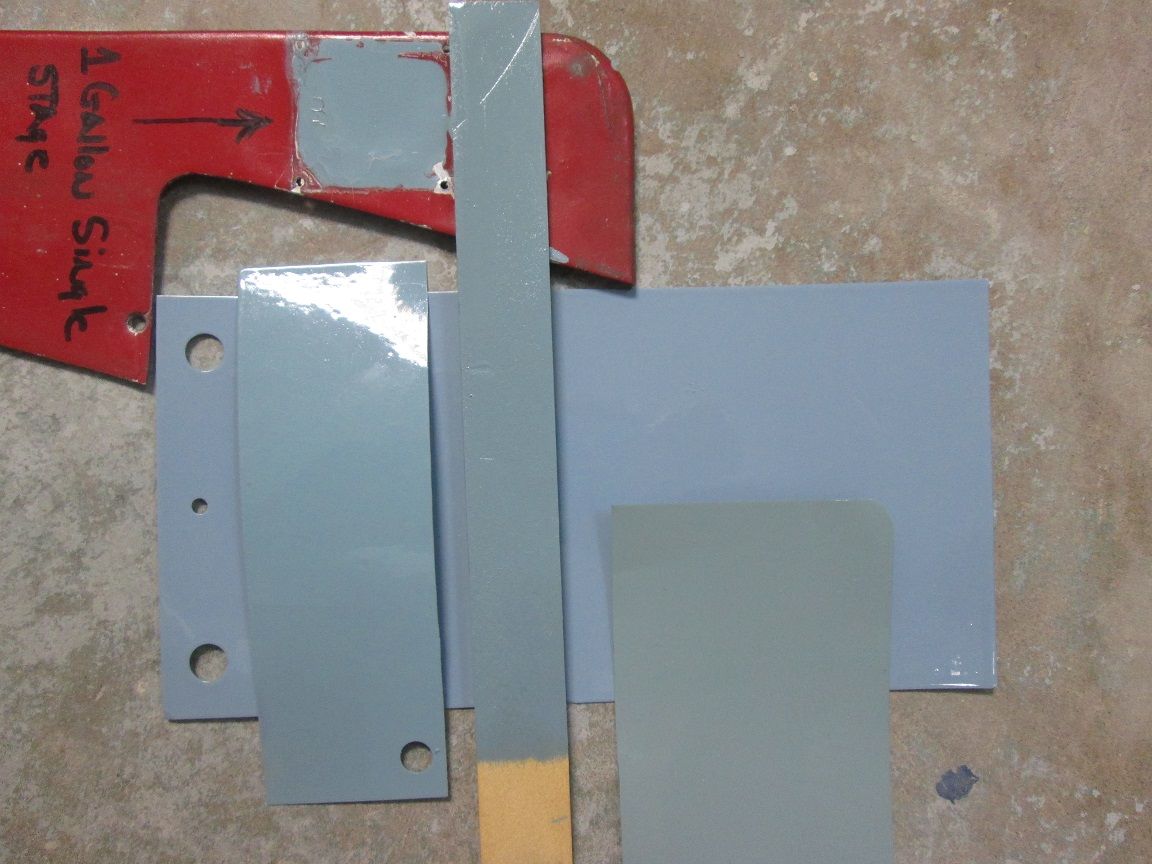

      Click image for larger version  Name:	image_63192.jpg Views:	4 Size:	127.6 KB ID:	109400 Found the original paint was still lurking under the red respray. Carefully peeled the sample free that was under the tag for future reference. A direct comparison with the paint stick.
      Click image for larger version  Name:	IMG_6086.JPG Views:	0 Size:	97.1 KB ID:	109401 Spray out test on the body plugs. As close of a match as I could ever hope to get.

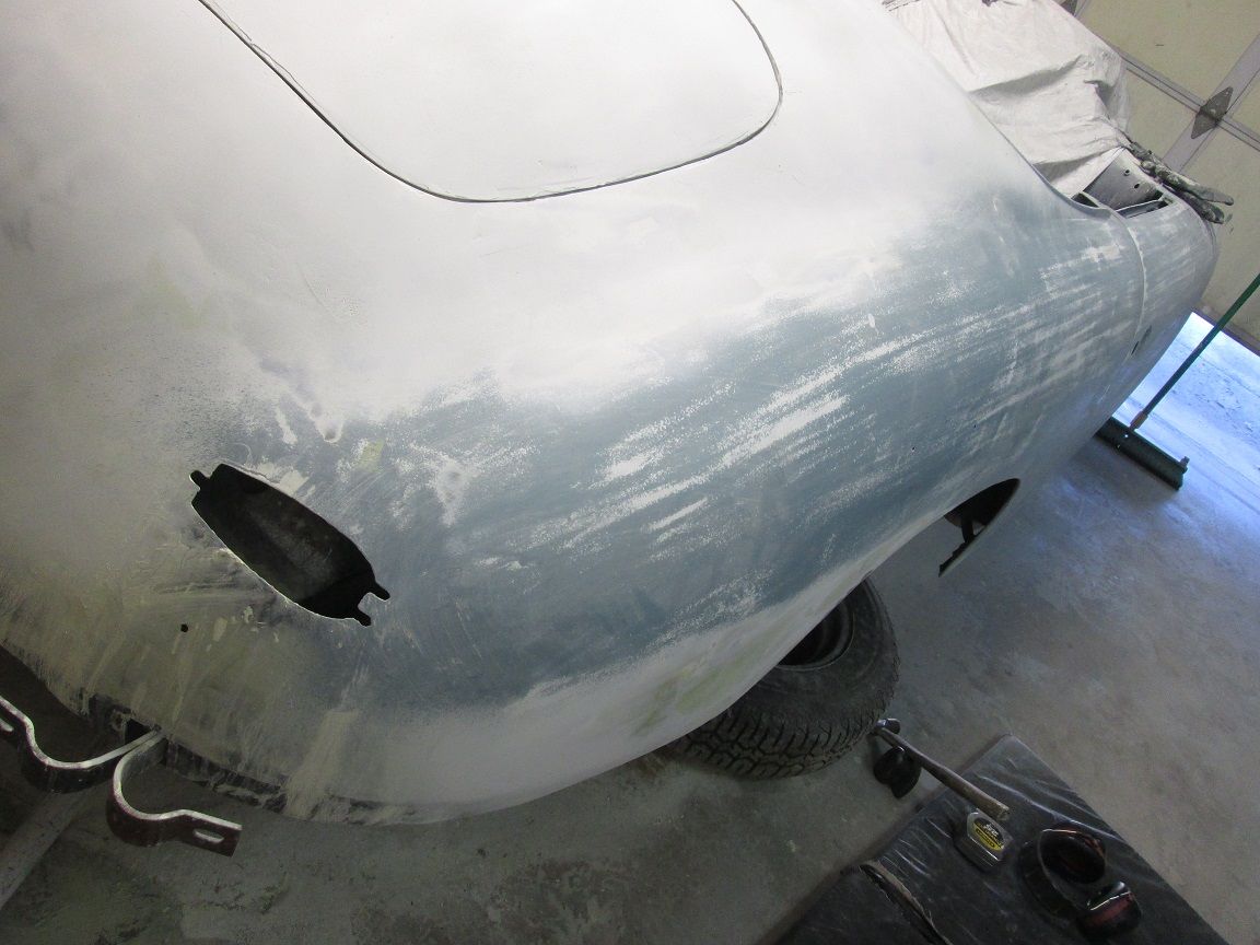

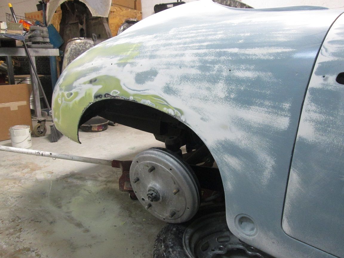

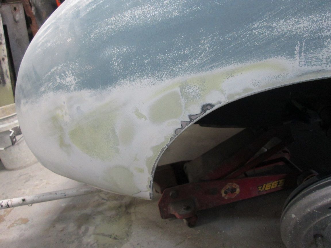

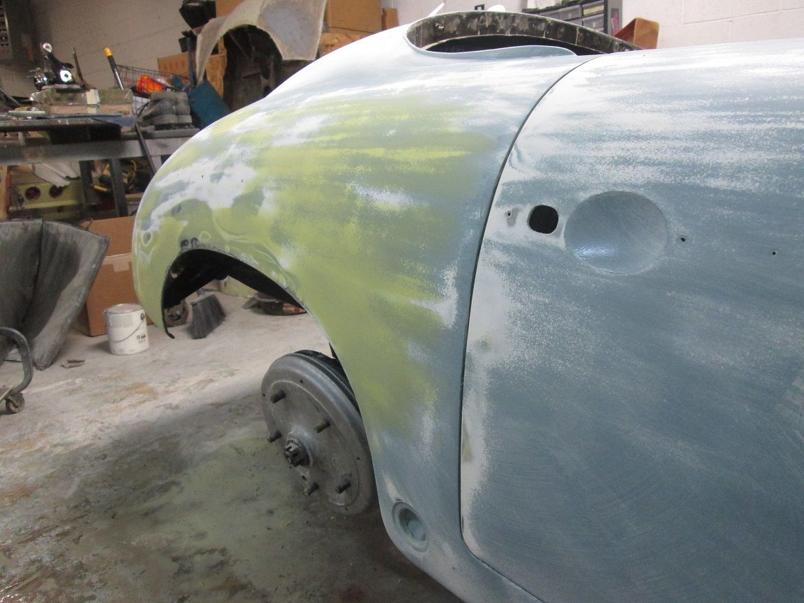

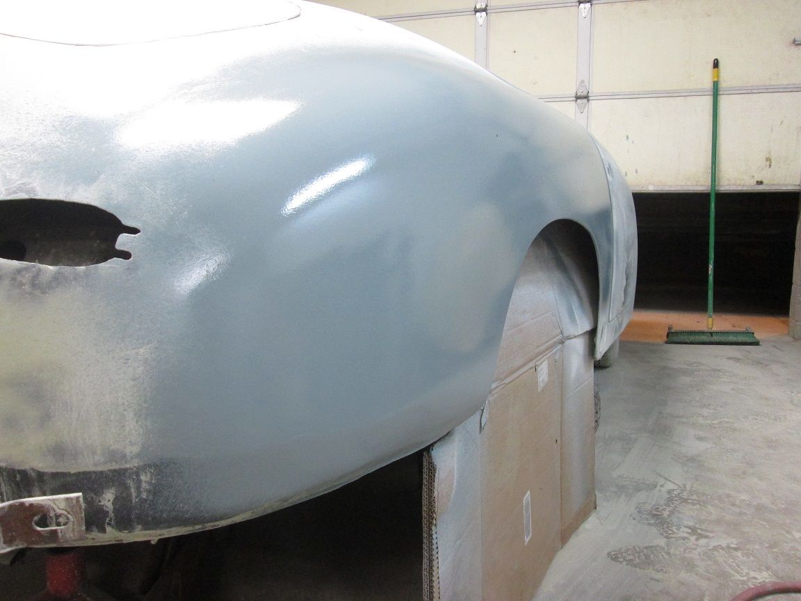

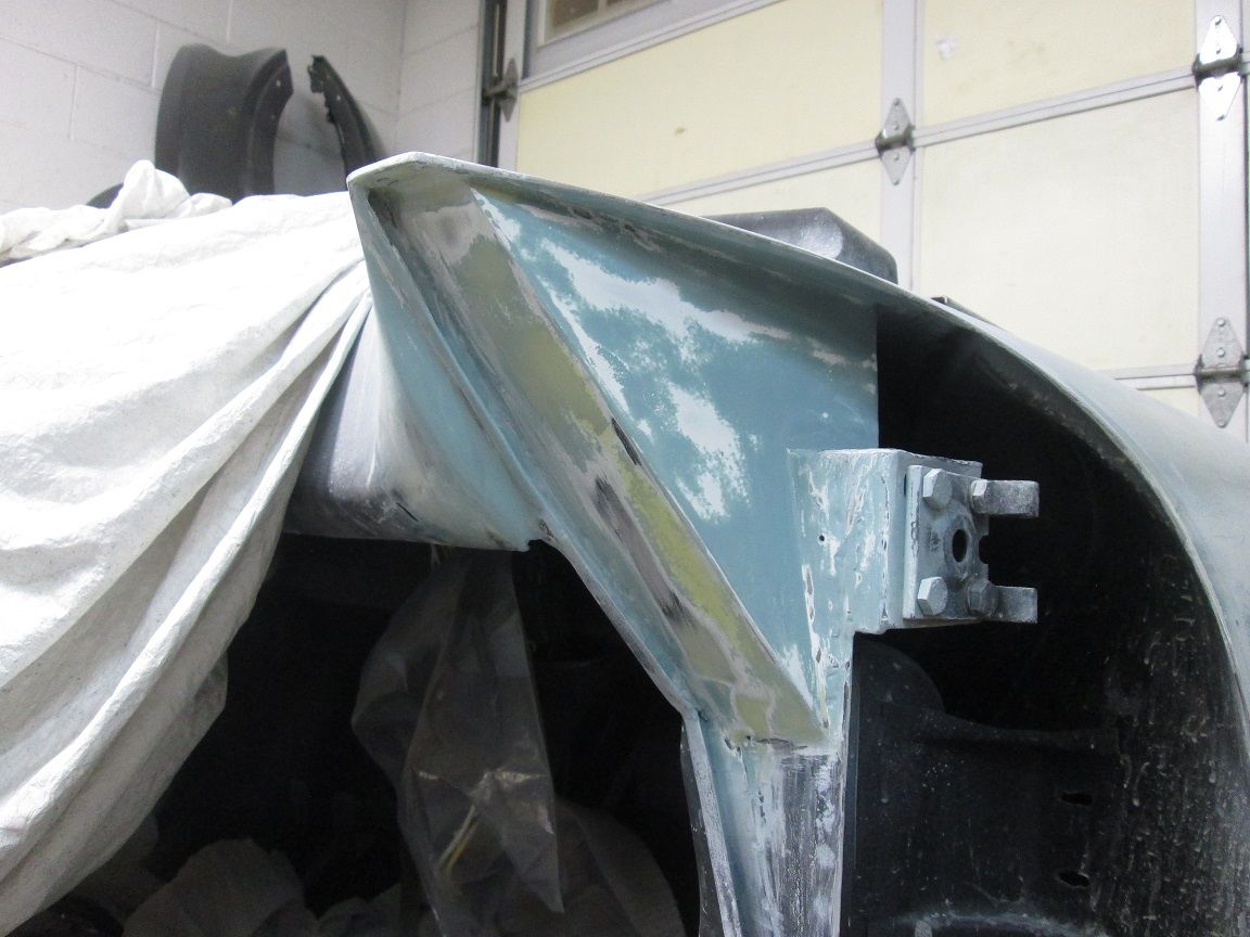

      • Right quarter panel profile and wheel arch.

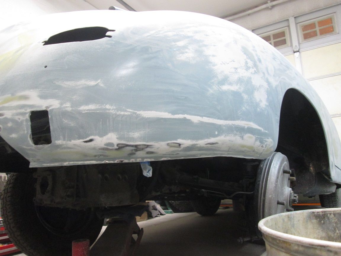

        Click image for larger version  Name:	IMG_6061.JPG Views:	0 Size:	122.1 KB ID:	109416 Working the wired edge up to both thin the filler and to create a reflection that will travel clean off the edge of the lip without bevel or tapered like profile shape around the opening.

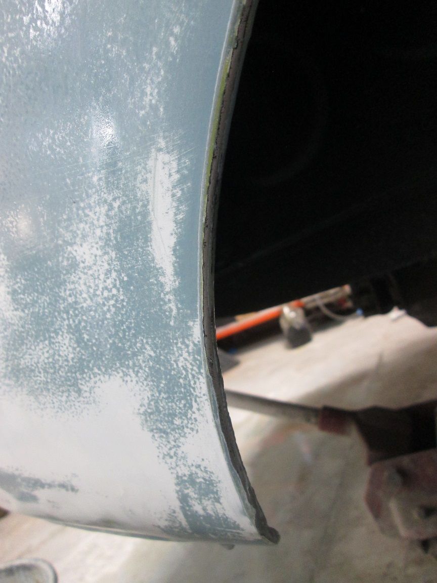

        Click image for larger version  Name:	IMG_6062.JPG Views:	0 Size:	118.4 KB ID:	109417 Also dealing with old accident damage in through here so the overall contour shape at the wheel opening had to be worked all the way up through the crown to get the set shape I needed.

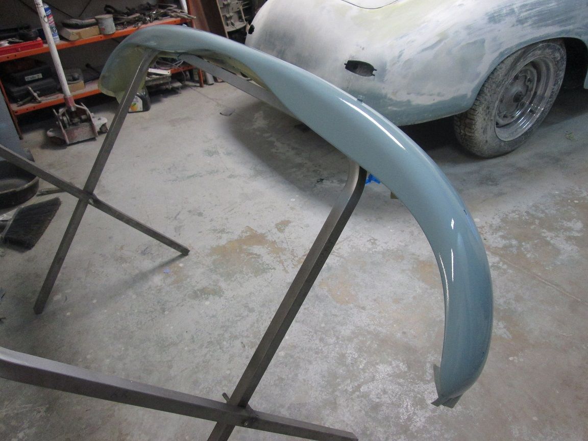

        Click image for larger version  Name:	IMG_6063.JPG Views:	0 Size:	153.6 KB ID:	109418 Raised the areas successfully so it was now onto aggressive blocking to both thin and shape the filler.

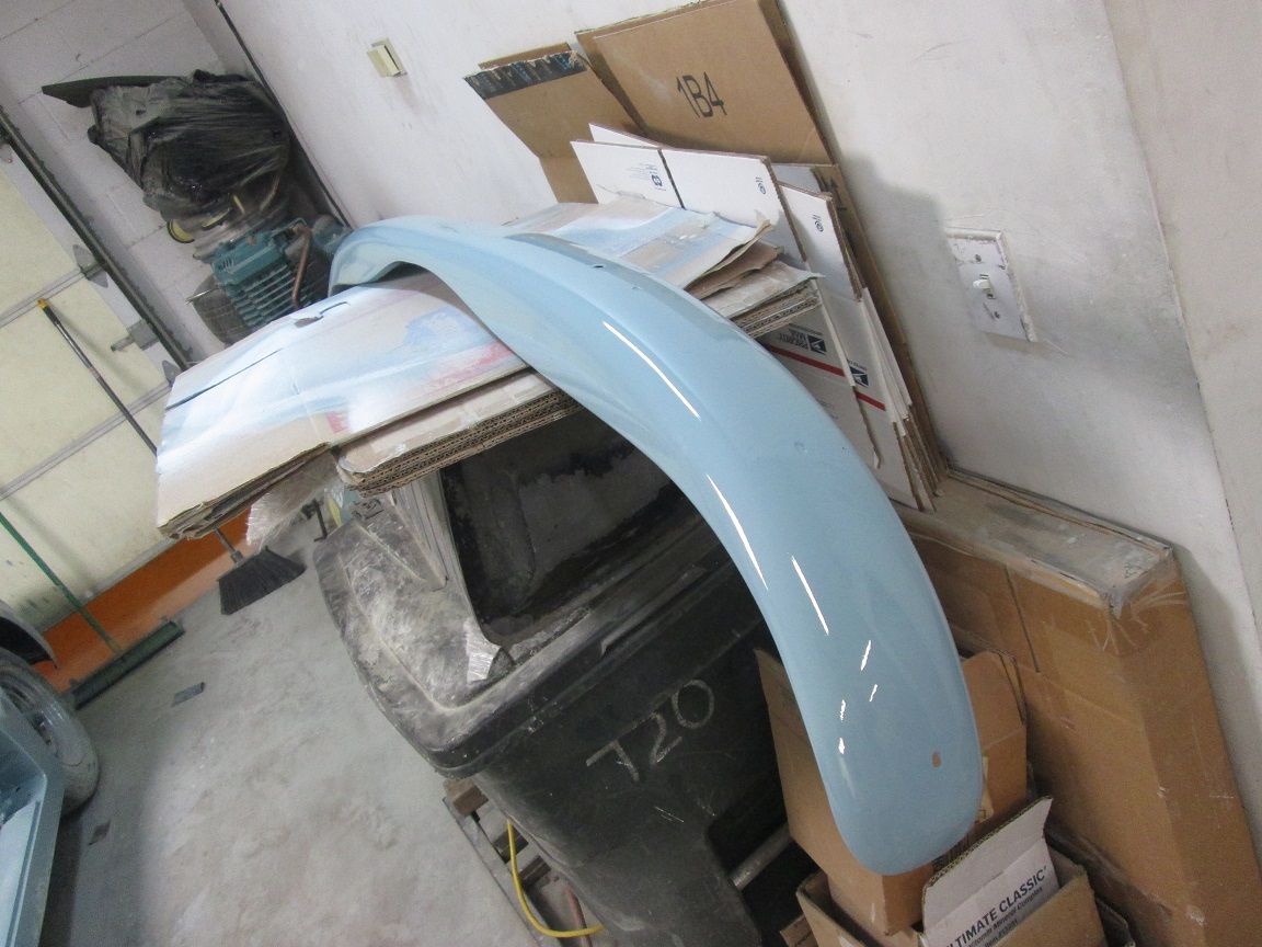

        Click image for larger version  Name:	IMG_6066.JPG Views:	0 Size:	138.1 KB ID:	109419 Added in thin swatches of filler to the forward section to eliminate some slight rollers that were bending the reflection as it traveled across.

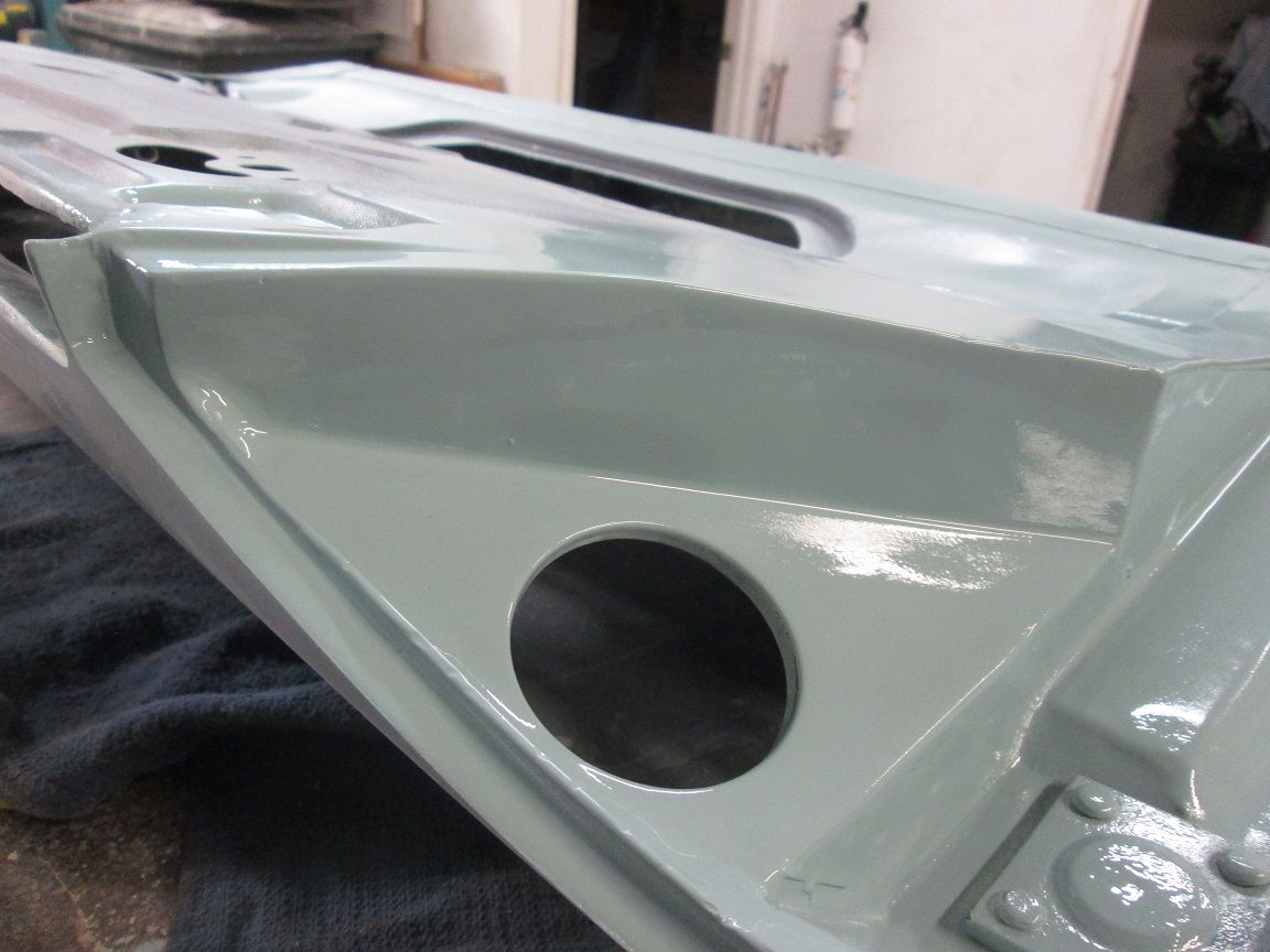

        Click image for larger version  Name:	IMG_6091.JPG Views:	0 Size:	103.7 KB ID:	109420 Another sealer and work coat round. Getting happier with the shape and contour of the wheel opening. The wired edge is thin and not caked in putty and the reflection is rolling right off the edges . Moving lower to address the valance, pleat detail etc.

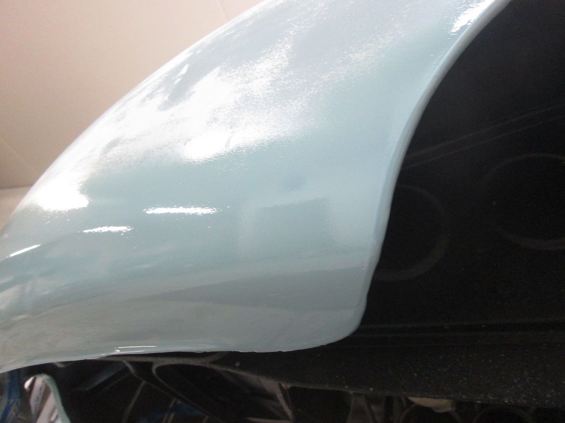

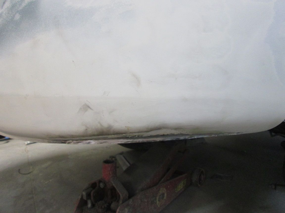

ID:	109435 Block sanding resumed. The edged lip on this side was too thin. I tried to fade it in during an earlier repair but I just couldn't leave it once I saw it in paint.

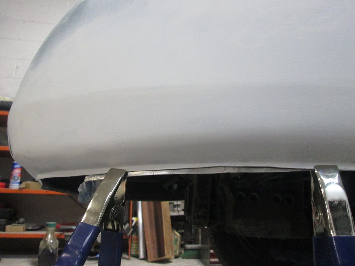

          • Click image for larger version  Name:	IMG_6135.JPG Views:	0 Size:	76.1 KB ID:	109438Filler strip added and weld dressed.
            Click image for larger version  Name:	IMG_6136.JPG Views:	0 Size:	78.5 KB ID:	109439 Excess ground and filed away.
            Click image for larger version  Name:	IMG_6153.JPG Views:	0 Size:	108.1 KB ID:	109440 Much better and now matches the left side profile shape.

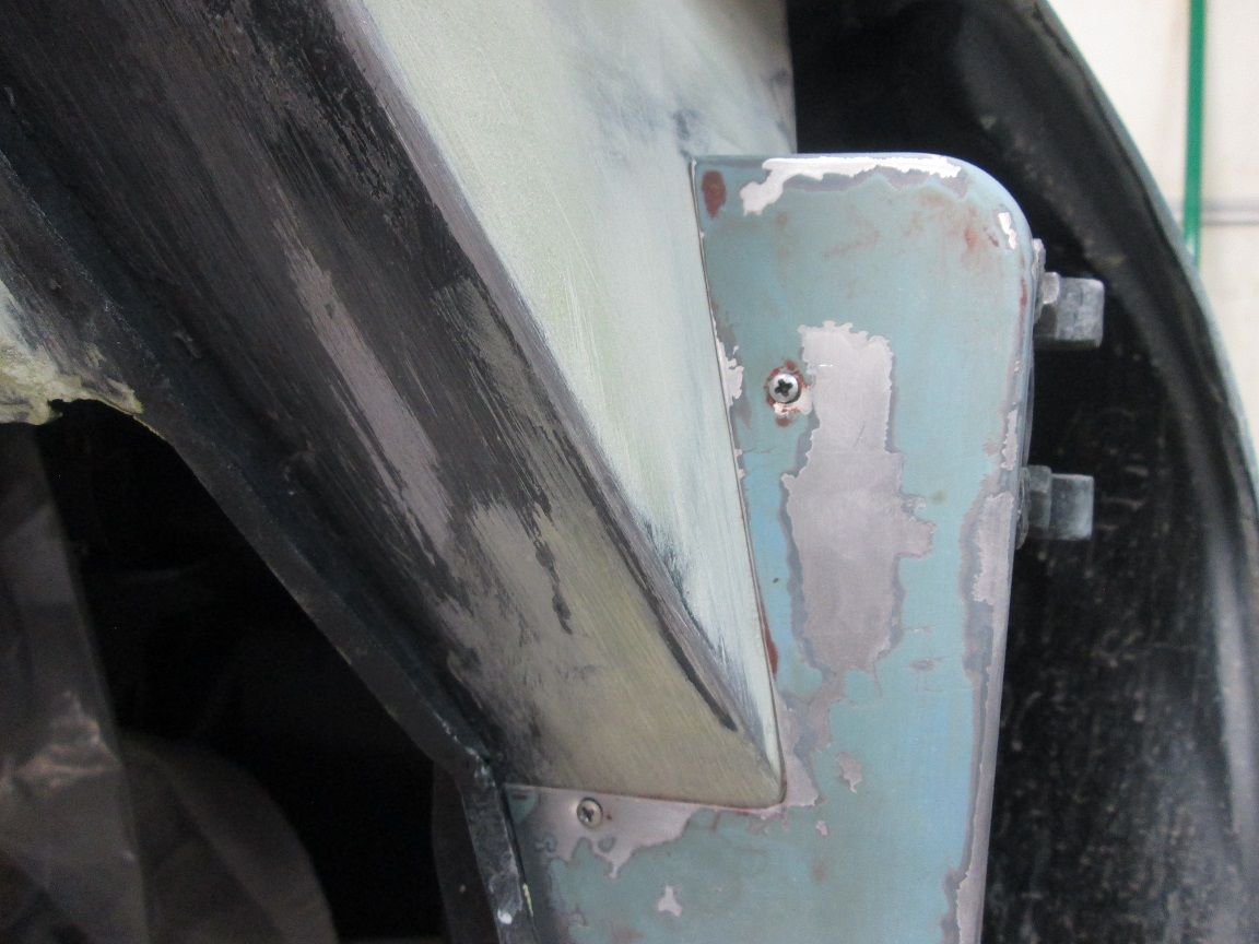

            Click image for larger version  Name:	IMG_6164.JPG Views:	0 Size:	141.5 KB ID:	109464test fitting the original hinge cover plate.
            Click image for larger version  Name:	IMG_6174.JPG Views:	0 Size:	111.4 KB ID:	109465 This area has been releaded so the holes didn't quite align, with the bottom third hole in these upper two were really crowded out. Will have to file the surface to allow the plate to slide into alignment all the while shaping it for a nice tight fit with the edges of the plate. All the issues you don't want to discover after its all painted.
            Click image for larger version  Name:	IMG_6165.JPG Views:	0 Size:	112.7 KB ID:	109466 Discovered this loose flap under the mount edge. Hoping it wasn't overlooked rust.
            Click image for larger version  Name:	IMG_6169.JPG Views:	0 Size:	103.0 KB ID:	109467 Just some solder that didn't take. Nice to catch a break every so often...

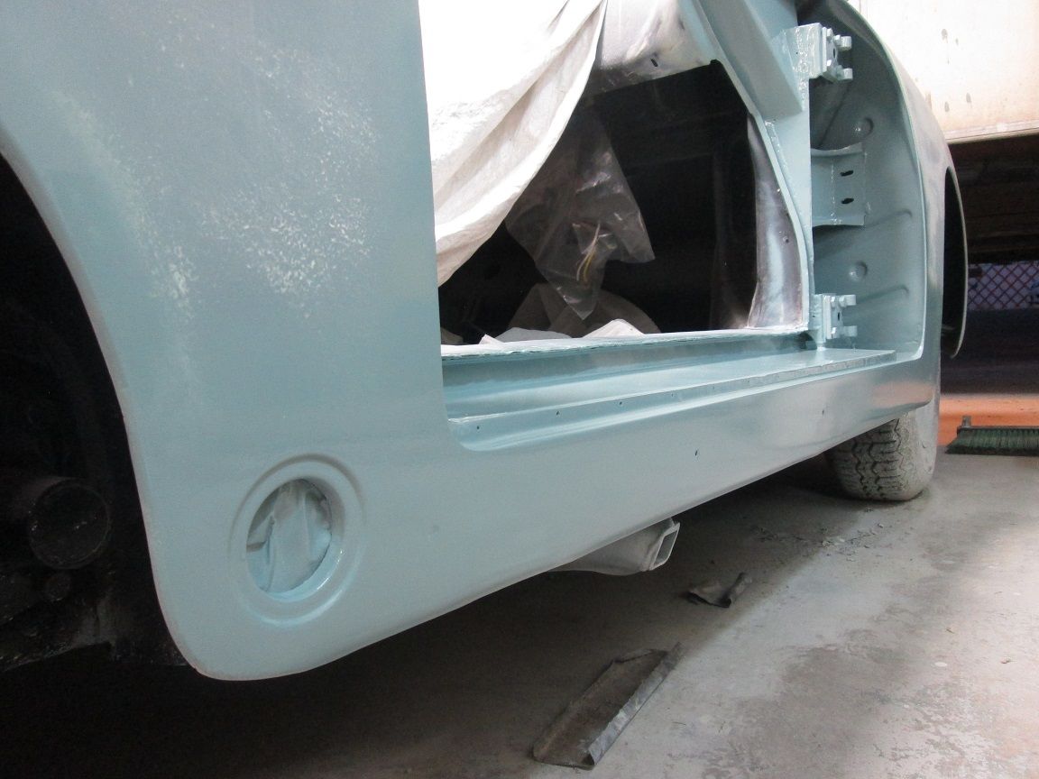

              • Jamb finishing continued:
                Click image for larger version  Name:	IMG_6179.JPG Views:	0 Size:	167.9 KB ID:	109493 Blocking out the door frame relief shapes.
                Click image for larger version  Name:	IMG_6182.JPG Views:	0 Size:	113.4 KB ID:	109494 A pillar skim coated and blocked to final shape.
                Click image for larger version  Name:	IMG_6181.JPG Views:	0 Size:	115.0 KB ID:	109495 Tight uniform fit around the hinge cover.
                Click image for larger version  Name:	IMG_6186.JPG Views:	0 Size:	142.8 KB ID:	109496
                Fine detail finishing on the lock post shapes.
                Click image for larger version  Name:	IMG_6201.JPG Views:	0 Size:	106.0 KB ID:	109497
                Then began shaping the edges of the rocker panel and block sanding the general surface. Rotated work between all these different areas as putty was applied to keep it moving. Lots going on all at once.

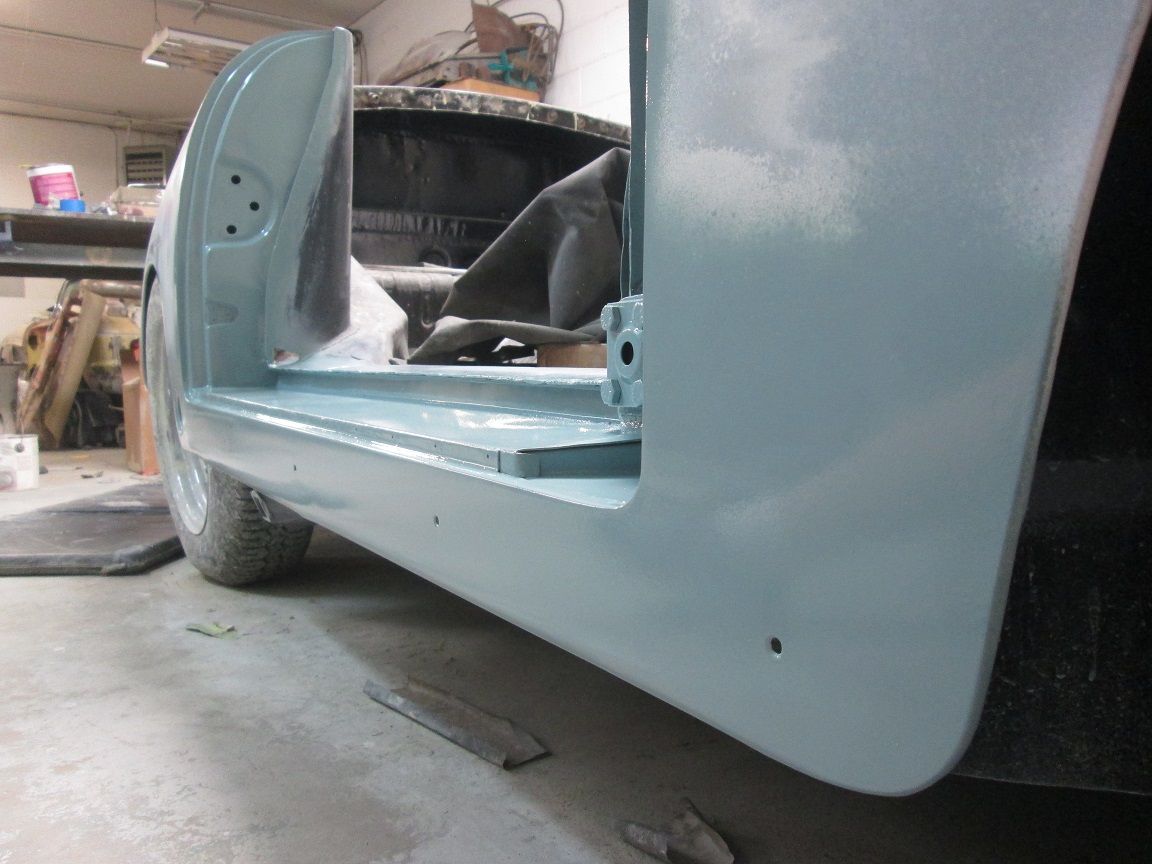

                • Finishing out right door jamb work .
ID:	109554 One last pass of putty to get the remaining divots and blemishes out after an initial test coat and block sand.
ID:	109555 Same deal for the striker post. Just when you think your done you find those last few nicks or divots in the surface after a test coat.
ID:	109556 Then it was onto smoothing out the door side of things.
ID:	109557 Then the forward areas. Extra care taken with all the surfaces that can be clearly seen when the door is opened.
ID:	109558 Another round of sealer and paint. I could obsess more but I think I am all but done except for a final finish sanding pass.

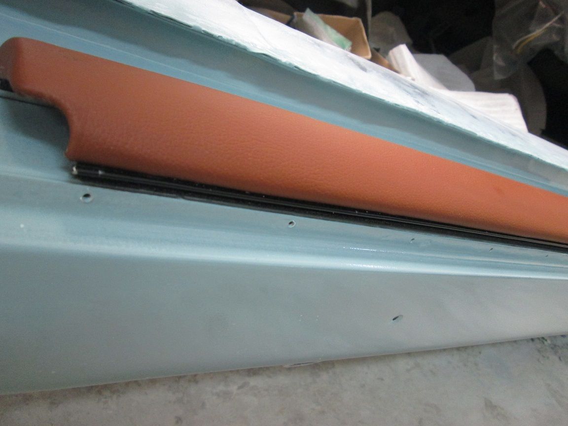

ID:	109563 test coating the rocker and its edges.
ID:	109564Have a few small areas to address but it won't take much.

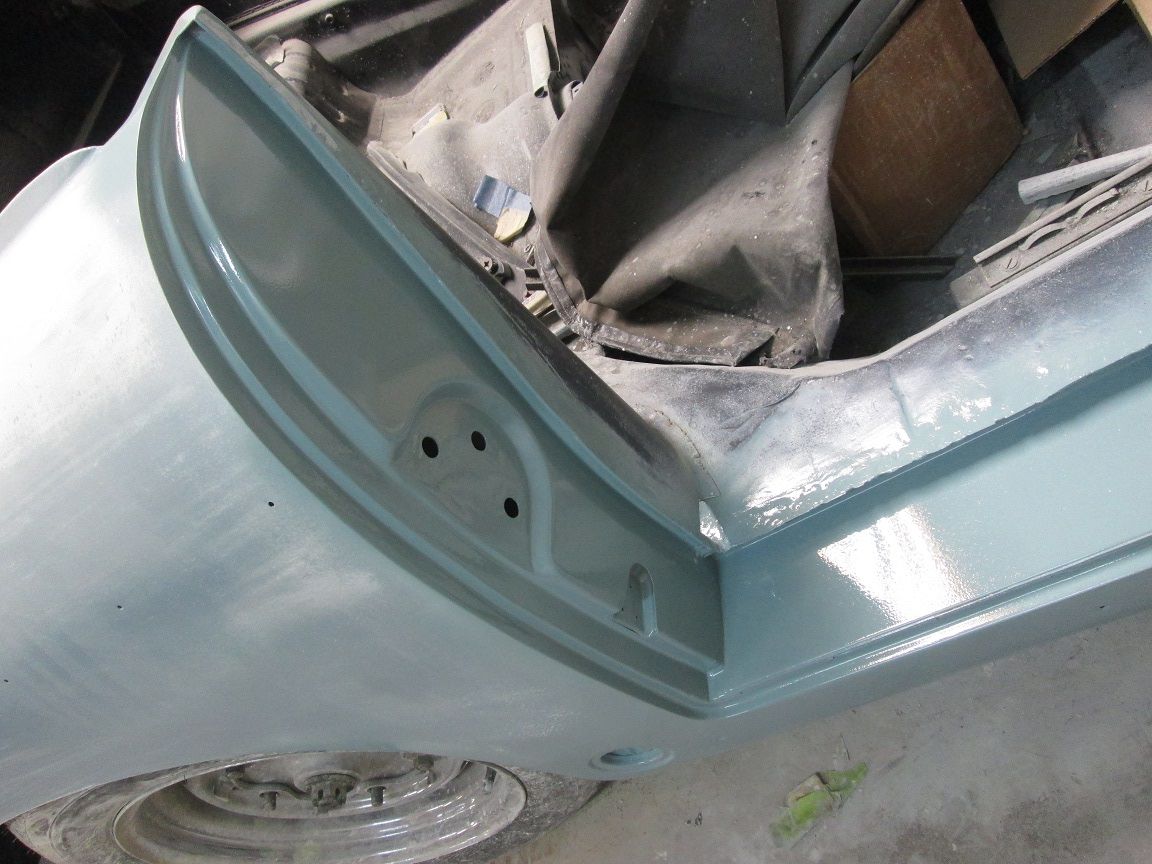

                      Click image for larger version  Name:	IMG_6219.JPG Views:	0 Size:	145.1 KB ID:	109571Needed to change gears so I decided to get the front bumper in final paint. Mounted on my stand here to shoot the inside first.

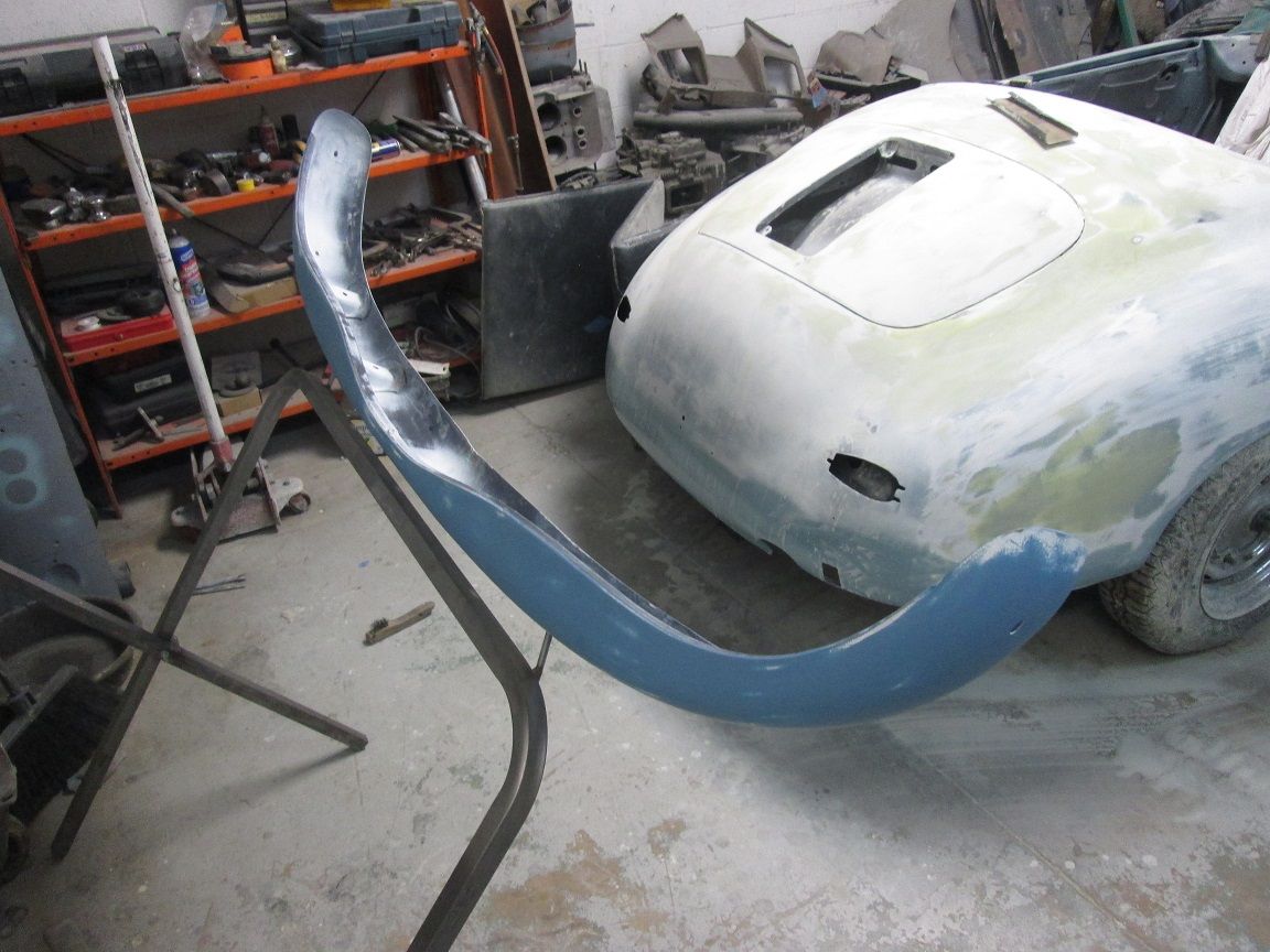

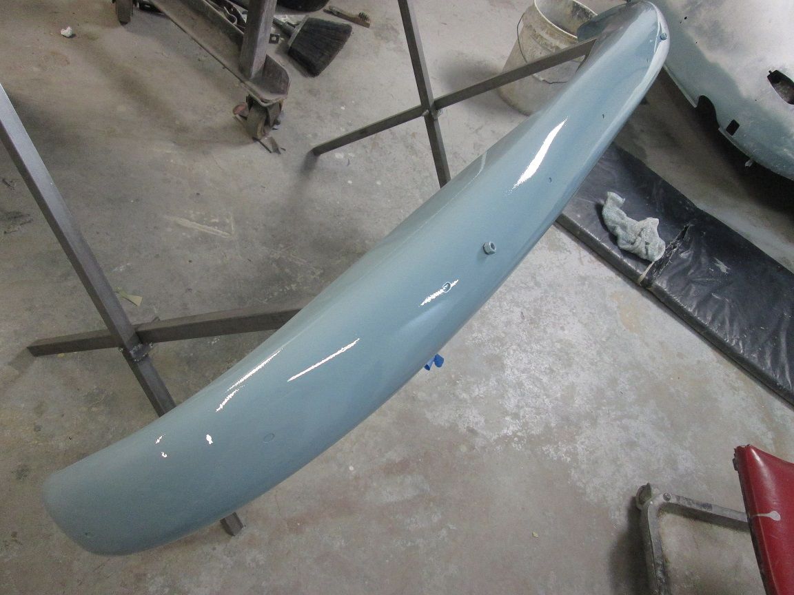

                      • Front bumper in final finish:

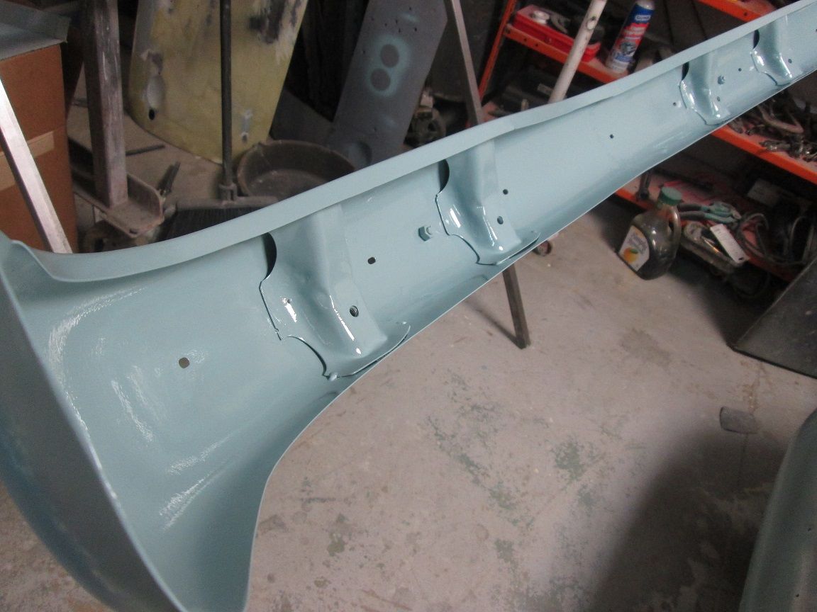

                        Click image for larger version  Name:	IMG_6226.JPG Views:	0 Size:	155.0 KB ID:	109573 Final block sand to the outer skin to both smooth and scuff any shiny surfaces.
                        Click image for larger version  Name:	IMG_6227.JPG Views:	0 Size:	138.3 KB ID:	109574 Inner surface back masked and in process of applying the final color coats.
                        Click image for larger version  Name:	IMG_6228.JPG Views:	0 Size:	131.6 KB ID:	109575 I'll be renting a spray booth to shoot the body but small parts like this I can handle here. I'll be stressed enough ensuring it all goes right the day the body is shot and having not to deal with small peripheral parts like this will make that session slightly less frantic.

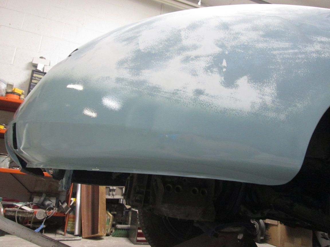

                        Click image for larger version  Name:	IMG_6229.JPG Views:	0 Size:	101.0 KB ID:	109576 So far so good. My buddy wants a final finish with some orange peel, not a glass finish so I don't have the luxury of color sanding out dry spots, runs, excessive lint and the like so the final application has to be pretty good right from the start.
                        Click image for larger version  Name:	IMG_6267.JPG Views:	0 Size:	131.3 KB ID:	109577 Front bumper complete. Nice to have something in the done column but finished parts are always a magnet for damage after the fact so I've got to stash this away safely while I finish the rest of the car out. Onto the next deal.
