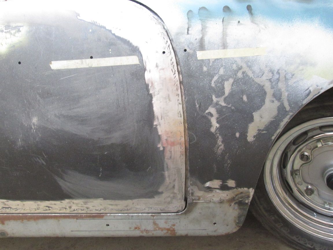

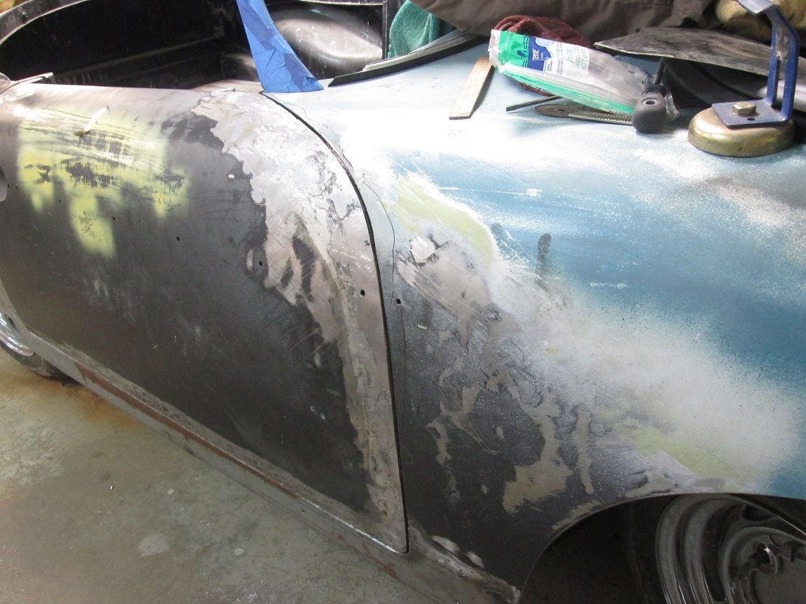

    • Click image for larger version  Name:	IMG_4809.JPG Views:	0 Size:	124.6 KB ID:	107845 Gas welded seams on the underside completed things up here.
      Click image for larger version  Name:	IMG_4817.JPG Views:	0 Size:	183.8 KB ID:	107846 Offically done with the door bottom now onto the rest of the issues with this frame.
      Click image for larger version  Name:	IMG_4731.JPG Views:	0 Size:	139.7 KB ID:	107847 Upper corner had this ratty patch hidden under a chunk of solder.
      Click image for larger version  Name:	IMG_4732.JPG Views:	0 Size:	130.4 KB ID:	107848 The give away was the weld joint hanging out in space which warped into the cavity below giving a really swollen appearance with the lead applied.
      Click image for larger version  Name:	IMG_4820.JPG Views:	0 Size:	135.8 KB ID:	107849 Plan was to move the weld joint lower where its tight and supported by the inner panel. Seemed straight forward enough..

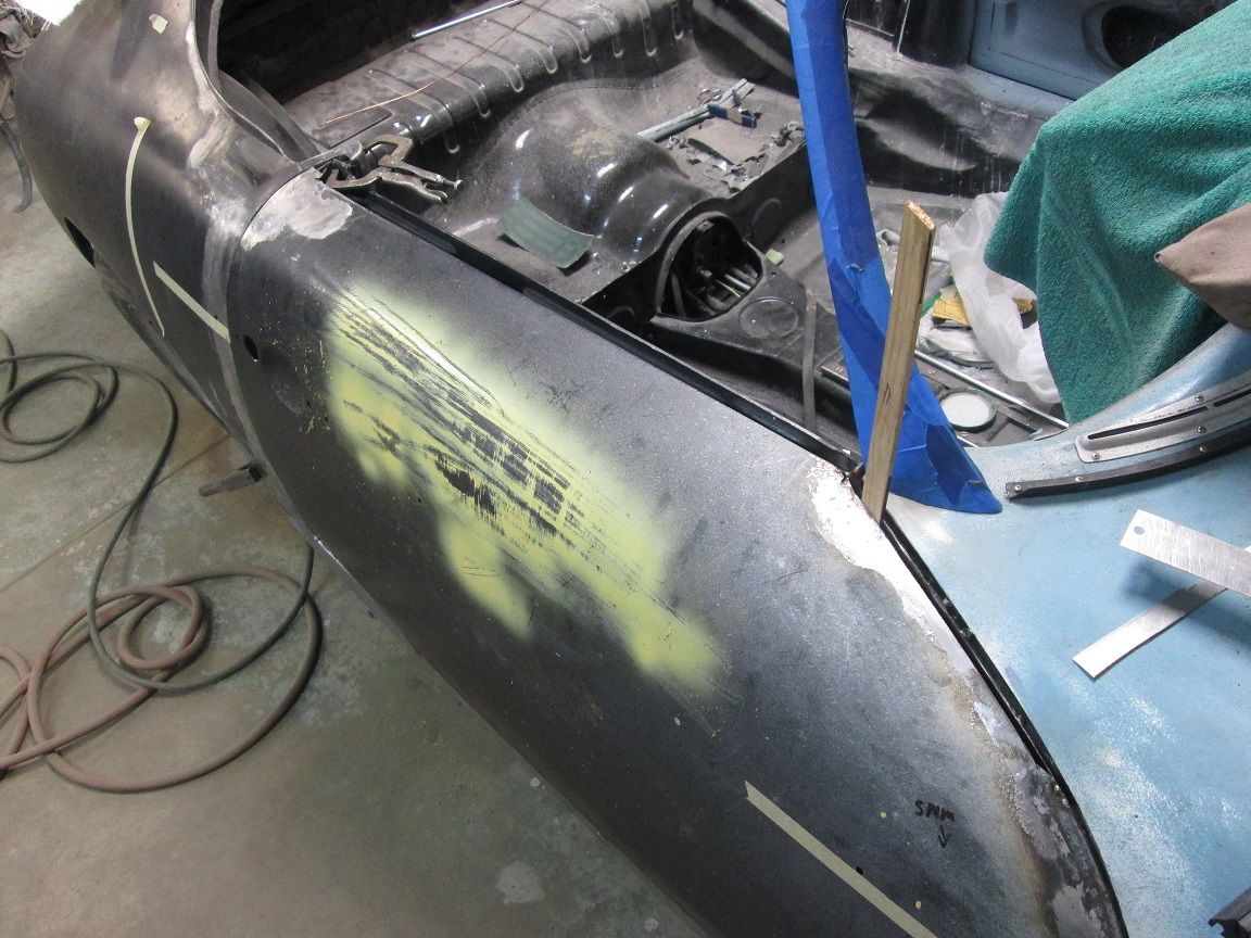

        ...but no. The other door showed this stepped relief feature in this area that the other shop missed or just didn't want to replicate. As always I thank god for factory referrence parts.
ID:	107852 Eventually got that feature hammered in and copied.

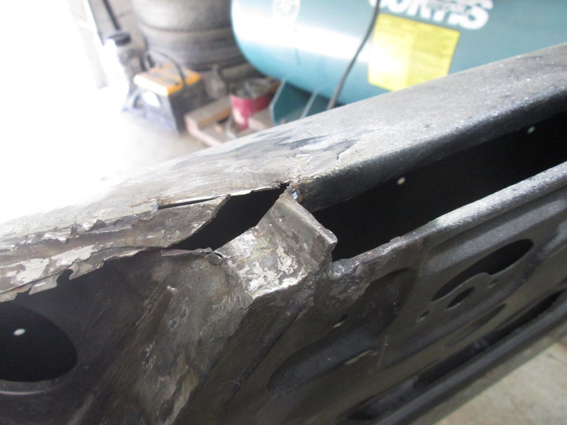

ID:	107855 While I was in this area some overlooked fatigue cracks where also welded up. Onto the rear upper corner next.

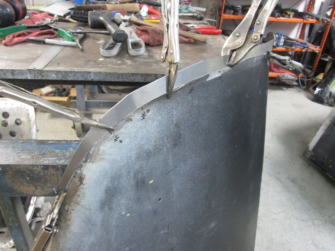

        • Click image for larger version  Name:	IMG_4831.JPG Views:	0 Size:	132.6 KB ID:	107861 Upper corner flange area is a bit rough and mishapen so most of the lip will be trimmed out and built to suit. The bare door structure twists and flexes with ease so those vicejaws where needed to draw the door in tight to simulate the preload that will be needed once the skin is back on.
          Click image for larger version  Name:	IMG_4844.JPG Views:	0 Size:	115.1 KB ID:	107862 Area straightened with flange trimmed but I've gone as far as I can until I get this skin closer to installation time. Onto the skin preparation.
          Click image for larger version  Name:	IMG_4834.JPG Views:	0 Size:	185.4 KB ID:	107863 Leading flange cut free for repositioning and backfilling.
          Click image for larger version  Name:	IMG_4835.JPG Views:	0 Size:	125.1 KB ID:	107864 Flange is now mocked up on the doorframe to establish a "new" raw gap that will require a more reasonable amount of solder in the end.
          Click image for larger version  Name:	IMG_4837.JPG Views:	0 Size:	168.3 KB ID:	107865
          With an approximate 4mm gap at the edge of the fender I'll need a filler strip of steel about this wide.

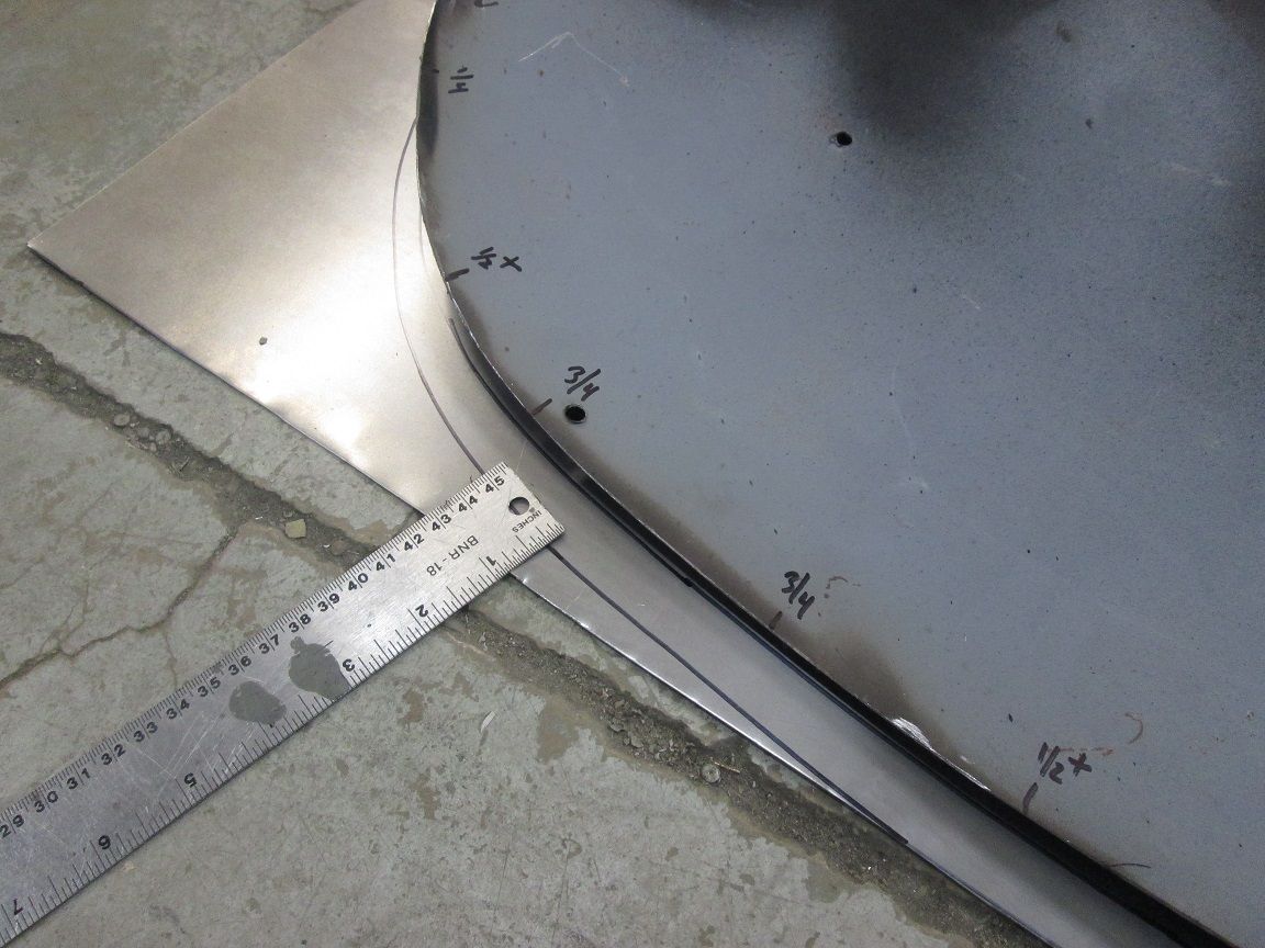

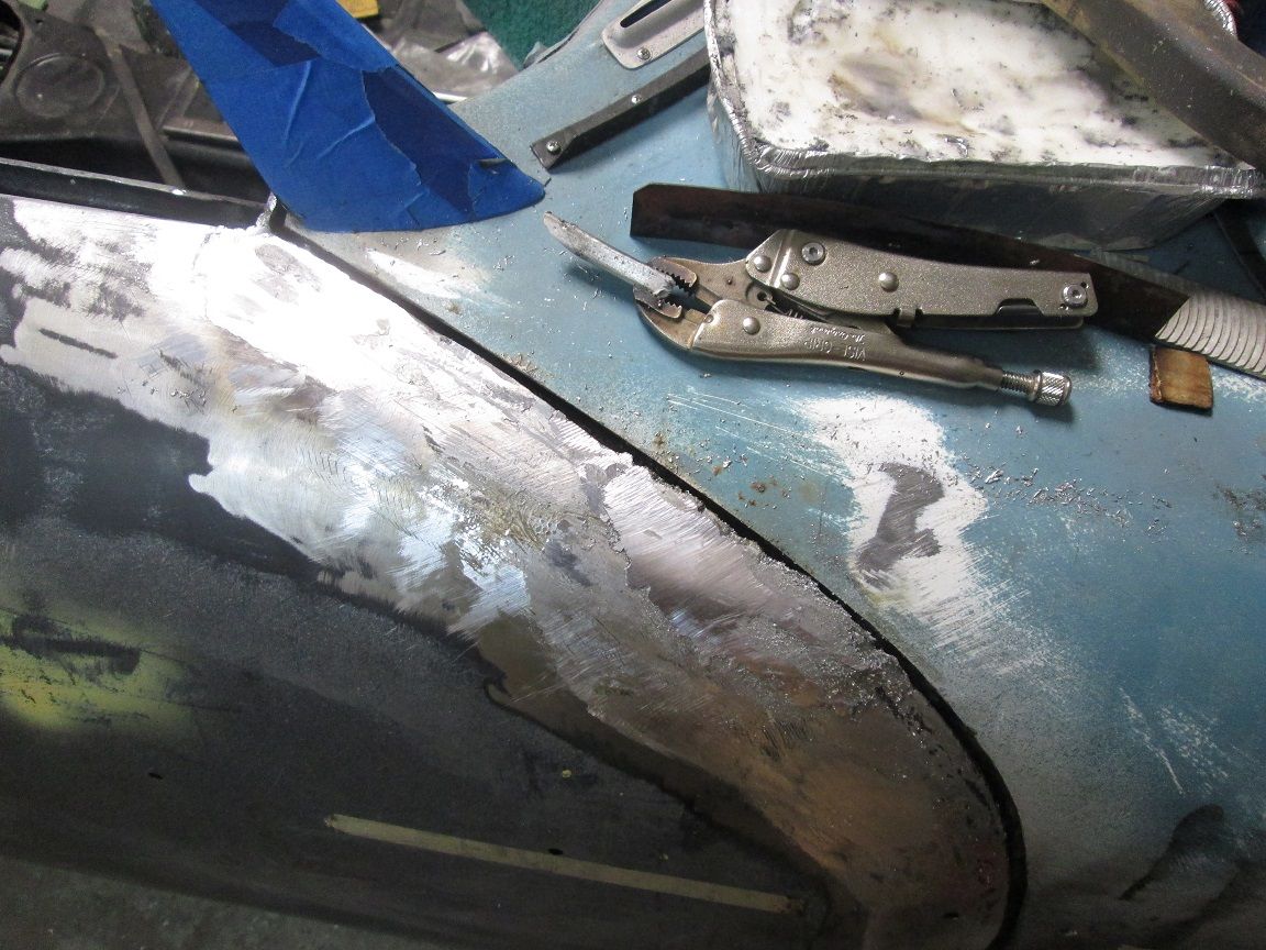

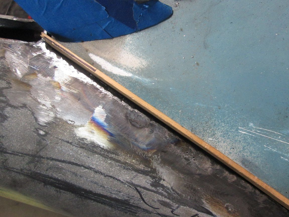

            • Forward leading edge:
              Click image for larger version  Name:	IMG_4840.JPG Views:	0 Size:	103.6 KB ID:	107873
              With the flange reset for a 4mm gap with the edge of the fender there is some excess that needs trimming back to even with the edge of the frame which incudes where the previous spot welds where . Who ever supplied this skin just rolled this flange in a half-inch too soon.
              Click image for larger version  Name:	IMG_4845.JPG Views:	0 Size:	176.2 KB ID:	107874 Flange trimmed back and now onto width determination for the filler strip.
              Click image for larger version  Name:	IMG_4846.JPG Views:	0 Size:	142.3 KB ID:	107875 Just about mapped out here.
              Click image for larger version  Name:	IMG_4848.JPG Views:	0 Size:	166.4 KB ID:	107876 Trimming for a final fit here.
              Click image for larger version  Name:	IMG_4849.JPG Views:	0 Size:	172.4 KB ID:	107877 Tack welded on.

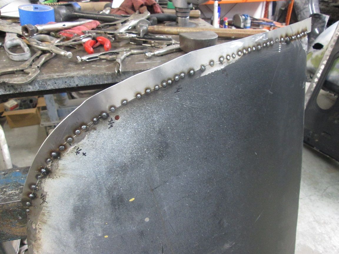

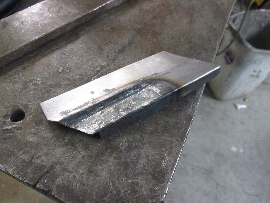

              • Door skin prep continued:
ID:	107879 Stitching the filler strip in a section at a time using my welding table to help hold down the warpage.
ID:	107880 Now onto joining it with the old flange. Tacking it slowly and adjusting for height and gap with the car as it goes.
ID:	107881 Ran a little high in places and a low in others so it was series of fine adjustments and repeated test fits.

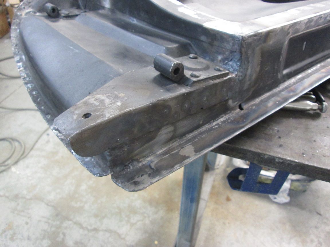

                • Adding new bottom flange section:
                  Click image for larger version  Name:	IMG_4877.JPG Views:	0 Size:	138.8 KB ID:	107885 Carefully establishing my cut line so the new leading edge winds up in the same spot.
                  Click image for larger version  Name:	IMG_4878.JPG Views:	0 Size:	135.8 KB ID:	107886 I had to hit this one right on the money otherwise I'd lose my bottom door gap, my sides spear hole alignment or both. The side spears really complicated things.
                  Click image for larger version  Name:	IMG_4879.JPG Views:	0 Size:	146.5 KB ID:	107887 Commitment time...
                  Click image for larger version  Name:	IMG_4880.JPG Views:	0 Size:	138.8 KB ID:	107888
                  Getting ready to stitch it together starting from the center outward.
                  Click image for larger version  Name:	IMG_4882.JPG Views:	0 Size:	163.8 KB ID:	107889 New bottom flange installed and just about ready to test fit it to the car.

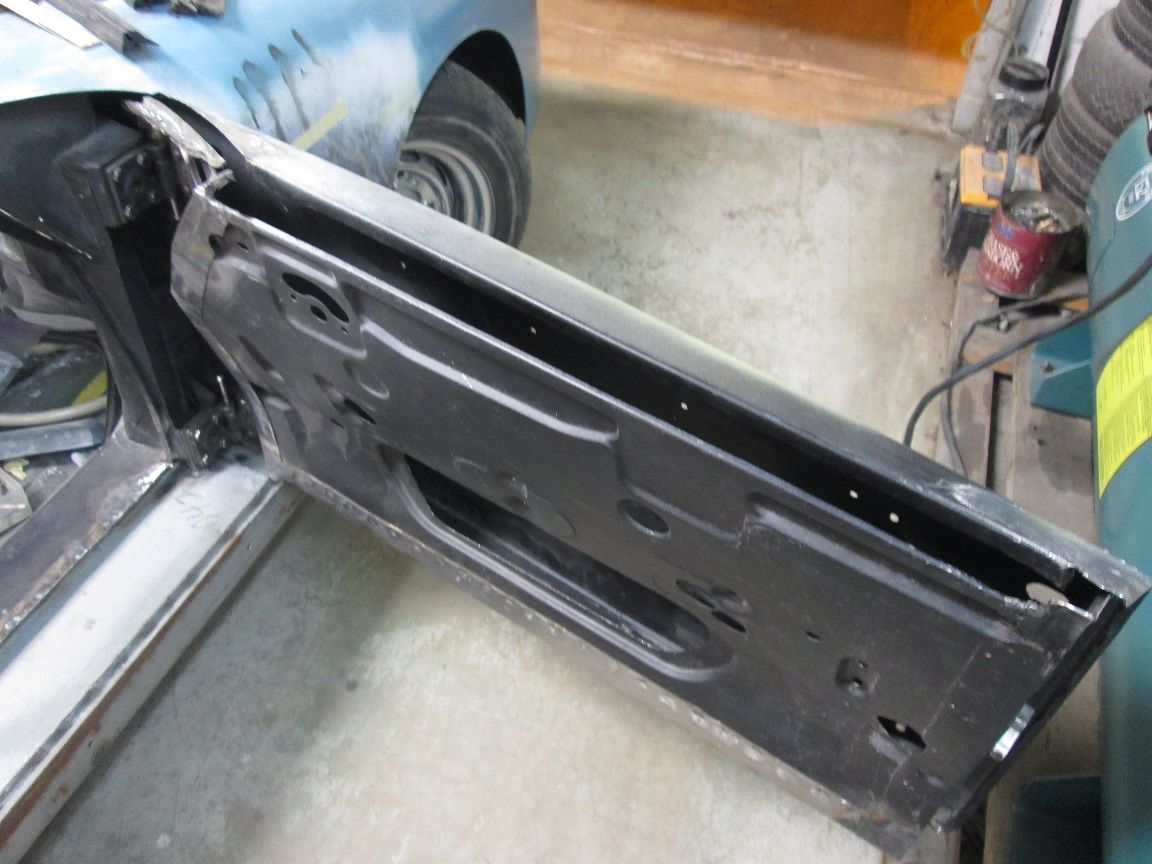

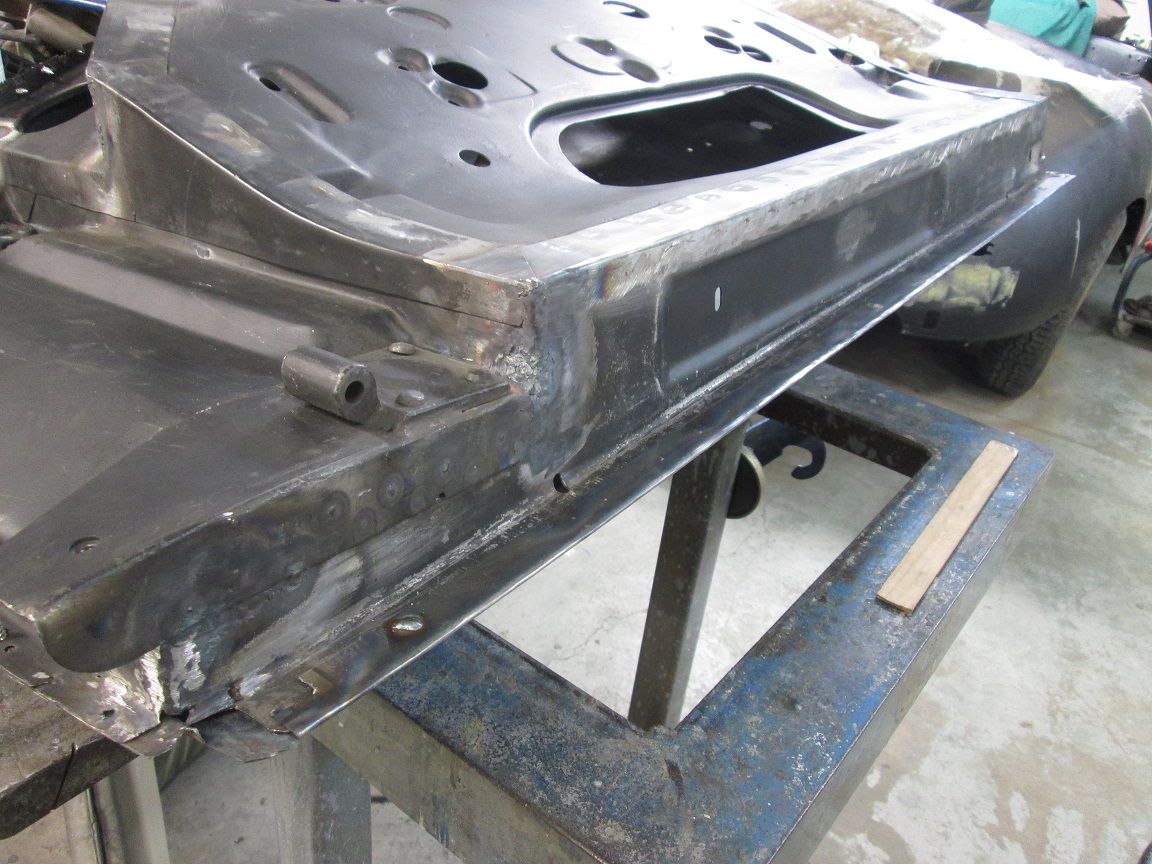

                  • Initial mock up with the skin's new flanges and final reassembly.
ID:	107891 Heeling the flange over a little tighter but not too tight so it will clear the rocker threshold. Time to slip the door frame back in and see how off it turned out.
ID:	107892 Much to my great relief my 3mm gap was preserved with only some mild irregularities.
ID:	107893 Most importantly the side spear holes are aligned while that bottom gap sits at 3mm's. Because this is all redo work the build sequence is out. The closing panel(door) should be built and set first then everything else added in around it. Building a closing panel to fit the opening of a body makes the challenge so much harder. I know first hand now.
ID:	107894 Preloading the door with clamps and set screws next to get just the right twist in it so that the upper and lower corners of the door even out with the body; or as close to it as I can requiring the least amount of solder in the end.

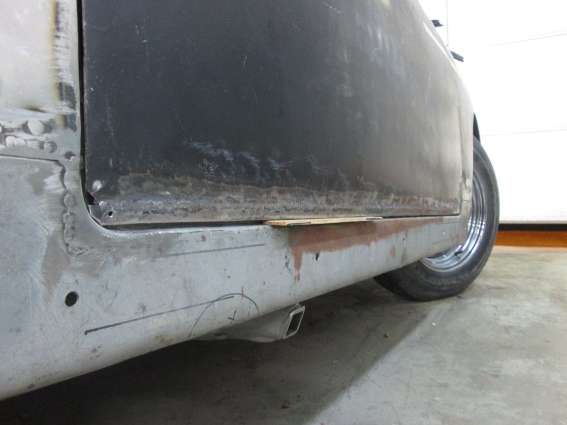

ID:	107895 Door frame preloaded in its best adjusted position and now locking in that tension with the skin. Slowly replacing set screws with plug welds.

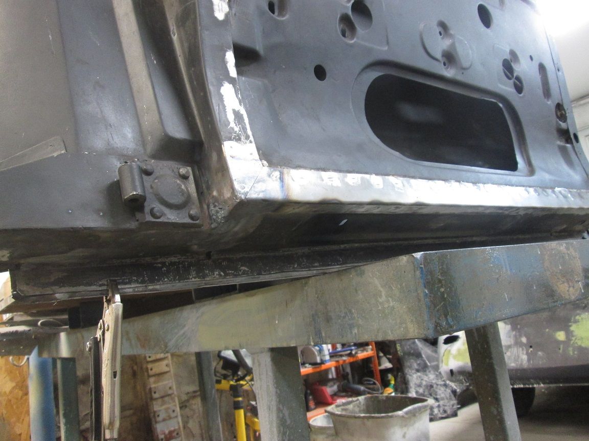

                    • Most of the welding completed on the right door now its onto the loose ends.
ID:	107897 90% of the leading edge of this skin is now finally all stitched up and dressed.

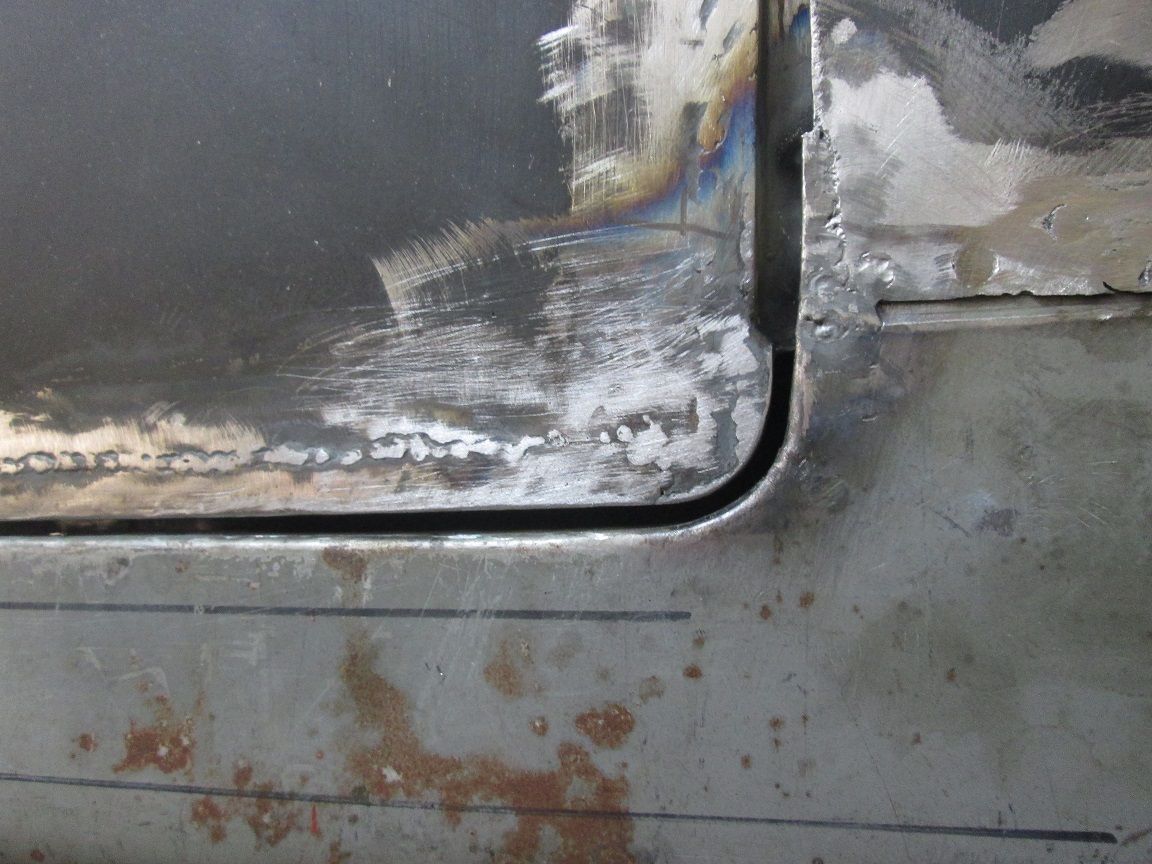

ID:	107898 test fitted to the car one more time to make sure the door held that tensioned shape I was after. So far so good...
ID:	107899 Good consistent match against the rocker.
ID:	107900 Now its onto tying up my loose ends at the corners.
ID:	107901 Beginning at the top.

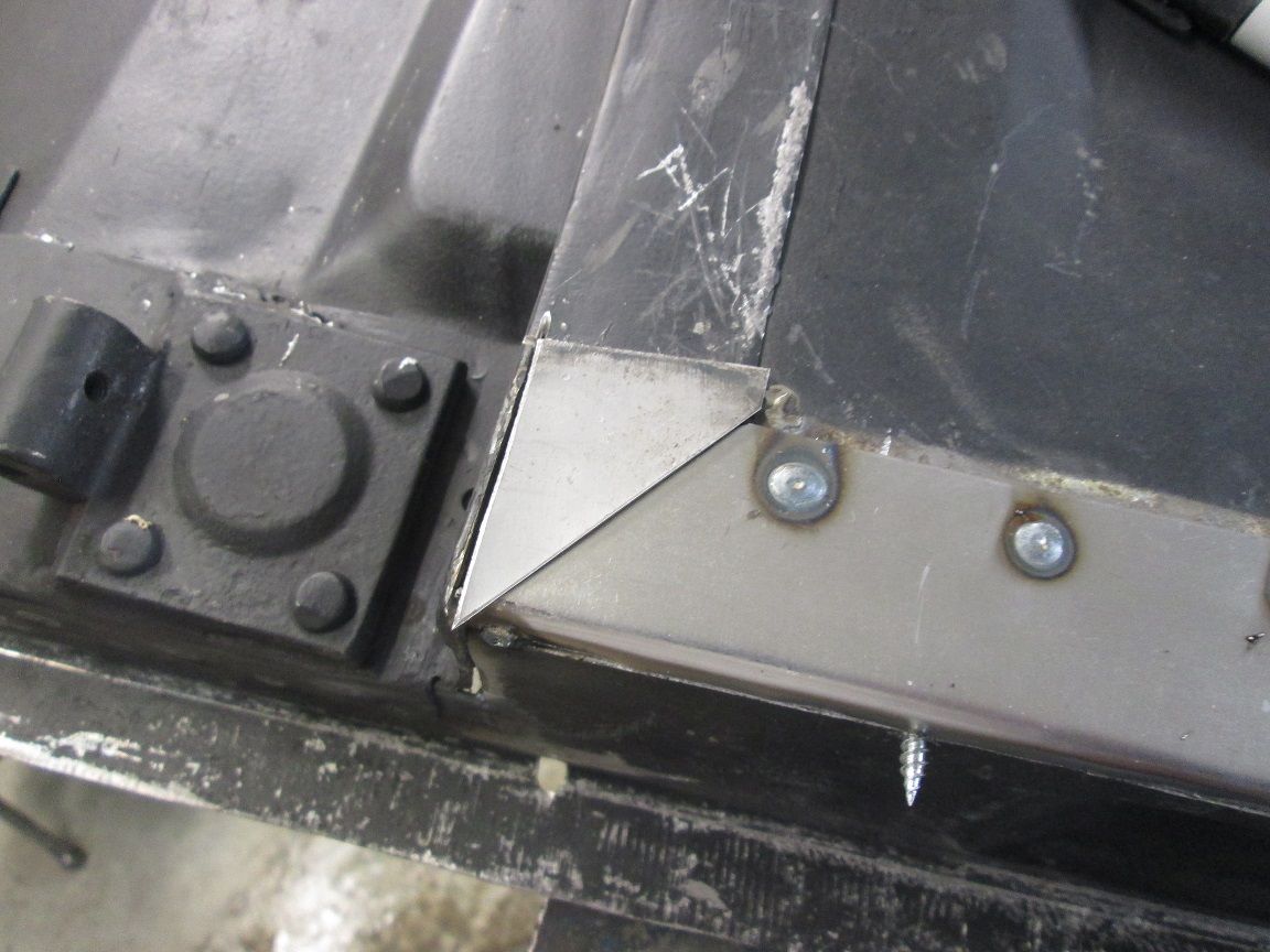

                        • Rear upper corner.

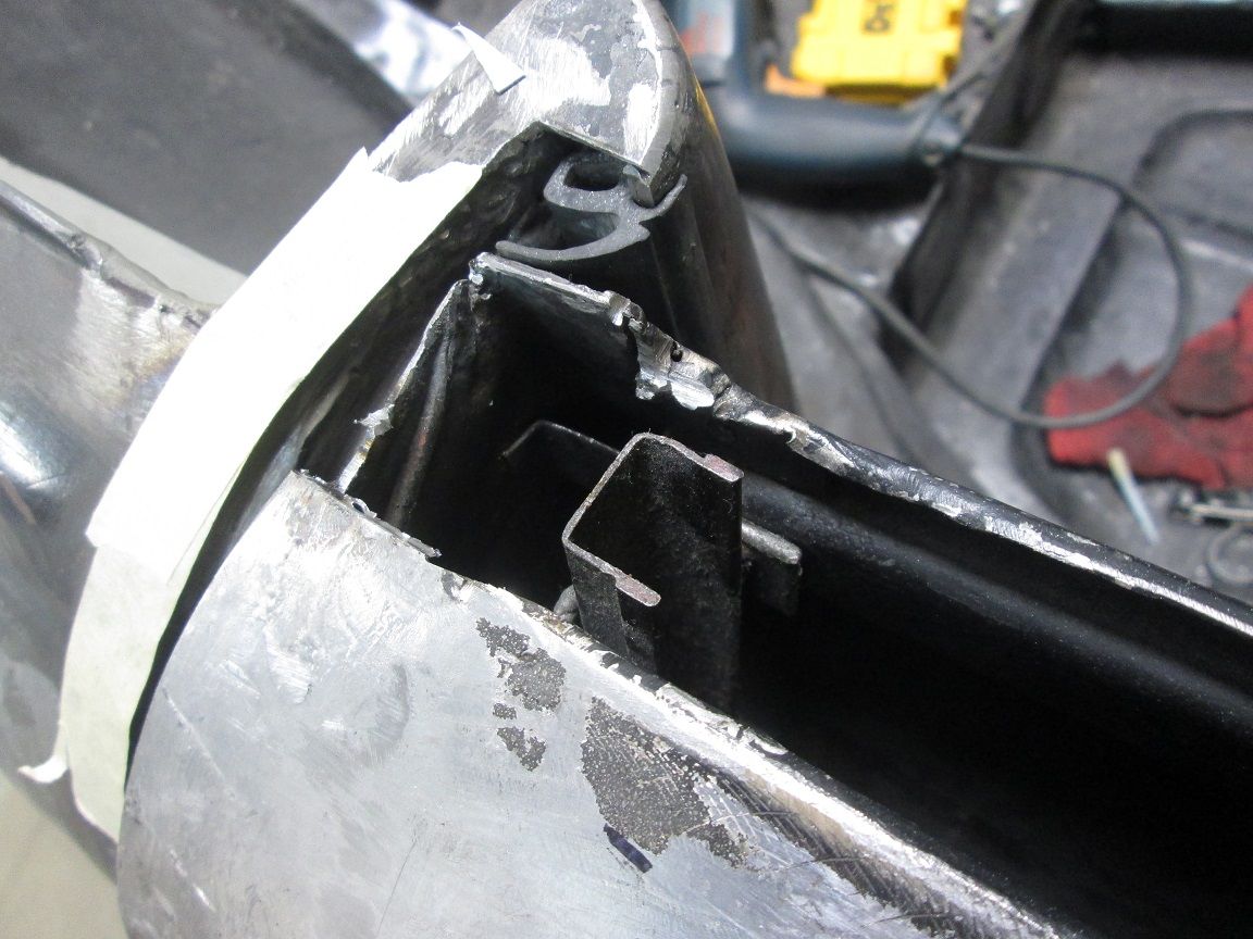

ID:	107909 Onto steel
ID:	107910 Before I could commit to anything I had to mock up the rear window channel to make sure the new opening shape was going to clear.
ID:	107911 Ran a small reinforcement to strengthen up this edged opening. The other side shows it double walled along this edge.

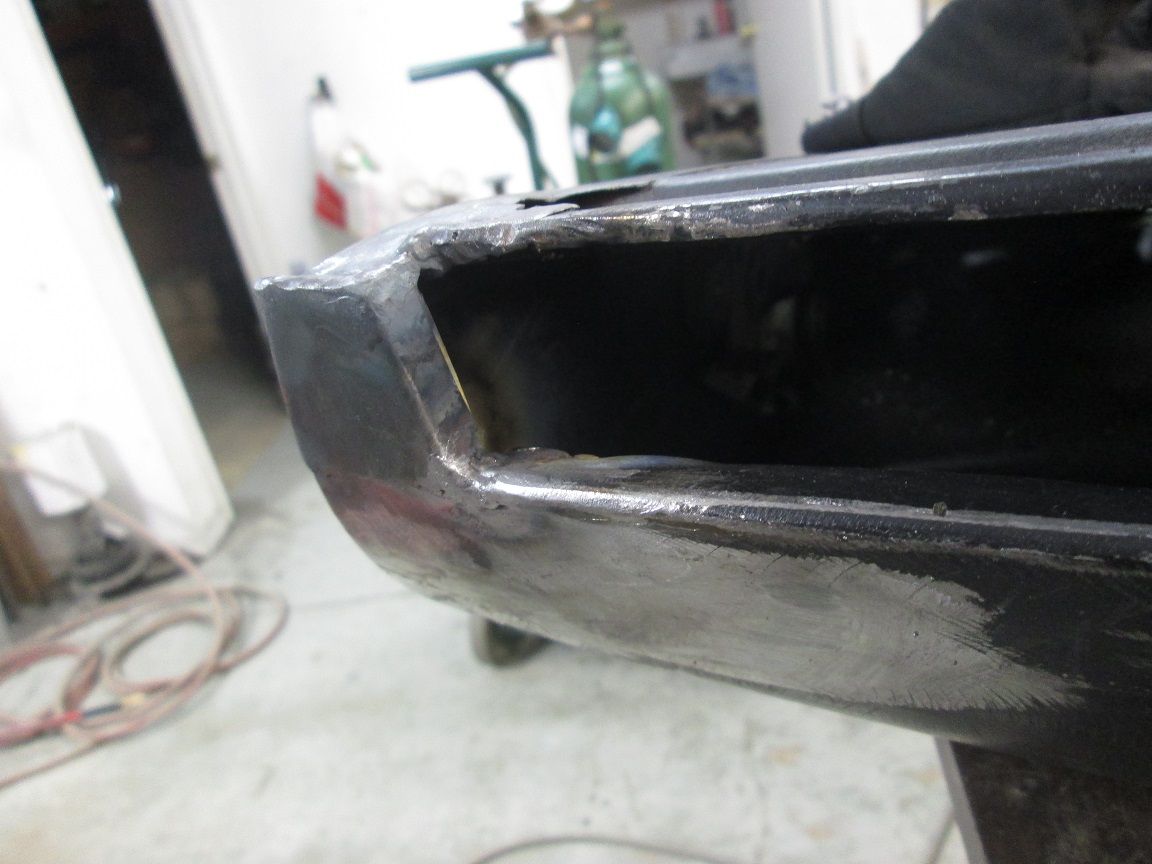

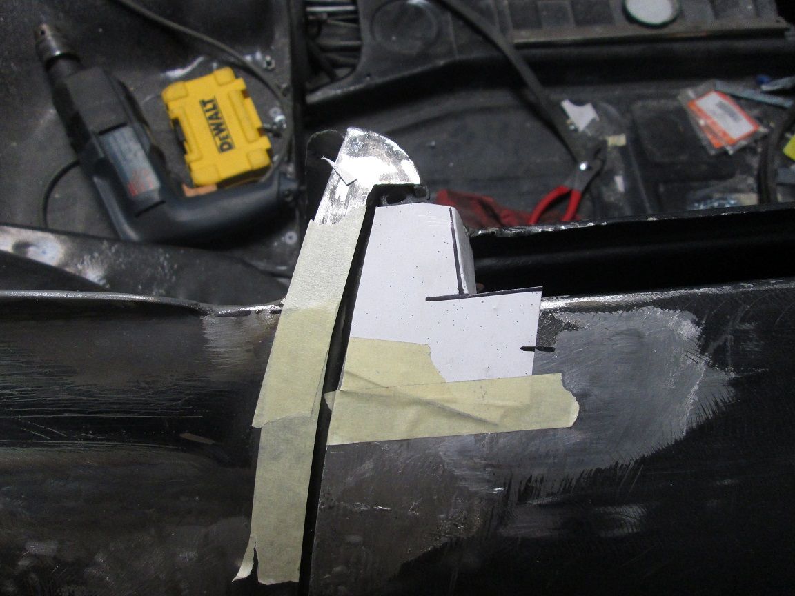

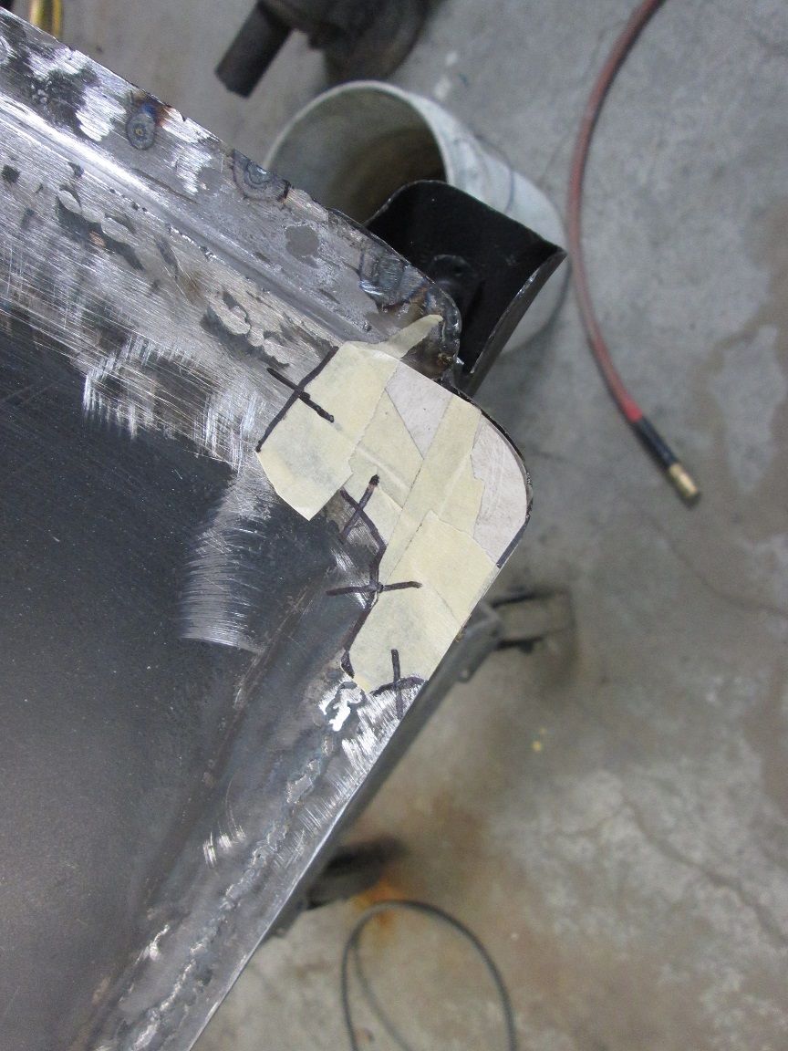

                          • Lower forward corner.
                            Click image for larger version  Name:	IMG_4920.JPG Views:	0 Size:	147.1 KB ID:	107915
                            Templating for the final shape needed to match the rocker opening.
                            Click image for larger version  Name:	IMG_4922.JPG Views:	0 Size:	134.9 KB ID:	107916 Both inner and outer walls added and shaped to the needed contour.
                            Click image for larger version  Name:	IMG_4924.JPG Views:	0 Size:	117.1 KB ID:	107917 Nice to get this mess all tidied up.
                            Click image for larger version  Name:	IMG_4925.JPG Views:	0 Size:	151.5 KB ID:	107918 The corner itself will need almost no filler the "step" at the top represents the amount of solder that will be needed to get the final gap width. Had a sliver of weld yet to add to the body side to smooth out its leading edge.
                            Click image for larger version  Name:	IMG_4926.JPG Views:	0 Size:	146.2 KB ID:	107919 and finally the rear corners was finished out completing my steel repairs to this door. This was a long one...

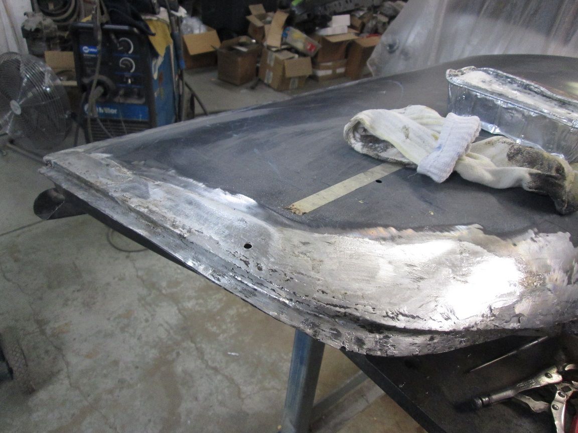

                          • Resoldering begins:
ID:	107924 I finally have my raw metalwork finished in and around this right door and its now ready for some tinning acid.
ID:	107925 Began with the leading edge of this door. Lead wiped with solder and tinning acid.
ID:	107926 I get out of practice quickly so I started out on a more horizontal section before I make my way downward to the vertical.
ID:	107927 It took some doing but by sessions end I was able to apply and spread the solder vertically without losing it on the floor.
ID:	107928 My lead work still has a lot divots in it but the loins share of the needed shape is in lead so I'll feather the rest of it out in putty.
