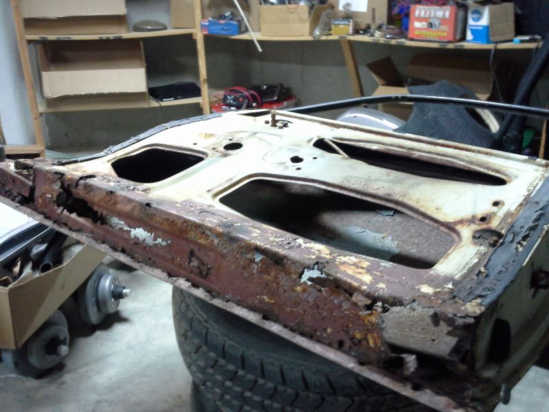

    When can I send you my doors so I don't mess them up? This way I know they will be done properly.

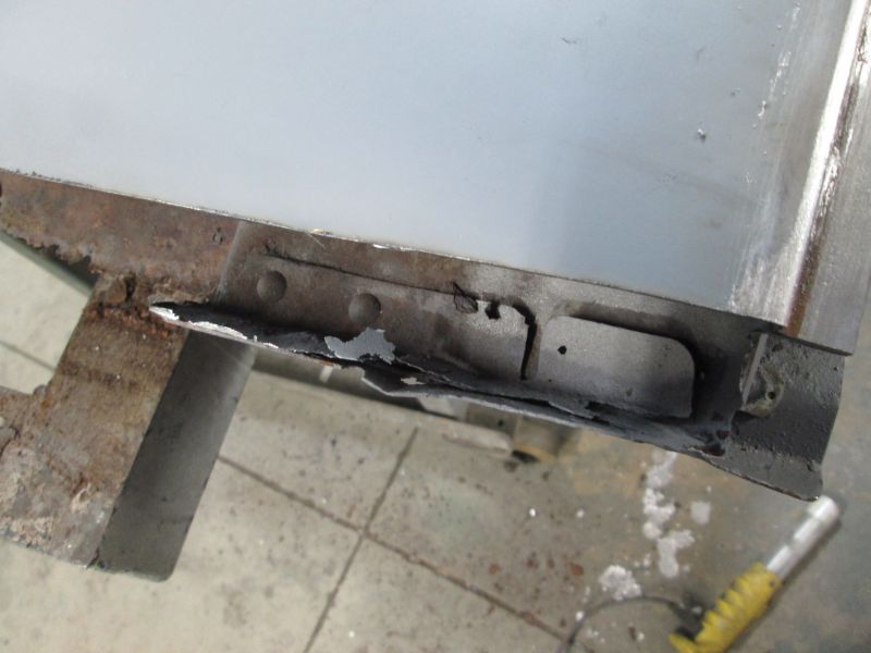

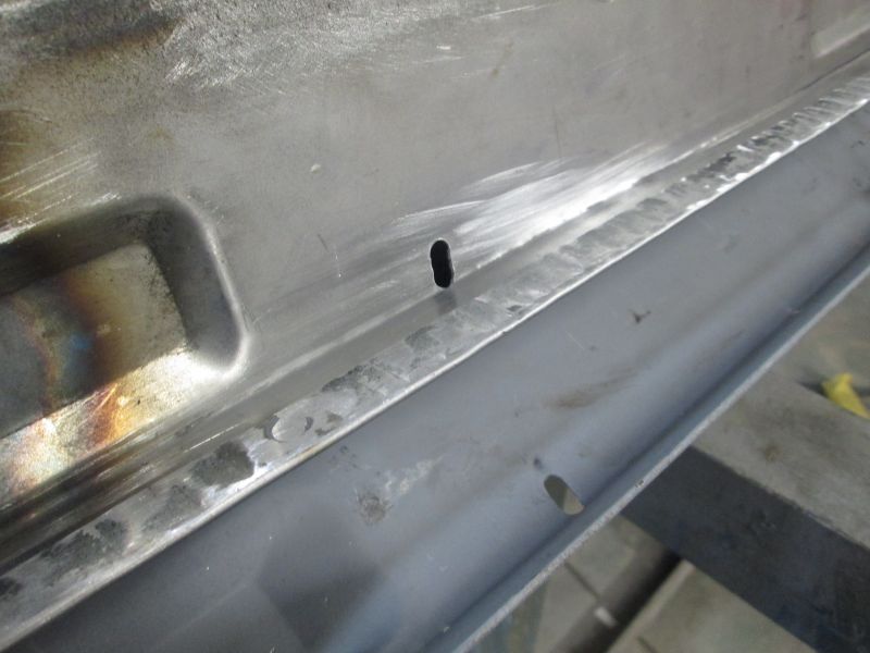

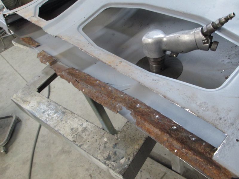

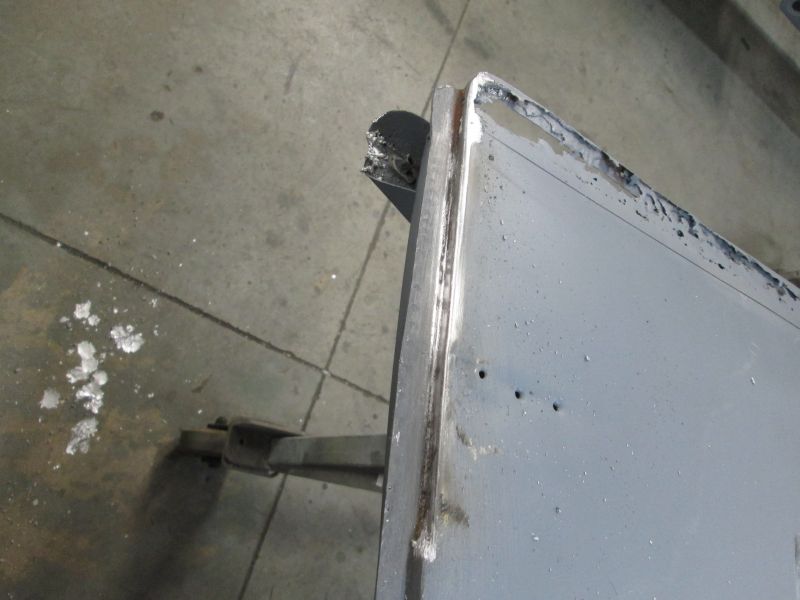

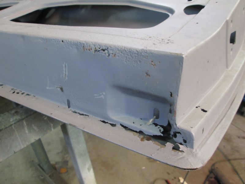

      WHile messing with the right door I realized I had forgotten to add the drain holes in on the left door. Drain pictured above the original for correct shape and location.

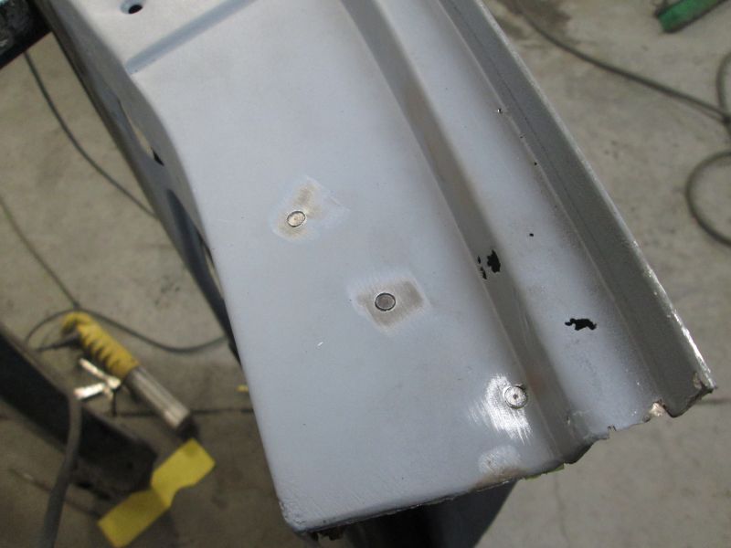

      I was very concerned about stabbing the skin with the drill which is why I should have punched these before the skin but it worked out especially up here where I had to relief cut.

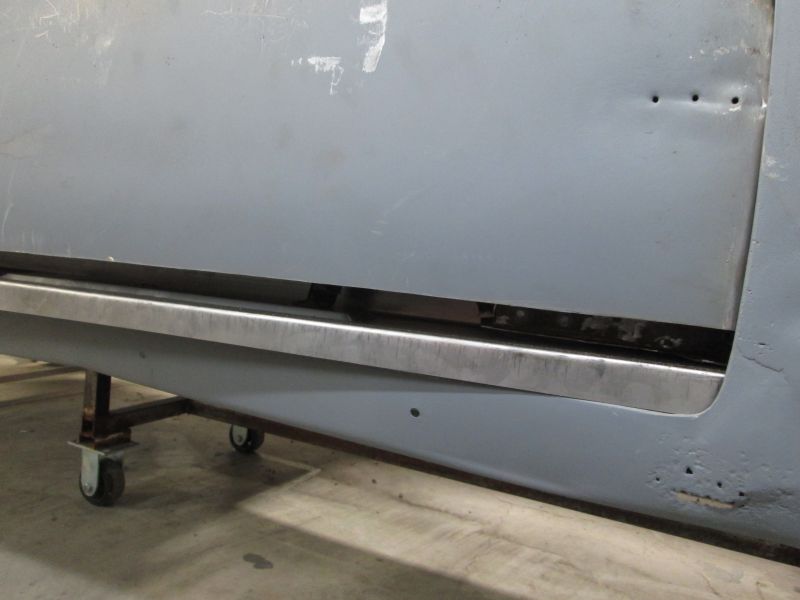

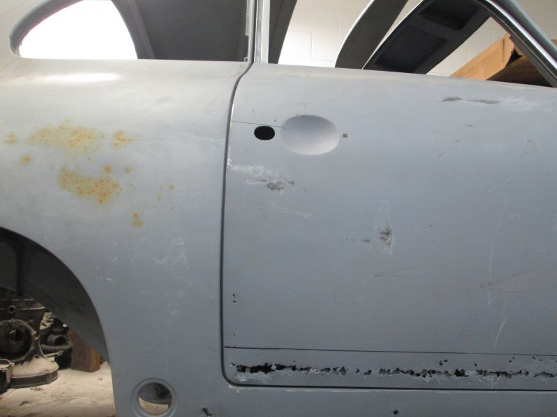

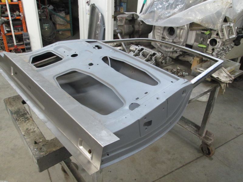

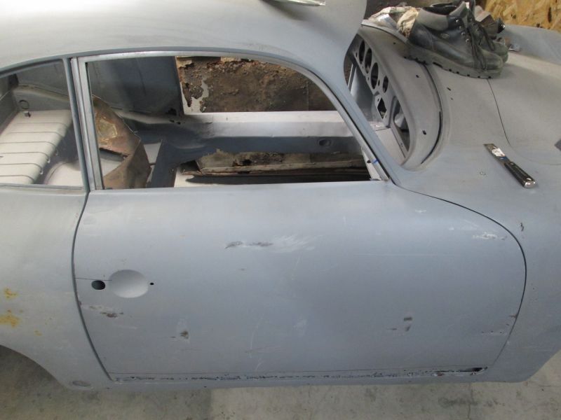

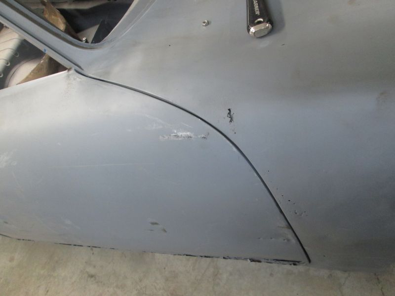

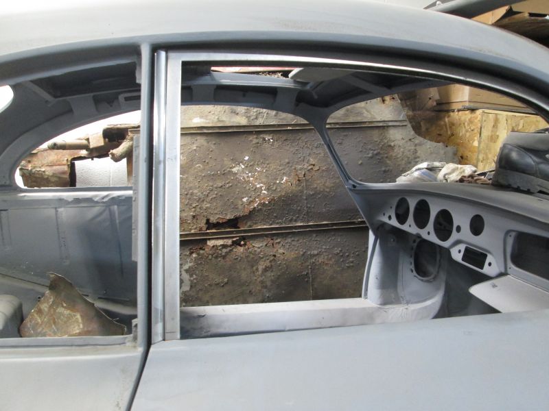

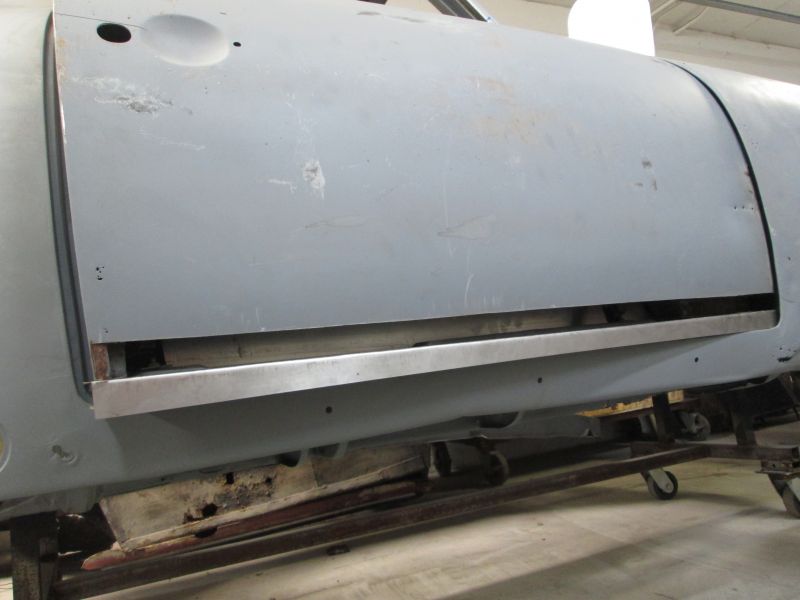

      Back on the right side door. Mocked up on the car with frame to confirm a base line fit and finish before I begin cutting.
      Like the left side the door fits beautifully being the numbers original.

      Frame fitment also noted in case something doesn't fit or look right after the repairs.
      Looks nice to begin with and hope to preserve that.

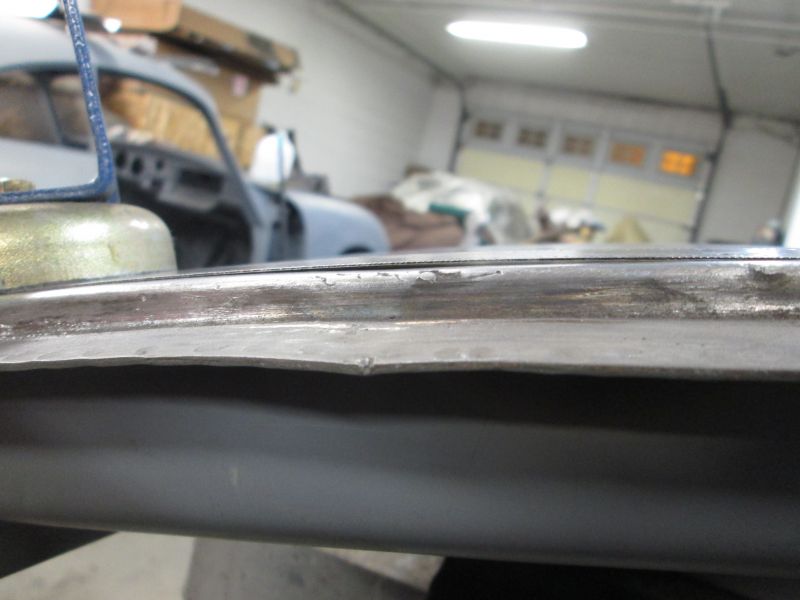

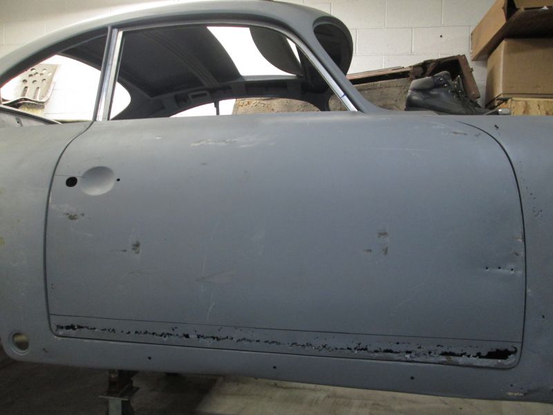

      Old accident damage and rust have thrown this alignment off; so much so that it collides and binds up here. So glad I tested it before hand just in case it continues to give me clearance problems.
      Time to begin cutting out the rot.

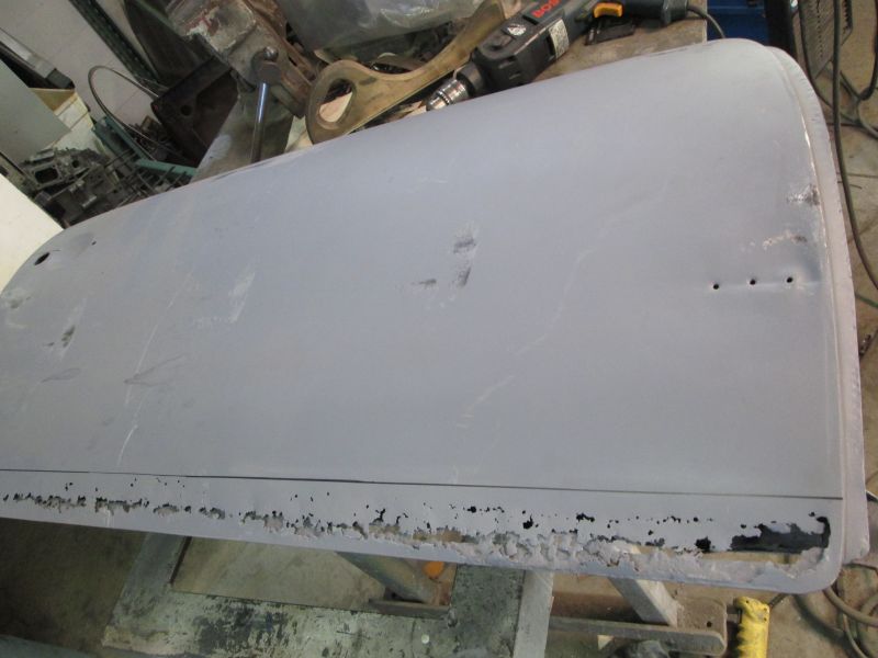

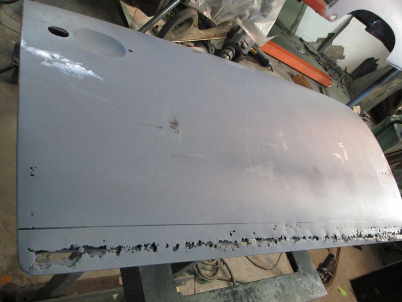

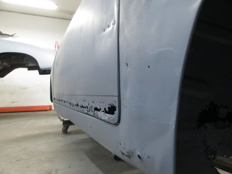

        Save for the bottom and that forward dent with poor removal attempt this original door skin is in nice shape.

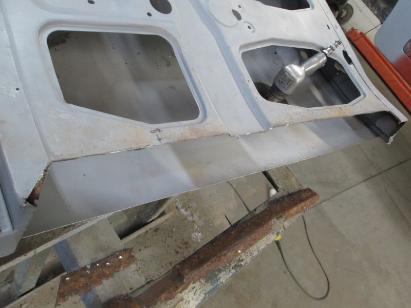

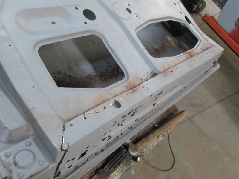

        Will have to perform the dreaded lower repair section run but I want the weld joint as low as possible. This cut line doesn't get all the rust holes but I fill the ones on that back edge as it goes.

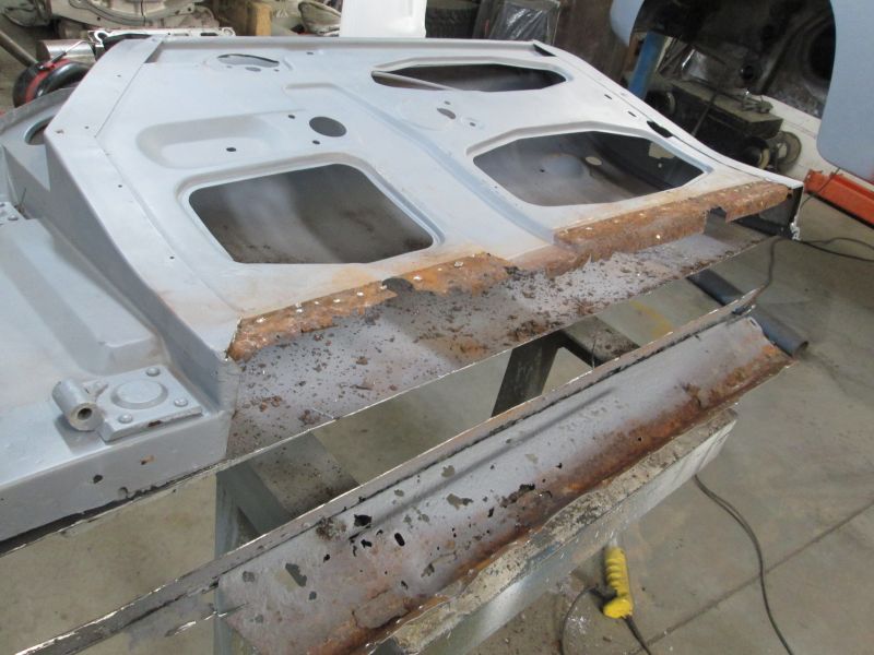

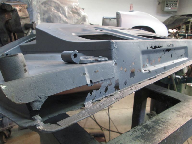

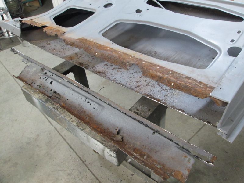

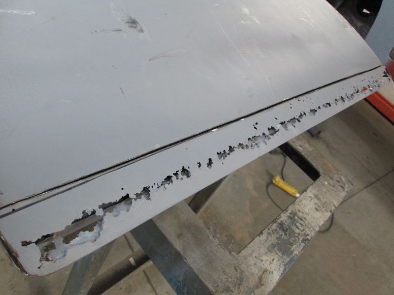

        While the skin is nicer than the left door was the rust on this side is touch more advanced than on the drivers door.
        Just an observation. Doesn't make a whole lot of difference as the required repair to the frame will be about equal.

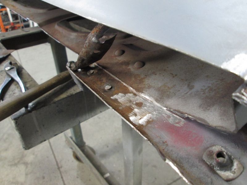

        Began prep work by removing some lead. Disturbing only what I have to so I stopped just above the dent.

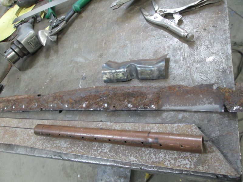

        It all has to go so I took the bottom with the skin section out in one shot.
        Off; Almost a rust free door here.
        Rust is slightly higher and more advanced than the left side just as suspected.

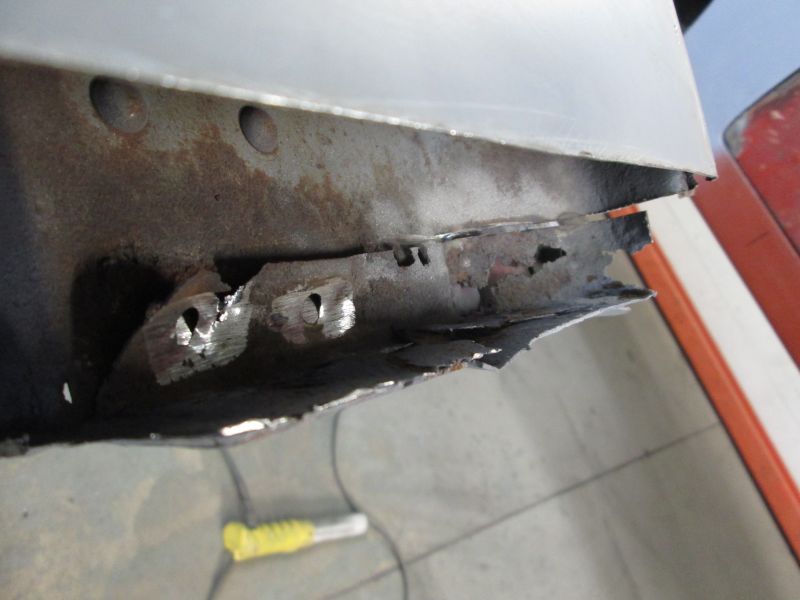

        Remnant of the inner wall flange was removed next. Again the rot went higher and deeper so I had to cut it just at the step flange relief detail along the bottom. Hope to preserve that step as the new section is eventually welded in.
        This door doesn't seem so bad now. For the last couple of days I've been planning my attack on how to best approach this repair. My number one concern is how well that lower skin section turns out and those who have tried it know what a bitch this can be. At the end I need a close contour with no oil canning. As it sits here you can see I have clean shot at both sides of this joint and it could easily be welded, shrunk where needed then Picked and filed. With that in mind I've decided my best shot is to weld and finish out the skin repair first. Before I do that however I'll tee everything else up. All the new lower flanges will be made trimmed and set screwed into final position. New bottom will also be trimmed so when the new skin section is finally done the rest of the door repair sections will fall into their predetermined place. This is the plan so we'll see how it turns out.

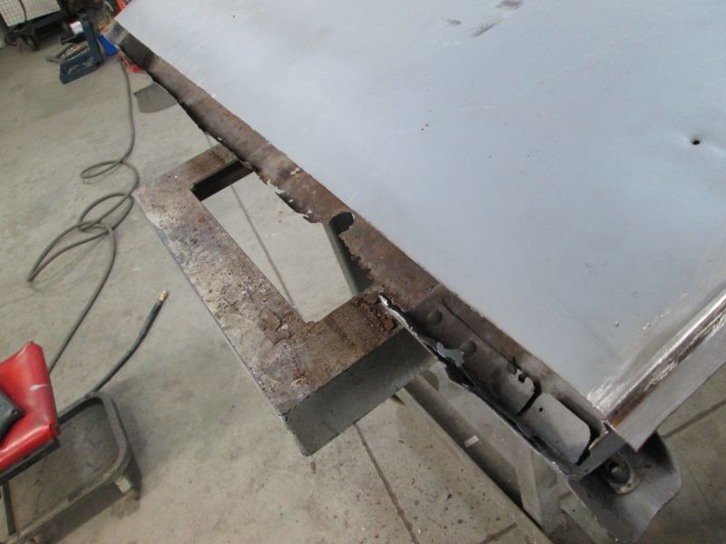

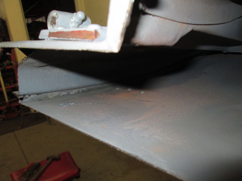

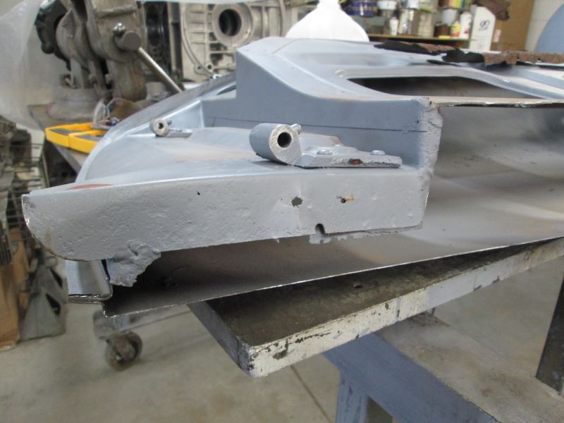

                Again with side being a touch rustier the bottom of the door stop housing is pretty thin most of the way through. A blessing at this point as it clears the way to remove it creating more access space while I mess around up here. I recap it with a piece of 18 gauge once everything else is all welded in for good.
                Begin cleaning out the remains inside the stop housing.
                Just about there with most of the bottom of the stop housing removed. Ample room to work now.
                I also get a much cleaner shot of spooning out that old dent as well.

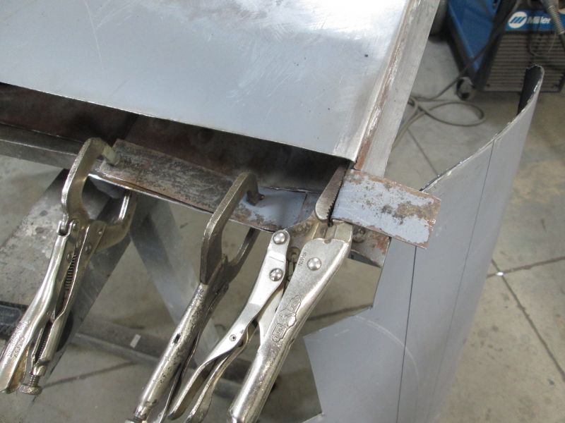

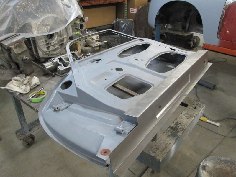

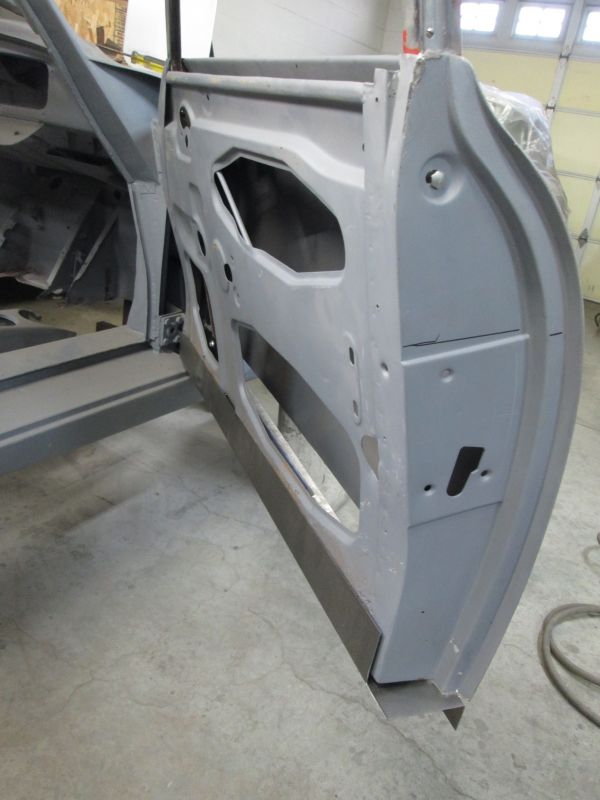

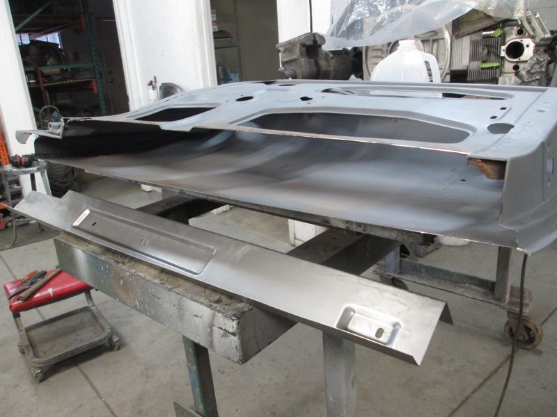

                Mocked up with door frame to begin locating the new bottom.
                I can now start roughing it in.

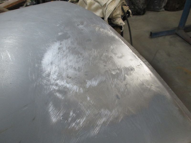

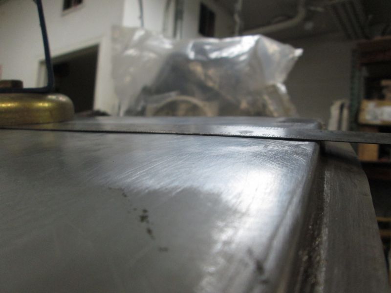

                        11/15/17

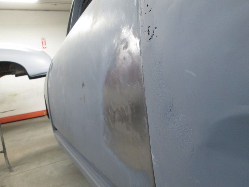

                        PIA Dent removal.

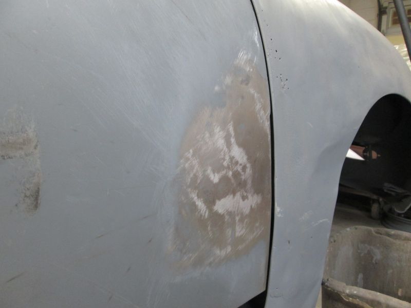

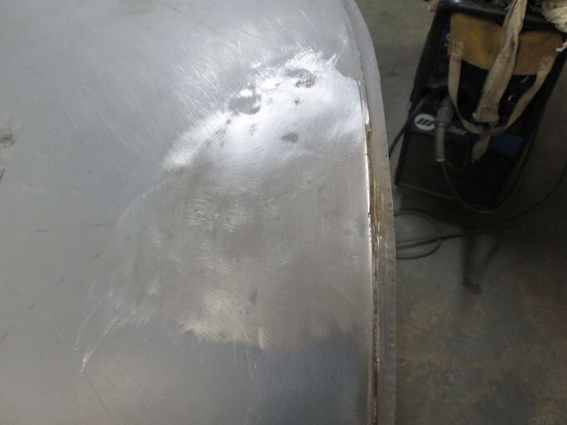

                        Looks innocent enough but this old dent and previous removal attempt turned into a real challenge. Its deep forward position didn't help either. Even though I have the bottom of the door open the narrow cavity made it nearly impossible to generate any meaningful hammer strike from inside.
                        resorted to a couple of whiskers to try my slide hammer with. Mixed result at best.

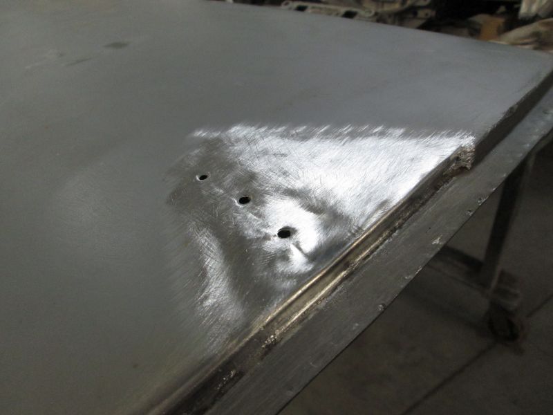

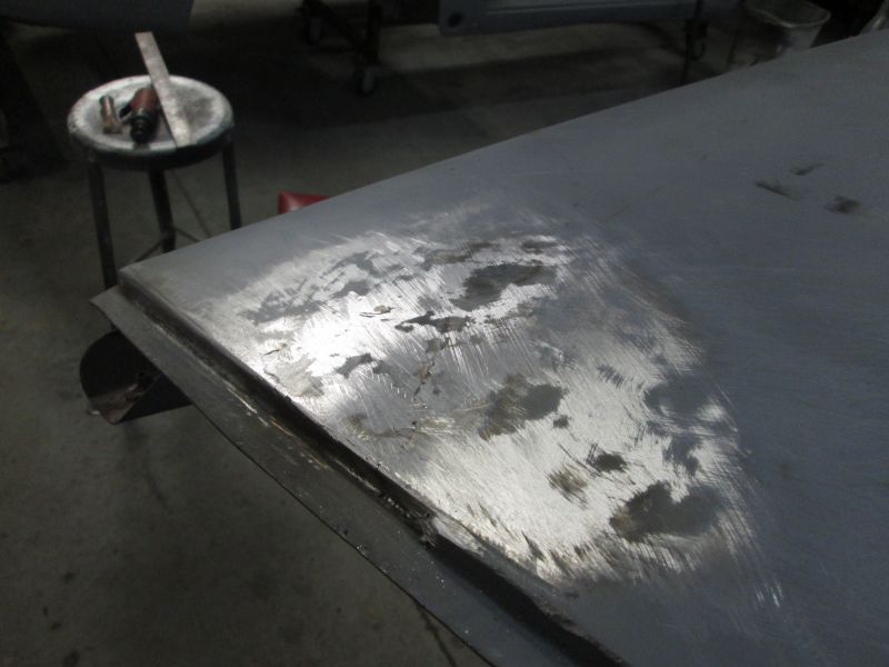

                        What made it so tough is that it was a "crease dent" so the surface is stretched and scored creating a nice trigger point. What ever went across it also knocked the leading edge back ever so slightly holding more tension. I only realized this after a quick heat attempt and the whole area just sank deeper. Added that relief cut to break its grip and allow the surface of the skin to relax upward; with more torch heat to help me move the surface easier.
                        Couldn't work with it on either side so I had to string it upright to have any shot at it. Wedged two dollys in there so I could planish from the outside. You can see here I was in the middle of throwing everything I had (which isn't much) at it to get that area to raise back up where it needed to be.

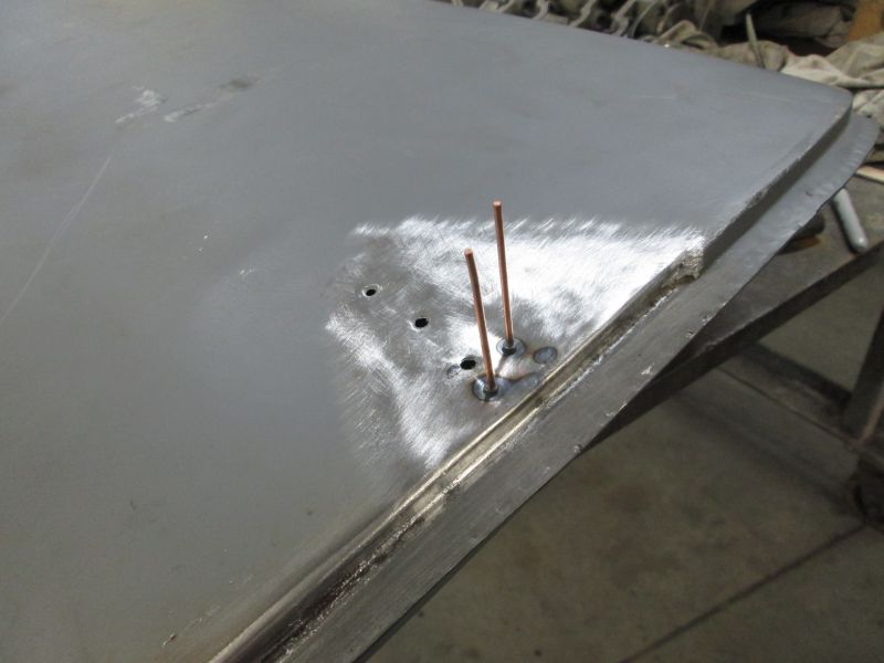

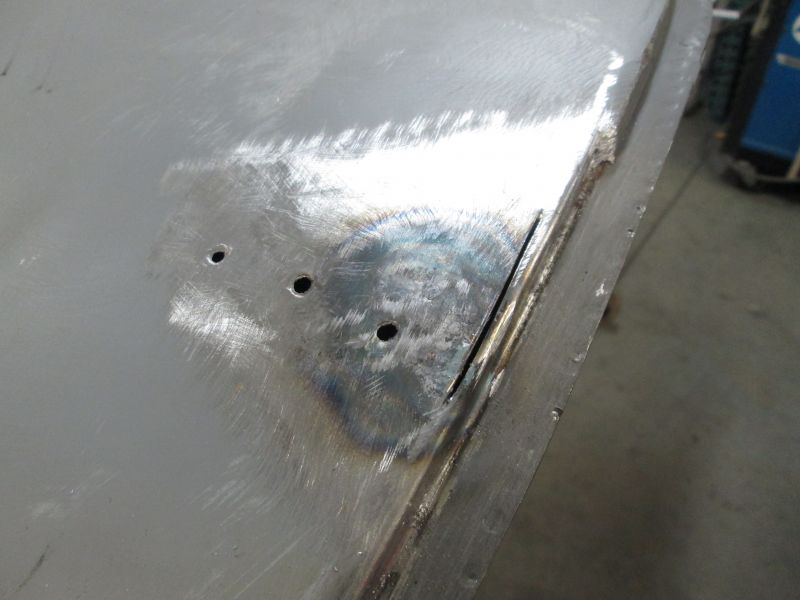

                        I wasn't out of the woods with it. Once I welded up those holes the area drew back down again and also began to oilcan just ahead of this area. Had to heat shrink and chase it back out again. PIA

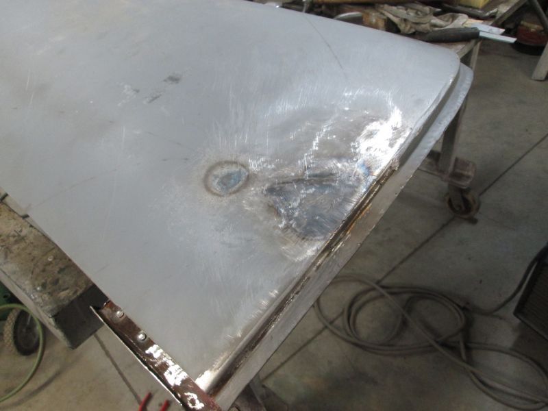

                        Just about the last of the pick and filing here.
                        By sessions end it was close however not perfect but at a level that will need just a swatch of lead to get that last 10%.
                        through the middle its still a little flat where that dent was but some lead less than the thickness of that ruler will correct that.
                        Length wise some subtle rollers remain but again just a swatch will do'er.
                        One more light scuff with a file just to highlight the topography.
                        Though subtle and light I was still tempted to keep chasing but I just can't spend anymore time here. Limited Time, limited tools, limited access, limited talent...A deadly combination.
                        Glad its in the done column though. Areas like this are heart breakers but only so much can be done if you can't hit it squarely from the underside. Onto the next repair.

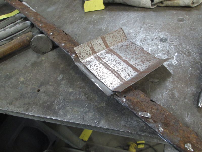

                              11/21/17

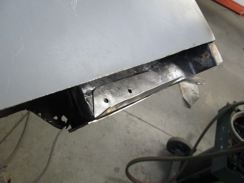

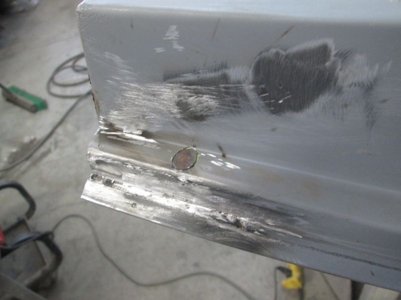

                              Begin small repair patches.

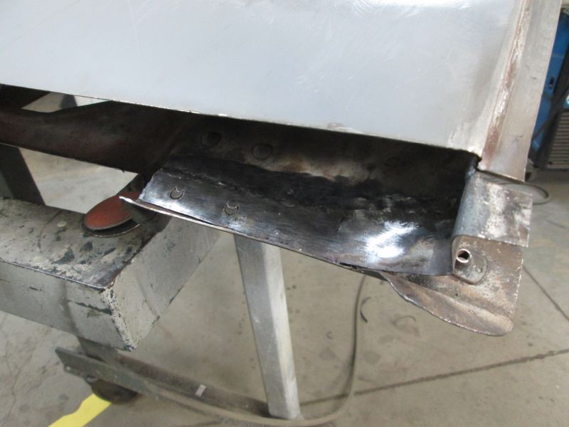

                              All the breaches are localized so saving this original lower section was doable. drilled out the small rust holes and the knockouts from my hole puncher provided the plugs.
                              Larger rust hole reamed out with plug ready to tack in.
                              Rear vertical wall repair complete.
                              Onto the front

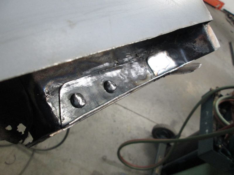

                              Same Plan as with the left side repair. New donor section harvested from the old door skin.
                              All stitched in.
                              one more sliver patch to add on the lower skin flange.

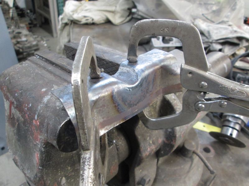

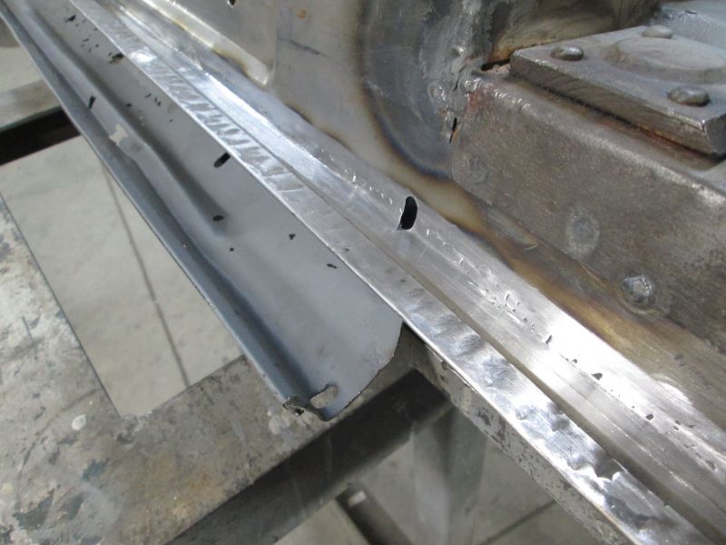

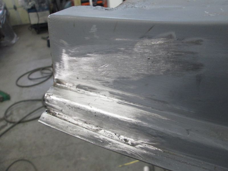

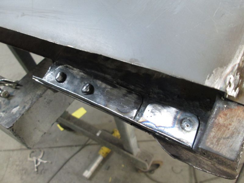

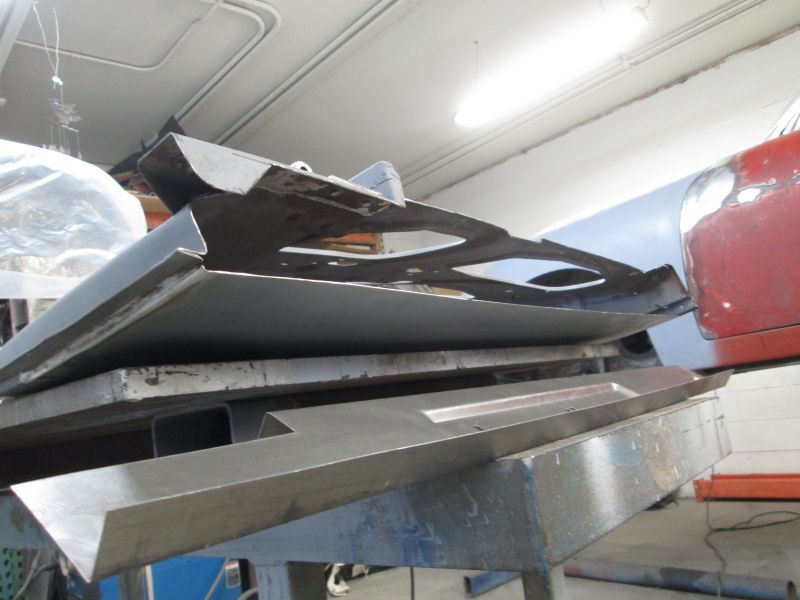

                              Begin making the door bottom lap/flange detail. Because of the lower door skin repair sequence and space needed to work this has be to done in a smaller and seperate strip.

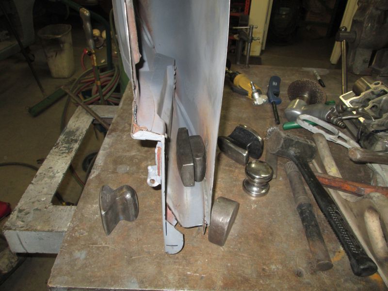

                              • #90
                                11/24/17
                                New flanges

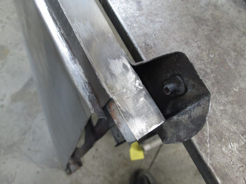

                                Forward lap flange with "rivet head" detail complete.
                                Far as I can go up here until the new lower skin section is stitched in.
                                Began on the inner closing panel flange starting with the center relief.
                                Adding in the drain arch as before.
                                folding up the rest of this flange run next.
