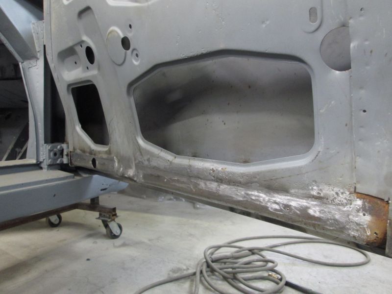

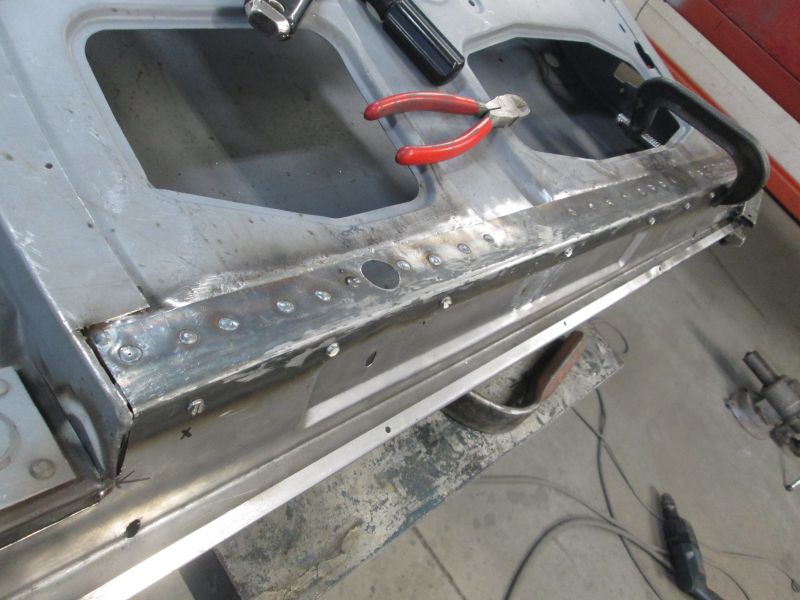

        Forced to trim off the rest of the door stop flange to be able to slide the bottom back on.

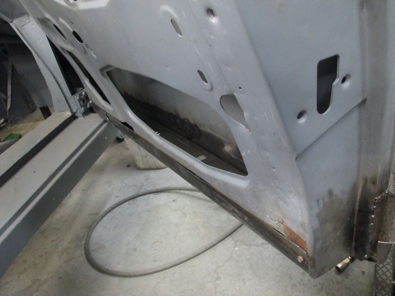

        Test fit with the bottom installed and the alignment with the rocker improved.

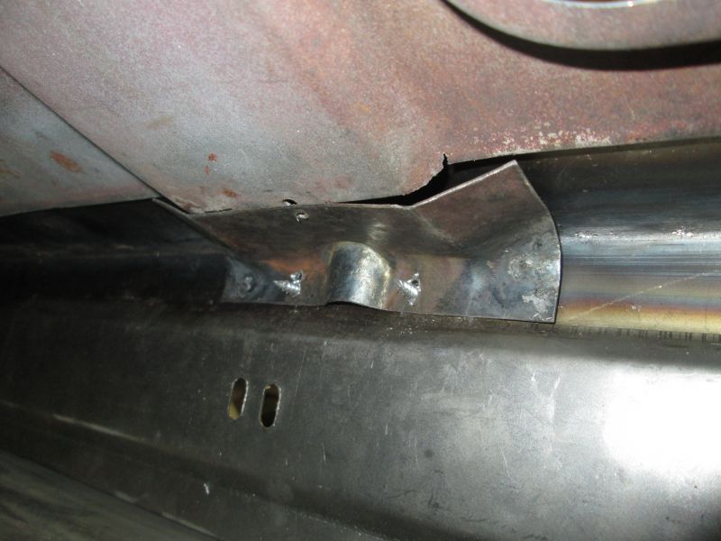

        All the new pieces beginning to work together.

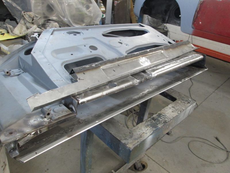

        All stitched up.

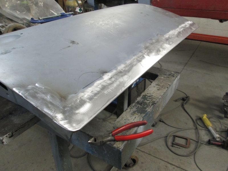

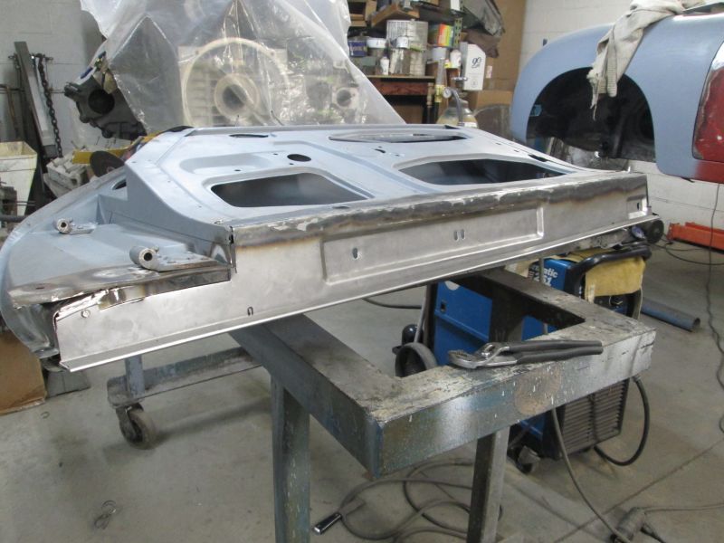

        A lot of waves and rollers to iron out but not a horrible start.
        Many rounds of heat shrinking

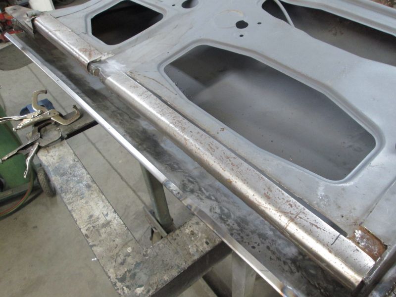

        Again the real luxury was having easy and clear access to the backside.

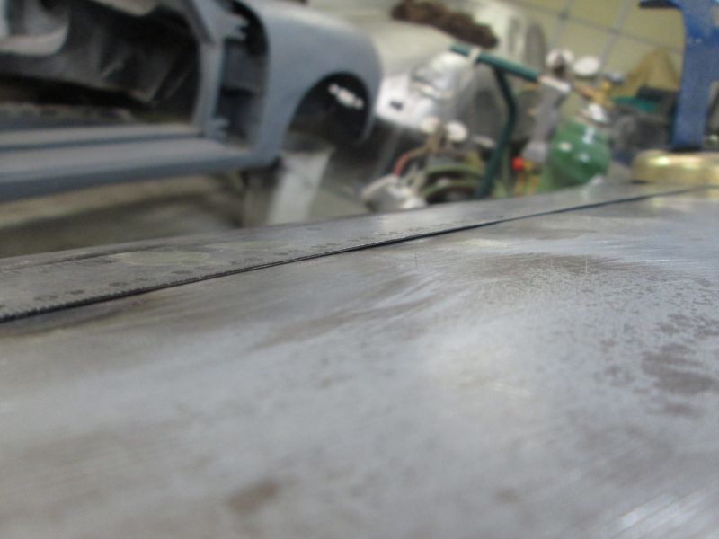

        Some waves remain but no deeper than the thickness of this ruler.

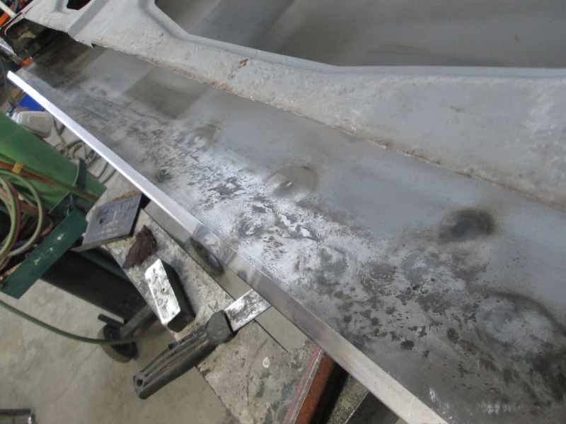

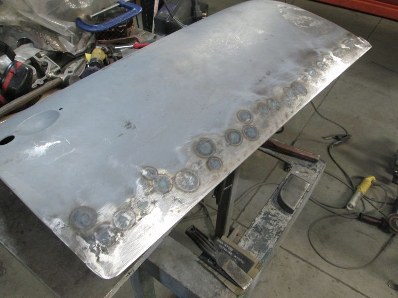

        Chased it about as far as I can with it hanging loose.
        It will certainly change a little once its finally clamped to the bottom so I wait and make any further needed adjustments to the skin's surface once its all built. I won't have the access but hopefully I won't have to correct too much.

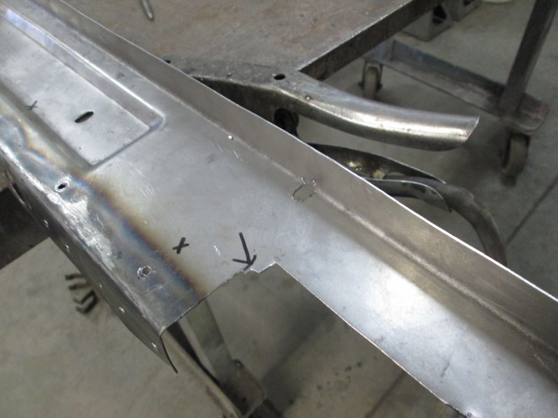

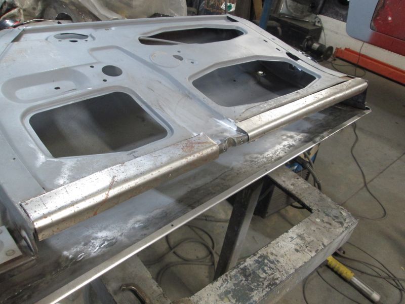

        • 12/14/17
          Installing inner wall flange.
          Starting with the center section then building outward. Setting it in here almost blind was a lot trickier than on the left side where I had open access with the door skin out of the way.

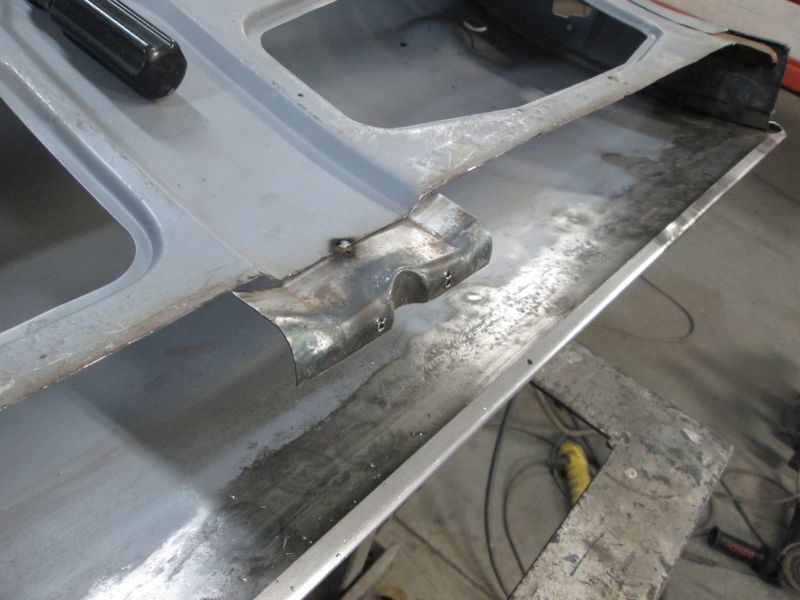

          It took a series of trials and errors before I had it so the first few holes where a bust.
          I was able to sneak in a quick tack to hold its position so I could remove the bottom for final trimming and welding.

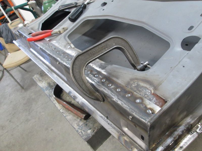

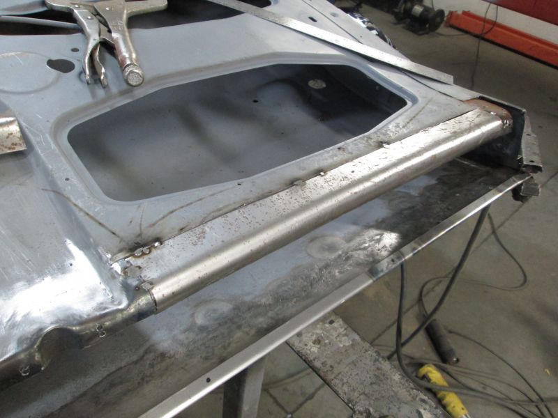

                12/14/17 Part 2
                This thread is a little behind so I'm trying to get it caught up.

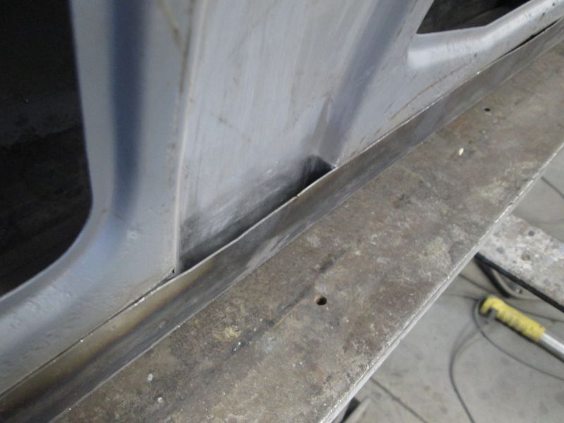

                Rear portion tacked in first.
                Relaxed the flange a touch so it sat flush against the bottom then started adding set screws.

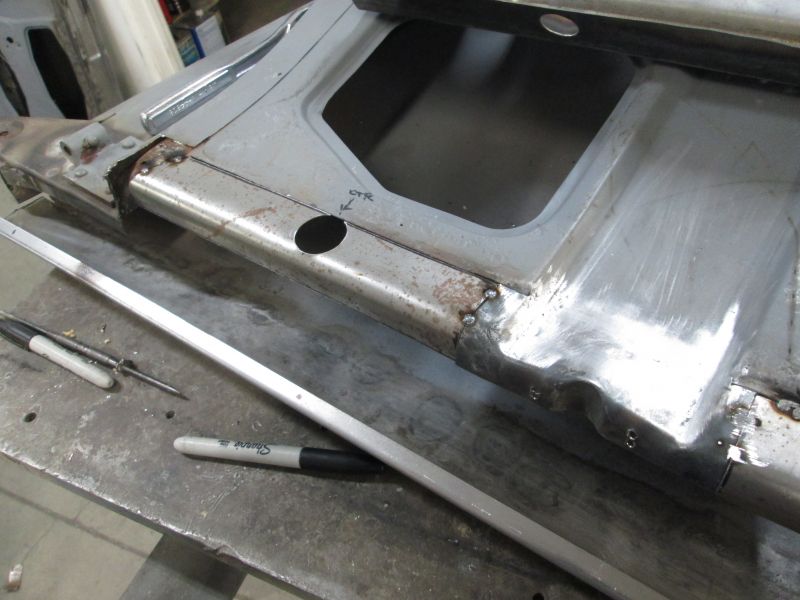

                Froward section next with access hole punched.

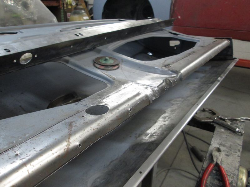

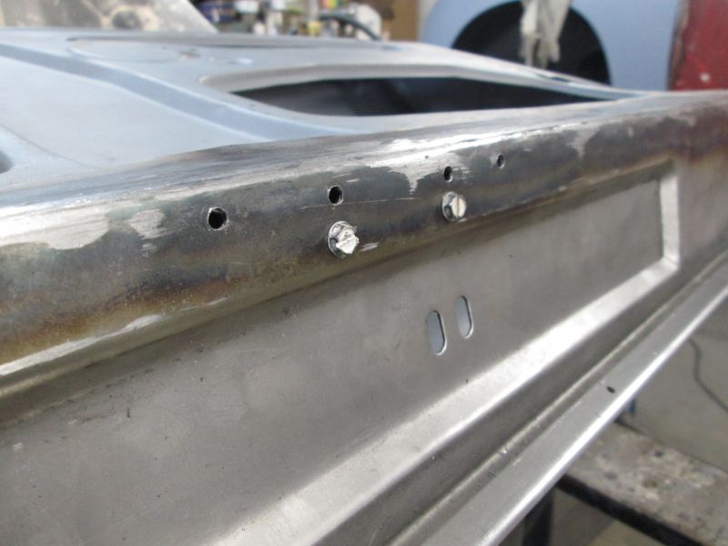

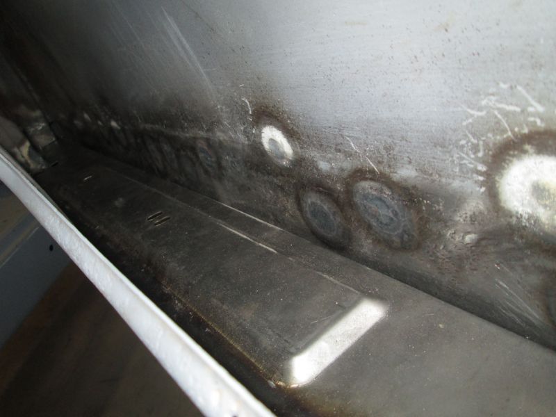

                With the new flange snug against the bottom I added more screws to draw everything tighter still they also represent where the eventual plug welds will be.
                Had to finish stitching them in. The last of the long seam welds on this repair though.

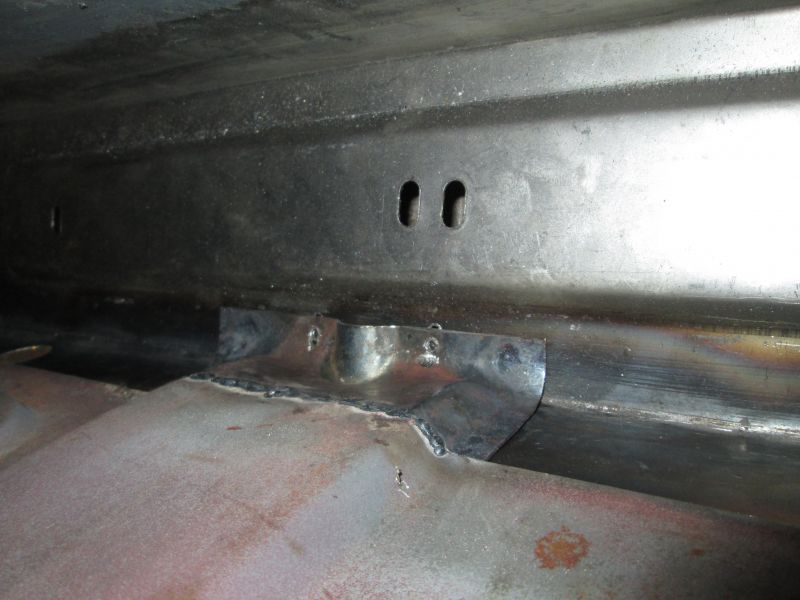

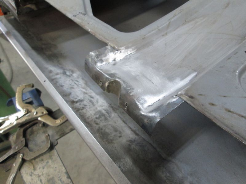

                Getting the bottom ready for final installation by tying up some loose ends like welding shut these incorrect prepunched holes.

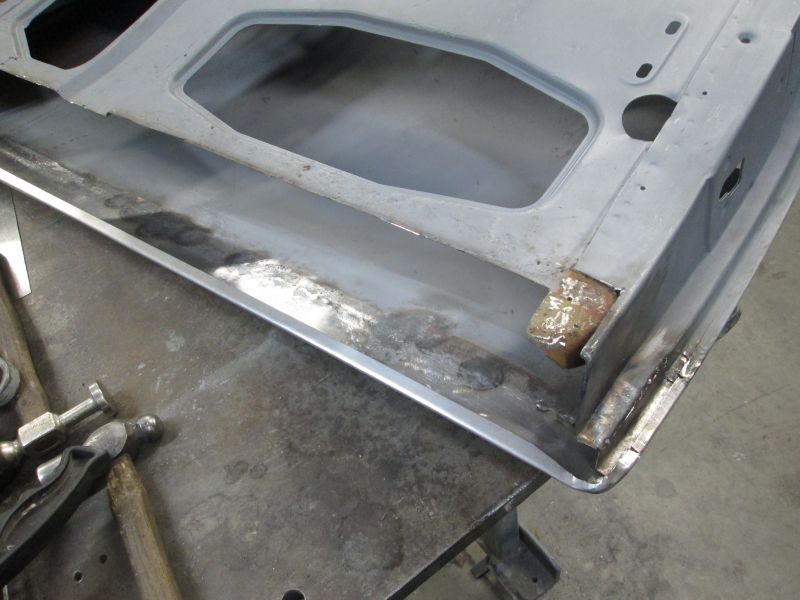

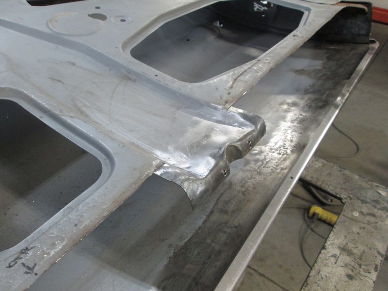

                And also adding in the twin drains up by the outer flange.
                A little more trimming yet to do but I'm dangerously close to finally buttoning this up for good.

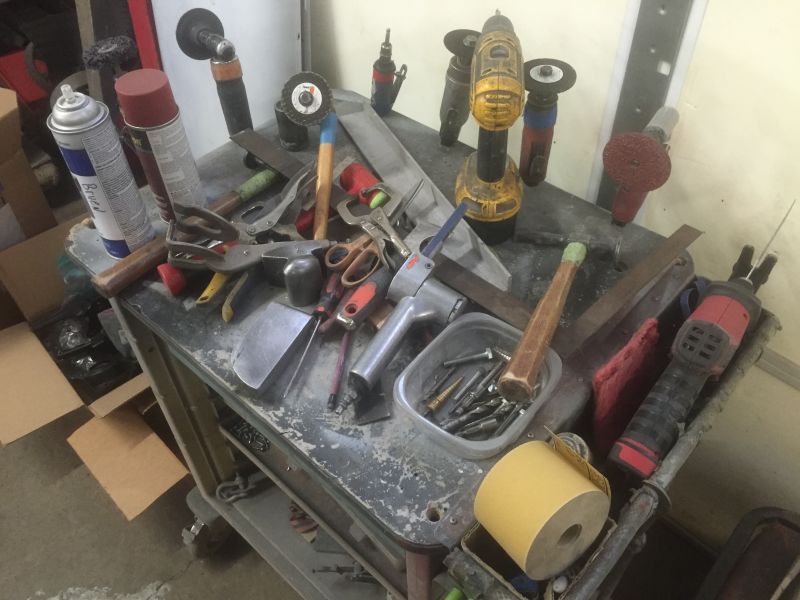

                    • Like this, center on the cart?
                      • Dynabrade, good high quality tool.
                        Jay D.
                        • Thanks for the Tip! I'll have to look into getting one for sure.

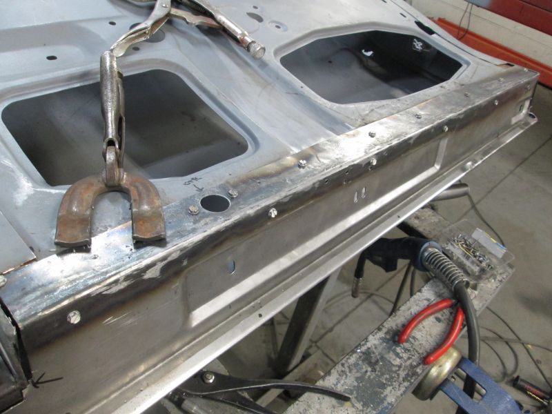

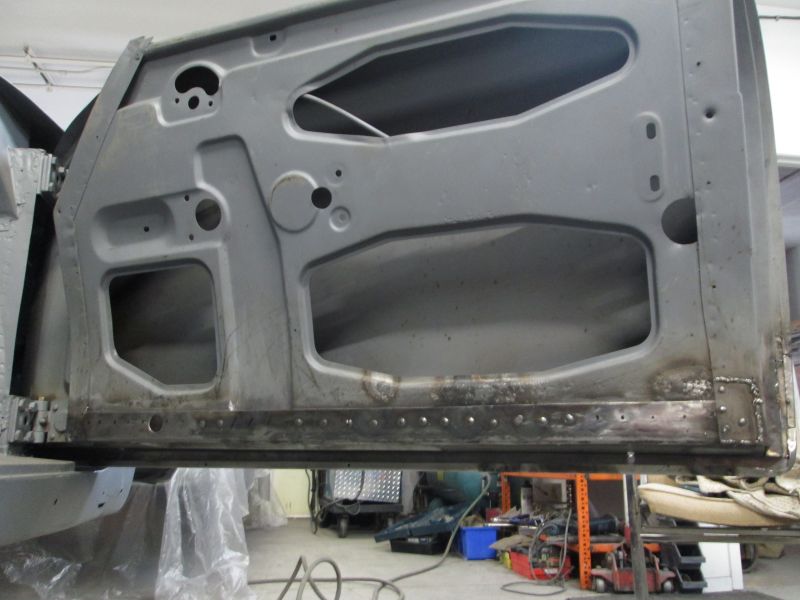

                          12/15/17
                          Bottom on for good!
                          After some careful checking to make sure I was actually ready to close this up for good I began plug welding this inner flange.

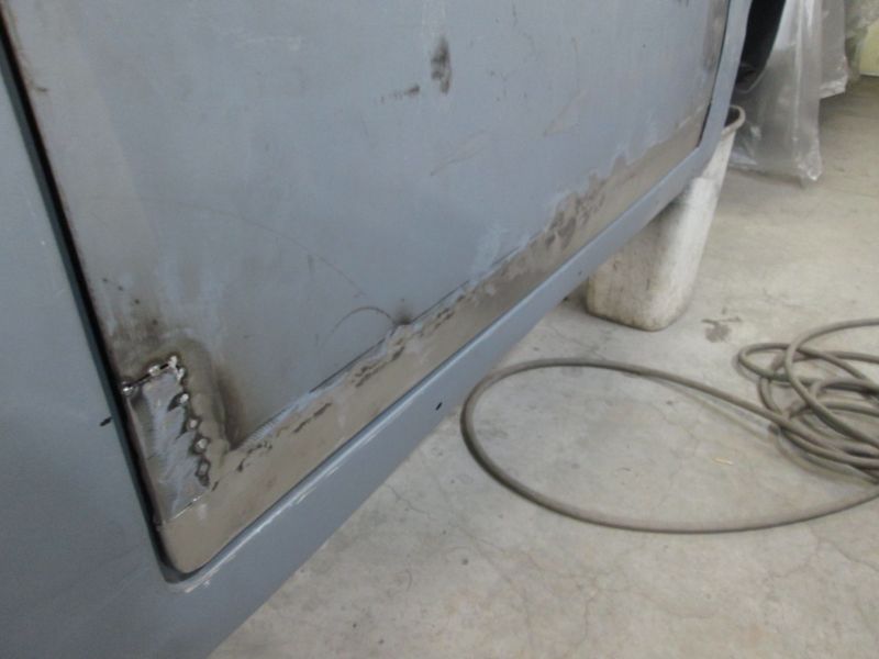

                          Bottom flange row would be welded next. Then it was onto closing up this forward corner.
                          Angle cut and overlapped as Originally done.

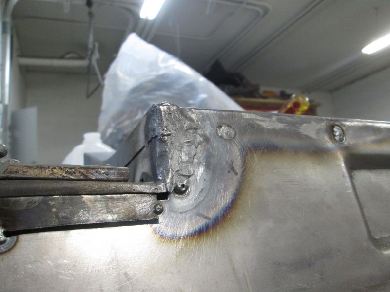

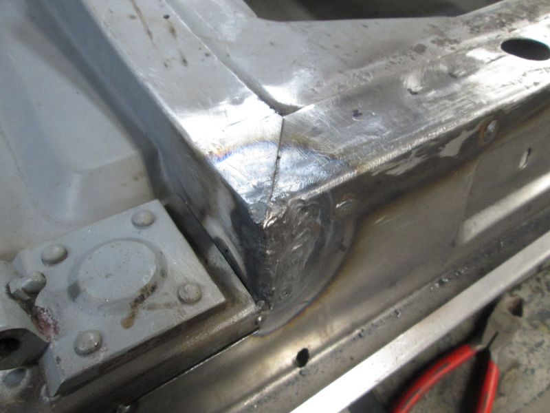

                          Gas welded the corner with replicated overlapped edge detail.
                          Spot weld detail next and will complete the cosmetics.

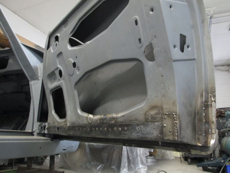

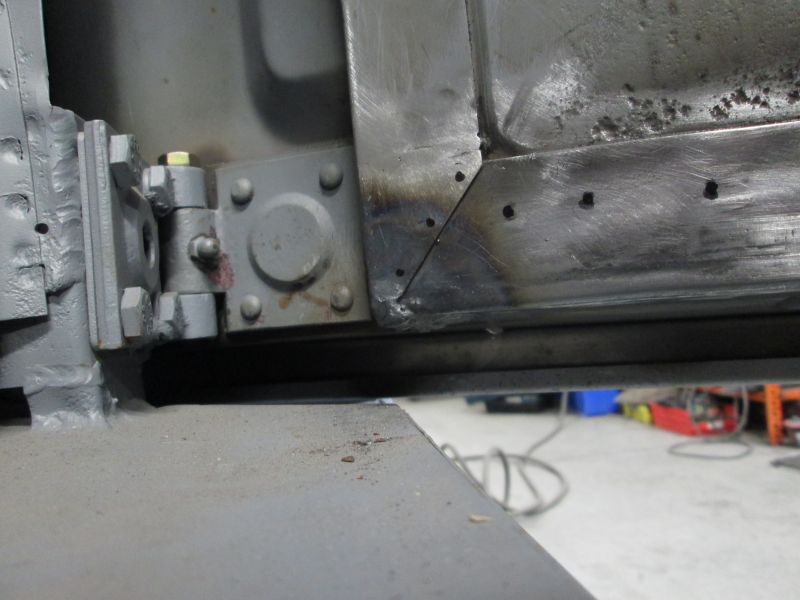

                          Tested back on the car to make sure the bottom hinge hasn't shifted from all the heat. Rear overlap flange just welded in.
                          Dressing it next along with more welding to come. Getting this door closed up made for a great session.

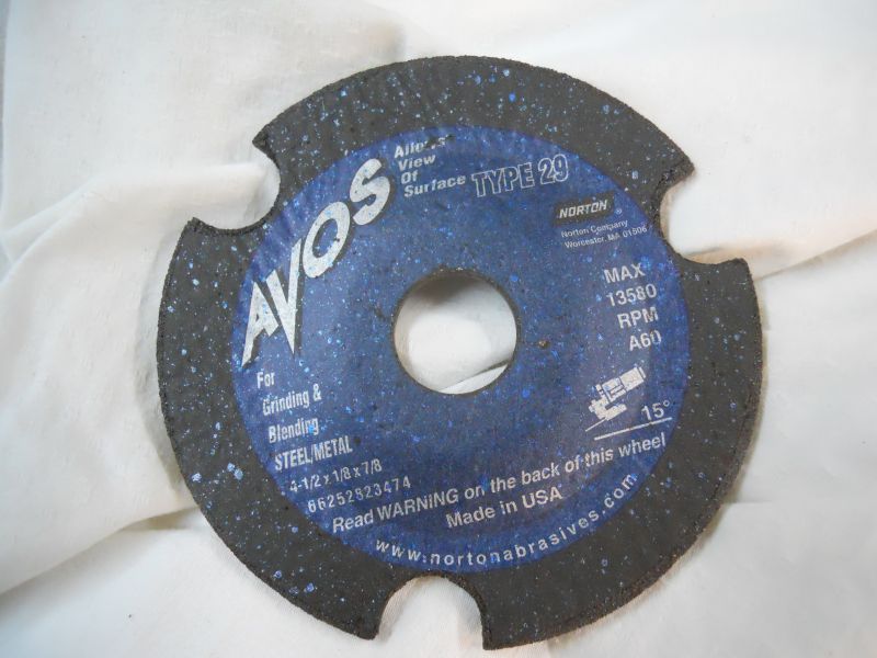

                            have any of you tried these, they work great for grinding tacks and welds. you can see the tack weld right through the wheel when your grinding it. also I see that you use sheet metal screws and I do sometimes, but have any of you used Clecos.
                            Jay D.

                              • your absolutely right about the Clecos, they sometimes just don't pull up tight like a screw dose.
                                Jay D.
