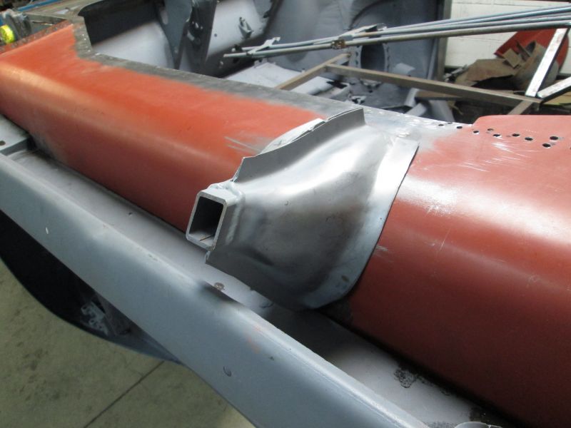

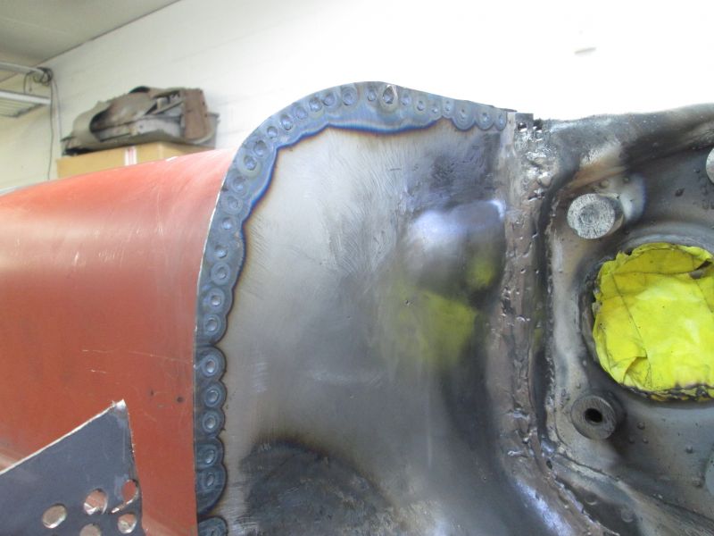

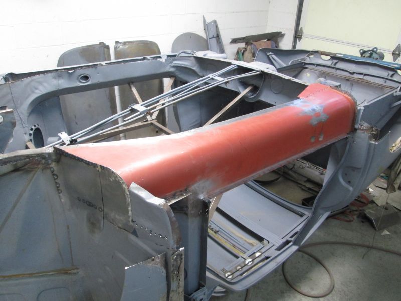

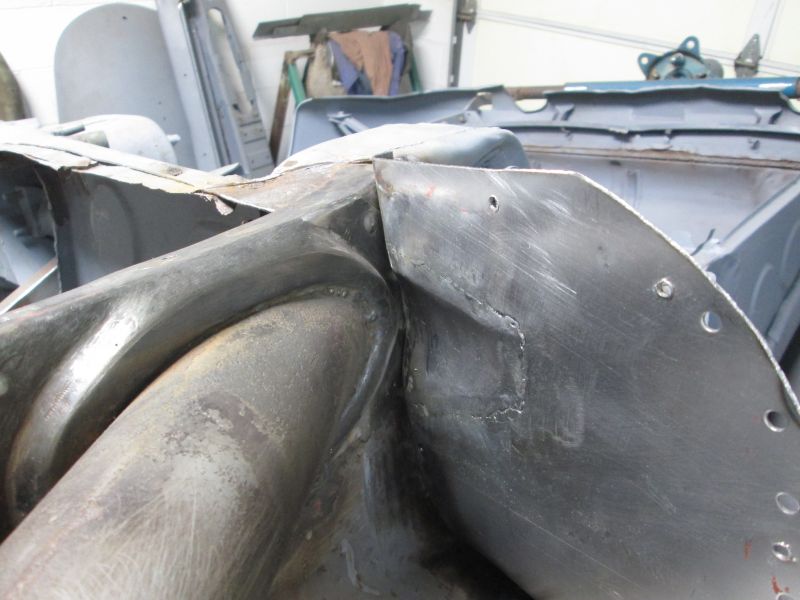

  • How strange,yesterday after reading your post Justin, I went out to the garage to look at mine. Trouble is, in the 70's that end closing panel to the longitudinal was rusted through on both sides so I fabricated end panels myself removed the rusty ones and gas welded them in. I do remember and noted in my workshop diary the longitudinal and heater ducting was really free from rust so applied plenty of zink primer and paint before closing up with the torch.
    I made no mention of an indent to clear the heater pipe area and I believe it fitted and had clearance. So mine today are flat or more or less so. I worked back then in a far different way to these days.
    I capped the bottom of the torsion bar housing as it had some rust pin holes. The cappings have been used ever since for garage hoist lifting so have worked well.
    I will look for a photo maybe?
    Your area there Justin will look like new!!!
    • And we know it's not a "California thing."
      Agree Bruce I don't think its a California thing either.

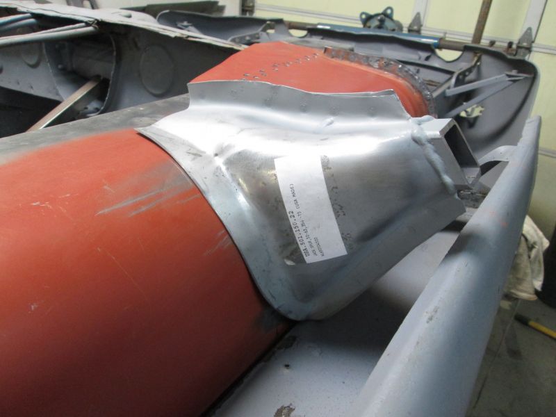

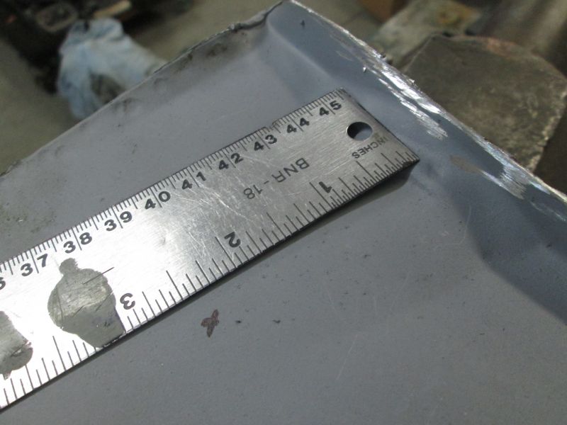

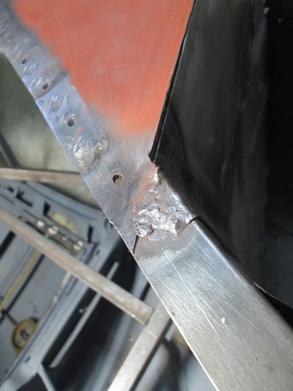

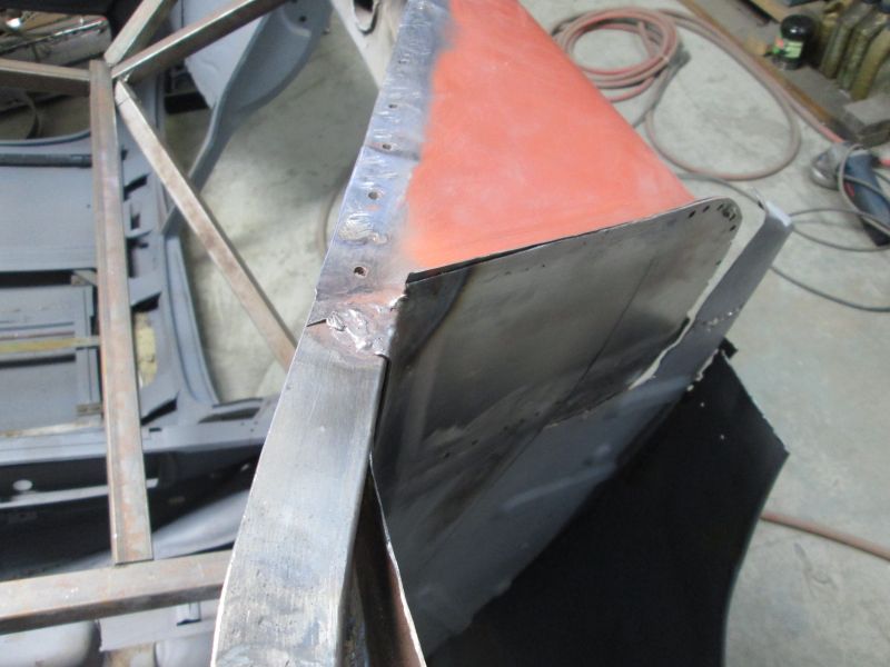

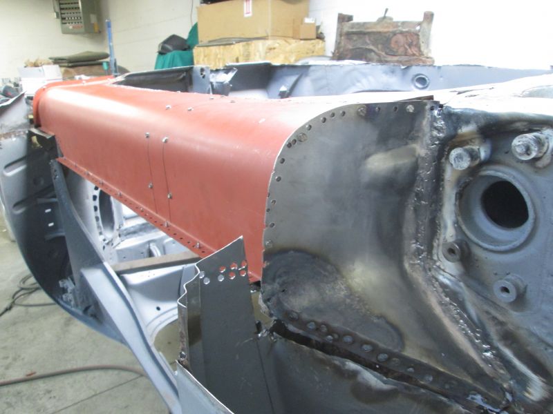

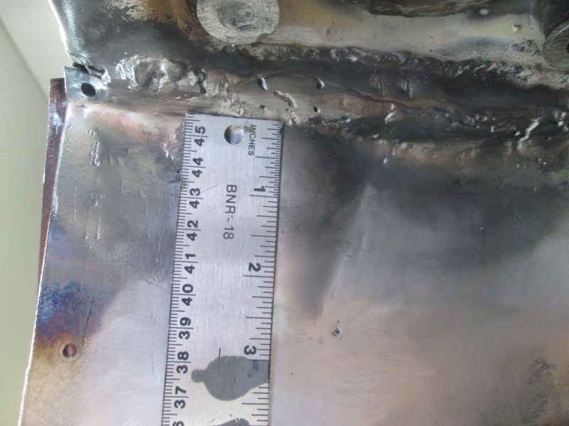

      They certainly do vary in definition even on one side to the other. This one was coming in just under 2.5 inches in length before it washes out.
      Mine is about the same though I defined the end more perhaps giving it the appearance of being longer. Anyway, just one of those crazy details we can all get too caught up with.
      Its an easily overlooked detail Roy and one that is not necessary for clearance as you can see is clearly the case here. The reason for this is that I let that new Simonsen closing panel dictate where the cap was going to be. I didn't want to deal with having to shorten and rebend the flange on it over just a couple of MM's. Life was much easier this way.

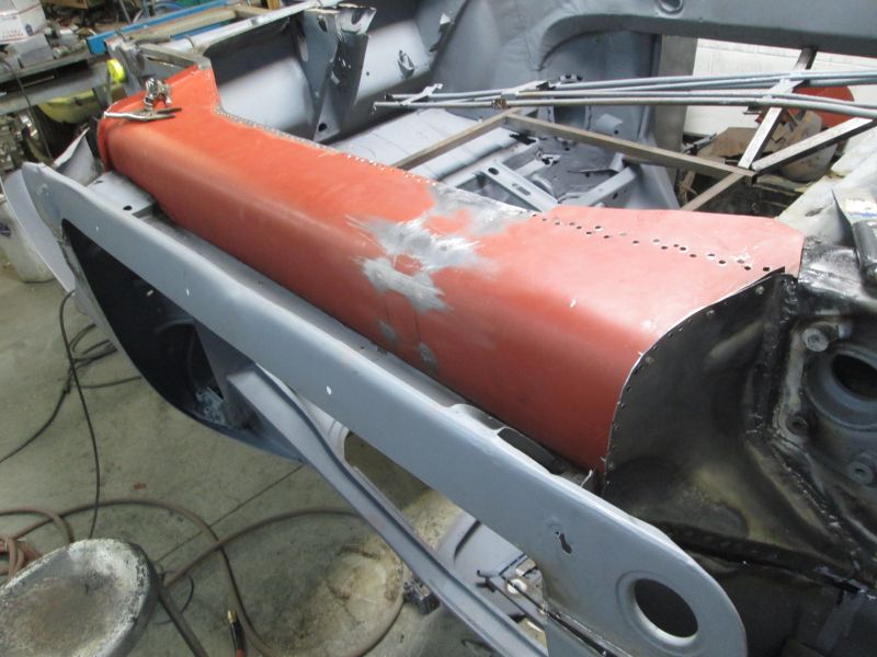

      6/7/18

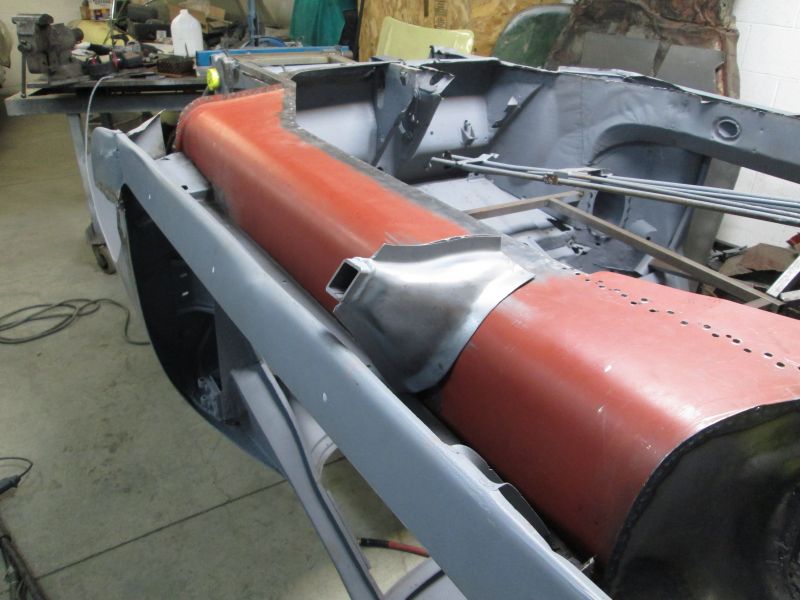

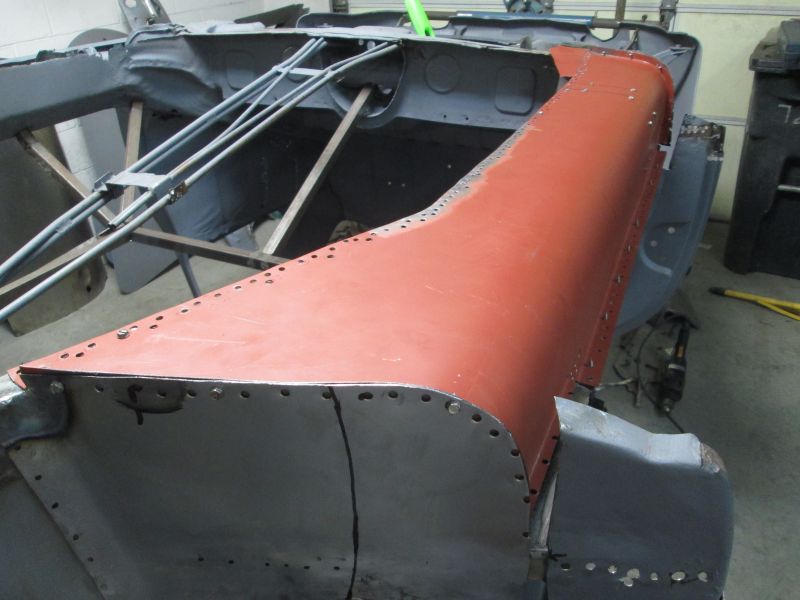

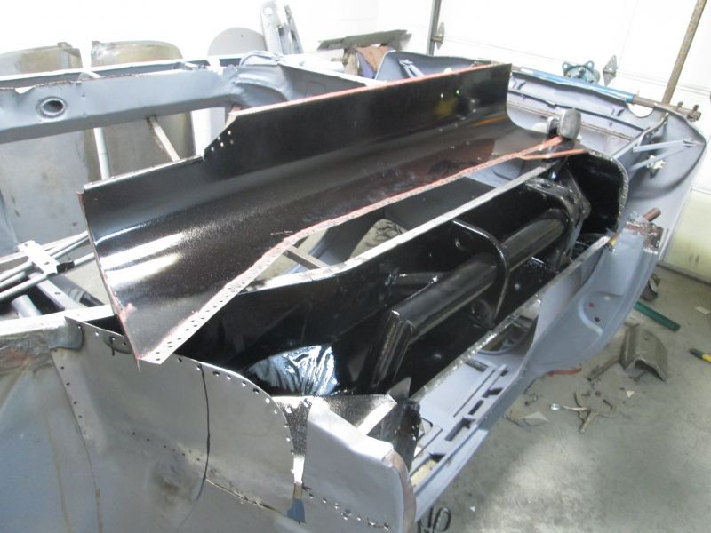

      Closing time! Right longitudinal

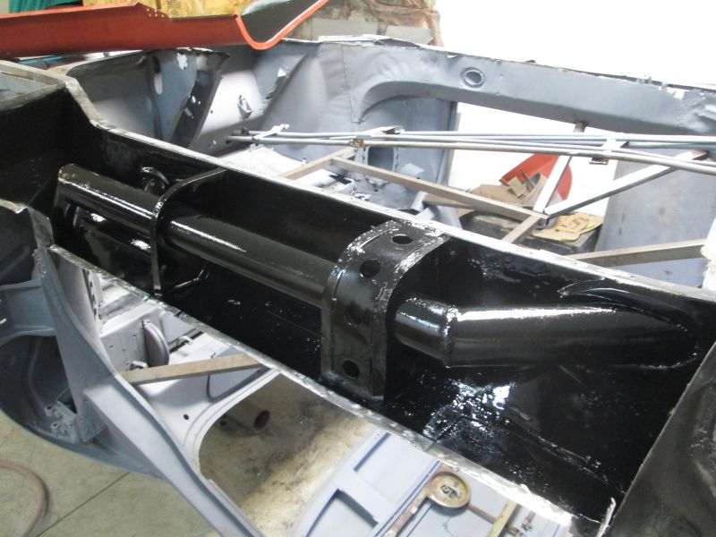

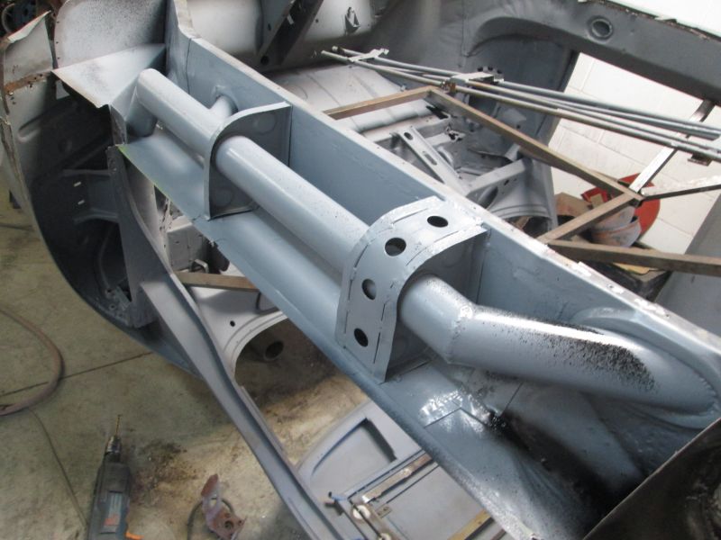

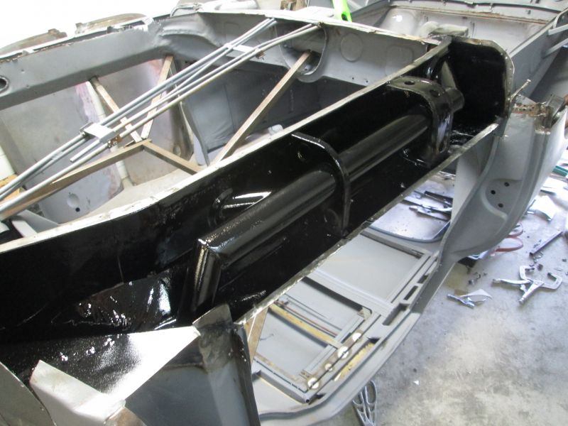

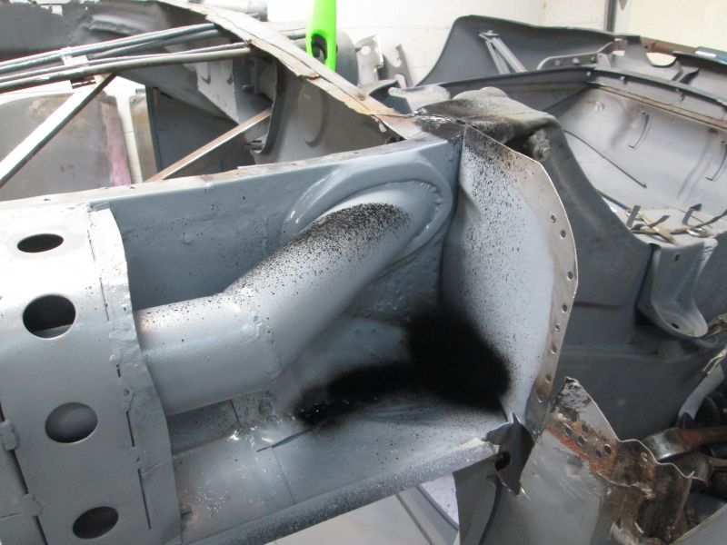

      A long road to get here but this cavity was finally ready for its sealer coats.
      Behind 3 solid coats of epoxy while checking for blind/bare spots as it went.

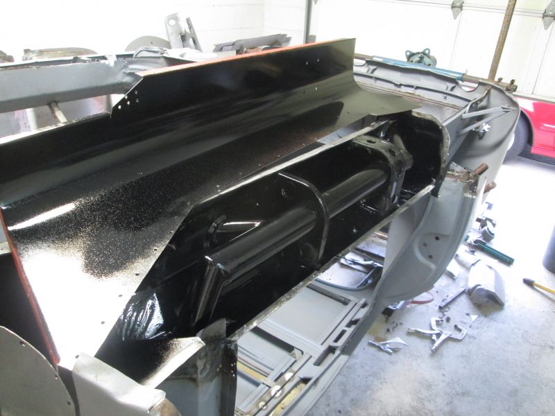

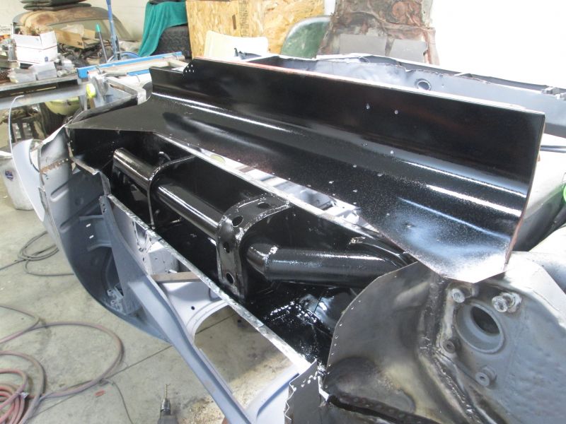

      The extra was poured straight down into that hole for insurance. Begin squirting the final top coat of black here.
      Final top coat of black.

      Inner surface of the closing panel also
      Left to cure with only plug weld holes left to add.
      Holes punched and mating surfaces cleaned. She was finally ready.
      Set screwed into position for the last time.

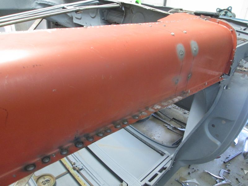

      Ready to begin laying down my first series of plug welds starting at the center.

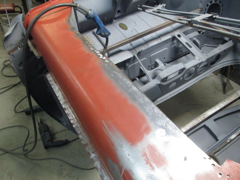

      At long last I was welding it on.
      I'd weld a series then grind them down so it was such a bore. A lot holes to fill and dress.
      Threshold flange fully welded and dressed along with the attachment plugs to the twin bulkhead assembly.

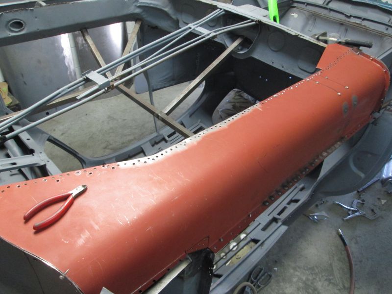

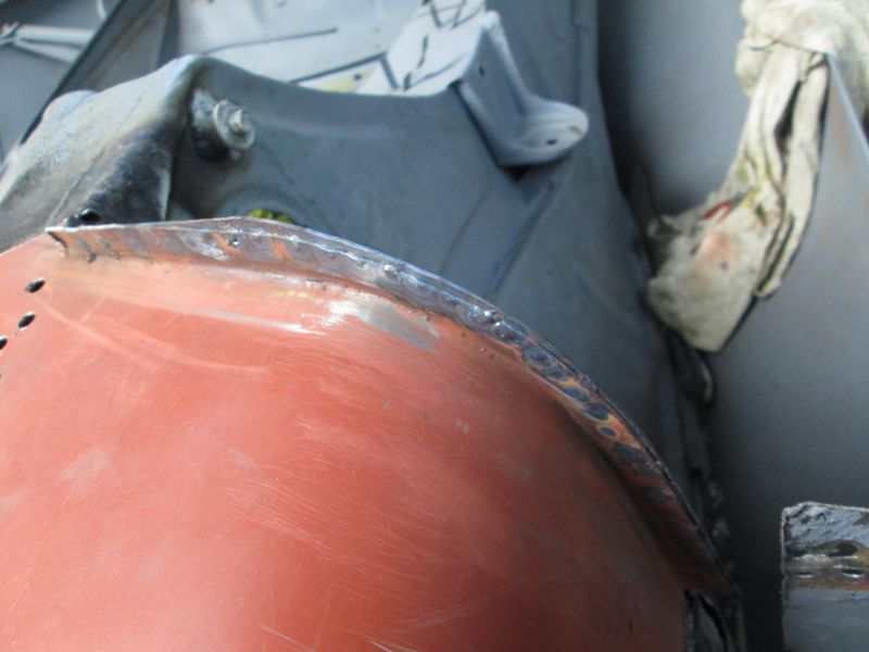

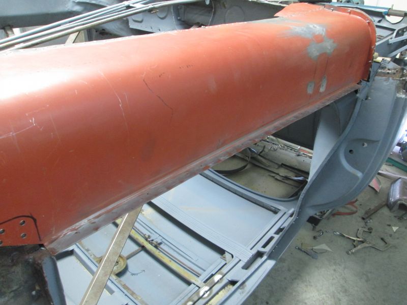

      Quick test fit with the rocker just to see and make sure. It fits and clears fine. Onto the next series of plug welds next.

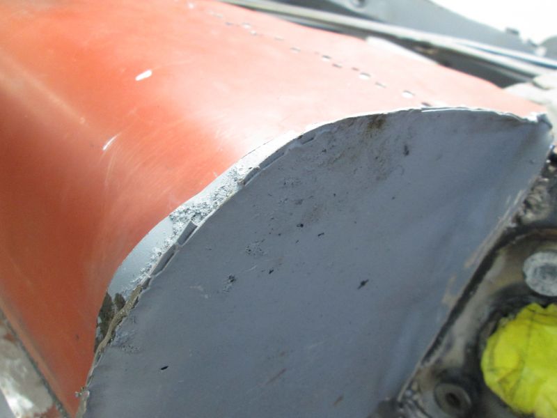

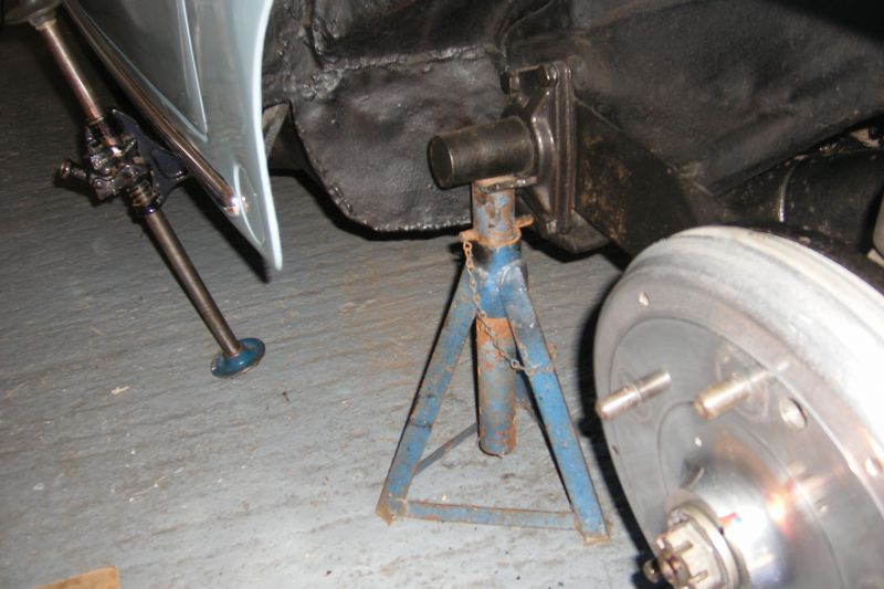

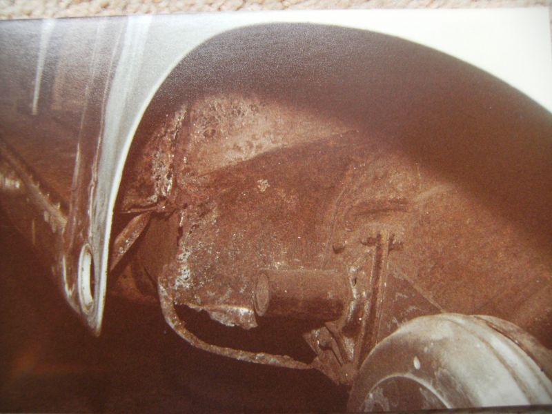

      • I did find a couple of old photos showing the removal of the L/side rear longitudinal end capping rust damage ready for welding in Dec 1976. ( You will notice the raised area has been cut out and I left the shape of the large radius for me to copy. I know now of course a cardboard template would have been better!)
        The other photo taken in 2009 when I started a rear brake overhaul shows the repaired end capping thirty three years later still looking okay and still the same today the rule though of dry driving does apply.
        Now truthfully back then I had a full gas welding kit but no special disc grinder to grind back the welds underneath the car. In fact I thought bit more strength why make it smooth.
        The work standard today is so much higher than all those years ago.

          Plug welding and dressing continues.
          Getting close to buttoning this up.

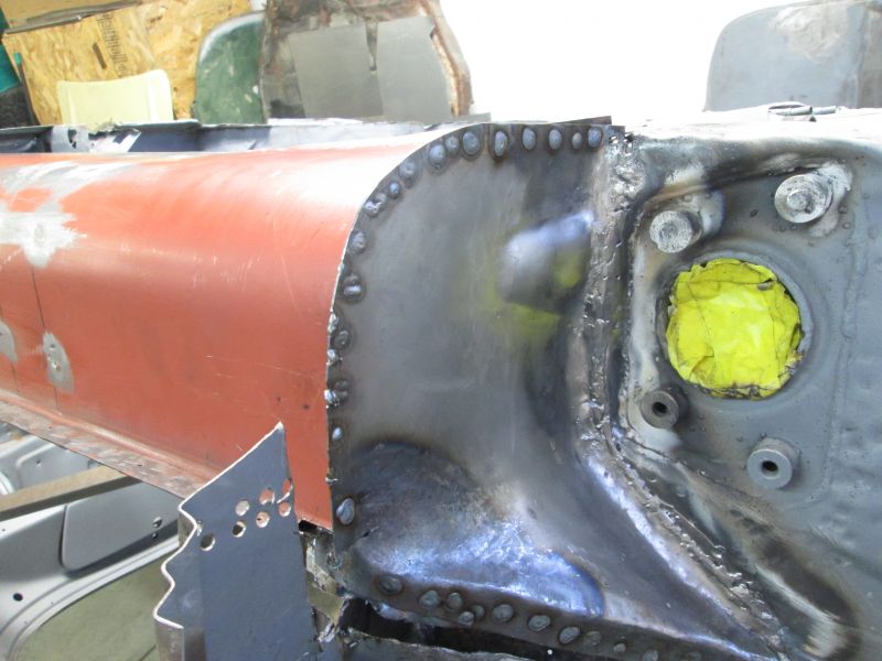

                              Gas weld detail replicated at the forward junction.

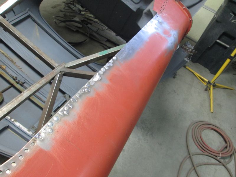

                              The rest of the run after it was now finally fully dressed. I left alternating set screw holes open in anticipation for the eventual floor pan. Why drill for these twice. One of those things you pick along the way. So out of character for me to be thinking that far ahead. but I actually did this time.

                              Moved onto plug welding up the back.
                              All plugs fully dressed and ready for final finishing detail.

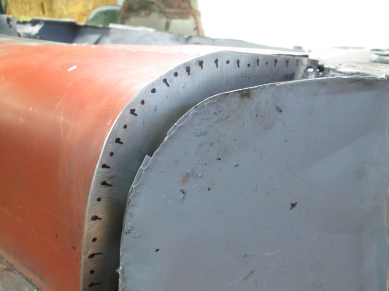

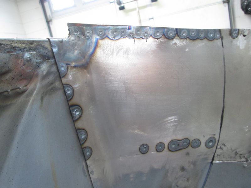

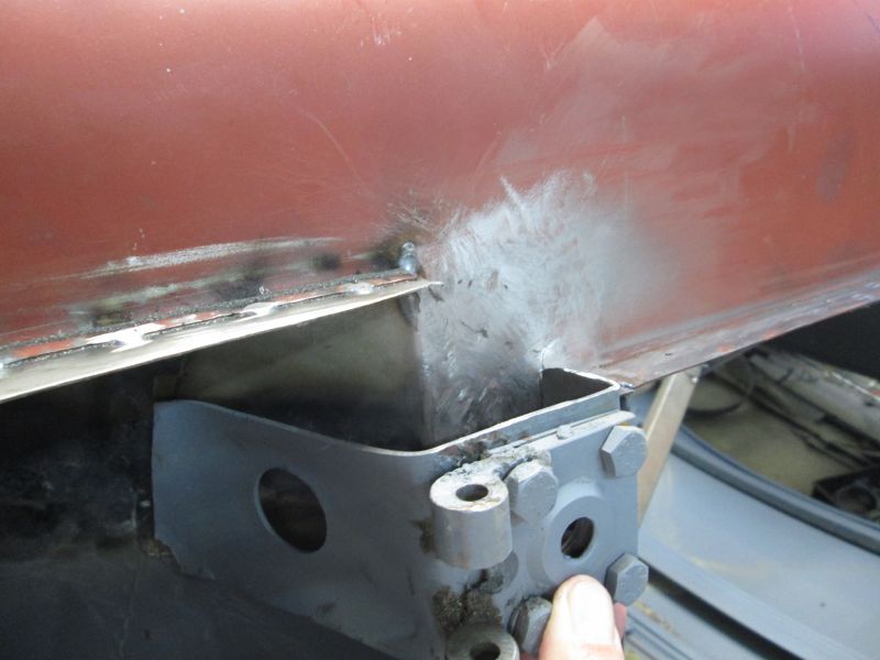

                              On my early T1 there where no plug welds here; the flange was fused at the edge instead. As you can see the edge on a T2 was left very raw and the two were spotted together.

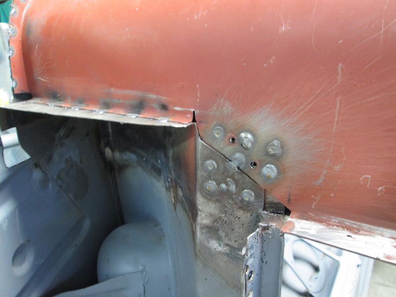

                              This T2 detail will be replicated with my old panel spotter.
                              Spot detail complete. Very close together and numerous as the original shows.
                              Flange edges where not perfectly uniform with each other and this was also replicated.

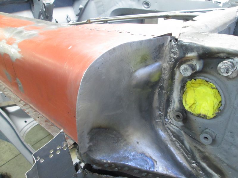

                              Front spot weld details were next. Frequency and spacing also replicated to continue the look off the original panel above this patch. Again the mating flanges where not perfectly uniform with each other up here either.

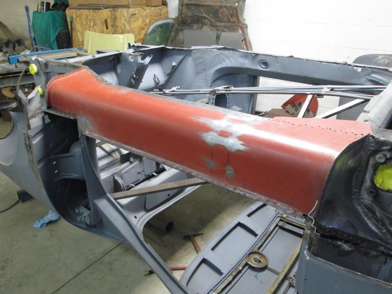

                              Right longitudinal just about completely welded and finished.

                              Rear inner run and corner are all that remain.

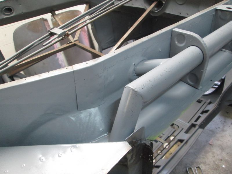

                              Time to start adding on more parts like the jack spur.
                              Good initial fit but some flange shaping and trimming yet to come before its ready.
