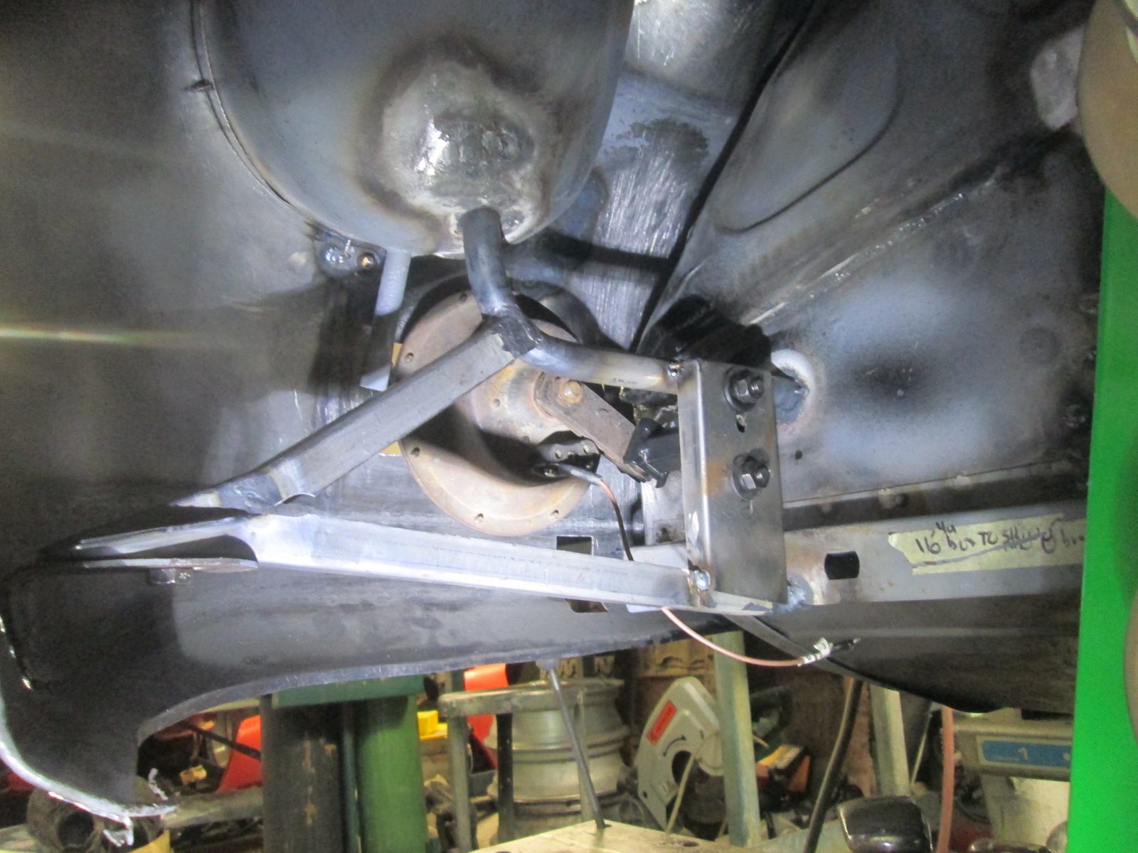

      • Right fender brace installation complete.
        Click image for larger version  Name:	IMG_2773.jpg Views:	0 Size:	207.2 KB ID:	116378 Gas weld around the neck of the conduit sealing up the bucket. Leaving the plug welding around the headlight bucket for last in case there are any last minute adjustments that need to be made.
        Click image for larger version  Name:	IMG_2838.jpg Views:	0 Size:	231.9 KB ID:	116379 At the opposite end, the edges of the tube and flared hole in the box wall were fused around their edges as originally done.
        Click image for larger version  Name:	IMG_2772.jpg Views:	0 Size:	217.5 KB ID:	116380 Then it was onto the last two pieces of the puzzle. A full horn mock up would be needed to set and locate the base mount in its best position. The upper brace run was now a bit short with the new conduit. A small backfill extension in process of being added here. Dialing in the final needed length.
        Click image for larger version  Name:	IMG_2776.jpg Views:	3 Size:	209.4 KB ID:	116381 Upper brace lengthened and ready to go back on for good. Once this was tacked in the horn mock ups were next to set the base mount.
        Click image for larger version  Name:	IMG_2777.jpg Views:	3 Size:	211.7 KB ID:	116382 Right side fender brace completed. Horn mount set in its best position with gas welds replicated as my original reference shows. So much easier and cleaner to build this brace in the car to suit versus trying to wrestle a preassembled unit in to fit like it should. I missed a weld here BTW. The upper brace weld should be solid all the way around the conduit. I'll have to go back and weld up the center of it.
        Thanks for looking.

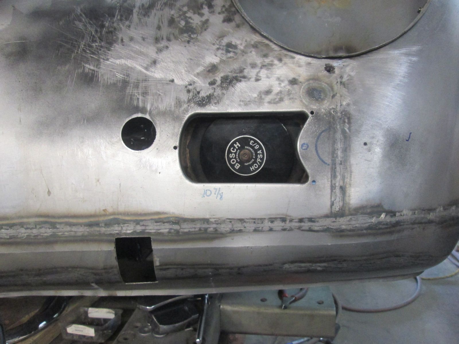

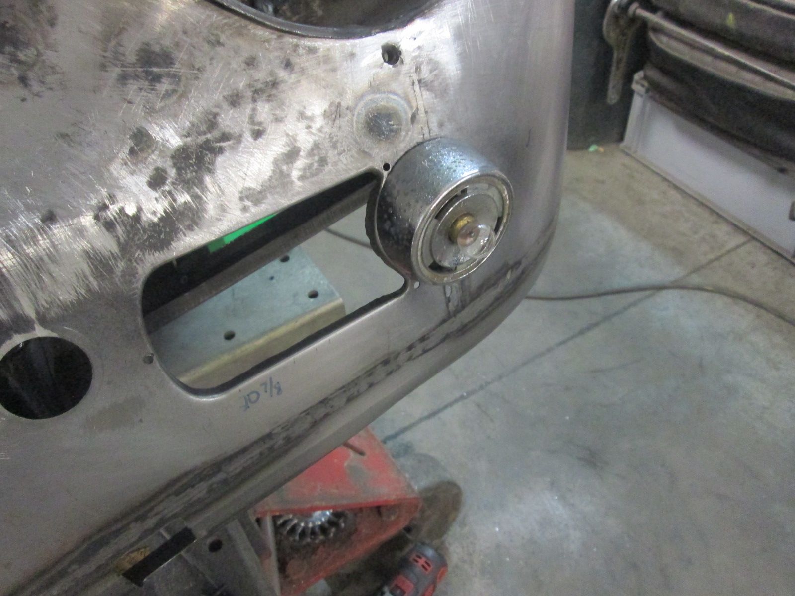

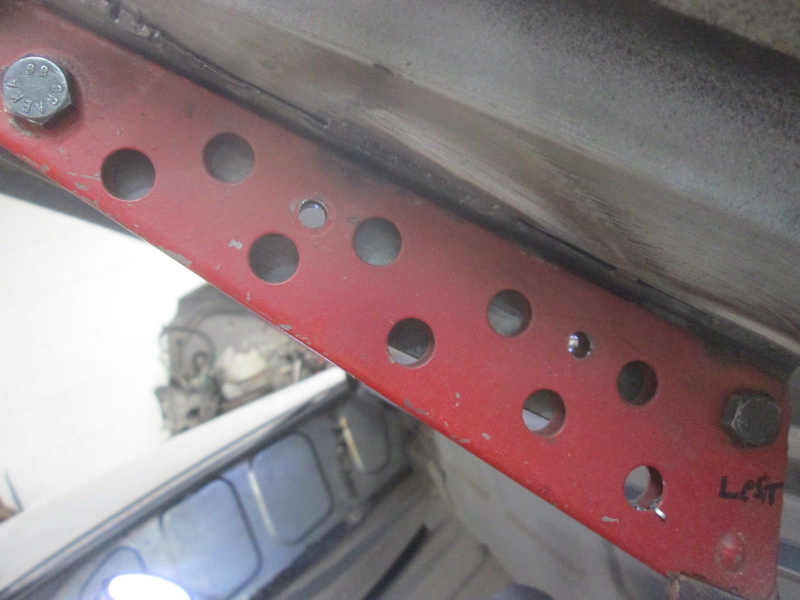

        • Click image for larger version  Name:	IMG_2778.jpg Views:	0 Size:	226.4 KB ID:	116390 Last confirmation fit after all the welding. Horn clears the bucket and battery box.
          Click image for larger version  Name:	IMG_2780.jpg Views:	0 Size:	184.2 KB ID:	116391 Horn sits level...
          Click image for larger version  Name:	IMG_2762.jpg Views:	0 Size:	196.6 KB ID:	116392 and is centered in the window.
          Click image for larger version  Name:	IMG_2781.jpg Views:	0 Size:	234.2 KB ID:	116393 Then it was onto one more confirmation fit for seal clearance with the ring before plug welding.
ID:	116394 Last little job on this side of the nose after the bucket plug welds was opening the holes for the turn signal.
          Thanks for looking.

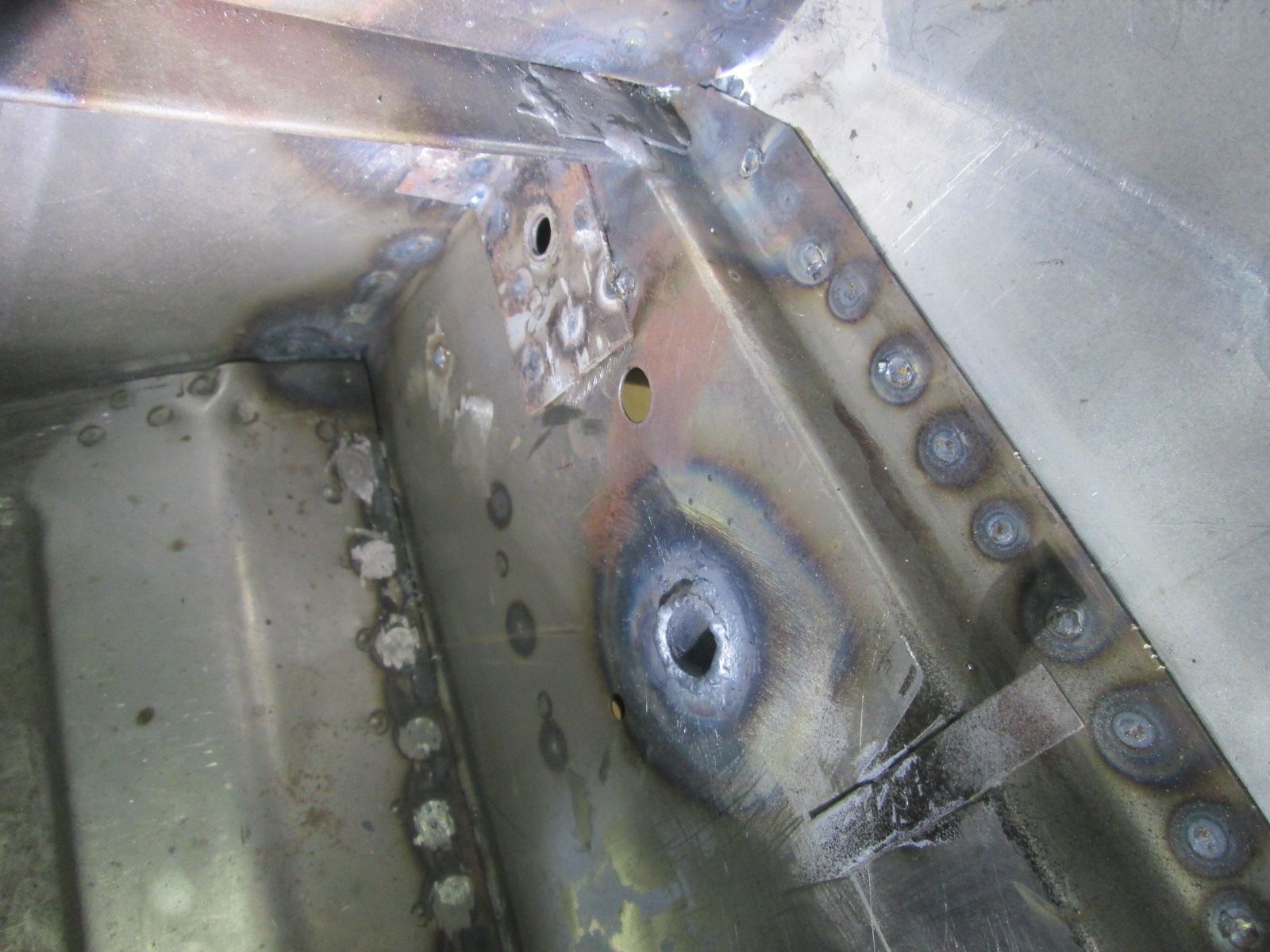

            • Click image for larger version  Name:	IMG_2787.jpg Views:	0 Size:	216.1 KB ID:	116409 Socket hole is slightly smaller but no clearance issues with it or the boot.
              Click image for larger version  Name:	IMG_2789.jpg Views:	0 Size:	197.0 KB ID:	116410 Right side metal work chores completed.
              Click image for larger version  Name:	IMG_2790.jpg Views:	0 Size:	203.0 KB ID:	116411 Moving back over to the left side to prep the bucket for final installation.
              Click image for larger version  Name:	IMG_2792.jpg Views:	0 Size:	245.5 KB ID:	116412 Before the bucket goes in I had to finish picking and filing the weld joint. I had to be able to reach in through this opening for direct access to the back of this weld joint to have any shot of getting it even close to uniform.
              Click image for larger version  Name:	IMG_2793.jpg Views:	0 Size:	190.9 KB ID:	116413 Slowly working my way over the top.
              Thanks for looking.

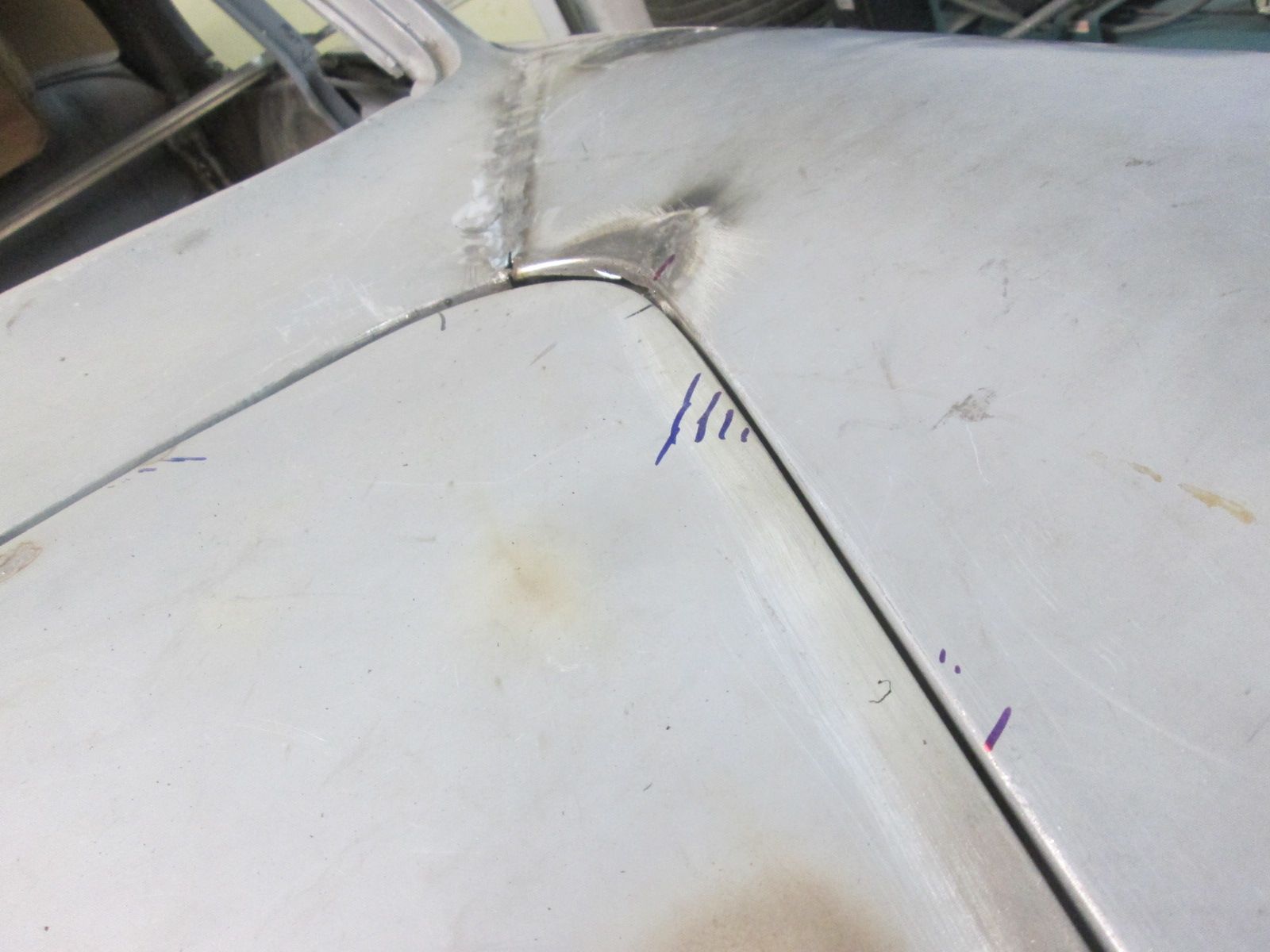

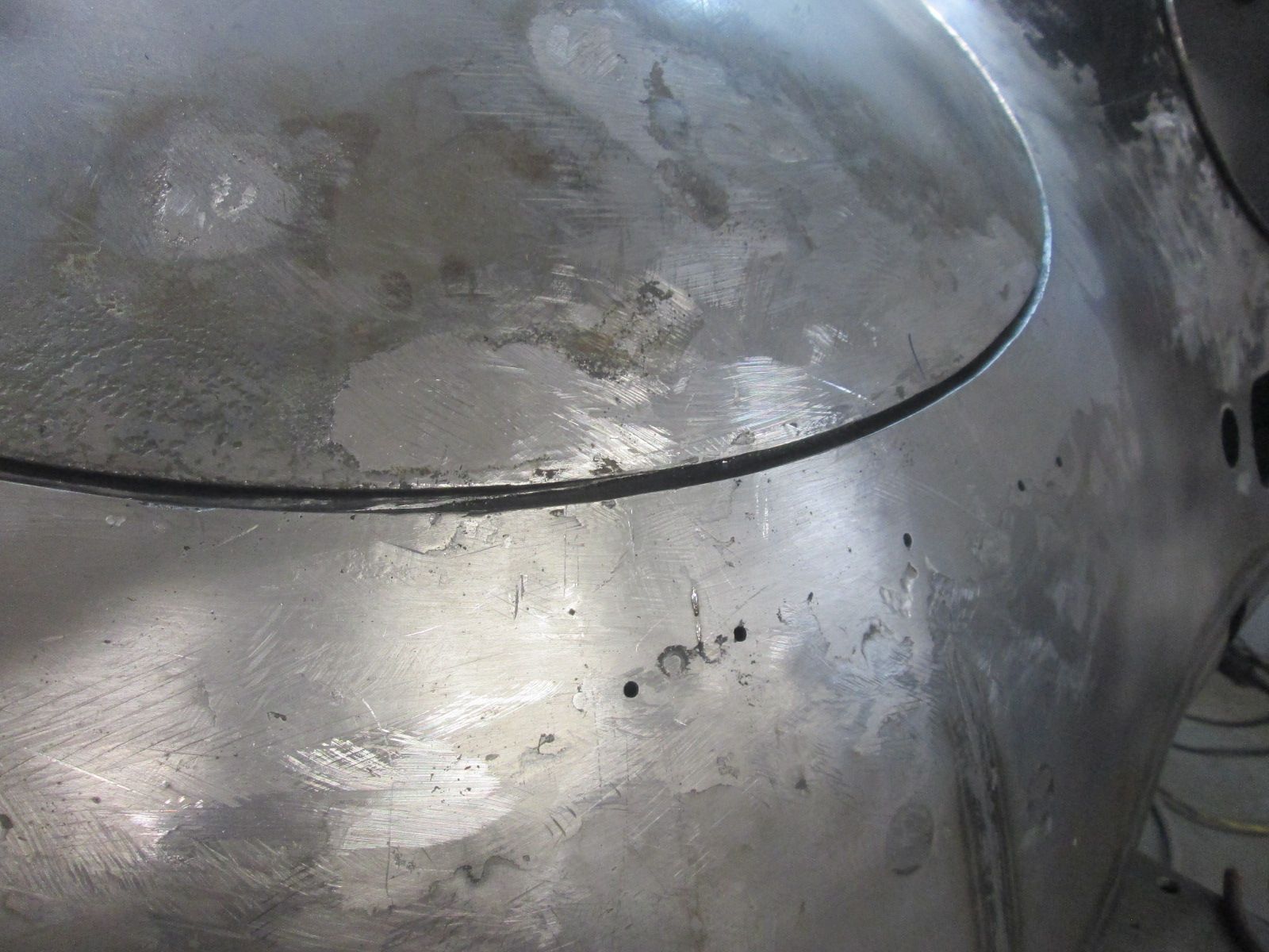

              • Smoothing out the big weld joint:
                Click image for larger version  Name:	IMG_2794.jpg Views:	0 Size:	217.7 KB ID:	116424 Making my way up and over the top of the fender with small improvements to the surface with each pass.
                Click image for larger version  Name:	IMG_2795.jpg Views:	3 Size:	204.2 KB ID:	116425 Once I get down to the nose's horizontal weld joint access through the headlight opening won't be necessary . The wheel well opening provides the best access from there on down.
                Click image for larger version  Name:	IMG_2804.jpg Views:	3 Size:	208.8 KB ID:	116426 I'm dealing with old crash damage along with the welding heat distortion as I make my way down the side.
                Click image for larger version  Name:	IMG_2805.jpg Views:	3 Size:	169.5 KB ID:	116427 Fogged another tracer coat on but this area chased just about as far as I need. Pretty happy with the basic contour shape between these two panels.
                Click image for larger version  Name:	IMG_2806.jpg Views:	3 Size:	188.4 KB ID:	116428 A couple of spots that needed further smoothing down in here while that tracer coat dried. Getting close to bucket reinstallation time.
                Thanks for looking.

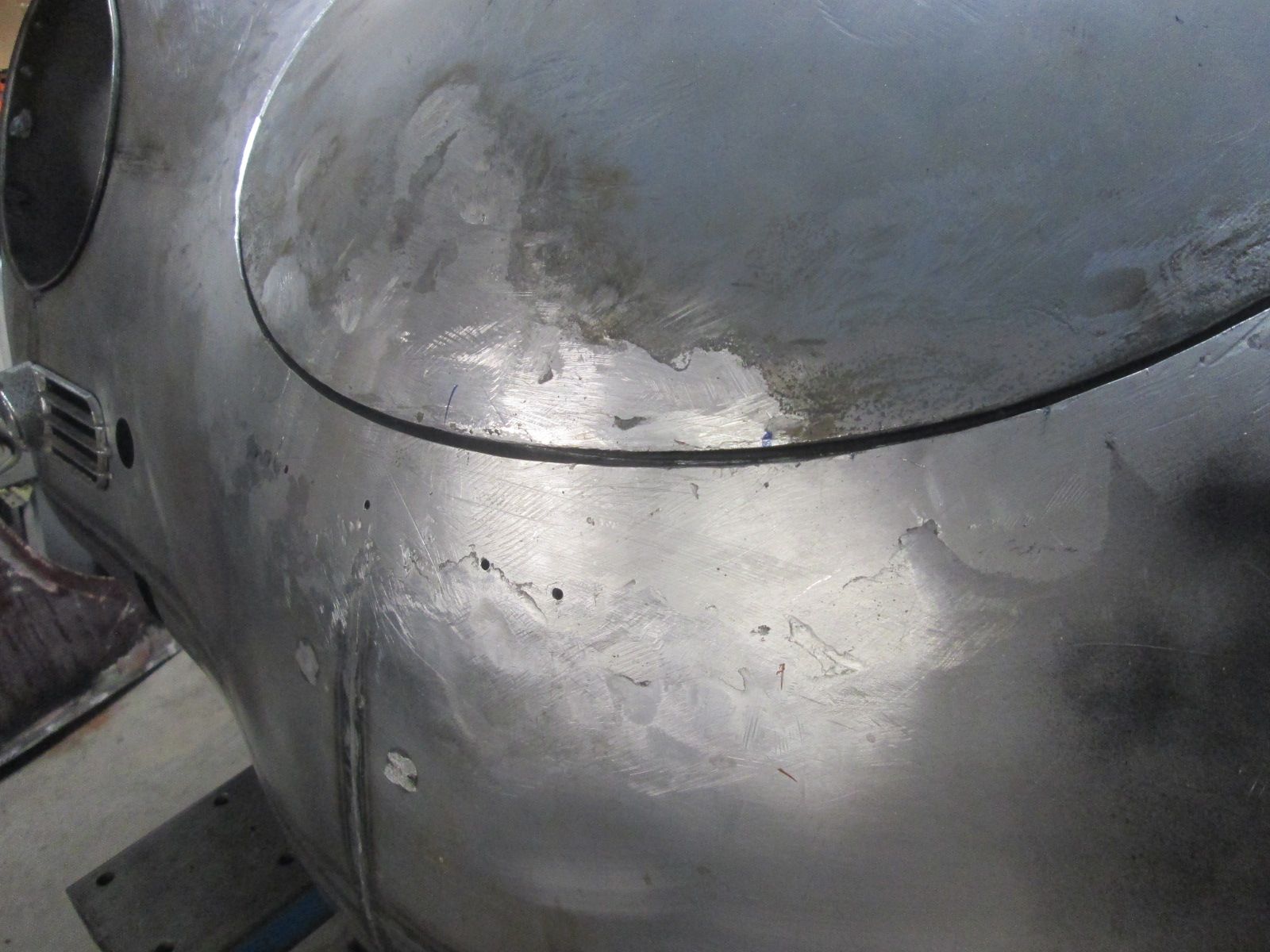

                • Left bucket repairs:
                  Click image for larger version  Name:	IMG_2807.jpg Views:	0 Size:	196.0 KB ID:	116436 More residual crash damage where it buckled and was beat in and is very stretched at this point. I thought about smoothing it before the bucket went in but found I have better access through the wheel well.
                  Click image for larger version  Name:	IMG_2808.jpg Views:	3 Size:	202.6 KB ID:	116437 Onto repairing the rust holes at the bottom.
                  Click image for larger version  Name:	IMG_2810.jpg Views:	3 Size:	221.6 KB ID:	116438 and then it was back over to the leading edge to get it back into shape.
                  Click image for larger version  Name:	IMG_2811.jpg Views:	3 Size:	186.8 KB ID:	116439 At long last the weld joint was finished to where I no longer needed access through the opening and bucket repairs completed. Ready to be reinstalled.
                  Click image for larger version  Name:	IMG_2812.jpg Views:	0 Size:	194.7 KB ID:	116453 The first try of course didn't go as planned. Slipped in fine and with just over an inch left to go it locked up tight on me. It was so close to seating that I didn't want to turn back as I thought it would still go eventually . A section of 2X4 was laid across bucket then smacked in the middle with a dead blow hammer at various heights. I thought I was getting somewhere but soon realized I was deforming its lip and also creating a bend to the opening between the 6 and 9 o'clock area. I was now all done, out it would now have to come out to fix the buckets lip, restraighten the nose opening, relax the shoulder opening and fix the damage I was doing to the bucket itself from the extraction. The slide hammer was bit harsh but no other way. This all quickly snowballed into a real mess.
                  Thanks for looking.

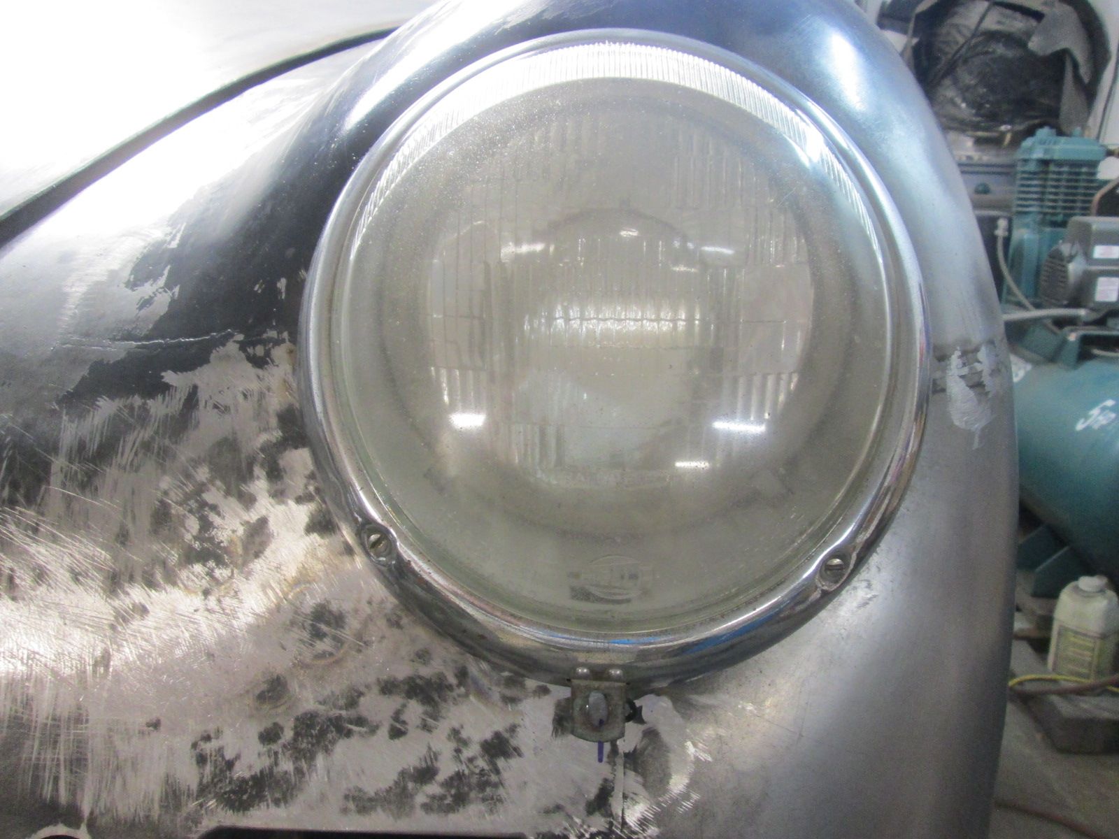

                    • Left headlight bucket second installment attempt with a small adjustment needed.
                      Click image for larger version  Name:	IMG_2822.jpg Views:	3 Size:	215.9 KB ID:	116480 Heated and hammered the openings shoulder down to relax it slightly throughout where it had bound up and then bent.
                      Click image for larger version  Name:	IMG_2823.jpg Views:	3 Size:	212.9 KB ID:	116481 Followed with a light filing to clean up the edges. Now ready to try another installation attempt.
                      Click image for larger version  Name:	IMG_2824.jpg Views:	3 Size:	201.7 KB ID:	116482 Bucket restraightened and fully seated into position here. The earlier relief shaping turned the trick. The fitment was still tight and positive but thankfully it went all the down without binding causing damage to it or the nose from the amount of force required to get it there.
                      Click image for larger version  Name:	IMG_2825.jpg Views:	3 Size:	242.1 KB ID:	116483 Headlight test fit with the bucket installed. A slight orientation issue cropped up. The new nose came with mounting holes predrilled. I assumed Trevor uses these for sight marking and jig points. I didn't question their location and proceeded to weld in a capture nut several weeks back. Now that bucket is in their is no wiggle room and the predrilled hole location is tilting the light slightly giving it a sideways glance attitude.
                      Click image for larger version  Name:	IMG_2826.jpg Views:	4 Size:	232.3 KB ID:	116484 With just a slight rotation to the middle all is right with the world. You can see half of the original hole peaking just outside of the mount tab. No choice, I had to relocate this hole. Just better than the width of the mounting bolt itself. Only a little off but making too big of a visual impact to leave alone.
                      Thanks for looking.

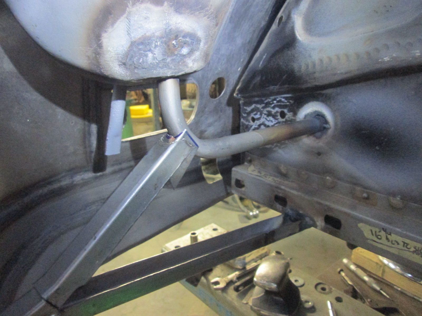

                          • Left side conduit install.
                            Click image for larger version  Name:	IMG_2840.jpg Views:	3 Size:	227.8 KB ID:	116533 Conduit installed. Onto adding the upper brace back in. In process here of fitting a filler section to its end.
                            Click image for larger version  Name:	IMG_2844.jpg Views:	3 Size:	229.0 KB ID:	116534 Then onto locating and installing the horn mount. Last detail out here is punching the holes for the turn signal light.
                            Click image for larger version  Name:	IMG_2845.jpg Views:	3 Size:	228.1 KB ID:	116535 Upper brace runner fully welded back in. Horn mount tacked in its best adjusted position.
                            Click image for larger version  Name:	IMG_2838.jpg Views:	3 Size:	231.9 KB ID:	116536 Finished fusing the ends of the conduit to the insides of the battery box walls as done originally.
                            Click image for larger version  Name:	IMG_2848.jpg Views:	3 Size:	217.2 KB ID:	116537 Moved back to the outside to punch those holes for the turn signal light. Running outof things to do on this left corner finally.
                            Thanks for looking.

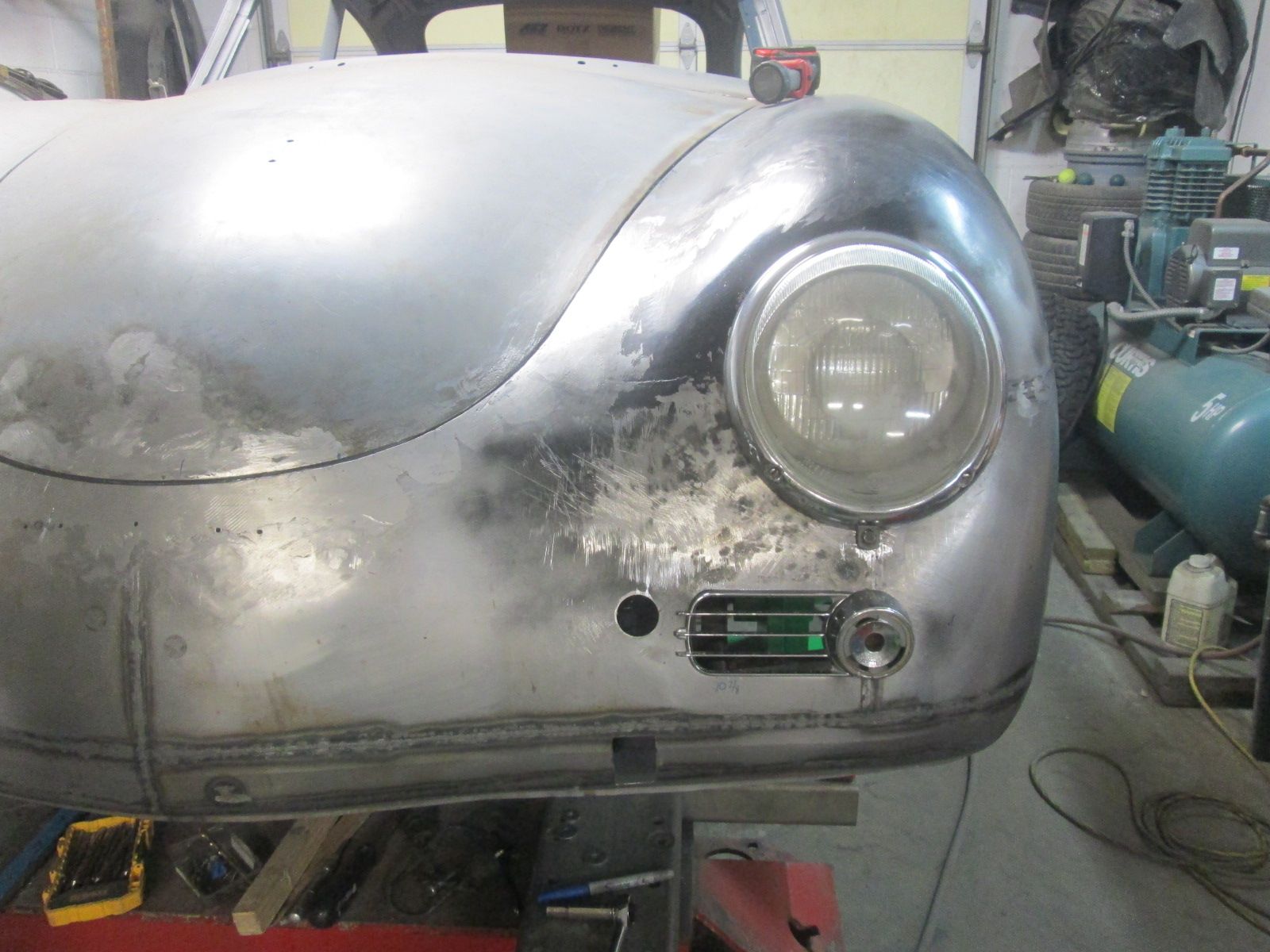

                            • Nose work completed.
                              Click image for larger version  Name:	IMG_2853.jpg Views:	0 Size:	213.4 KB ID:	116554 All the holes drilled and the brace/ horn mount set completing the remaining nose work.
                              Click image for larger version  Name:	IMG_2854.jpg Views:	0 Size:	239.0 KB ID:	116555 Some fine bodywork finishing remains up here
                              Click image for larger version  Name:	IMG_2855.jpg Views:	0 Size:	217.8 KB ID:	116556 but the hood is set in its final adjusted position.
                              Click image for larger version  Name:	IMG_2856.jpg Views:	0 Size:	185.3 KB ID:	116557 Redrilled the alignment holes in both hinges to locate and lock in this final adjustment.
                              Click image for larger version  Name:	IMG_2858.jpg Views:	0 Size:	154.5 KB ID:	116558 Moving to the back corner to begin those final repairs.
                              Thanks for looking.
