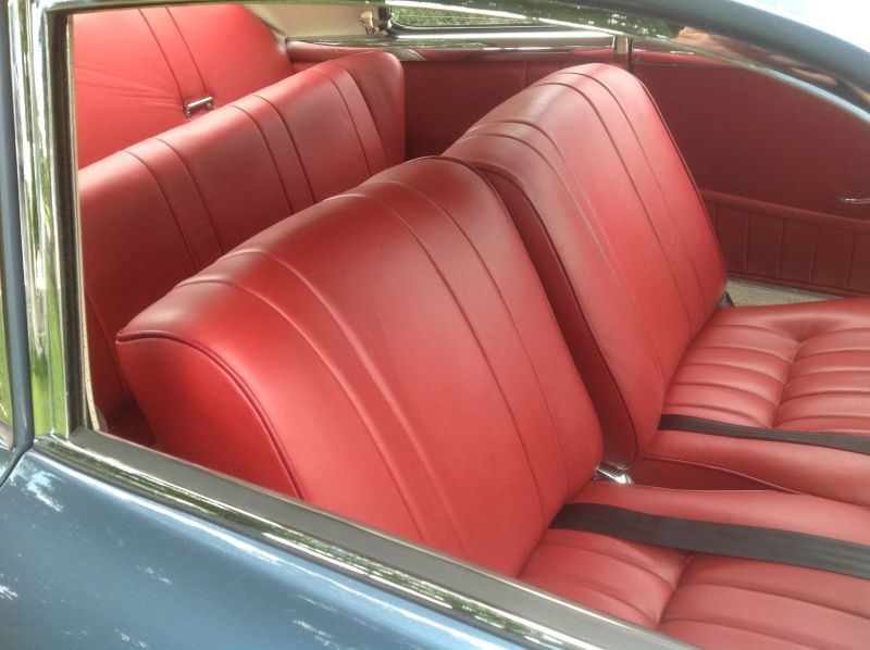

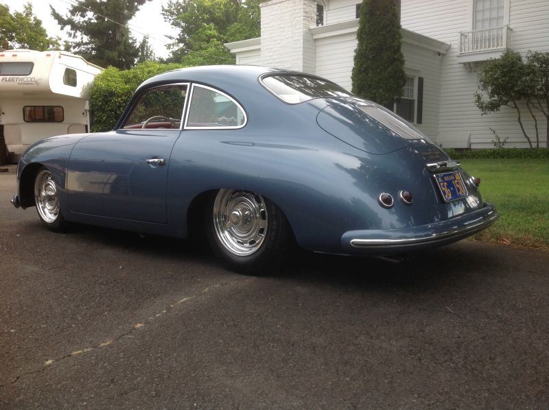

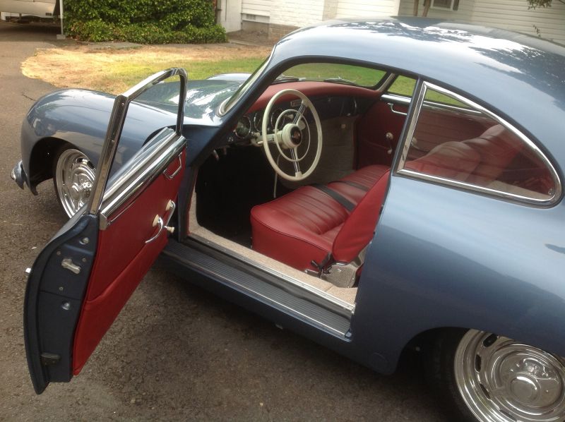

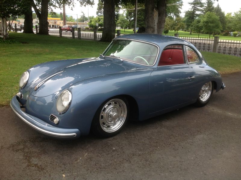

  • WOW Gordon, Unlike me, you really got this thing painted and back together in a timely fashion. It looks fantastic! I agree with John, the stance is really nice! How did you get the front to squat down so low? Is your interior now complete?
    • Thanks John and Justin. I have a set of dropped 2 1/2" spindles on the front. Its a bolt on part on early A's. Easy to take off if you want
      to go back to stock. Gordon

        Its lovely, the colour is so nice on a 356 it shows off the curves so well. Interior looks great too, as Justin says you have really done well getting that all together and looking good. I agree the slight alteration to the front to lower it,suits the car very well. I don't think you will revert.

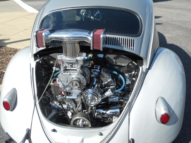

          NOW, 'IF' you wanted to take another step like this VW with a Blower on it!

          NAW-yer doing jus' fine!

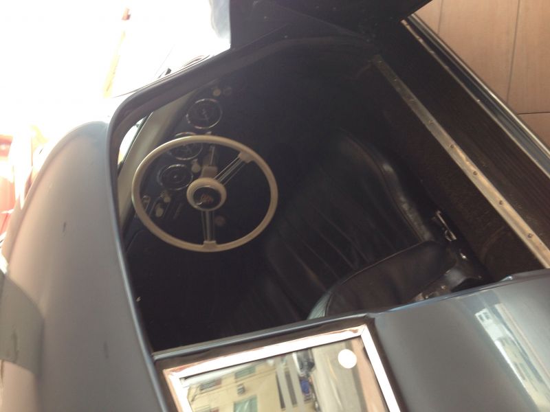

                    Gordon, I have a few questions,if you don't mind. I have a 56 too but the steering wheel my car came with is different. Am I having the wrong steering for my 356
                    • Your car looks amazing. Truly an inspiration.

                        Murugesh, your wheel is correct but you are missing the 'horn ring ' that shou;d be in the middle part of the wheel that you can see on Gordon's car. You must have a horn so I presume if you press the centre plastic Porsche emblem in the middle you get the horn to work??
                        But ... normally the ' push emblem' allows you to 'flash your headlights'
                        The horn rings are delicate and often are broken msybe thats why its been removed?
