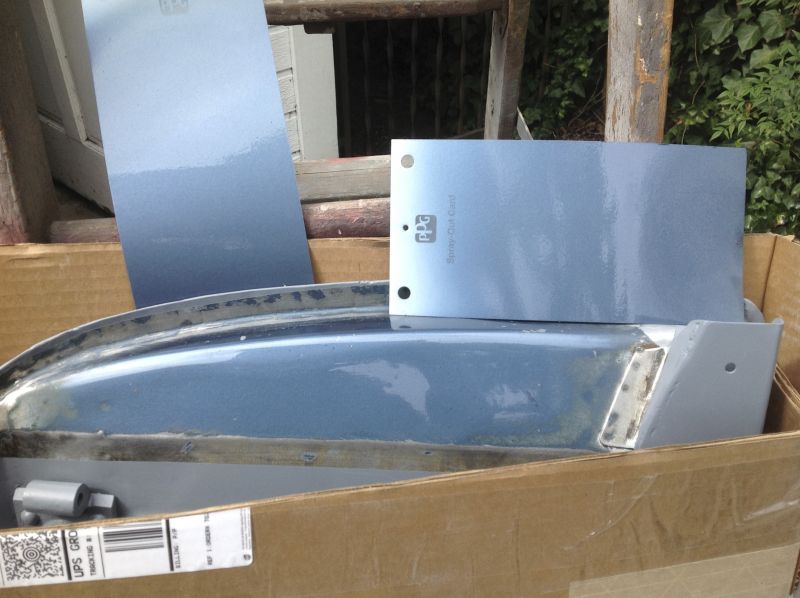

        • Gordon, great pictures! I am doing a T-1 with 5607 and gray. If you could tell me please what brand of paint through which you found Aquamarine metallic? I am having trouble with most vendors "getting it right" and while I spoke with John Willhoit about his sample and how close it is to my original sample and the car I am ready now to paint, he forgets which brand he used for his sample! I'll keep 'networking' until I get it right. I am at 7 samples from three brands now, and counting......
          Thanks,
          -Bruce Baker
          • Bruce, I used PPG two stage and was able to find a good original sample on the door
            which I buffed out and matched on the paint store computer.
            It came up with a GM color that was close and the computer adjusted from there.
            Hope this helps, Gordon
            Last photo is of the original paint and spray card with new color.

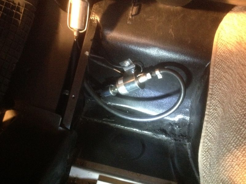

                      • I added an auxiliary fuel pump to aid starting after long periods of sitting and
                        I was pleased with the results.
                        I run the electric pump with a mini starter button and it takes only a few seconds
                        to fill the float chambers. This is nothing new but I thought I would post it anyway.

                        • Gordon,
                          I plan to do the same. Can you post the specs on the pump you used?
                          Thanks.

                            • John,
                              The brand is an Airtex E8902 and it is 6 volt with 2 1/2 to a 4 lb.
                              range. Comes with a pre filter ans 5/16 hose fittings.
                              Google it on the net for the best price.
                              The instructions want the discharge elevated from the suction end
                              to keep air from getting trapped. It runs nice and quiet.
