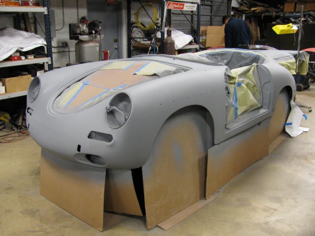

    With two coats of epoxy for a base I gave it three coats of polyester 2k hi build for
    Block sanding. It is starting to take shape.

    • #47
      Looking good Gordon.
      • #48
        Looking SUPER GKW!!

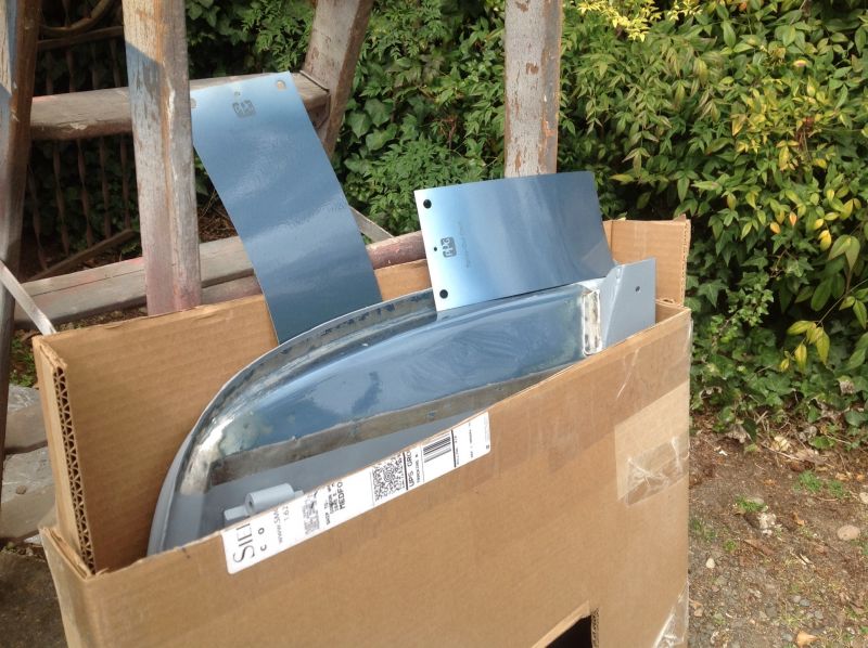

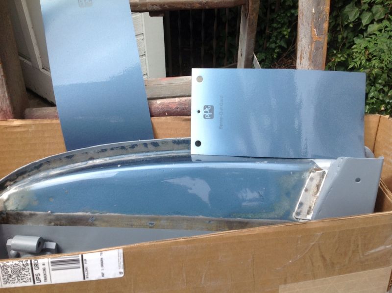

                  Sprayed a couple of cards to check the paint color and it is looking pretty close.
                  Hard to get exact because of the new base clears seem to kick up the metallic a little more
                  Intense. Tell me what you think.
                  Thank you, Gordon
                  • #54
                    Gordon, Are both cards sprayed with the same shade or do you have two different tints? There is some shadowing and angle of light maybe making the one on the right lighter than the left one. As far as the pics go the one on the left (darker) looks to be closer to your door. Is this what you are seeing in person? Justin
                    • #55
                      Justin, Both cards are sprayed with the same mix, the only difference
                      is one has 3 coats of base and one has 4.
                      I wanted to see how well it covered. Sometimes it is hard to tell
                      until you spray the clear. The Aquamarine blue met. looks light in the bright sun.
                      Thank you, Gordon
                      • #56
                        Looks a nice colour for your car Gordon.
                        • #57
                          I think its as close as you could hope for. Justin

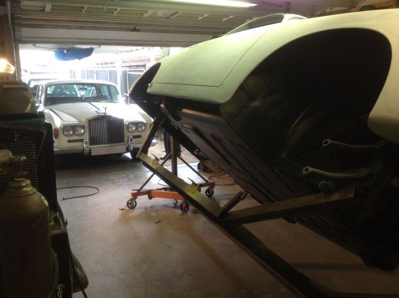

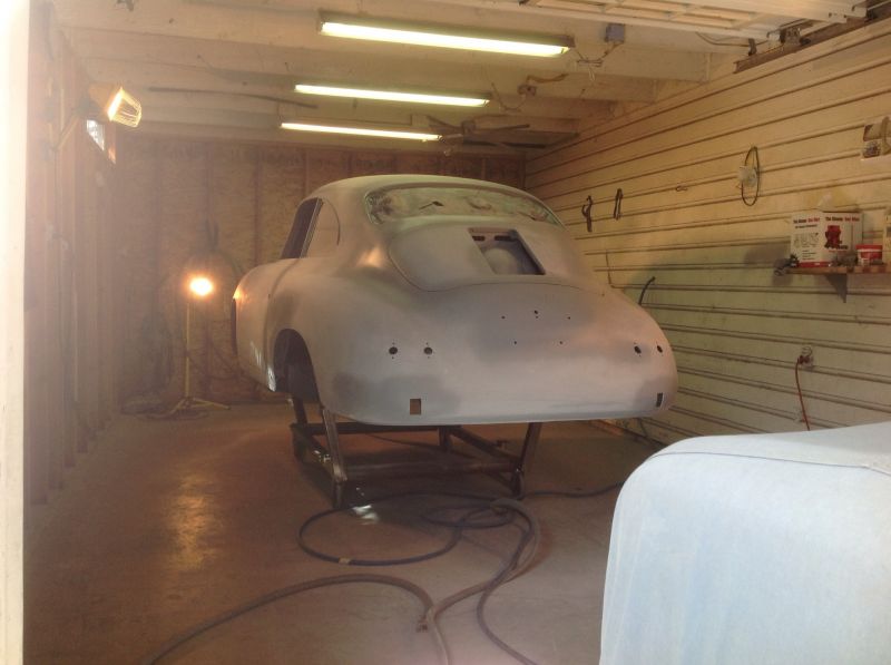

                            I finally had to break down and take the T-1 off the rotisserie so I could get to the front and
                            Rear a little better. I am still in the block sanding mode but I can see the end in sight.
                            Here are a couple of shots of the car on the ground.
                            This is a cart I made 3 paint jobs ago, it will do for one more time.
                            Thanks Gordon

                            • #59
                              Thanks for the update Gordon she's looking great! Getting it off the hoist is such a milestone isn't it? Congratulations! This body has not suffered collision damage? Will you be shooting the final color with panels installed or seperate? Man, Porsche, Rolls Royce this appears to be a very high end shop. Looking forward to seeing it in some color! Justin
                              • #60
                                I plan on shooting it with all the panels on.
                                I think I will have a better chance of metallic consistency.
                                Thanks, Gordon
