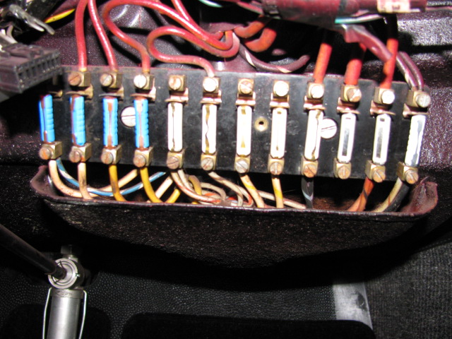

          I checked the 3rd fuse from the right that I think I'll tap from.
          Its labeled 'Supplementary Heat'.
          OK what is that?
          No electrical wire coming from the down side.
          So I don't think it is running anything!

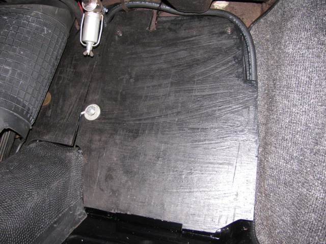

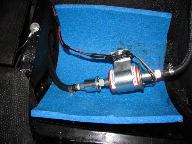

                • Gordon,
                  Thanks so very much for posting your AirTex Electric Pump installation.
                  The Roadster now sports one also, a Model E8011 6 volt version.
                  I road tested it today after fighting with a fuel weep for a couple of days on the supply end of the pump.
                  A couple inches of 'yellow' pipe thread tape fixed it.
                  I had to do some rerouting of the rubber fuel lines for the Roadster due to the shortness between the fuel cock and the hard fuel line that goes into the tunnel.
                  Not a big deal!
                  I used a momentary push switch that I got at Radio Shack and a 10 amp in line fuse.
                  For power I came off the 3rd fuse from the right of the fuse block which on my car is labeled as 'Supplementary Heat'-I don't have one of those and is has a 25 amp fuse that I don't use.
                  I also did not drill the forward panel of the passenger compartment to secure the pump.
                  I used a small piece of 'camping foam' to cushion any shock. with the hose attached and this foam base to cushion it the pump isn't going anywhere.
                  For the pump ground I used the 10mm bolt that is used to hold the passenger floor board in place.
                  This is the pump in place.
                  This is the passenger floor board back in place showing the routed fuel lines.
                  I did have to cut the top right side of the boards to make clearance for the fuel line, but they are not original boards since I made these many years ago when the originals rotted out.

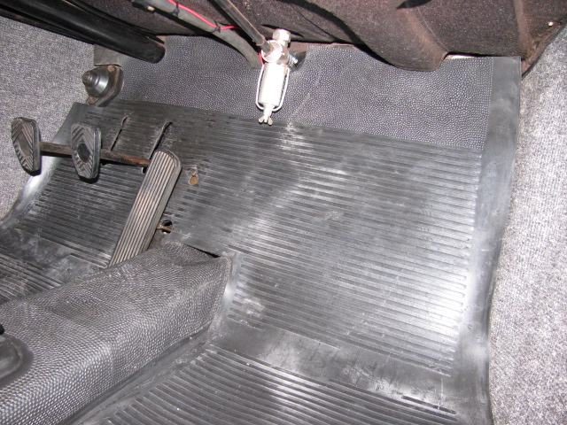

                  After it was installed, I pushed the Momentary Switch for about 5 secs and fired the car up.
                  The real test will come after it sets for a while to let the ethanol loaded fuel evaporate from the float bowls.
                  With the rubber mats in place to cover up and protect the lines from abrasion there is no noticeable deformation in that area.

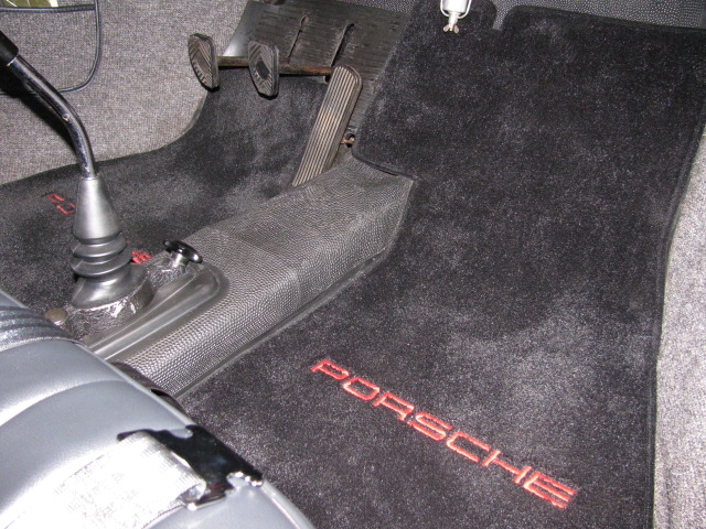

                  My Porsche Logoed carpets go on top of the rubber mats.
