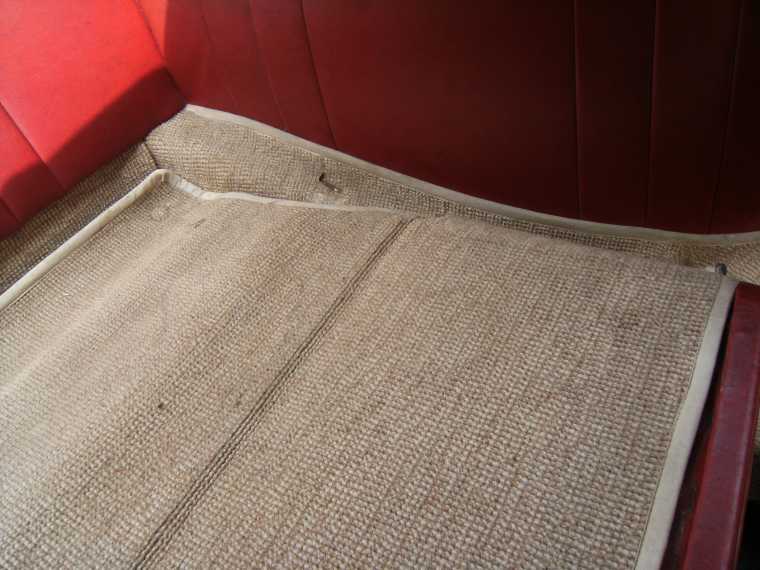

  • Thanks Justin,

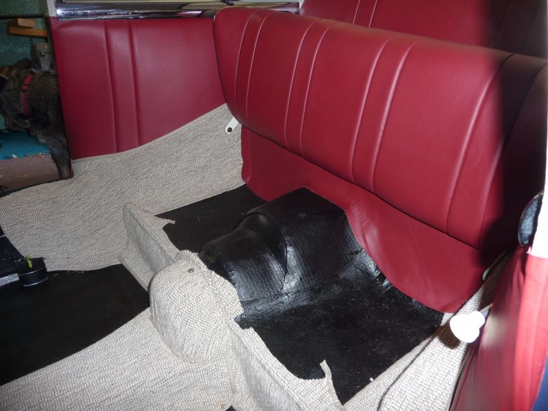

    The rear seat back is the only original part in the rear seat area that came with the car.
    I have it covered in red leather in the picture below.
    When the back is folded down there is a gap between back shelf and the seat back.
    What am I missing here? I used a carpet set from a 356 vendor for a T-1.
    Thanks Gordon

    • Nice Work Gordon! No, you're not missing a thing; pre-a and 356AT1 all had the open gap with the seat back down. Sometime in mid-57 with the T2 phase-in they draped over this gap with a train of carpet hanging from the seat back. Three snaps were installed at the foot of the firewall to secure the end. Here's a shot of Roy's T2 coupe:
      Additional details about this change can be found here:
      http://www.abcgt.com/forum/4-356-Forum/5072-Evolution-of-the-356A-T1--T2-How-they-differ.html?limit=6&start=36
      Keep up the great work, its really looking sharp!!

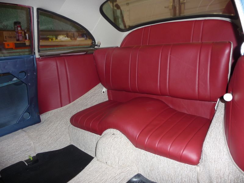

      • Rear area is getting closer. I don't know how any one could sit in the back seat.
        Thanks Gordon

              • Gordon,
                Really nice work. The back seats are fine for kids although nowdays they need seat belts. Back in 70's I took my mum and dad for a trip of about 2 hours. My mum decided to go in the back sitting across the seat with my dad in the front. When she got out took her some time straighten out!!
                I like your attention to detail. So many cars I see re-upholstered have carpet between the seat back and the seat bottoms. Vinyl or leather makes the transition look in my eyes so much better.
                Well done.

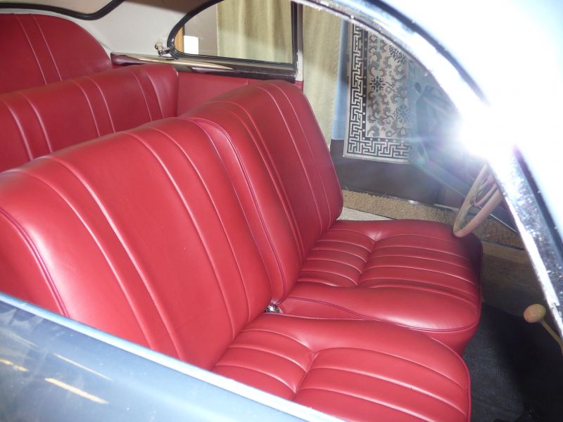

                • Seats are in for the last fitting . Working on the door panels now and will post them
                  when done. Thanks Gordon
                  • Looks very cozy in there Gordon! Beautiful job on this interior, the pleats look amazing!

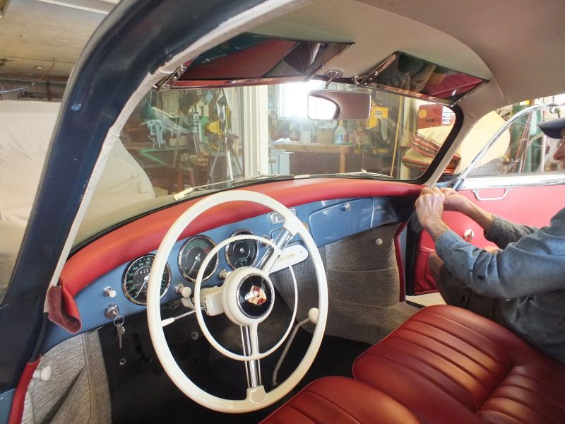

                    • Just installing the last bit of leather on the dash. The total job took three cow hides.

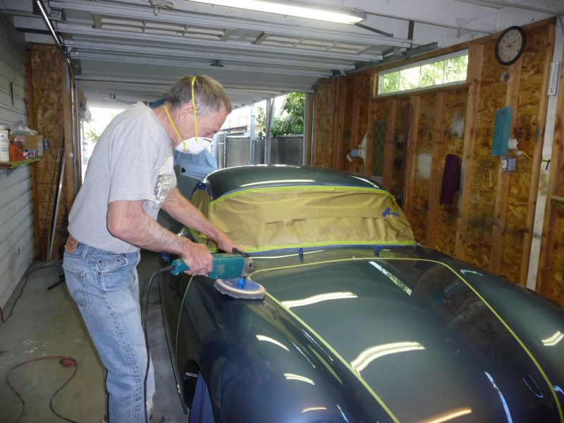

                      Final cutting and buffing. trizac 3000 and 5000 .
                      Thanks, Gordon

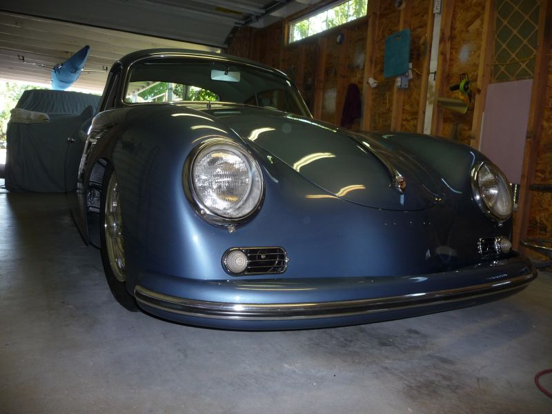

                            • Its getting close to seeing the light of day. Thanks Gordon
                              • Beautiful! Is the ride height lowered? Looks sexy
