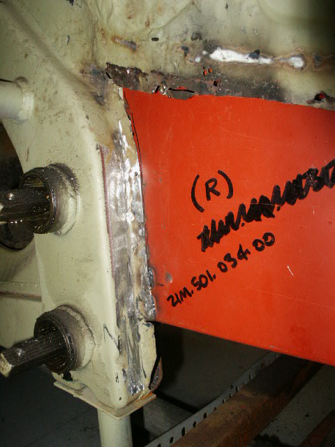

      This is a T1 Speedster in which a new simonsen wall was purchased. Back then I had no idea about a T1 to T2 variance. Once I had the side walls in, no way could I get this new wall as purchased to fit down between them squarely.
      As you can see the walls were in flush against the suspension horn so they weren't going any wider.
      I didn't want to do it but I eventually had no choice but to section it. Once I fitted it into my T1 coupe I was convinced that simonsens simply stamped this thing too wide. Then later, once I had a few T2 cars in front of me I realized that they were in fact wider. So in going back to what you were saying the lateral walls could very well be wider on a T2 as well. I never measured. I haven't heard of any complaints about these new walls being too wide for anyone else so they very well may fit perfectly into a T2 as built. I'll get some numbers next time I'm at the shop.

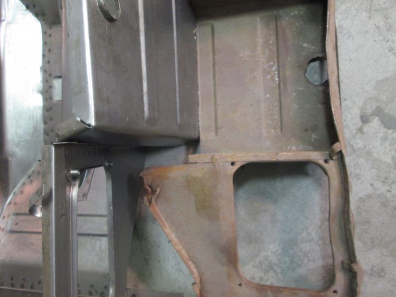

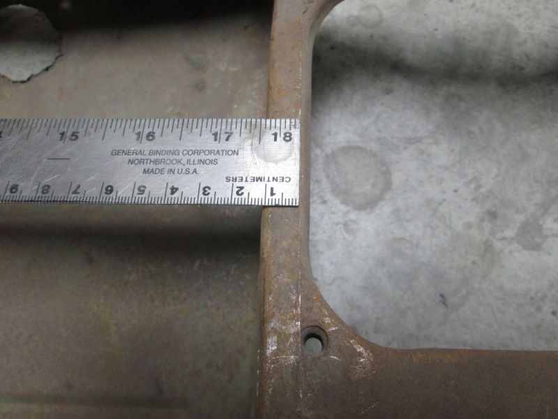

          • Okay Ignacio, I did several measurements and a bit of study and here is what I found:
            Overall width of a T2 battery box down between the side walls is approximately 28.5 inches. The overall width of my t1 battery box between the walls is approximately 28.5 inches...they are the same. It was a real brain teaser until I started comparing the lateral wall sections more closely.

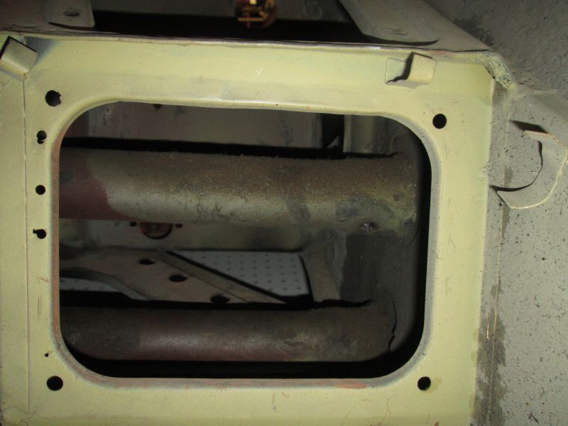

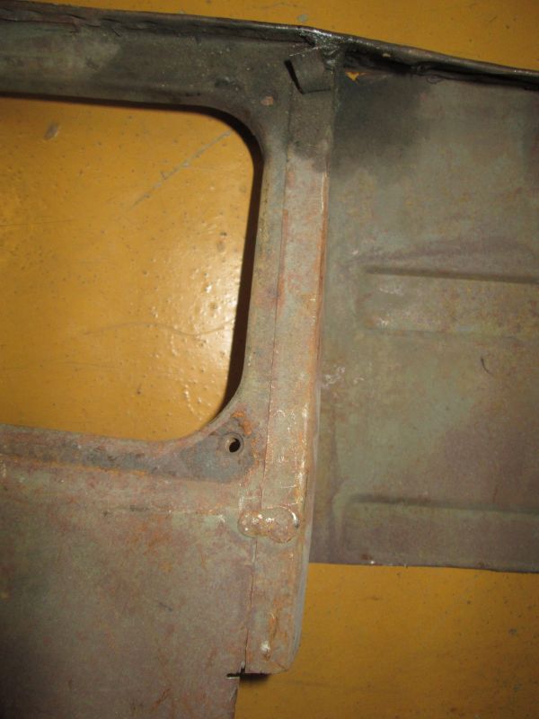

            This is an original T2 wall I cut out of a 58 coupe a few years back.
            Notice how the overlap flange really encroaches into the access cover bolt holes on this left side.

            The left overlap flange is much narrower too. Yet still almost covers the bolt holes.

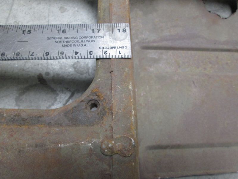

            The right flange is approximately 5MM wider with ample distance away from the holes.

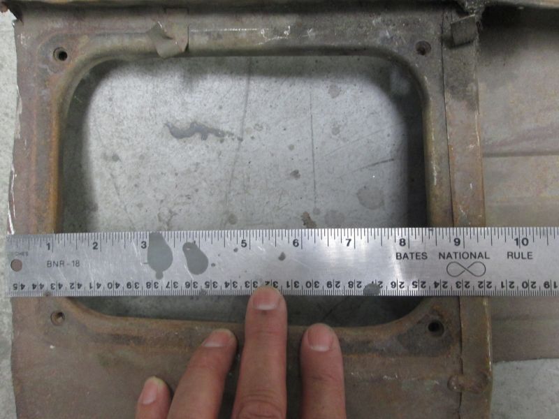

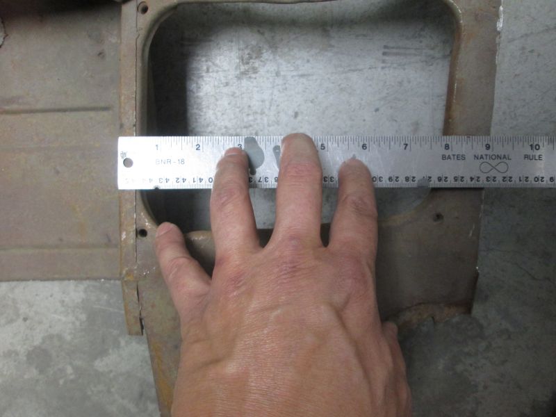

            Overall distance of the right access cover wall is about 9.5 inches for this T2 and my T1. When I cut this wall free it was at the flange so we're only missing a MM or two.
            Overall distance(please excuse my hand) on this T2 left side is 9 inches even. Overall distance on my left T1 side is 9.5 inches.

            T2 walls are built asymmetrical. The left side only was narrowed to accommodate the added 1/2 inch of width to the center.

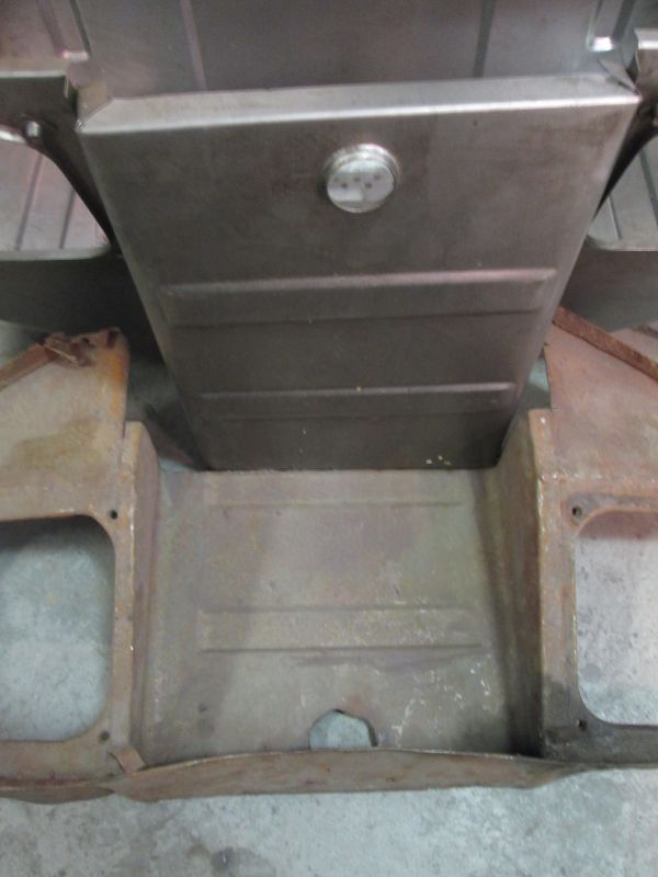

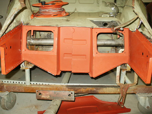

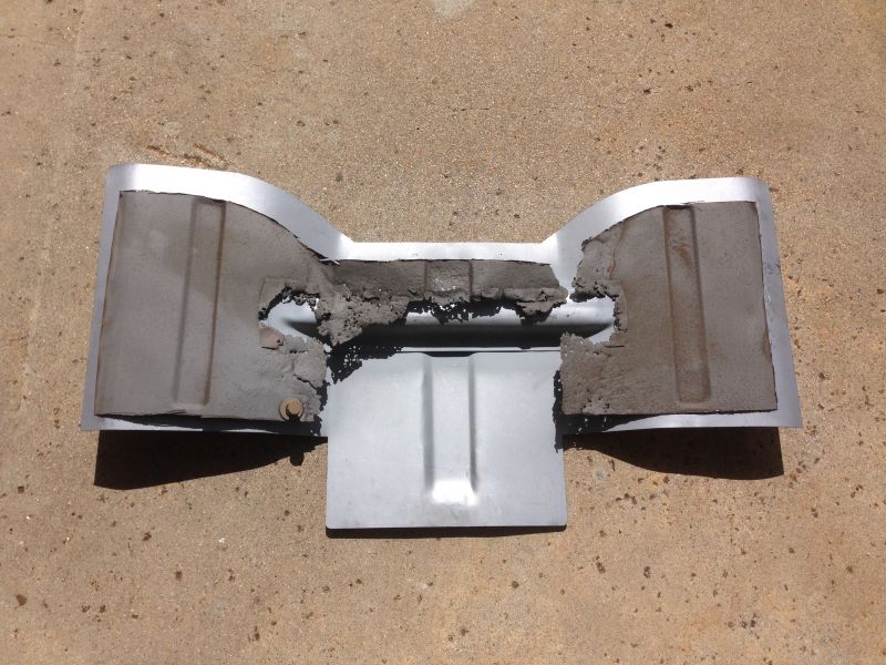

                  • Ignacio, FYI: I took delivery of this battery box assembly from Trevor Marshall last week.
                    It was ordered for a T2 application
                    But as you can see Trevor builds the T1 version. If you haven't purchased from simonsen contact Trevor about this wall and save yourself the modification that might be required otherwise. His quality is excellent.

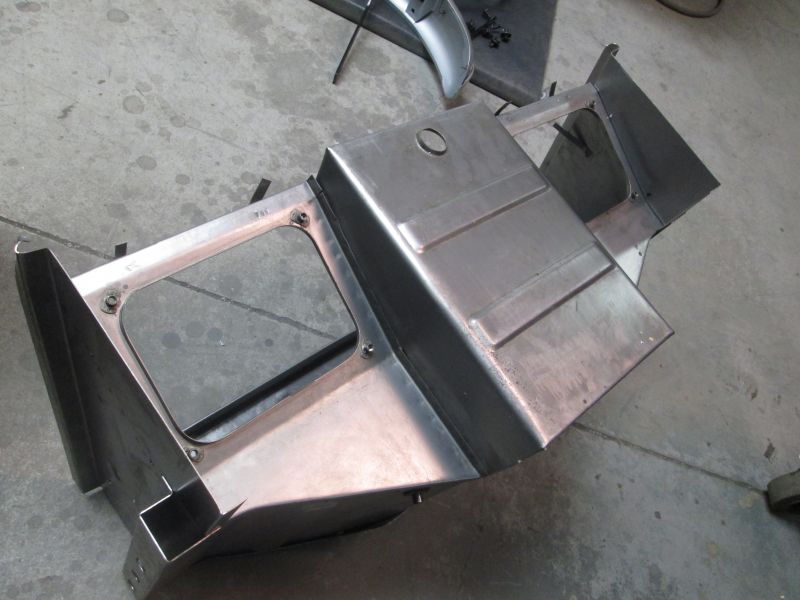

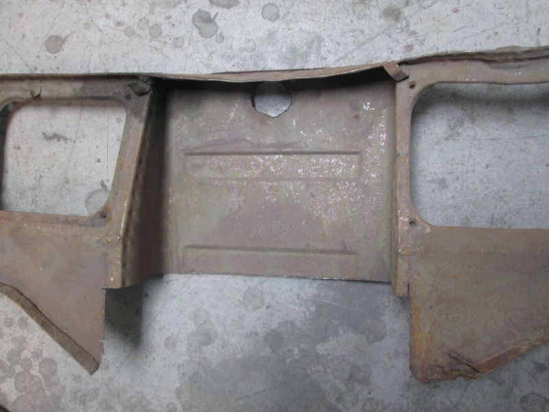

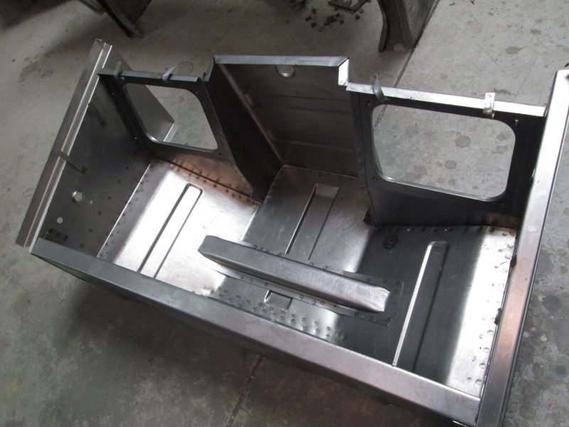

                        Hi Ignacio, It was ordered for a '59 and is supposed to be for T2 as it has the center embossed Rib found on the T2 floor which also gets the tow hook.
                        However his center battery recess section is the narrower T1. The owner wants this detail correct so this OG T2 center section will be grafted in its place.

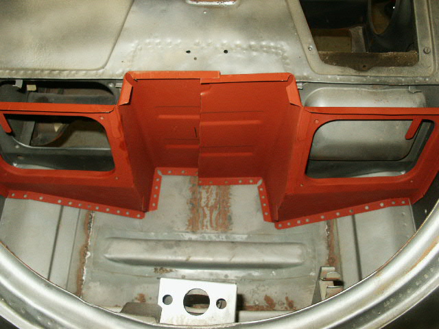

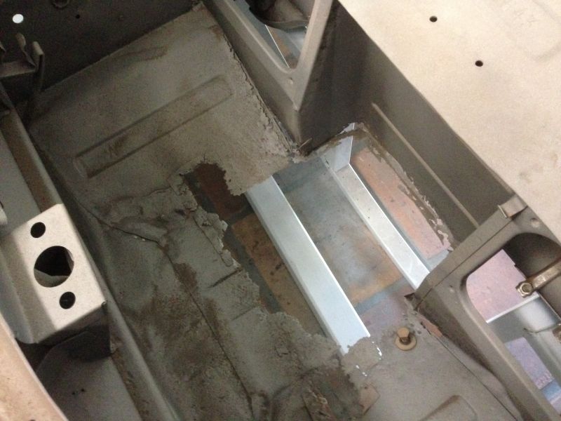

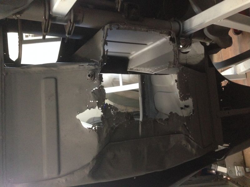

                          Just to add a detail here. My T1 Coupe (six digit VIN/Chassis car) had the center rib under the cross brace. I believe that it has been said that all T1's were flat on the bottom floor and no rib under the cross brace - indicating that the center rib is a T2 feature. I'll try to add a pic via the edit button from my iPhone.
                          [email protected]
                          • All six digit cars I've seen starting with low 100200s do already have this kind of panel. Probably implemented at the start of the series but I wouldn't be surprised to see some later cars without the rib, just to use up the old stock.

                              • Trevor, thanks for posting those. WOW, yet another example of how there are just no absolutes when it comes to these cars. Your rear wall looks exactly like Trevor Marshall's offering. It has the dual removable access covers like a T2
                                a central rib on the floor but yours seems to have the narrow T1 style battery recess. Can you measure the width? As Bruce stated above; the factory was clearly just using up old stock from the previous run. I would have never guessed early closing panels to be undercoated from the factory like that Bruce but certainly sounds like a few where. Again no absolutes with these cars. Thanks for the continued education you guys!
