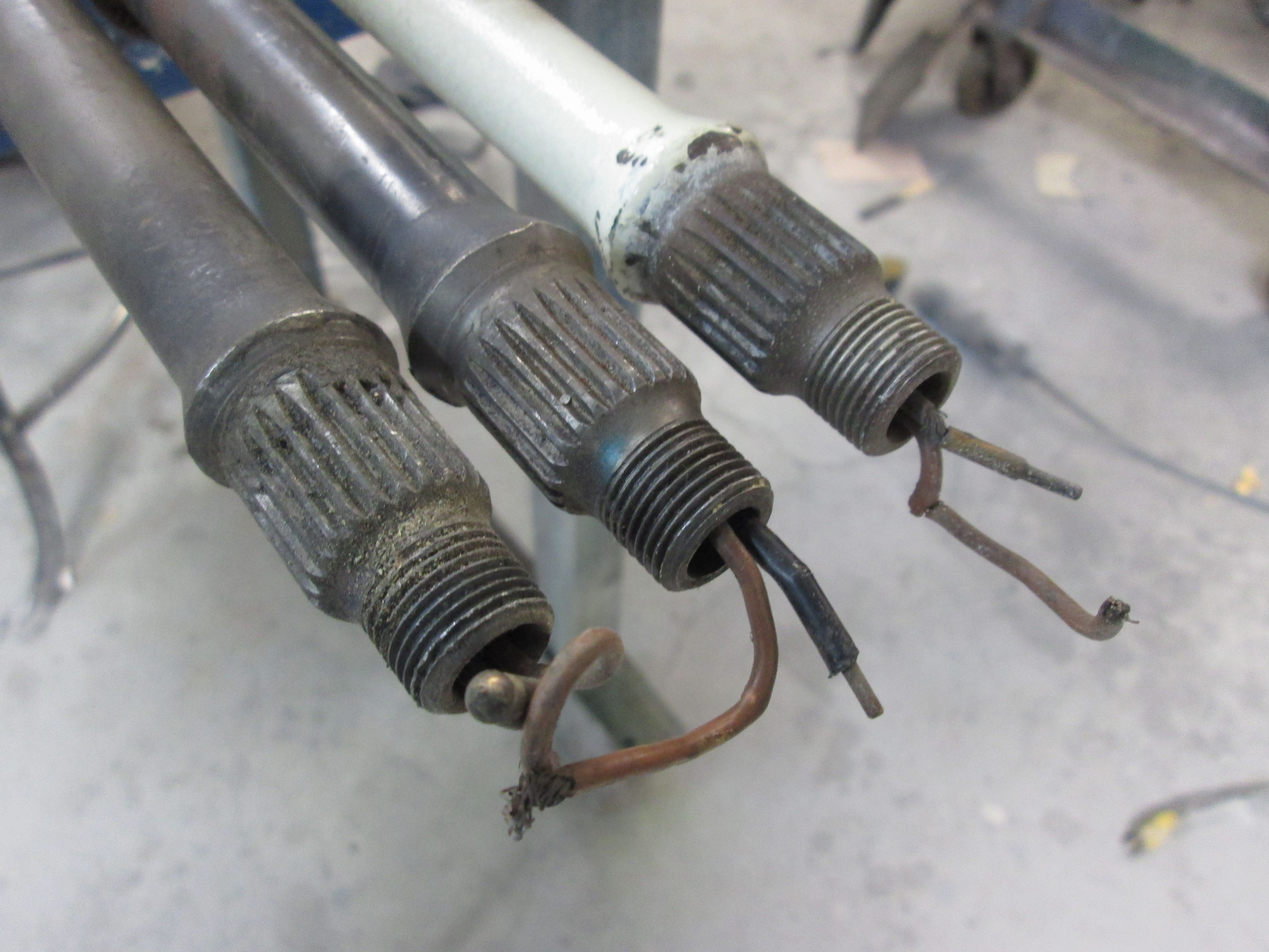

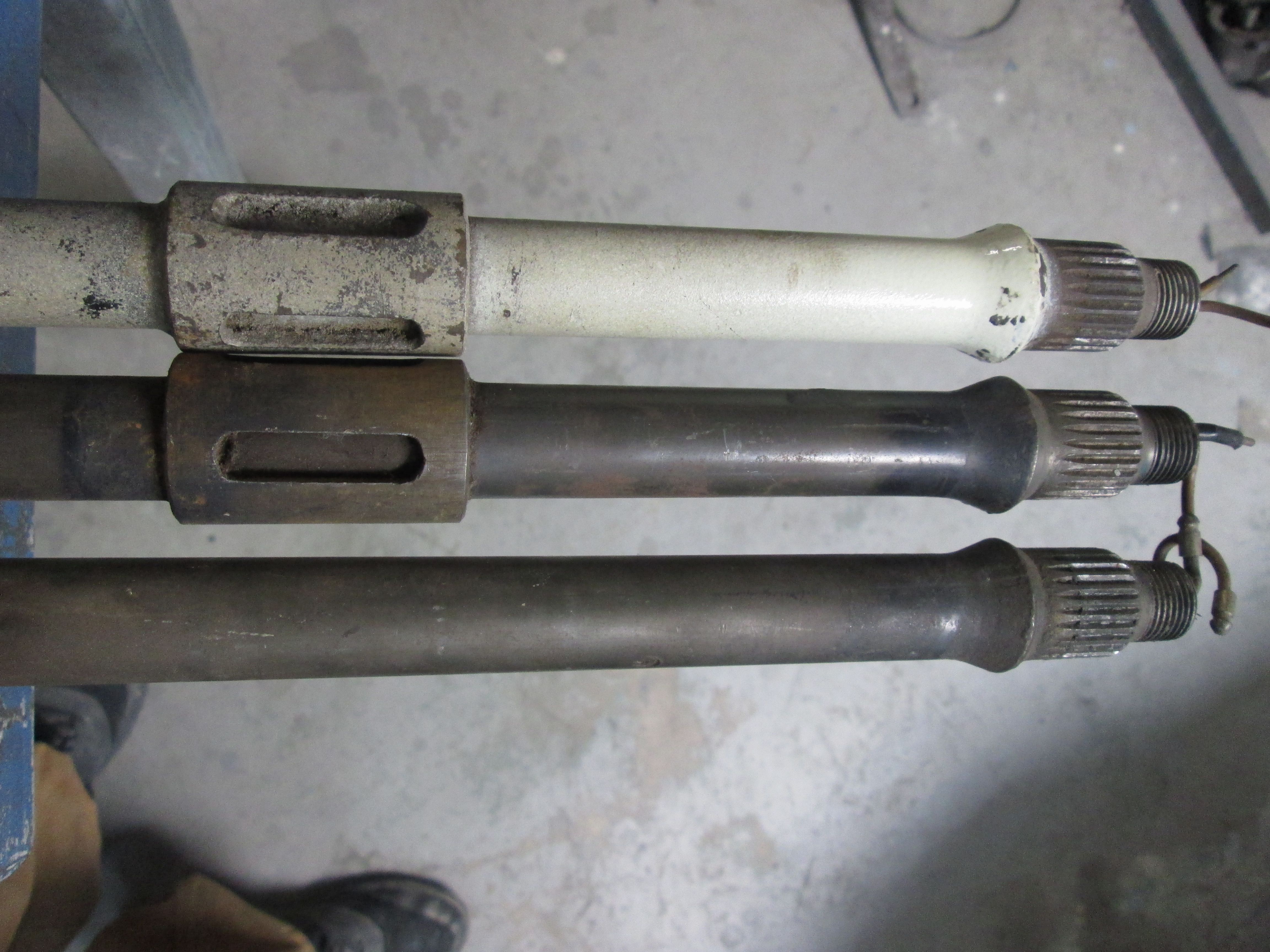

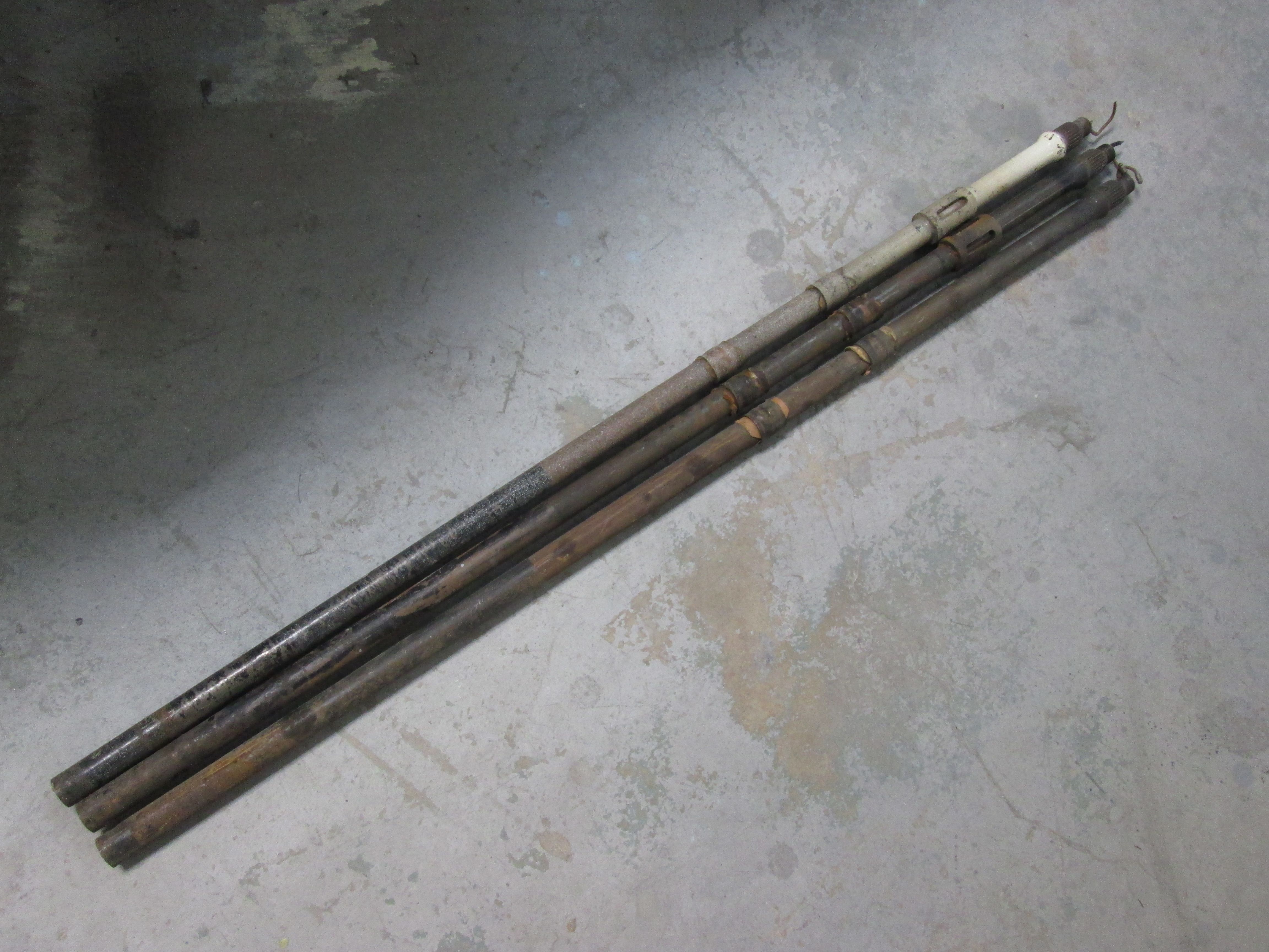

                      • Steering shaft changes.
                        While prepping one for installation I noticed some subtle differences between my early T1 units and a known T2 unit from a '58 coupe.
                        Click image for larger version  Name:	image_60222.jpg Views:	1 Size:	1.50 MB ID:	104800
                        Bullet connectors found on the wire leads on the T2 shaft while both of my '56 versions lacked these ends.
                        Click image for larger version  Name:	image_60221.jpg Views:	1 Size:	1.56 MB ID:	104799
                        Both of my T1 units came with the collars for the optional steering wheel lock where the later T2 version was no longer outfitted for the option. When this was eliminated?? Who knows...
                        Click image for larger version  Name:	image_60223.jpg Views:	1 Size:	1.61 MB ID:	104801
                        Horn contacts are identical and overall length unchanged for the later ZF steering box. Same part used throughout with only two notable differences.
