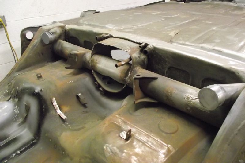

              SJ my father ran type 1 VW gear box in our T1 coupe but it requires modification.
              The bulk-head face must be cut away to allow for clearance. (this was done before he bought the car for a corvair drivetrain) A heavy flat-bar drop bracket was made by dad and buddy of his who was helping him to get it running in the late '60's. It bolted into those holes drilled into each mount horn there and carried the stock VW trans mount in the center. Wished I would have taken a photo of it. Anyway the stock trans hoop and mounts bolted right up to the bell housing and all the drop linkage for the shifter lined right up. So it can be done.

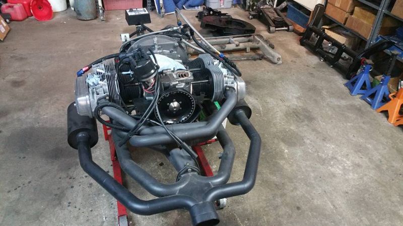

                  • #99
                    Thinking of going back to something similar
                    • What are the specs on this engine Greg? Is this a milder mill than what was in there? I like that exhaust system BTW!
                      • That's a 2276cc I was going to run in the 356 maybe a year ago. I dug it out this week to put together for one of my buses...
                        What I am going to do is take the same 2332cc that was in the 356 and "de-tune" it a bit.
                        Change out the SuperFlo heads for something more reliable for a daily street car (044 Wedgeports or 044 SuperPros) change out the FK89 cam, again for something more streetable, and drop the compression to below 10:1 so I can use pump gas.
                        I'll still be running IDA's and the sweet exhaust Kris at Paradise made for me originally.
                        I'm sure the HP will still be in the 125 - 150 range which I am OK with
                        Up in the air is the color combo. I sold the 911 shroud, etc. that was on the engine, so I need to figure that out as well.
