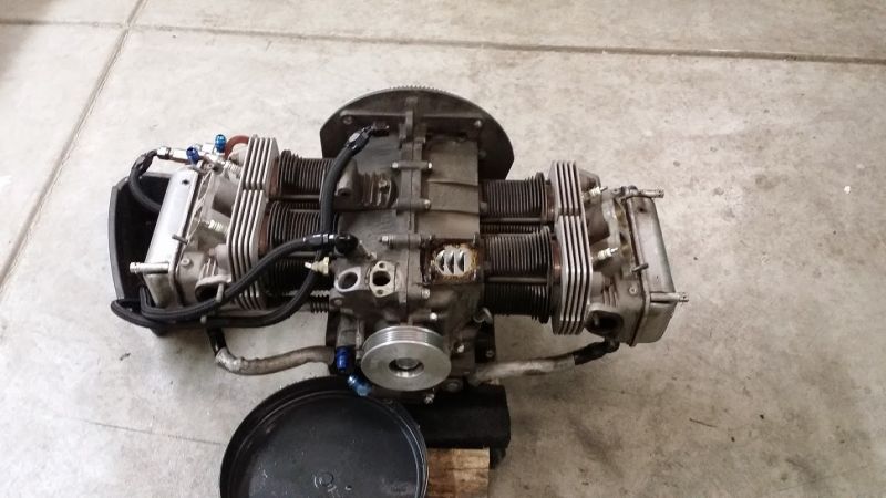

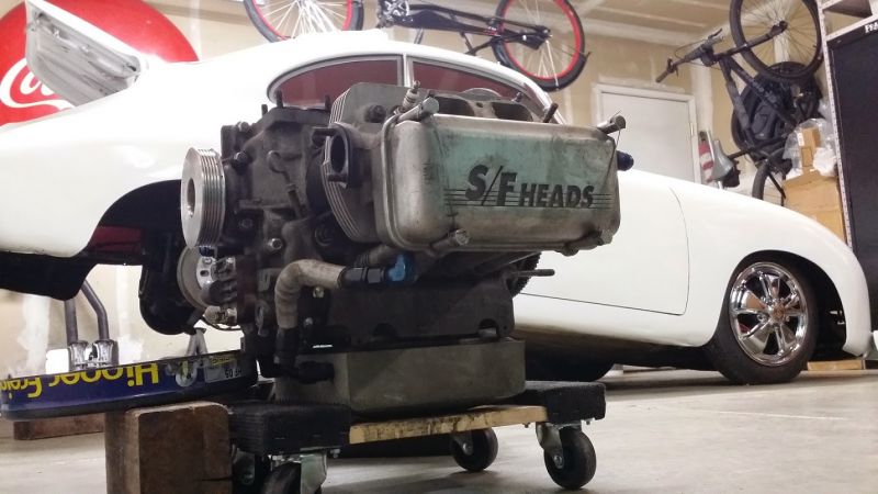

                    Since day one my Pro Street trans had made some "noise" and I knew it had to come out. I didn't want to mess with it until after my wedding (almost a year ago now) With a baby due (in less than a month now) I figured I should probably get my projects done before I didn't have time to do so.
                    I decided to pull the current engine and trans a month or so ago.

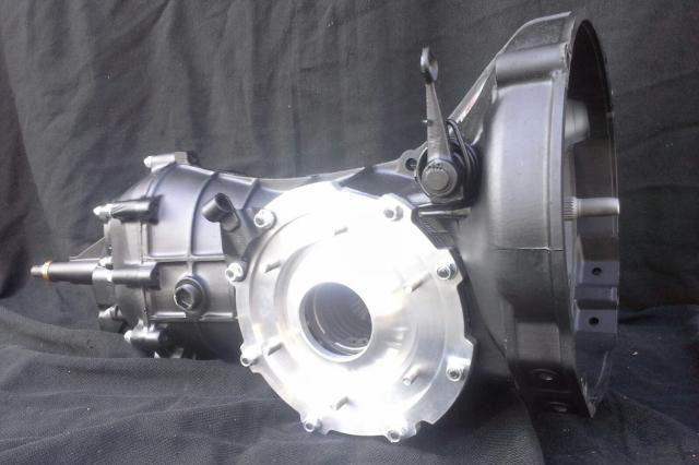

                    I sent the trans to be repaired and have the R&P changed to a 3.44 along with the 4th switched out to a .77 match my Salesflap because it does so well cruising on the freeway.

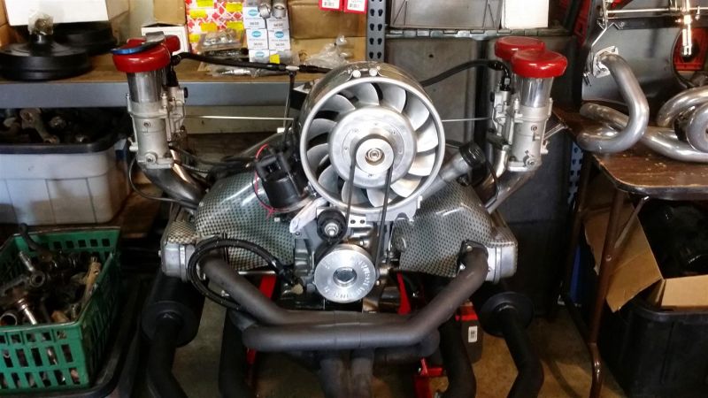

                    While the 200+ hp engine was "cool" it turns out what I really wanted was a more "stock" engine I could hop in a go for long leisurely drives in with no hassles. I planned on buying another 1720cc Porsche engine but not having a core was not cost effective. So I toyed with the idea of using a more streetable 2276cc I had in my shop. I even went so far as to dress the engine to make sure the exhaust, shroud, etc. would fit and work.
                    It did....

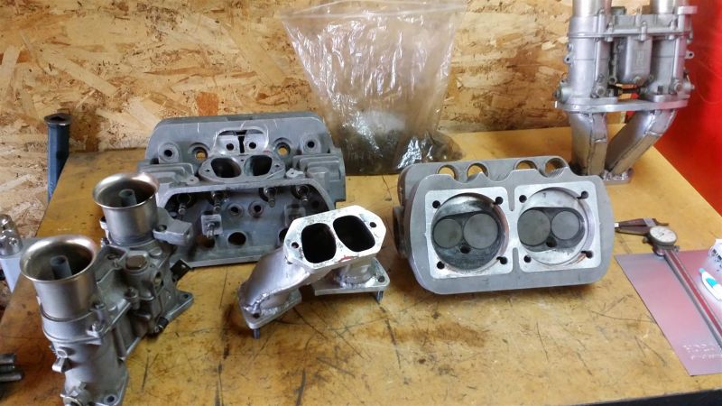

                    Maybe I'd drop the compression in the 200hp engine, get rid of the SuperFlo heads and run these "regular" Street Eliminator heads instead...
                    Not sure that would really help out my situation though....

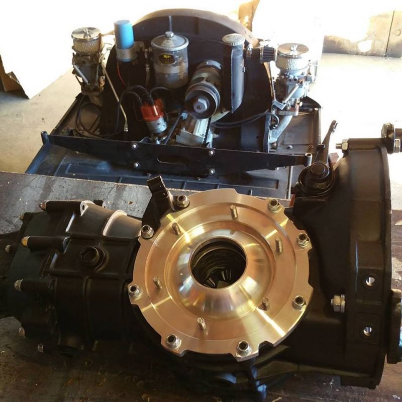

                        July 2nd 2015 -
                        Not sure what is going on with Rancho the last year (too busy to keep is what I am hearing) but they still have my transmission. So I ordered a "Freeway Dominator" from another re-builder about a month ago. It arrived today.
                        Specs:
                        3.44 ring and pinion
                        4 spider dual clip sSuperdiff
                        HD side plate
                        Tg welded gears
                        Hard keys
                        Seel forks
                        New sliders/operating sleeves
                        New pinion bearing
                        New mainshaft bearing
                        Re-bushed gear carrier housing
                        New syncros
                        Welded crosshaft
                        Late style pinion bearing 12 volt case
                        Bus 3rd gear and bus fourth gear
                        Added oiling groves and vent the case for high speed use
                        3.80 1st, 2.06 2nd, 1.21 3rd, .82 4th
                        Even with the .82 instead of .77
                        MPH with a 25" tire (195/65/15) looks OK
                        3000rpm-65 MPH
                        3500rpm-75 MPH
                        Now you are caught up, except Justin has me second guessing myself...
                        Anyone want a 912 engine? Runs but needs some TLC.

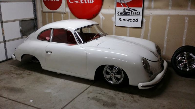

                            Re-visiting this build has me motivated again, and re-thinking what exactly it is I want to do. I do know the car will be rolling by the end of the month. No sure what engine I'll be working on to put in it though.....
