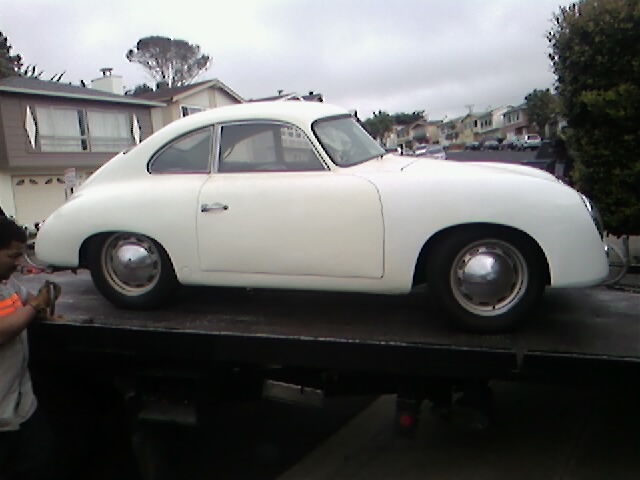

    As found -

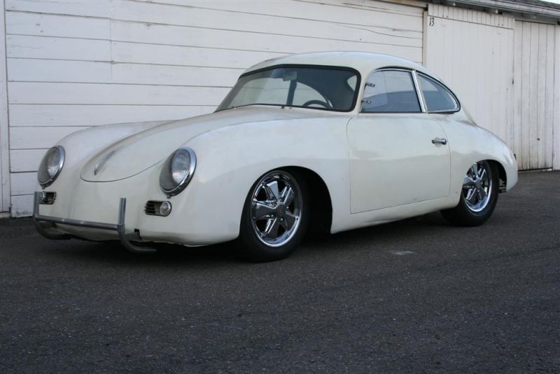

    2013 -

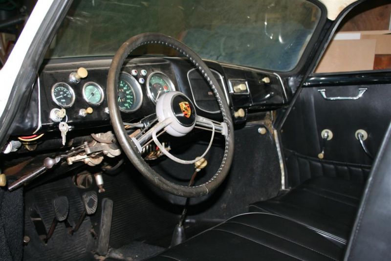

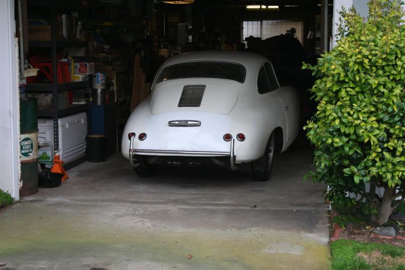

    March 21st 2009
    "Did the deal today...
    1954 coupe (COA) says it was originally Silver with Red interior. Same as my other '54. It was a driver until the trans started "clunking" per the previous owners description.
    I'm going to fire it up and make sure the engine is cool and then pull everything out for a trans rebuild."

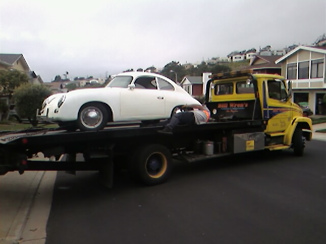

    "Loaded up and heading home"

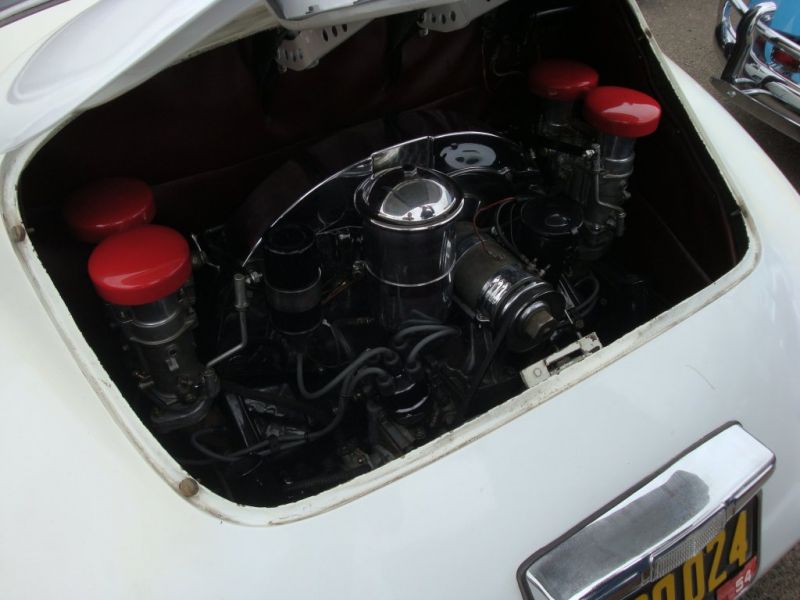

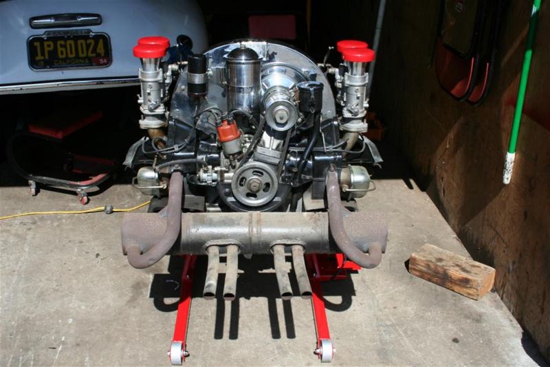

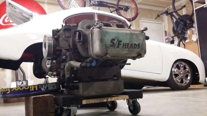

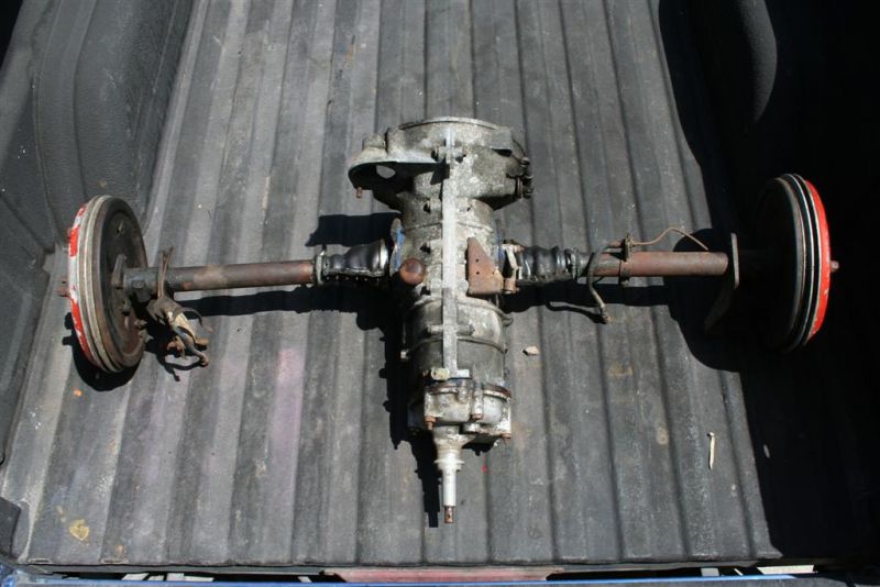

      Got it home with no issues and did some tweaking to the engine. New fuel lines, fresh Optima 6v battery, new gas, checked the floats (one was stuck), had it running in about an hour.
      At this point I pulled out the engine put it on my stand and started sorting how to fit IDA's. I also pulled the trans and sent it out to have the cracked R&P repaired. This was March 23rd.

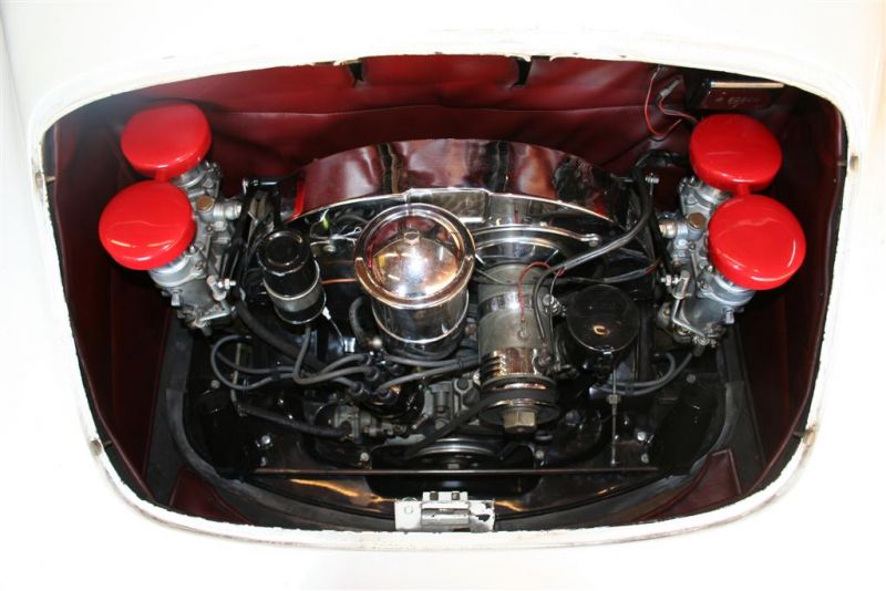

      Fast forward to May of 2009 and I decided I wanted to take the car to the VW Classic in So Cal. At that point I worked non-stop for about 3 weeks to get it some what "done"

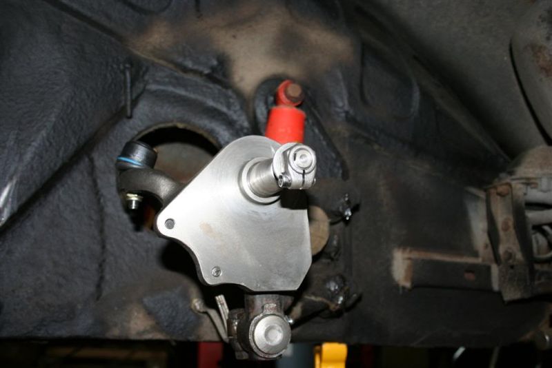

      I found and bought another 519 trans (mine original was not done yet) and did a trans swap, added some dropped spindles (with disks) adjusted the rear down, and worked a bit more on the switch it over to IDA's. I thought since the engine was a 1720cc with the proper jetting it would be OK.

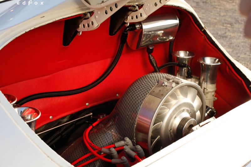

          June 3rd 2009 (still shooting for a June 11th deadline to head out for SoCal)

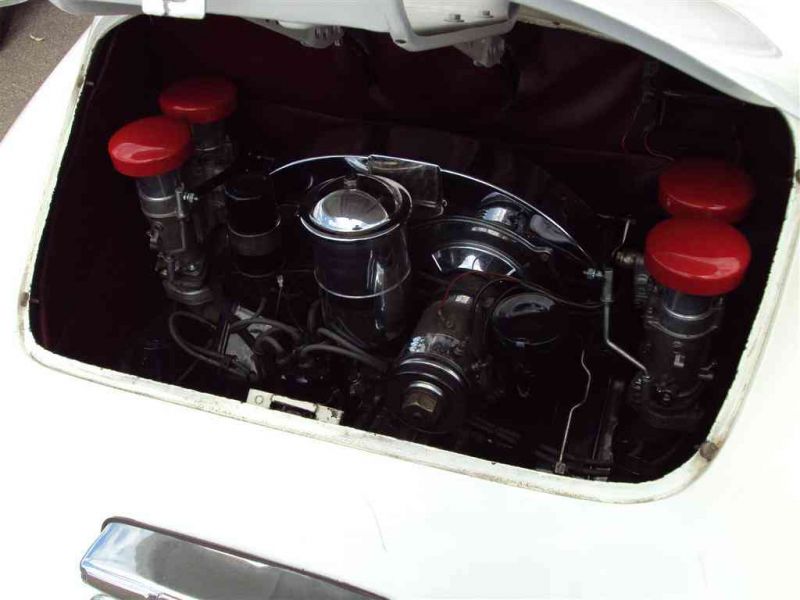

          022 installed, IDA's dialed (still need smaller idle jets but everyone is out of stock, so it's a little rich when just sitting), bumpers are on the way, wheels / tires mounted, brakes bleed / adjusted, tranny full of gear oil, clutch adjusted, shifter adjusted, visors over the gauges installed, mirror installed, etc.
          Engine goes in tomorrow. If that goes smooth the alignment should be the next day and the glass trim (windshield) installed Friday.

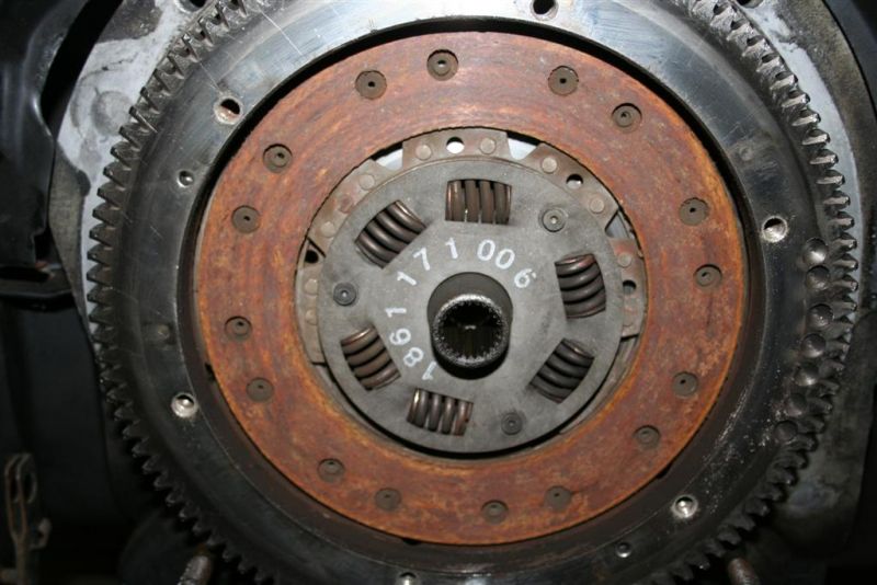

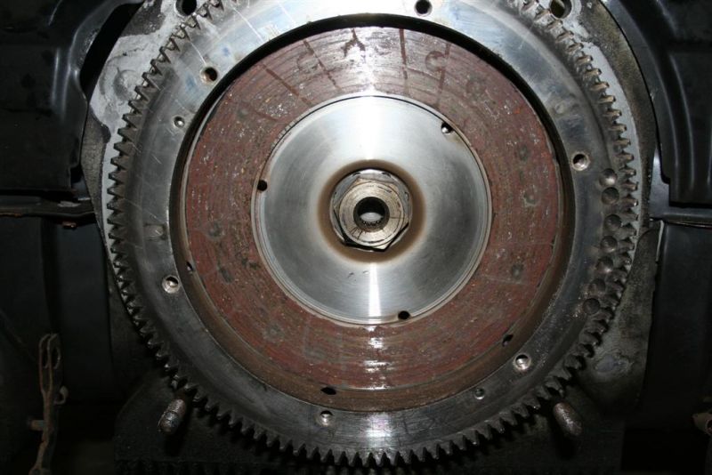

              The engine is coming out again tonight. I get no response from the clutch pedal, and I think *hope* the disk is stuck to the flywheel... We'll see later.
              All show, no go.
              Literally........
              Let my mistakes help you.

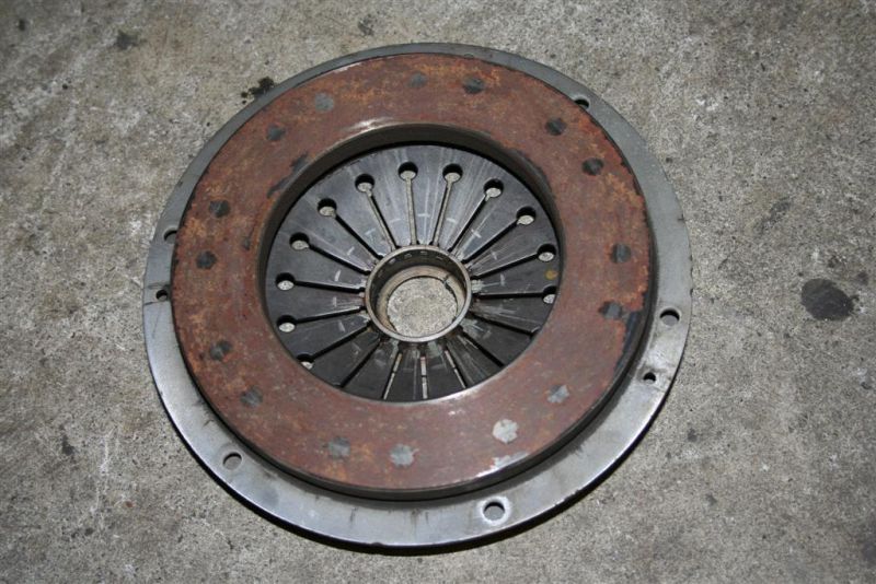

              If you are dealing with a car / engine that has been sitting for +/-25 years take a look at EVERYTHING.
              In my rush to get the engine back in the car I never even thought of checking the clutch assembly.
              When I pulled it apart tonight I found that (as I suspected) the disc was rusted to the flywheel, and the pressure plate.
              No slippy means no clutch action.......
              I'll deal with that tomorrow, but I can sleep tonight at least knowing what was wrong.

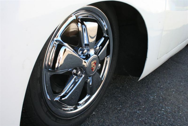

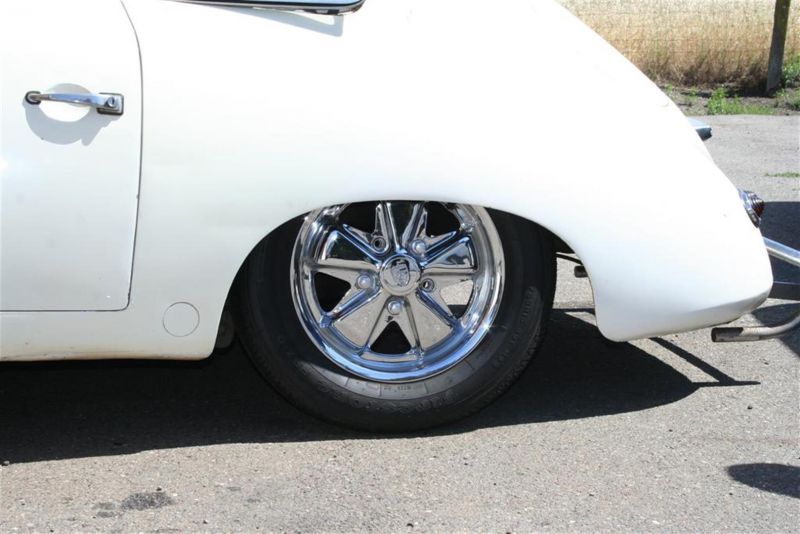

                On a nice side note, these 5.5's and king crabs look bad ass, and the stance with the engine in is "spot on"

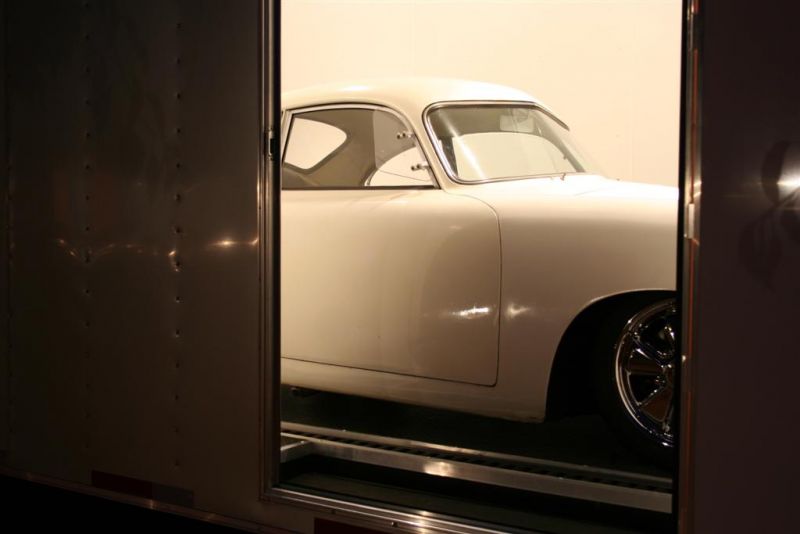

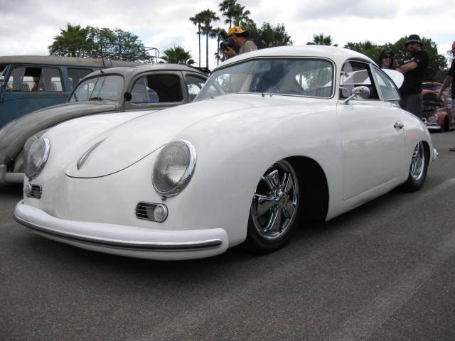

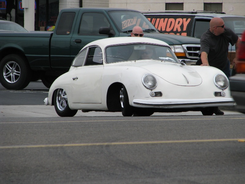

                      So you'd think all was fine and dandy at this point, but really the car wasn't running right (popping at low RPM's which I later found out to be a "lean pop" due to the large venturis in the carbs) and the trans wasn't shifting quite right.
                      But I made it to So Cal and there was a swarm of people around the car when I unloaded it Thursday night at the Host Hotel and cruised it through the parking lot.

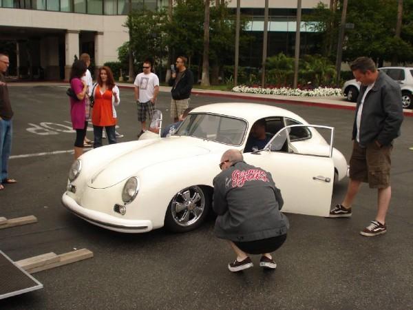

                            With the curb damage hurdle sorted for the time being a few friends started checking the car out, helping me adjust the doors a bit and trying to sort the shifting issues as well.

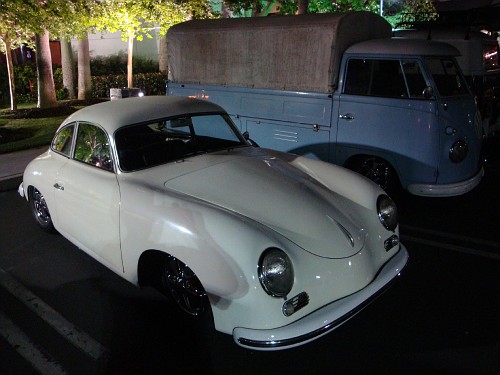

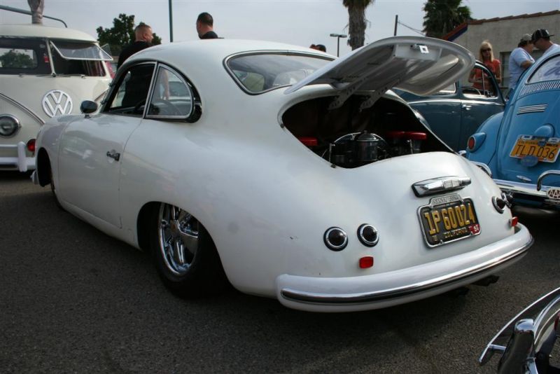

                              Even with the damage the car got a lot of response at both the cruise night Friday and the big show on Sunday
                              Here's a few pictures from each.
