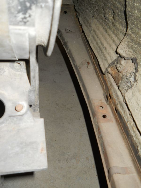

    While I'm pretty sure it will clear my initial concern is the added final length this stand will put on this engine.
    This is a mock-up polo motor in that 58 hotrod I'm working on and due to the rear suspension mods this unit sits back a bit farther than it would in a stock position. Even with this change there is a good 3.5 inches of clearance with the rear tray so I think it will workout okay.

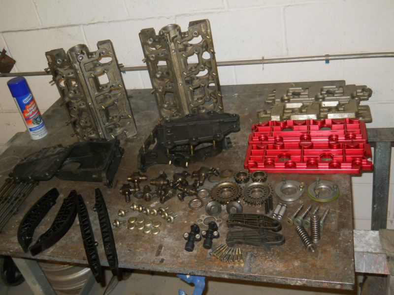

                  Beginning to round up more 3.6 liter 964 engine components.
                  While looking for 964 cam towers and chainboxes I was fortunate enough to hook up with a really great guy by the name of Kevin Roush owner of GAS motorsports in Upland. I received my first parts package from him last week.

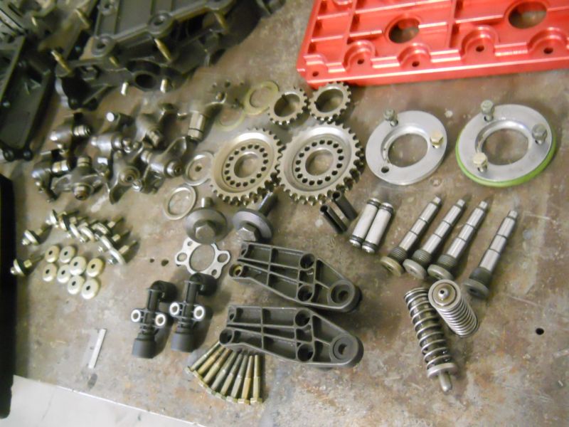

                  but then my initial order soon turned to all the small hardware you don't even think twice about until its time to put the engine together.

                  I know I am still missing a good amount of small hardware but I did make a pretty good dent in it on this go around. I've found a few exploded parts diagrams of a 964 so I'll match that up with what I have and get my next purchase order ready.

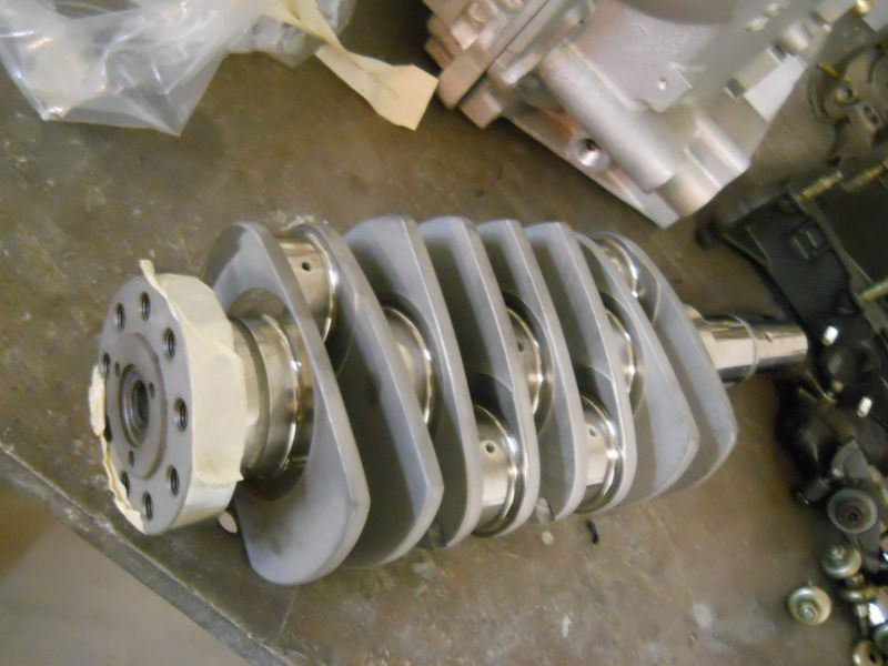

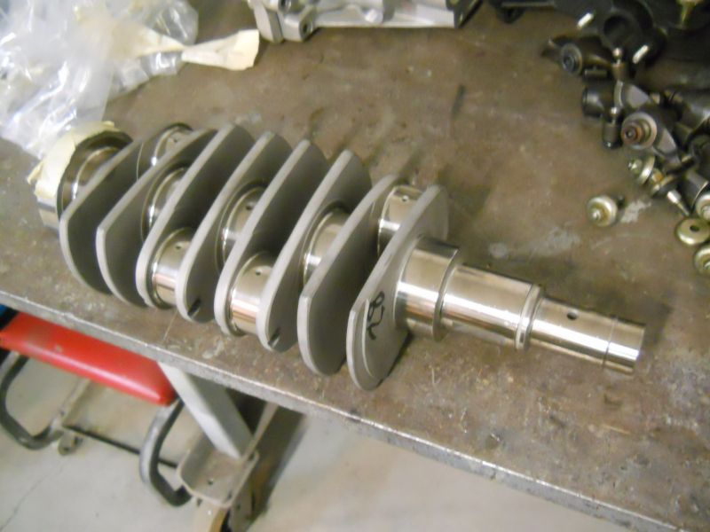

                  Weird how a lot of parts came in all in one week. Dean brought me my new crank shaft yesterday when he picked up his car.
                  82mm Stroker crank. A beautiful piece and as long a throw as you can go without moving the oil pump outside of the motor.

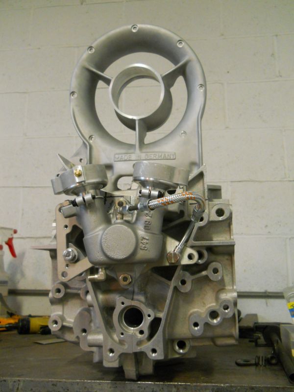

                  Of course while Dean was here I was showing him all that I've gathered for this motor project so far. He really liked Nigel's V-drive casting and definitely approved of the 4-cam fan shroud going on as the photo above shows.

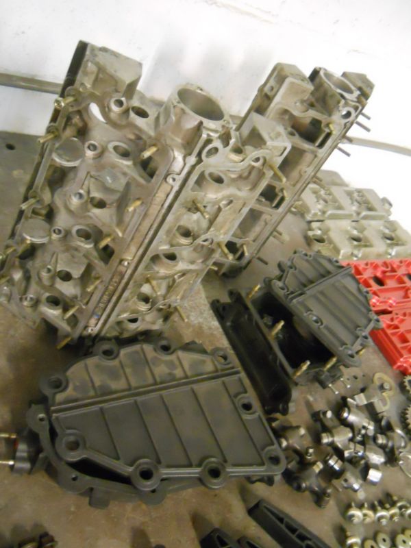

                    7/14/15
                    Test fitting newer 964 parts to begin figuring out what needs to be done.

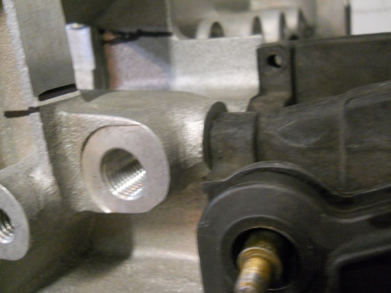

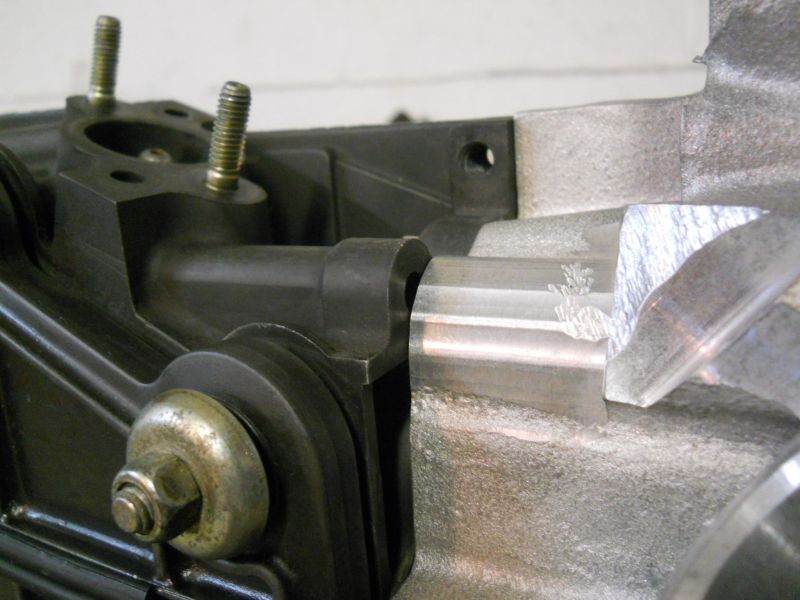

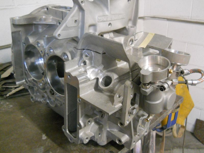

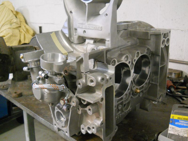

                    Dean's engine blocks are machined and set up to run earlier version 911 components so several minor changes will be necessary to get these parts to work. Fortunately the basic 911 design has only slightly changed in detail through the years so these parts still basically fit.
                    Much to my great relief the chain boxes bolted right up to the existing mounting holes. so the same basic pattern here.
                    Earlier 911 motors run an external oil line to feed the cams however these later chain boxes have an incorporated oil galley instead. You can see the opening of this passage peaking out here. We'll have to add and tap a feed for this galley on the engine block. This is probably going to be the most involved modification to run these later boxes.

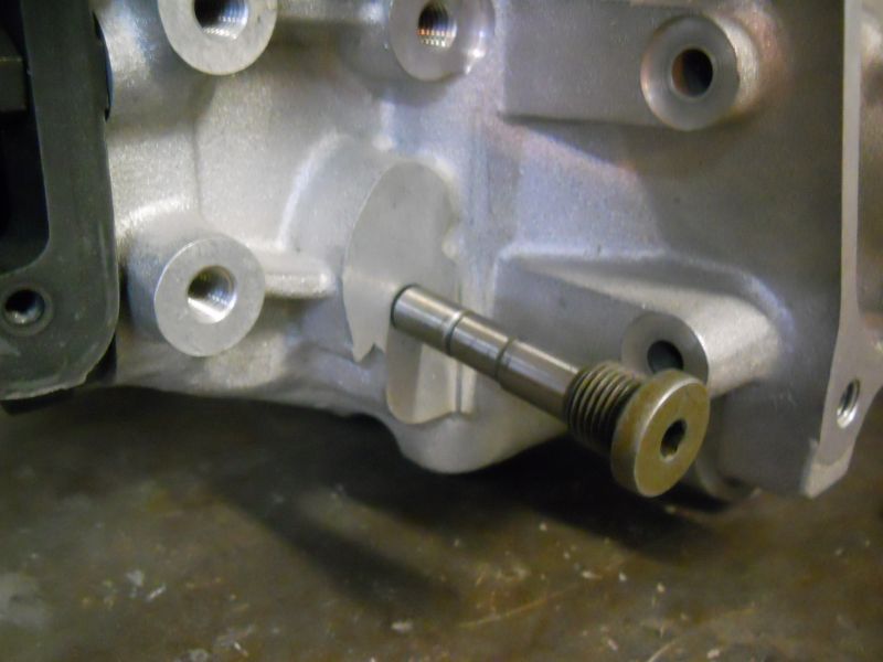

                    Oil galley on the other side will also need some work but will only require an adaption.
                    embossment will need to be drilled and tapped to accept these keeper bolt for the lower chain rail.
                    Mocked up what I have of the tensioner assembly to get a better feel for it.
                    I only have a basic working knowledge of the 911 engine but I suspect I'll know this engine intimately before its all up and running.

                          Is all the "Sharpie" drawings the extra material that needs to be carved of that lovely cast?

                              Hey Per, yes, the sharpie marks are a very conservative starting point for my buddy Bill to machine off. Tony, I wanted to run the latest and the greatest of the air-cooled 911 evolution. I'm already running 964 racing heads and cylinders so this choice just adds continuity to the long block. Thanks very much once again you guys!

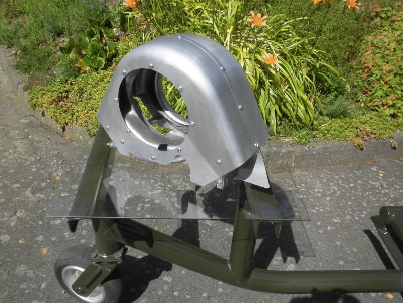

                                8/6/15

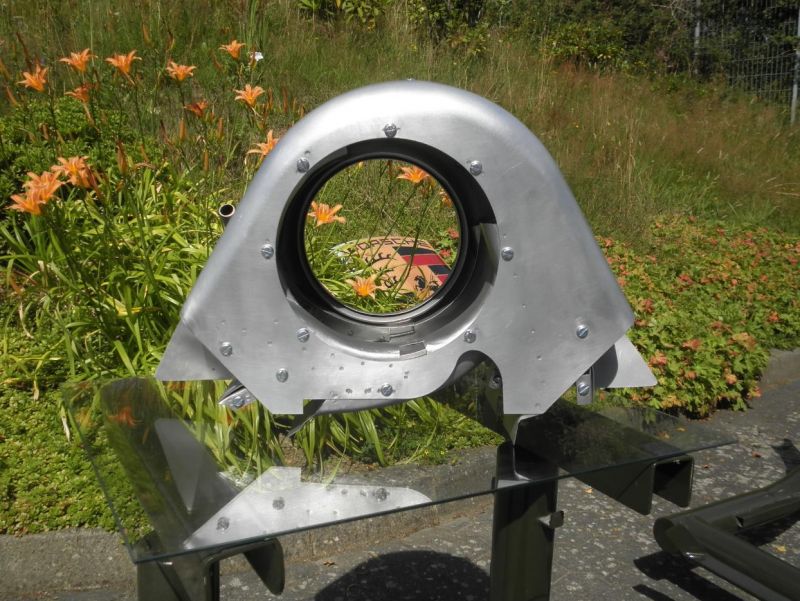

                                My new 4-cam fan housing ready to ship!
                                Metal Master Gerd Breuer just sent me these photos of my new housing that will be going out as soon as the paperwork clears customs. His workmanship and product presentation is nothing short of amazing!
                                Everything sure looks spot-on from all the photos I've ever seen of an original housing
                                Impressive inner vein construction.
                                He is truly an artist of the highest standard.

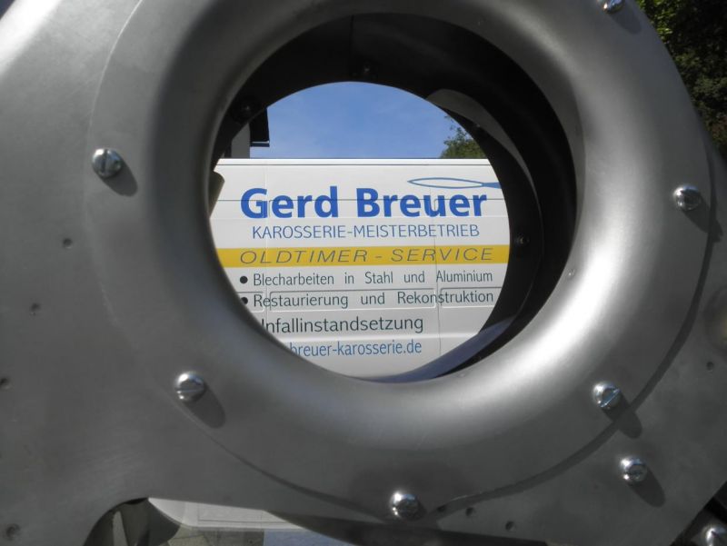

                                Here's Gerd's contact info if you're ever in need of one. The inlet ring is a new stamping he just finished to more accurately replicate the original.

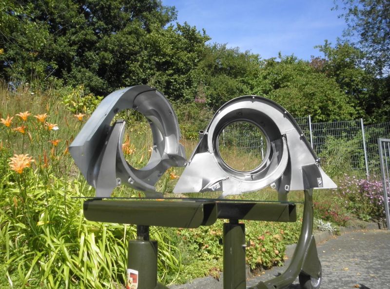

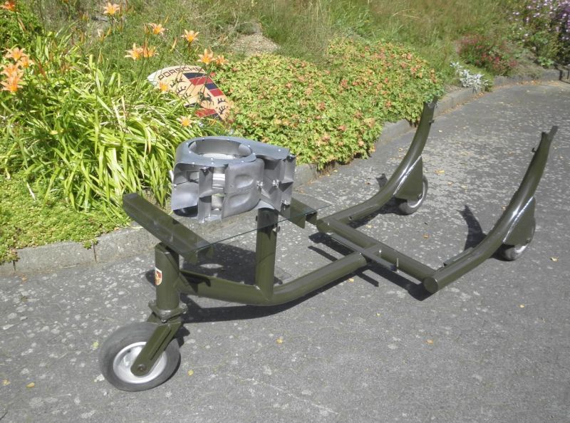

                                I complimented him on his nicely replicated chassis dolly but he said its actually an original factory Porsche dolly he bought from Ebay that needed only minor repair. He's thinking about making these as well.
                                I drooled over these shots all afternoon, I hope you liked looking at them as much as I did. Even the back-drop and props where nice touch for the photos. Thanks again Gerd, I'm looking forward to getting it into my hands!!
