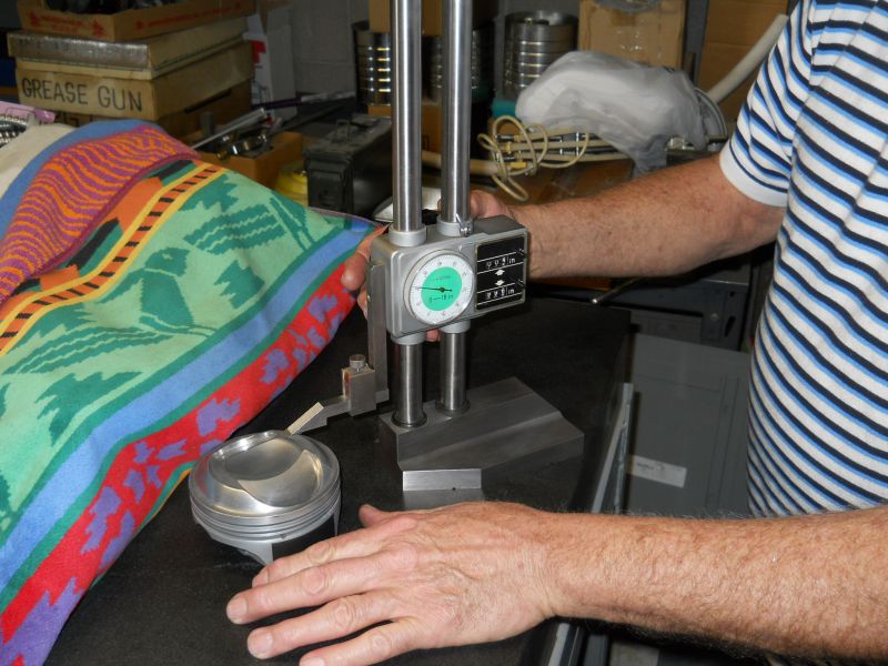

                I spoke with Dean yesterday and he said they were just getting ready to do a run of crankshafts. He knows I want the biggest stroked crank we can get in there but he had to know the deck height of my pistons I bought first to ensure it would all clear. I'm shooting for an 80mm crank but said I might have to settle for 78mm if the deck is too high on the pistons. BTW: he's played with the idea of going up to an 82mm crank but this would require moving the oil pump outside of the block to get the clearance. Tempting but I don't want to get that crazy.
                So I was instructed to find the deck height from the center of the wrist pin. Had to call on my good friend Bill La Fever (expert machinist) to help me out with that one.

                Here's shot of Bill getting this technical measurement for me on his trueing table. Its a 500 pound, 5 inch thick slab of granite with a milled surface that's true by several thousands of an inch. Needless to say he has an amazingly equipped shop. Bill determined the deck height to be 31.521MM and the crown of the piston to be 42.190MM.
                I passed these numbers along to Dean later that day but told him I had made up my mind weather it clears or not I want the Big crank. I'll have these pistons fly-cut if needed. P&C sets come and go but the cranks are normally around the duration. I only want to buy one crank shaft. Anyway, waiting to hear back from Dean to see if these will work as is. Thanks for stopping by! Justin

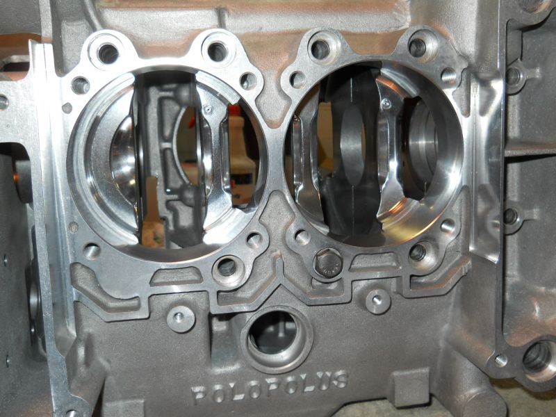

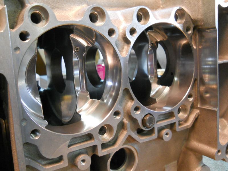

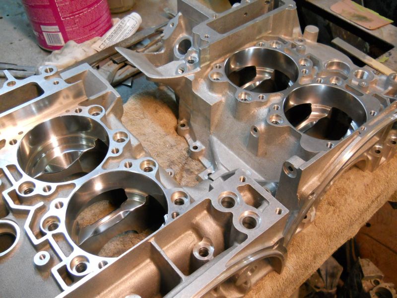

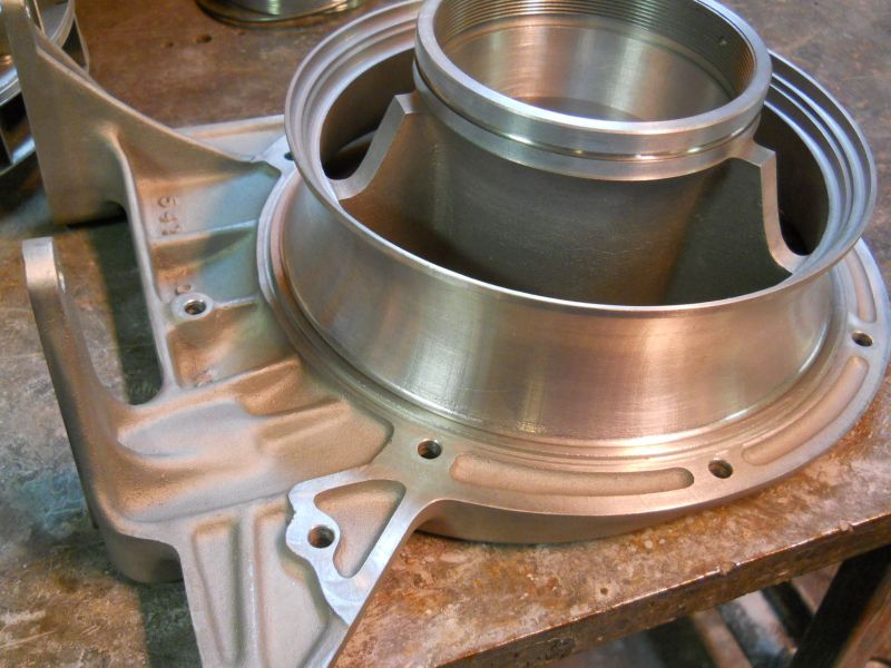

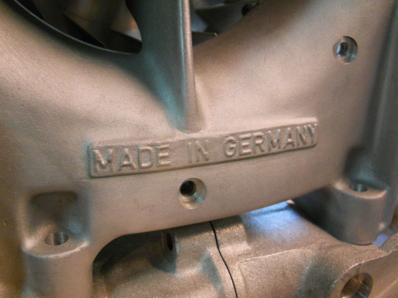

                      Finally finished up the other case half so I am officially done with polishing and shaping for windage.
                      Onto the next challenge. Thanks for looking! Justin

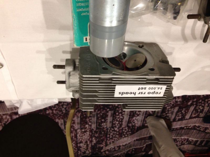

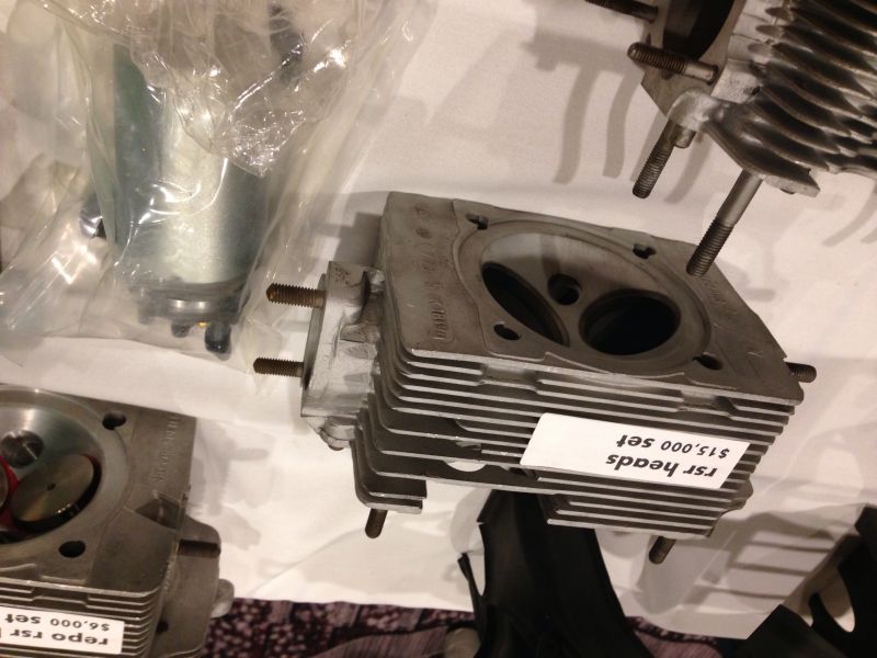

                          Hey Justin - I saw these heads this past weekend at the LitMeet and thought of your engine.

                            6K for a set of repo heads and 15K for the OEM? I'm feeling alright with what I had to put into my heads.
                            Thanks for thinking of me Trevor.

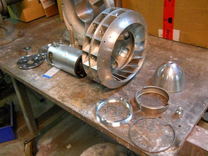

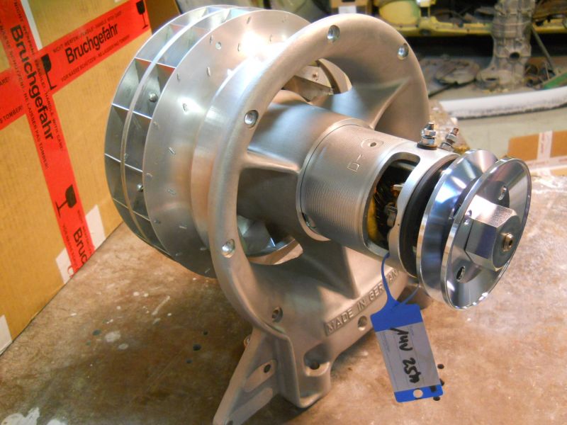

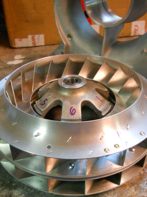

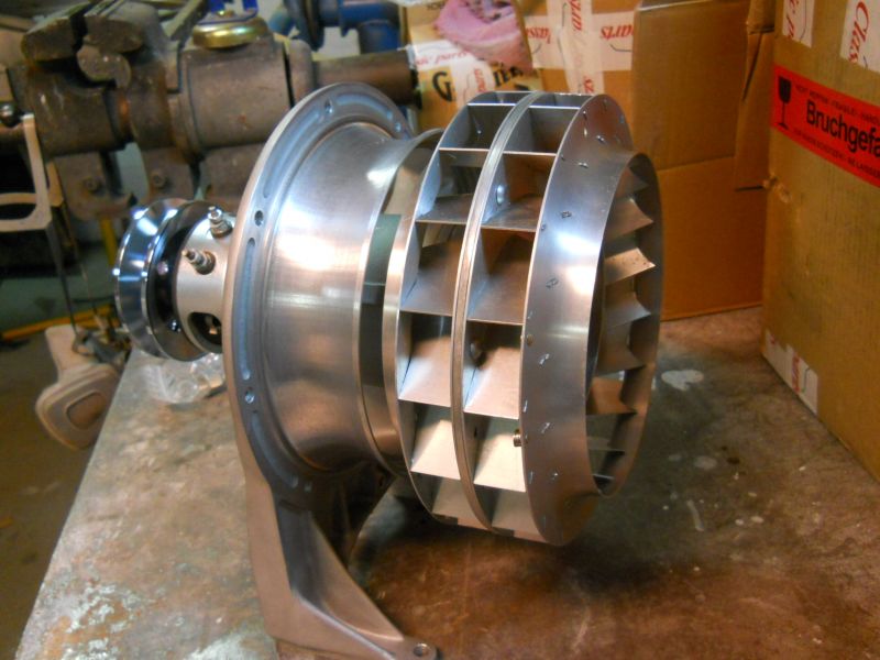

                            Coincidental you posting here, I was just getting ready to update this thread with new development. At the bottom of page one I was talking about the stock 911 cooling fan that was going on it and that the dream set up for my car would be a retrofitted 4-cam cooling/charging unit.
                            Well I decided to go for the conversion.

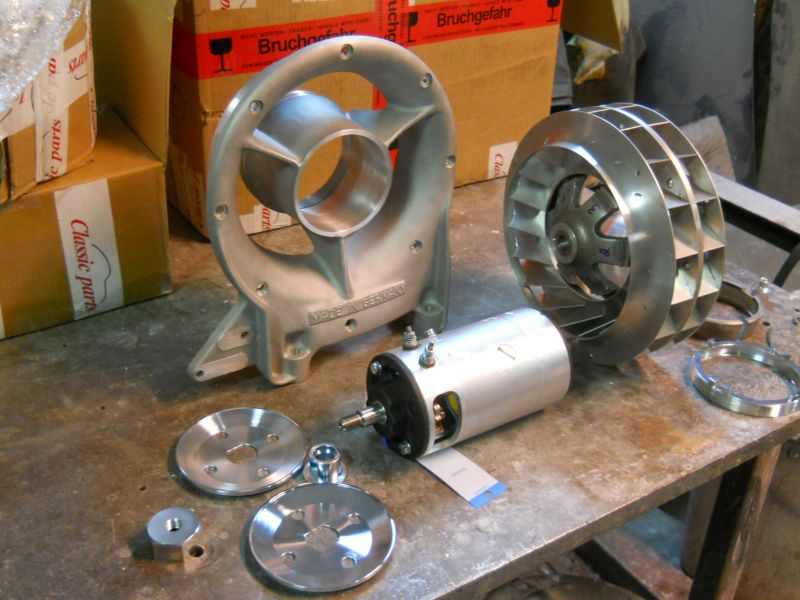

                            Here is what just arrived a few days ago from Peter Hofmanns Classic Parts.
                            Will post more detailed shots tomorrow.

                                Here is almost everything save for the tin and few fasteners to build this unit.

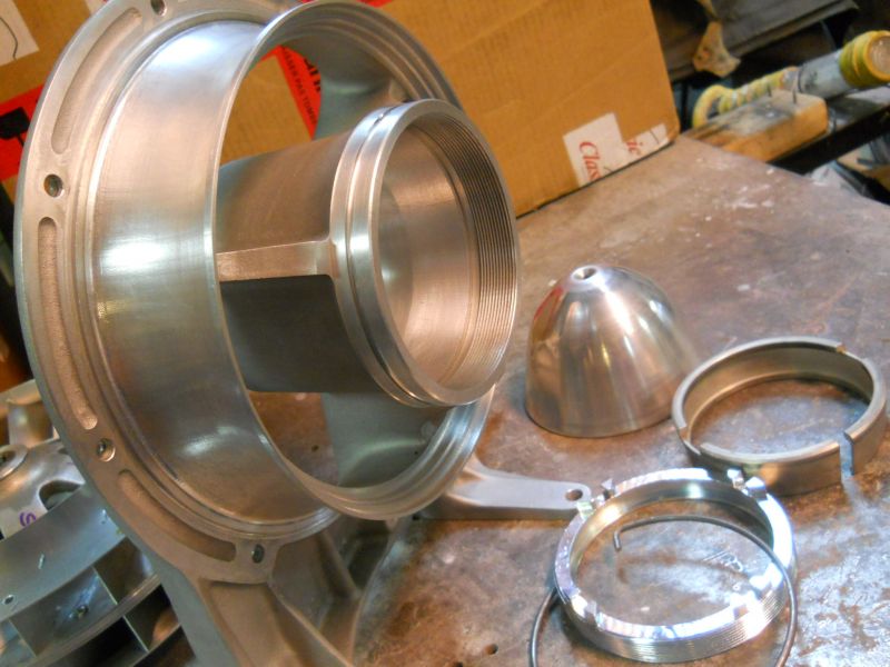

                                Peter was very helpful as he offered me specialized hardware I was not even aware that I needed at the point of purchase.

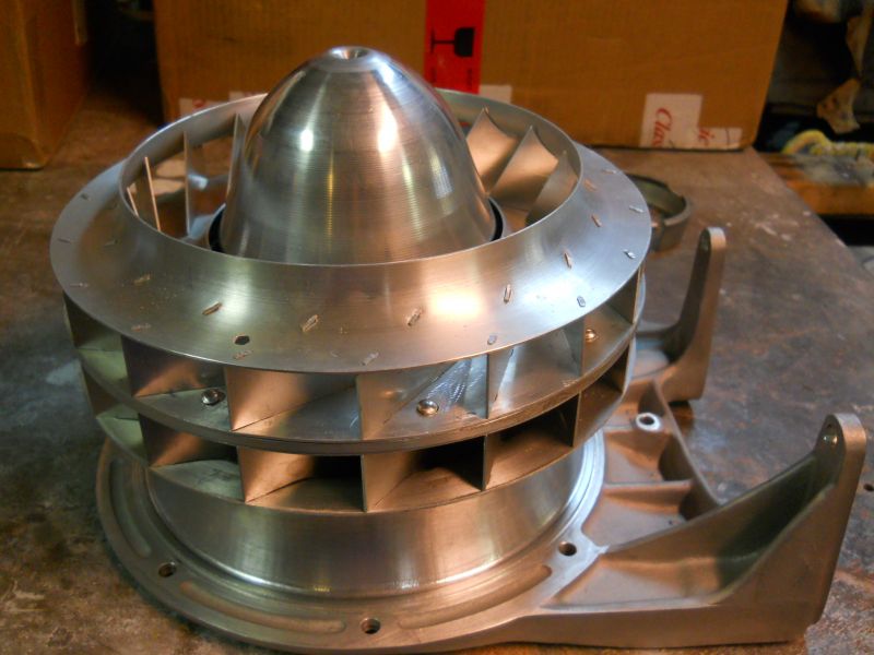

                                The fan is a true work of art.
                                Bill Sargent recommended I have those holding tabs on the fan blades TIG welded as cheap insurance as he knows of two repro-fans that came apart during the initial runs on a Dyno. A precaution I will be taking.

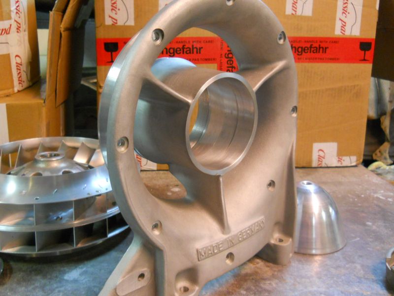

                                This new casting I was most impressed with.
                                Both front and back just "look the part" in every detail.
