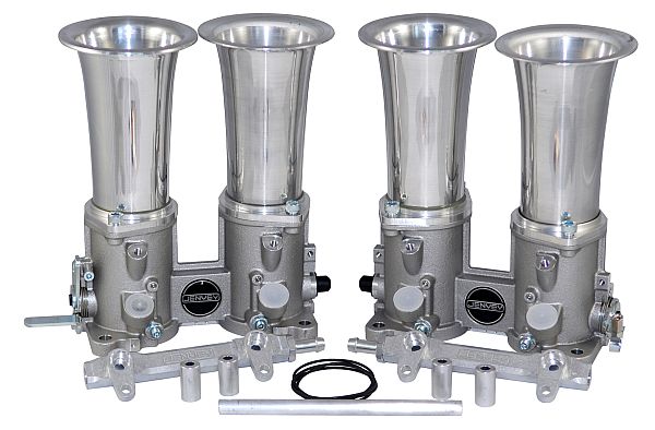

                    The fuel system is still in question at this point. I'm partial to EFI myself but

                    I've had this pair of early Weber 48IDF's on hand in case we decide on old school. If I use them I'll send them to Jaycee racing to be bored out to 51.5 MM and all the other upgrade tricks they offer for these carbs.

                    If we go EFI maybe something like these throttle bodies from Jenvey.
                    It was always a rule of thumb in my mind that more power and performance was had with EFI but according to Tony that's not always the case so its in the air at this point. Thanks again Jack!
