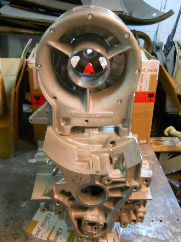

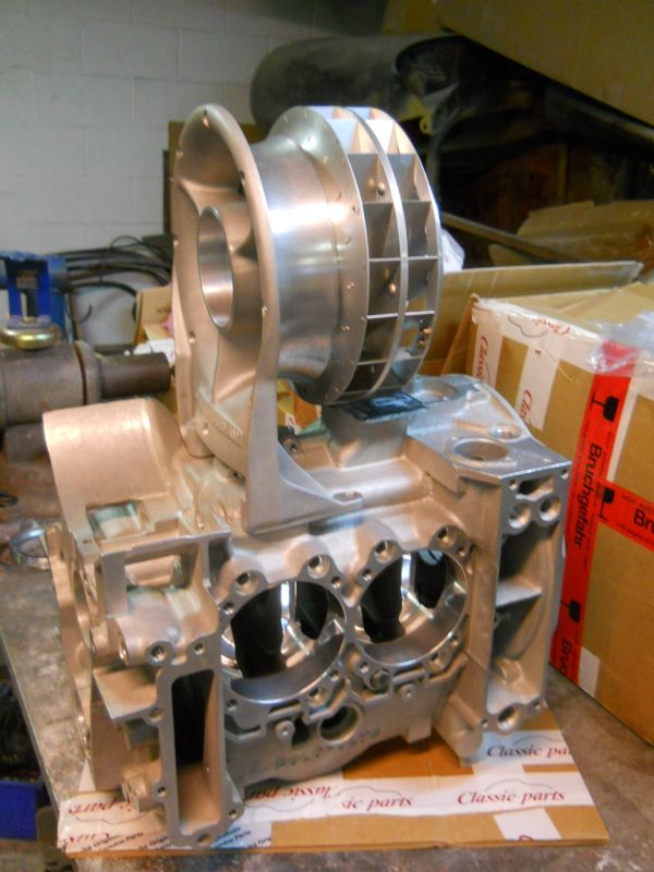

      Here are the last few shots I took that evening:
      I had to see them together while I was looking at everything.
      A very long way to go with a lot of machine work to do but I can a least begin to plan it out.
      It of course is sitting back way too far but this was the best I could for the photo until the 911 fan saddle is machined off. More later, thanks for looking! Justin

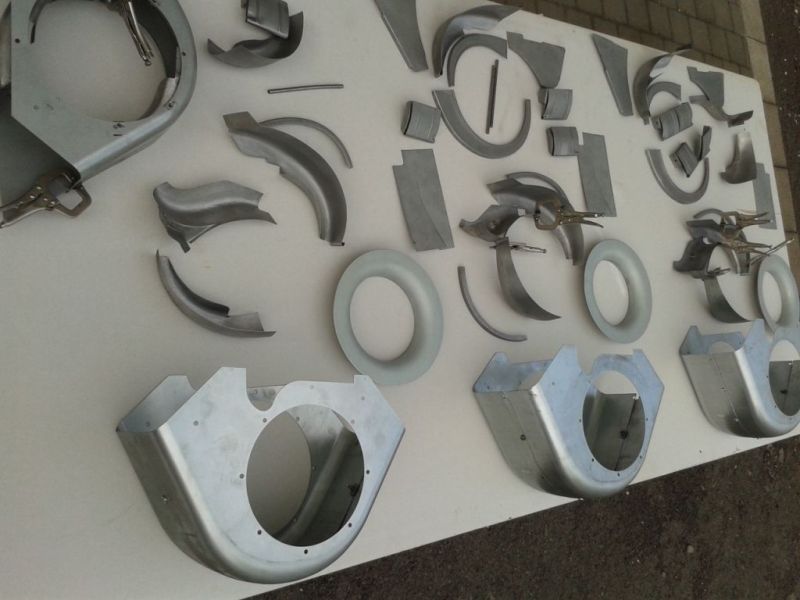

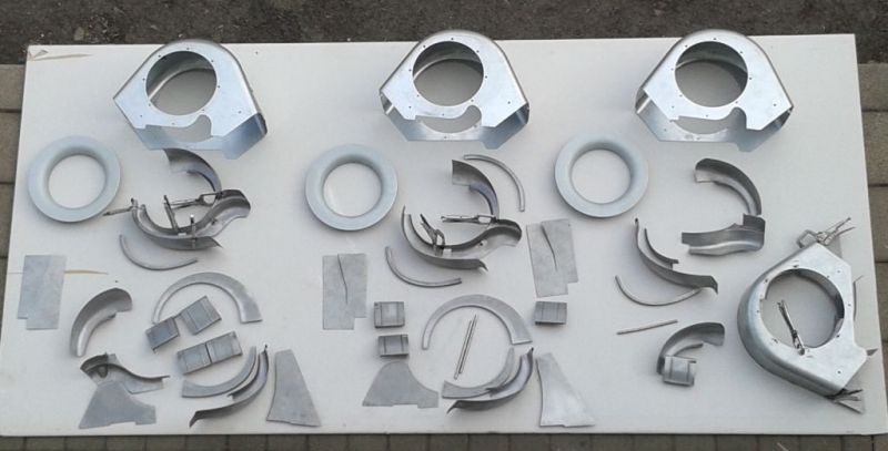

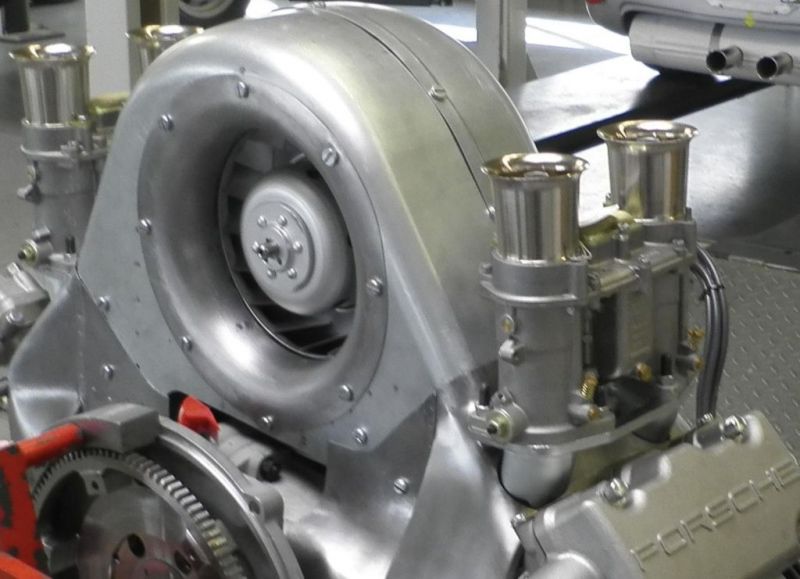

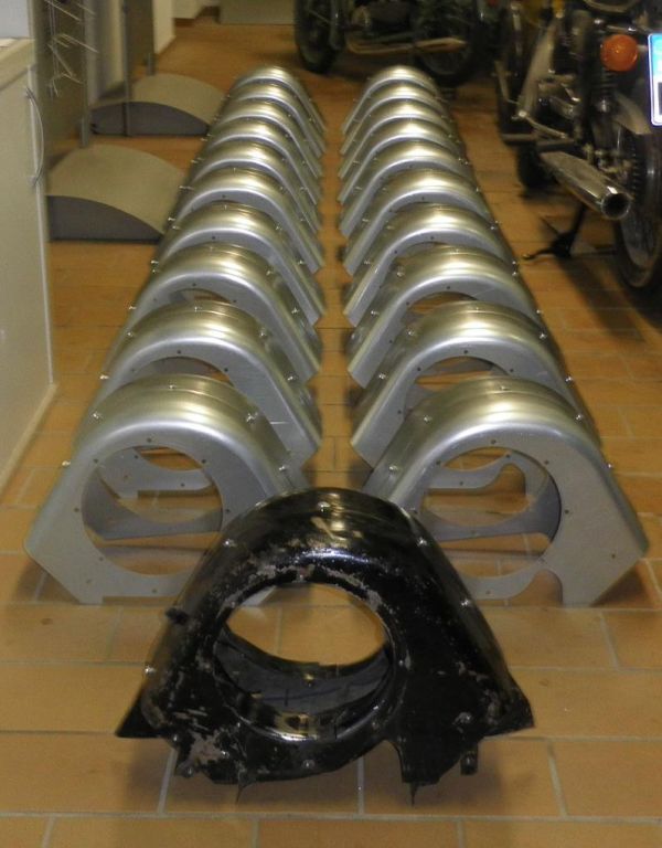

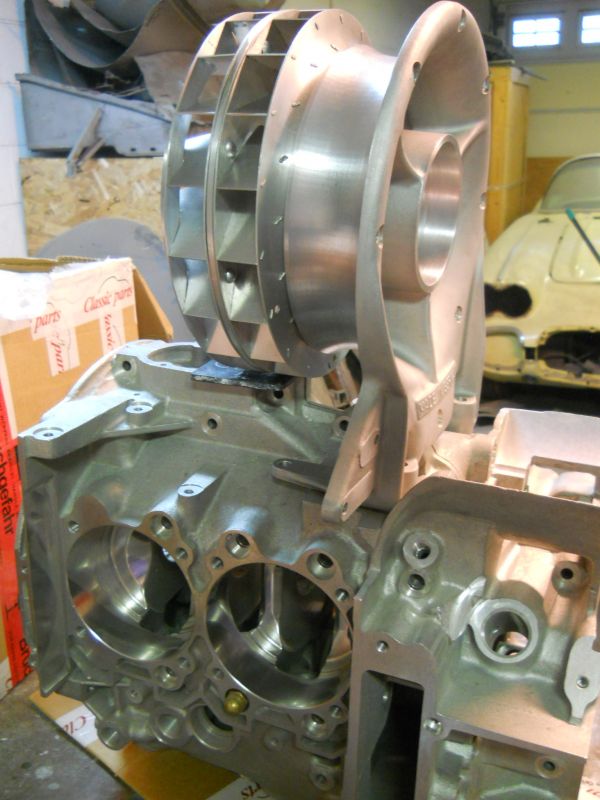

        My good friend Gerd Bruer (AKA: Blechqualer here on the forum) is well on his way to completing my new 4-cam fan shroud for this project. Below are a few shots he sent me of his masterful handywork!
        Looks like an old werks photo from back in the day! I think I see some GT tanks on the left there?
        He probably has more time in forming and shaping the internal veins than he does in the actual shroud itself.
        Can't wait until it gets here!!
        • #34
          Justin, don't you think its a good idea to build a extra spare engine as well now that unsere Blechqualer has some extra 4-cam fan shrouds laying around on his garage floor
          His work on the shrouds look really first class as well does his pictures from his restorations site.
          I'd love having the same set up as you are about to do for your #58367

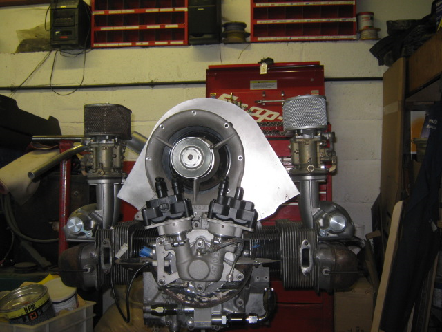

          • #35
            They are sweet - I could see one of those fan shrouds on my spyder. Would it retrofit a 356SC engine?

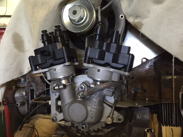

              Hey Andrew, Yes its been done several times over and it was Bill Sargent's "faux-cam" project on the Registry that's really shined a light on this conversion. As a matter of fact Bill introduced me to a really ambitious guy by the Name of Nigel Cousins in the UK who just set me up with a killer "coil stand"/mounting bracket for the eventual crank fired ignition system that's going on this engine. Take a look...
              Its a decoy 547 style V-drive which a pair of HEI Ford coils will sit atop to mimic distributors. Nice casting huh?
              Here it mounted on his 356 Push-rod engine with coils on top. Note the 4-cam shroud. The oil lines are fakes as there are no moving parts inside. You can see the degree wheel mounted in there with the sensor lead. His kit is specifically for 356/912 engines so I'll have to make my own mount plate for my polo application.
              Andrew, I'll start a separate thread for the rest of his offerings that will really get your mind racing.

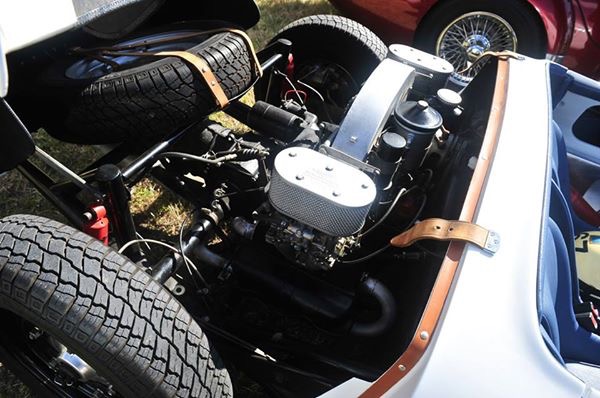

                    Nigel Cousins ( if its the same guy over here has really gone to town with his rep speedster. So hard to tell as it has a lot of 356 major items in it. Very nice work indeed. I attach a few photos of his car and I have a written article on him too somewhere.

                    I took these 7 years ago at goodwood. I have the article to find but I am so sure its the right car. It really impressed me as I usually only take a few photos.
                    Will try to find the report. I wanted one of the engine but don't have it.
