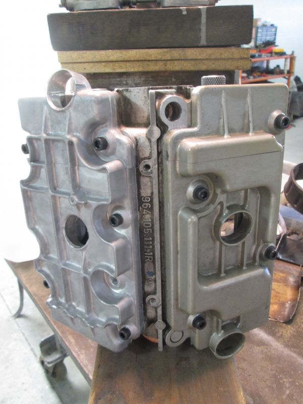

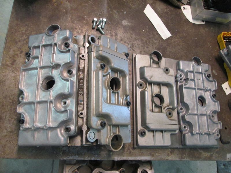

        I'm very familiar with these covers Michael and I was originally going in that direction until I decided to build this block with all 964 components.

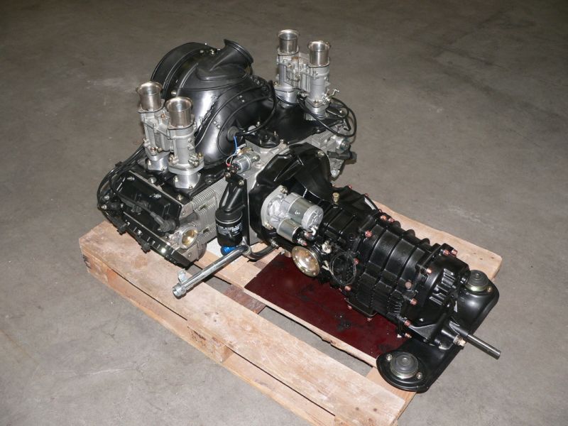

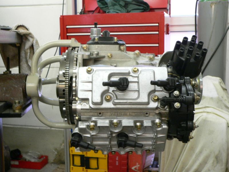

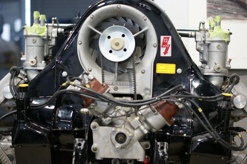

        Once I saw this guys engine I wanted to build mine as a 964 in miniature (as Mark said)too. Those custom covers also run 1k a set so I decided it wasn't that important for it to read "Porsche". That money will be better spent on an ARP head stud set.
        Thanks for all the suggestions you guys!
        • Nice picture of engine with the 964 valve covers. Does owner have website showing his engine build?
          Michael
          • He's a member here but has since gone dormant. He had posted a bunch of his progress shots but for whatever reason most of his images have been lost. Something to do with his host server I'm guessing? Its here: http://www.abcgt.com/forum/6-Hot-Rod--Modified-356/1845-The-Polopolus-4-cylinder-911-engine.html?limit=6&start=30

            Here are some shots of the finished engine.
            4 cylinder 964 engine....

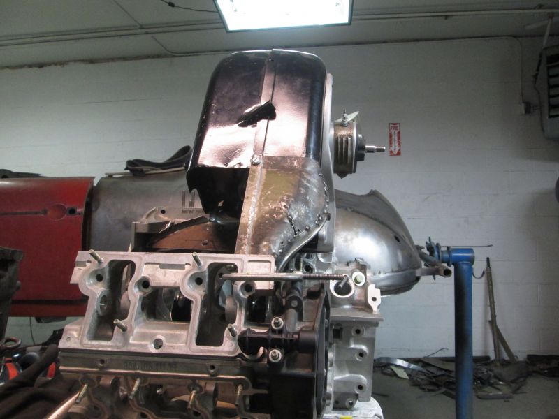

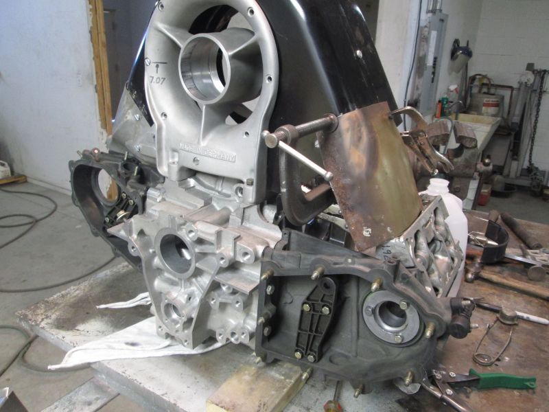

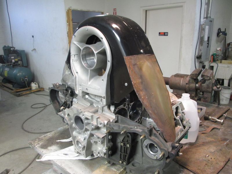

                This entry is months over due as I've been wrestling with and obsessing over the final shape of the forward lower closing tins. As time has allowed I've gone through several generations of shapes before I finally settled on one that suits my needs with the 964 chain boxes I'm running while giving me the final presentation I'm looking for. I know, who really cares how it looks as its just lower closing tin for god's sake but... I care, and if I don't like looking at it I'm just never going to be happy.

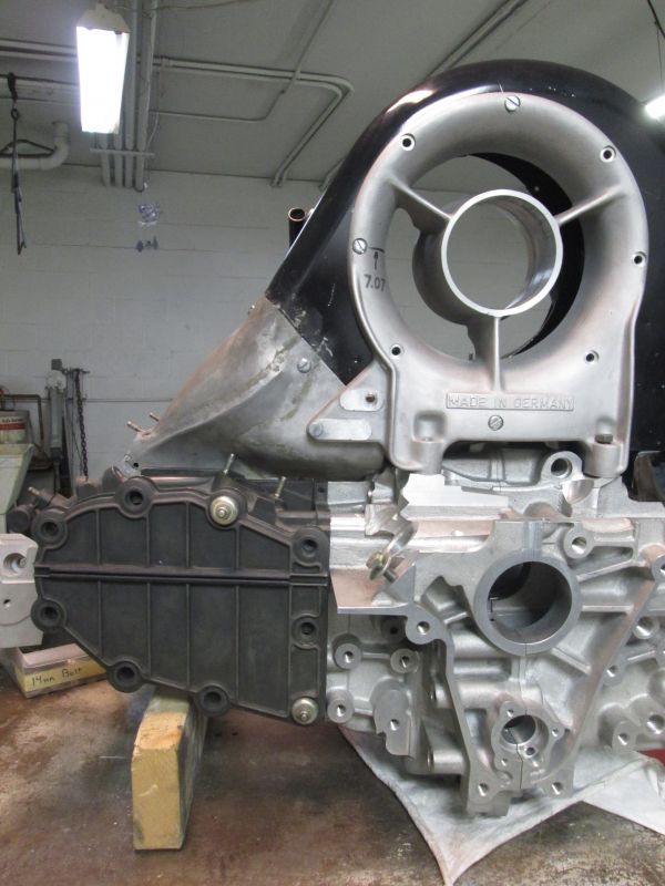

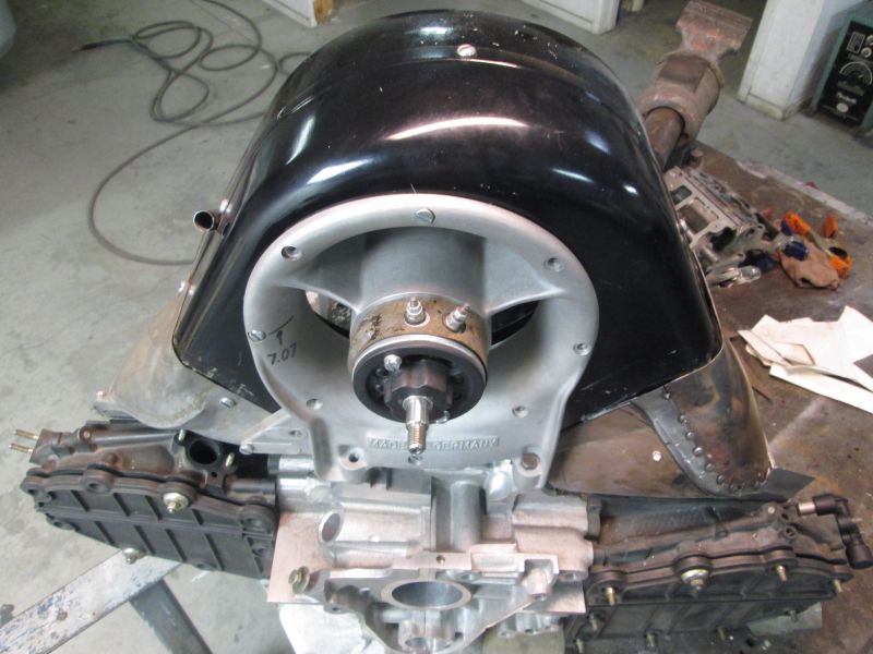

                This was where I was at several months ago and little did I realize I was heading in the wrong direction. I was relief cutting the tin to accomidate more of a 911 intake arrangement.

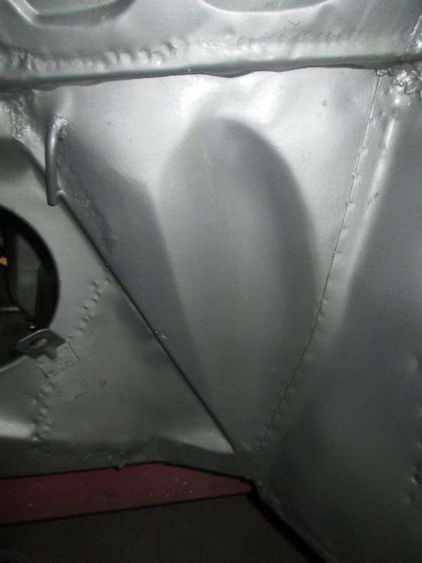

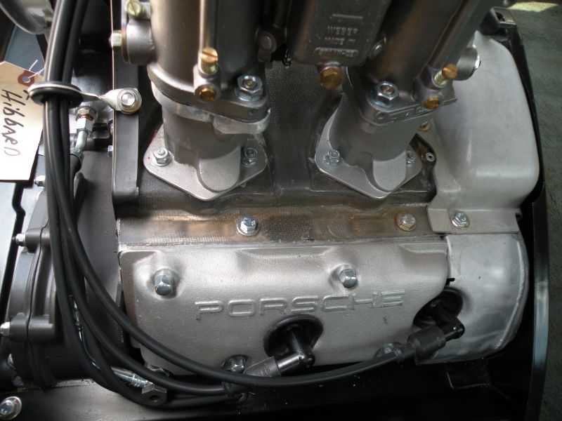

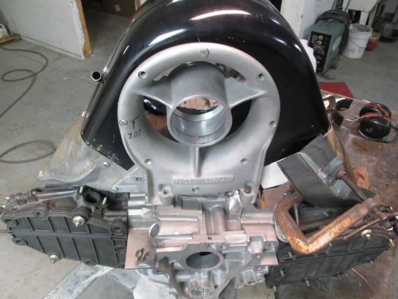

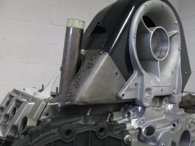

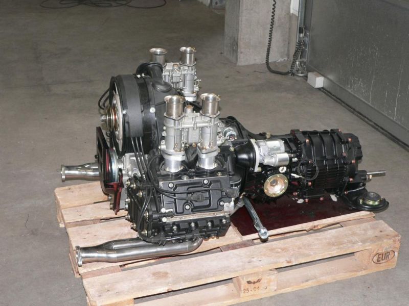

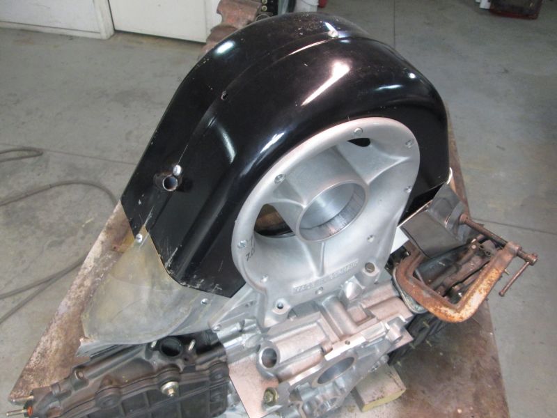

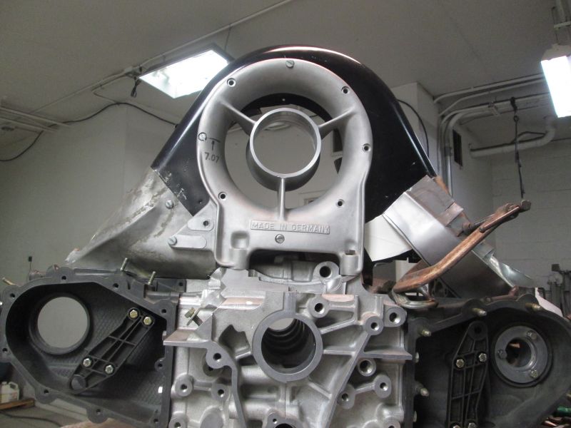

                By a timely coincedence I recieved this photo along with several others from Dean P. The Polo motor above is one of two Polo engines being fitted with 4-cam blower housings which are going into a pair spot on 550 replicas that Joe Cavaglieri is building. I had seen this engine several years before through Bill but they had yet to build the lower tins. BTW it was this engine that inspired me. Anyway, these are alloy mock-ups and the final parts will be done in steel but the basic shape just knocked my socks off. This is how they should look! The intakes manifolds are custom casting they did to replicate the carb position on a real 4-cam motor; Yet another critical build detail I was going wrong with.

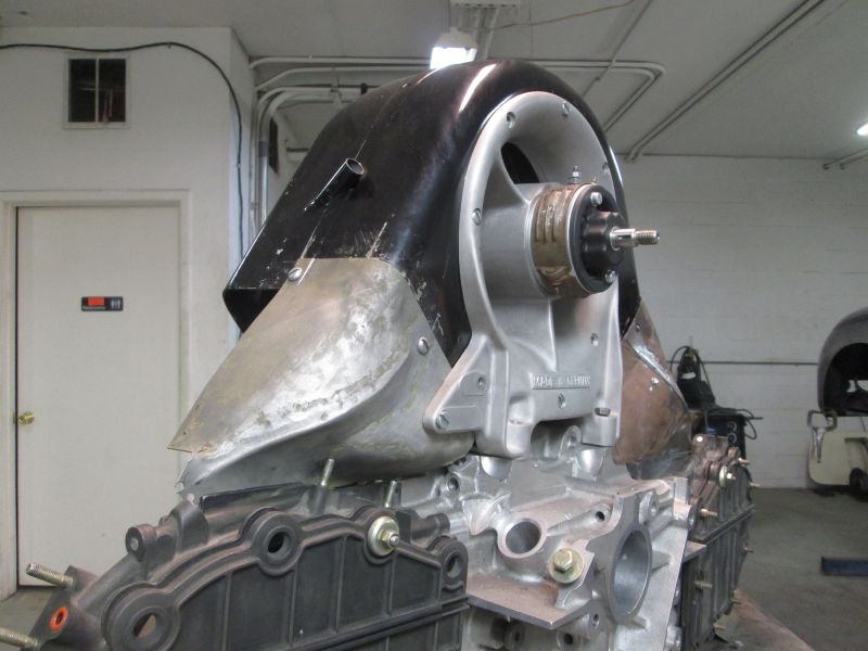

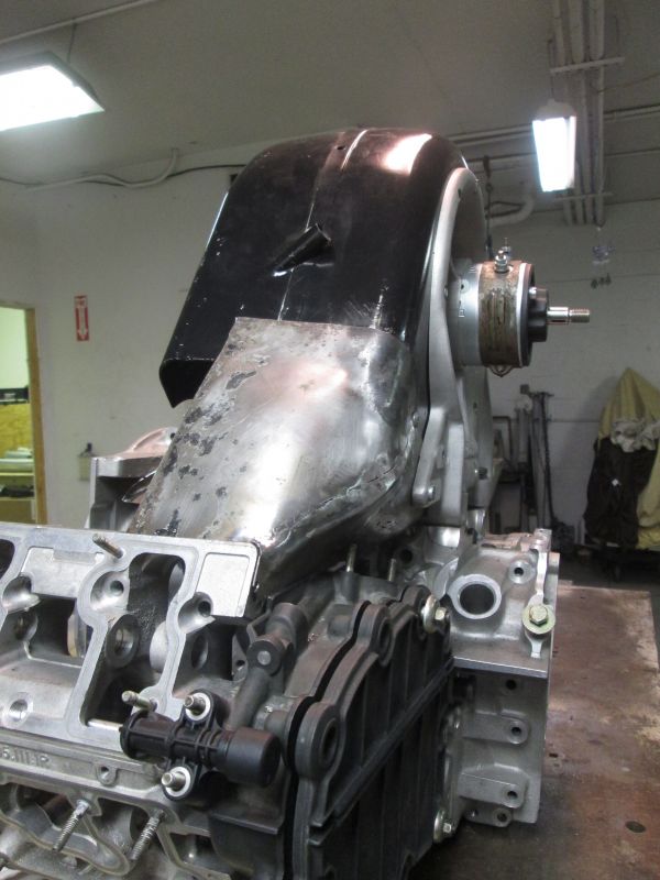

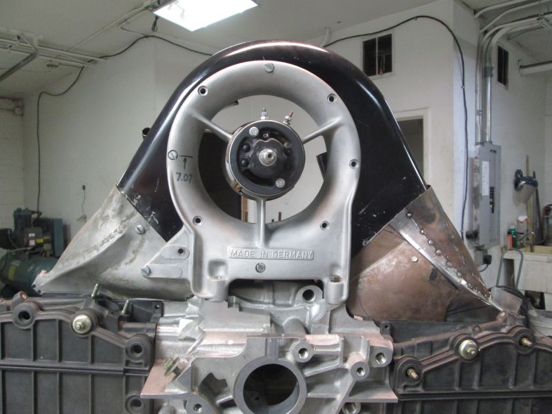

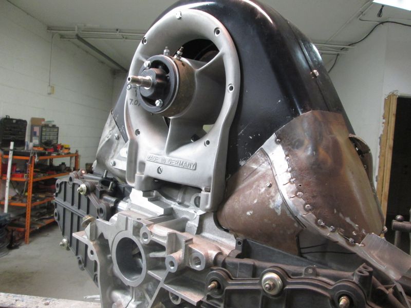

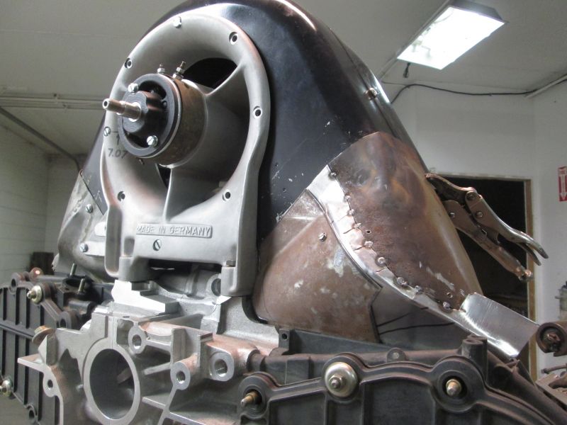

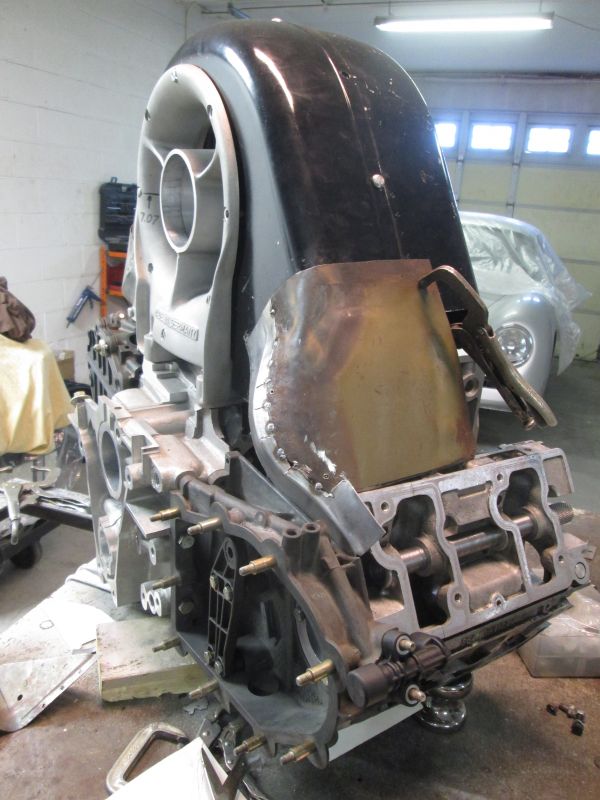

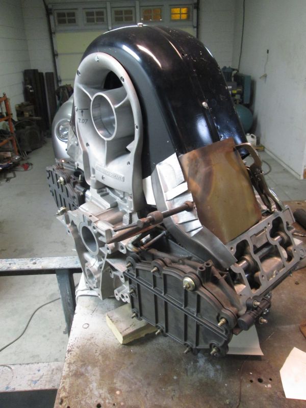

                After studying Dean's shots I was now completely unhappy with my rudimentary triangular extension. This is the difference between a pro and a novice like me.

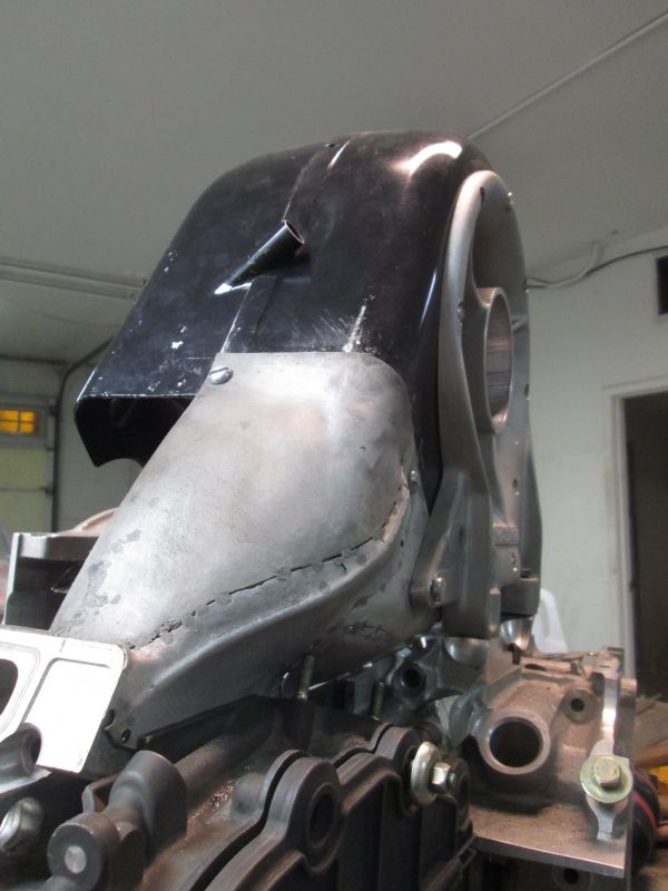

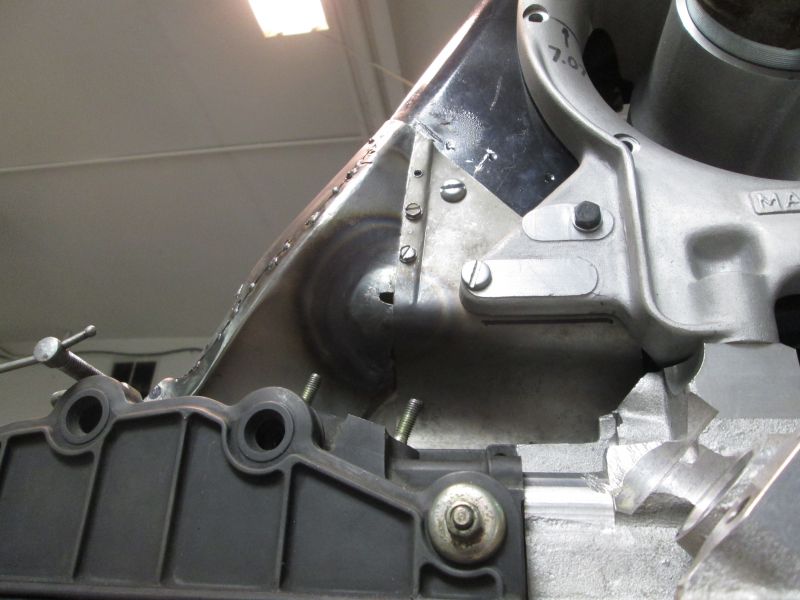

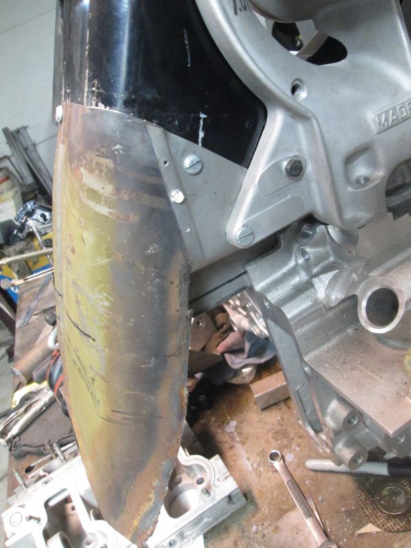

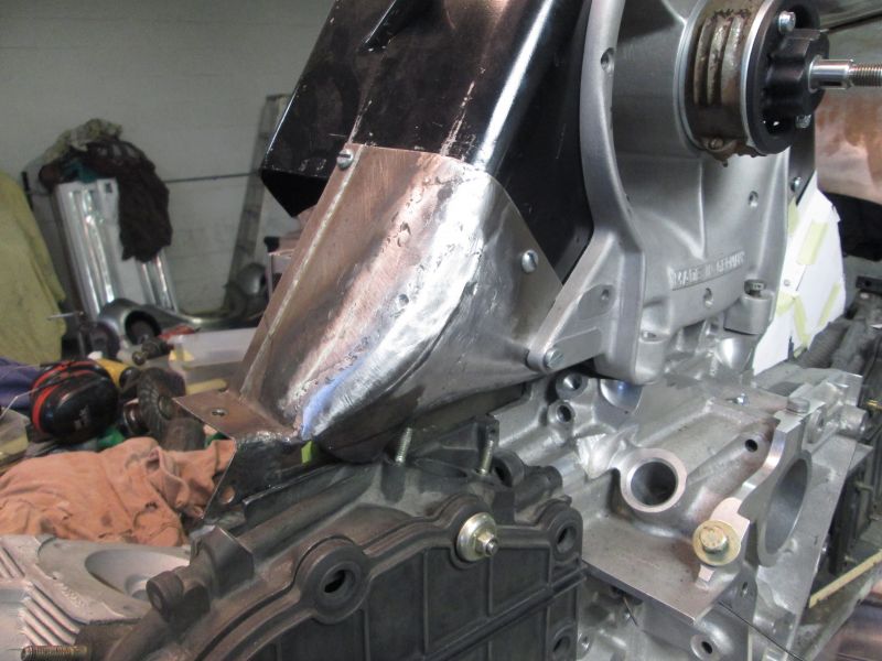

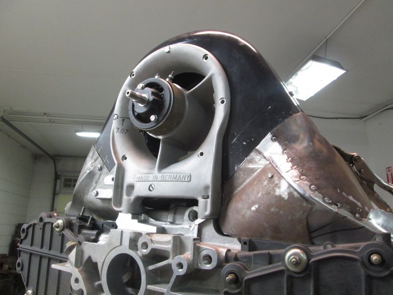

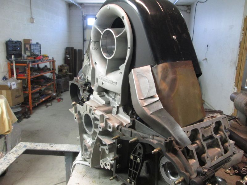

                Another detail I missed was how the lower tins flare and expand off the shape of the blower housing. I was incorrectly continuing the line down to the cam tower.

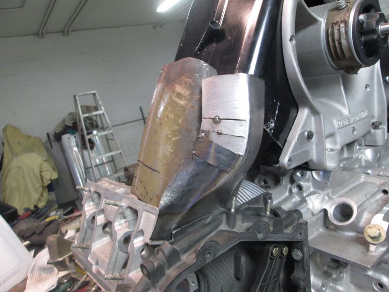

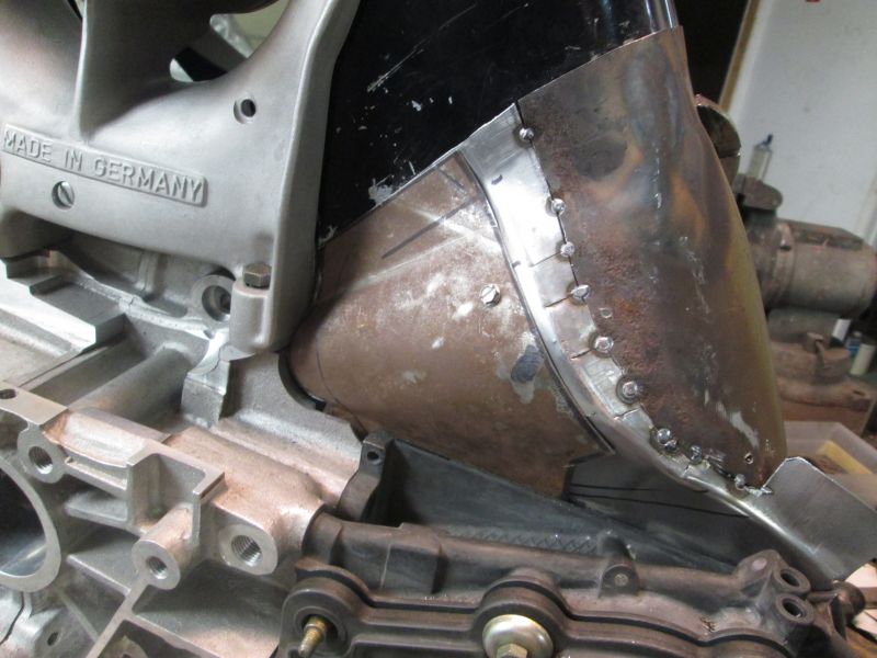

                This began my series of modifications to my first model to achieve a finished look that wasn't so simple looking and yet incorporated ques from both the Cavaglieri photo and the original tin all the while working with my specific application as these other polo motors are running the earlier and wider chain boxes. Not a tall order at all

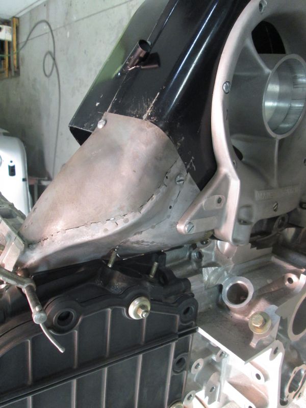

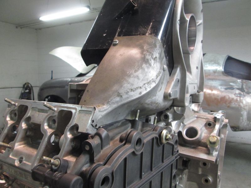

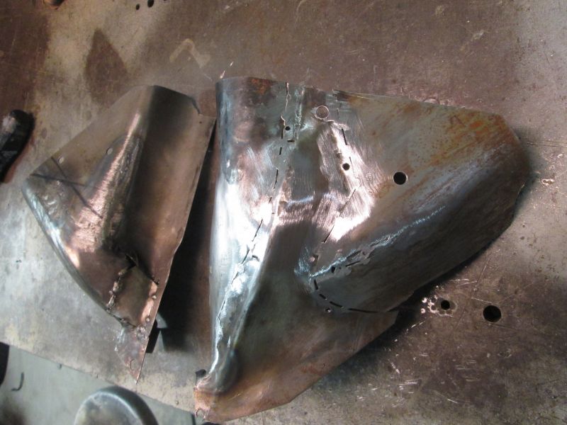

                After many weld , reshape and reweld attempts I had something a little better but I was still having trouble getting a clean relief shape in and around that chain tensioner cap that will eventually occupy that space. Again the earlier boxes don't have this so this is a change I have to make specifically for my motor.
                After several weeks and more time spent on it this piece then I ever should have or care to admit I still didn't have the final product I wanted.

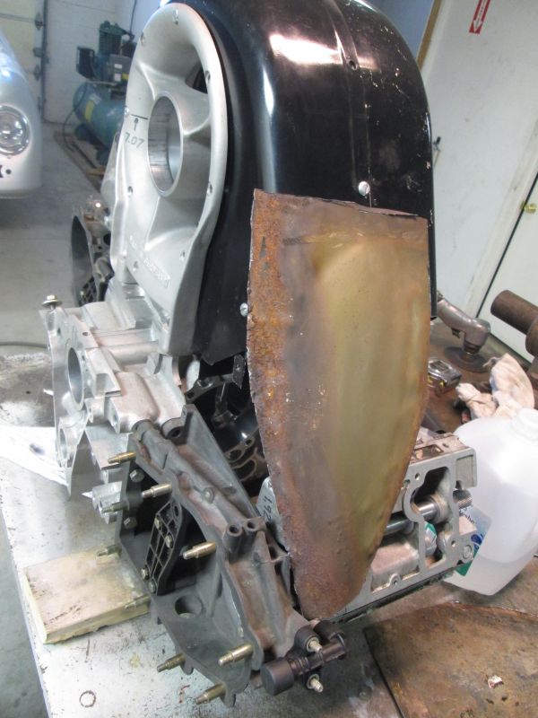

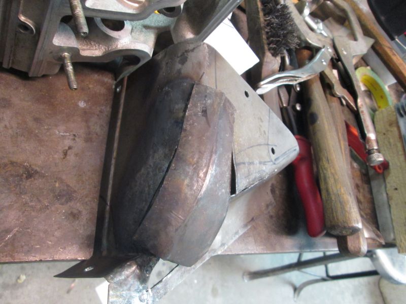

                Decided to scrap it and began rumaging through my remnant embossed chassis panel sections in search of basic relief shapes then started the expriments from there.
                There seems to be a pleat or raised relief where I've marked and I really liked it and wanted to replicate it in some fashion.
                However, when you study it from this angle it doesn't exist. The camera and the lighting in that shot was just playing tricks but it gave me a feature that I wanted to somehow incorporate.

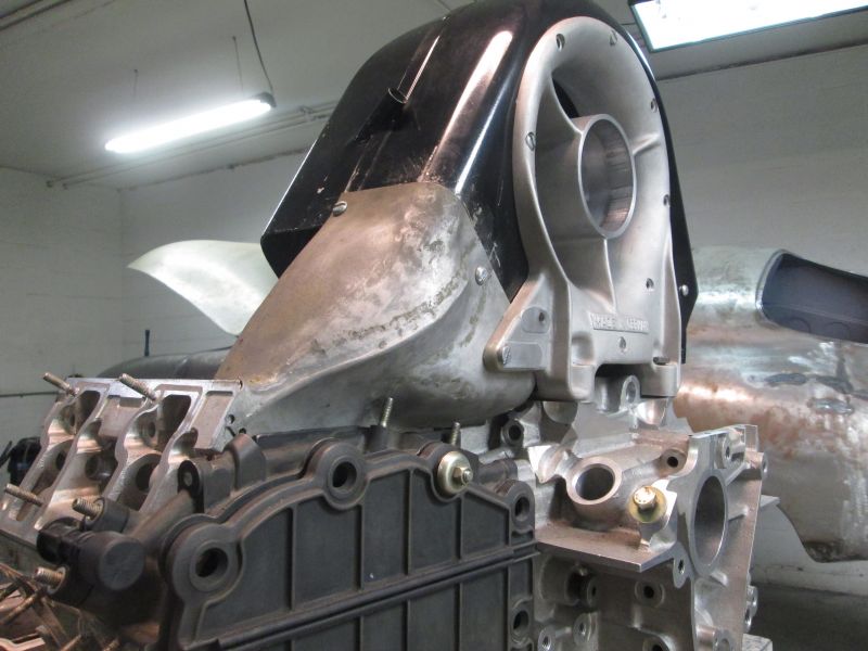

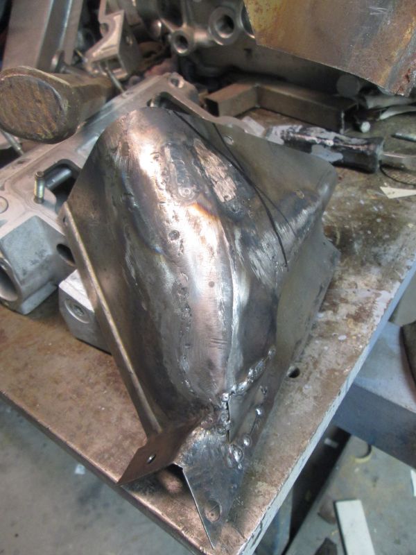

                As it slowly developed I experimented with an overlap two piece section like the OG four-cam metal showed above.

                • Justin,
                  It took me quite some time to go through all the photo's to understand the situation. Finally towards the end it became much easier to see exactly what you wanted. The final photo does show what I would want to see myself. When finished off I think it will look ' in keeping ' with the flow of the other casings. Really so difficult to get your head round that. But... worth all the time you have spent getting there.
                  Half way through my study of the problem I wondered if a form of templates could be made but with all those opposing curves it would be difficult to produce likewise drawing it would be the same. Lucky you had those photos sent to you to keep you on track and finding another way.

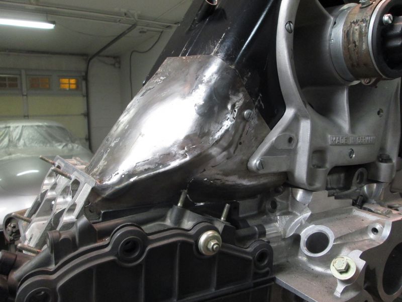

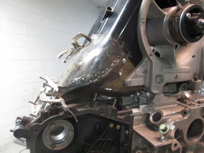

                    Remounted one more time before I trimmed away the excess metal. Tack welds dressed so I could do some light planishing and shape adjustment.
                    Its about right down the middle as far as the form following function and at the very least it's a shape I can now live with. Have to as its way past time to move on. I can't waste any more time on this one section.

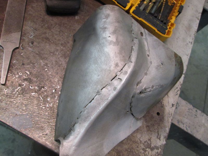

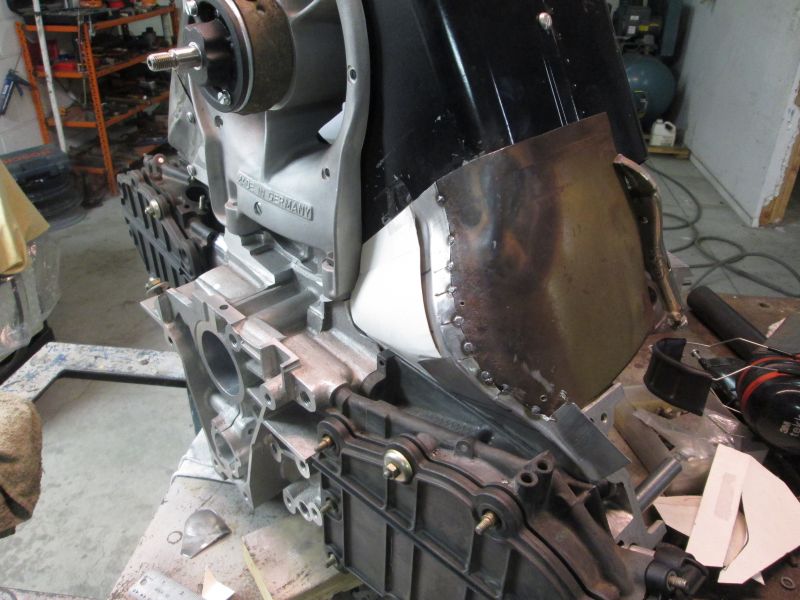

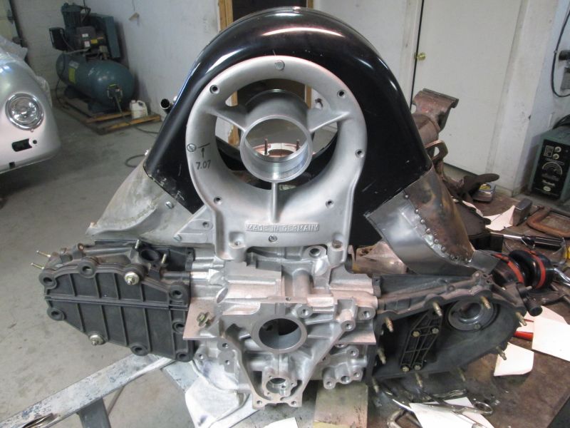

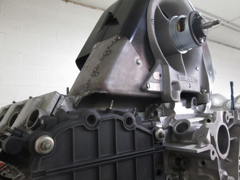

                    After a nice bath in acid to get it clean for TIG welding.
                    • 4/8/17
                      Stitching it up. From a few weeks ago.

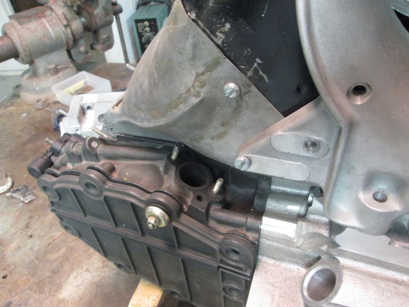

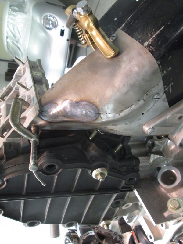

                      Remounted before TIGing to preserve shape and mount hole alignment from heat distortion. Made that mistake on the last version.
                      Much easier to weld with the motor on its side.

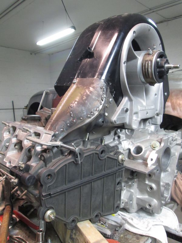

                      Began slowly stitching it together.
                      Just about welded up.

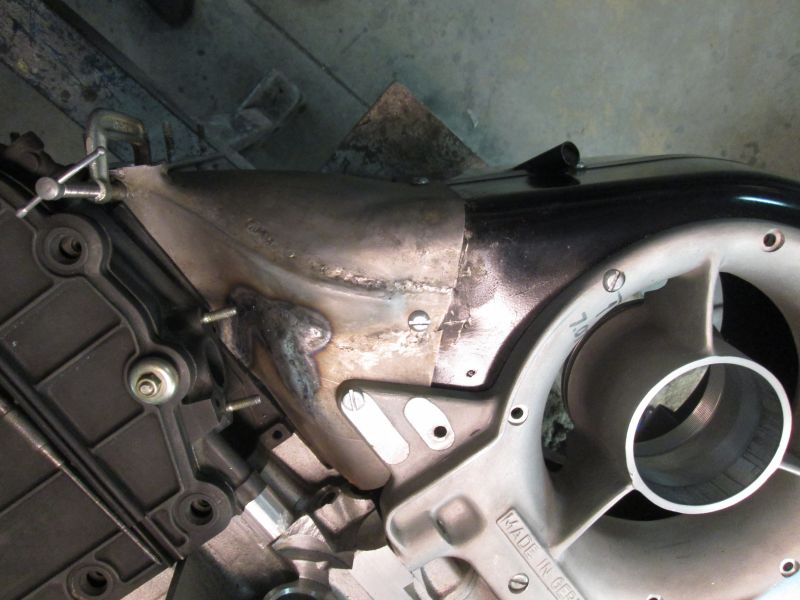

                      dipped in acid again then areas in and around the welds planished for desired shape.
                      I like it alot better than my first attempt.

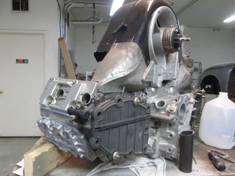

                      I'm expecting some slight clearance issues with the eventual cap but it shouldn't require too much adjustment.
                      Not 100% done but close enough for now.

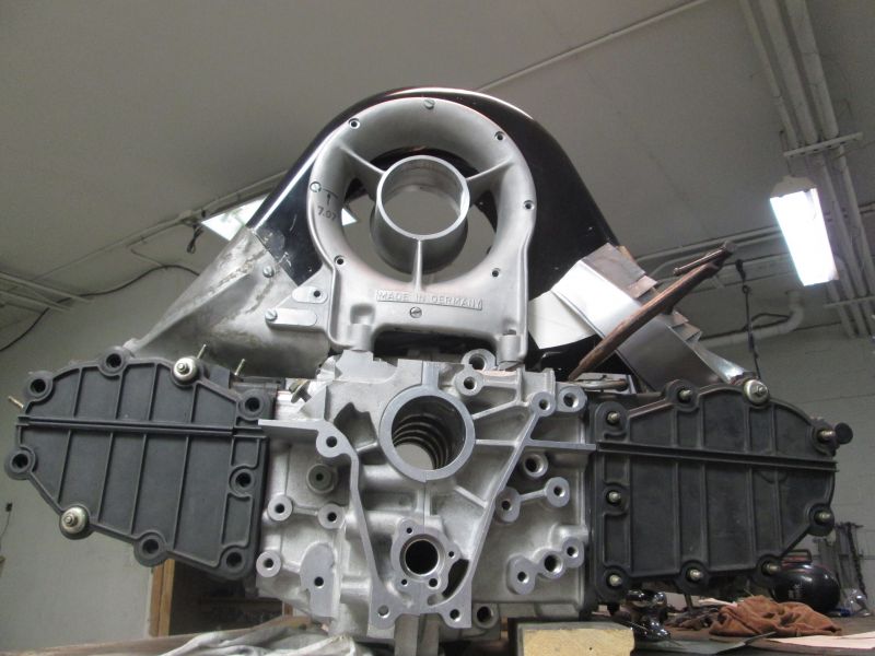

                              Cam tower and valve cover sectioning complete.

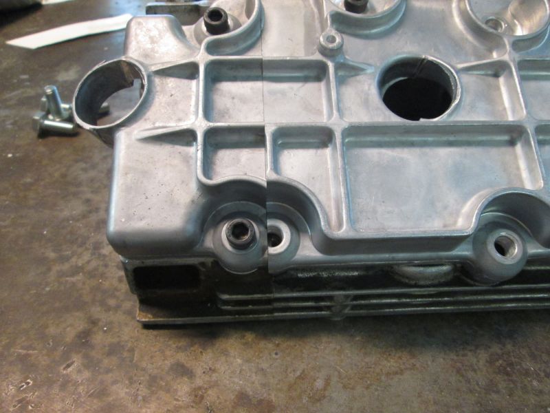

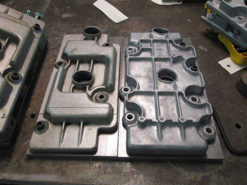

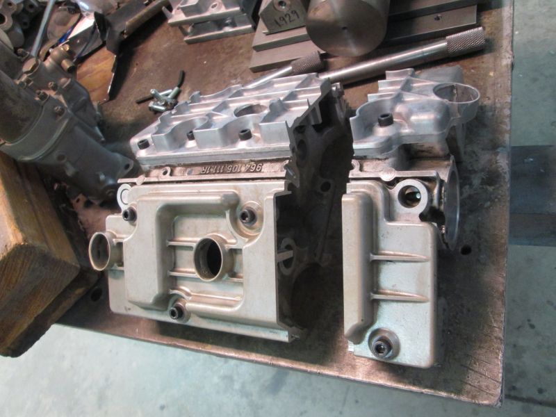

                              Bill was finally able to finish sectioning these parts so I can move onto the tricky part of getting them TIG welded back together with as little deformation as possible.
                              Lower covers sectioned just like the towers and upper covers before.
                              Won't be a seamless transition around this lower portion but will detail shape it as best as I can after welding.
