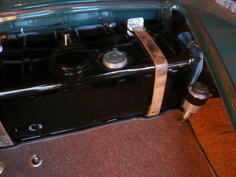

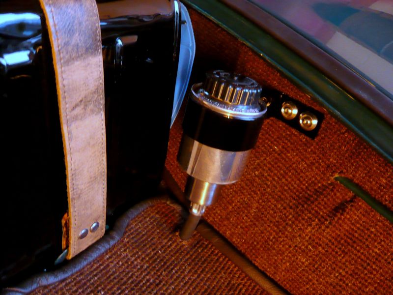

    Justin and all, I did a dual MC conversion on my A. Sorry I don't have any pics on this comp. Will post some tho. I didn't want to see the fluid reservoir from the outside. I took the reservoir from a 69-73 era 911 and mounted it inside the access panel for the steering unit. The curve of the reservoir fits the back left curve of the opening perfectly. Looks like it would be factory. I took the factory mounting bracket and reconfigered it to have tabs so it mounts to the lip. With the lid in place you will not see it. It should be visible for a quick visual inspection by looking up through the round DS body opening. Again, sorry for no pics.
    • #47
      I did a little trick with an oem single circuit reservoir for fluid fill in only. It is connected to a dual circuit reservoir hided under the bonnet, clean looks, nice function...... just my 2ct

        Tom, thanks for the links and for posting some shots of your conversion. I like the use of the old alloy res. It must T-off under the trunk floor to feed both ports I assume. The leather binding on your carpet really looks first class BTW! leather tanks straps are also very interesting.

          Tom, that looks really nice! I also like the straps on your tank. What is that cap over the sending unit? As for using the single resev. to fill the system vs. dual... If I understand it correctly, if there was a failure on one half of the system, you would lose all the fluid from the reservoir but leave the fluid in the half of the system. So you would still have brakes, and hopefully recognize that something was wrong, I.e. reduced braking capacity, and then check your system. So another words not wholesale failure.

            You described it correct, simple physics in here. The system works identically as an dual master system with the two chamber pod.
            Thanks for your comments on the leather straps on the tank, I will tell something about that in my post about #115368
