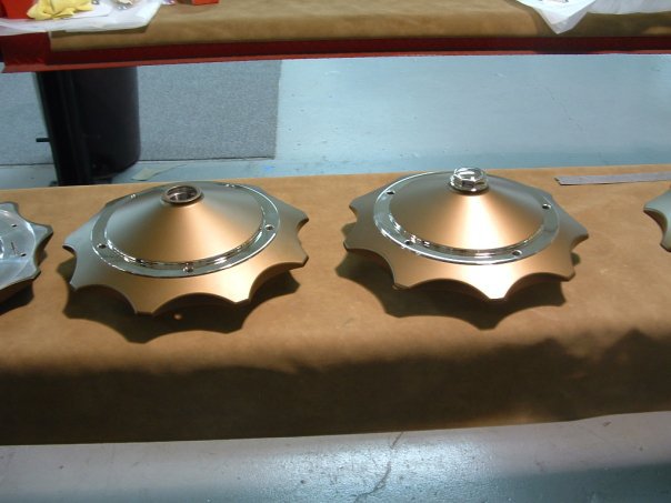

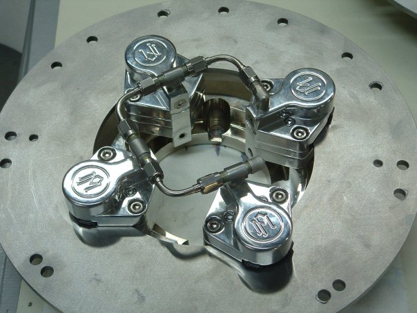

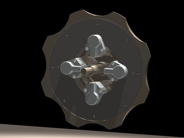

            I've been meaning to share this really trick, custom, one-off street-rod Annular disc brake design I found for the old wide-five Chevy bolt pattern. Certainly not for 356 but very 356-like and could certainly get the juices flowing for a custom 356 application.

            Impressive CAD design.

            Into reality..

            Here's the really cool part: Individual four piston design mounted all around. What a cool idea!!
            • #66
              That's a sweet set up for sure.
              • #67
                Man what a nightmare that would be to bleed.
                • #68
                  Yes, very trick but not practical.
                  • #69

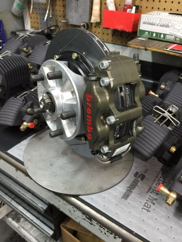

                      Below are some shots he said I could share of a 356C disc brake upgrade he was commissioned to build for another hot rod 356 that's being built.
                      Fully vented and slotted with Brembos!

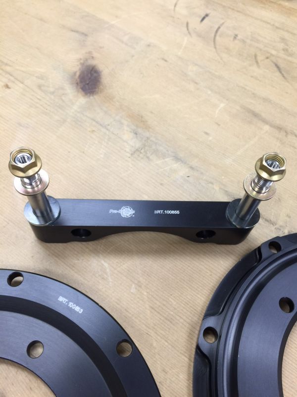

                      Alloy hats and custom adaptor for C-spindles.

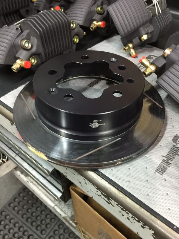

                      Forgot to ask him if the rotors float??
                      Same for the rear, fully vented and slotted. Trick, trick, trick. Says, he can build one more set... Any takers??
                      • #71
                        Contact info?
                        I know of an Outlaw 356 in my shop that needs those.
                        • #72
                          Thanks for the kind words Justin but it pales next to your work.
                          Mr. Warehouse you can reach me at apage@prosystembrakes.com.
                          I have everything for another set. You will have to have C front spindles and rear virtical links for a "bolt on" fit.
                          Ashley Page

                            Well have to say, that work looks so impressive, really super. Makes my old drums look as though they belong in the Arc!!
                            Great photo's.
                            • #74
                              Nice of you to say Ashley but I just fill in rust holes. I don't produce parts like this; I'm the guy buying from developers like you and if I were running disc's I'd own this set for sure!
                              Can't wait to see them on "curb Appeal" Greg.
                              • #75
                                Seemed like a great idea, but I have dropped spindles, so no go....
