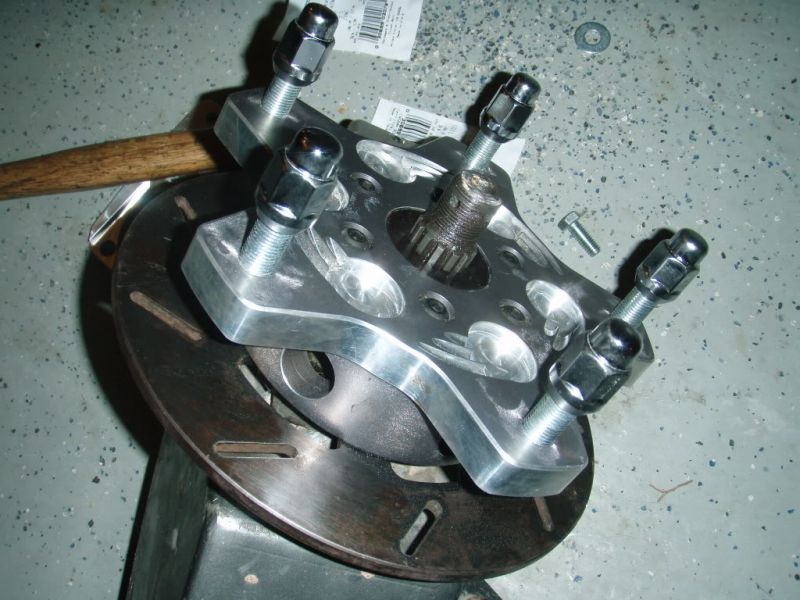

      Hey Mark, I think the alloy hub is black anodize but the steel rotor is probably a black oxide finish. Its gone after two Stop signs but it keeps the edges and the brake pad non-contact points on the rotor from rusting. Also looks really cool when you pull them out the box for the first time.
      A cool looking small to wide adapter...

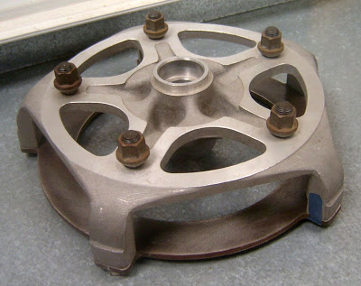

            old Maico annular type disc brake conversion for VW and/or Porsche. I believe this kit was introduced in the late 1960's. Cool looking,Too bad they never offered a rear kit...
              Thanks Justin. I agree with your commit on the sand rail stuff. I should have been clearer on that. It sounds like I was critical overall. What I was trying to get across applied only to using the parts on a car like the 356 or heavier car.

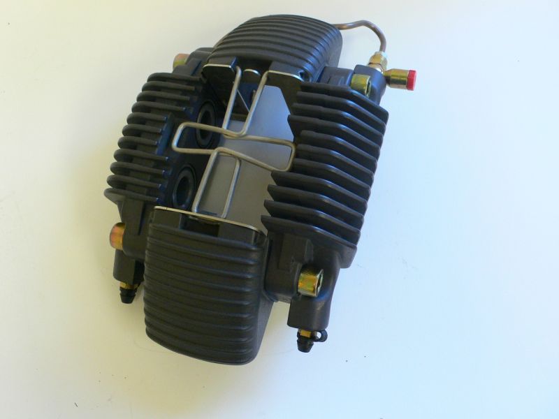

              Those parts are no doubt good used in their intended market. CNC has been around for a long time and is well thought of in the off road market. Wilwood also has a very good reputation and my company has a great relationship with them. We sell their products.
              We test brakes and brake components of all kinds and manufacturer a lot of brake components. For years NASCAR has been our primary market but we are also involved in road racing and vintage racing. The picture below is of a 917 or 73 RSR caliper that we manufacturer. We have the castings done outside and do all the machine work in house. They have been on a lot winning cars in the FIA vintage races in Europe.

                I think that Maico brake is really cool. In the past I tried to track down information on that but hit nothing but dead ends.
                That would make a very nice brake kit for a 356 but, again the problem would be getting pads. The Maico caliper takes a very unique pad and that is one part I could not find.
                If you are going to put a brake kit together, especially for street use, the pad and secondly the rotor is where you start. If you use an odd pad or rotor then you are headed down a dead end street.

                            You're making those 917/935 calipers?? Those are absolutely gorgious! Same as a 930 but without the cooling fins correct? I've seen those advertised through Zuffenhausen; they are your distributor then?
                            Thanks! Justin
