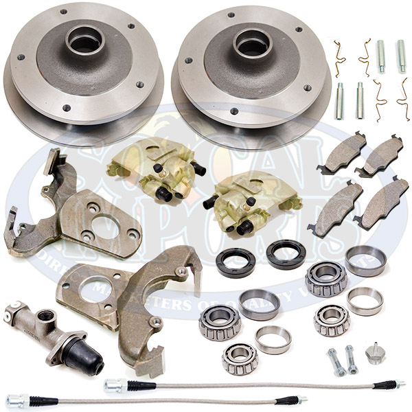

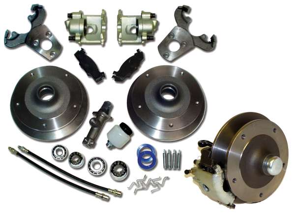

    Economy cast iron Wide-five disc brake conversion kit.
    Might require a vw spindle or drop-spindle if desired but after that it would be a direct bolt-on to your 356 front trailing arms.

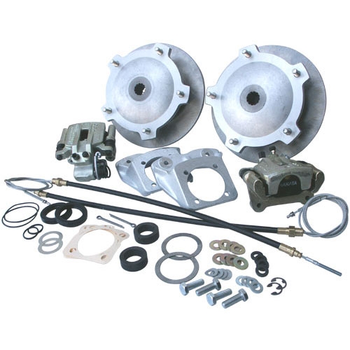

    CB performance rear disc brake conversion kit with parking brake. I know that the rear axle bearing and seal kits are the same for VW swing axle to 356 so this kit should be a direct bolt-on.

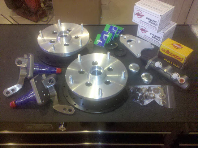

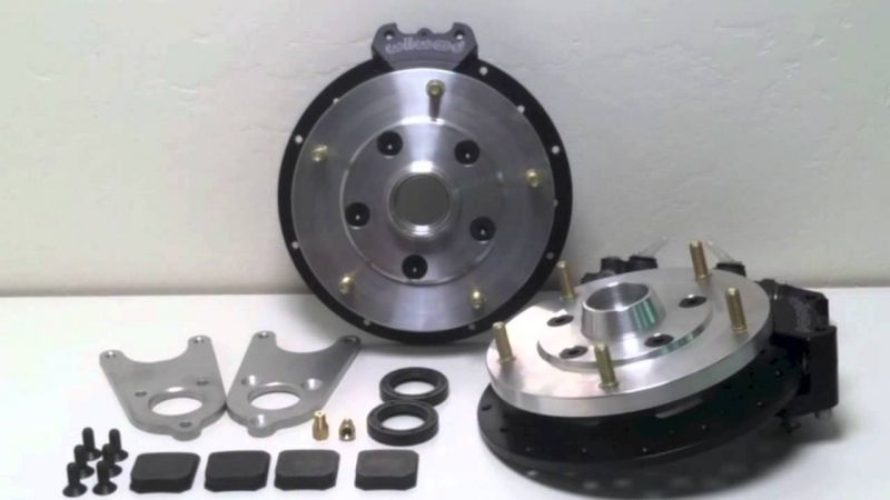

      Little more trick conversion by CNC with alloy hub. A buddy had these on his swing axle sand rail and worked beautifully. Especially when you consider they had to deal with tall paddle tires. I like the large holes in the center; really look trick and remind me alot of the same holes the old time racers used to drill into the GT drums on the Carrera Abarths and Spyders back in the day. Justin

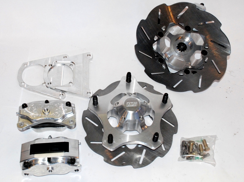

        Another rear kit offered by Poly Performance

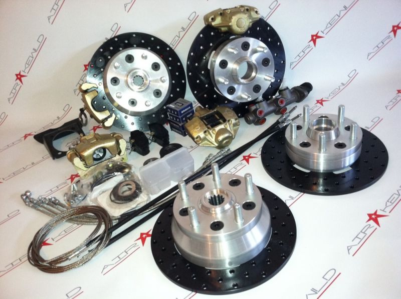

            http://airkewld.com/products-page/front-disc-brake-kits/1955-65-porsche-356-front-disc-brake-kit-stage-2-5x205mm/
            This is a kit from Airkewld. Made in USA, no far east stuff. One nice thing about this is the bolt pattern can be changed. It is three pcs. hub, rotor & bolt pattern so you can go wide or small 5.
            http://airkewld.com/wp-content/uploads/2012/10/Airkewld-Stage-2-Wide-5x205mm-BAD-Series-brakes.png
              Thanks Mic.
              yes, they offer some killer looking disc brake kits! here are a few images:

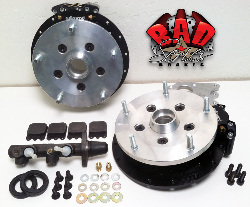

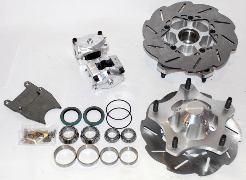

                A little trickier looking still... I really like these!
                Rear
                Front

                  Just basic no frills cast iron assemblies with single piston calipers. All if not most of the components probably manufactured in China. Price is 750.00.
                  Same basic kit So Cal Imports sells (photo 1 on page 1)

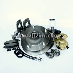

                    Disc brake kit offered by Zims

                    Again same basic offered by the other two vendors above. However Zims offers two versions of this kit to work with either the VW type 1 Pre-A and 356AT1 spindle or the later version 356AT2/356B spindle. (stronger shank and later style bearing) Kit price: 750.00
                      The Air Kewld clearly look like the nicest option out there, but not inexpensive. Does anyone have any experience w the basic Chinese kits, which Brock is referring to? I like the price, but hesitant about using inferior Chinese shit parts, if this is the case. I am soooo sick of poorly manufacture Chinese tools/stuff that I try to avoid them if at all possible. Thanks, Mark
                        Another question, Is a single piston enuf to stop these cars effectively? I realize many cars including 911's use single pots, but if you are upgrading should one consider the two pot AIr Kewld system or would it be overkill?
                        Edit, it looks like the AK setup is not two pots.
                          I think I read that the Airkewld set up is about 30# lighter than the cast iron set up. That's a pretty big difference.
                            Thats alot! Especially when your talking rotating mass and unsprung weight.
                            Mark, that might be thier base offering as far as calipers go. Other photos show those really cool Wilwood units. These cars really weigh nothing so I am quite certain the single piston/ single pot calipers are more than adequate to do the job; especially for street driving demands.

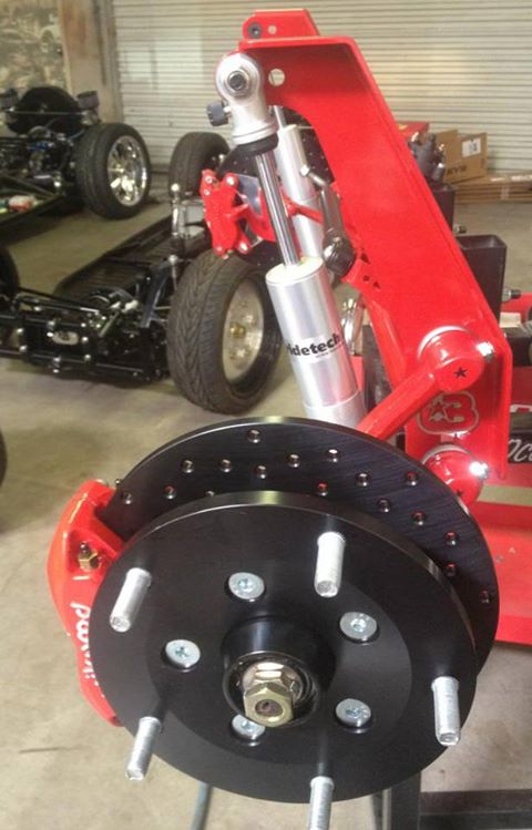

                            Another shot of the AirKewld unit with what looks to be 4 piston Wilwood's. Interesting shocks too! Air adjustable??
                              Does anyone know what the black finish is? I assume its anodized aluminum. I wonder if it has any affect stopping? Also, as it wears and exposes the silver and needs a refinish, then what do you do?
