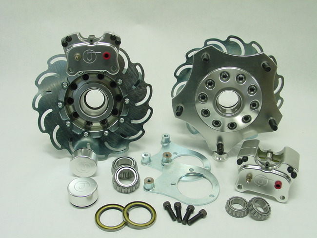

          Here's another really trick sand car set of wide fives you probably wouldn't be able to get pads or rotors for...

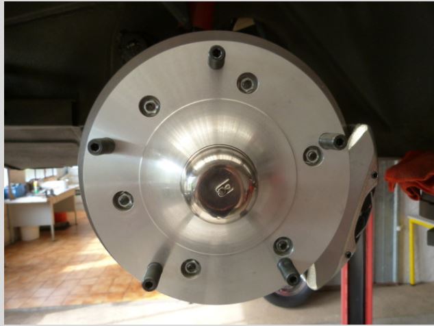

            I have read this topic with interest and after aprivate discussion with Justin here are my comments
            Over there in Europe, more and more 356 owners wants to use their cars, despite their continous rising value as daily driver.
            The major problem is aluminium drum brakes who after so many years are very often very worn
            The solution is to change aluminium drums by disc brakes
            CSP (Custom and Speed Parts) a German company offer a reversible ready to fit
            solution
            • #36
              CSP disc brakes fits without any modification and it is always possible to revert to the aluminium drum brakes to resale the car
              My own BT6 outlaw Porschinelle was fitted with these disc brakes

              • #37

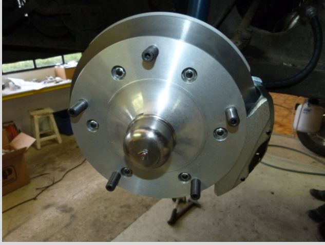

                • #38
                  after conversion

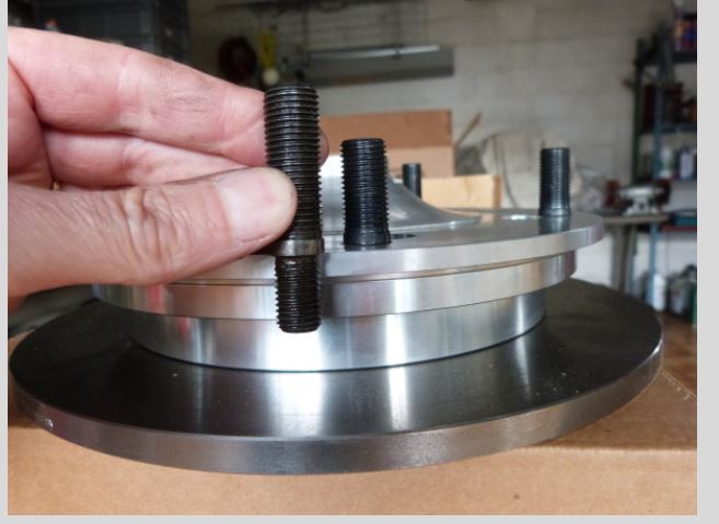

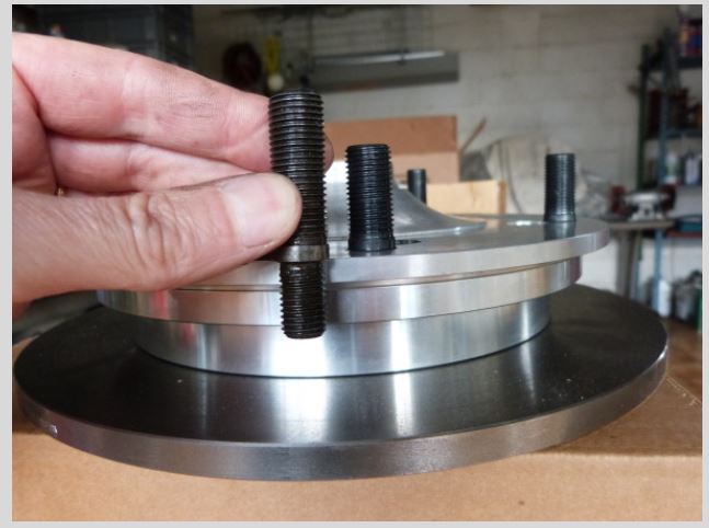

                    • #40
                      Originally posted by Porschinelle" post=9907
                      Some pics taken during the conversion
                      Are the spacers required on this setup? It looks like you have some spacers between the wheel and the hub.

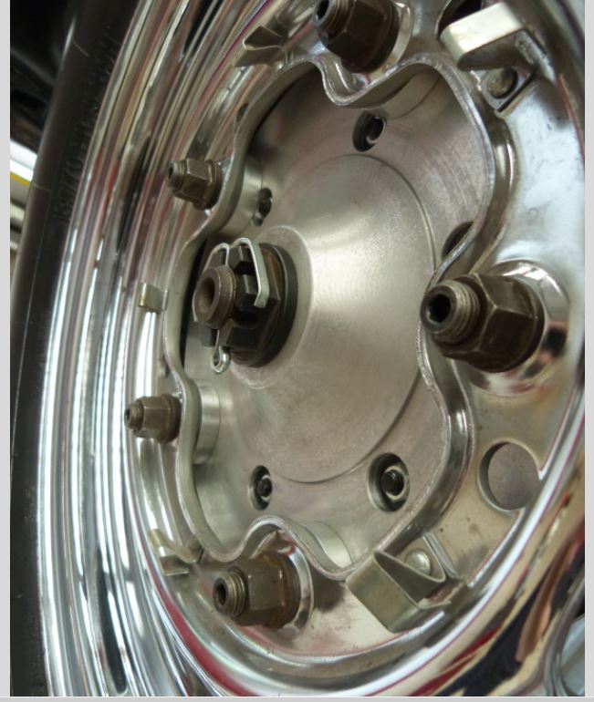

                          Disc Brake 5x205
                          Bug/Karmann Ghia -'65 ZO-version (zero offet) cross drilled (for CB-spindle)
                          at the front, stock drums (longer studs) in the back. Change of the spindle is needed, but offers you several more options. You can find those option brake systems here:
                          http://www.csp-shop.com/cgi-bin/cshop2/front/shop_main.cgi?func=det&wkid=51739280427&rub1=Wheels%20%2F%20Brakes&rub2=Brake%20Systems%2CBrake%20Systems%20front%2CB eetle%20%2F%20Karmann%20Ghia%20%2D%2765%2CPCD%205x 205&artnr=15458c&pn=0&sort=0&all=
                          Have fun,
                          • #43

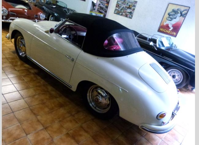

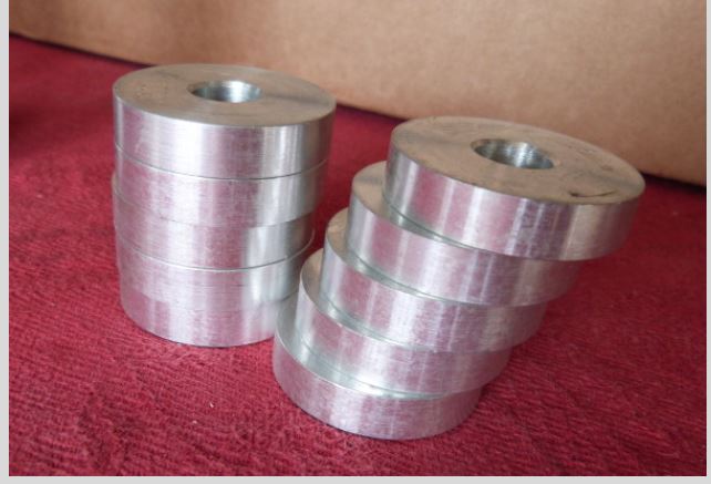

                            Hi Mark
                            Hi Justin
                            The new owner of that 1959 convertible D has particullarly asked for the back wheels to be extended
                            The spacers are supplied by CSP together with the longer studs

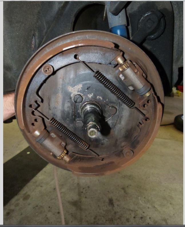

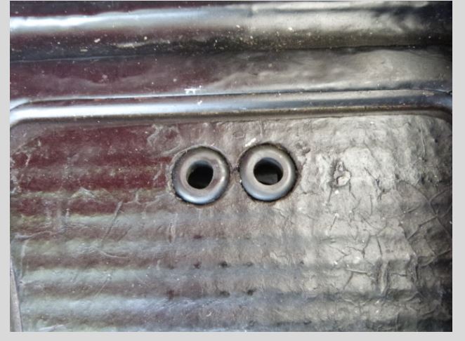

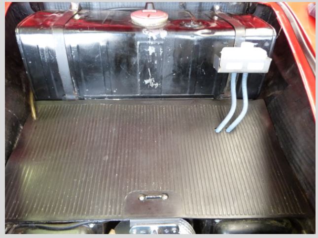

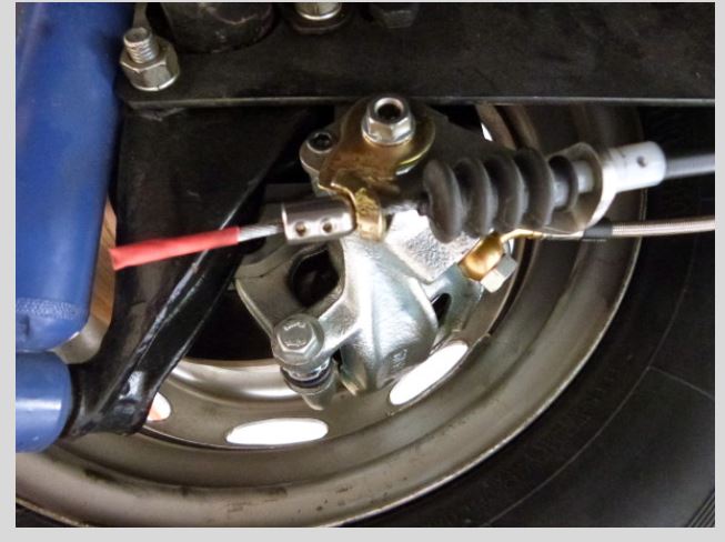

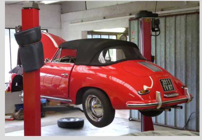

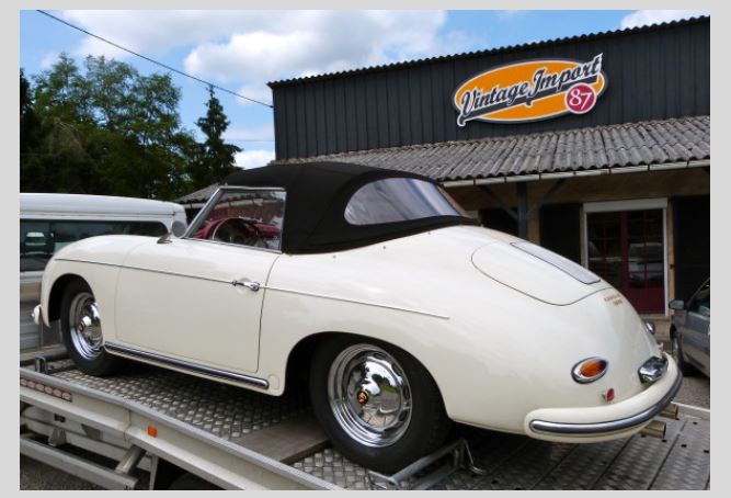

                              • #45

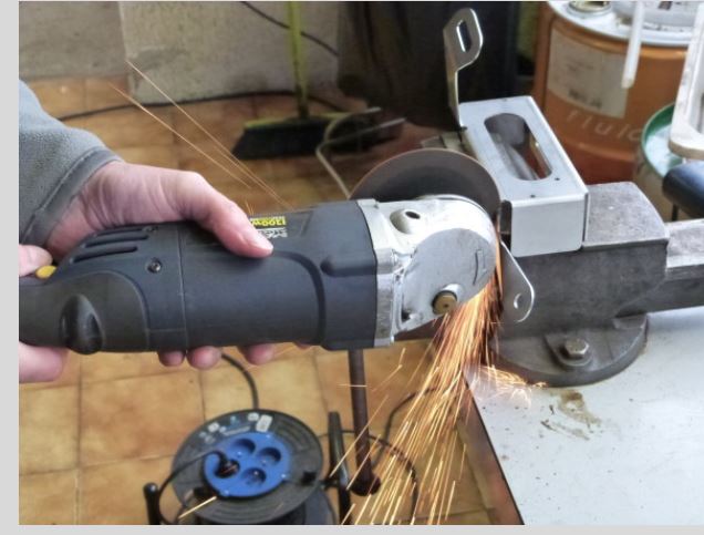

                                Another CSP conversion done by my friend Bruno some month ago on a pre A cabriolet
                                This cabriolet belong to a couple of English who have retired in the country near Limoges
                                They have had this car for more than 5 years now and complain of brakes problems since they have had it
                                First step was to remachine the aluminium drums to make them turn free
                                Small ameloration but not what they expected
                                Decision was then taken to change the front drums to CSP disc brakes
                                Herewith some pics taken during the conversion
