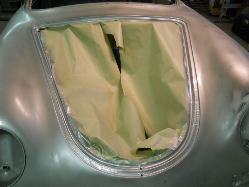

                Trunk jamb into final color. The hood must be installed when the body goes into final paint to ensure uniform shade and coverage. Once thats done removal and reinstallation of the hood is always a dicey proposition with a high risk of cowl damage from the corners of a loose hood. So once its painted I made the decision that I did not want the hood to come off again.

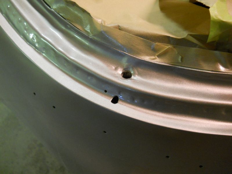

                While wet sanding and working the hood in these past weeks I noticed that a good amount of water would just pool in that second step right at the rubber seal. Standing water is my biggest concern though not original I decided to add that secondary drain hole at the base. Only a sliver of it is visible once the seal is in and its more piece of mind for me that this moisture has some place to go other than accumulating and finding a breach to gain a foot hold.

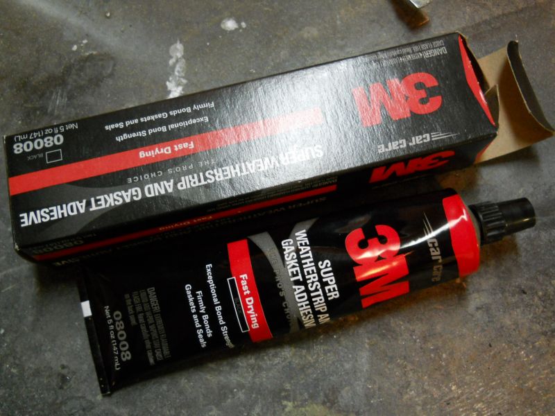

                The seal goes on next. The factory manual calls for adhesive as well as the set screws. This black 3M seal bond is perfect for the job.

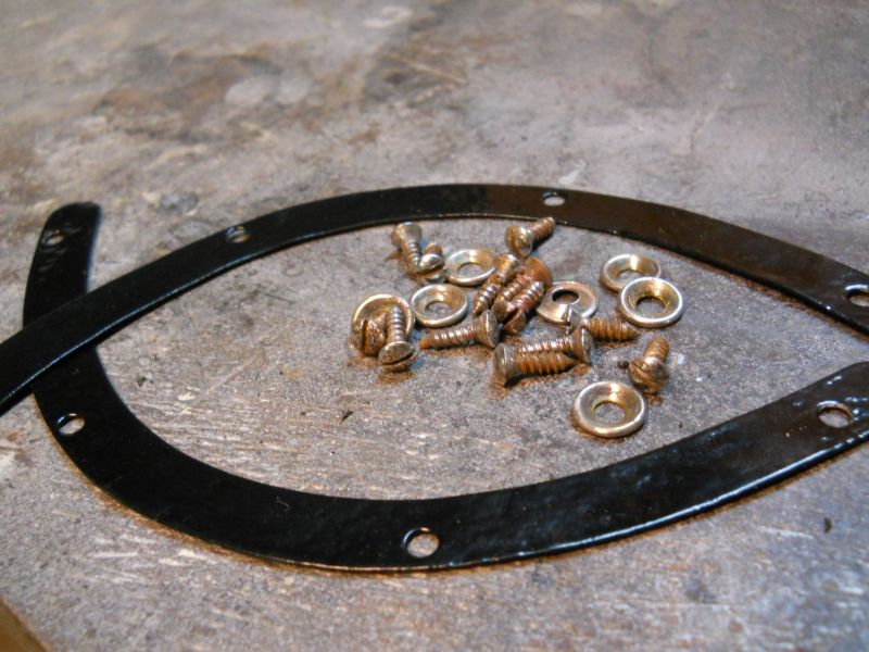

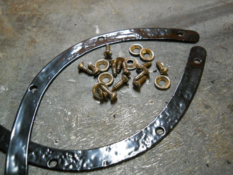

                In continuing with my late friend and Porsche Guru Craig Stevenson's advice on keeping the car as original where possible I have restored and cleaned the original clamps and screws. Had the Original clamps powder coated for extra durability.

                Picked out my best and most rust free original screws and washers.

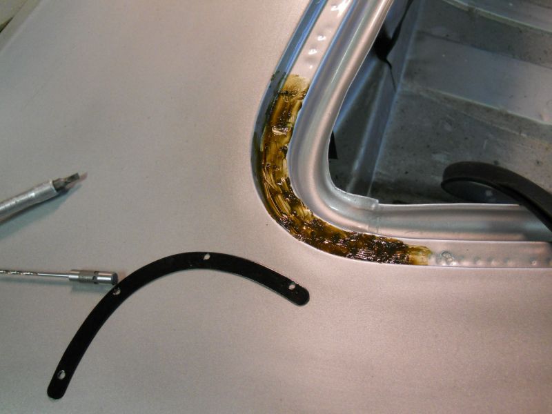

                Same rule as before: Grease is the word! Any screwed or bolted together area that will see moisture (like this area certainly will) gets a coating of grease to make it harder for rust to start back up. These corners with the set screws are a perfect incubator. The clamp will also be greased before it goes into the seal to help preserve it too.

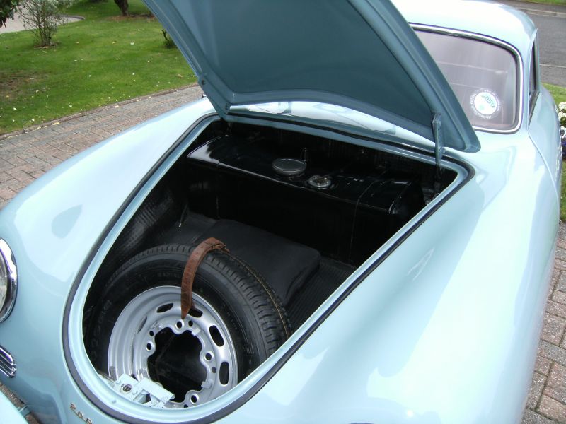

                      • Justin,
                        Great job! And your 2 main points about the fitting of the seal are so important! The position of the cut under the corner bracket and the hole puncher. The advice on the where to position the the cut ends I have read before but I never seen the hole puncher before.
                        When I did mine I never had the forsight to lay the joined ends under the corner bracket. I bought new brackets and screws but still have I think the originals which I should haver painted. But they were so thin, the water does collect there especially over here!!
                        So I joined my seal at the centre of the windscreen area. Its never looked right (or rather professional). And I can't remember when I took the original? off in the 70's where the join was. Crazy!
                        The holes were of course there on the steel inner rim as as guide, I made a scriber impression through the rubber and into the hole. This probably makes it stress more.
                        Maybe one day I will buy a new seal ( was it Mercantile you used ?) and try to rectify my mistakes.
                        Those tips are worth a lot to someone about to do that work.
                        I attach a photo of the wrong way to join the seal! Since then I have unglued and made it neater but its wrong!

                                Thanks Gordon! I'm using 3M seal adheasive. Theres a picture of it on the page before this one.
