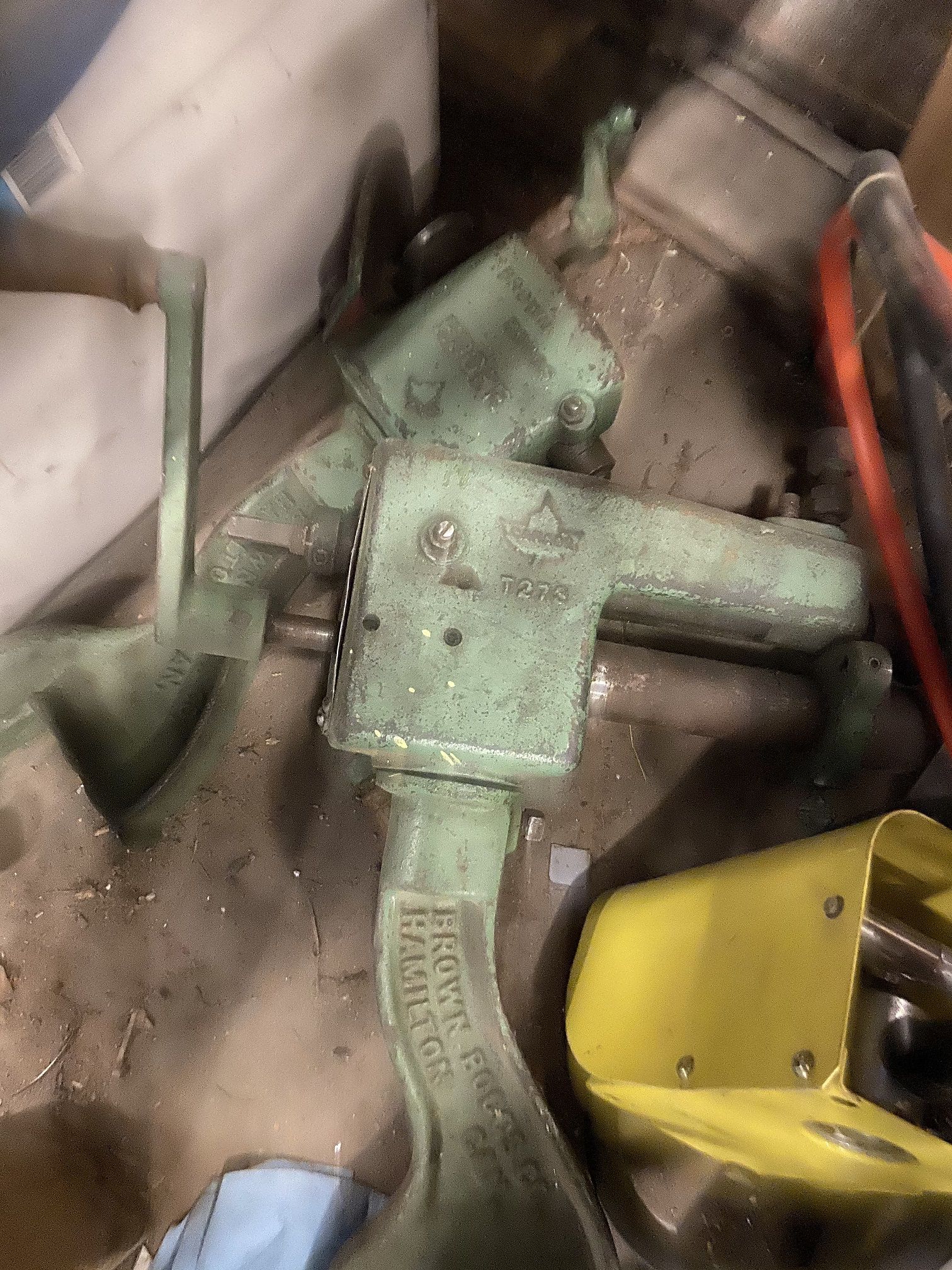

    do you have acces to a Shriner/ Streacher? I run a beadroller down the drain strip to from the gutter, the shrink and stretch it into the nose. 18ga will bend right around comes out nice.
    • Thanks for the intel. Not sure I understand the suggestion. I have a shrinker and stretcher which has come in handy a few times. I have some old bead rollers I picked up at a garage sale a few years back but never had the courage to pull them out. Do you have pictures of what you are suggesting?

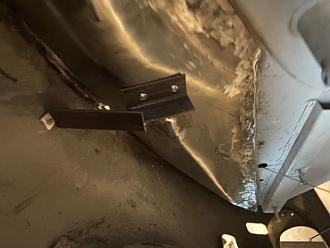

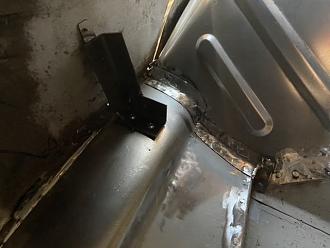

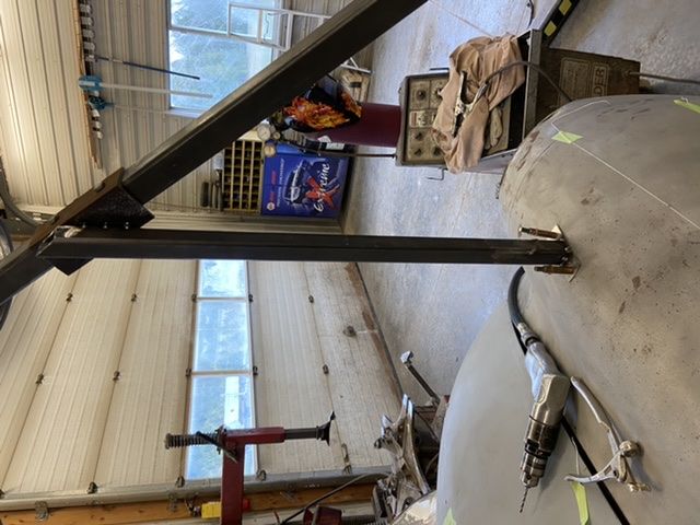

      • Started to put a number of brackets and supports in place to pin down the fender before I cut it away from the nose piece. I Want to make sure when I cut off the nose I can position the fender in the correct position while I merry it up to the nose and build up the side panels near the door. I recall reading a post on here that when you cut the nose off it can flop around and be a pain to put in position. I welded a bar from the rotisserie to Cleoco the top of the fender (suspend it down the road) and built a number of brackets underneath Click image for larger version
ID:	108599Click image for larger version
ID:	108600Click image for larger version
ID:	108601Click image for larger version
ID:	108602Click image for larger version
ID:	108603 to pin the edges along the hood. I will need to cut along here to weld in a new rain gutter along the sides in the future.

          its not too hard, mostly practice. Save your scrap sheet metal and sun it through them. I did not have time to power the bead roller , but you either need to ditch the crank, and get a wheel or a helper. The shrinker and Streacher are also simple, but put a foot pedal on them

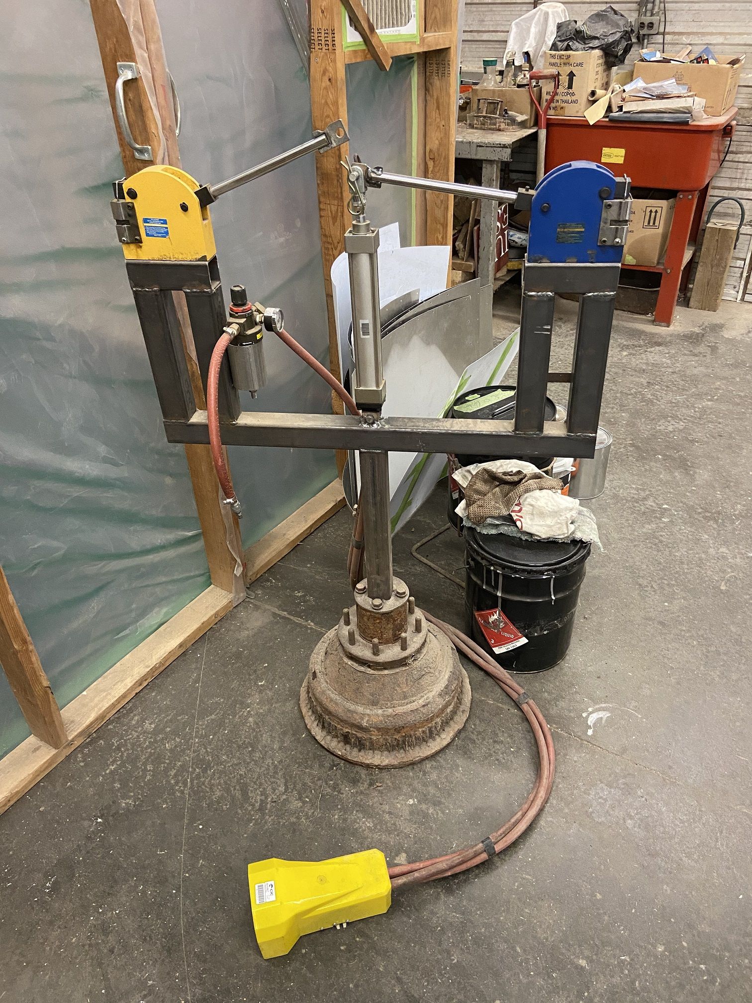

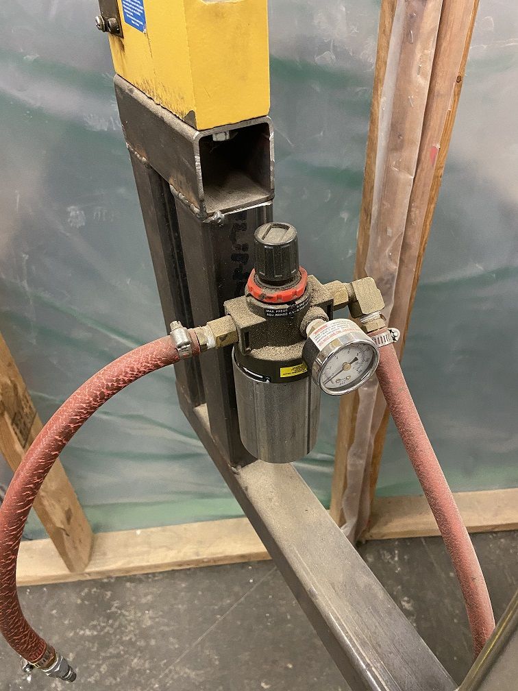

          • I did get the standard Princess Auto or for our US members - Pep Boys or Eastwoods then welded them up to an old truck drum and frame. Also bought the $25 foot pedal and air arm - a real good investment to be able to hold the piece and tap with the foot - also installed a pressure valve to adjust pressure - see the small piece made using this below in thread).

              Really nice setup. You'll wonder why you didn't buy them years ago. I know I did...

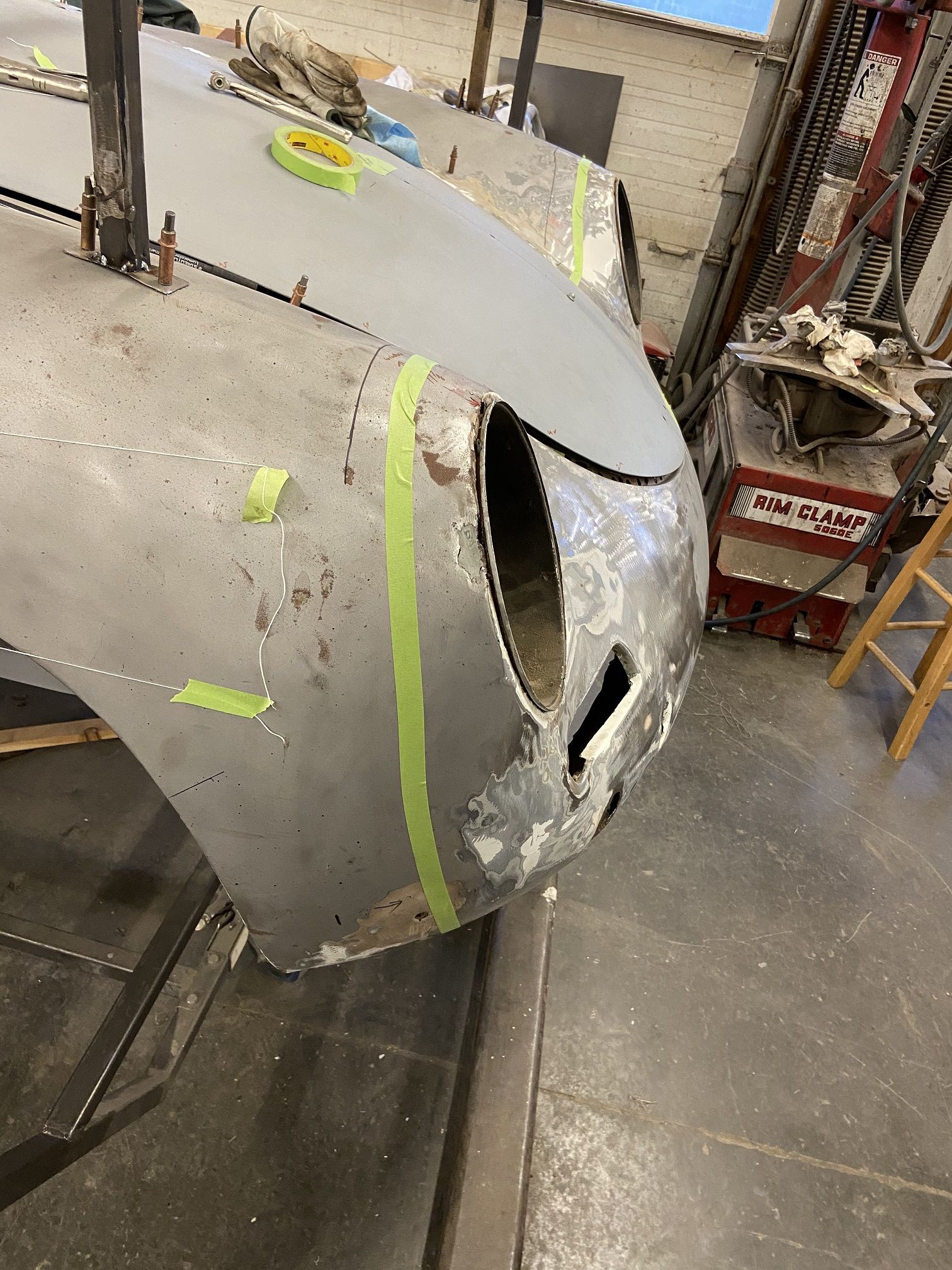

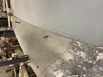

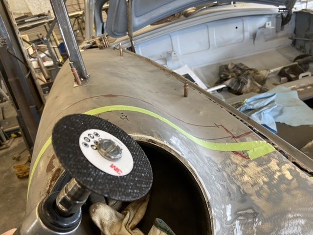

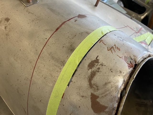

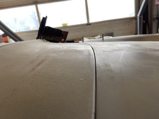

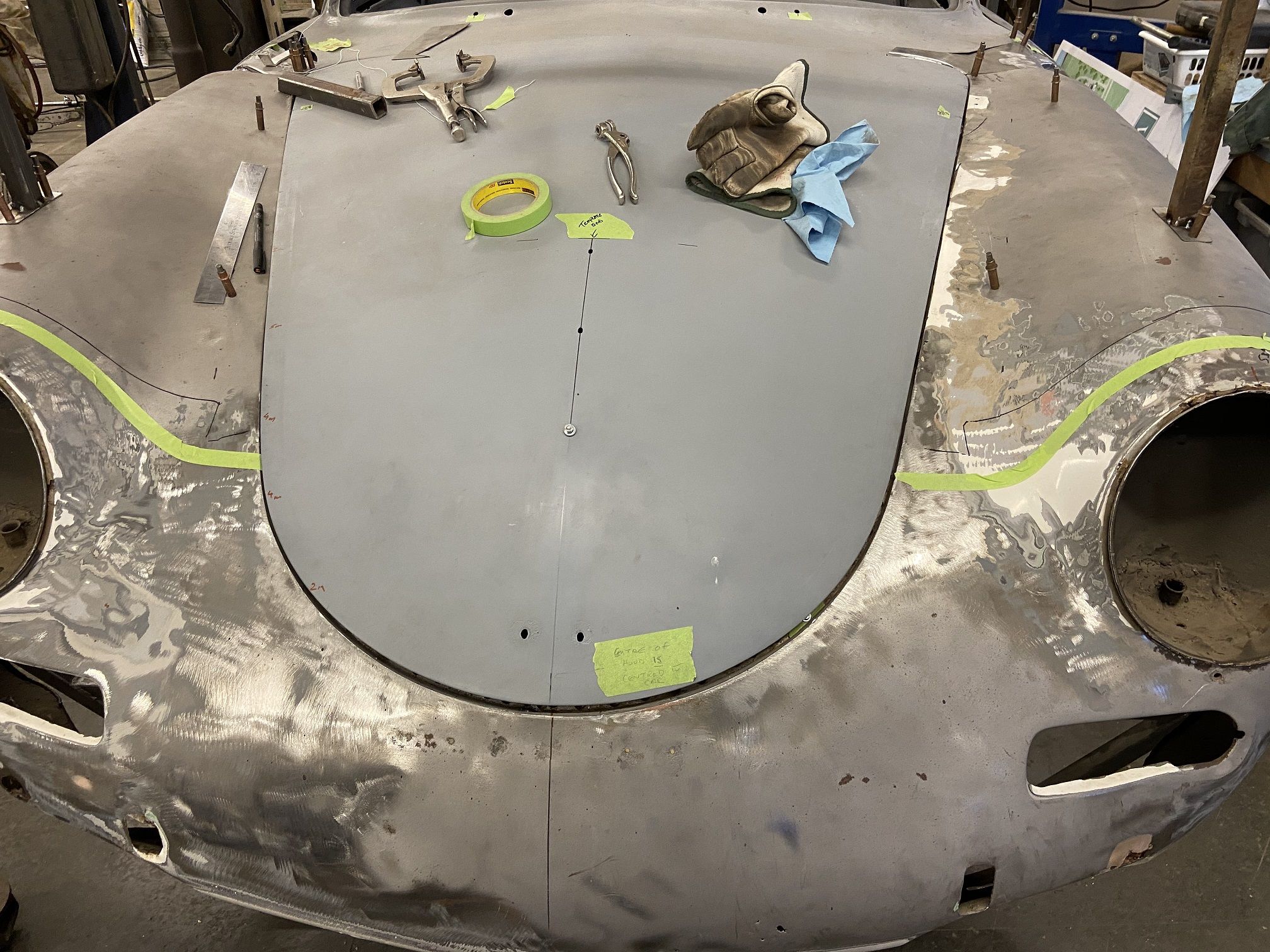

          • So - I'm now at the point - with the side fenders in a fixed position - to consider cutting off the old front nose. The green tape shows a rough proposed cut line - with lots of meat left to overlap the new nose so over time I can sneak up for the best fit - likely will be trim the new cut line a number of times in the coming weeks. Just need to get up the courage to actually make the cut of this major piece of the original car. Just still a chicken at the moment. Im sure I will find other jobs and excuses to hold off longer.
            One job is the issue that the centre of the hood closest to the cowl is a little high - will likely need to remove the hood and apply a little pressure to reshape.
Name:	042920 right light potential cut line.jpg
ID:	108643Click image for larger version
Name:	042920 front hood potential cut line.jpg
ID:	108642Click image for larger version
Name:	042920 hood gap.jpg

              Don't forget to mock up a hood seal in there as it goes. The load pressure will change that height discrepancy your finding from the cowl to the hood and with the edges of the fenders too.
          • Thanks Justin. I had not considered that.
            356 Registry main thread;
              Yeah, the seal changes everything. Even a fully original car; if you pulled the seal out it would become a different animal. The latched hood would be a step lower than most of its surrounding bodywork.

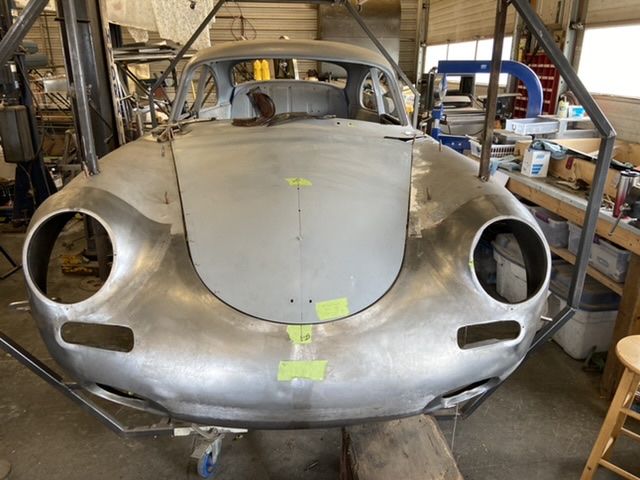

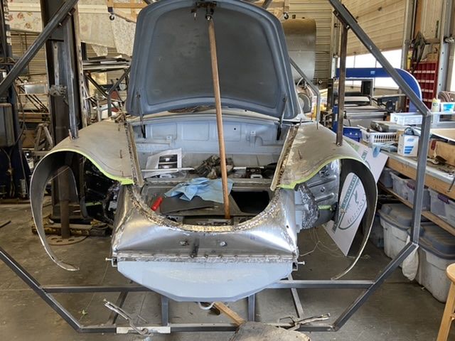

ID:	108683 Well finally got up the courage to cut off the biggest single piece of metal from the car. Old nose is off and new nose in position. Initial alignment not bad on left side but lots of work to do on left side.
ID:	108680Click image for larger version

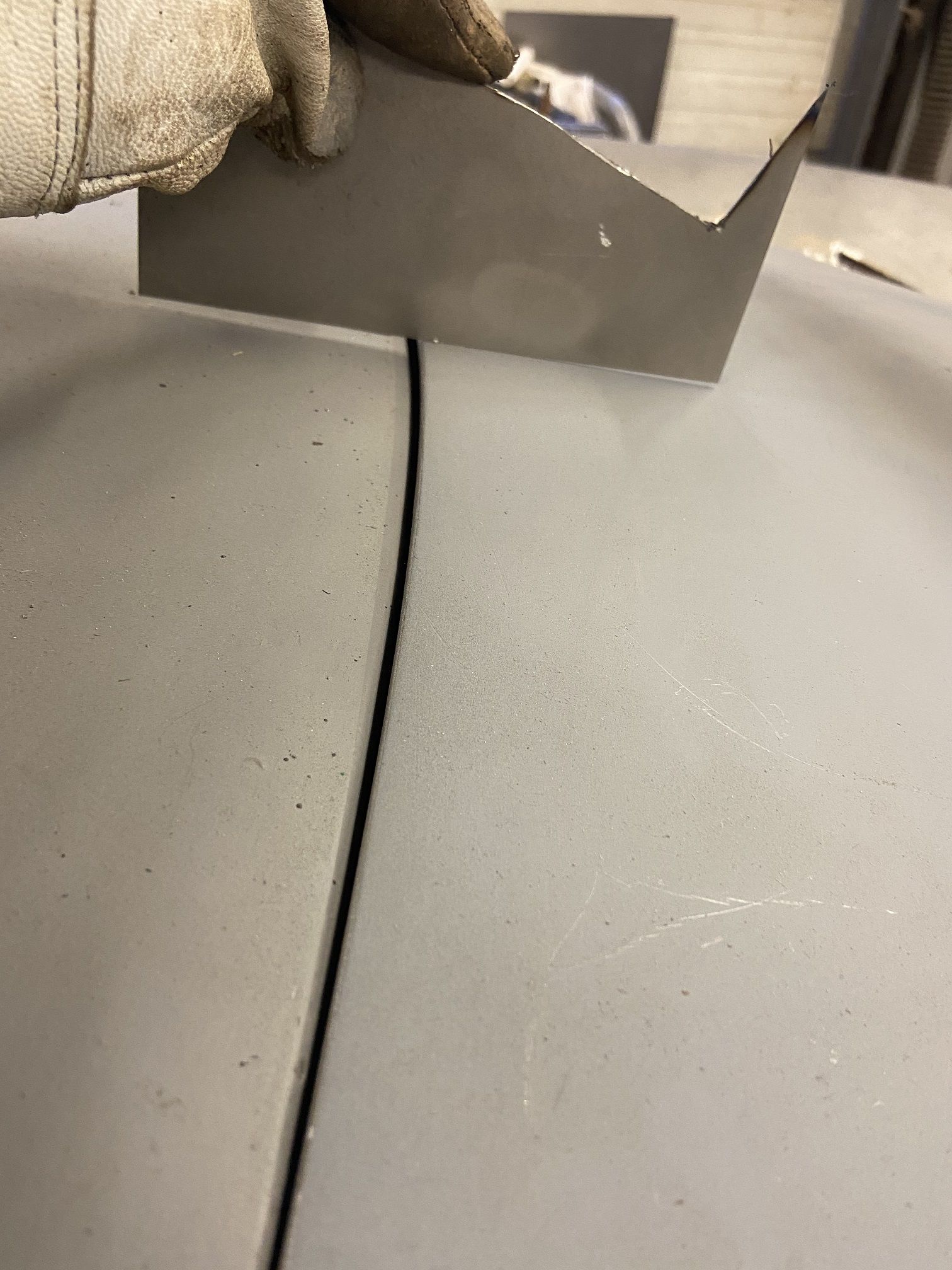

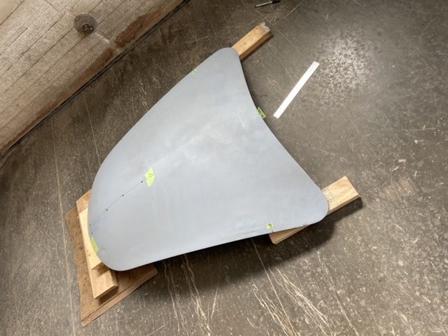

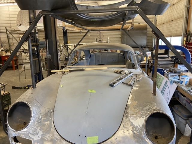

            • Also took some time to remove the hood and with some gentle pushing with the hood suspended over some 2x4s I managed to get the centre crown down so it lines up flush with front cowl. Some before and after shots Gap is a little tight so also need to pull the hood forward a bit Click image for larger version
ID:	108689Click image for larger version
ID:	108686Click image for larger version

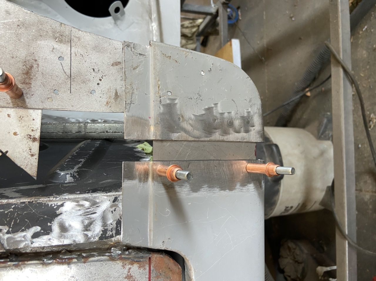

                  • Needed to resolve the end of the rocker panel before working on fender. The end of the rocker did not line up with fender by about 20mm. Got it off and m Click image for larger version
Name:
ID:	109877 oved it forward.

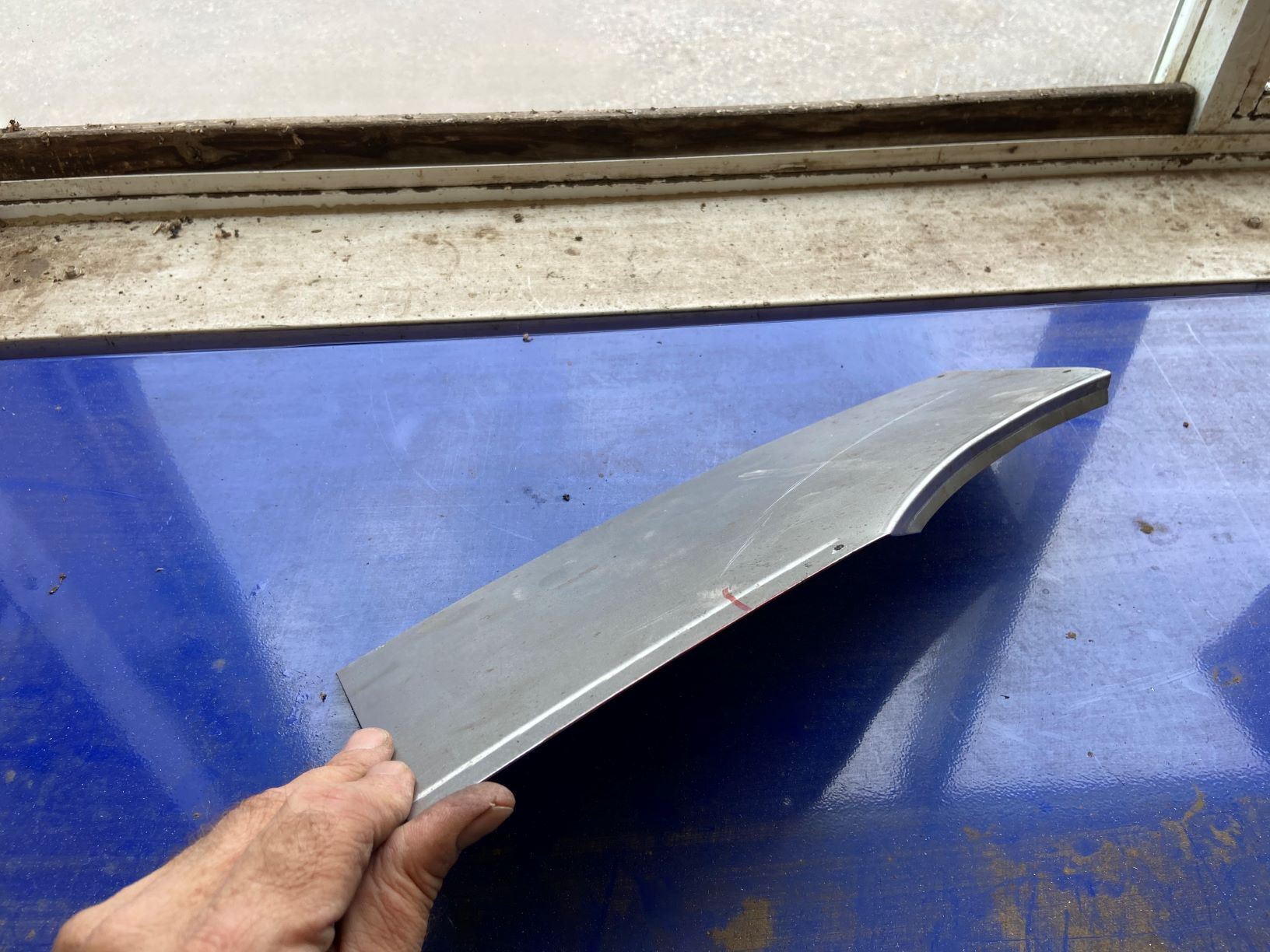

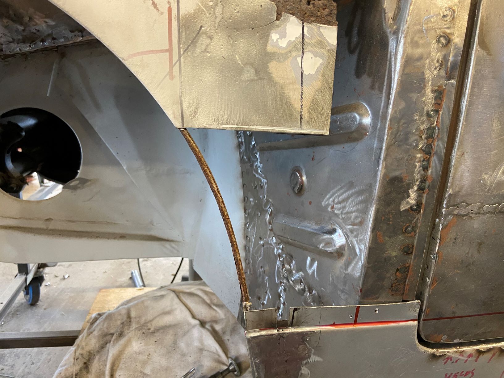

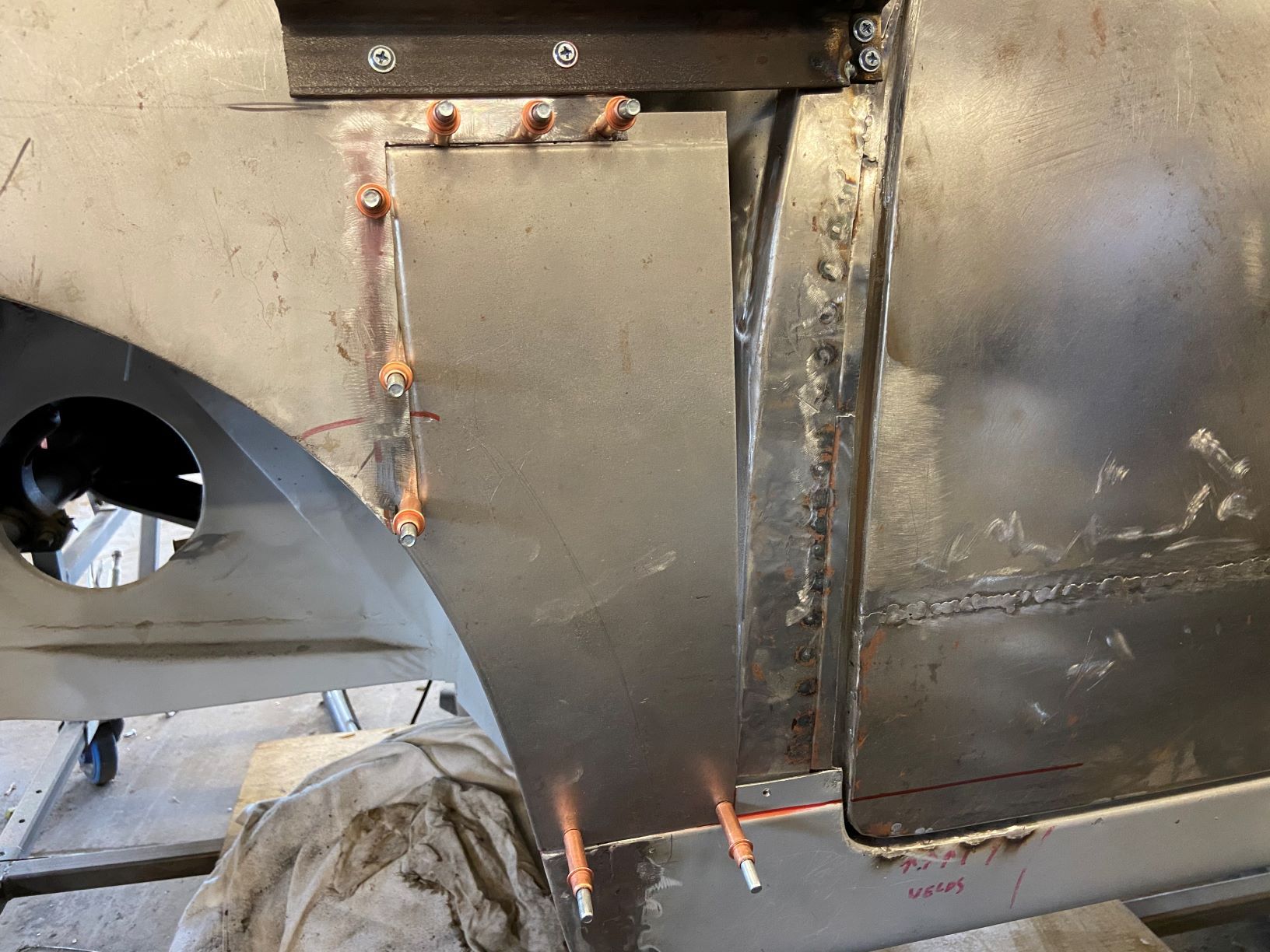

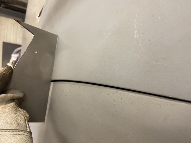

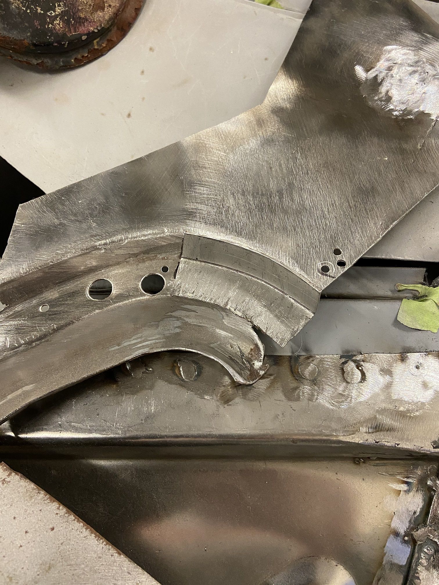

                    • Justin and Roy - thank you for your kind words, encouragement and advice. I took a page out of Justin's approach on a previous post and cut a slit in the left forward rocker. It was not out as much as the right side. This retained the nice lines. I filled in the lower rocker gap then removed the bad metal above in the fender and exposing the wire. This gave me a good template to confirm the shape of the new fender section. Pulled out an old bead roller i had never used - did a few practice attempts and was really happy with how it turned out. Spliced in the piece leaving enough space for the final section to fit beside the door. Click image for larger version
Name:	left rocker fill.jpg
ID:	109962Click image for larger version
Name:	fender wire and gap.jpg
ID:	109963Click image for larger version
Name:	new panel piece.jpg
ID:	109964Click image for larger version
Name:	new fender piece in place.jpg
