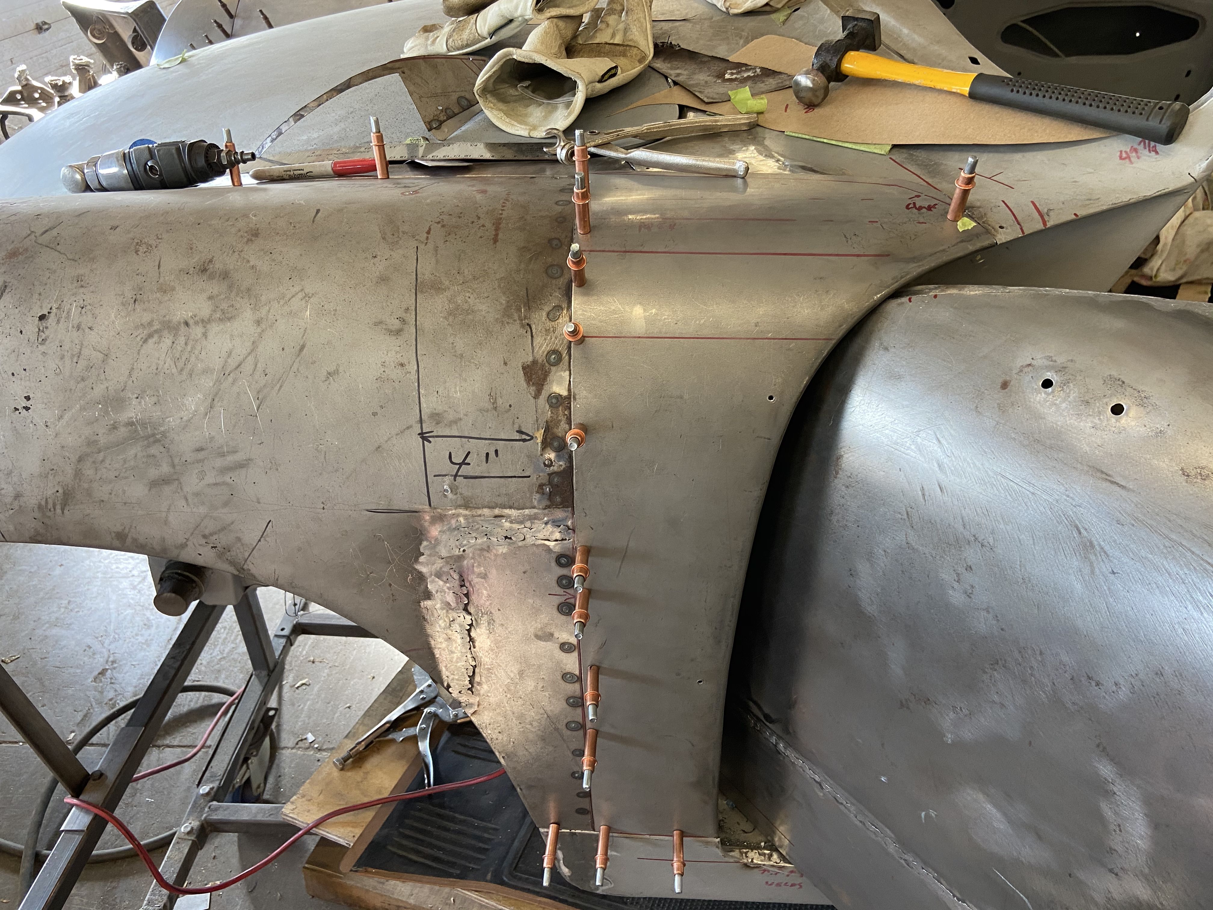

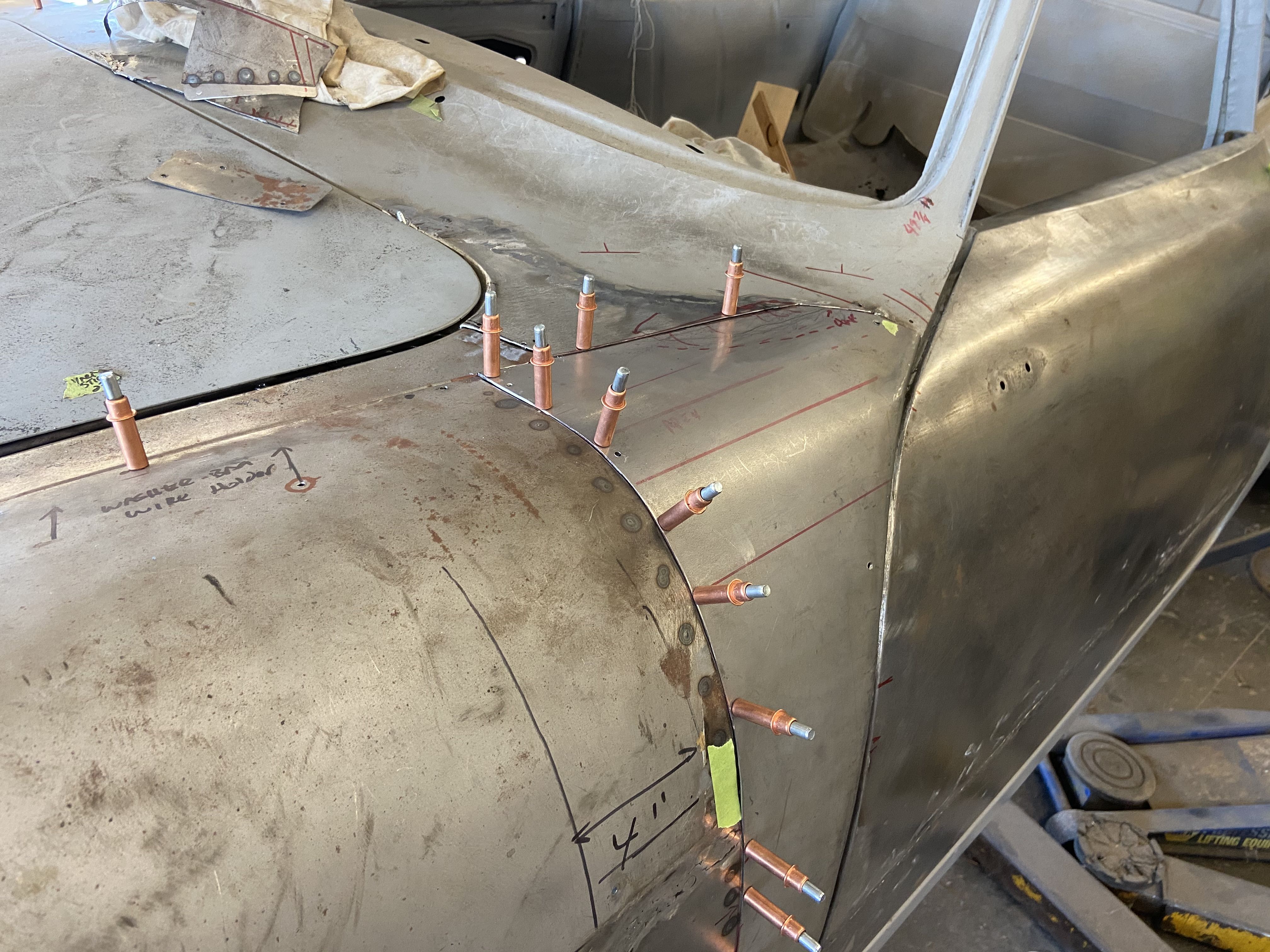

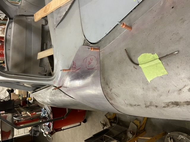

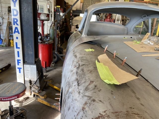

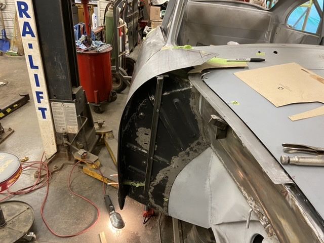

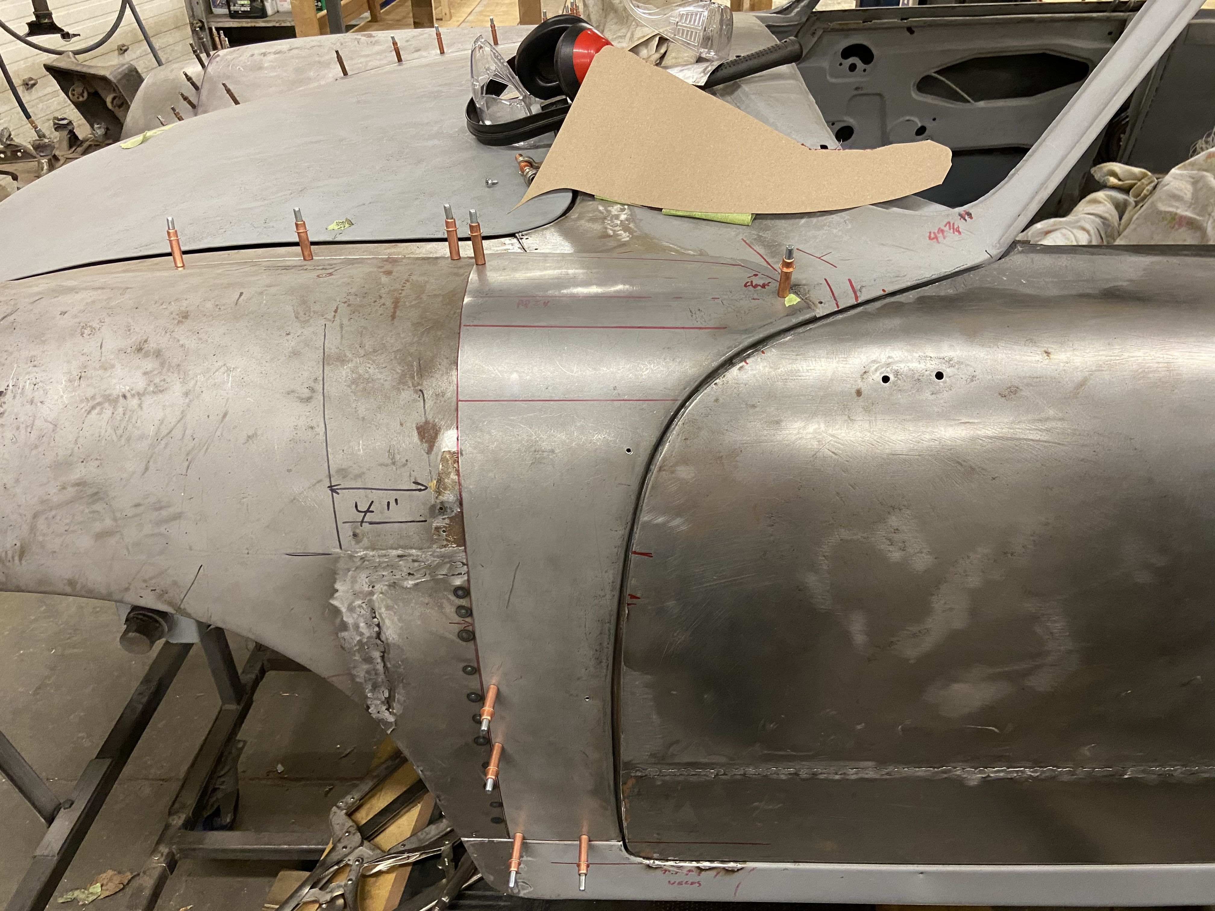

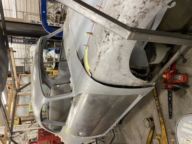

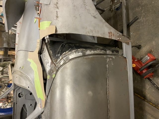

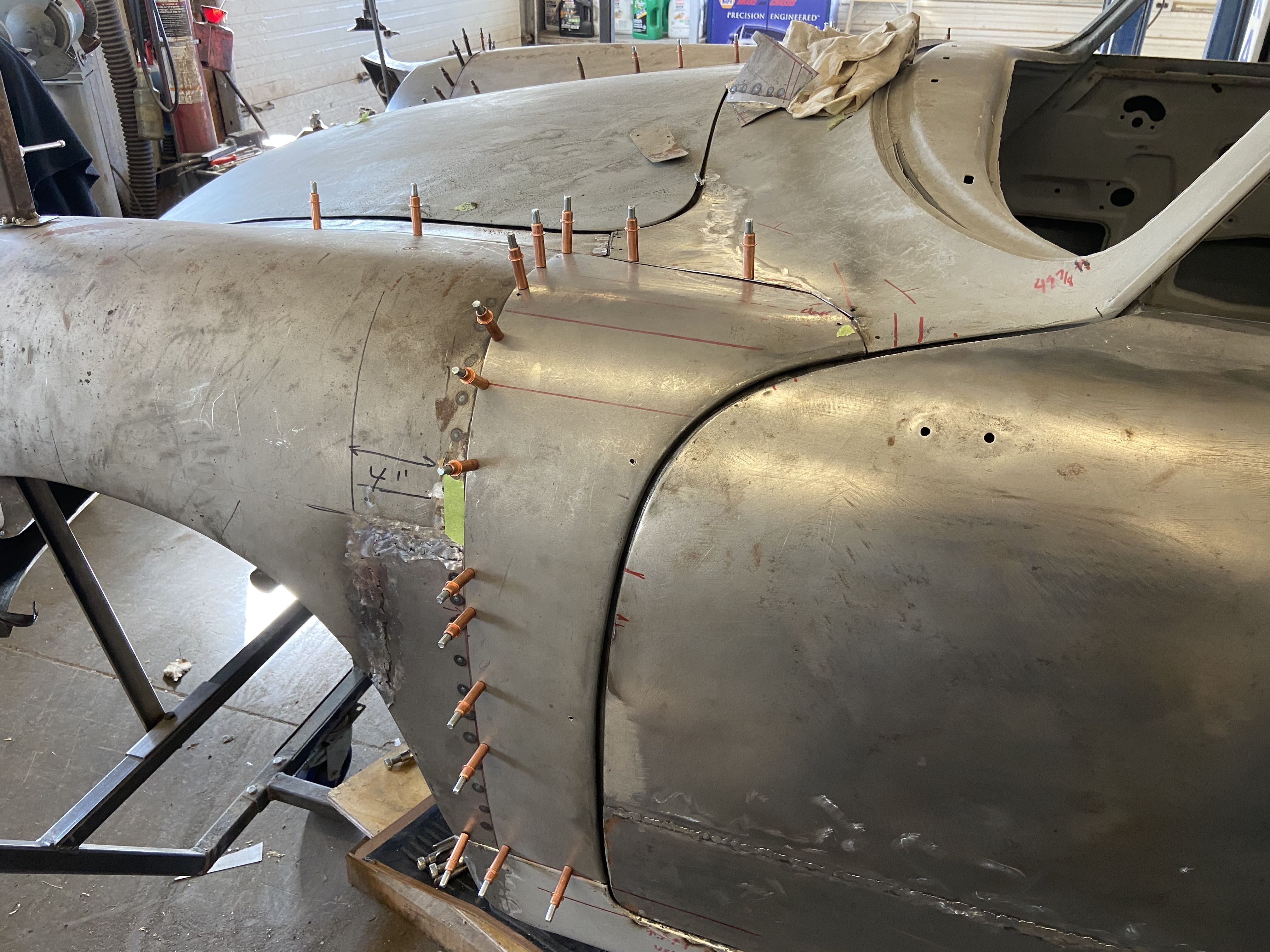

ID:	109978 Back over to the right side to begin fitting the curved inner fender section. Slowly trying to shape the top curve around the upper fender as well as best fit for door gap. A lot of different angles and shapes all coming together. Click image for larger version

    • Wow Scott that second photo down does show the rust you encountered. Over in England so many 356 cars were like that in 15-20 years! Really intensive work to remedy that but you look to be doing really well. I guess like Justin you correct one area then move on to the next. But... your experience goes the same way, every job builds the experience up so in the end you not so surprised at what you find each time you start a new area!
      Well done and nice clear pics!
      • Roy - there has been more metal replaced than I care to contemplate. This one spent some wet days on the east coast of Maine at one point in its life. And here in the north America the drivers side is the worst due to salt and sand in the winter.
        started to tackle the drivers side now.

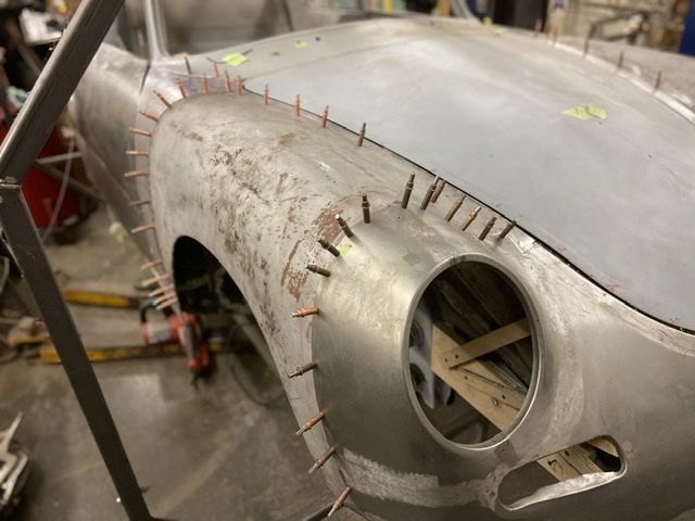

              Looking good! The wheel arch is turning out very nice. A good supply of cleco's there, looks the "hell raiser" with all those installed. lol

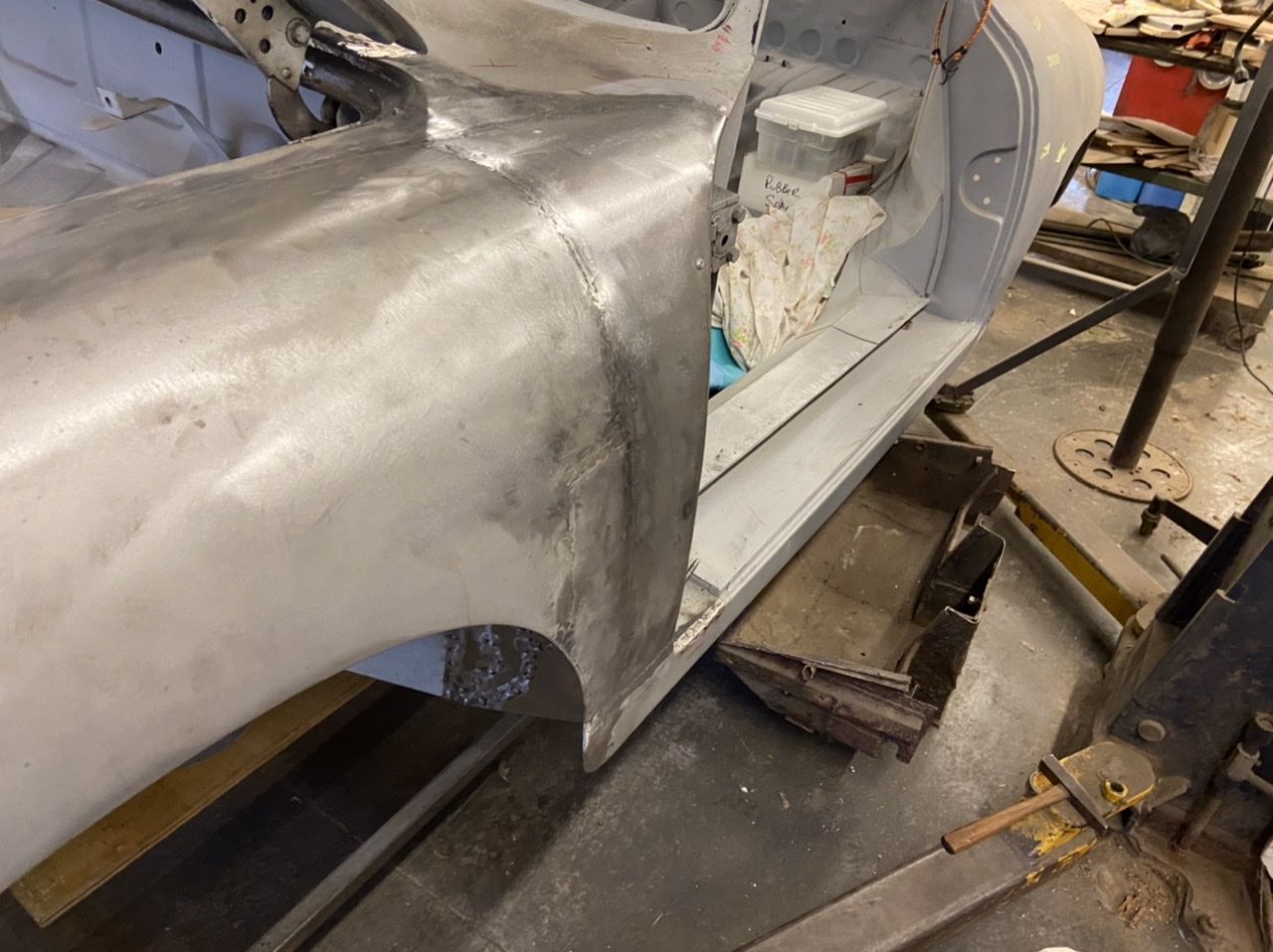

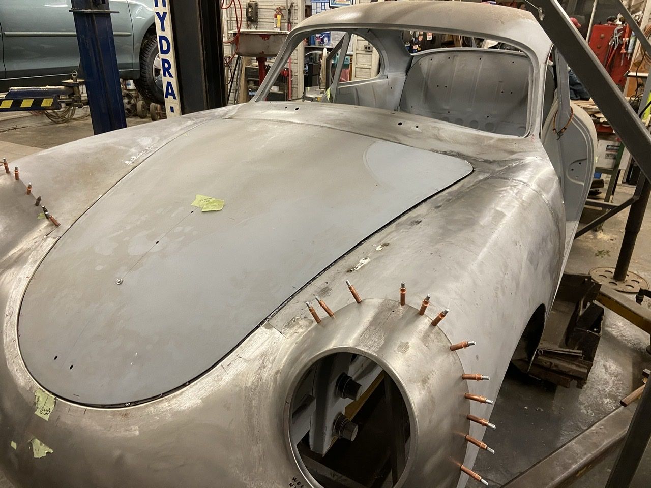

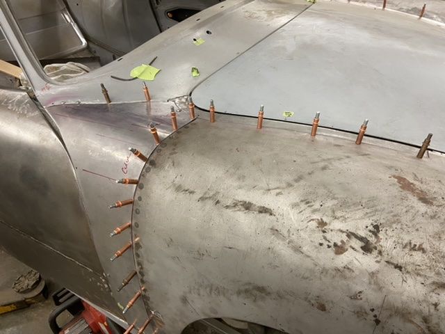

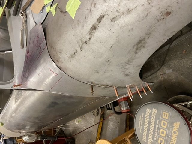

            • With all front pieces shaped and positioned time to do a final media blast of doors and fenders. I can’t count how many times I have taken the fender on and off but I am ready to weld it in for the final time

            • Right side fenders welded in and dressed. A few high spots to tackle later with heat or shrinking disc. On to the left side next.

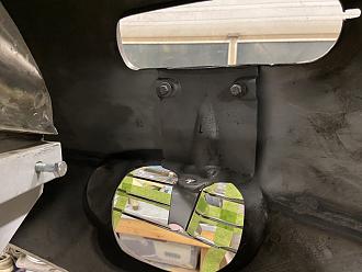

              • Question _ I’m not sure how to finish off the transition between the bottom ledge of the splash panel and the closing panel on the closing panel of the longitudinal. At the moment the bottom ledge abruptly ends as it joins up with the end closing of the end of the longitudinal. Anyone have pictures.
ID:	110249 Click image for larger version
                356 Registry main thread;
                • The way you have it is just about right Scott. It lays over at about a 30 degree angle.
ID:	110282 Here's an original. The factory also put a short seam weld at the leading edge of the lap joint.
                  • Justin, thank you kindly for the update and information.

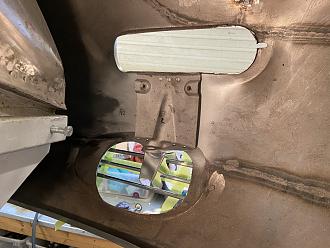

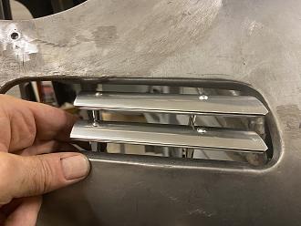

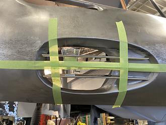

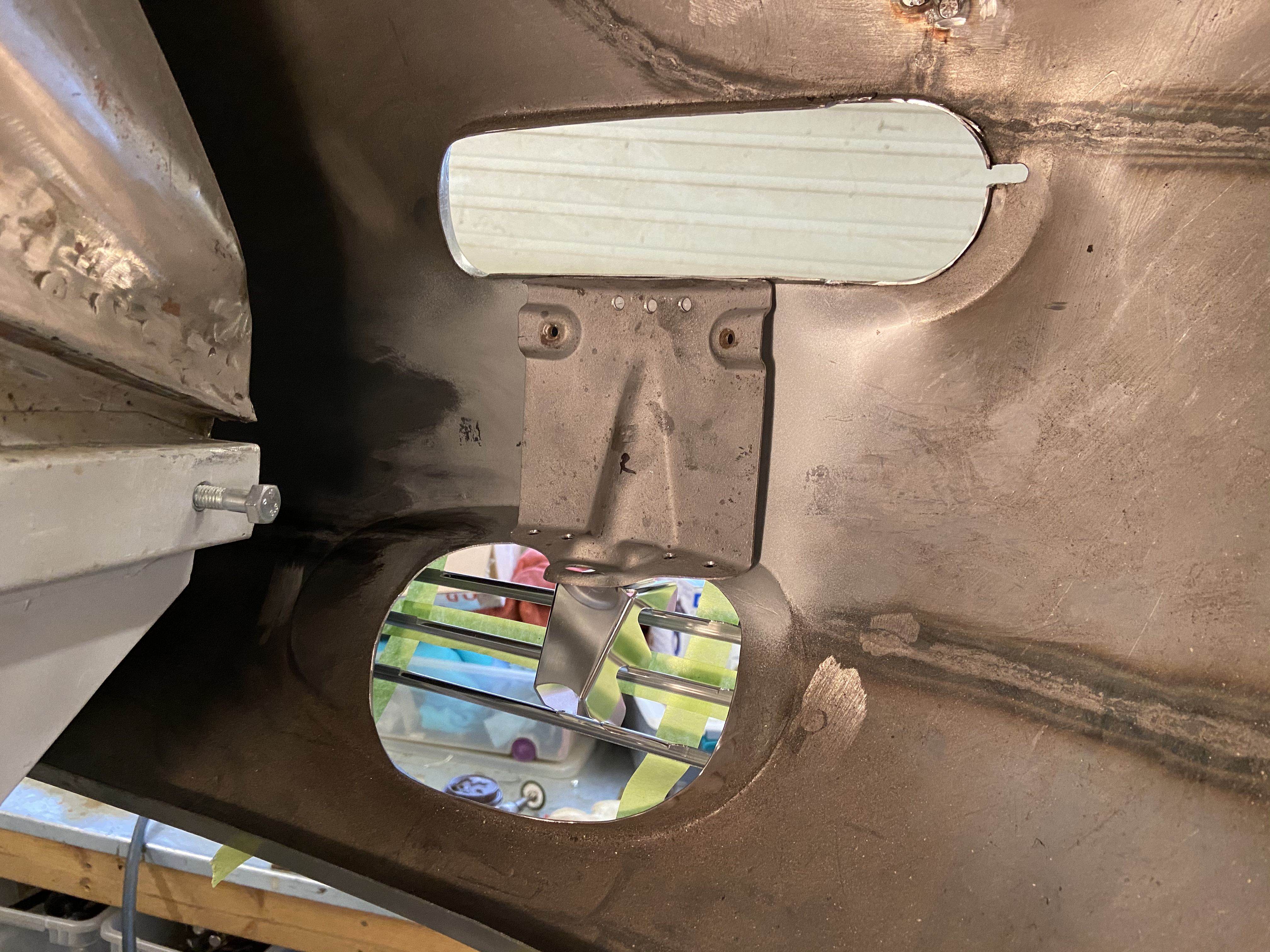

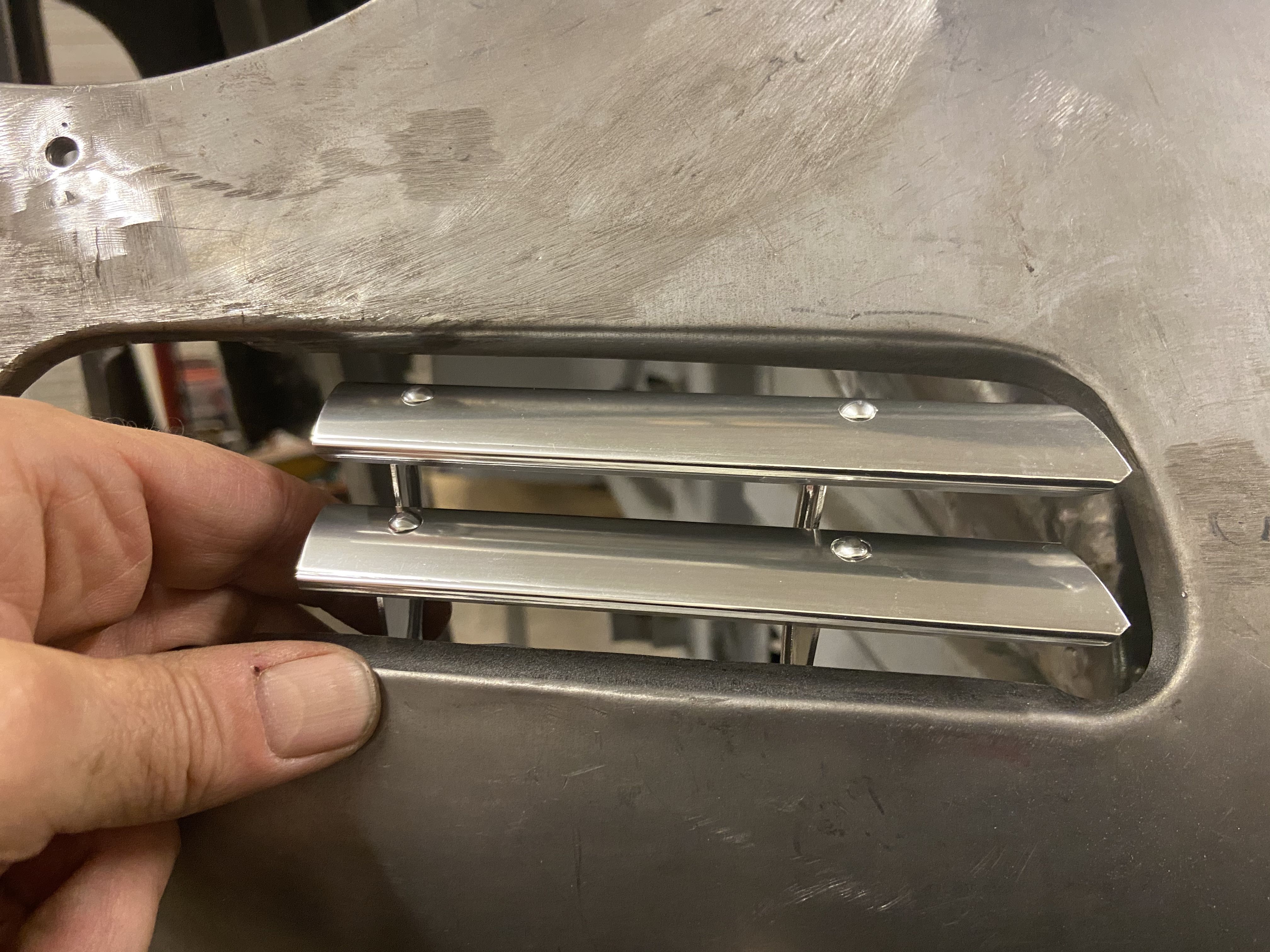

                    • Working on little tidy up jobs on the nose. Refined horn grill openings and positioned and welded in the horn/grill bracket. Found best position from lower horn grill.

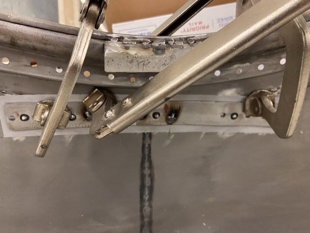

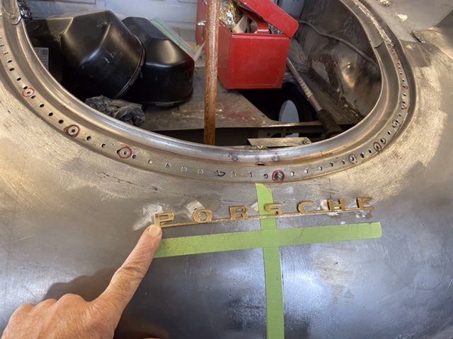

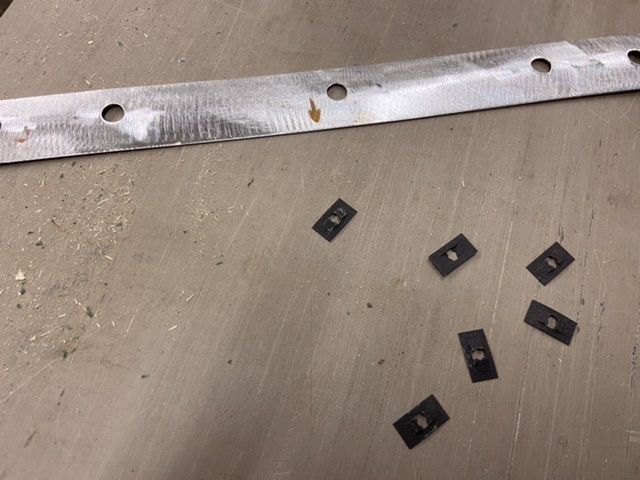

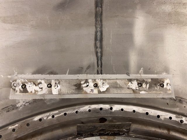

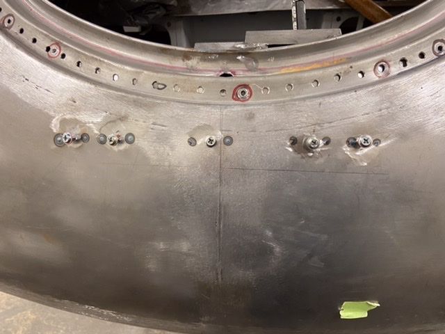

                      • Took some time to position the front nose porsche script emblem. Tricky finding correct placement but got it fitted. The next challenge was putting in the backer clip plate. This is no longer available so I had to recreate. I used a piece of metal drilled out for the emblem pins but large enough to allow the metal fasteners (pal clips) to set inside of the hole with a bit of movement. They were lightly held in place with screws to properly position them then overlaid the metal strip and then welded in place capturing the metal clips. Click image for larger version
