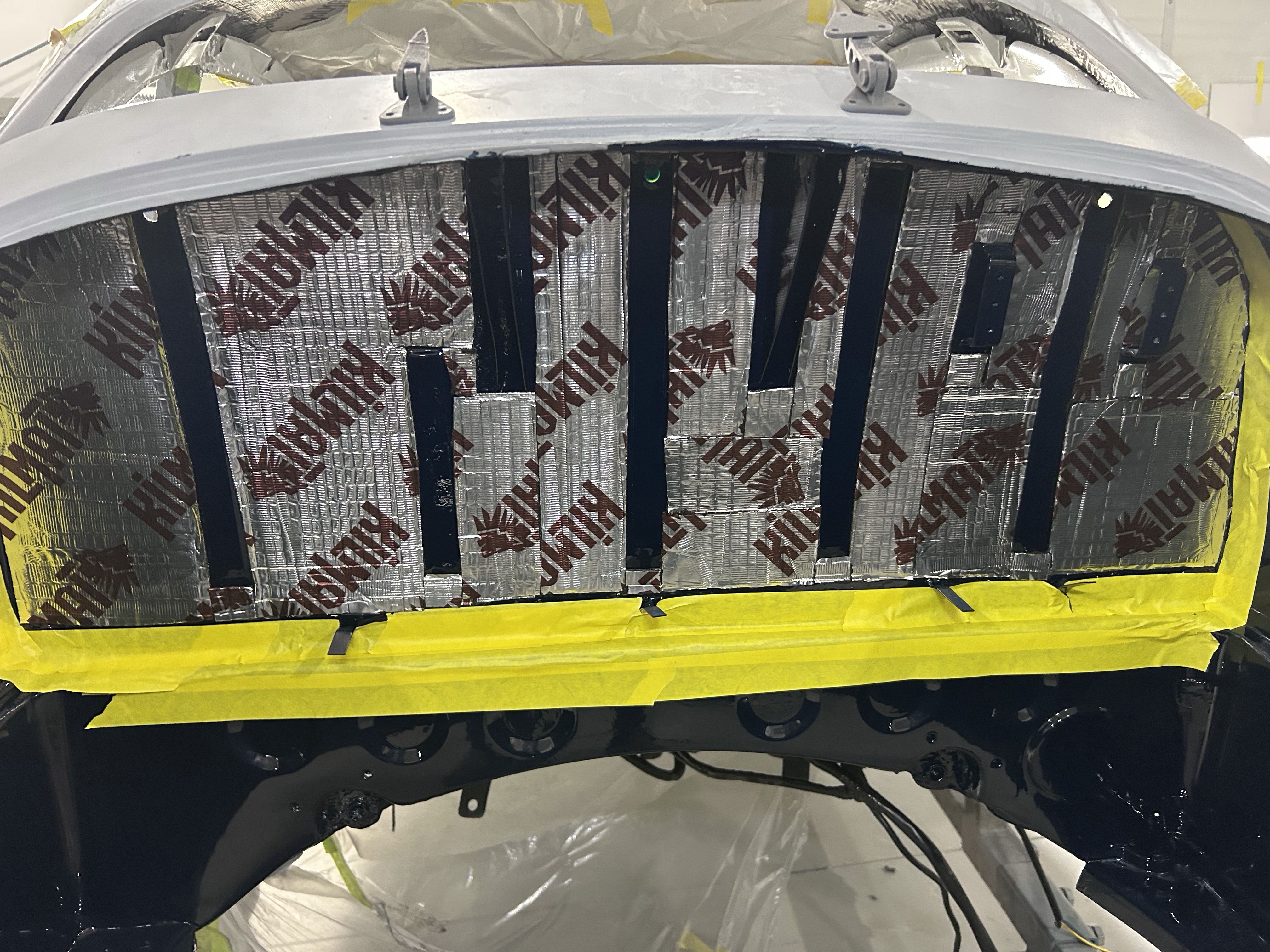

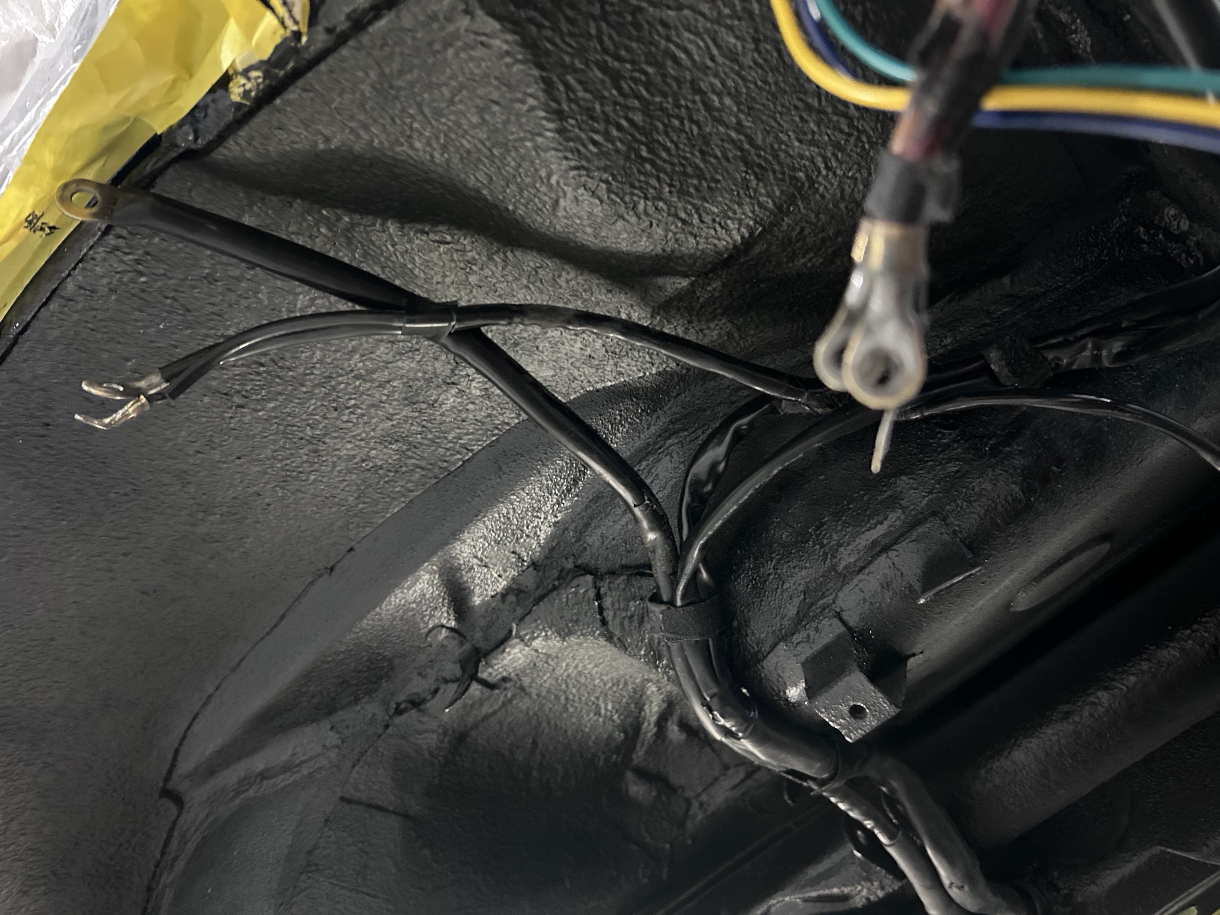

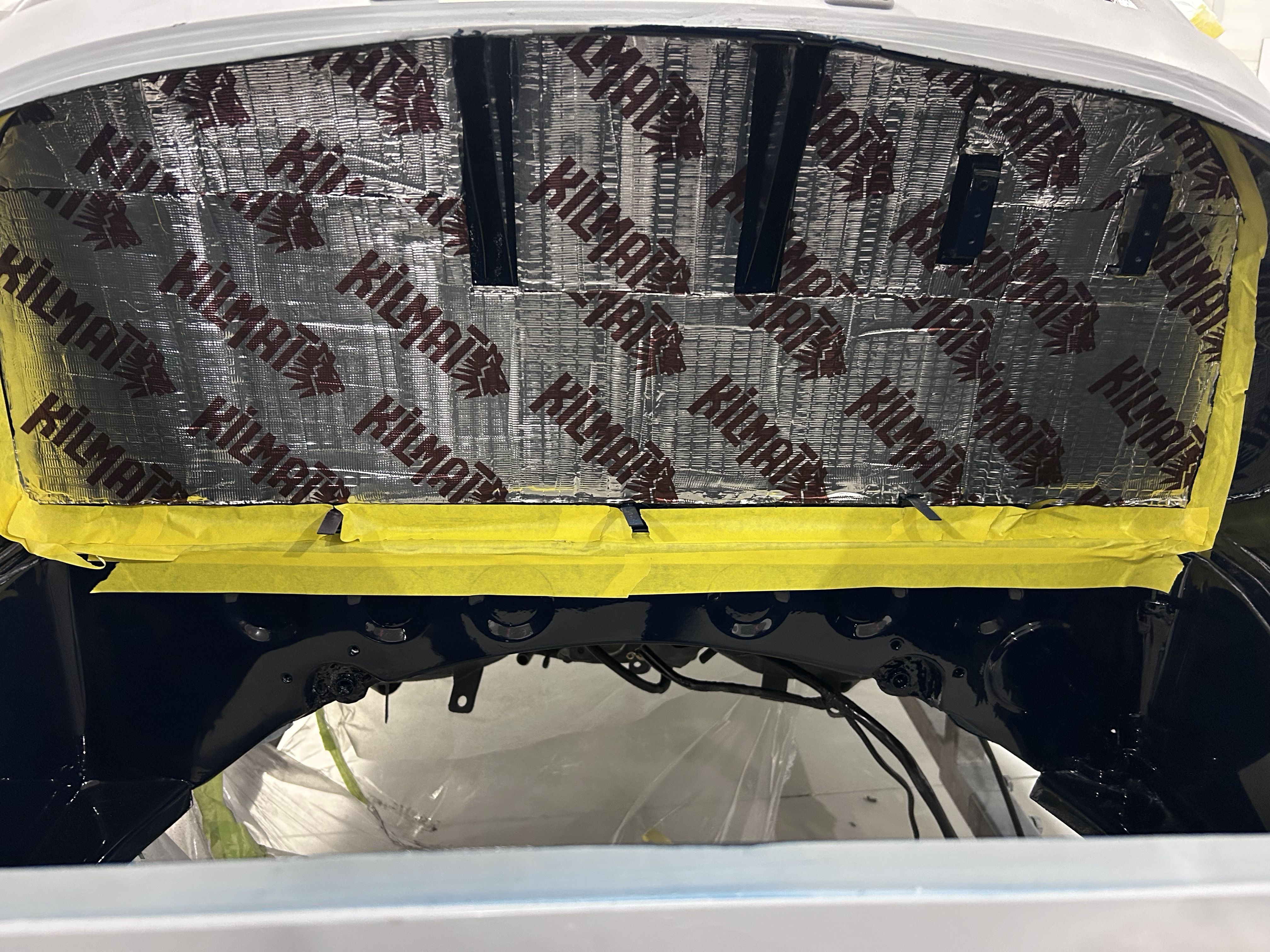

  • A few updates. Roll bar shape now complete nicely hugs the body shape by 3/4â€� Off to get media blasted then epoxy coated and sanded before paint. Wire loom is in and tucked Click image for larger version

ID:	117269 in place in the rear. Black Mercedes insulation glued under transmission tunnel then two coats of black rustoleum. Rear firewall all tucked in With noise proofing (a few layers to fill in voids between ribs.

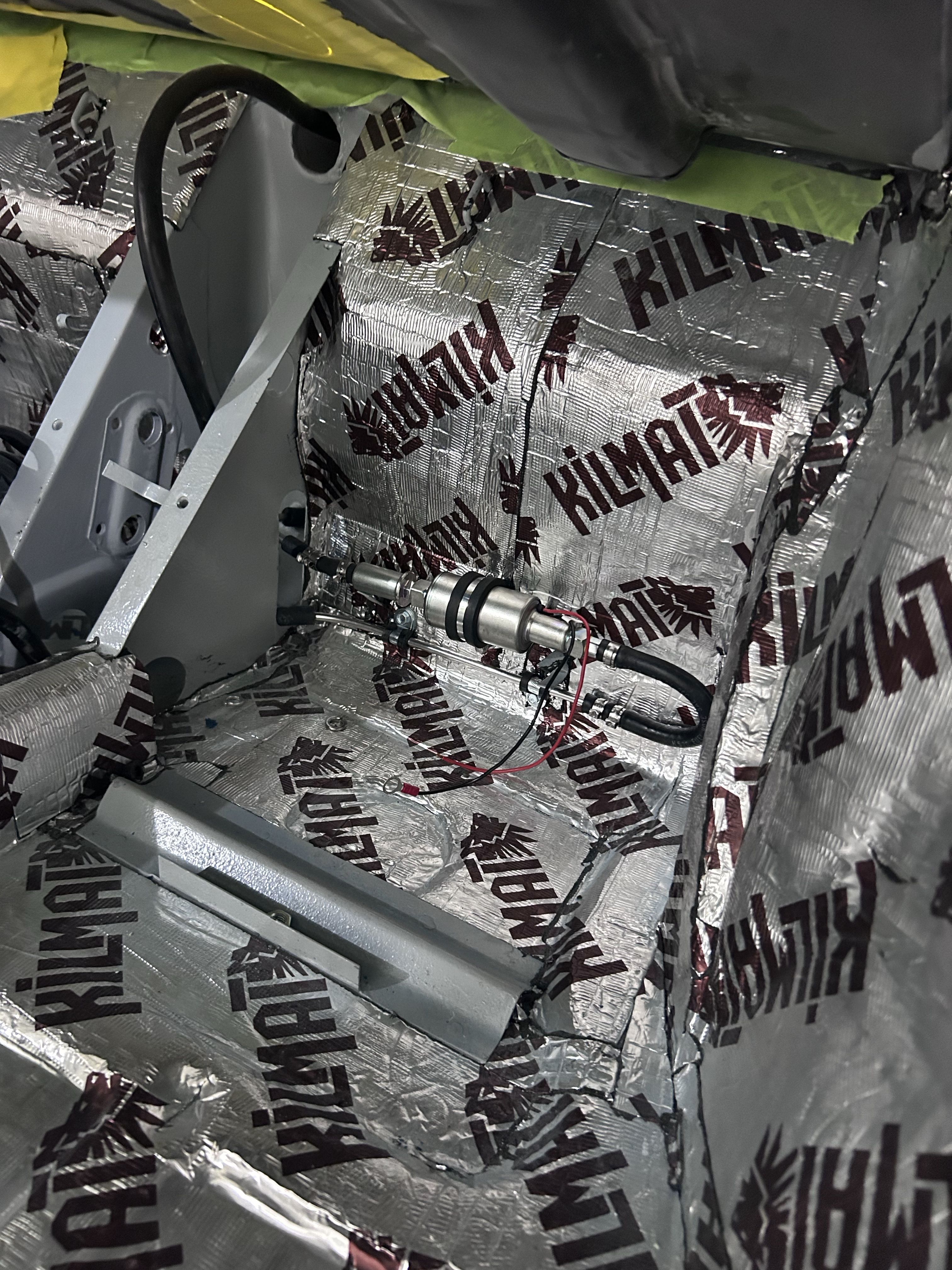

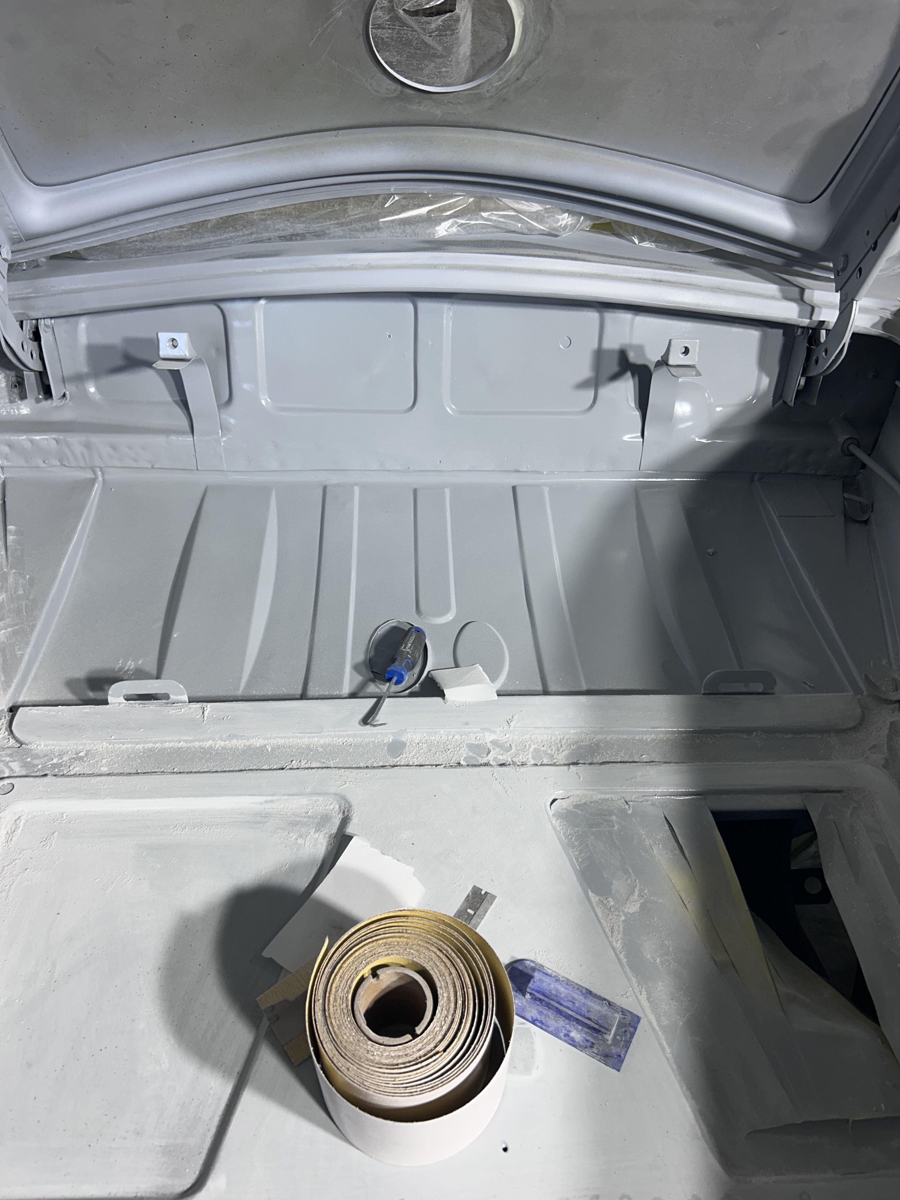

ID:	117279 Installed 6volt electric fuel pump and finishing up frunk sanding and prep for paint. Click image for larger version  Name:	IMG_7604.jpg Views:	0 Size:	1.88 MB ID:	117280

              It all looks clean, neat and well planned. I like the hardline plumbing and mounting of the pump down in there. Nice work Scott!

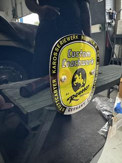

          • My friend Dave was able to source a rare NOS hirschmann centre mount antenna. Temporary window installed along with the windshield wiper mechanism to ensure that the mounting hole to be drilled and bottom mounting bolt wouldn’t interfere. Also wanted to ensure the wipers would have clearance. The antenna is then angled upwards to the roof close to parallel to the windshield. On the roof a holding clip will also be mounted to secure the top of the antenna. Love the look of this rare accessory. Here is a pic of Mr porsche with his early VW and a centre mount antenna.​

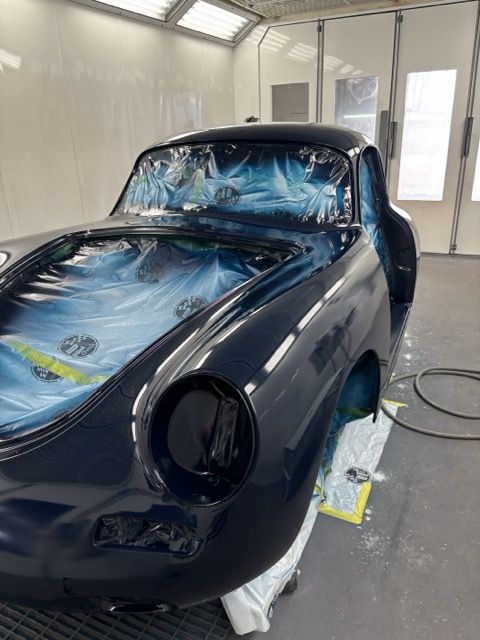

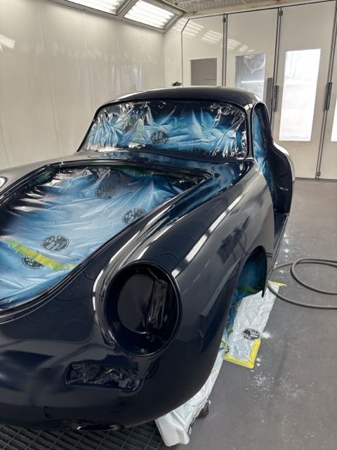

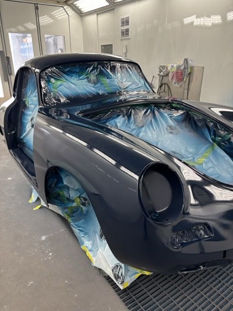

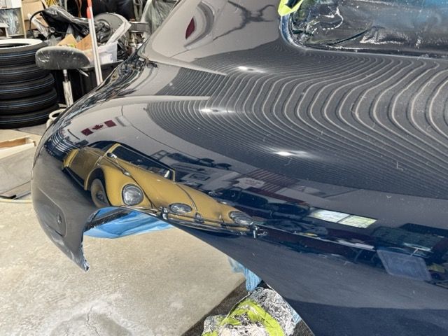

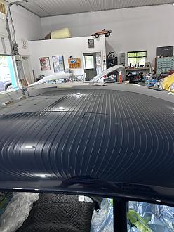

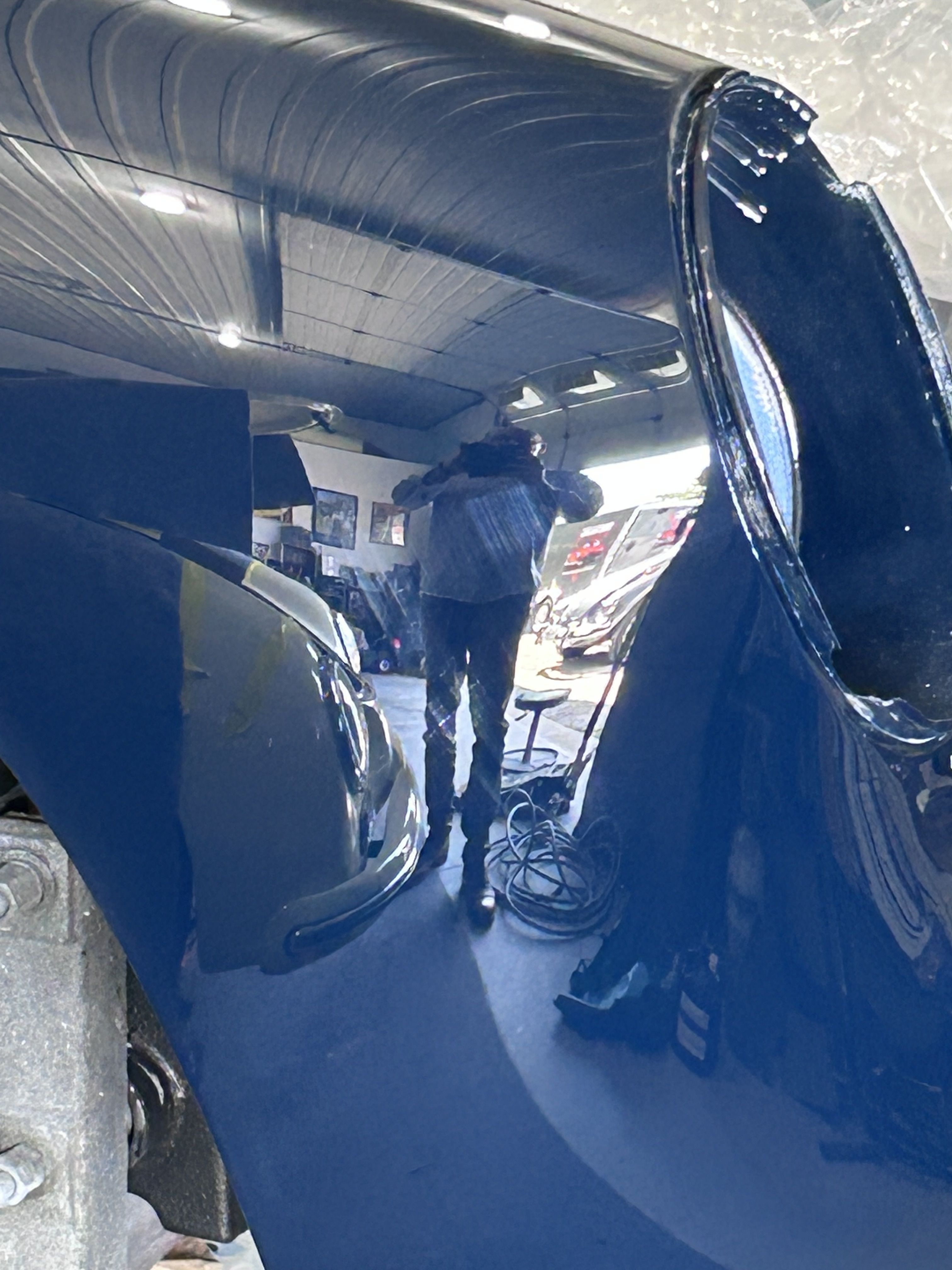

              • Final wet sanding prior to paint. Still using guide coat as final check. Using wet surface and grease and wax remover to generate reflections as well to confirm curves and straight surfaces.
                356 Registry main thread;

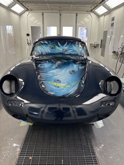

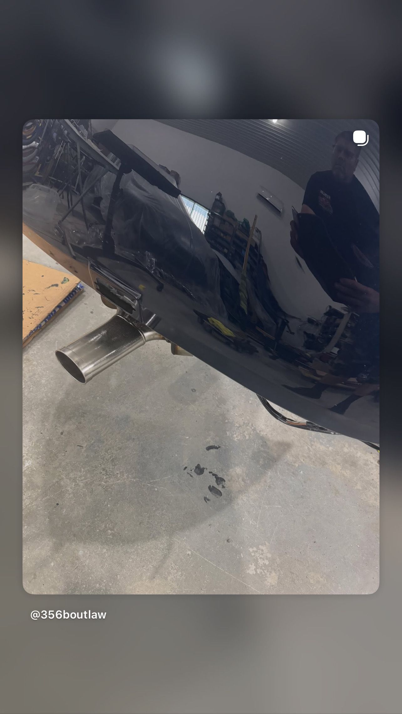

                • Body paint done. Three coats of base Bali blue with black tint. Five coats of clear. Time to cut and polish. https://www.facebook.com/share/r/1As...ibextid=wwXIfr

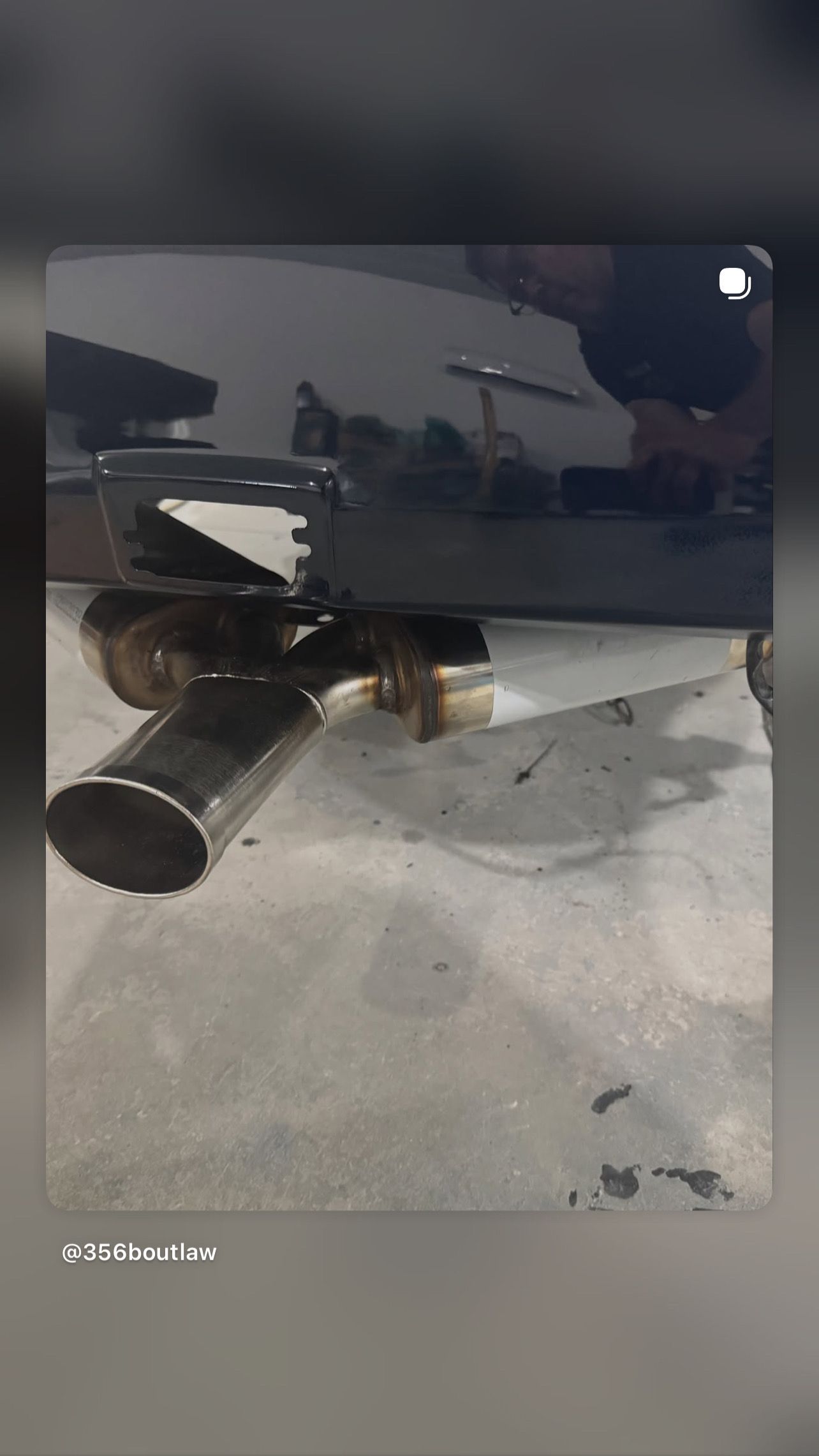

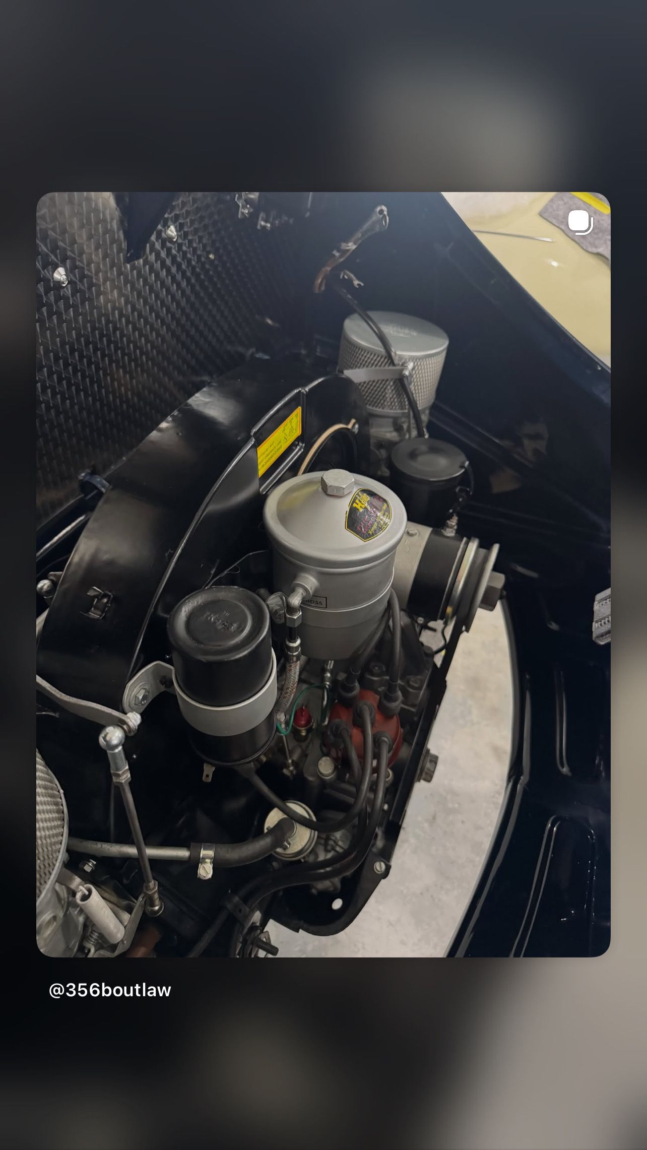

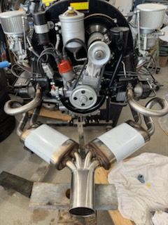

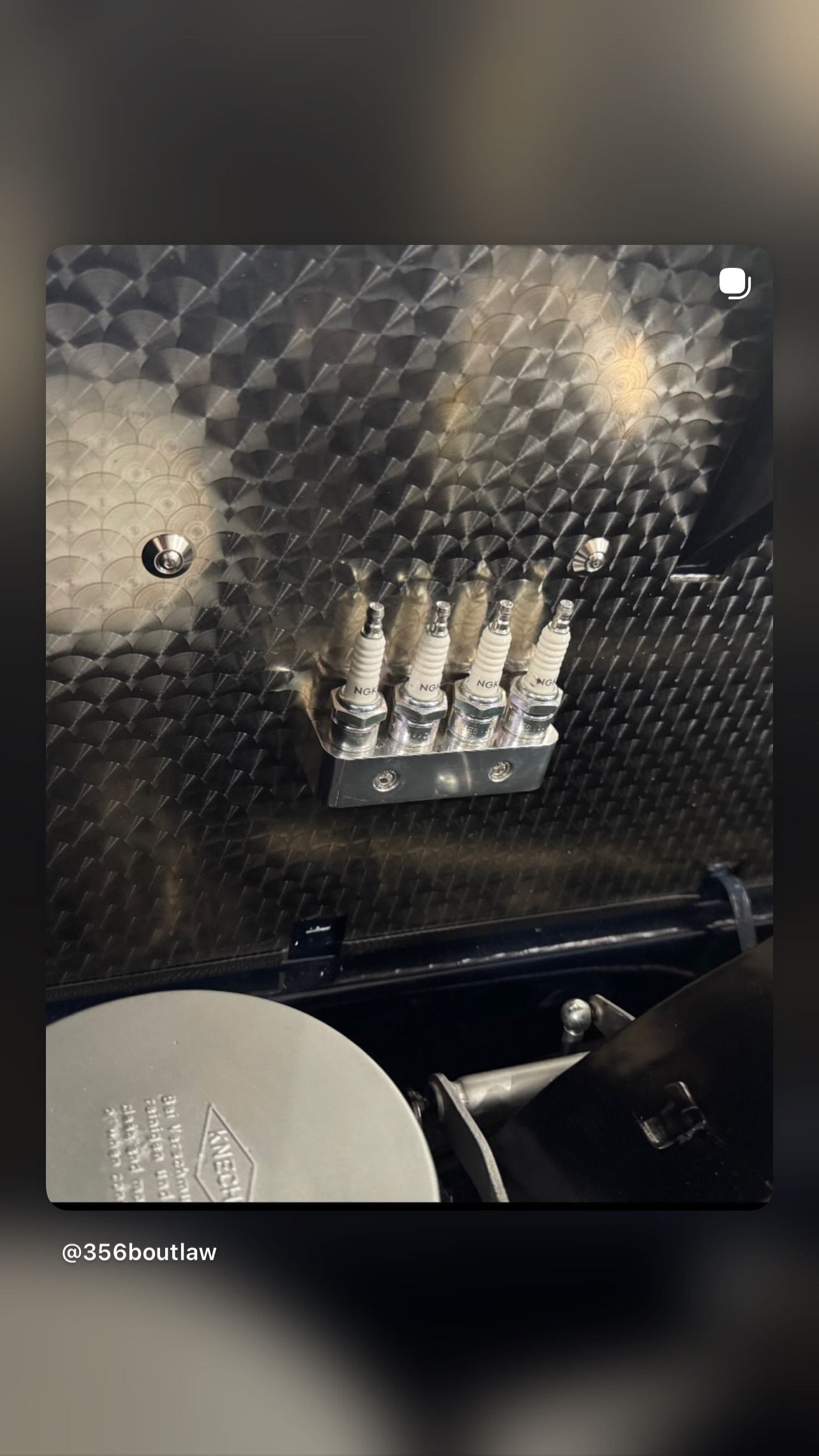

                  • New firewall. Motor installed and Sebring exhaust mocked up. Spark plug holder installed as well.

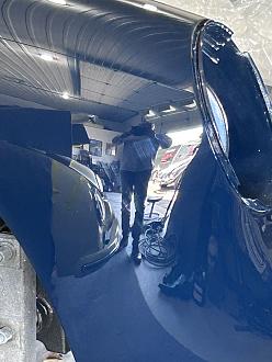

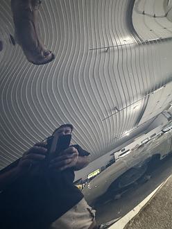

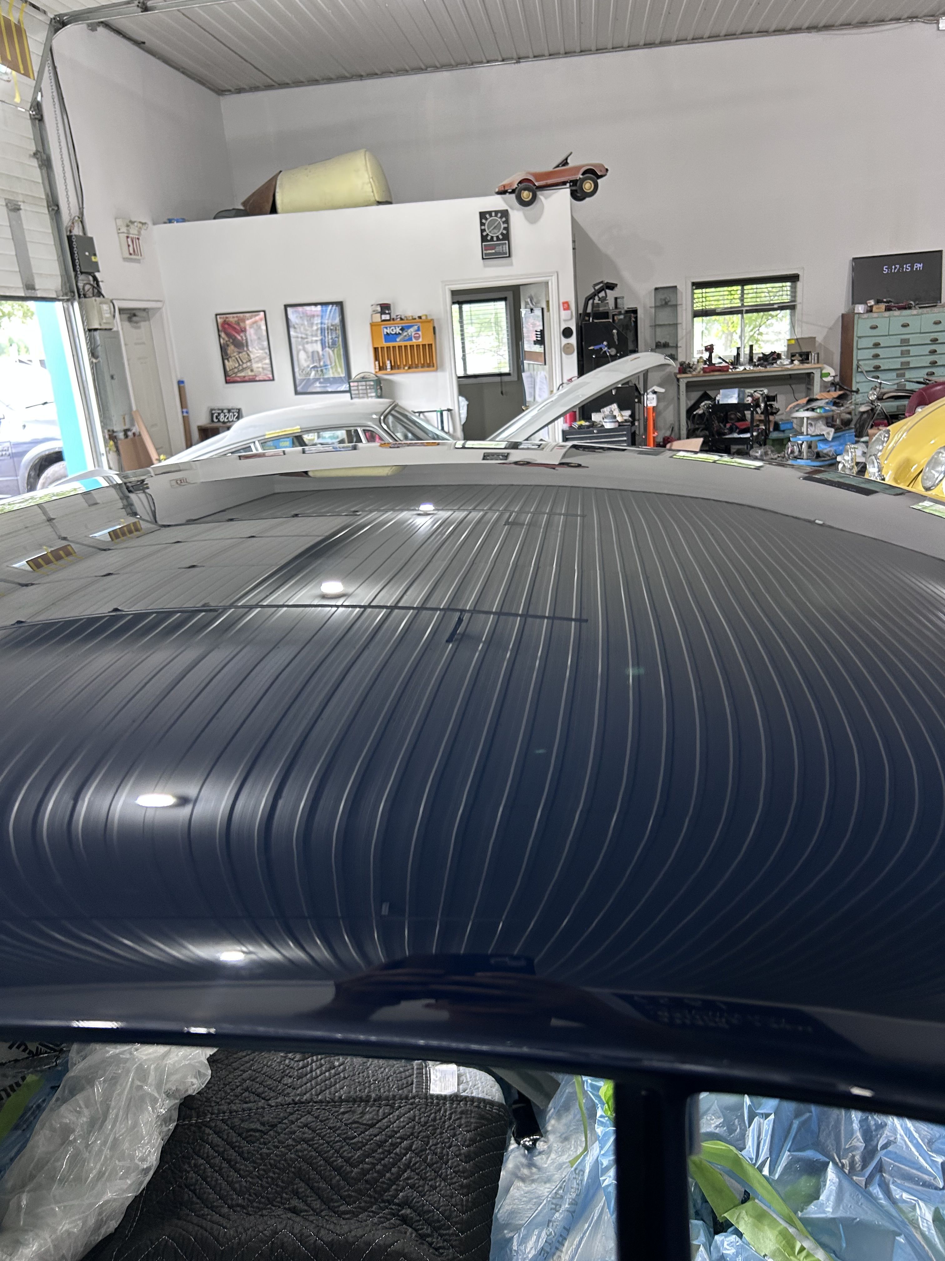

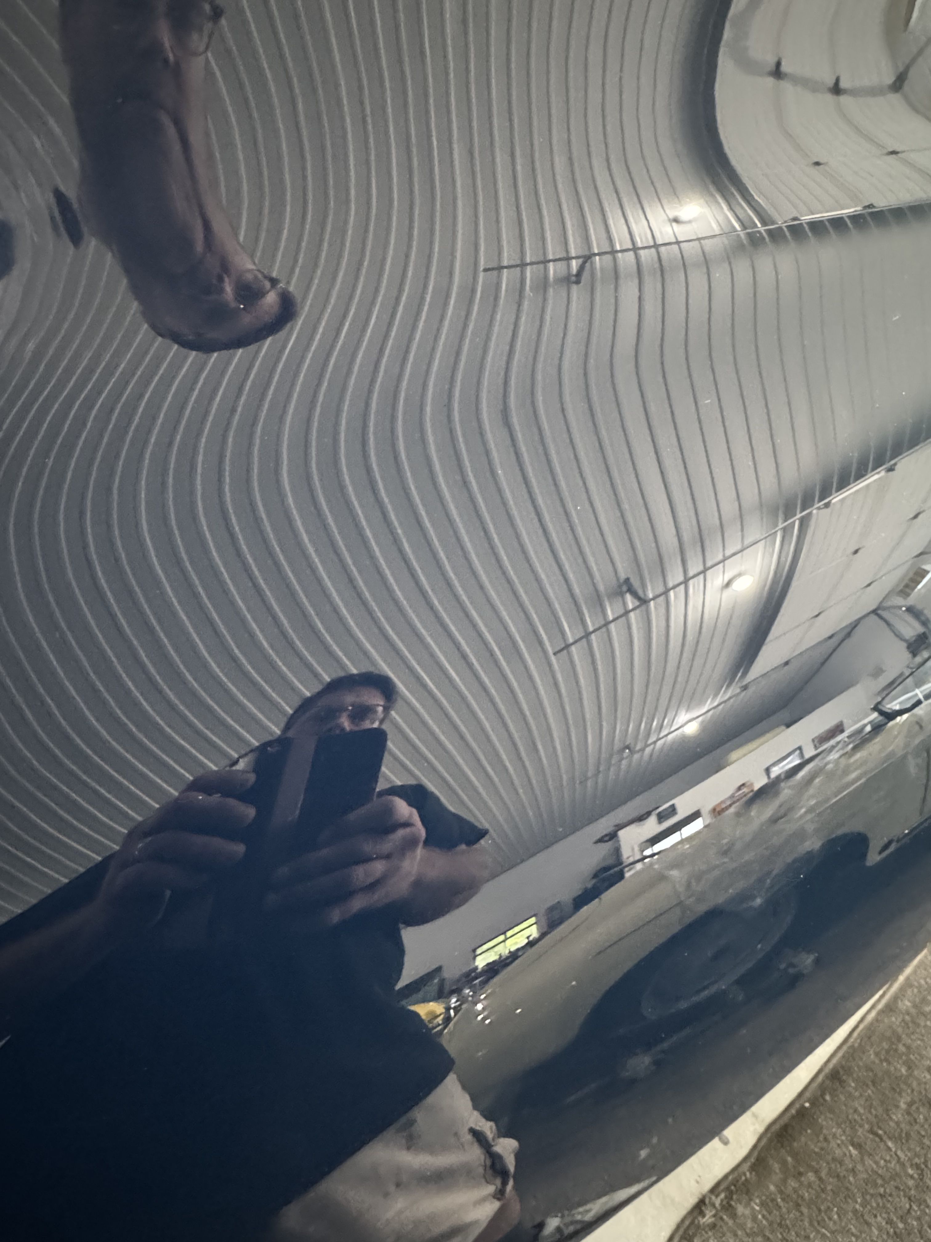

ID:	117342 . Here are some updated shots of body. Wet sanding over a 1000 now and higher. Getting there. Really solid mirror finish.
