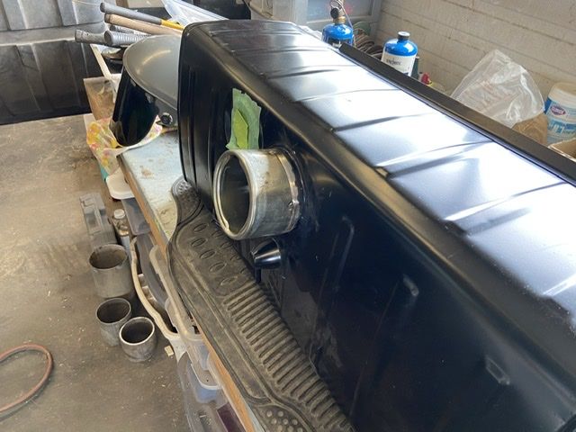

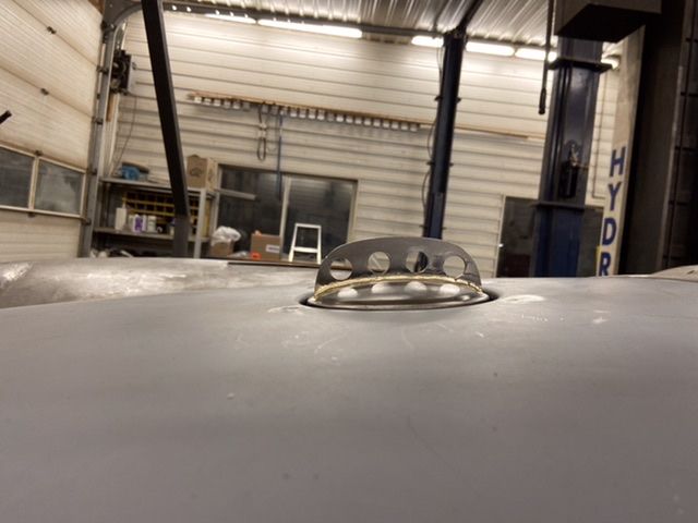

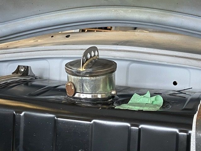

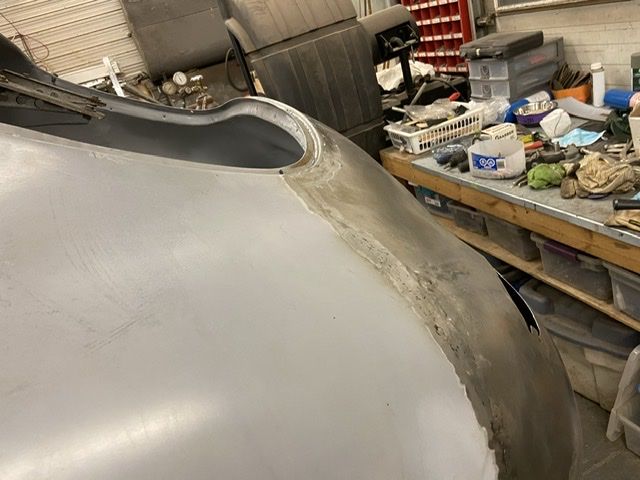

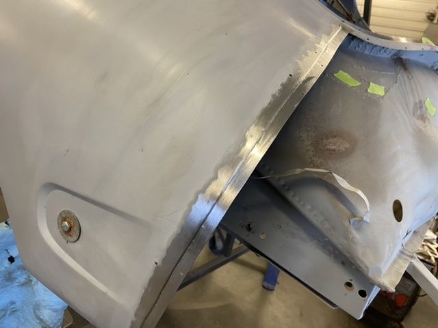

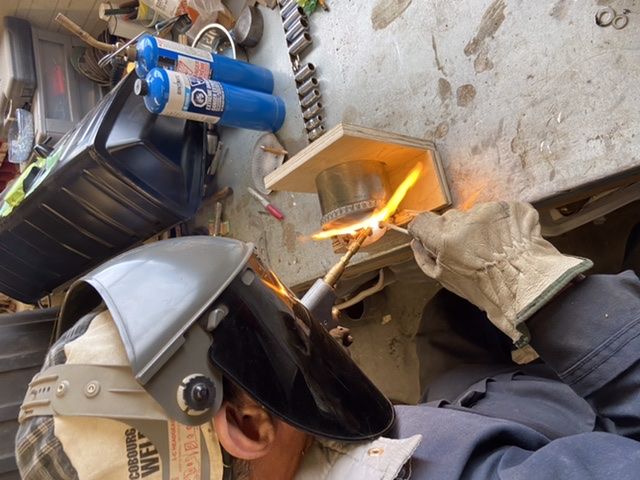

      So made up a jig to hold the filler extension and gas cap to position the four hole grab handle. My buddy bronzed it on and a little clean up and grinding the seam - turned out well. Next trick was to figure out the height and angle of the filler neck extension. Took some math and challenges to cut the angle and then sneak up on the height. I think I am going to go with the gas cap flush with the hood. I have seen examples with it sitting lower. Click image for larger version  Name:	7A1E1942-4EEB-48A8-A876-E28321E65ACB.jpeg Views:	0 Size:	61.7 KB ID:	110795 Click image for larger version  Name:	D9D40590-FD39-4C60-898A-22C7918ACD41.jpeg Views:	0 Size:	50.3 KB ID:	110797 Click image for larger version  Name:	A936EDA6-516D-46B8-BE5F-5980F88018D0.jpeg Views:	0 Size:	44.5 KB ID:	110798 Click image for larger version  Name:	F410724F-56E5-4465-97D8-5519CD845826.jpeg Views:	0 Size:	38.4 KB ID:	110799
      356 Registry main thread;

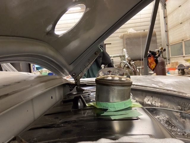

      • Settled on final position and angle of the filler neck. Magnets and a couple of tacks to hold it in place and Click image for larger version
ID:	110802 Click image for larger version
ID:	110803 Click image for larger version
ID:	110804 then bronzed around the lip.

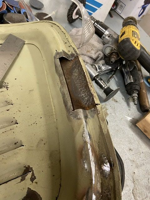

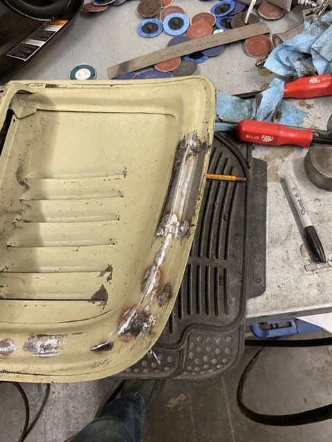

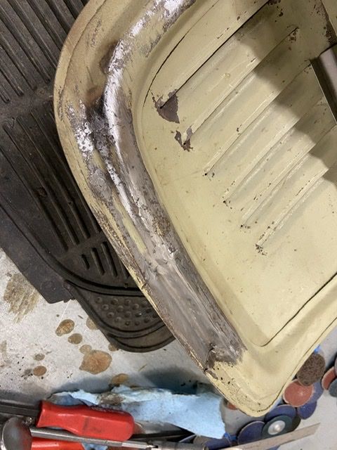

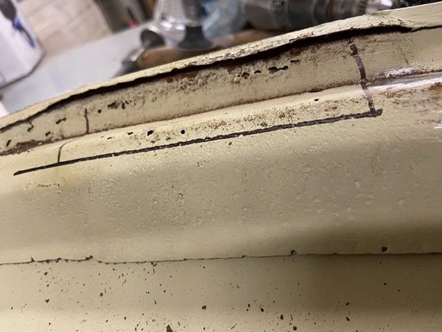

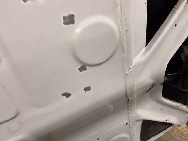

        • Need to focus on the rear now. Will be replacing the rear with a Trevor panel. First job is to address rust issues on the rear lid. Some of the pin hole rust spots are to tough to weld with a mig. Just blows through the lacy thin metal. Fabricated a piece for the worst section.
ID:	110806 Click image for larger version
ID:	110807 Click image for larger version
ID:	110808 Click image for larger version
ID:	110809 Click image for larger version
            small tedious repairs like these almost seem endless and are very hard to get motivated to tackle at times so congratulations on knocking these out.

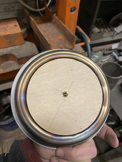

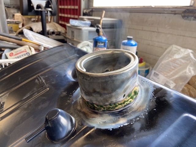

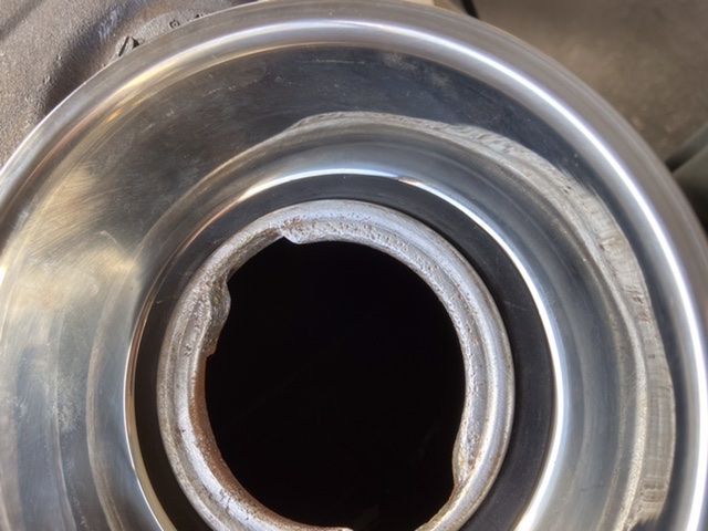

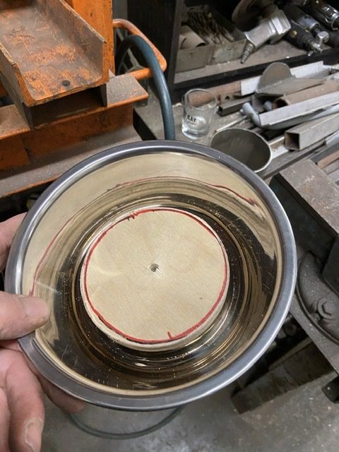

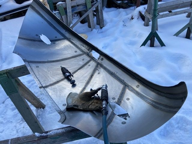

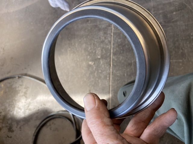

        • Finished up the rain tray - using a dog bowl - cut hole and slide on a rubber u channel for snug fit. Moulded a bit of a curved lip in metal with a press. Click image for larger version  Name:	64D911B2-2E41-4A11-A7AC-A7EE74E9D981.jpeg Views:	0 Size:	50.3 KB ID:	110821 Click image for larger version  Name:	688A3F98-FE49-4006-9F3E-73CC0F8F94C9.jpeg Views:	0 Size:	51.4 KB ID:	110822 Click image for larger version  Name:	41A5A656-07DF-4659-8F31-E742FE086E20.jpeg Views:	0 Size:	43.4 KB ID:	110823 Click image for larger version  Name:	75EECB21-3879-441A-A33F-6EFDC4900AB8.jpeg Views:	0 Size:	47.2 KB ID:	110824 Click image for larger version  Name:	5B451975-FCAF-4C80-8CDE-751B13D1DACC.jpeg Views:	0 Size:	62.0 KB ID:	110825
            Very cool! Repurposing an existing product for your needs, its stainless and shiny, should be very clean in the end. Love it! Are you adding on a drain tube at the base like the originals had?

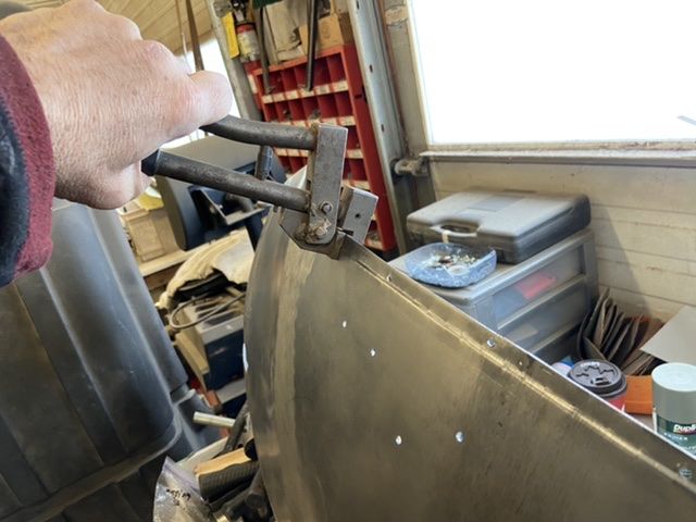

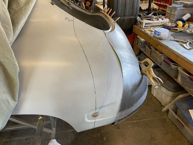

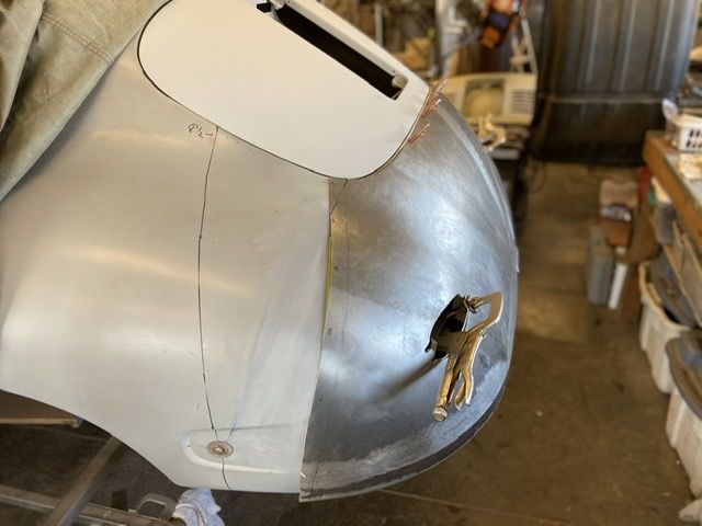

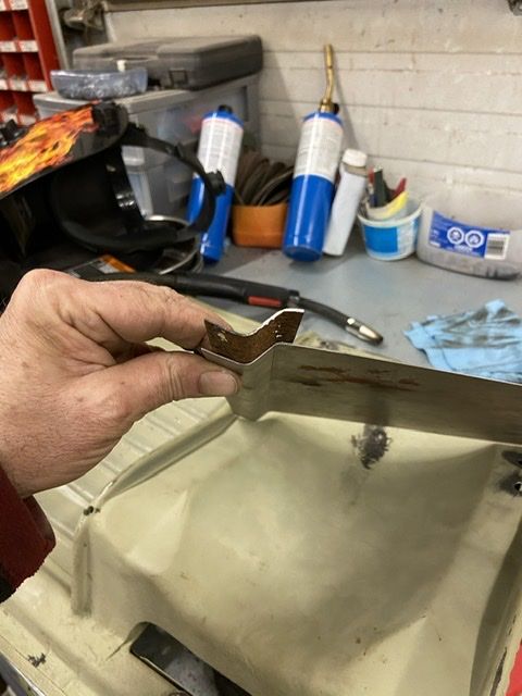

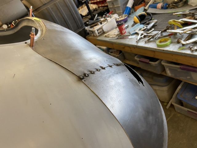

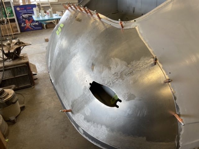

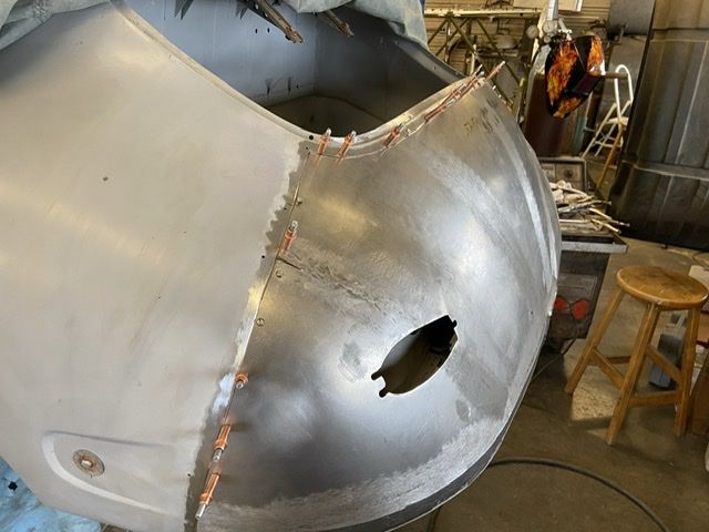

        • Starting to tackle the rear end. I was really tempted to cut in the full new panel but I think it would be more work then it’s worth. Found a compromise just out board of the bumper indents. Started to cut off some off the excess off the new panel. I didn’t like the profile of the rain gutter lip either - Click image for larger version
ID:	110827 Click image for larger version
ID:	110828 Click image for larger version
ID:	110829 Click image for larger version
ID:	110830 Click image for larger version
ID:	110831 to shallow and not deep enough so I have decided to not use this. This may be a problem down the road as I won’t be able to dolly the weld seam but saves a lot of effort in drilling out the old gutter and reshaping the new gutter.

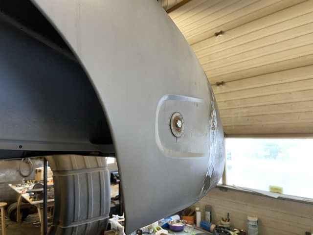

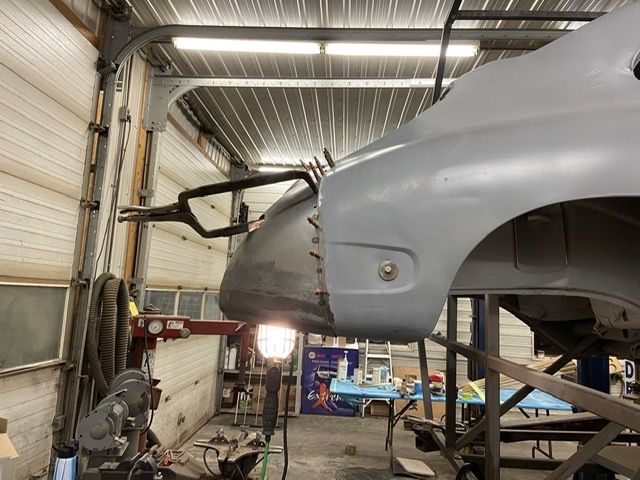

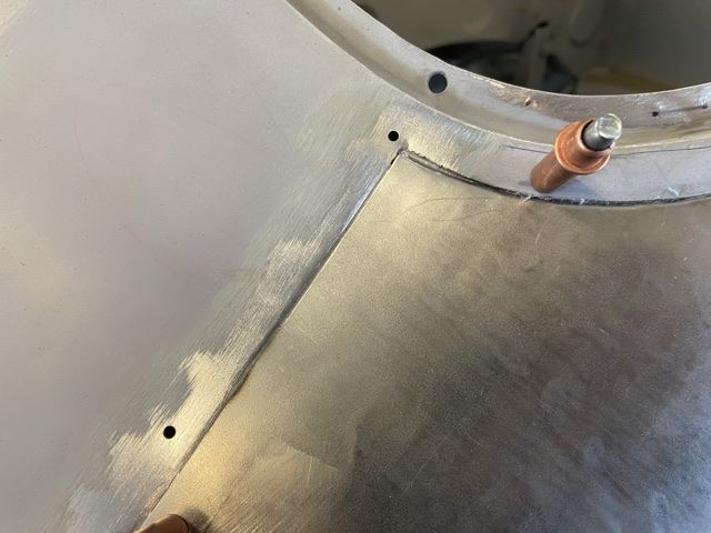

          • Early fit with first cut on the sides of the new piece and the gutter cut off. Worked to get this centred around he existing light holes. Click image for larger version
ID:	110833 Click image for larger version
ID:	110834 Click image for larger version
ID:	110835 Click image for larger version
ID:	110836 Click image for larger version

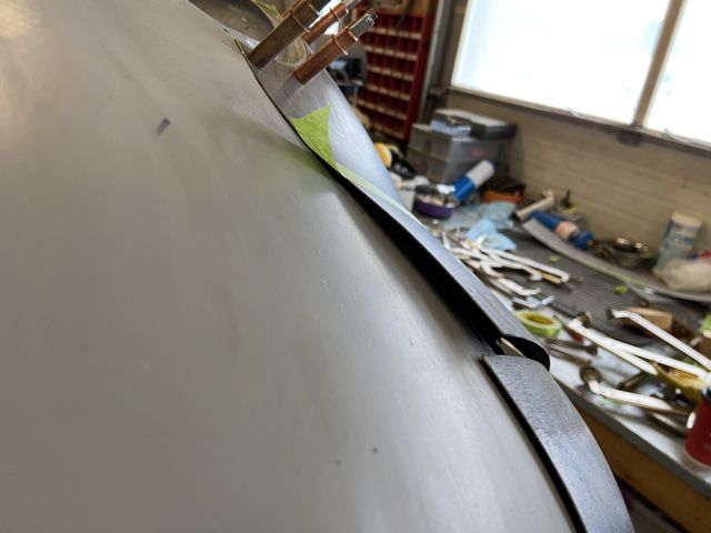

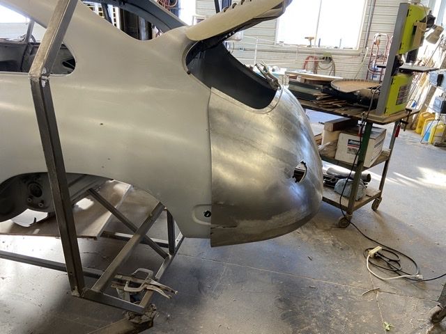

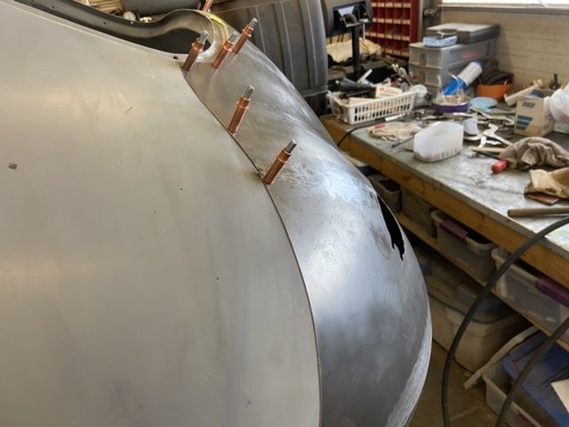

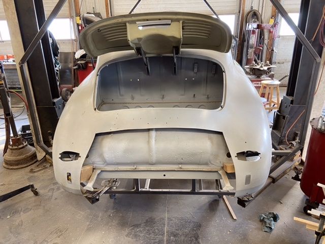

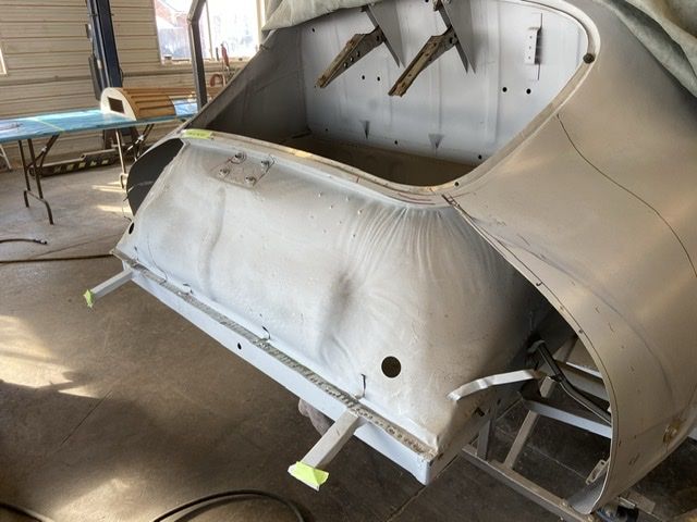

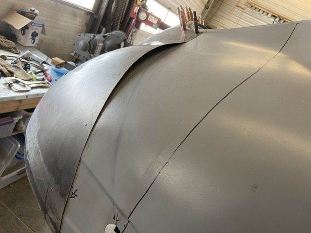

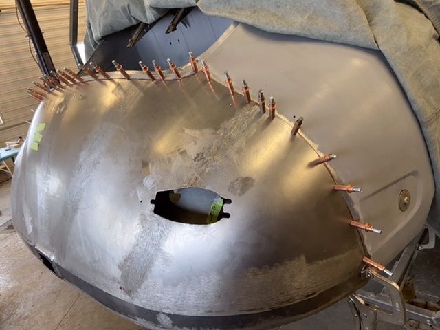

            • Started to tackle the rear with removing some of the old metal to start sneaking up. Clecos around the gutter and then pinned it to the rear brackets. There is a lot of extra material here on the new panel. I can get it close with lots of clamps but a lot force. I think I may have to slit the new panel. Not sure yet. Click image for larger version
ID:	110839 Click image for larger version
ID:	110840 Click image for larger version
ID:	110841 Click image for larger version
ID:	110842 Click image for larger version

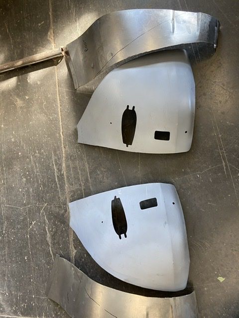

                No surprises there. I found it necessary to cut new panels back apart to suit my specific needs as well. As a matter of fact I asked Trevor if he would be willing to sell me future panels like this unwelded. I figured it would save us both time but he said no. Its coming along nicely Scott....

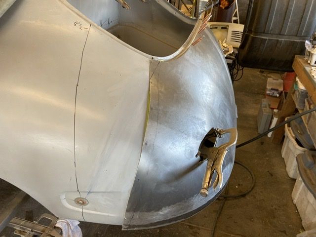

ID:	110851 Thanks Justin - and great to hear your written voice again. Was getting worried I hadn’t seen you post in a while. I hope all is good and you are keeping safe and healthy.

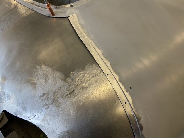

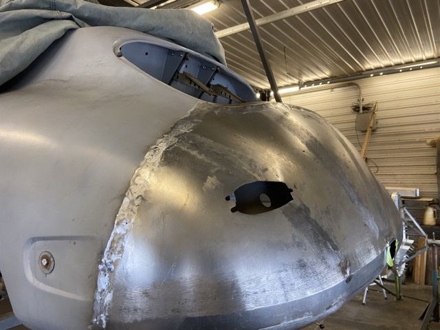

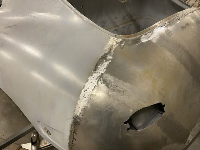

              So I ended up slicing through the original seam. The metal needed some shaping a bit as the curve was more than needed. I then clamped it back on and allowed the two piece to overlap in position. I then tack welded the pieces to together and then took little slices out to butt seam and weld slowly up. I think I have gathered enough metal up to make the left side work now.

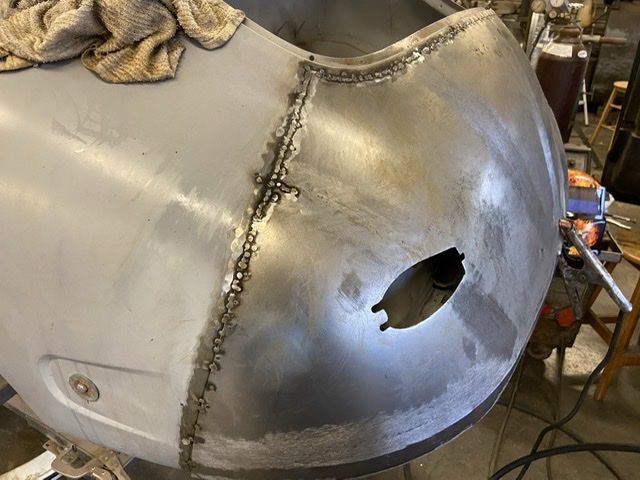

                • Panel all prepared and in final position. Tacked in place - no turning back now - slowly welding trying to control the heat. Click image for larger version

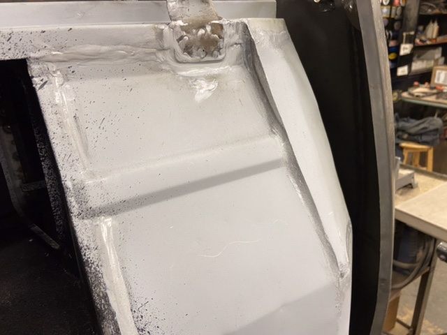

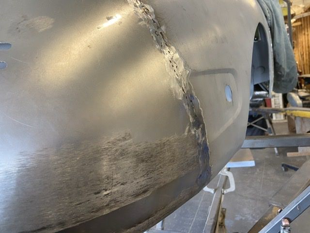

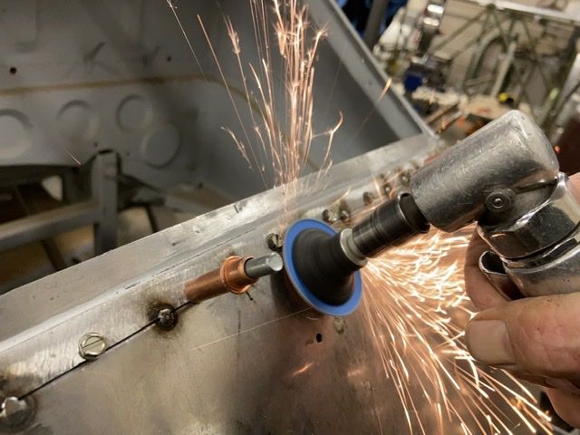

                  • Weld and grind and dolly. Weld and grind and dolly. And repeat....and repeat. Some hours ahead. Click image for larger version

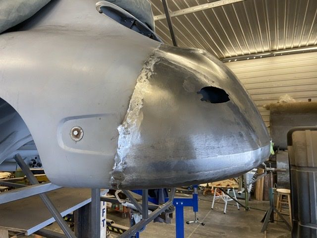

                      • Roy thank you for your kind thoughts. First time restoration but I have a great mentor. Tail is almost complete. Click image for larger version

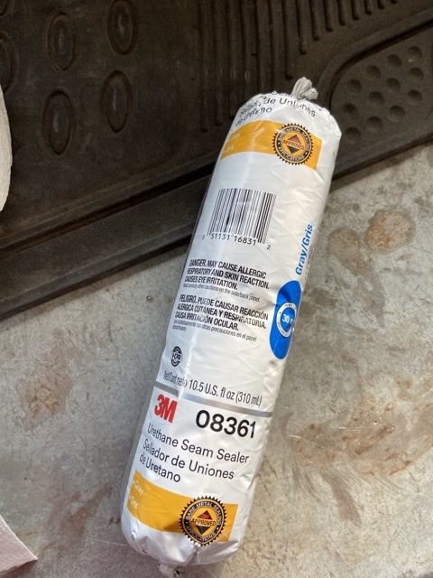

                        • Now starting the long process of seam sealing. Click image for larger version

                            Looks like a package of chocolate chip cookie dough. How are you applying that Scott?
