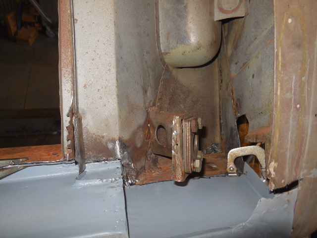

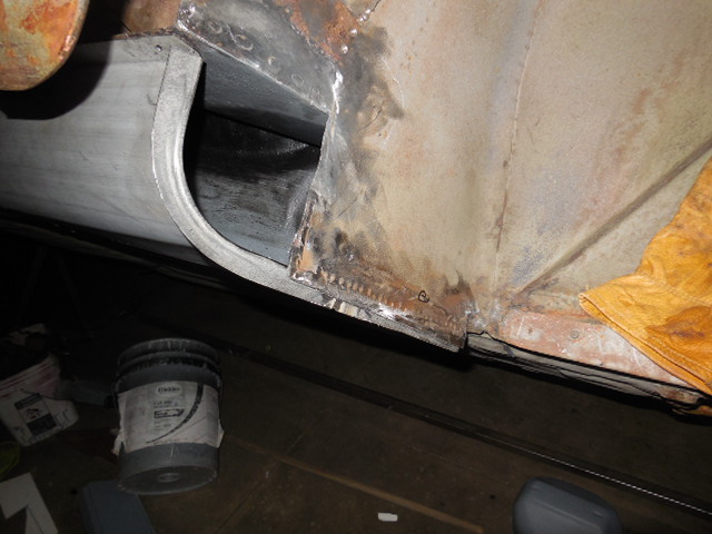

            OK I'm out of the naughty corner, done my home work and now back at work. Getting back at is great after a break; spent the day fitting the longitudinal, on off and on again many times ! I got it almost right and held with some screws, I cut it in half at the heater tube support as per the 'bible' - makes life soooooo much easier.

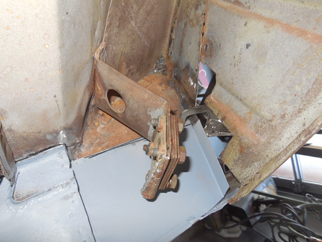

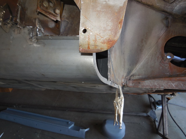

            I need to work out the rocker fitment, it's the original I cut off with a new front "shelf" ...so should go right back, but doesn't The new front shelf (part of the rocker) is fowling the longitudinal or vica versa...(older picture of a trial fitting of the rocker.)

            but will look with a fresh eye in the morning. BUT (on page 37 of Foam Car it shows the front 'shelf' sitting OVER the inner back tray ? Mine was under and the other side confirms this. Is this A Vs BC thing ?

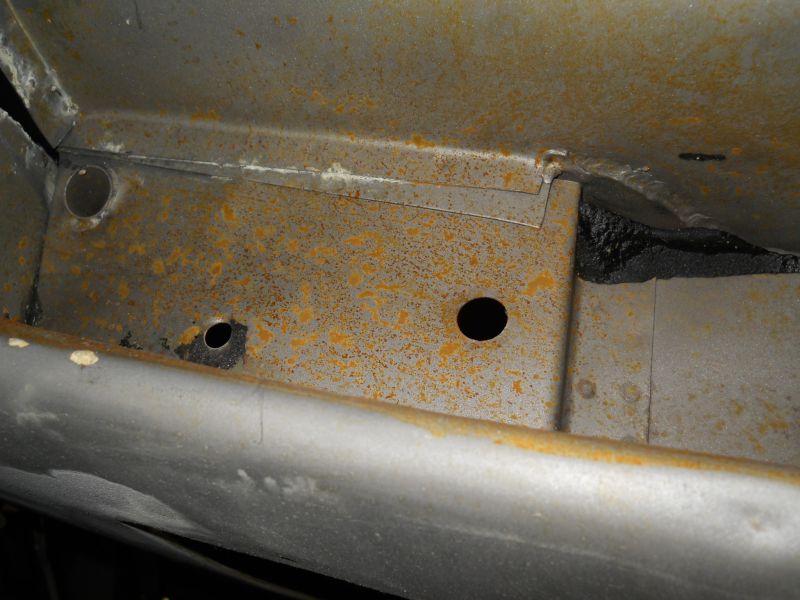

            On the bottom edge in the wheel well, the old spot welds appear high relative to the new metal flange, not sure why but think it will work - will drill new holes for the "spot welds"
            The bottom edge had rotted...

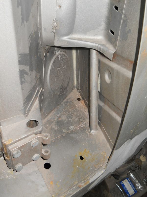

              Maybe this will help - this is as delivered ! The rocker appears to lay UNDER the shelf - but with all the repairs I have see on this site (John and Foam Car) that shelf extends out to fender - so is this some old repair I am seeing ? (my drill holes of course....) Lovely ventilation slots too, ....very Ferrari

                Here's a '57 that was restored over 25 years ago in Europe. It seems to agree with your findings, sans venting a la Fizzahwe.

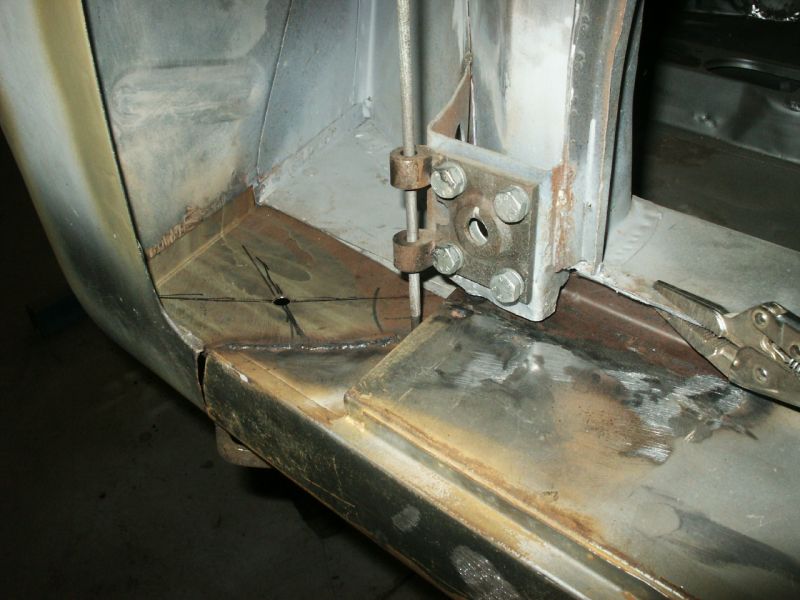

                  Here is how I did my car with the outer longitudinal spot welded to the door cavity floor. A little different than what you have, but it makes installation a lot easier.

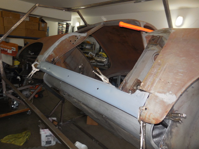

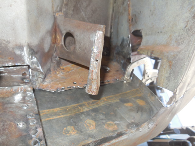

                    Thanks John and Bruce, that is exactly what I needed to see; clearly someone has been in there before and repaired it "the other way". Just goes to show that nothing in this game can be taken for granted.

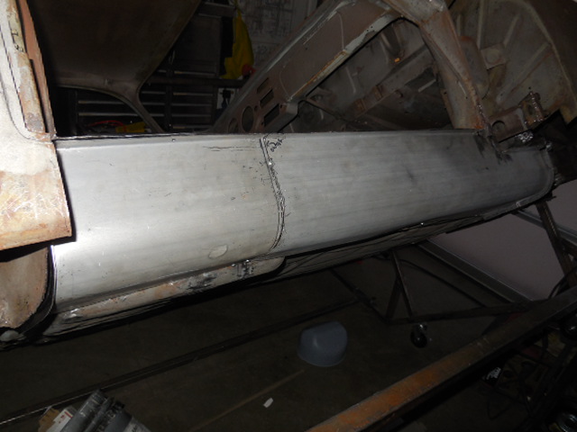

                    So spent the afternoon fitting the longitudinal and then the rocker panel with the front shelf now over the existing,. What a difference a few mm make (said the actress to the Bishop the hinge mount on the body now realigns pretty much dead on, with the cut marks on the rocker.

                    • #55
                      Thanks John and Bruce, that is exactly what I needed to see. I think John I am following the same path as you .... ? However clearly someone has been "in there" before and repaired it "the other way". Just goes to show that nothing in this game can be taken for granted however good the seams !
                      So spent the afternoon fitting the longitudinal and then the rocker panel with the front shelf now over the existing,. What a difference a few mm make (said the actress to the Bishop ) the cut hinge mount on the body now realigns pretty much dead on, with the cut marks on the rocker- will be better still when I come to weld...

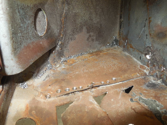

                        Steve
                        Sorry you were mislead by Foam Car. I installed incorrectly the shelf overlap. I realized that much later, and posted about it, but not an easy post to find. Should go back and edit where the pic is with a WARNING.

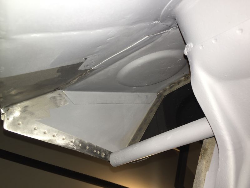

                          Pre-a and A-cars have the drain tray mounted below the longitudinal flange.
                          You have it right for your car Phil. B&C cars appear to have it mounted just the opposite.

                          • #58
                            Justin,
                            Your last picture of the B T-6 shows the outer longitudinal flange spot welded to the door cavity floor then the sill goes on top. It looks like the mounting sequence can go both ways. As you say: it may be a Karmann vs Reutter difference.
                            I also noticed the drain holes in the corner of the door cavity floor and also in the center of the sill plate. It's a great idea, which I can easily incorporate. Do you know if both karosseries put them there?
                            JP

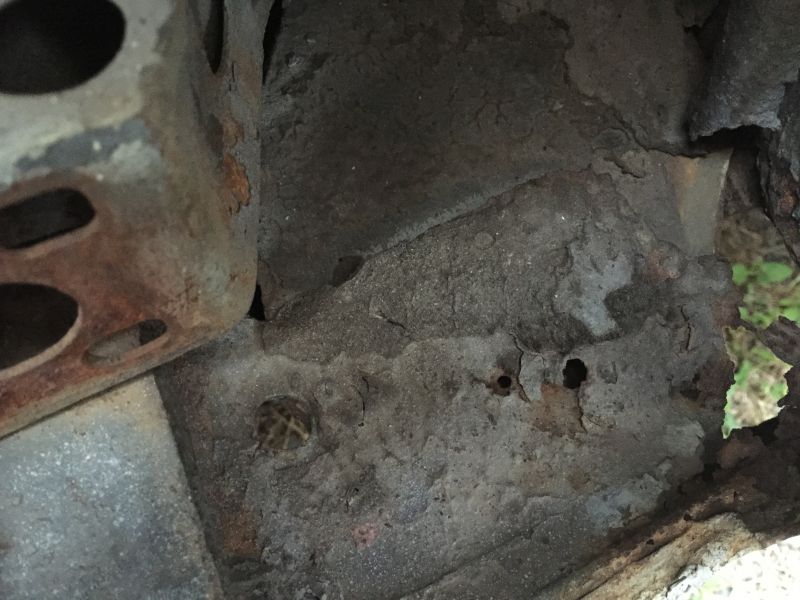

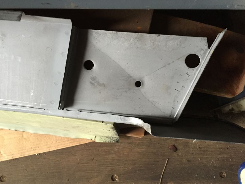

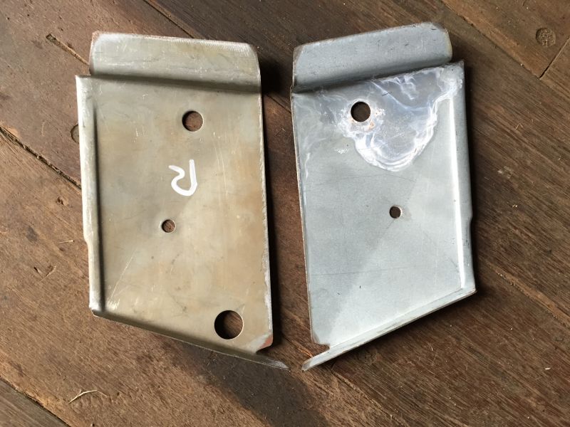

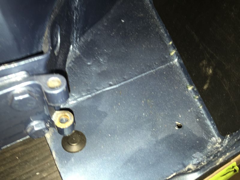

                              FWIW, pics of pieces. All I see are X'd to the drain hole. Usually, the repro's hole for lower hinge pin access is not located correctly and small disc welded in and a location marked from the hinges down.
                              The two separate rocker pieces are for the later T-6 bodies, the right side part having the drain tube pass-thru hole, T-5 on back would not.
                              As for that overlap and drain hole being different from R to K, it is not on my list. Whether an oversight or indifference, all I can say now is that the only untouched original I have here that is easily accessible is a Reutter T-6B and it has the forward sill plate on top.

                                John, my last two photos are of the same car and everything there is factory. If it was my car that's one drain hole detail I would not follow as that hole in the door well corner gives water direct passage into the longitudinal cavity.
